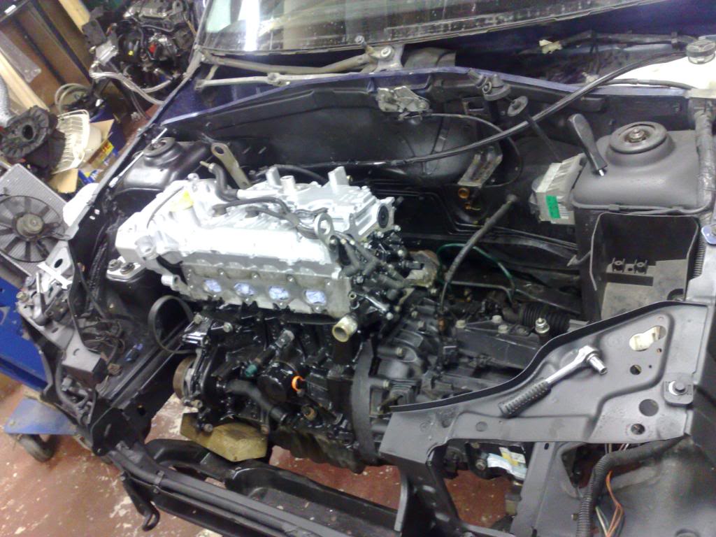

Put the wiring and loom building to one side for tonight and got stuck in with the engine itself.

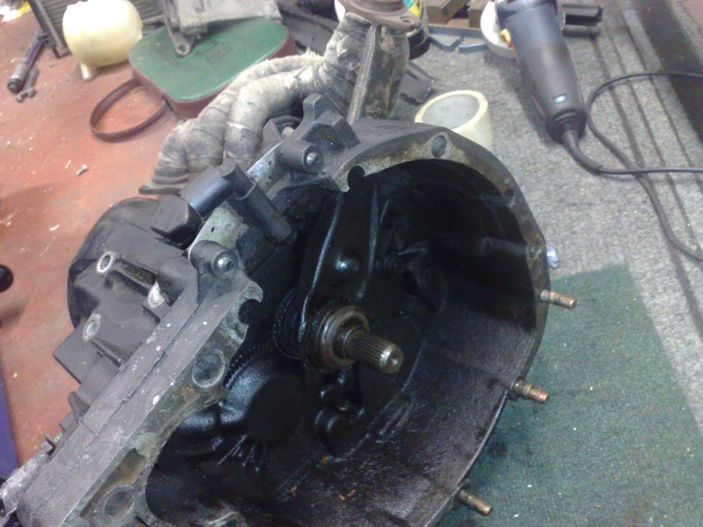

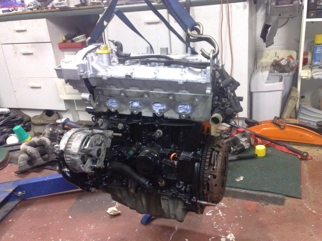

I picked a clutch fork pivot bush/cap up from Volvo on the way home from work which is needed with the longer fork the 172 uses. So I needed to take the gearbox off the old F7P. Not touched the gearbox at all since I bought it, a 20 quid special from Mark One which is now on its 3rd engine since it's been in my possession. Cant guarantee how long it'll last, but I'll address that issue when the time comes.
Valver loom to one side and box off

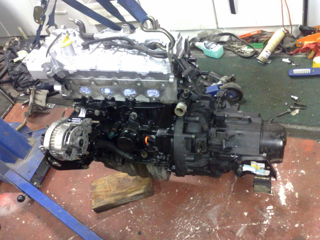

F4R ready for box. Clutch cleaned after I spilt a bit of oil over it before
172 clutch fork, release bearing and pivot bush fitted in place of old valver items. Cable riser bracket needs to be added later on as per 172's.
Gearbox on

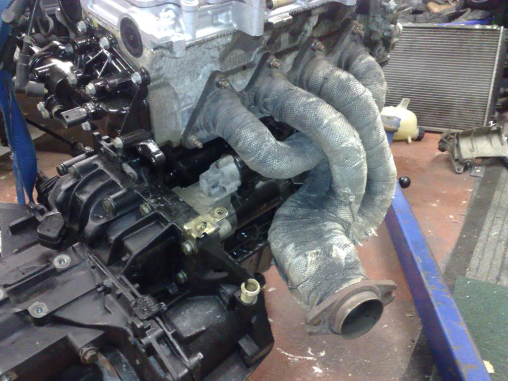

Starter motor and exhaust manifold fitted

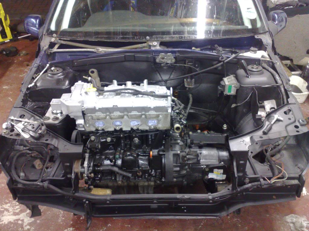

Then, as if by magic, it's in :cool:

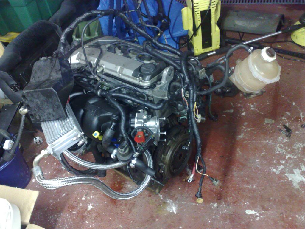

I think i'll go without for the time being, keep an eye on temps and make sure I'm happy before I think about selling it. If it was a higher spec build then yep, but with so few people running them in 172/182 track cars I think it'll be OK.
It'll keep things tidier without too, was a royal pain routing the pipes before and would be even worse given the bigger raditator. Your thoughts?
  clio 1.8 16v, civic vti
im going to fit an oil cooler when i change my engine as on a stage the oil temps were getting well above 100 degree's
  BMW M5 & E36
Yeah, on my old old (now dead) F7P, the temps were getting rediculously high which is why i fitted the cooler for F7P#2. If I was sticking with that, or fitting an F7R I'd be 100% keeping it. F4R seems to run alot cooler on the whole though, or maintains its temp better anyway.

Just on the oil cooler is the Sandwich plate a thermostatic one?
If so i'd be tempted to fit it anyway as wont do any harm..
  BMW M5 & E36
Awesome car :cool:
Mocal thermostatic job yeah. I agree that it won't hurt to run it anyway, just it'd make things alot easier without. I'd need to get a new pair of pipes made up too as the old ones struggled to reach around the smaller mk1 radiator.

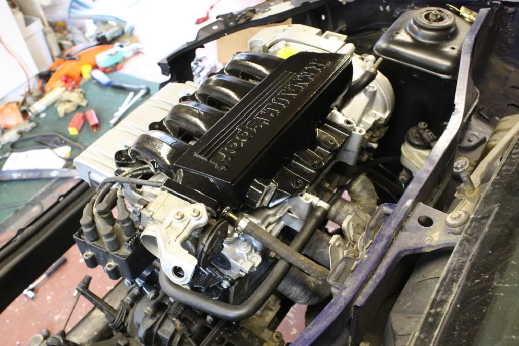

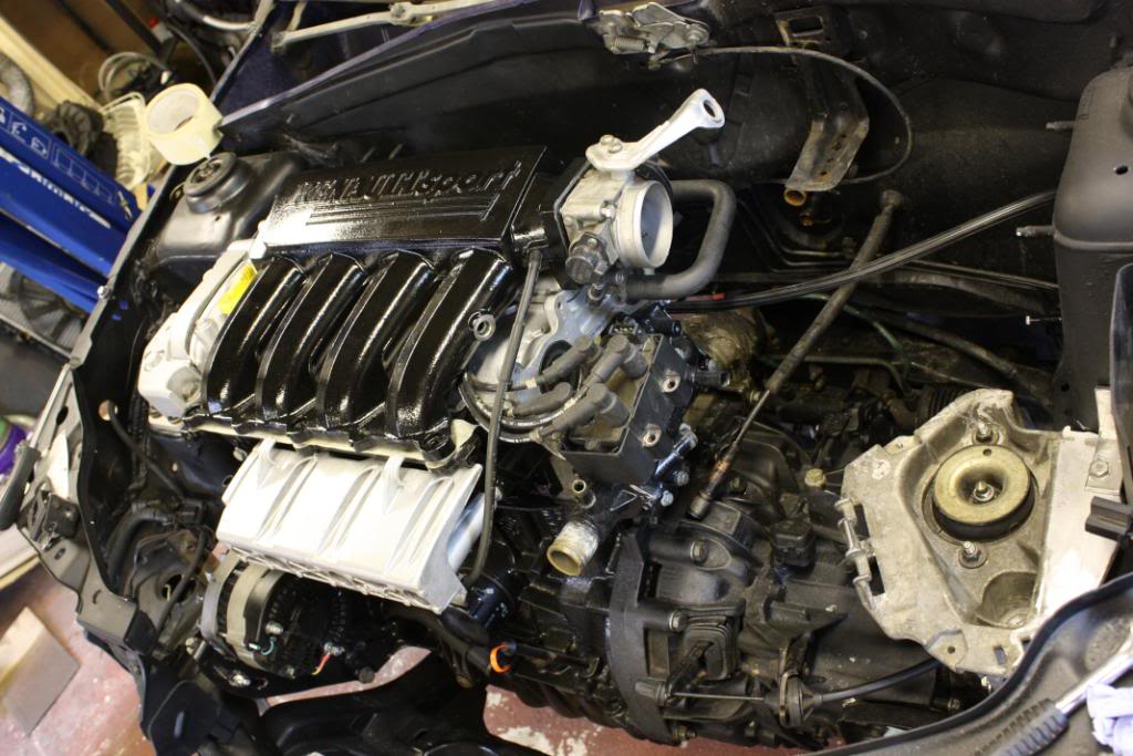

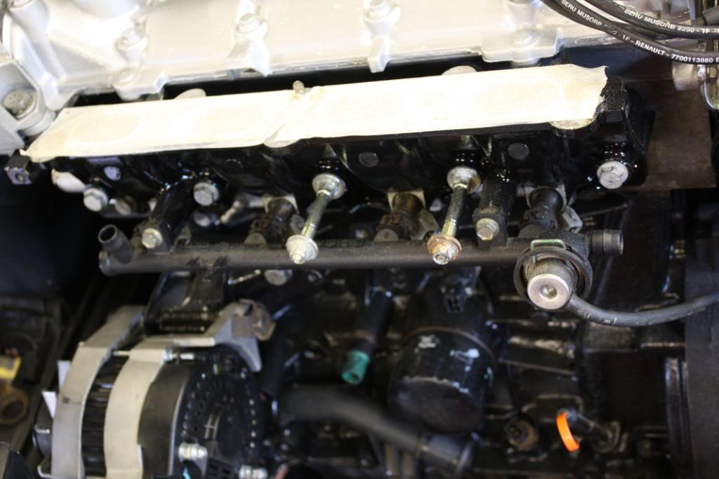

Got hold of an early Ph1 fuel rail and a couple of fuel lines from Beaniemoo the other day. Fuel pressure regulator on the rail in the same style as the Valver rail, rather than being regulated at the tank as per later Mk2's

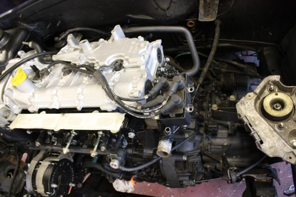

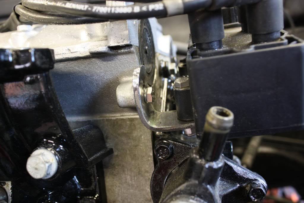

Made up a small bracket to mount the coilpack just above the thermostat housing

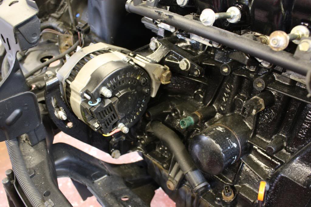

Alternator taken off the other engine and fitted along with the brackets and 5 rib belt

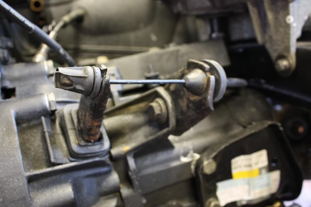

Clutch cable riser bracket fitted and then the cable put on. Pedal feels lovely and soft/smooth compared to what the valver one was

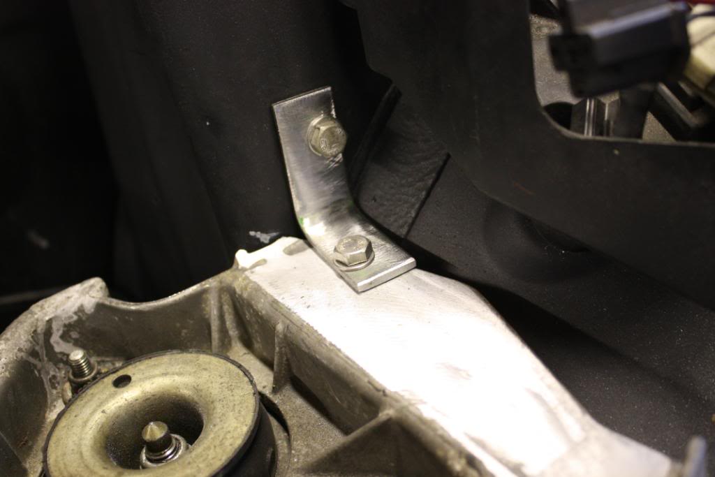

I'd been using a broken battery tray/top gearbox mount for a while now as I snapped the top lug off one day which bolts up onto the inner wing. Not the end of the world, but it wasn't as solid as it should have been. Not got hold of another tray yet so I made this up instead. Does the job just fine and uses 2 exisiting holes.

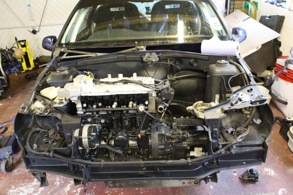

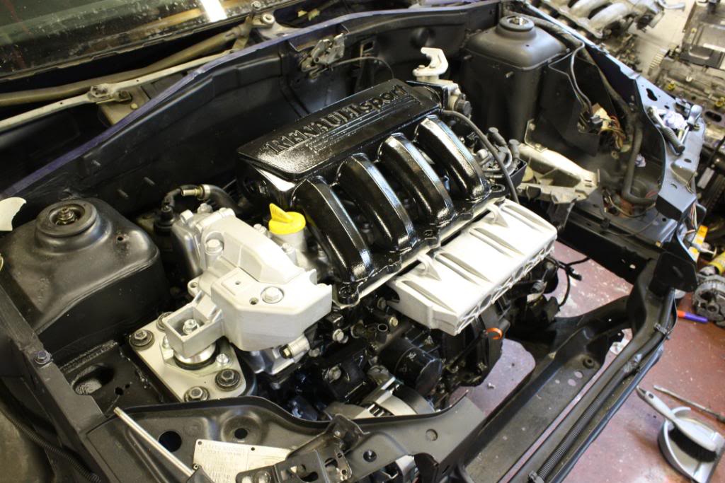

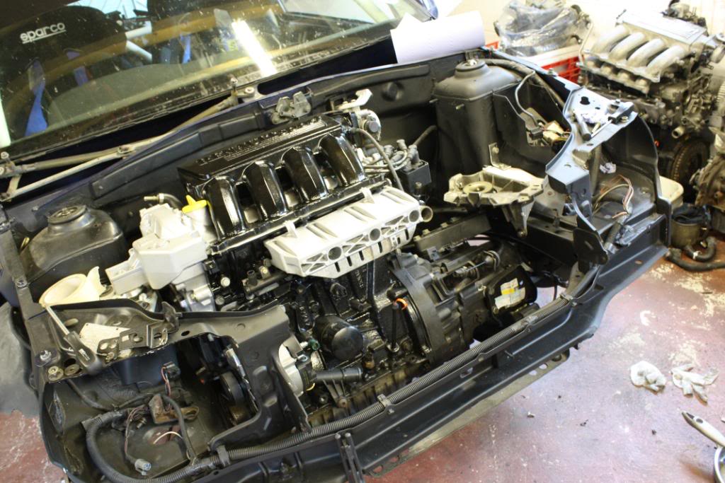

So it's now sat on all 4 mounts. I also adjusted the solid dogbone mount so that the engine sat in about the right position for the exhaust to be clear.

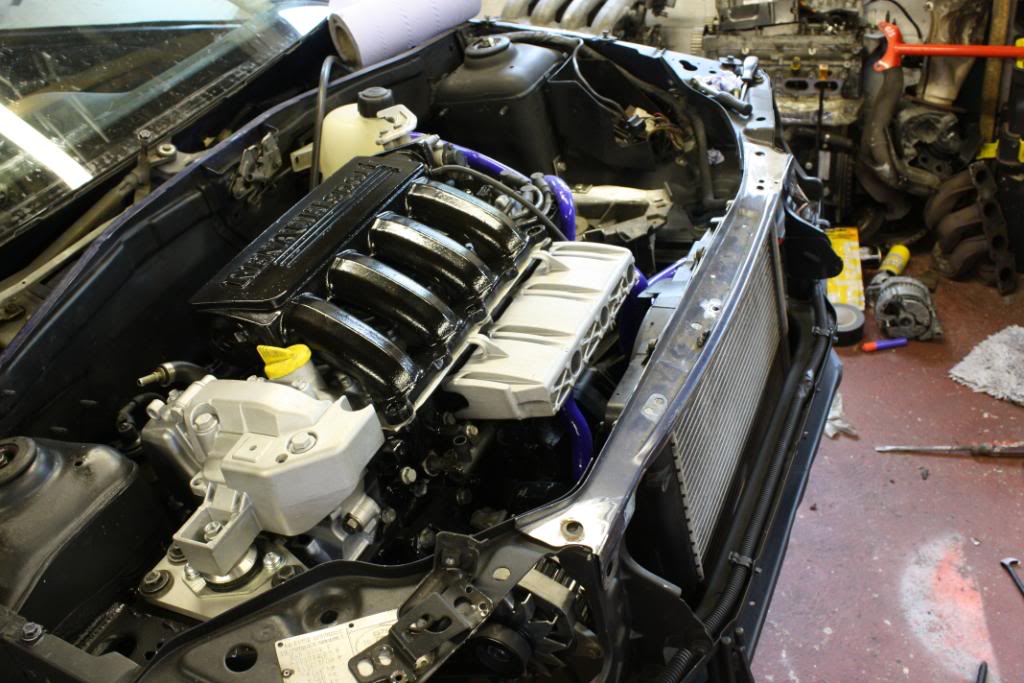

Top inlet loosely put on. I need to get a new set of plugs yet so no point bolting it down. Now the engine was in position it also showed me that I wouldnt be able to run my strut brace, despite cutting away the majority of the coilpack mount on the back of the inlet. Not far away, but not quite there.

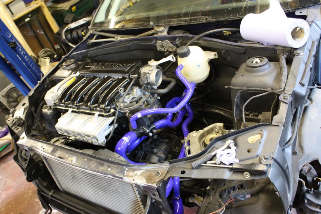

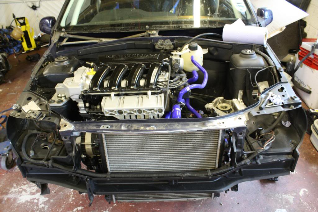

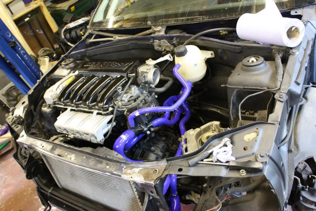

Finally checked fitment of the radiator and hoses. Makes me feel good seeing it look not too far off being done :D
I need to find a reducer of some description for one of the heater matrix ports as the samco is too big.
'Nearly finished' ;)

If you know the size that I need off the top of your head, and where I might find one that'd be good please. The top port is fine, it's the bottom one thats too small for the hose.

Get the mocal push fit types.. Pretty sure I even have a few spare fittings and push on type hose in blue as well ;)
Although they are a total b!tch to get over the barbs :rolleyes:
