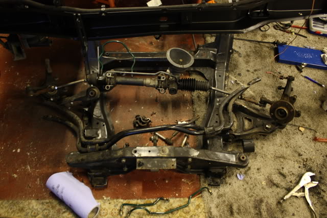

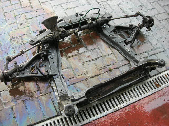

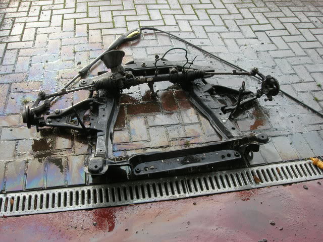

Dragged the subframe outside and pressure washed it off first of all. Was covered in rubbish mainly where one of the CV boots had split previously. Revealed a fair few rust patches, so I'll treat that and give it all a once over in good time.

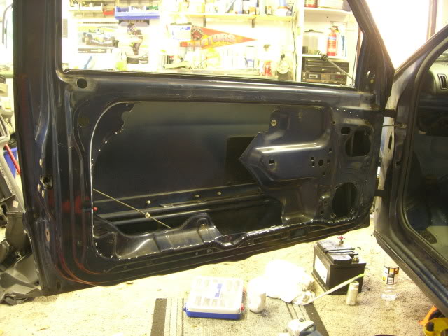

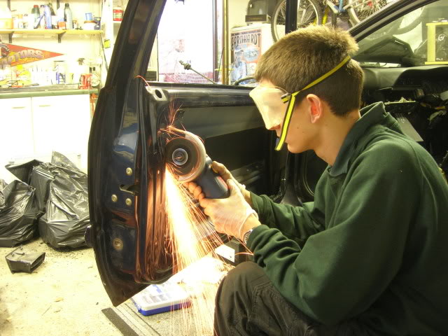

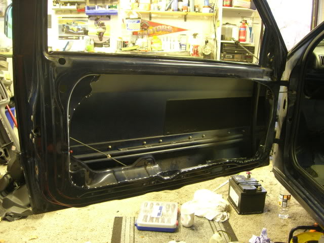

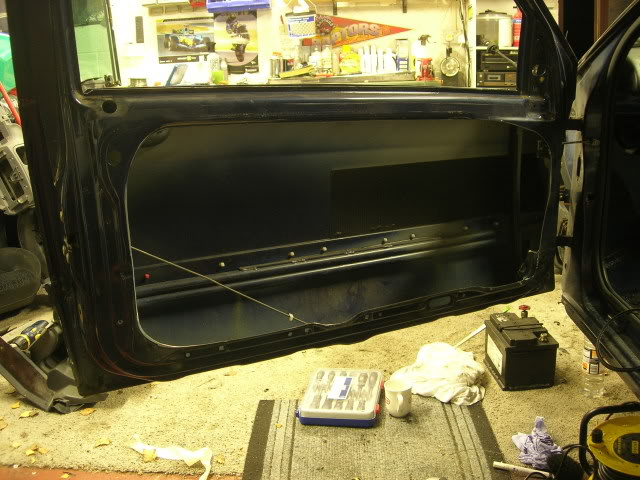

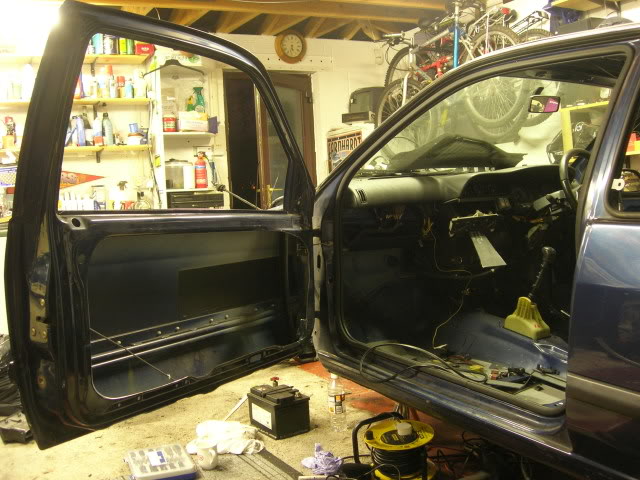

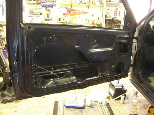

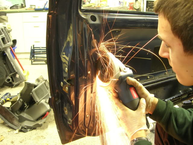

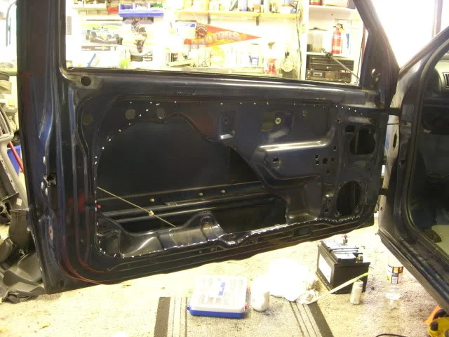

Next I started chopping my N/S door to bits! You may have noticed the drivers side has barely been touched yet and still has the glass and winding mechanism etc still in, so I'll try and get everything right on the passenger side so that I can make a decent job of the one I'll see the most.

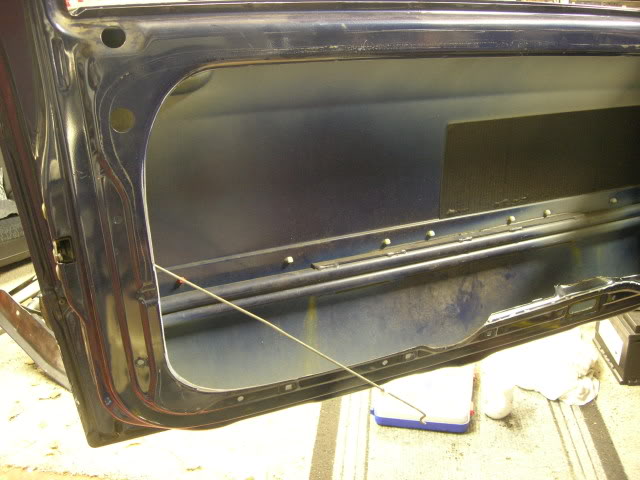

No need for any door internals at all. Fixed windows eventually and no chance of any speakers ever going back in.

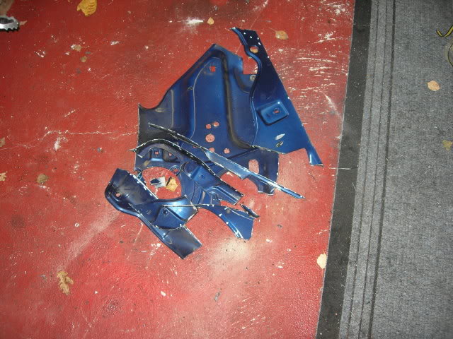

Not a bad curve in the end with an angle grinder
All done bar the small part inner/bottom

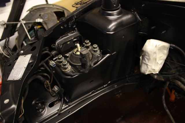

Not a great deal to report I'm afraid, progress has slowed somewhat!

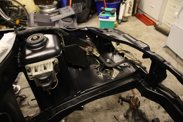

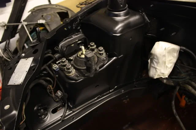

I stripped the engine bay of most bits and set about cleaning/degreasing that ready for some paint. Settled on satin black rather than a daft colour which briefly crossed my mind. Couple of coats of paint then started putting a few bits back in.
Finish is alright for rattle cans and not a great deal of prep work. I've done it to get everything back the one colour and protect the bare areas more than anything, so I'm happy enough.

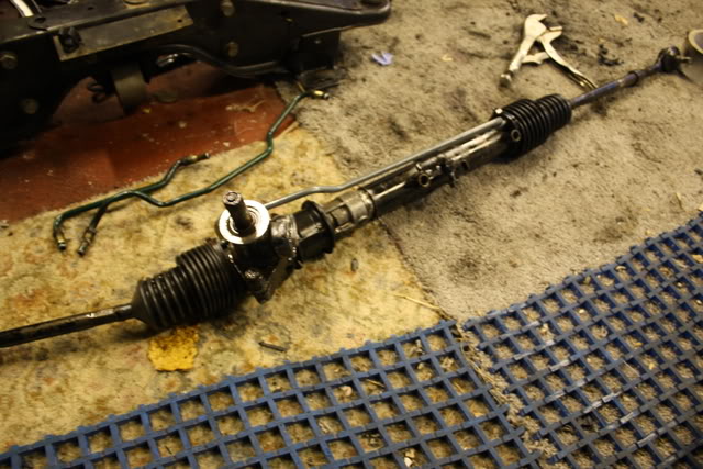

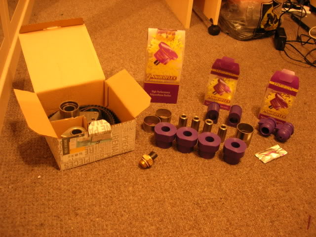

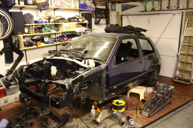

I drove 250 miles yesterday to pick a Williams steering rack up from f0xy. It will get the same treatment as my valver rack with the manual setup. Advantages are 1/4 turn less throw lock to lock (2 3/4 ish as apposed to 3 on the valver) and the arms are longer to allow for the widetrack. I could of got away with using the 1.8 rack, but I'd prefer a few more threads of the track rod ends wound in for peace of mind. Need to get 2 new rod ends for it and manual-ise it, but then it'll be good to go:

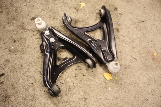

Collected a pair of R19 16v wishbones from a local motorfactors complete with balljoints. Cost a bargain £14 each plus the VAT, rather than £28+ that GSF wanted.
19 16v Anti roll bar also arrived from a guy over on WilliamsClio site. (Amongst the rest of the subframe bits)
Car as it stands. Yep, still in lots of bits.
I've decided on a slightly different approach to the widetrack setup too. Rather than keeping the valver brakes/hubs and sourcing a pair of Williams driveshafts (rare), I'm going to swap it all out for 172 items which will give me 280mm brakes as opposed to the standard 258mm too.
19 16v Goodridge brake lines and a short shifter kit on the way too.
So to summarise, a fair bit more spending and not a great deal more progress!
