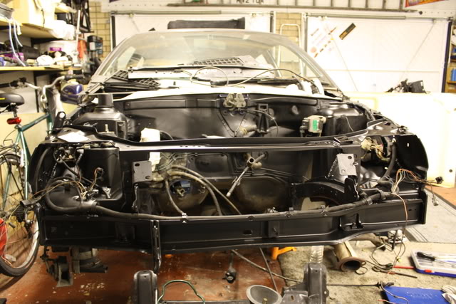

Another picture I got of the newly painted engine bay:

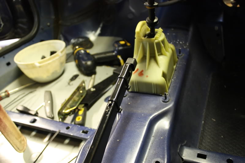

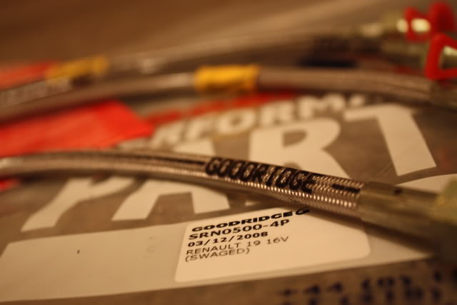

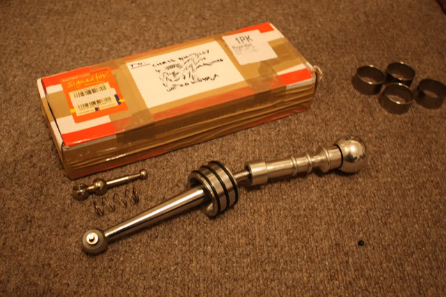

Seems like I'm forever bumping this. But more parts. Short shifter and shorter outer sleeves which I apparently need for the wishbone bush's, but we'll see. Is that all the parts of the short shifter for anyone who's had one before?

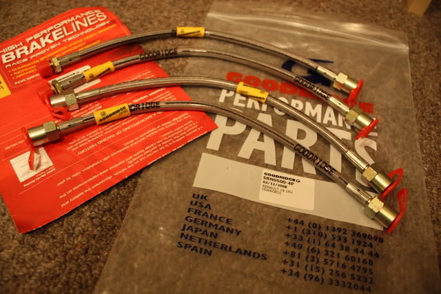

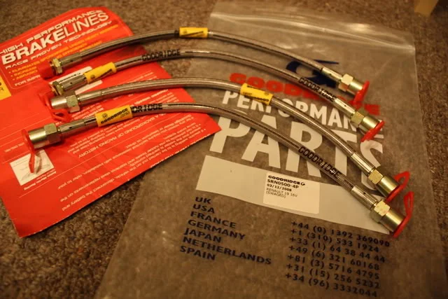

Brother wasnt awake to receive what I assume was my brake lines too :(
Yep that's all the bits i got with mine.
As for bumping the thread, if you got more work done on it :rasp:, you'd be able to report more! ;)

Il see what your's is like with the short shifter on before I get one....dont know if to or not atm
Foxy, i have the same one on my 172. it's brill, put it this way, i can change gear quicker than my clutch foot moves!

My release bearing is fucked so when I swap that and the clutch, I'll chuck one one! Link???

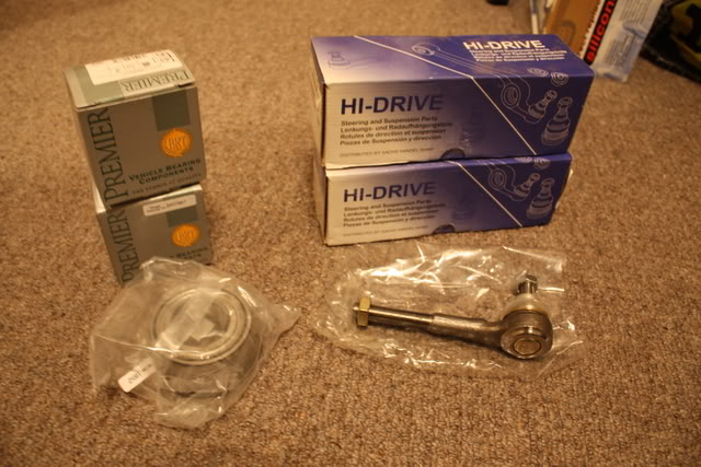

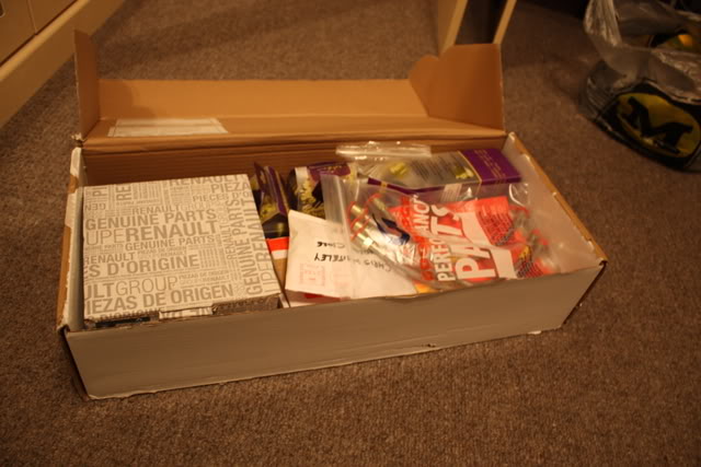

Well, predictably, more parts. Picked up some track rod ends for the Williams rack and wheel bearings for the 172 hubs when they arrive. Also had the tyres taken off my Williams wheels so I can refurb them when I get chance. Colour suggestions?

those rod ends? are they special in some way? Look a little longer and better quality than oem.
Re: Valver Track Car Project Thread
Nope, HI-DRIVE specials ;). £4+VAT from my local motorfactors. GSF wanted £13.90+ each.

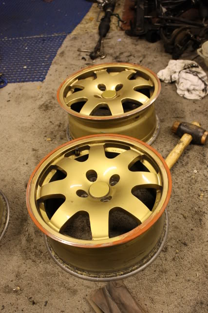

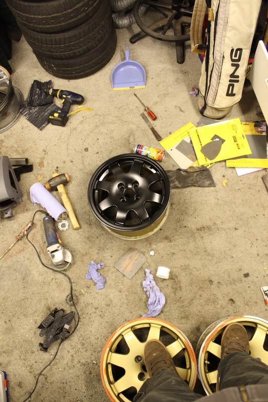

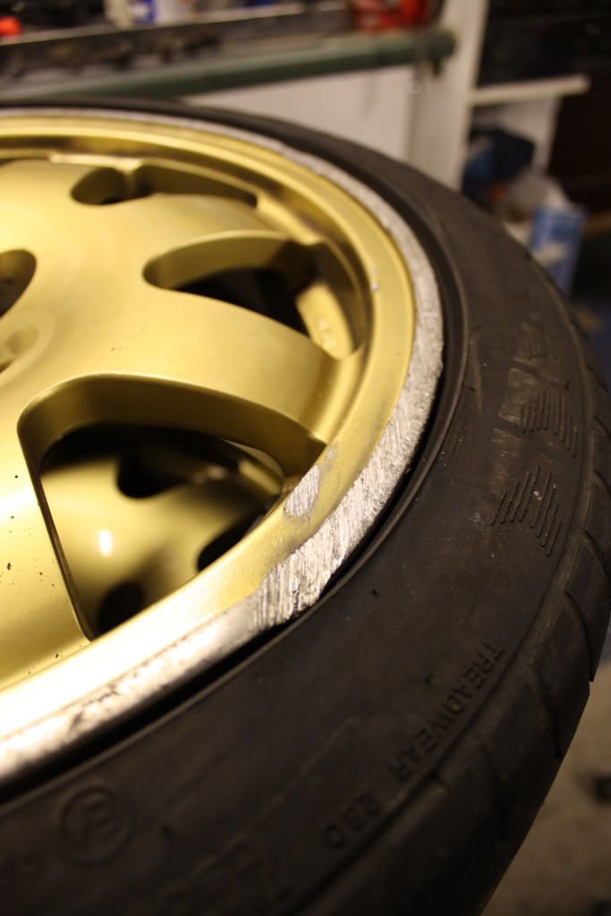

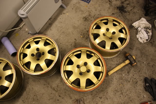

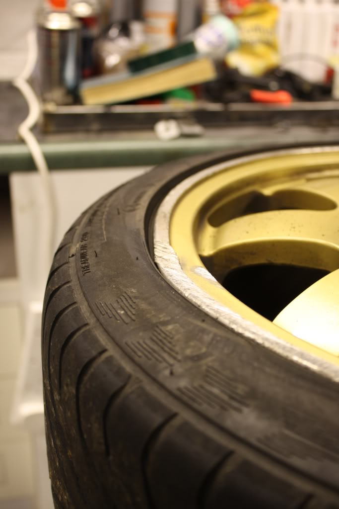

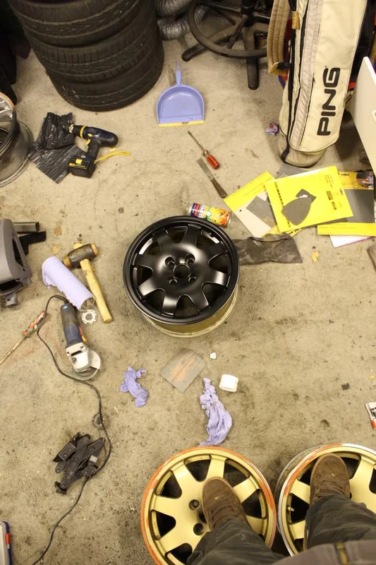

Had an hour or so on my set of Williams wheels this evening which came with the car. They were in a sorry state when I got it so I've had the tyres taken off to give me a chance to refurb them before I get new tyres sorted. To give an idea of what I had to work with, this is the worst one of them before I started:

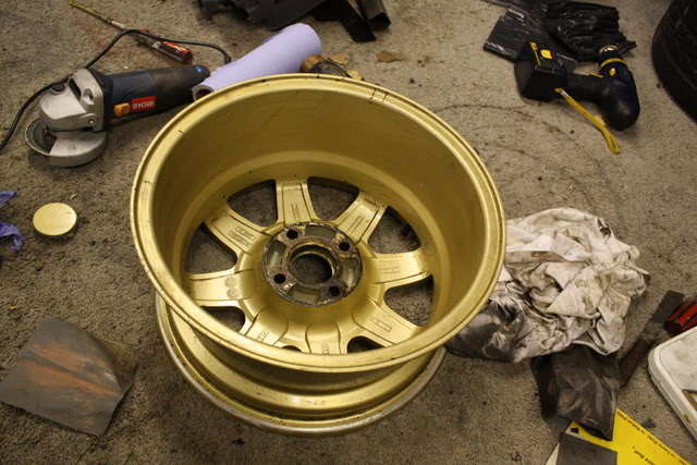

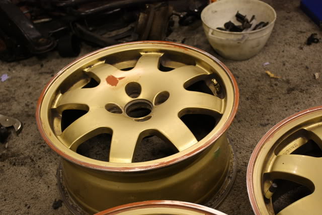

I'm using some red putty to help repair the curb marks that's used for filling welds in at work. I don't expect them to be perfect at all, just something that's useable and not obviously ruined.

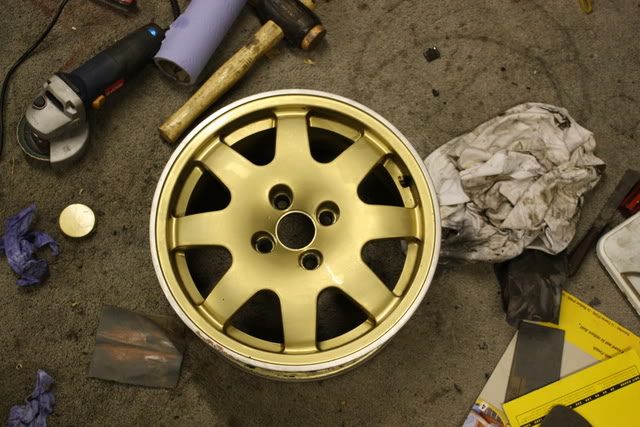

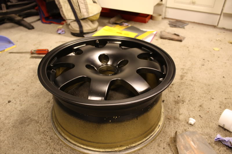

This fourth wheel was barely touched, just need a good clean and a slight dab of putty. Needs a little more rubbing down but will soon be ready for paint.

TBH i don't like black on blue, stop using left over paint, lol. try white on one and get them both next to the car and then see

I wouldnt go black I dont think dude, nor white, lol. White is a b*****d to keep clean, especially when its a track car so brake dust will be excessive.
Silver or Rover Stone grey FTW......
Shush you. ;)

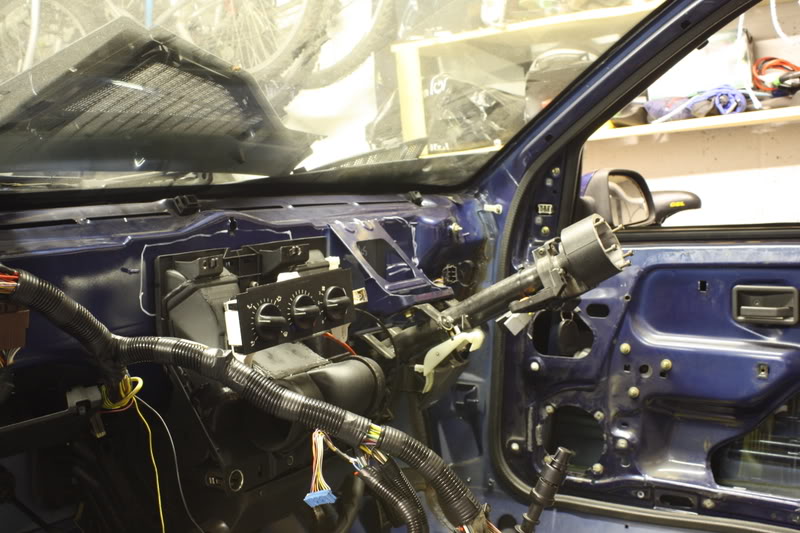

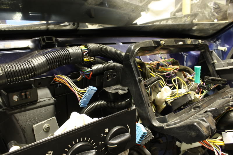

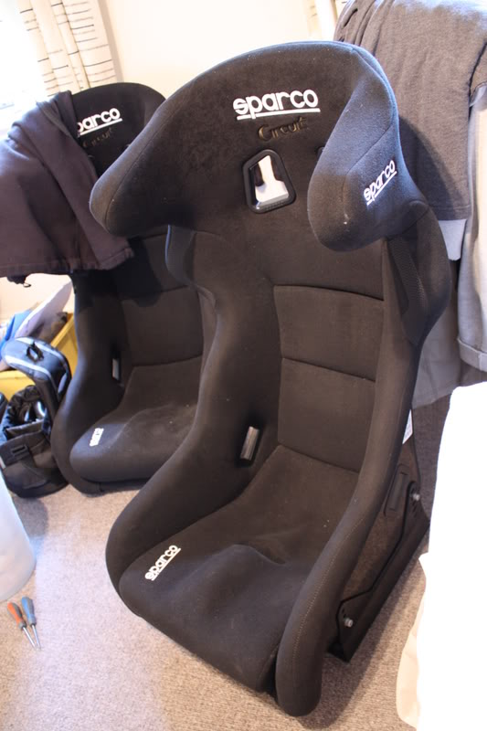

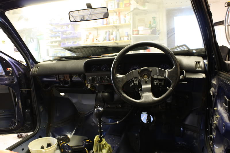

Bit more of a healthy sized update today. Decided I would try and get my dash finished and then aim to start removing it in preparation for my roll cage turning up, whenever that'll be.
Got my seat out the way and moved indoors first of all, getting in the way and it was bound to end up damaged.

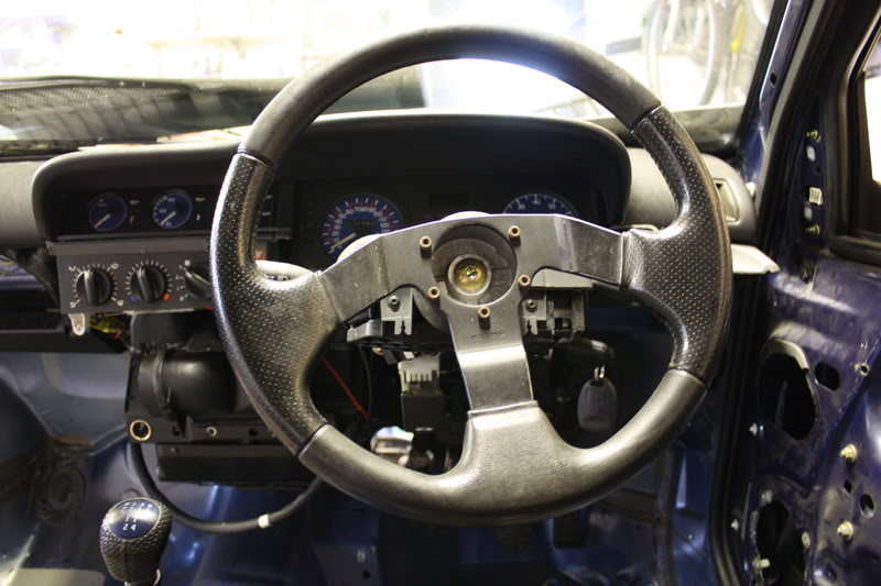

No pictures of how I did it as I was on a roll, but I finally got my heater controls mounted and secure. Plastic bracket made out of an old bit of dash bolted to the heater which sits under the controls, 2 screws into the bottom of the controls to attach and then a final screw through from the top to secure and tie it all in together with the rest of the dash, was solid.
I then started looking into replacing my handbrake mechanism as the ratchet broke when I got a bit carried away weight saving and took the rubber grip off. I'd tried to put it back together previously without success, so I was pretty pleased as it saved me a load of work. Function comes first!
Finished dash, bar a bit more wire tidying and wrapping. Layout is final anyway.

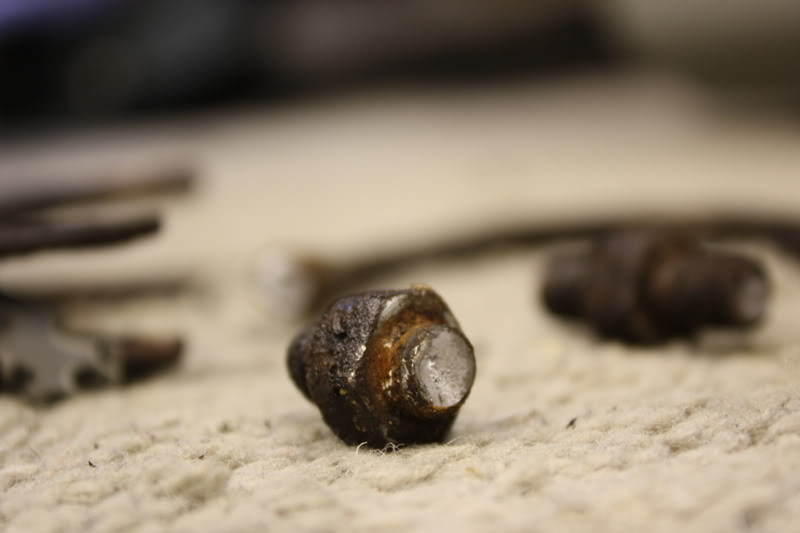

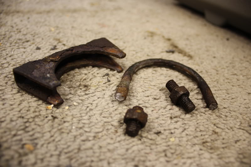

Went to undo this U-clamp to separate the front and rear sections of the exhaust and it snapped rather than unbolting, new one needed!

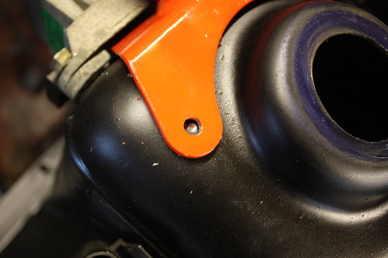

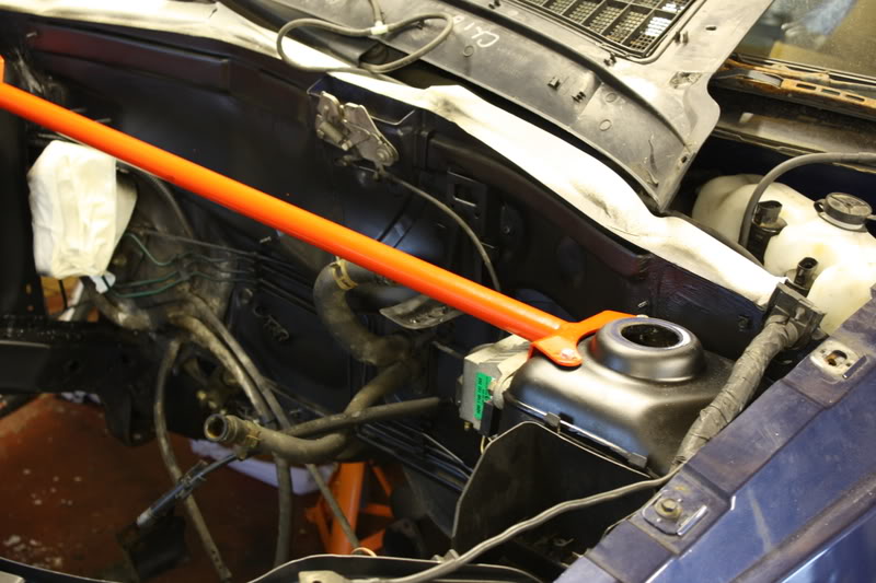

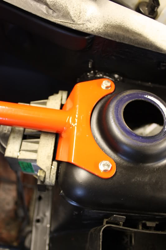

Marked and drilled the holes to mount my strut brace. The brace comes with some crappy self tappers, so they went in the bin and will be replaced with bolts/washers/nylocs. Hole is only M6 at the moment but I may open up to M8 to make it a bit more secure.

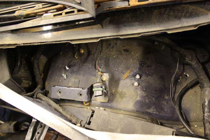

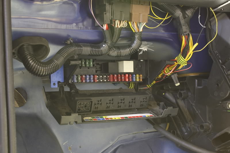

Pictures of the reduced fuse box and how it's mounted. Nicely tucked up out the way but still easily accessible. Bolted through into the scuttle.

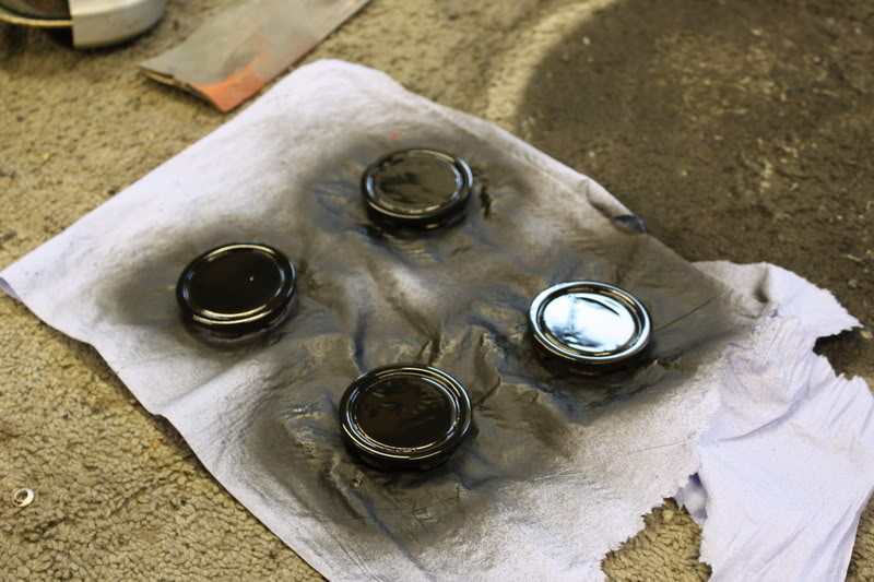

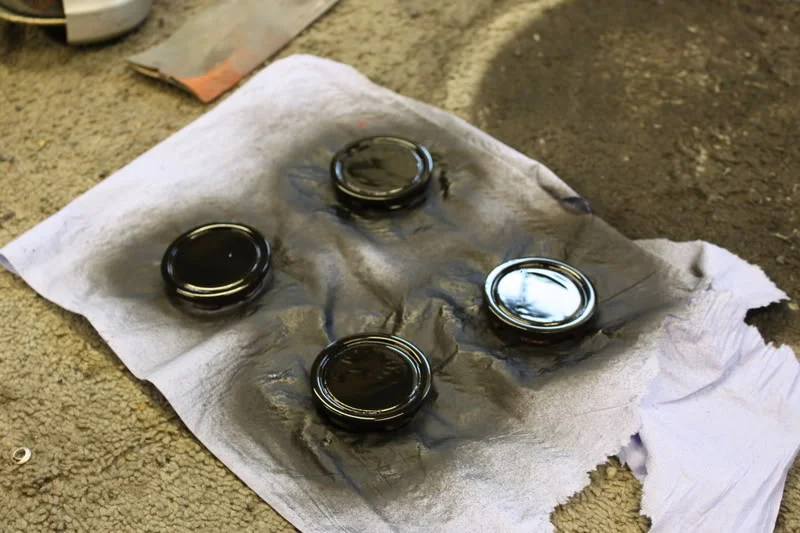

Realised the centre caps from my Chrono's fit the Williams wheels, so gave them a quick blast of satin black. Looks gloss in the pic as it was still wet.

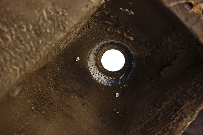

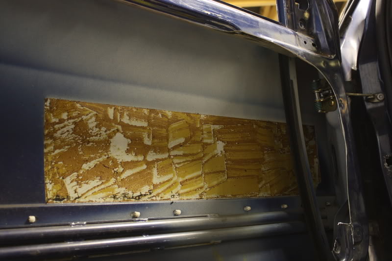

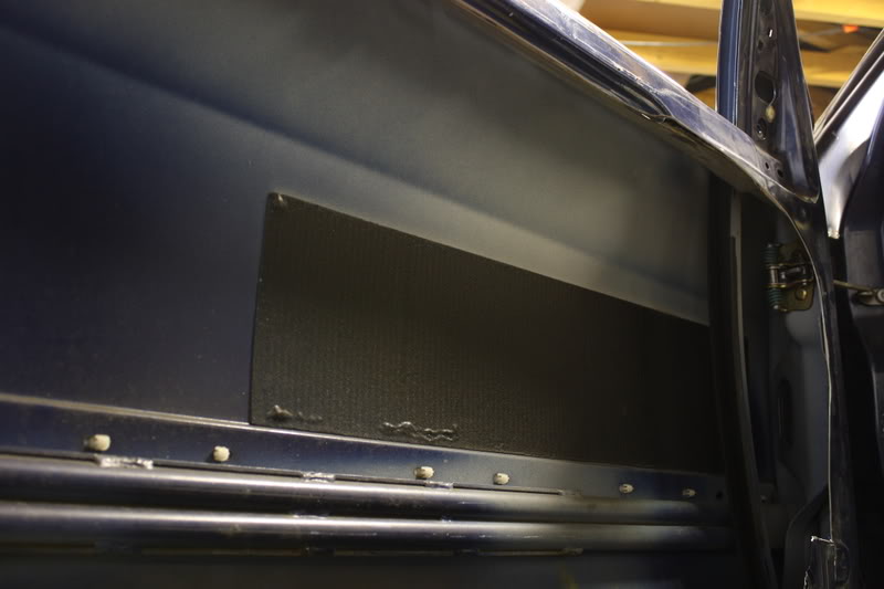

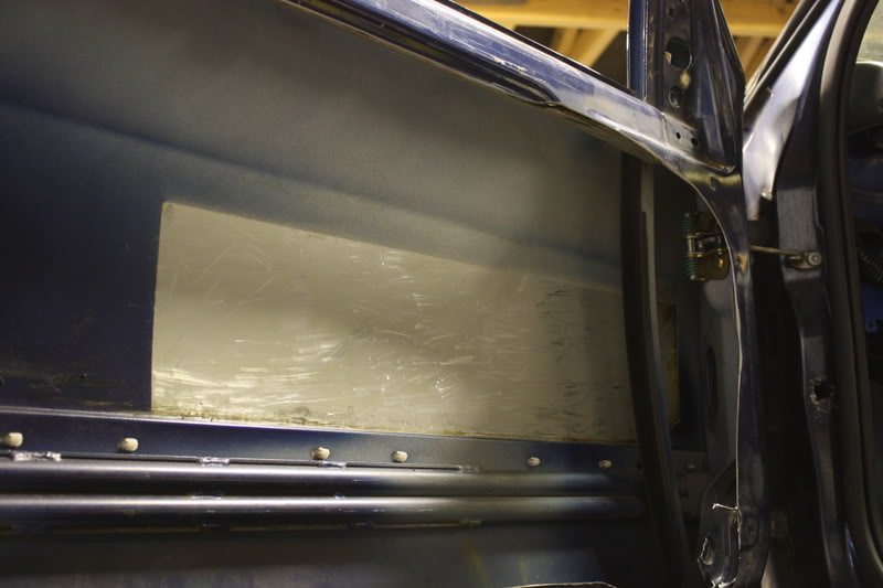

Removed yet more tar, this time from the inside of the cut-out door. Easy weight saving. The other door is still complete at the moment but will be getting the same treatment once the car is on wheels and turned around.

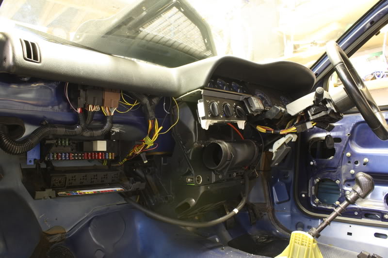

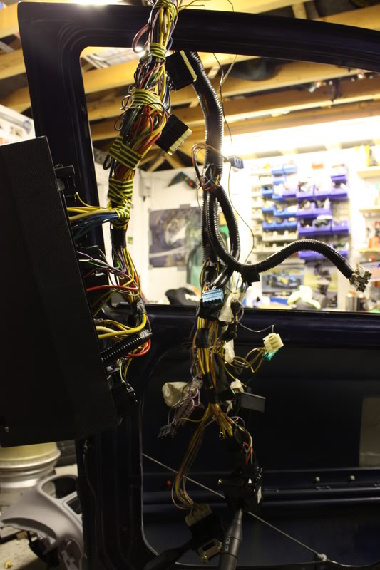

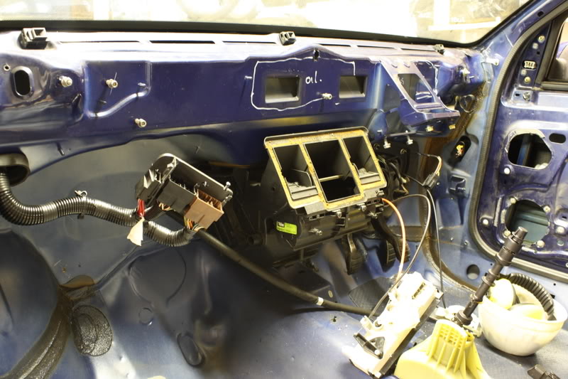

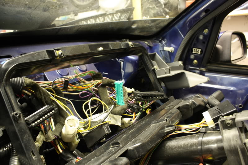

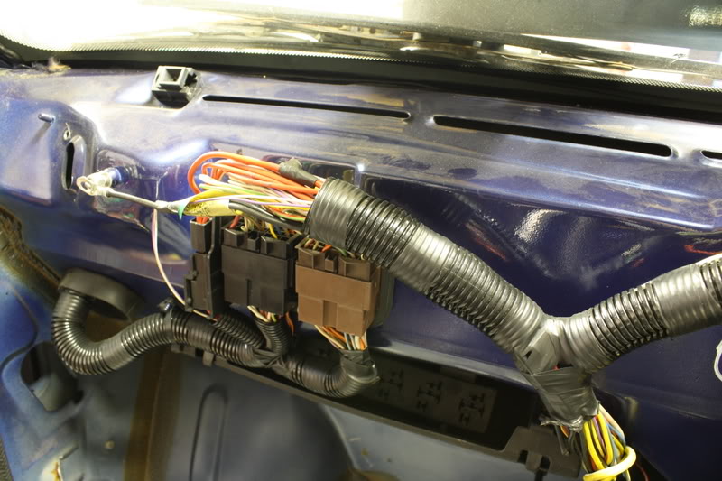

Now that I was happy with everything in the dash I started removing it. The interior will be painted once the cage is in so I want it as bare as possible. Ive taken these more for my own reference when it all goes back in, but i'll put a few up anyway.
What remains of my interior loom, not a great deal of it!
And finally...
that looks proper tidy mate mine was a right mess i just didnt bother and put the dash in thought it looked alot better, imo unless you can get rid of everything inc heater matrix all wires it dont look right but youve got that proper tidy.
Yeah I wanted to lose the lower dash but keep it reasonably neat still. The heater was staying all along for demisting and slight comfort reasons so I had to work around that. Has turned out quite well and will hopefully be a little neater again when it all goes back in for good. Will get a passenger footrest eventually too.
