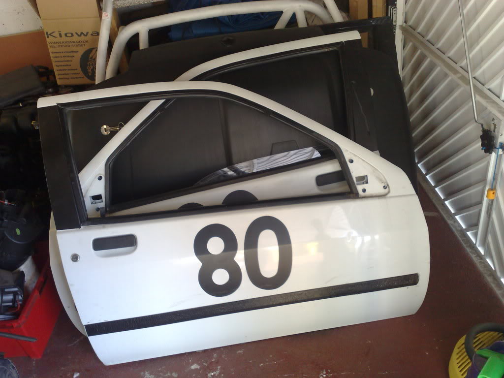

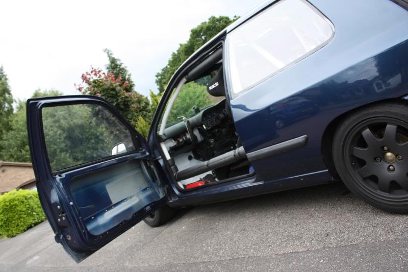

Yesterday I did 350 miles in the daily Valver and made a few collections. First was a pair of doors. They happen to be off a Cup Racer for added coolness. The reasoning behind having another pair is that my current doors look like this:
Now in the summer I'm more than likely going to the Nurburgring for 10 days or so, and fixed windows in the old doors would be a royal pain in the arse. So the Cup doors have the inner skin intact, glass windows and manual winders which should provide a bit more comfort for the road trips. Will use the old ones as trackday doors with the plastic windows still. Obviously the new ones will need painting to suit.

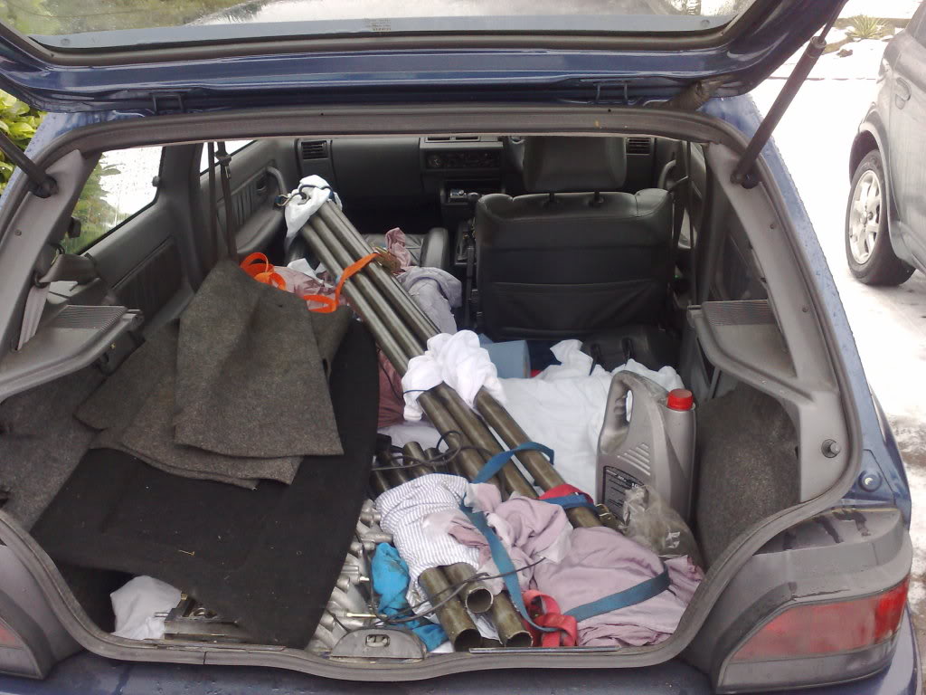

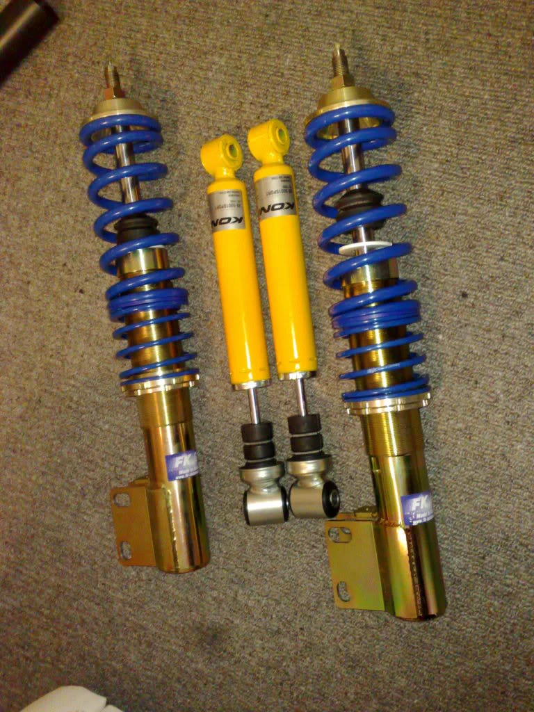

Thats 18m of 45mm CDS rollcage tubing and my FK Konigsport coilovers that f0xy kindly got machined for me to accept 172 hub bolts.

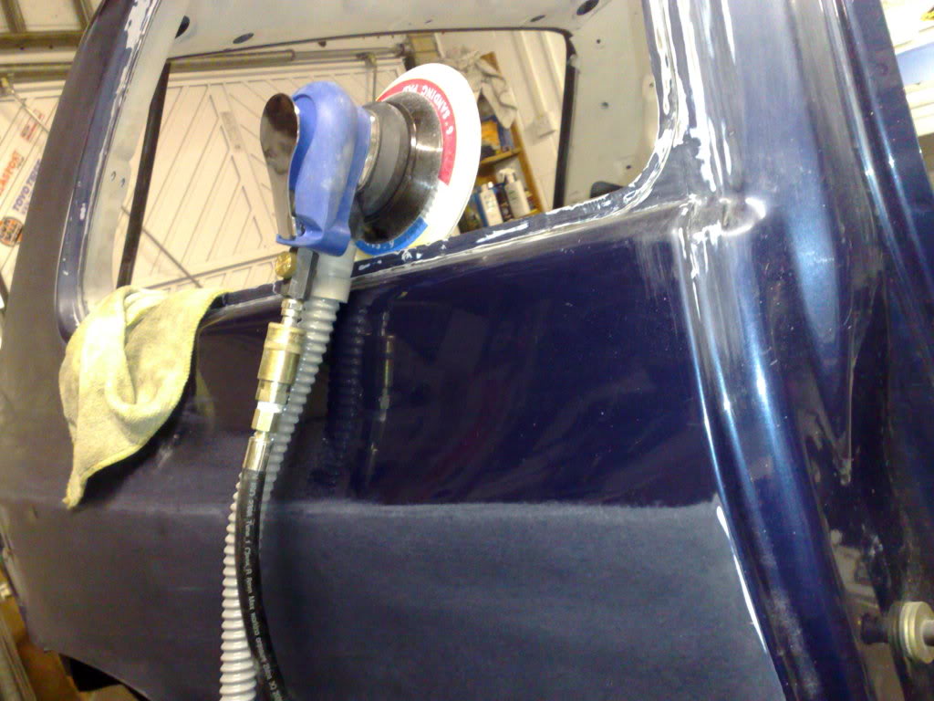

My new air sander also turned up in the post the other day, so I had to have a little play with that....
No going back now :eek:

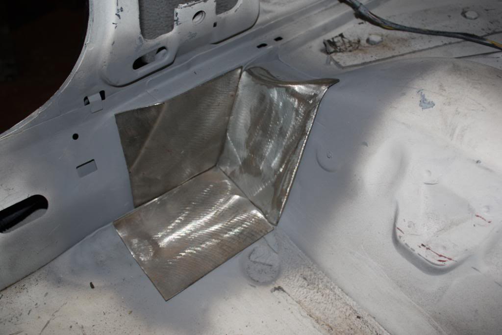

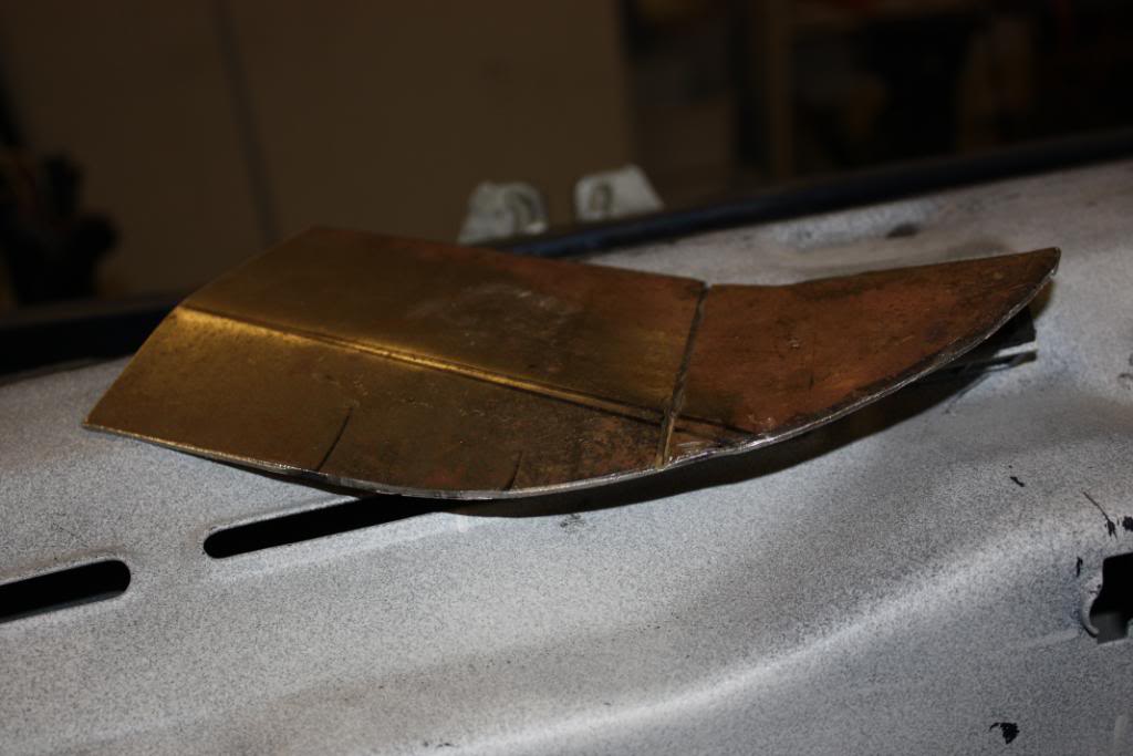

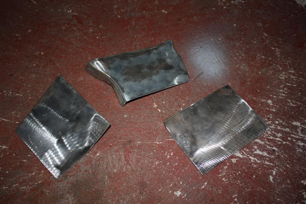

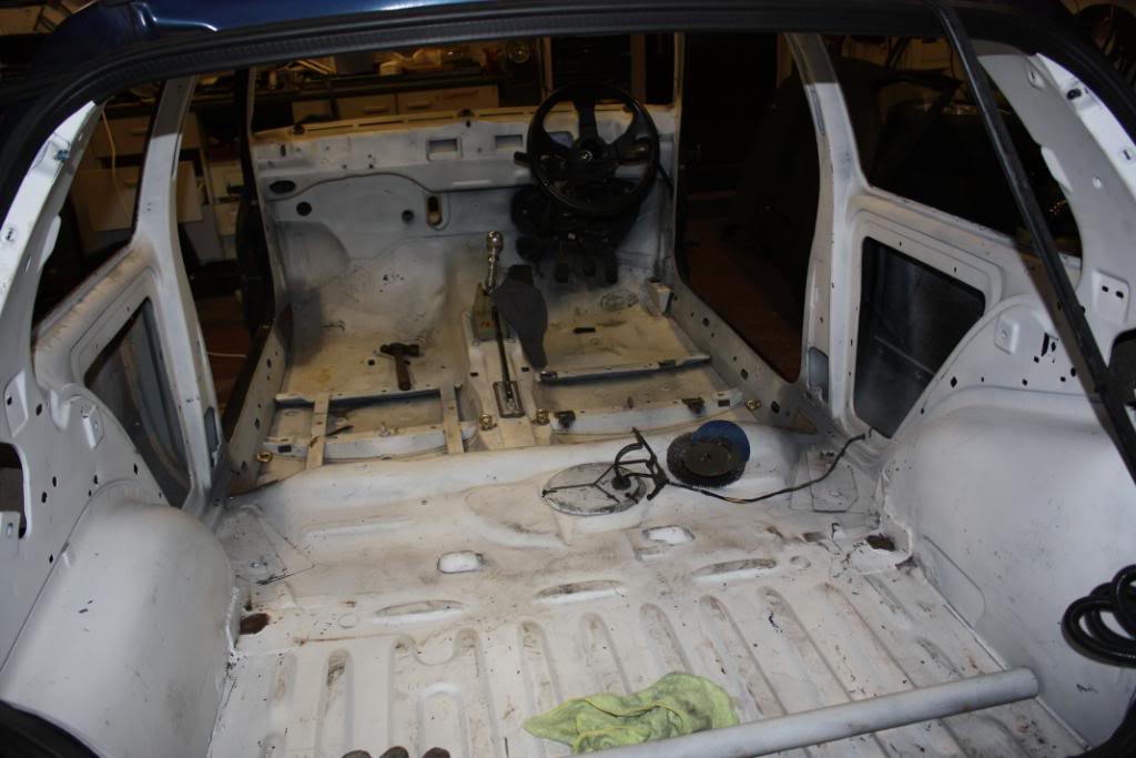

I've spent what seems like forever cutting out and starting to replace the footplates for my cage. It's massively tedious work and I'm not the best equipped for metalwork either, so upto now it's been a case of 'cutting something, trying it, bashing with a hammer over my vice, cut a little more here, hit it again and that'll do'.

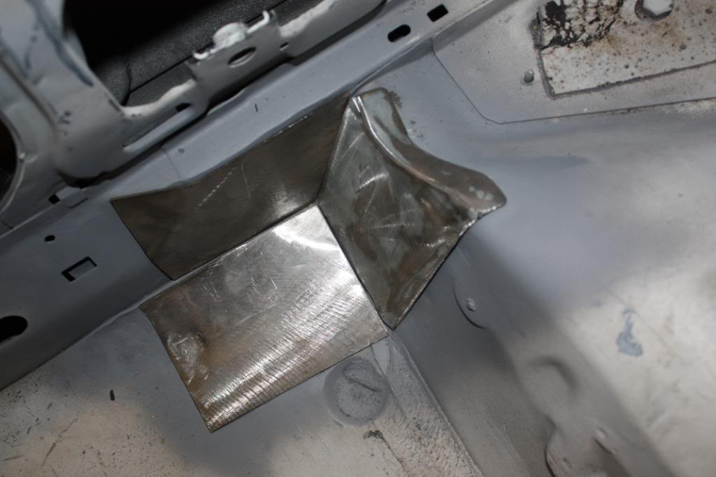

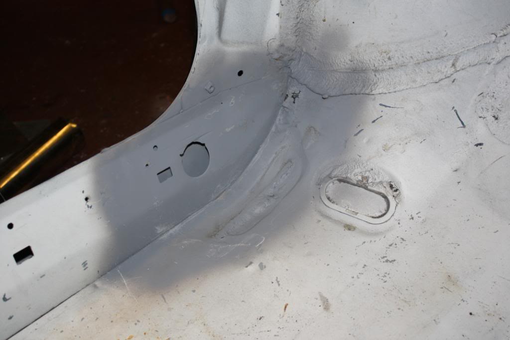

I'm making outer skins to patch the chassis and to form a more solid base for me to mount the new box sections on, whereas before the lame OMP 'footplates' were welded straight onto the chassis. This is why I now have various holes to try and fill in/cover up.
This is the middle off the car, bottom of where the main hoop will sit. As you can see, it's a bit of a state having cut the old box's out
Numerous hours later I had these made up. Some of the bends I had to make with my grinder and hammer were a little difficult

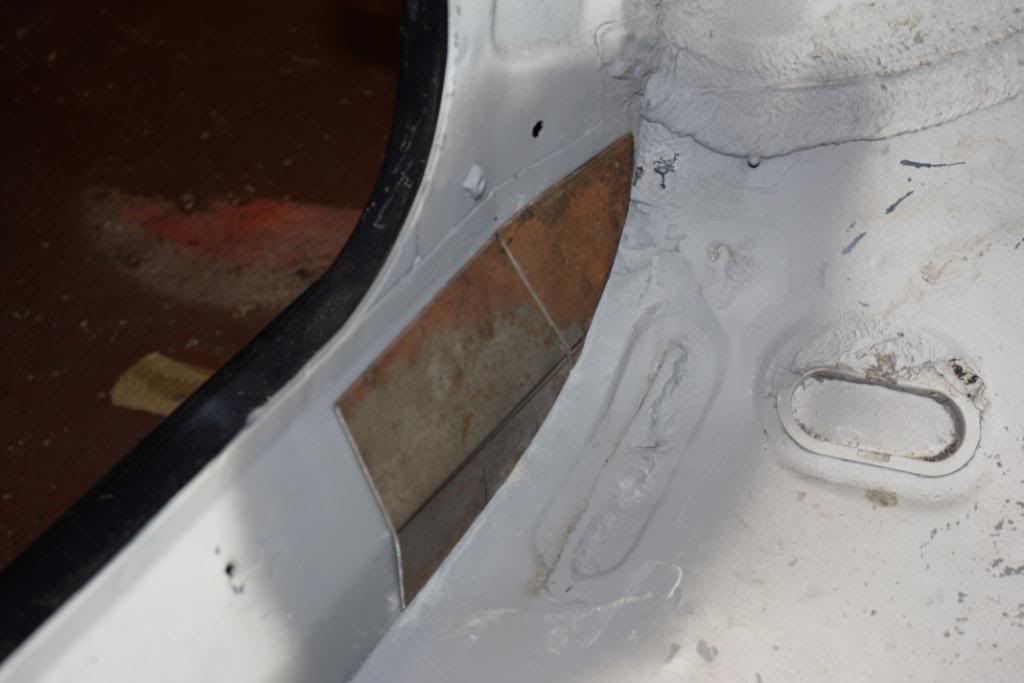

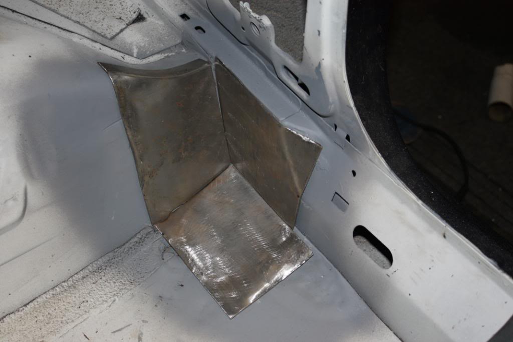

They sit (quite nicely :D) in here:
Likewise for the N/S:

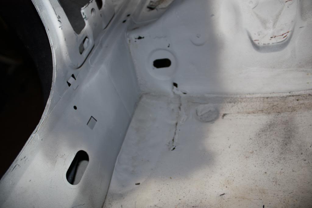

I've only got as far as cutting one of the old front box's out upto now, so made a start on plating that corner. Old removed:
These are the sorts of bends I'm having to make. It's easy enough putting a simple crease in to follow the sill, but when it also needs to go the other way at the same time it's a bit awkward:
That goes in here:

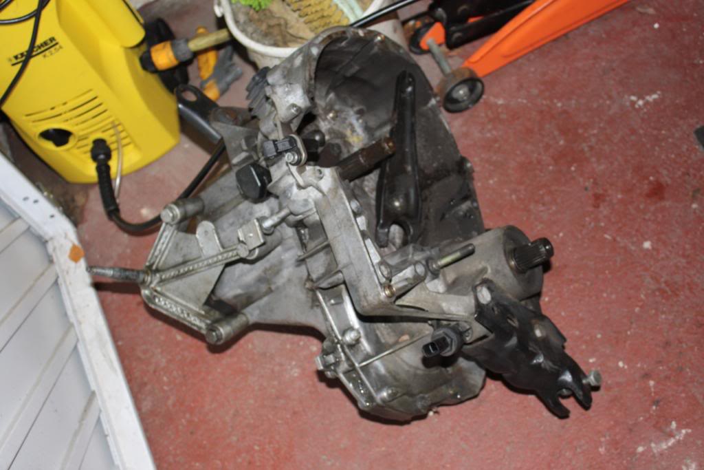

New Ph1 172 JC5 089 gearbox to replace my crunching Valver JB3 048.

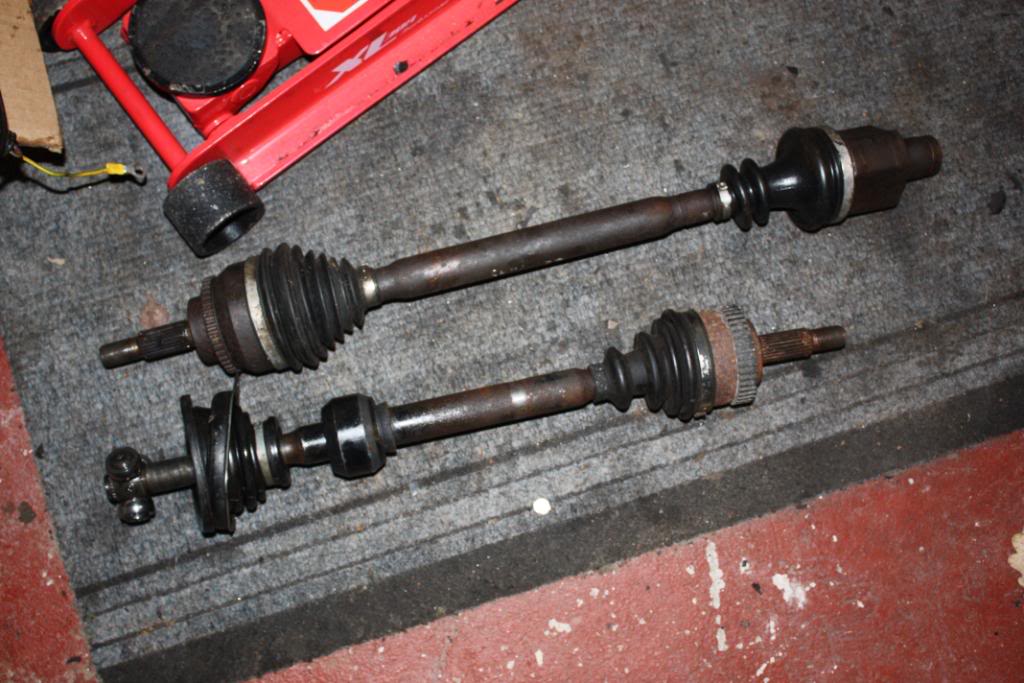

Another pair of driveshafts. I've had a knocking sound on heavy right hand cornering for most of the past year, which ive narrowed down to being the shafts so hopefully these will cure it. I'll also looking into refurbing the old ones as spares.

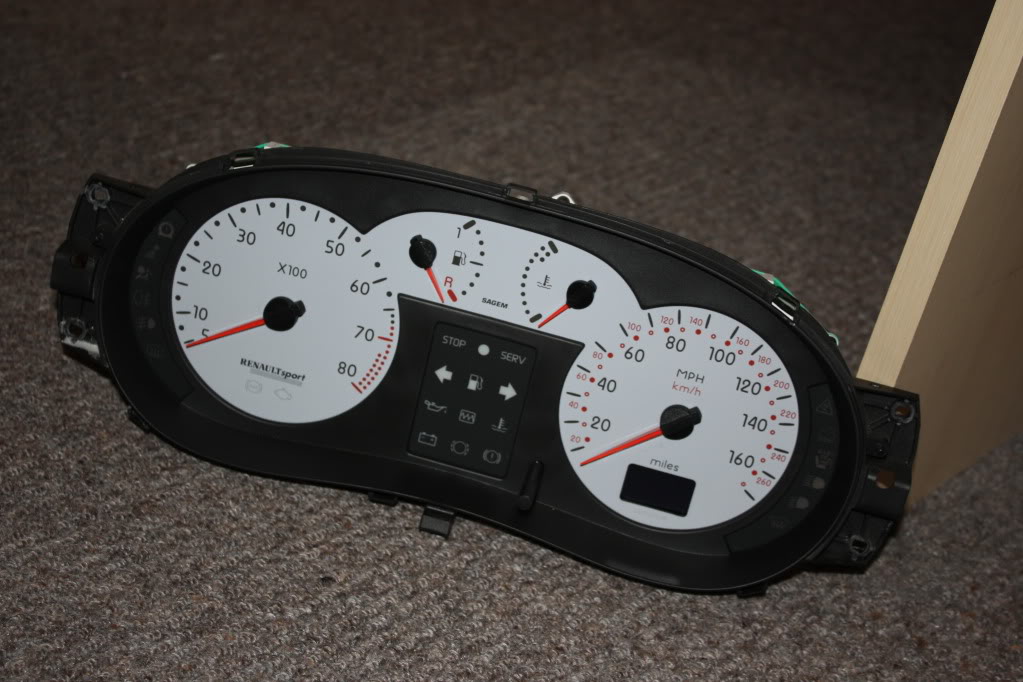

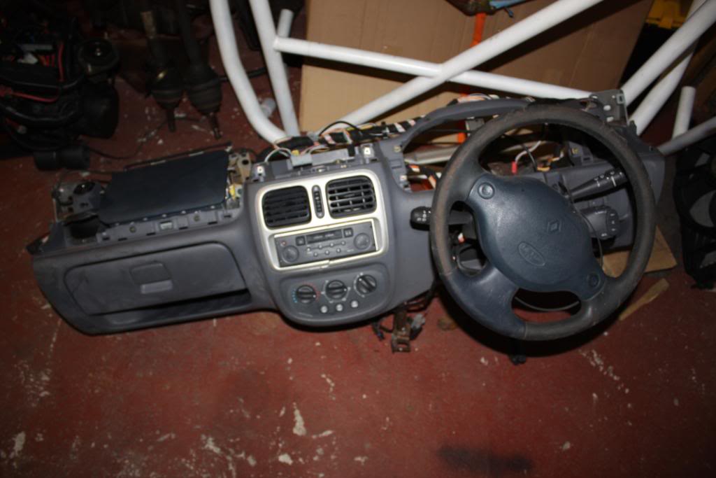

Complete Ph1 172 dashboard with wheel/column/airbags etc etc. I only need the connections for the speedo clocks from this so the rest will be sold/scrapped. I forgot to photo the clocks:

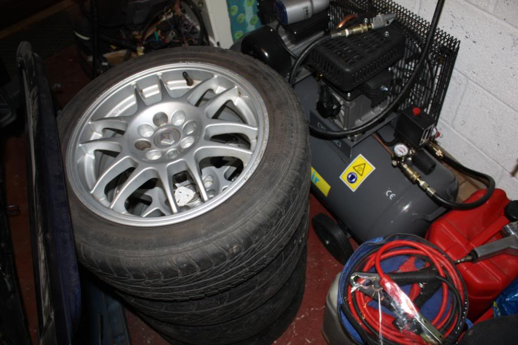

Ph1 172 OZ F1 wheels with 4 odd ditchfinders on. Unsure whether I'll keep these yet, or put them on the daily Valver when I sell that in a couple of months

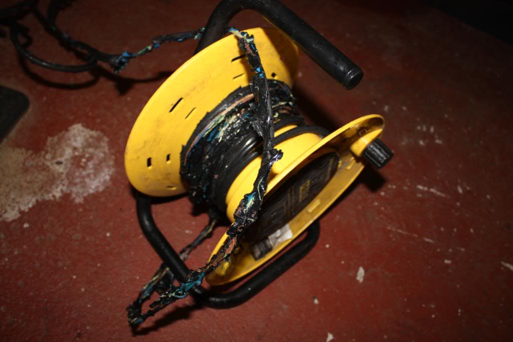

I also had a slight mishap with my extension reel. It didnt like two fan heaters and a grinder all being connected to it. 2005-2010, it's done me well :(

Yep, 172 clocks when it's back together. Also does away with the speedo cable which will help clearance for a bulkhead bar in my cage:

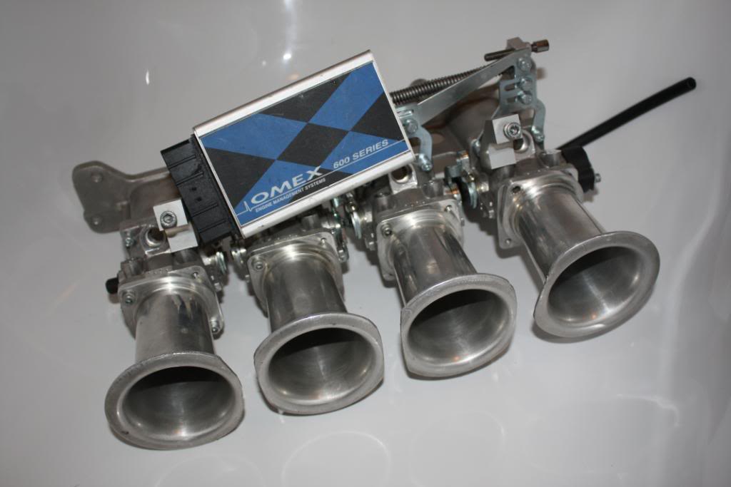

I've also gained these small components :headno:.
Keep an eye out for sale shortly, I don't think I'll be keeping them, change of plan.
