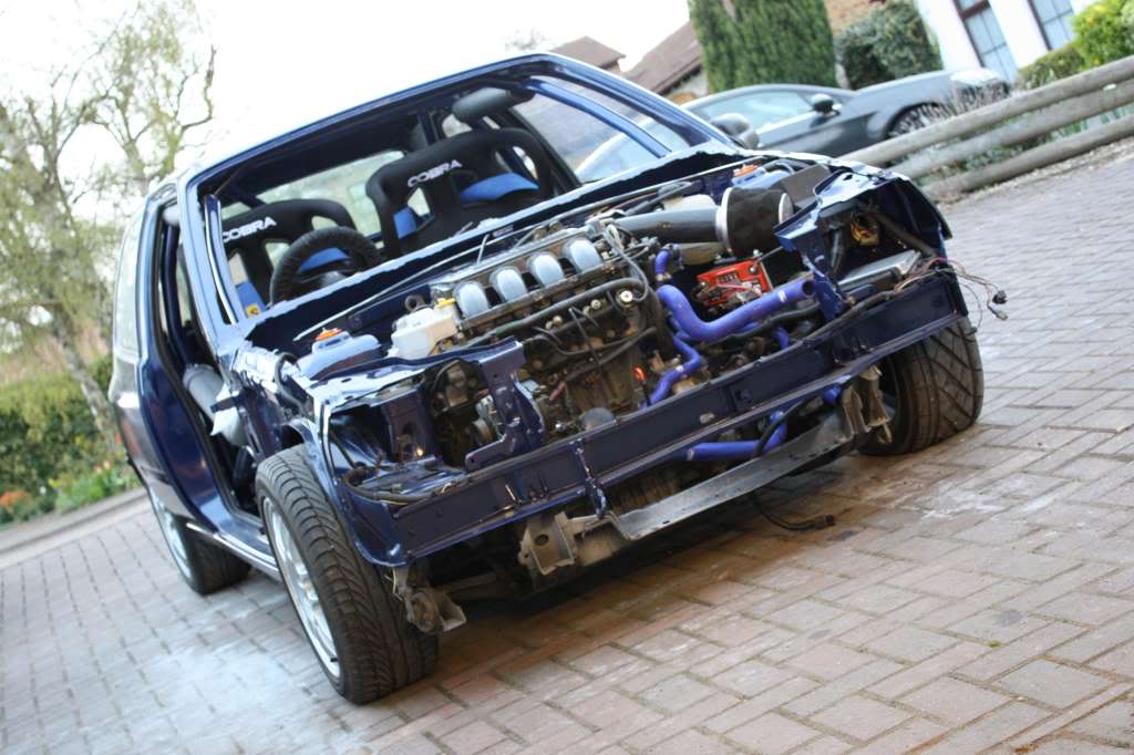

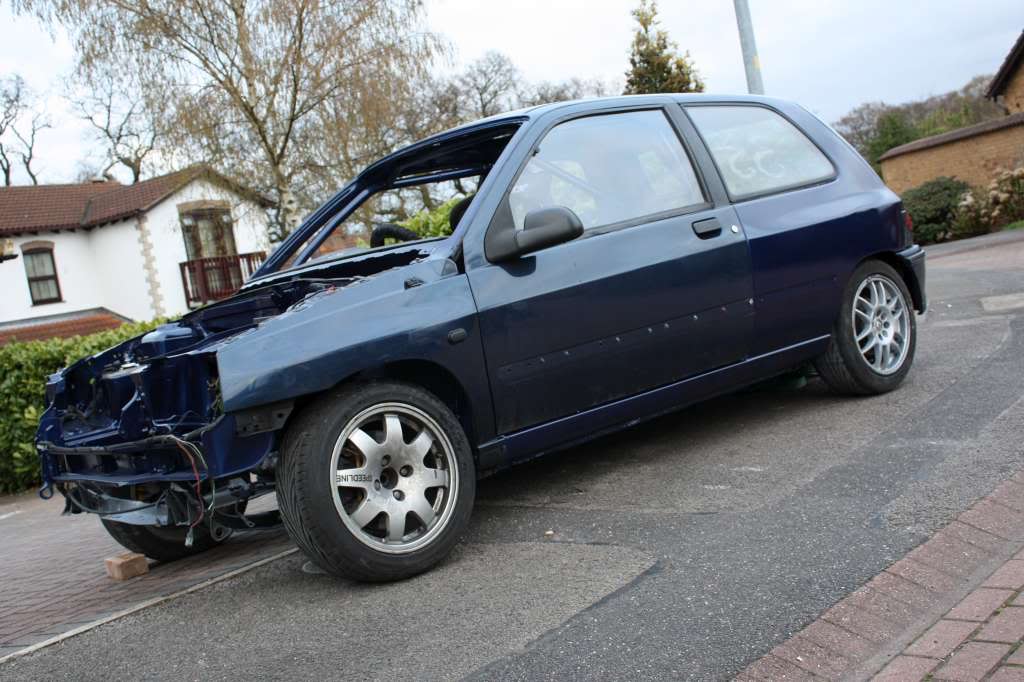

It's coming along quite nicely now. Panels seen on the car are all 449, so you can see the colour different between new and old. Fitted a replacement rear screen into the boot as the old one got smashed.
A few upto date snaps, click the thumbnails to enlarge else they'll take forever to load

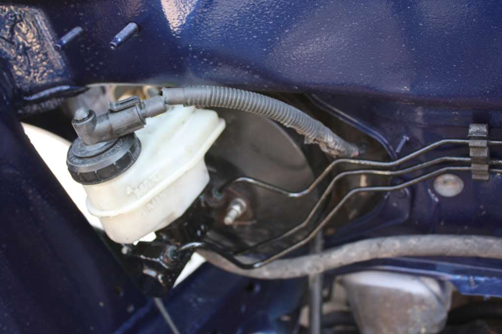

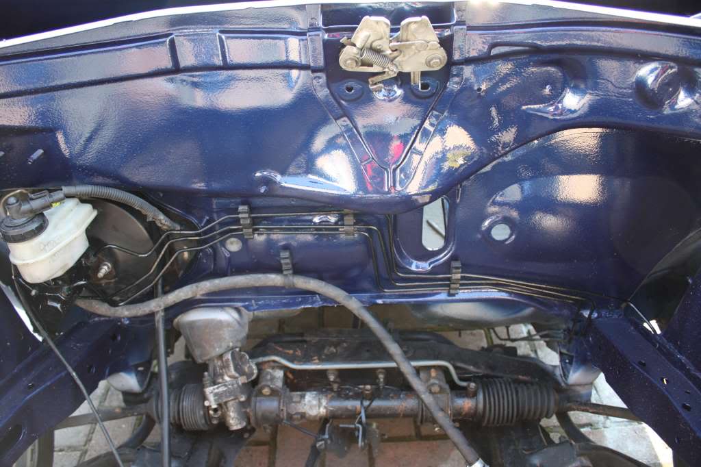

Brake master cylinder and reservoir fitted back on and lines painted black to neaten them up a little

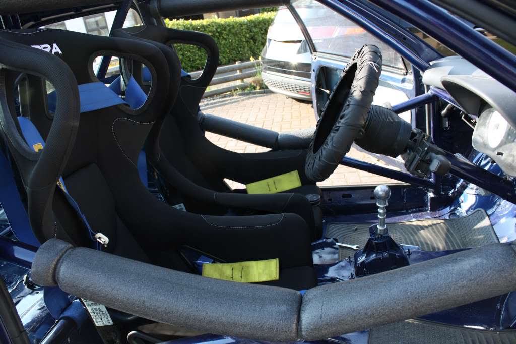

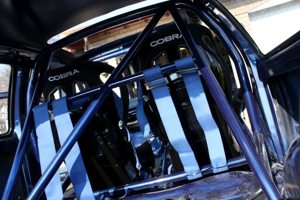

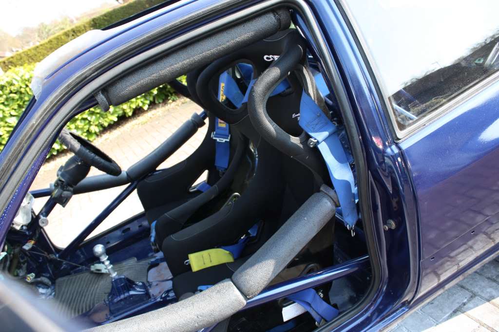

GT width (+30mm) passenger seat in. For anyone with a big cage in a little car, i'd not recommend the extra width seats, it barely fits :banghead:

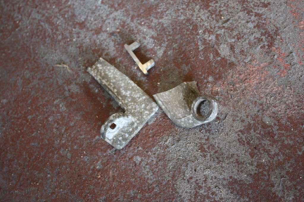

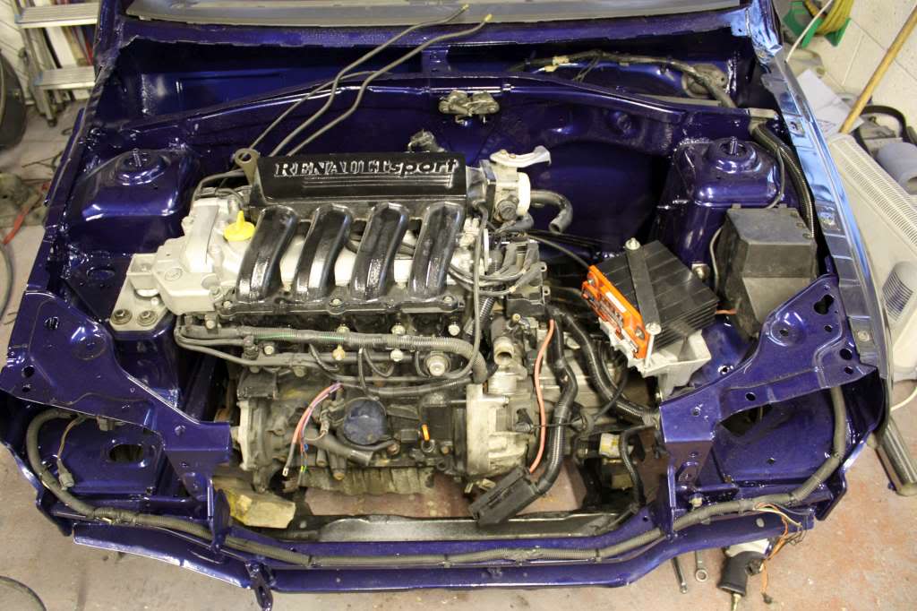

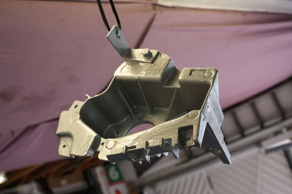

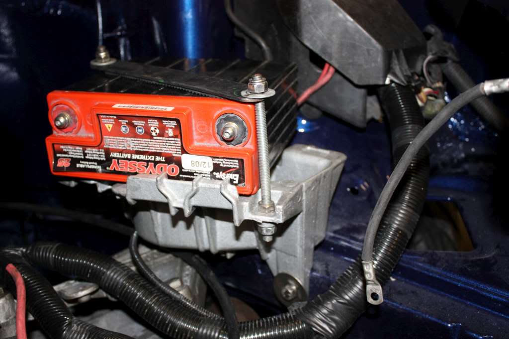

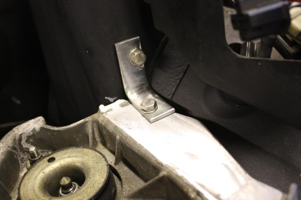

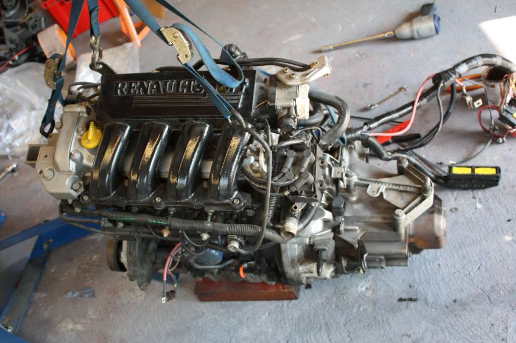

Dragged the engine out its hiding place for the past 5 months and made a start on that. I needed to make a Mk2 battery tray fit as I'm going to be running a 172 gearbox this year. All but one of the holes lined up, so rather than start drilling new holes in the car, I modified the battery tray to suit
It was the upper 'arm' which didn't line up, so I cut it off and made a new one that bolted to an existing tapped hole in the tray. Its similar to what I did when the same part snapped off my Mk1 tray if anyone remembers. Then a quick lick of hammerite

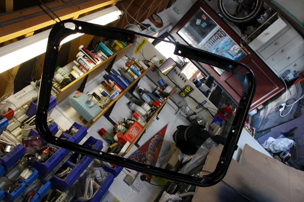

Also painted whats left of my inner sunroof surround as it was white from before. Just a quick rattle can effort

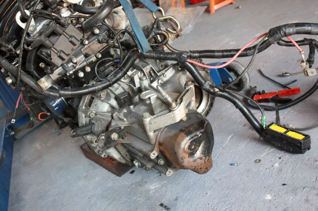

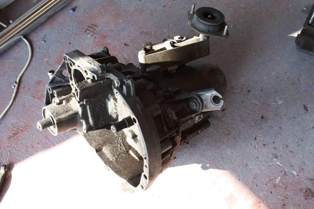

Swapped the gearbox over
Will paint the end cap at some point
Old box, bit crunchy but will do as a spare

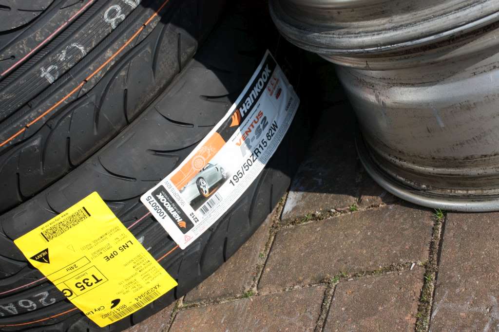

Pair of Hankook RS2's came in the post the other day

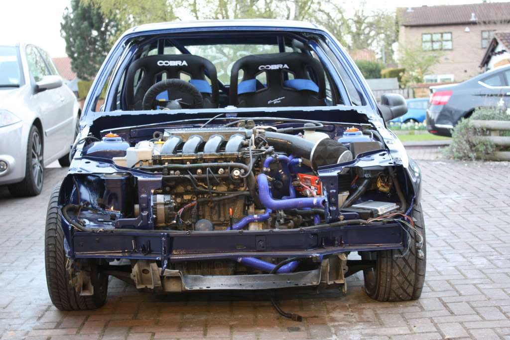

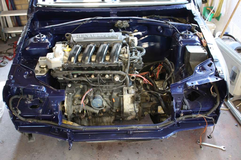

Engine and box lifted in

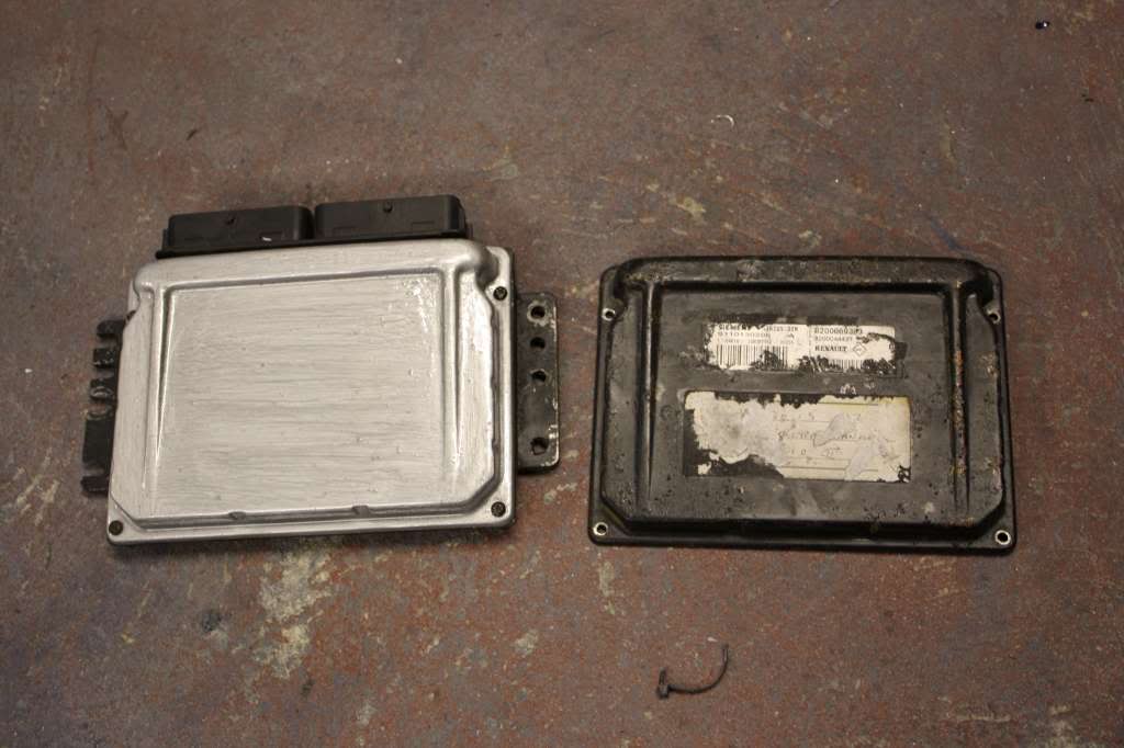

Freshed up the ECU cover. New vs old
Battery tray bolted in and battery in situ

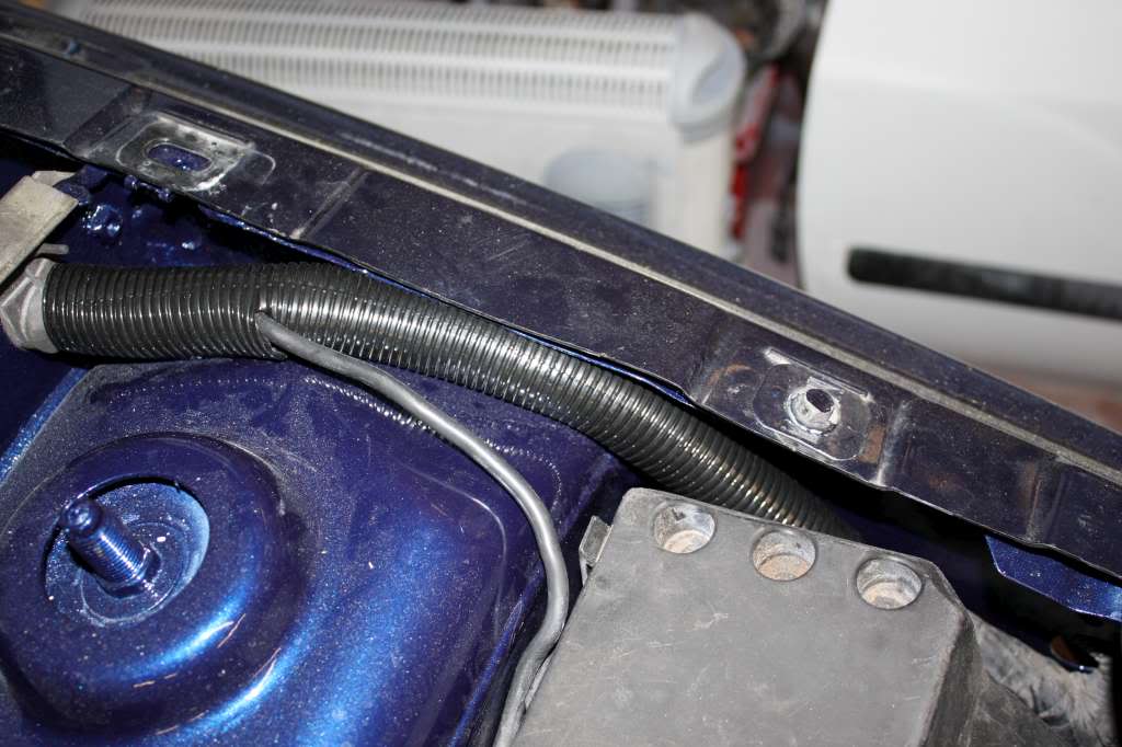

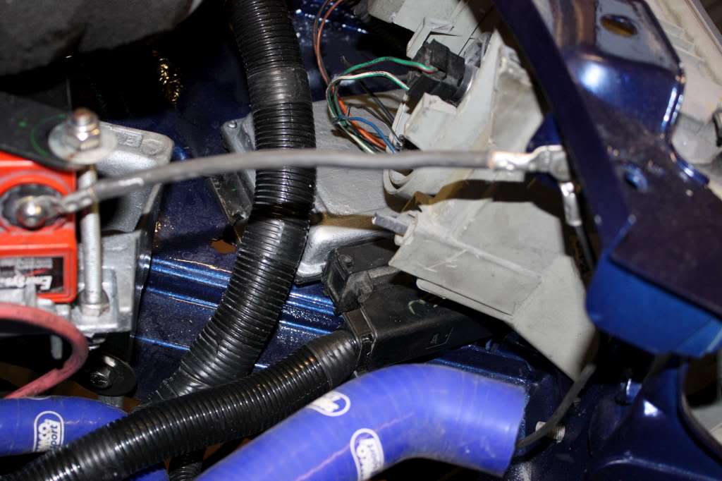

A bit of conduit around some wiring which I had loose last year

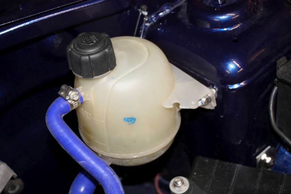

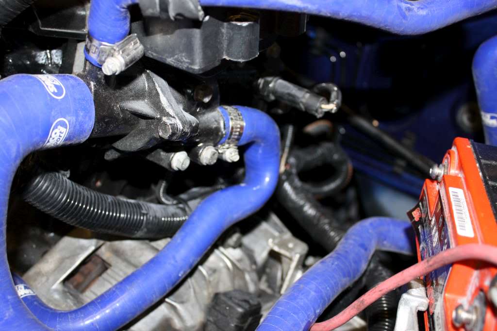

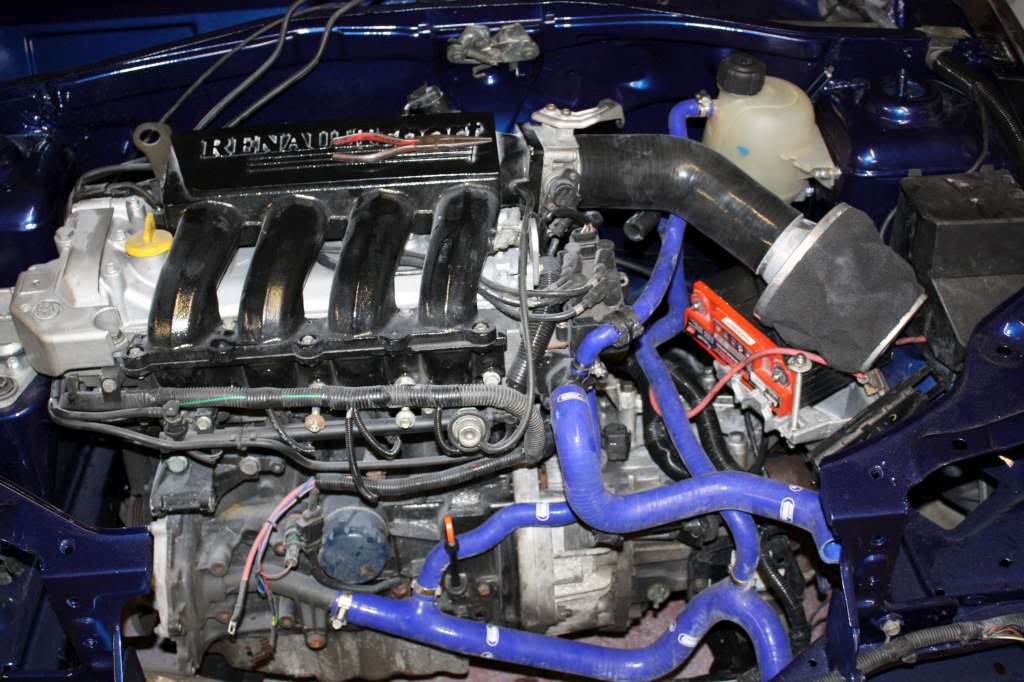

Header tank on

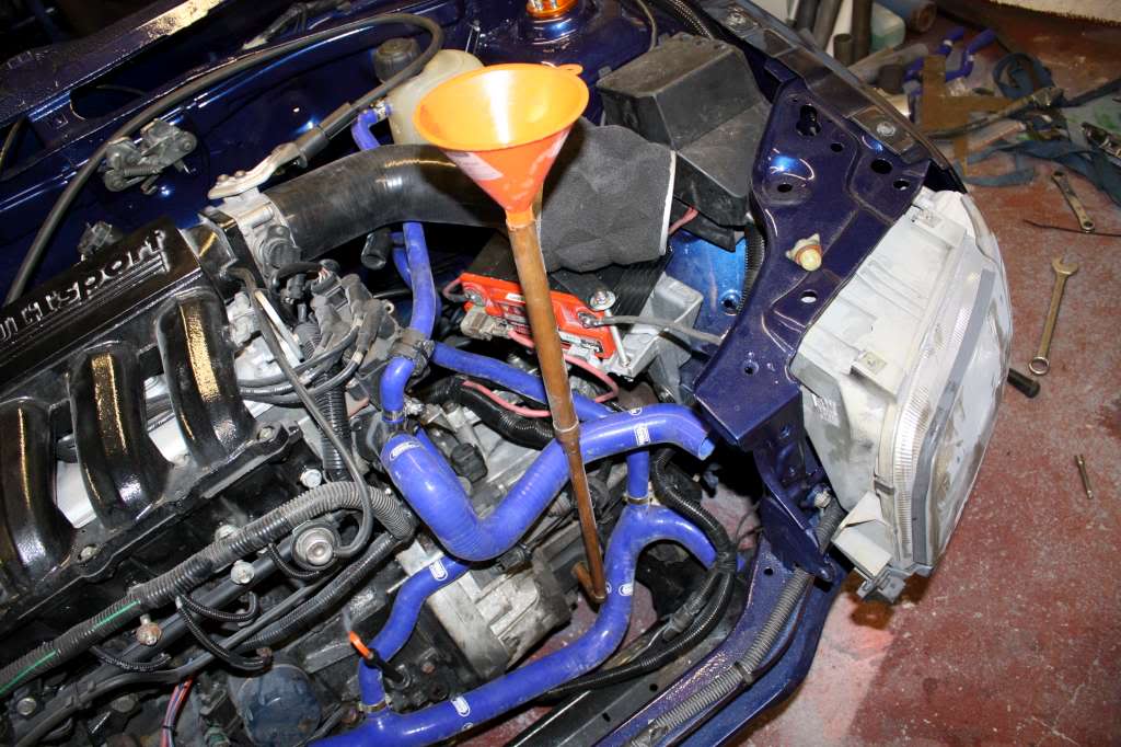

I've taken the heater out the car now. Luckily I could cut the Samco's in such a way that it kinked a minimal amount and looped back on itself
Plumbed up
Packed up for the night, to continue tomorrow

Nope will be a first for me, need to refurb the Cup wheels then put them on. Will have RS2's on the front and T1R's on the back for now.
  S4 Avant
Cool, I'm going to need tyres to get me through the MOT, let us know how you get on with them compared to the toyos and paradas

Chris excuse me for being possibly dumb here, but i was under the impression the 172 gearbox VS the williams/valver gearbox all bolt up in the same place (to the battery mount) IE the vertical pin is in the same place on all of them regardless of how the bracket fits to the box?
also the bit you've made for the battery tray looks a bit flimsy, i've seen OE ones snap with hard use
  BMW M5 & E36
I knew there would be something wrong when I saw you'd posted!
Never actually compared the two pin positions side by side, was just going from what I'd read and been told previously about fitting Mk2 boxes with Mk1 trays. Keeping everything Mk2 gives me the option of changing the mount for a better k-tec mount in the future too, which it could do with.
The bracket I made is pretty much the same as what I did previously on the Mk1 tray:
I did this after the original one snapped on me (like you mention), and I never had a problem after that. I took it off before and it was exactly the same shape as when I put it on, so I'd say it did the job well enough. (4mm steel btw)
Off topic - I emailed you about a Meg cambelt a while back, easier to ring sometime?

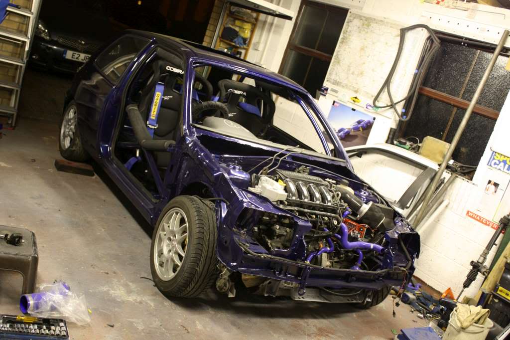

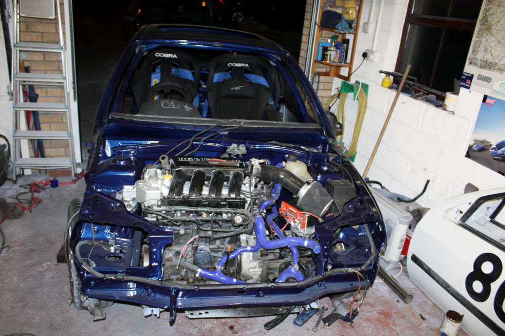

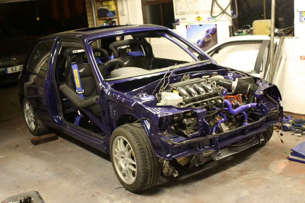

More time on it again today. Half decent progress :)
Found a spot for the ECU under the headlight. Only temporary as I want to move it inside eventually, but with the time I'm working to it'll do for now

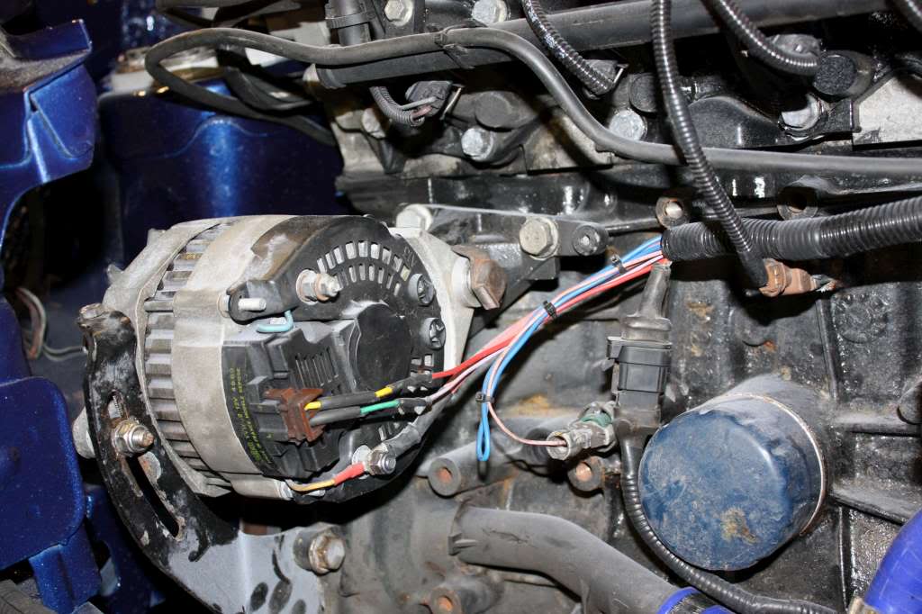

Alternator and brackets all fitted

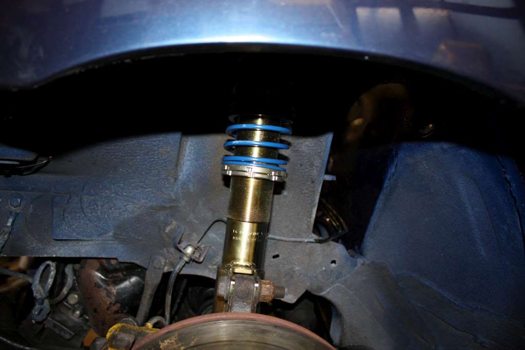

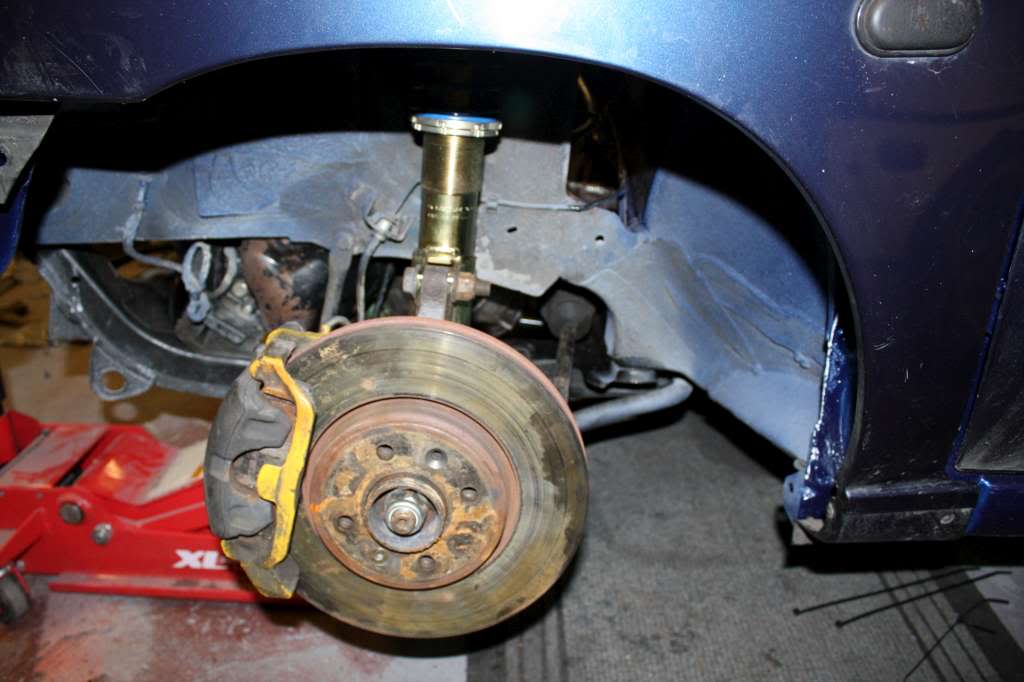

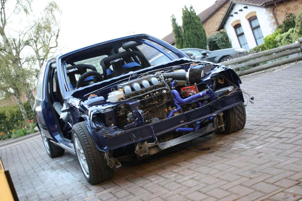

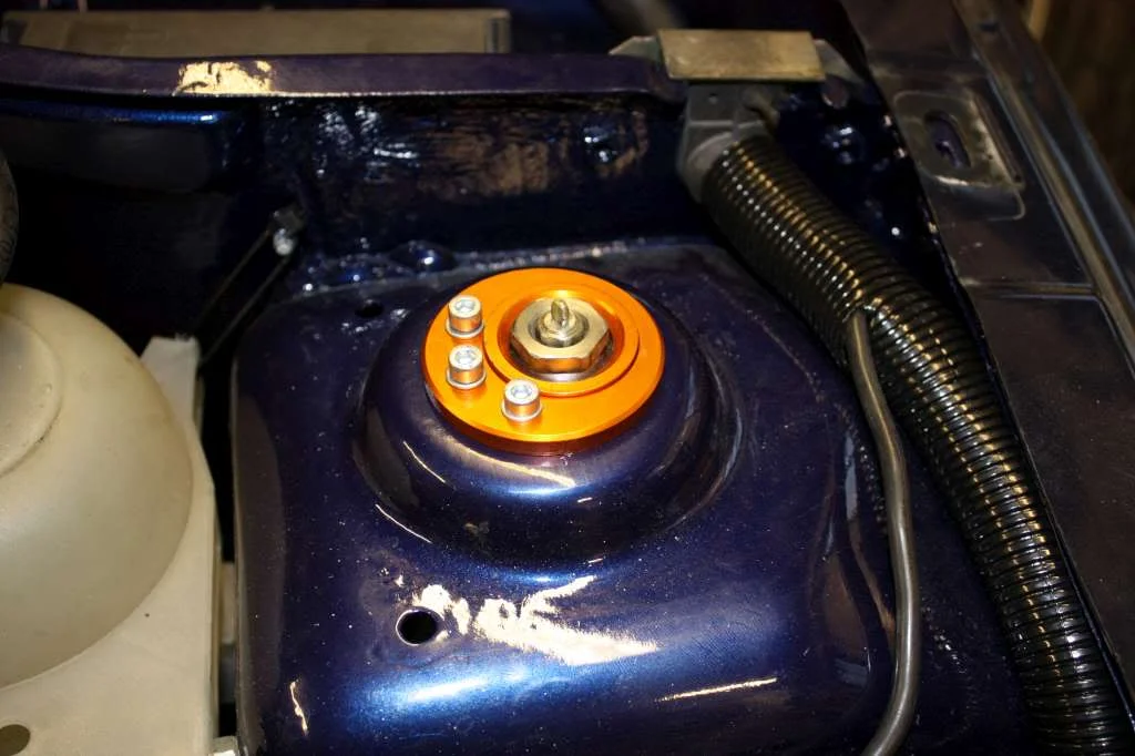

New suspension and top mounts on. It's far too low at the moment so will need to be raised
Driveshafts in, filled up with 'box oil
Then, as if by magic, it made it outside under its own power :D

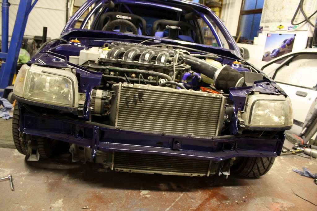

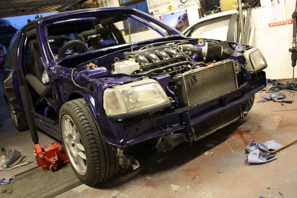

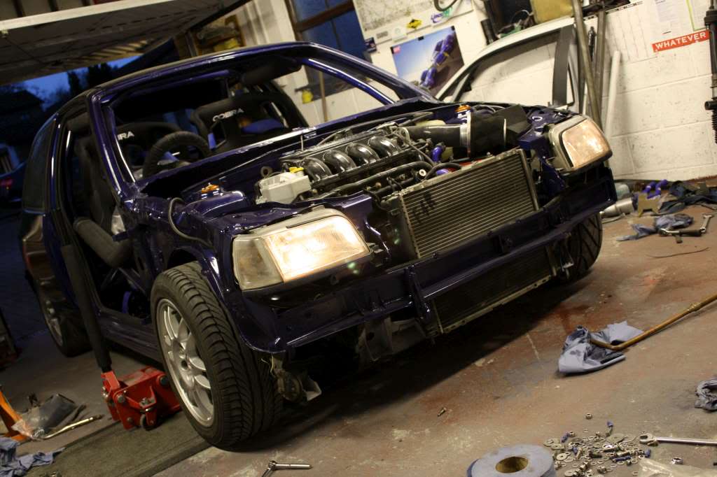

Radiator in, filled up with water, bled through and ran upto temp, then headlights on
Getting there :)

I've got a 172 box and battery tray in mine and it all bolted straight in? :S Not entirely sure what you've done.....
(I digress, This is going to sound gayer than Boy George holding Gay man weekly, but I've been thinking about this thread all farking weekend! Drooling at seeing it all put back together! What a feckin loser I really am...)
  BMW M5 & E36
Mk2 tray didn't fit without either a) drilling a new hole in the car or b) modifying the tray as I have done. I ought to have taken a pic but I've been rushing all weekend! Or maybe its off something else, I honestly can't remember where I got it from, lol.

cracking progress, youve done more in last 2 weeks than ive done since last time i shore you rstunning
hows your rad fitted
is just resting infront of the subframe, can't tell from the pic
The passenger side is sat on the subframe as the Mk1 radiator would be, the drivers side is further forwards and hanging over the front. When the top panel is bolted in and the rad tied to it, it's plenty secure enough.
thanks just couldn't tell from the pics
