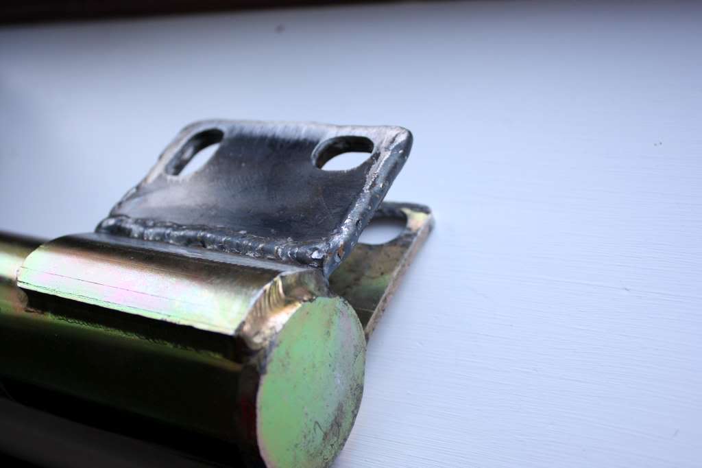

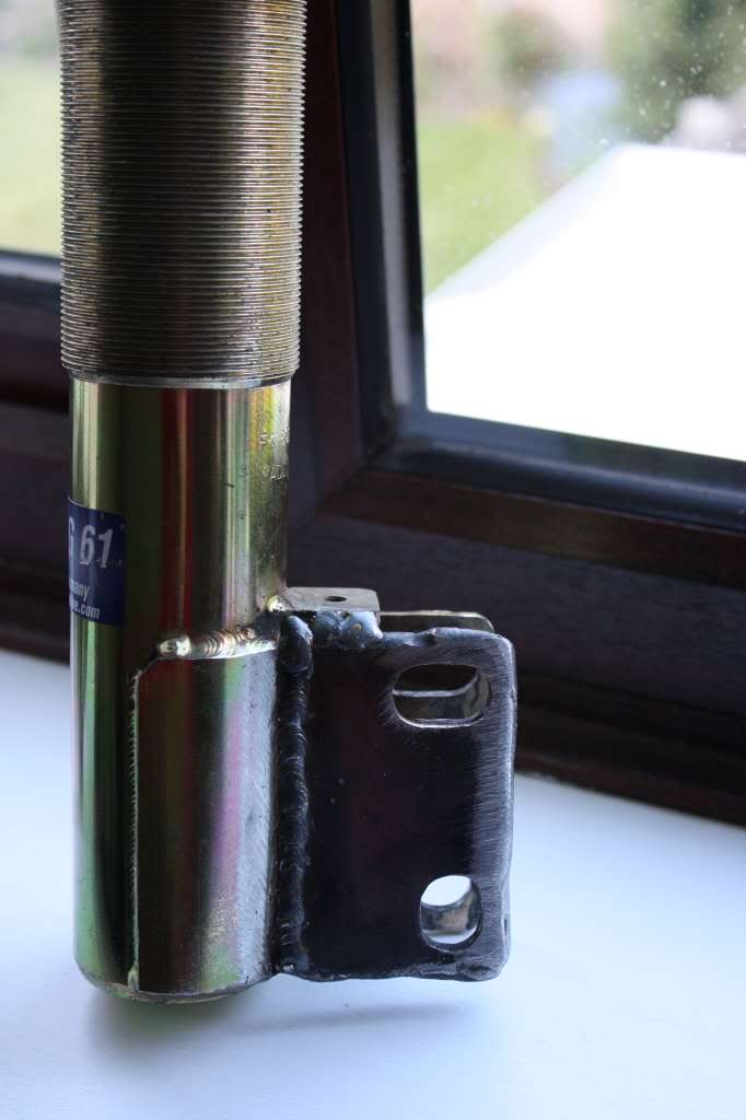

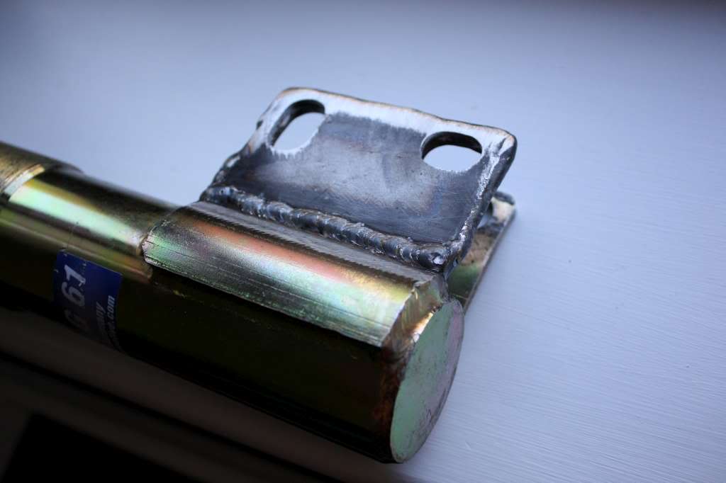

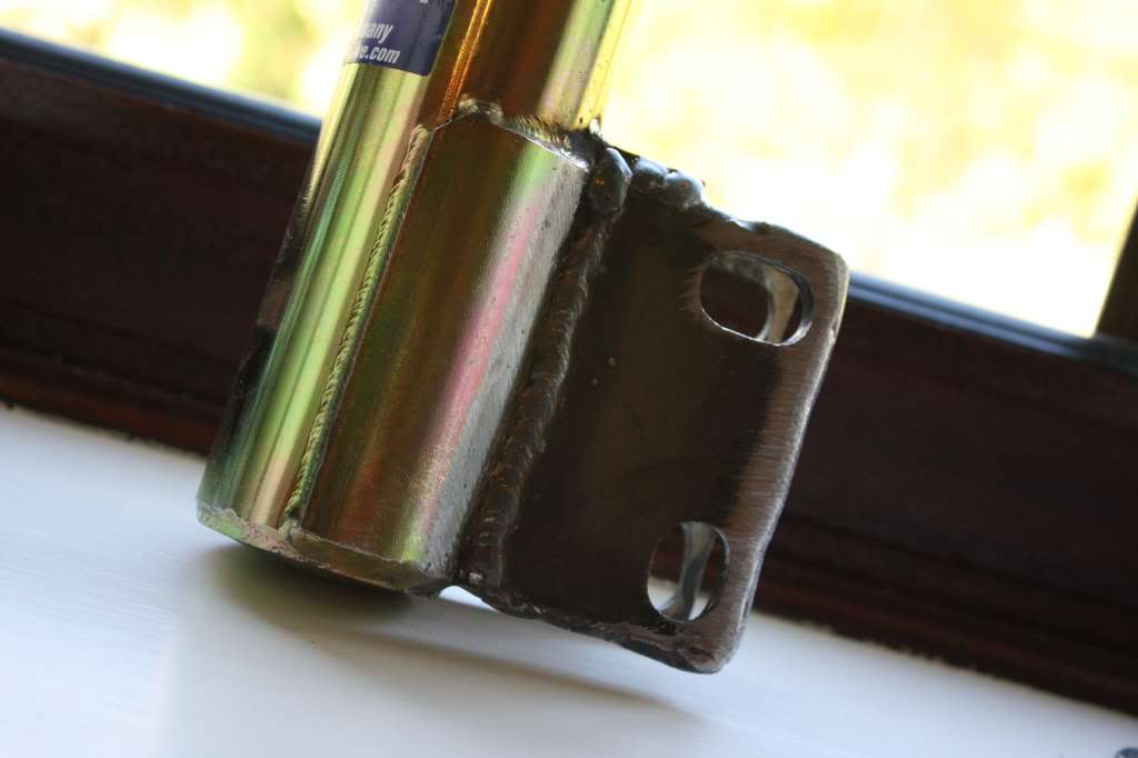

A slight issue which I found at Oulton the other week:

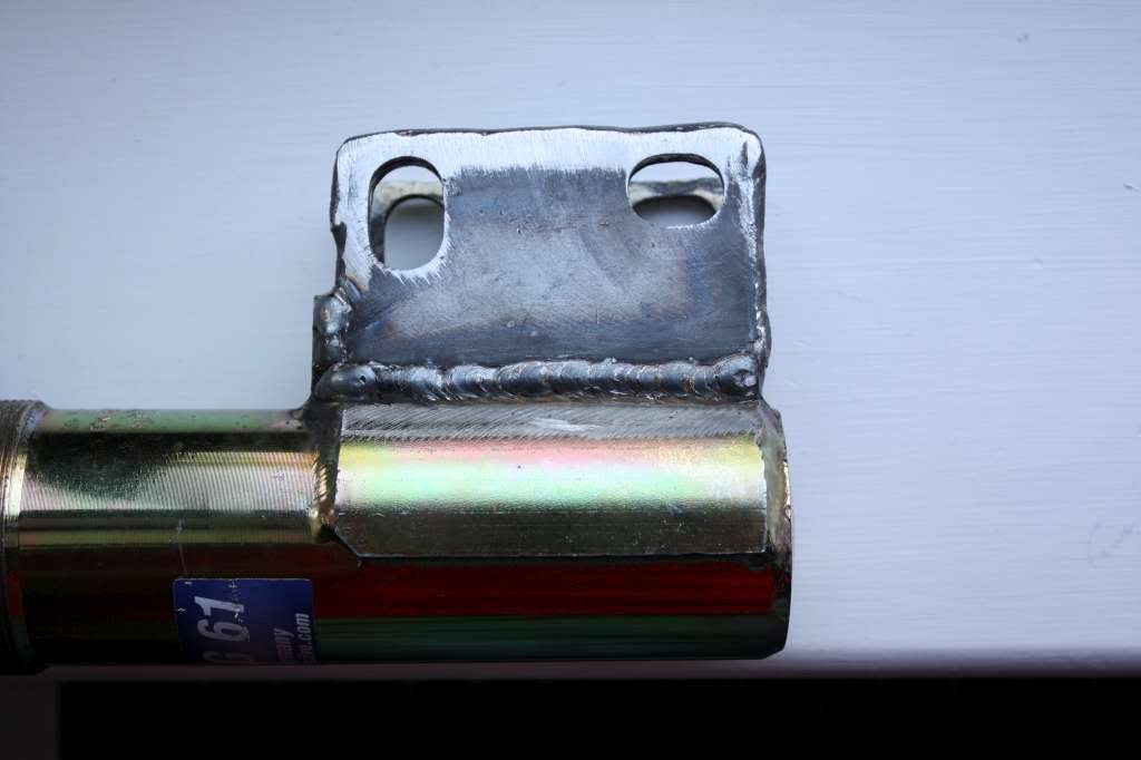

To run the 172 front hubs, the (Williams fitment) coilover holes need enlarging from 12 to 14mm to accept the 172 shock>hub bolts as the Mk1's use a smaller bolt. f0xy has been running his like this for over a year now without fault, so he had my holes machined by the same chap that did his. Fitted perfectly when I originally fitted them so thought no more of it.
Throughout the day at Oulton I seemed to gain more camber on one side. Now I knew my bearing on that corner was about shot, so I thought this might have had something to do with it. Anyway, not wanting to waste the day I carried on regardless, lol.
When i went to take the hubs off to change bearings, the problem became obvious. The holes in the coilover had enlarged and ovalled. Whether this is down to FK using monkey metal, the holes now being too big (as above, EXACTLY the same as Jord has run for a year), or the mega grip my Mk1 produces (;)), I don't know.
Anyway, I set about rectifying this and strengthening the mounting plates. I have about 6/7mm spare thread on the 172 bolts so I can get away with adding 3mm thickness to each side. Found a fair size offcut at work and set about making something suitable. So far I've managed the following, just 1 out of 4 done so far. Only one shock seems to have enlarged, the other is as I put it on...? Anyway, I'll do both shocks to hopefully eliminate any problems in the future.
As you'll be able to see also, the ABS sensor thing at the top of the shock (with tapped hole in) isn't welded to the side plates as standard. Why this is I'm not sure, as it'd strengthen them up no end. So i tied that in too while I was at it.
Comments/suggestions welcome as ever
My first thought is that it would have something to do with how tight you've done the bolts up. Really tight>lots of friction>less direct shear load or looser>bit of movement allowed>excessive force concentrated on the hole circumference
What material is that coilover tube made from? Is it just a zinc coating or something?
Yeah they are just plated/coated, eventually comes off and goes crusty (over the past year on mine)...
I have always ran the coilovers, so I just measured the width of the coilover and machined the hub down to that which is a very tight fit on mine just how I wanted it...
Chris originally ground his shocks down to the width of the Billies he had on last year, so there may be a different dimension somewhere - so as its been tightened the sides have squashed inwards
They are just made from zinc plated steel. The zinc plating corrodes off after a while so might be worth sealing them with something if you want them to last longer.
I think this has happened because you tried to field mod them and use them for something their not designed to do, it wont be because of the spec of the metal.

I modded mine (machined hubs down and made the holes 0.5mm larger) in October 2008, covered 20k and alot of trackdays and they are still as they were - same coilovers, same setup, never had an issue like this...
The only difference is - I milled my hubs down on a milling machine, to an accurate figure (.5mm) so it was a perfect match for my coilover - whereas Chris used a grinder and matched it to his old 'standard style' Billies...which could well be different to the FK's, or his hubs are just not accurate enough. It would explain the sides squashing in under tightening (i.e. the hub being too narrow)

The only problem you may have now is by welding on the shock tube, you're getting the actual damper internals SUPER hot and could have cooked the oil, melted a seal/O-ring etc etc. May be ok but you never know!
I'm confused...
How would the bub beng too narrow cause the shocks bolt holes to elongate??
I'm a pussy and didn't want to take a milling machine to my brand new shocks so i'm using a collar over the original valver hub bolts! lol.
Right front.
The heat did cross my mind, and I was going to remove the insert from the tube all before welding, but all the welding I did was additions to the mounting points and not directly onto the tube itself. Also let it completely cool between each weld so I didn't generate too much heat.
I'm confused...
I don't think it would. It's a minimal amount, so I'm fairly sure it's got to be down to enlarging the holes and leaving a very small amount of material to the outside of the holes.

I wasnt on about the holes enlarging, i was on about the deformation of the mounts - i.e. closing/squashing together
