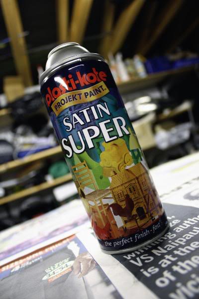

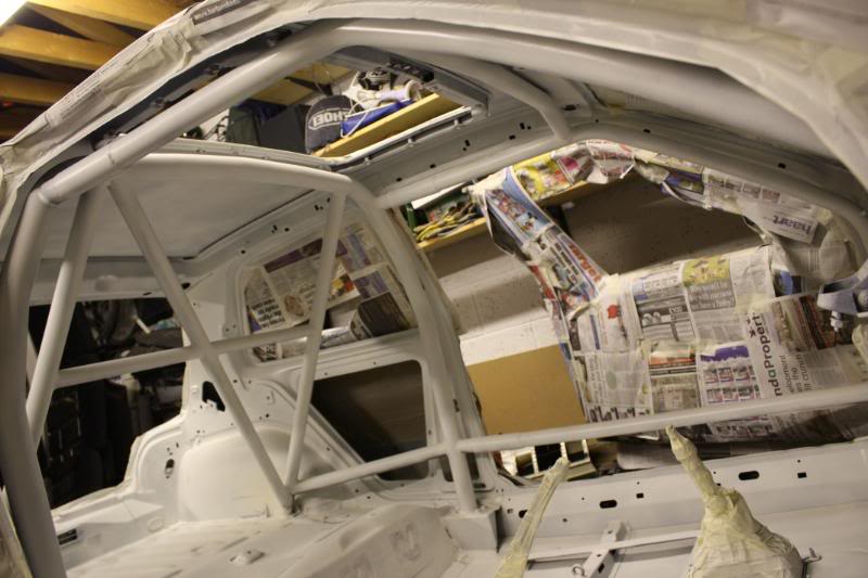

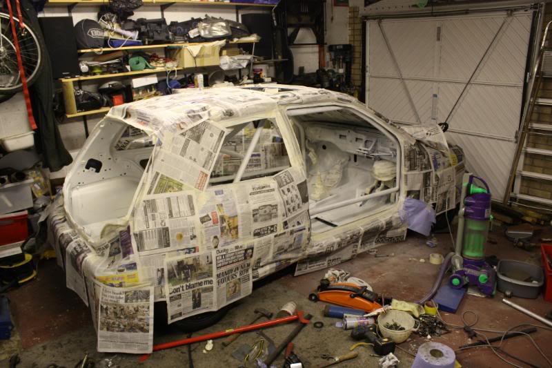

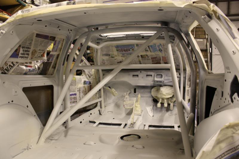

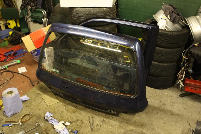

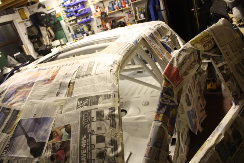

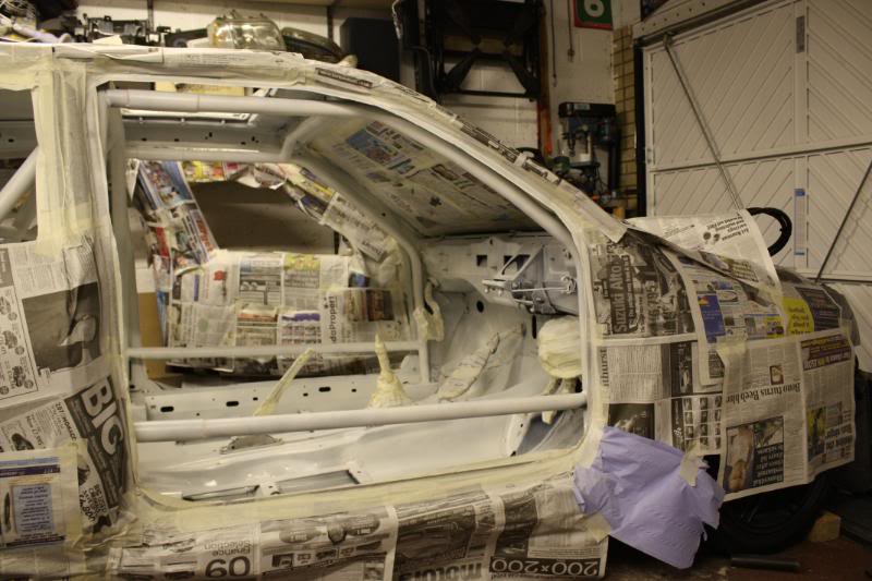

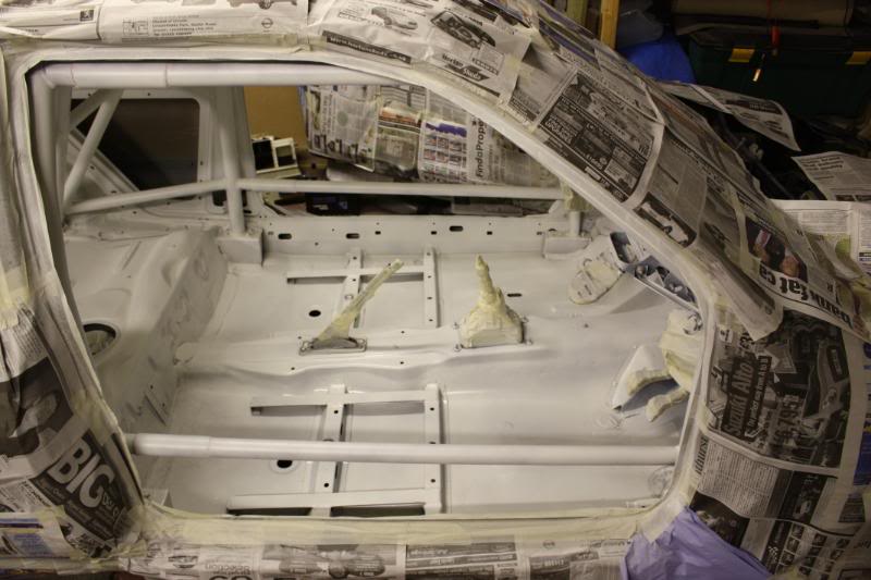

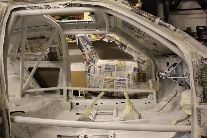

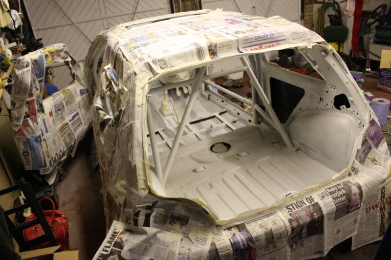

Been masking and painting tonight... til a lack of paint brought a stop to the proceedings.
Bootlid off for better access and to stop it being painted
Old school sticker of win, well some of
The newspaper print wrap
#7 down. The mother is getting me more tomorrow, B&Q wont serve me as you have to be 21 to buy paint :S

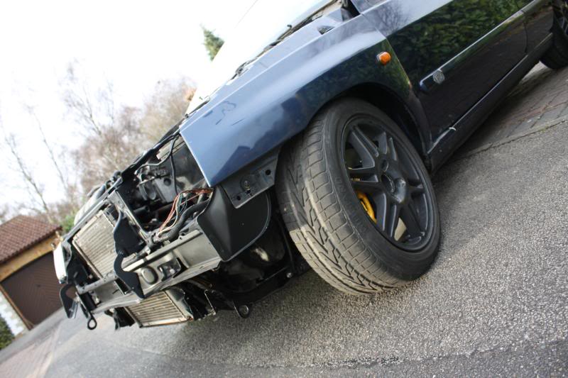

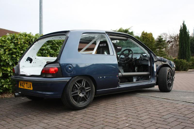

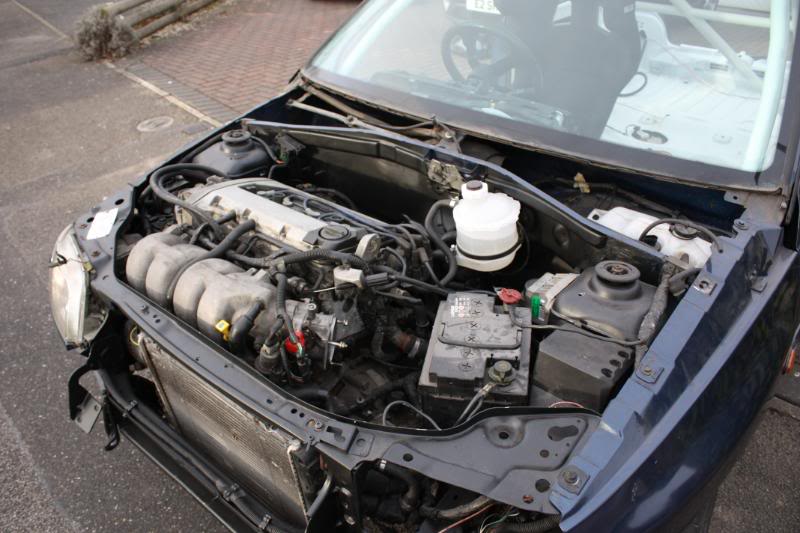

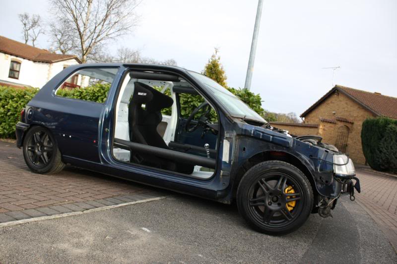

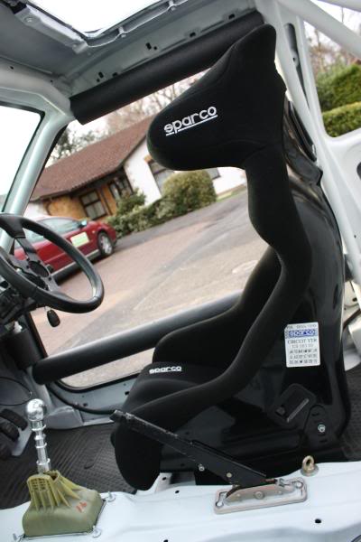

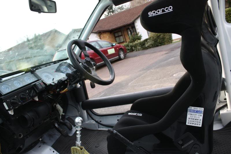

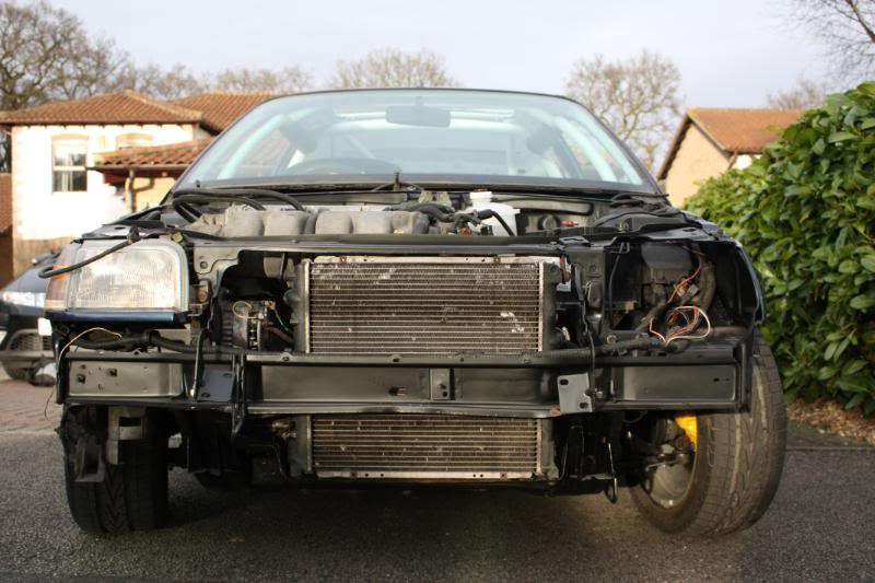

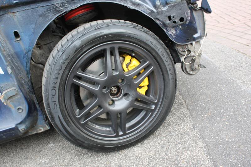

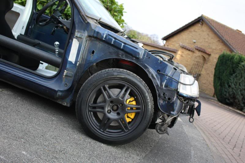

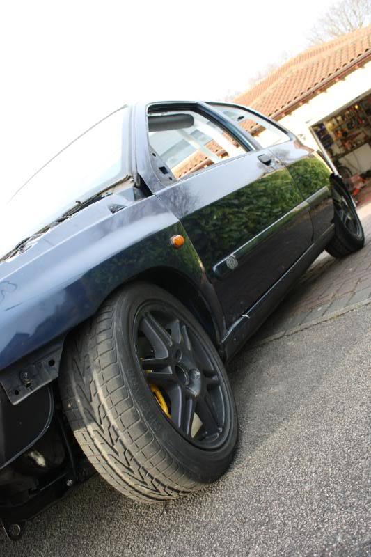

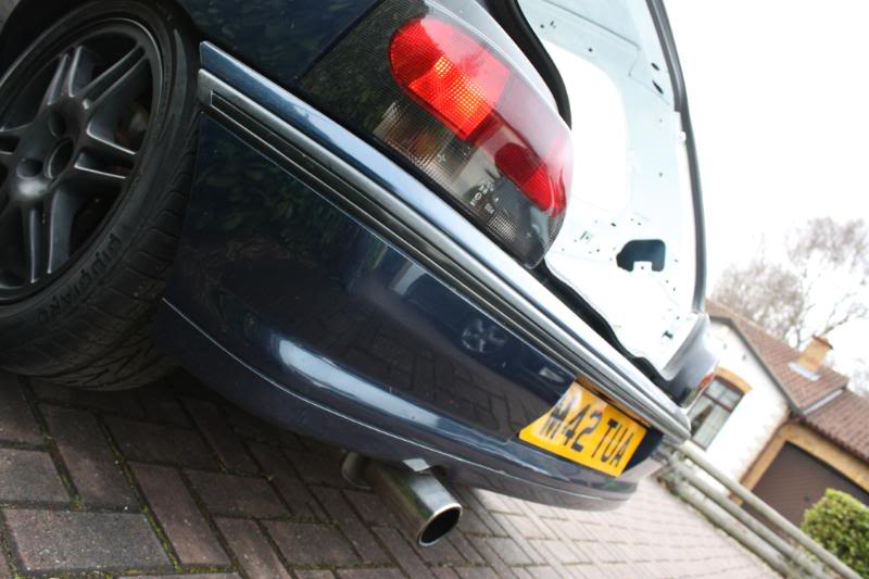

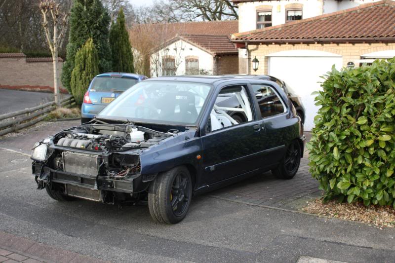

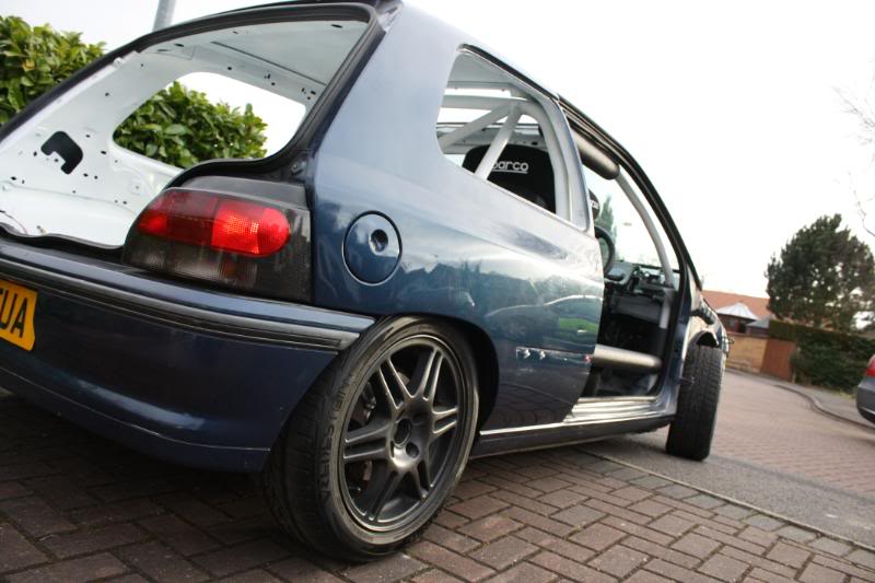

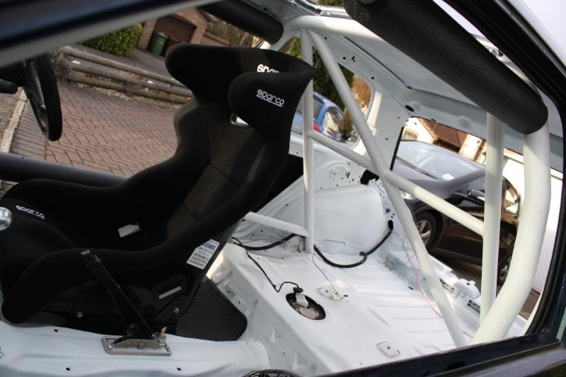

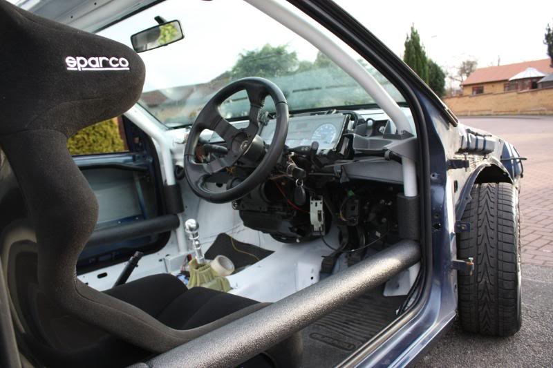

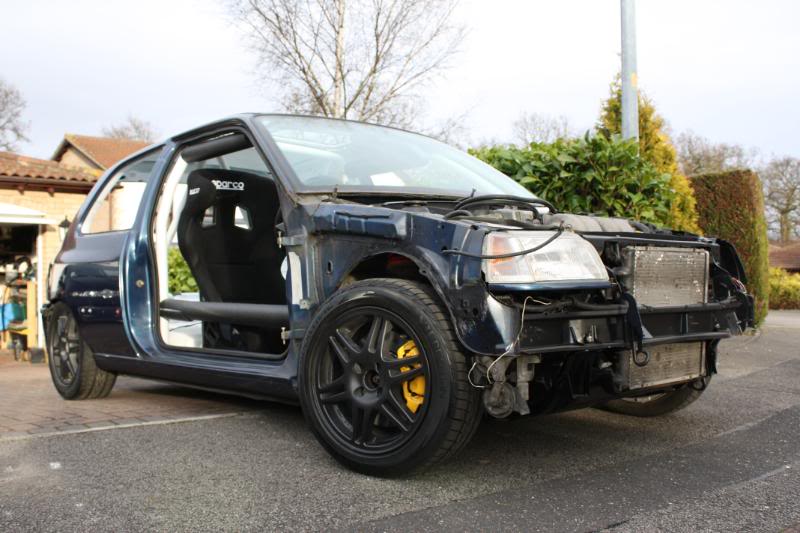

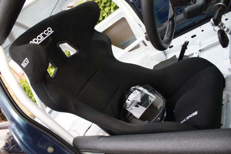

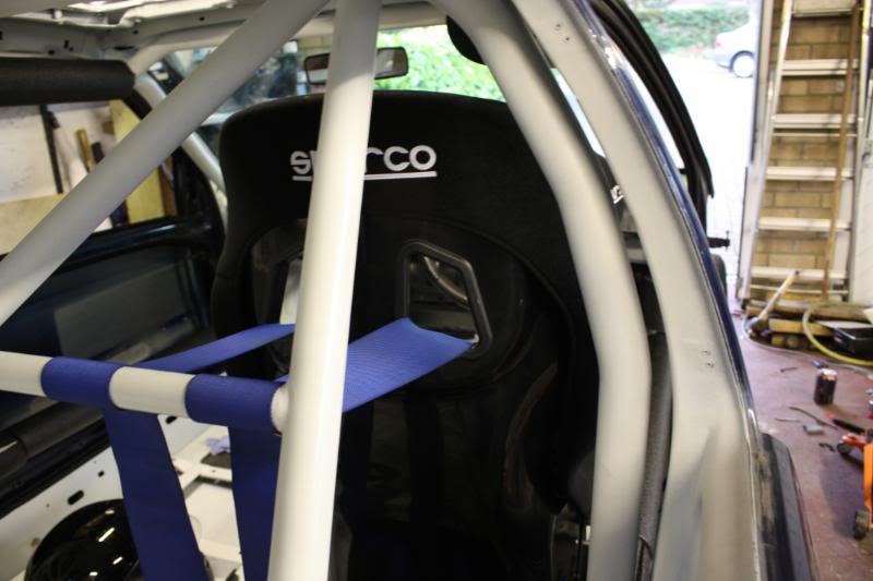

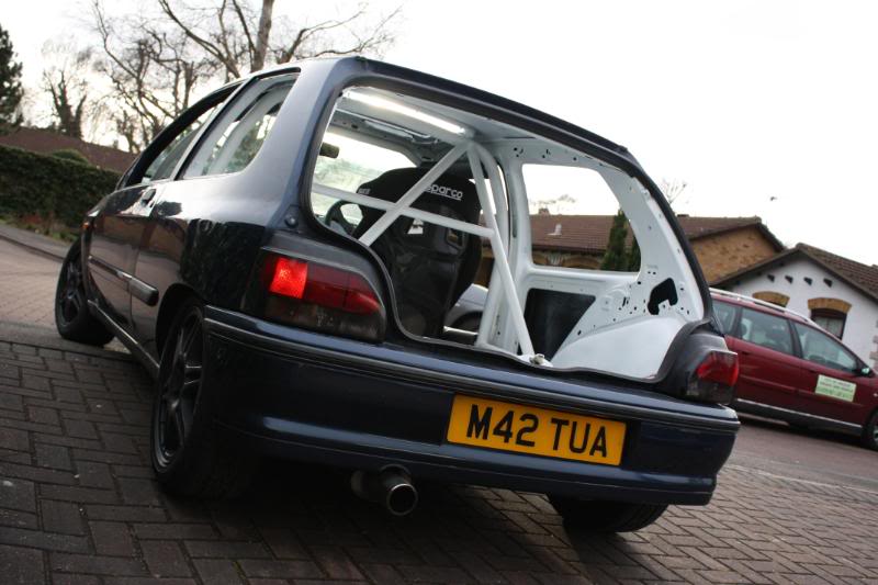

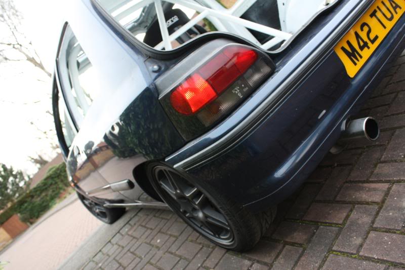

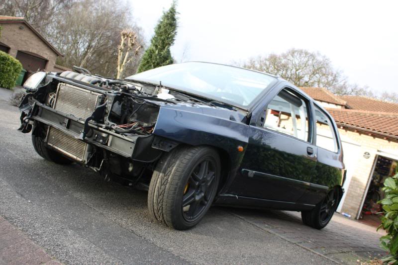

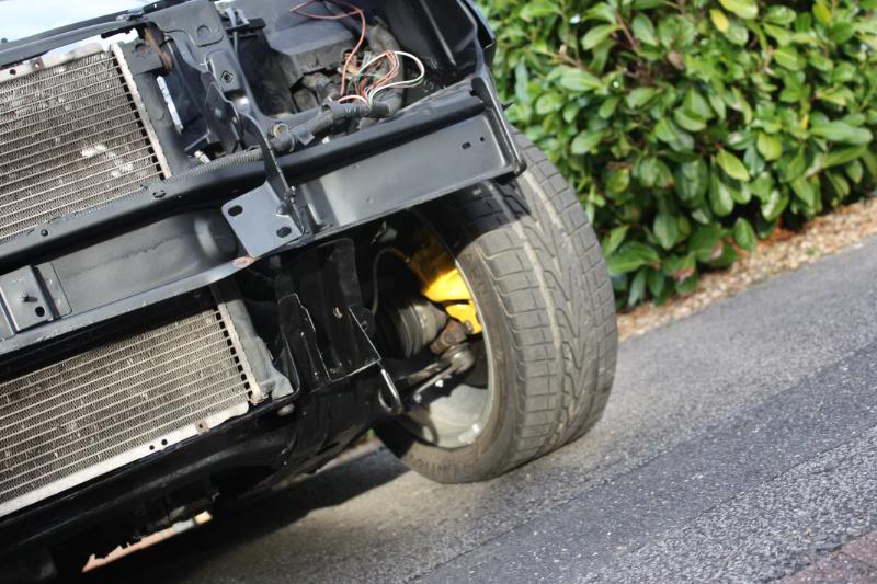

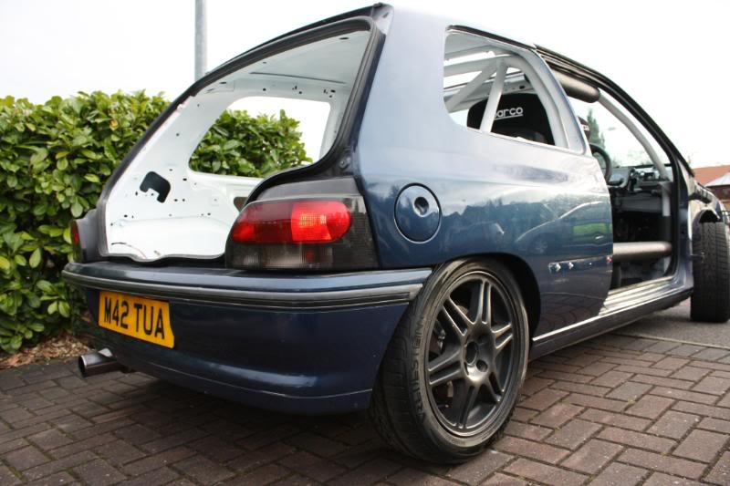

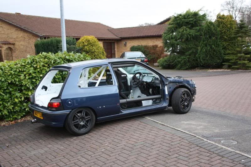

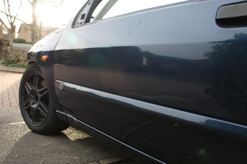

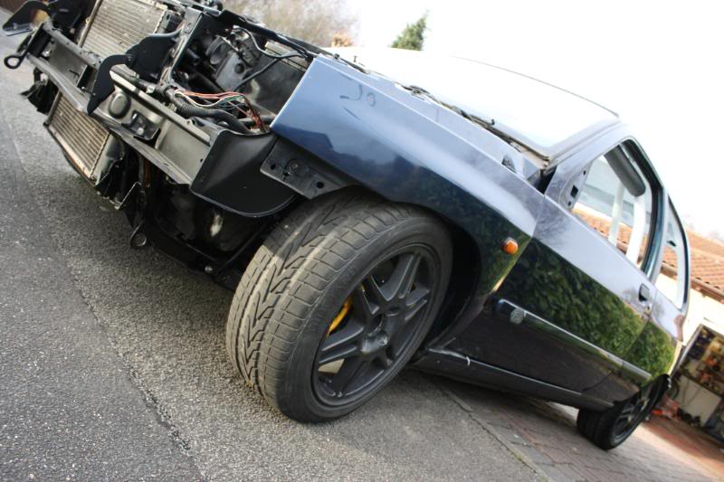

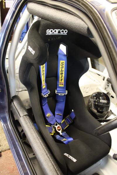

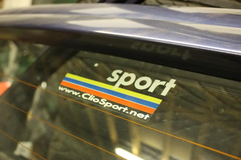

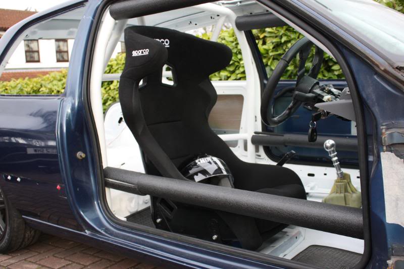

Been a while without an update, but I've been pretty busy. Not taken any pics since the last set but things have come on quite a way. I'll let todays 'current status' pics show you where I've got to. Note it's at the top of the drive, under its own steam ;)
Lots of pics:
