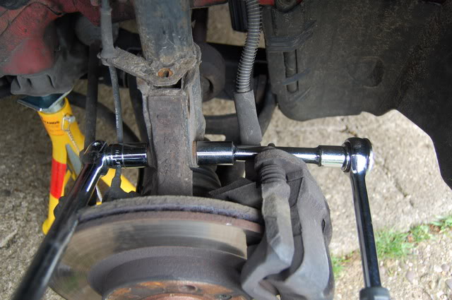

Going to be fitting new springs tomorrow using THIS GUIDE, ive got all the bolts soaked in WD40. Is there any other tips before i jump in with both feet tomorrow?
Once ive unbolted the strut do i need to be caerfull of the driveshaft falling out of the box and leaking gearbox oil everywhere?

Nah dont worry about it, the shaft wont pop out the box because your not going even close to removing it,
  Astra 1.9Cdti SRi
Urm hope you have spring clamps,
It's literally 3 nuts in total to remove the old suspension, so you cant go wrong doing it,

ive gone through the two bolts on each front strut and the rear bolts on the dampers this morning and made sure i can get them off. took ALOT of WD40 and ALOT of hammering the spanner with a big hammer but they came loose in the end.

If you only disconnect the 2 bolts on suspension were it connects to the hub then the driveshaft shouldnt pop out, its the same for non-sports & sport models, both work the same way.
Btw Passenger side driveshaft is also bolted to the box via 3 10mm bolts,
^ Ok so as long as the 2 bolts (top and bottom) are being undone:
are undone the driveshaft shouldnt pop out?
My top mounts undo easy but i havent checked the bottom 2 bolts.

The drivehsafts do pop out, well can pop out, just puch em back in though.

THE biggest tip is what that man above me says, if the shaft pops out, don't panic, and pop it back in.
Don't do what most (including myself) do, put your hands on your head and shout "f**k" as you lose all your gearbox oil for no reason at all, other than being an idiot.

^ driver side just push back in, its splines so will just slide off abit,
Passenger side like i said has 3 bolts holding the shaft in place, the end to this shaft has 3 ball type ends, which needs to be in oil every time, but be carefull on the passenger side and it will be easy

3 hours, one nearly broken finger and they are fitted.

It wasnt actually that hard, however, the hardest bit was getting the strut-to-hub bolts out and then back in again. i found that a hammer came in handy lol probs also didnt help that i was doing it on a slant . Needed the spring compressors, would have been stuffed without them.

to stop the DS popping out just suppose the hub with something to stop it from falling away from the car. Renault jack or something similar would do.
Yeah refitting the hub bolts is a pain to be fare. Just have to keep wiggling and hope it goes in.
