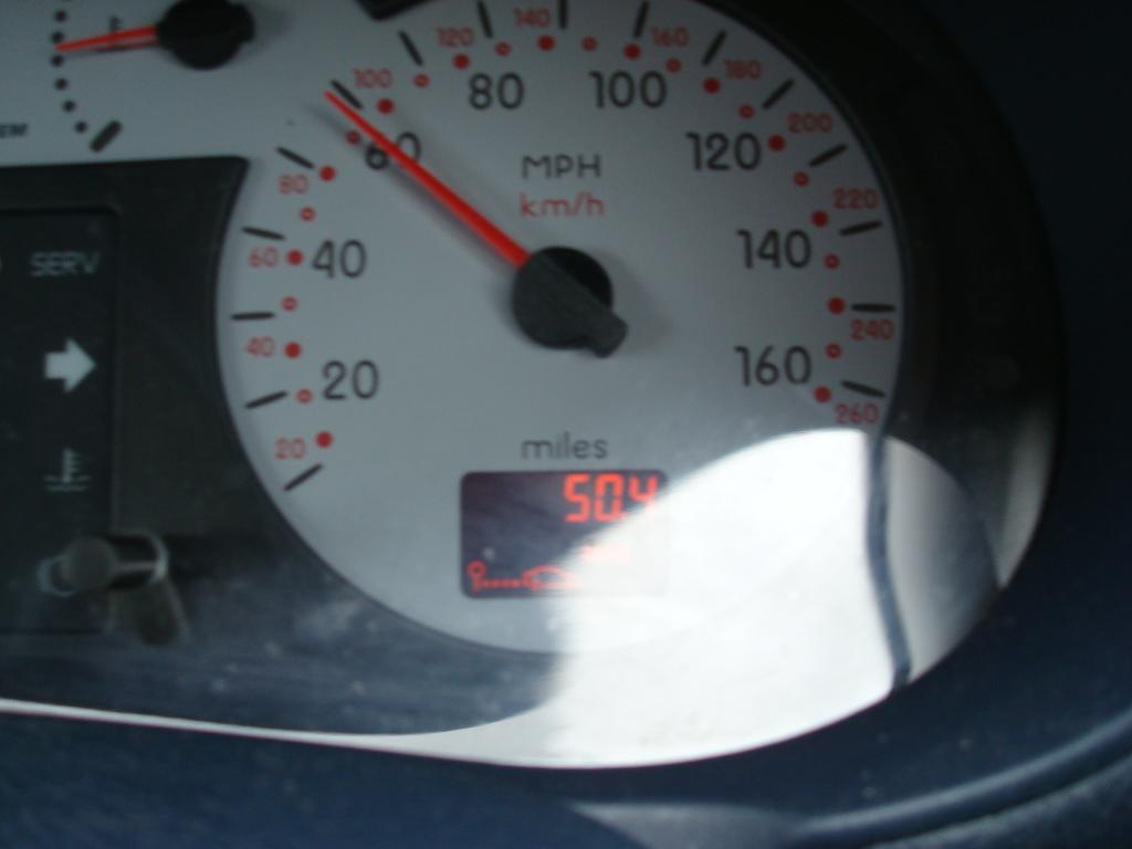

Reset mine at the petrol station was getting 51mpg till I hit town and traffic, now it's only 38mpg

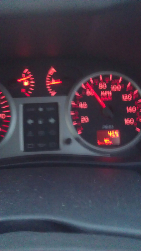

The pic below from earlier in the thread reminded me of my temp guage before I fitted a new thermostat. On the motorway it should sit a bar higher than this, mine now gets up to temp very quick and stays there. Even in -4 last week.
This is what i get on the motorway
Untitled by sbridgey, on Flickr
Having said that, if a slightly leaky thermostat makes much difference to MPG I did not notice it though. My last tank before replacing it got an average of 33 MPG doing mainly a 20 mile B road commute - I am getting 34 MPG now (I floor it quite often so expect I might be able to get more)
