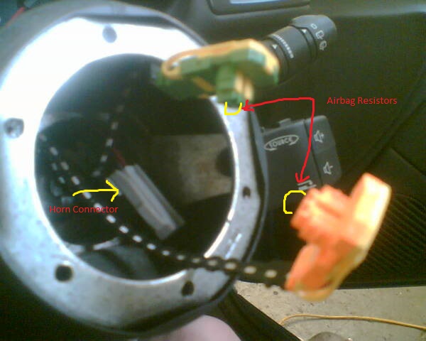

They sit in the boss. The airbag wires are connected to the airbag ring. This spins with the boss, so nothing crosses over. ;)
Like this
Resistors go in the x2 airbag connectors (ignore the fused resistor in hand lol)
Horn connector is pushed down into the boss there. I'd simply get some spade connectors, connect to your horn, then connect to the horn connector (cut off and keep in safe place if need be)
But.. He cant get the connectors for the airbag through the boss kit tho, thats what hes on about, ;)

Cheap maplins resistors don't work.
/speaking from experience.
I've fitted about 5 steering wheels to RS's in the last few years and they all work. Resistors are resistors. You must have had the wrong ones.
Like this
i never got that far cos the stupid wires wont go through! lol hopefully ill get to see that next time i try. i dont know what you mean about the horn though?i dont know anything about conectors or wires? thats something else im confused as to how ill get working and wired up lol

you know how you say the resistors go in, do the resistors go from one end of the airbag clip to the other air bag clip or dus each resister go from one bit of the same wire to the other?not sure that makes sence lol?
1 resistor for the orange bit only and a seperate for the green/yello part only? or do they go from one to the other?
one resistor per airbag connection i.e one for grey one for orange... fold them in half and make a circuit for each connector

Does this help?
right this is like a "early learing - my first use of paint", but im tired and on a laptop without a mouse....
the two airbag connectors come out of the steering column, you need to get two resistors from maplin, bend them into a u shape and poke them down the holes in the end of the airbag wires. simple as that.

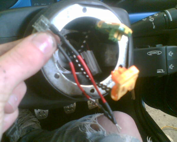

lol thanks mate this is also a good help! i understand the air bag resisters now so feel like i can tackle this one.....horn = :nono: i dont know....haha
ive not got round to doing the horn yet so dont ask me for a pic of that ;)
gona do the ph1 stalk though eventually with a horn push on the end. dont like the idea of frying the wiring by just connecting it to the horn push that came with the steering wheel.....
if you do get stuck with the resistors / boss, fire me a pm or something

Pretty sure with the horn, you get a metal ring with the boss, the black wire of the horn wiring goes to tha spade connector, and the horn push itself has a connector spade, the red goes to that (was i long time i wired one with a centre horn push). I'm running a phase 1 stalk as i have a Sabelt wheel
yeh thats exactly what ive got, just didnt want to connect it up due to reading about peoples wiring getting fried when they did???

Took it to an auto electrician haha, was easy as fuk took him abwt 10 mins and payed a 10a which is ideal as its now sorted.
All he did was use the wire that had came with the wheel, simply conected the wire from the horn conecter to the push bitton on the wheel, when he first did it a bit of metal on the push button must of hit the wire and started smoking, i started panicing but it was alrite and covered it in electri tape and now works
