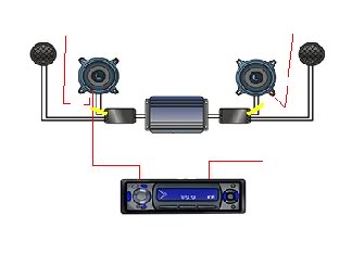

Sorry, forgive my stupidity but did you amp these? I'm thinking i can run speaker wire from the amp to the crossover and then from the crossover into the standard speaker wiring and then a seperate wire to the new tweeters? Would this be ok?

Cant remember if I amped them straight away or not but regardless the order you've written isnt quite right.
Amp>Crossover then woofer>standard speaker wiring (if you dont want to run it throught the door) and crossover>tweeter.

Hmm that's what i meant, basically running speaker wire from the crossover to the original woofer wiring. I'll try and draw a pic in paint lol.
T3gav
Hopefully my crappy pic will how what i mean, run the yellow speaker wire from the crossover into the original woofer wiring and then leave the original tweeter wiring doing nothing and re wire the new tweeters to the crossover.

Yeah thats it mate. But rather than splice into the orginal wiring cut it and use it from the cut. Seen someone just strip back the plastic coating and wrap the new wire around, not so good!
Ah yeah that's what i meant just hard to draw in paint :) Thanks for the reply.
