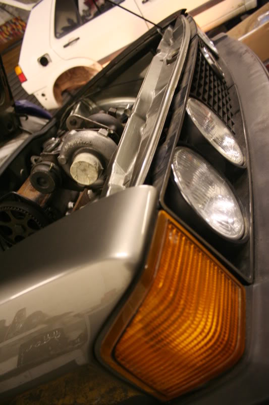

The turbos far to big so I need to sell that and find a T2/25 hybrid.. Shame as the T3 looks awesome lol

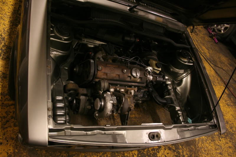

My mate welded my engine mount in for me in its new location so it would be rude not trial fit the engine.. It all very tight at the front end and on the bonnet

i havent read the whole threa but your putting a g40 engine in it? so 1.3 supercharged and then its gonna be turboed aswell??
Re: My 79 Mk1 Scirocco.... Got low
Cheers Mat.. Its from a 2WD Sapphire Cosworth LOL.. Bit big yes but thats what came with the engine and the lag will make traveling to shows cheaper ;)
I was thinking the turbo looked a bit big in the first pic. It's probably bigger than my k03s. Infact I'd say it is. But who cares about lag? It's hardly Gunna be a point to point racer! Haha
Its more like K04 size lol... Boost for duel carriage ways, motorways and very flat roads only lol

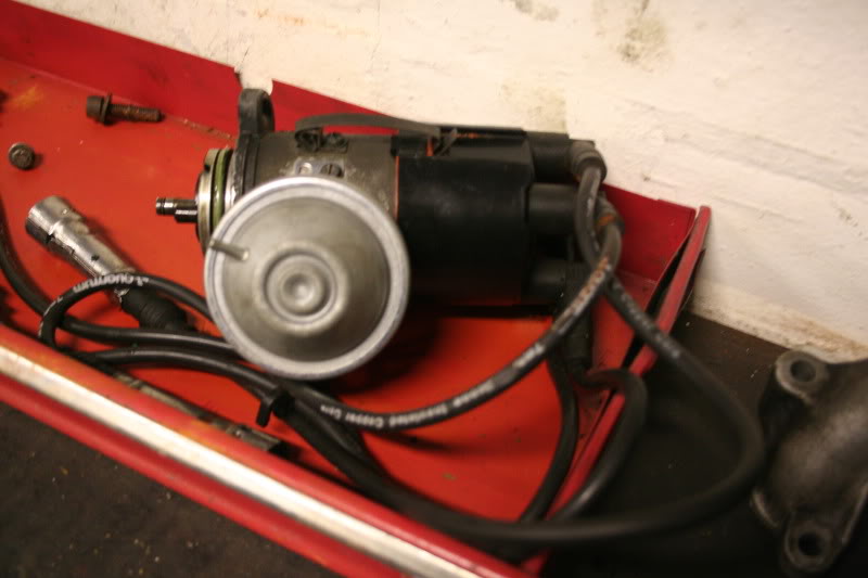

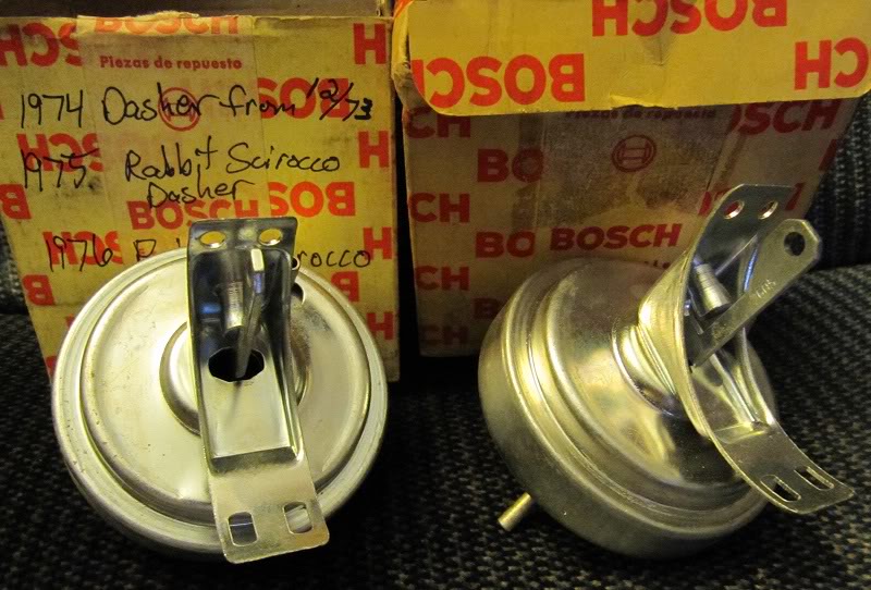

After reading up on Kjet turbos on VWVortex I found out I can use an early VW Rabbit dizzy vacuum canister and this will also r****d the ignition on boost.. I manged to sorce a NOS canister from a very friendly chap on Vortex.. So I intend to fit this to a mk2 Golf 1.3 dizzy.. wish me luck lol

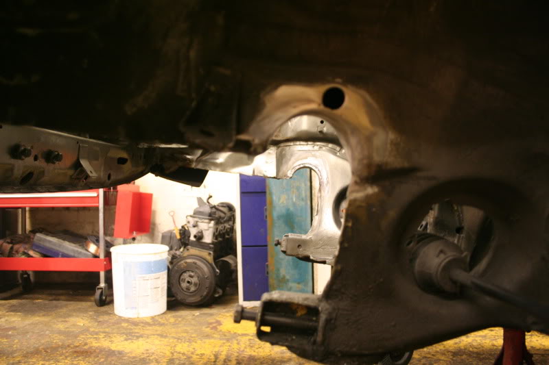

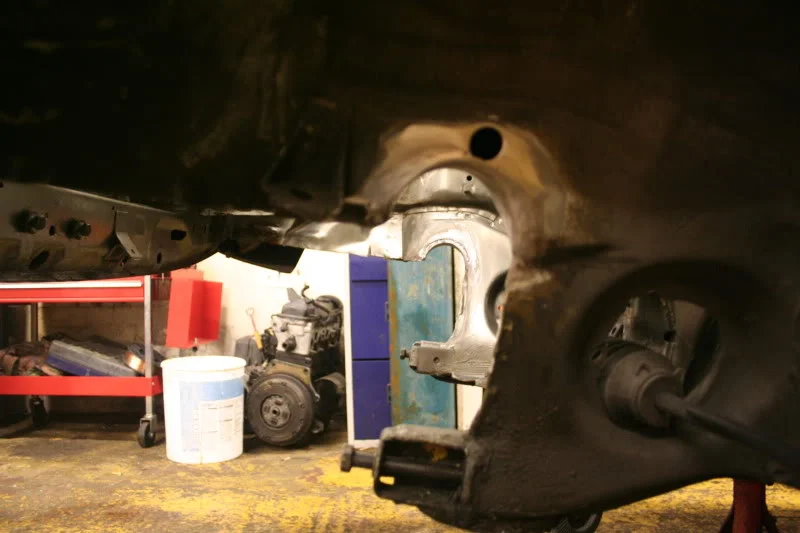

PS.. My mates dad has put a 2" notch in my O/S chassis leg but I have not got round to taking pictures yet.. I will wait till the other leg is done ;)

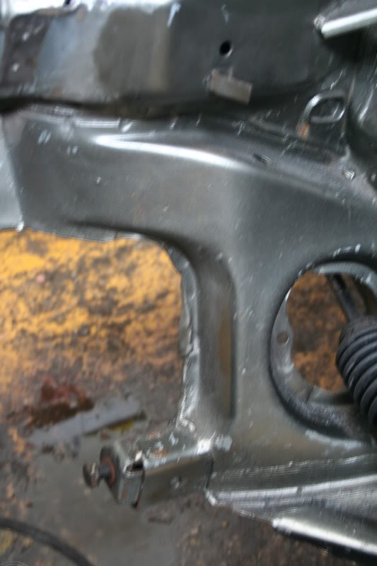

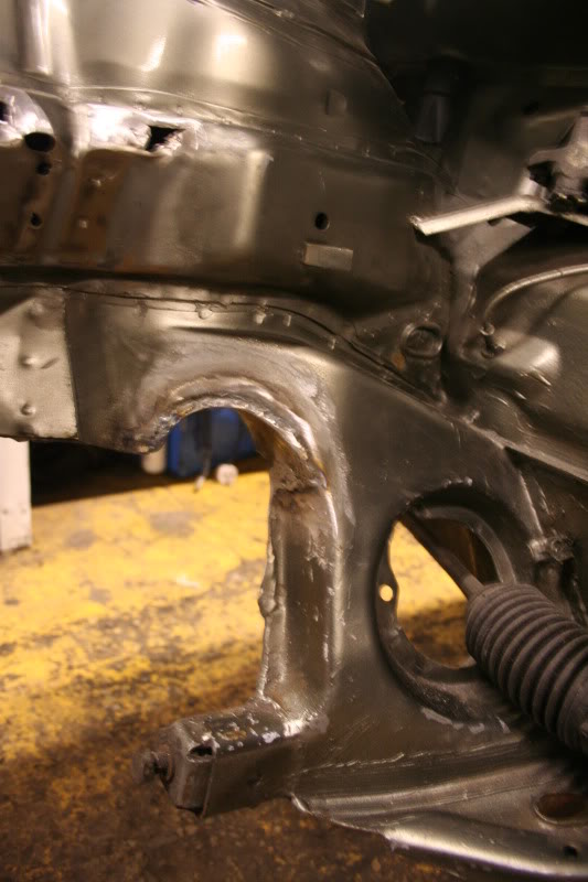

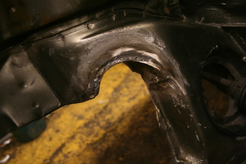

My car is said to have never been welded since it has left the factory and the first welding to take place is a chassis notch :cool::eek:... I still need to tidy it up but very pleased so far with glenns welding.. He's still got the other side to do :cool:
After

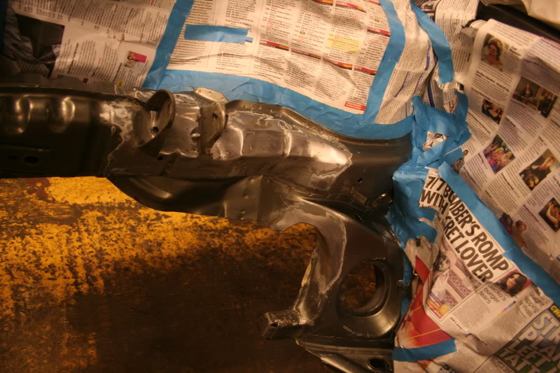

Ive cleaned up the notch... Glenns going to do some filling with the welder at weekend so I can get them fully smooth :approve:

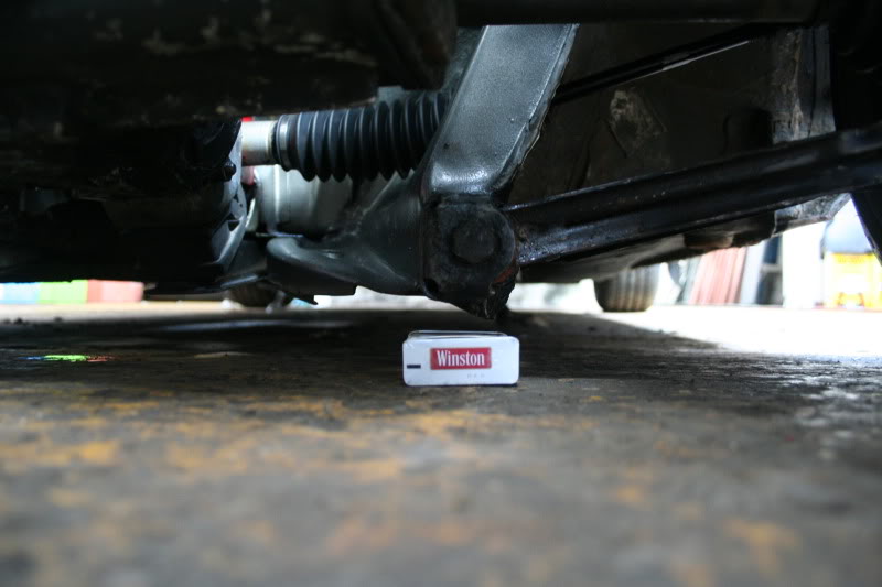

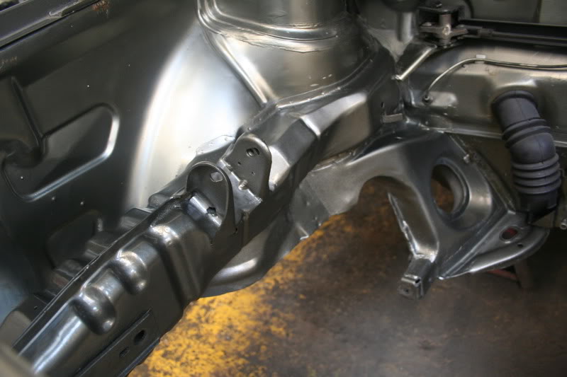

don't want to sound retarded but what use is the chassis notch? i know its so you can go lower, but is it cos the drive shafts would rub otherwise without it on winston style lows
Few people have asked so far from retarded
Yes.. They are to stop the driveshafts knocking on the chassis legs. The pictures on the first page are with no driveshafts fitted because when I first wound the coilovers down they stopped me from getting it sat right.

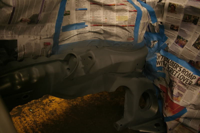

After many hours of grinding and sanding I'd had enough! I wasn't 100% happy with the way the notches blended in but I thought they looked ok for a first atempt.. This was ment to be quick job until I got carried away.. I will get them perfect when the full bay and car gets painted next year.. I now have so much respect for people with smooth engine bays. lol
4 coats of zinc primmer
4 coats of paint and 4 layers of laquer

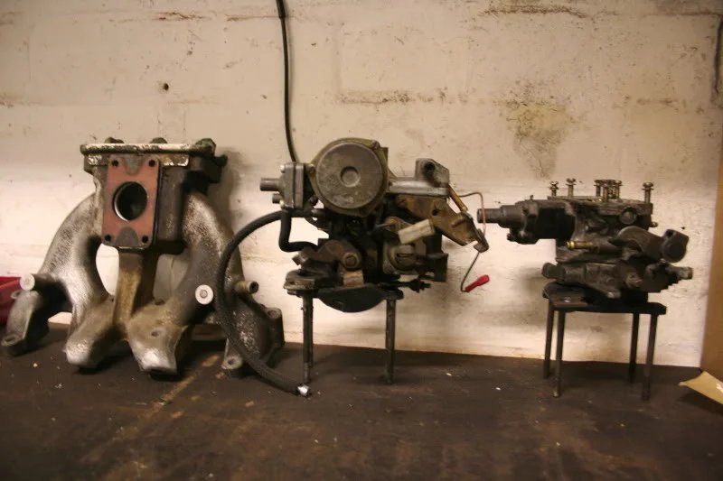

Vacuum canister fitted.. It was easy once I worked out I didn't have to strip the dizzy apart to fit it. lol

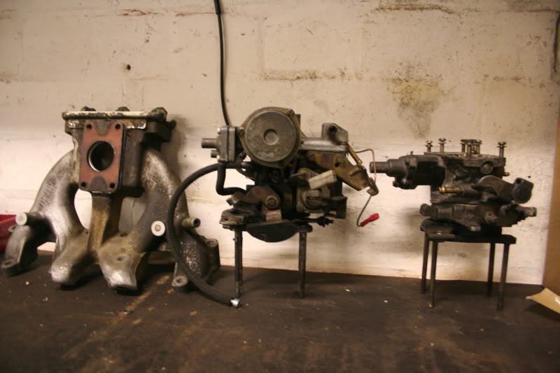

Mk1 solex manifold.. Mk1 Solex carb.. 5 GTT Solex carb... Nice and simple, no adaptors needed.

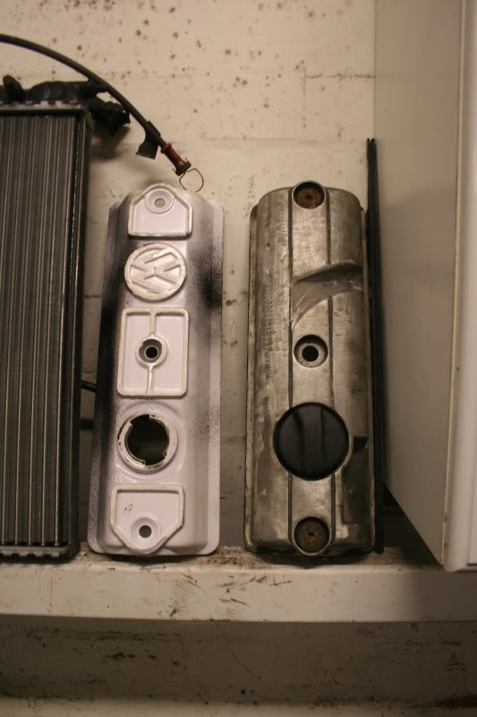

Ive bought the camcover on the left to polish up.

Not this year.. Im trying to make it look as much like an old original 1300cc Mk1 Golf engine as I can.. Once I know the engine is good etc I will make it shine.. i.e polish the turbo, gearbox and head:approve:

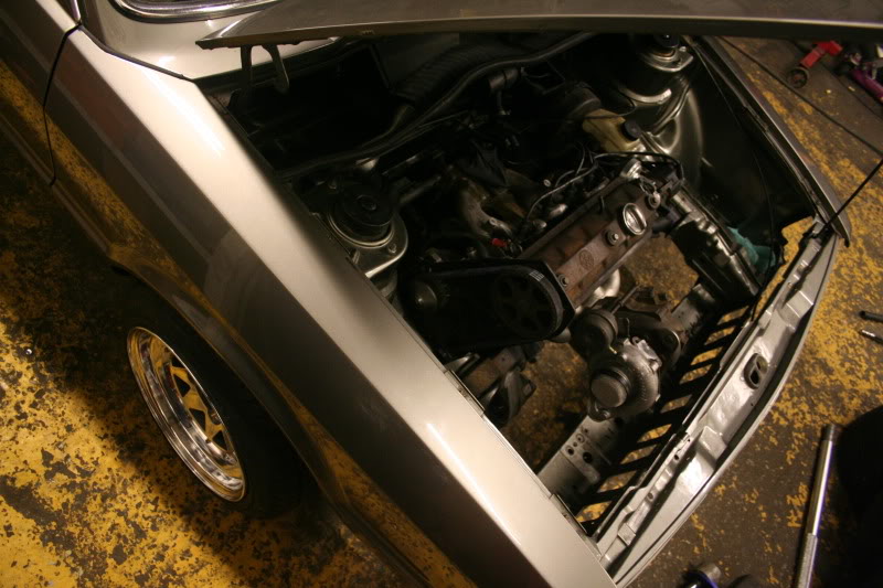

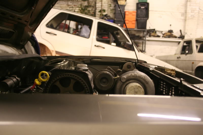

Right the engine is in after fitting a new cambelt, waterpump and Polo GT camshaft....
With the new engine being alot lighter than the 1.8 8V.. its not sitting as low as before.. This is an issue that needs some attention lol
