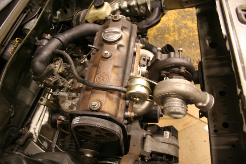

Now the engine is in I have ran into a few problems to deal with....
1. The carb fauls the bonnet on the adaptor plate so ive got to drill and tap the inlet manifold and even then it will be tight.
2. My turbo is upside down so the oil feed and drain wouldn't work.. I can't rotate the housings due to it being seized so Im on the hunt for a new turbo.. wish I had noticed sooner before I had bought lots of parts for the current turbo.. Oh well live you learn.
3. The shocks bottom out due to it being to low.. So I need to purchase some balljoint raisers as I can't raise my turrets like the Mk1 Golf boys because I have no room.. Im just waiting on the company getting back intouch on how to pay.
4. Looms are going to be a nightmare.. Its looking like I need to make the under bonnet looms from scratch.
Once these problems are sorted im sure I will have another list of problems to deal with.. Why do I make things hard for myself LOL

Ive just bought a Garrett T25 Hybrid from 5 Turbo on ebay today which is much more suited to the 1.3.. So fingers crossed I can make this work and get the project moving again :cool:

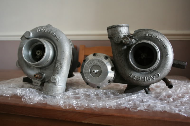

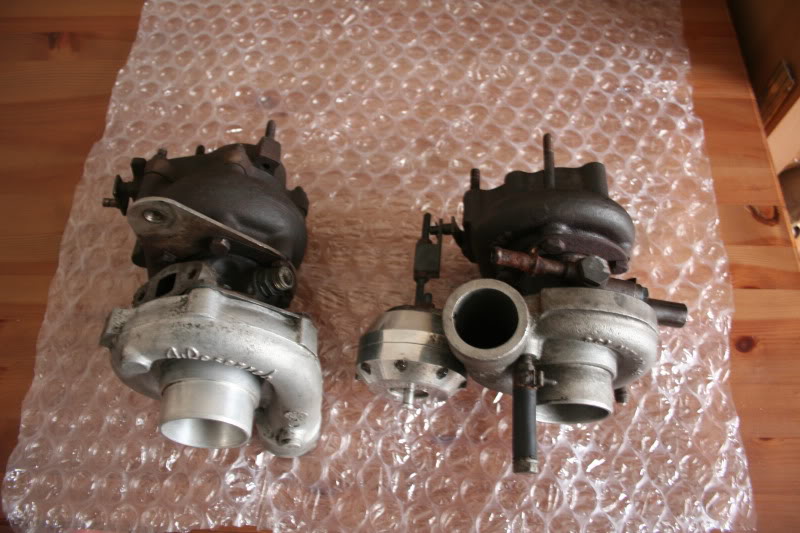

The new turbo turned up today.. Old on the left.. New on the right
The new turbo is quite abit smaller as you can see but its also much much lighter :approve:
Im going up to the car later in a hope that both housing rotate ok might might need a soak in some plus gas.
£80 for the old one... it has no back and forth play but does have side to side play, could do with a rebuild kit for piece of mind imo.. it also comes with a section of down pipe.

Ive turned the turbo housings and fitted a standard T3 actuator... leaving me an oil feed and downpipe left to sort out
The inlet is tapped and carb bolted down and ive sorted the throttle mechanism

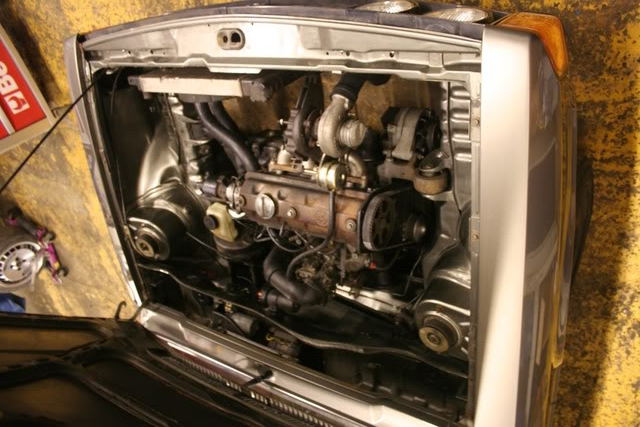

I feel like im getting somewhere now.. The bay is starting to fill up :approve:

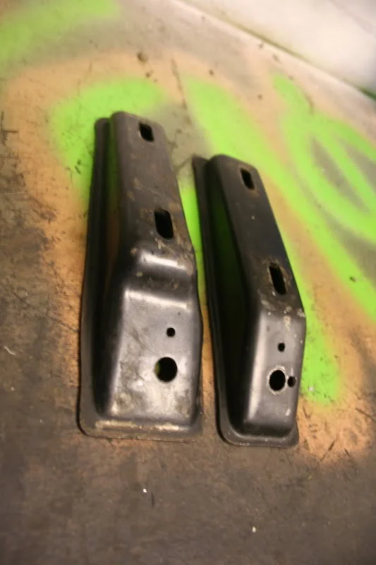

Quick update, mainly for Jason

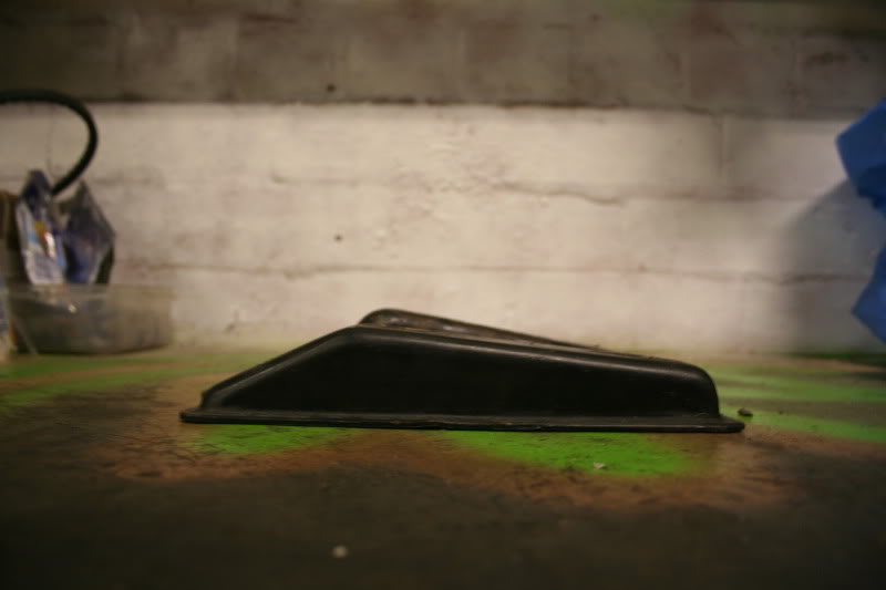

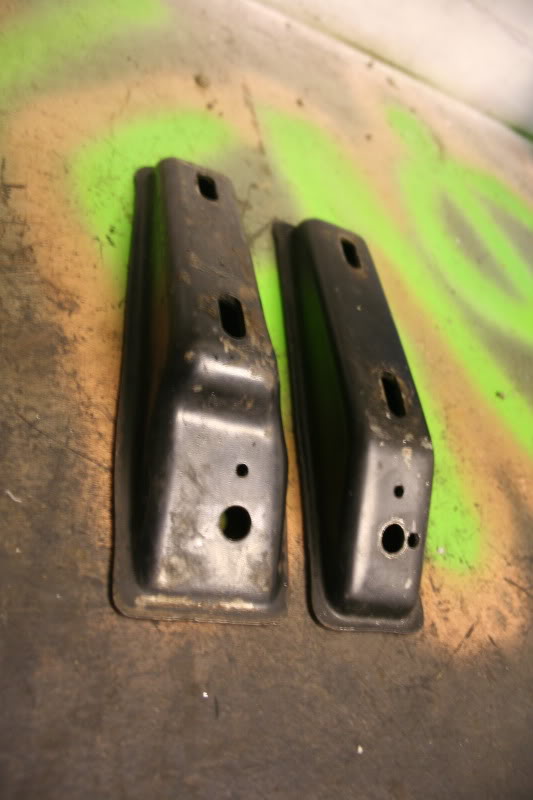

The mount bracket on the left is from a small block Mk1.. The one on right is from a big block Mk1.
I didn't know they differed and fitted the big block bracket to my small block and I wondered why my carb hit the bonnet lol.. when I realised and fitted the small block bracket it sat alot lower than my wishbone mounts and became the lowest point on the car.. you can see the difference in height below but i also sit further foward.
Im going to enlarge the hole on the big block and get it on the bench grinder :evil:

Sweet! I just took the big air filter assembly off mine to realise it's not a Pierburg, it's a webber. Needs a rebuild and a new fuel filter tbh.
