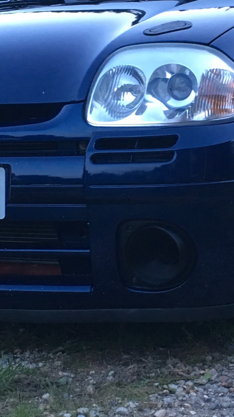

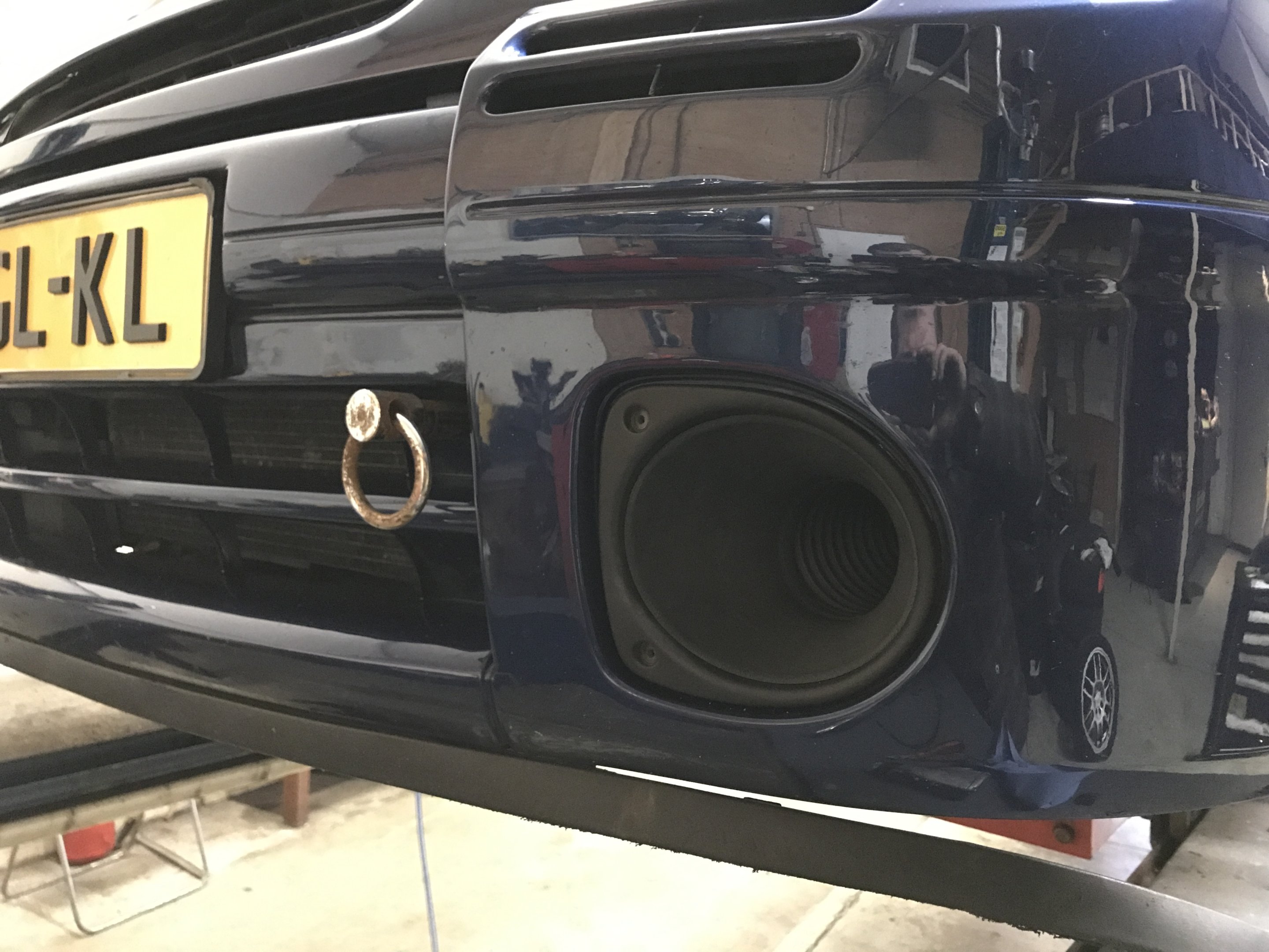

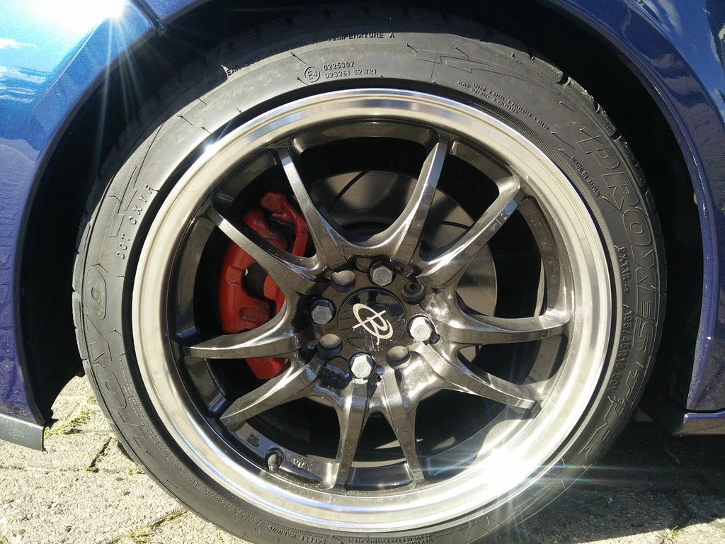

When I first got the car I did some yellow fogs and changed the ride height a bit. After a while i decided to do some maintenance, like change most of the gear linkage bushings. This made a huge improvement.

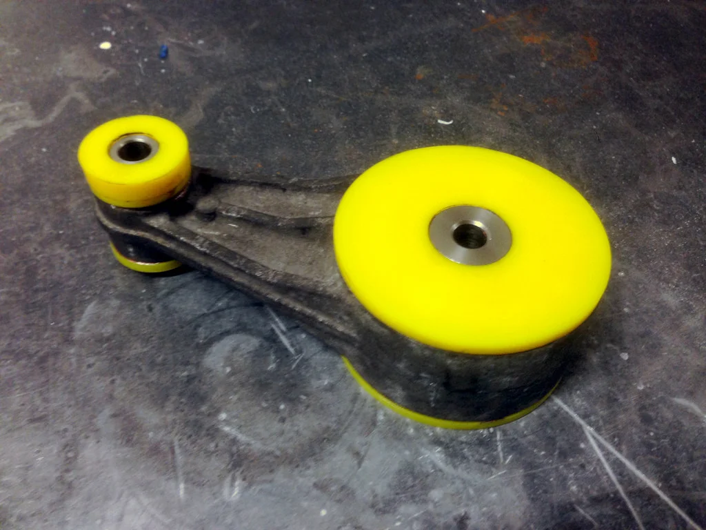

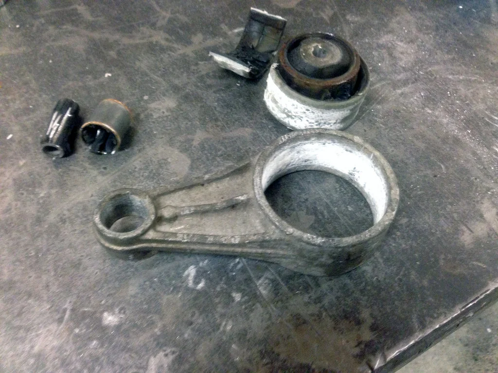

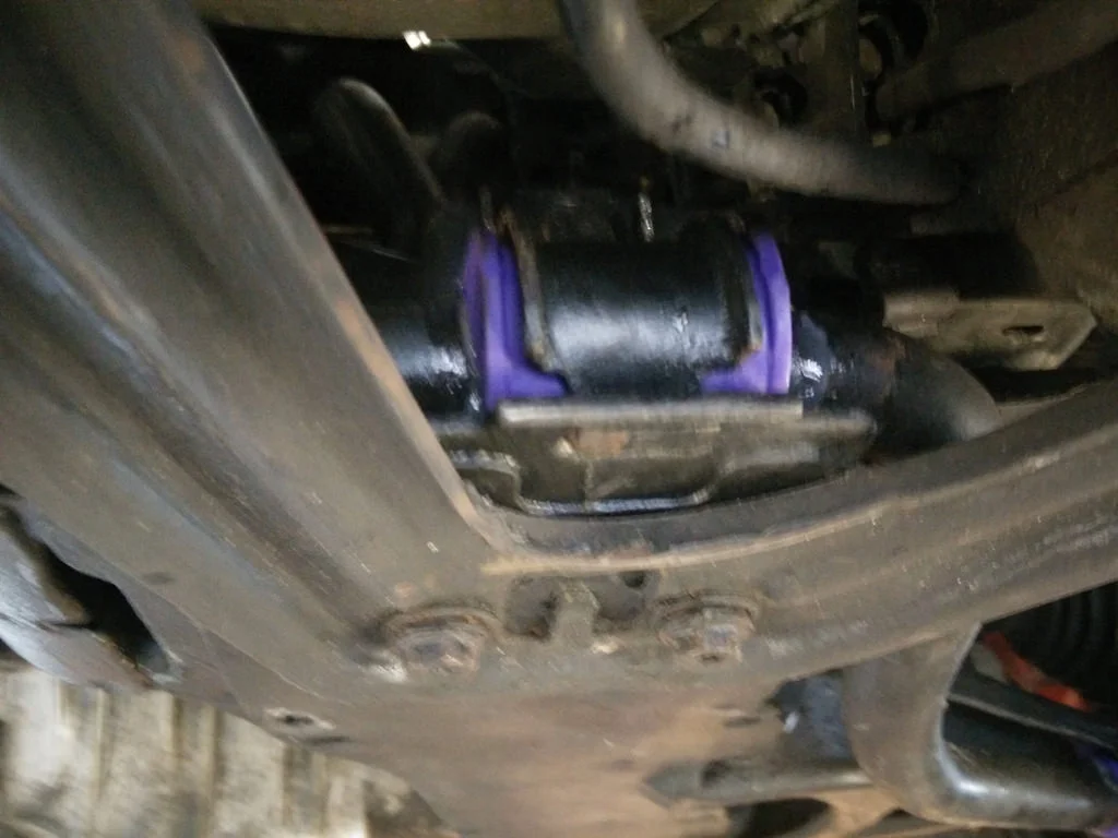

After a while I started upgrading the engine mounts. The dogbone was up first.

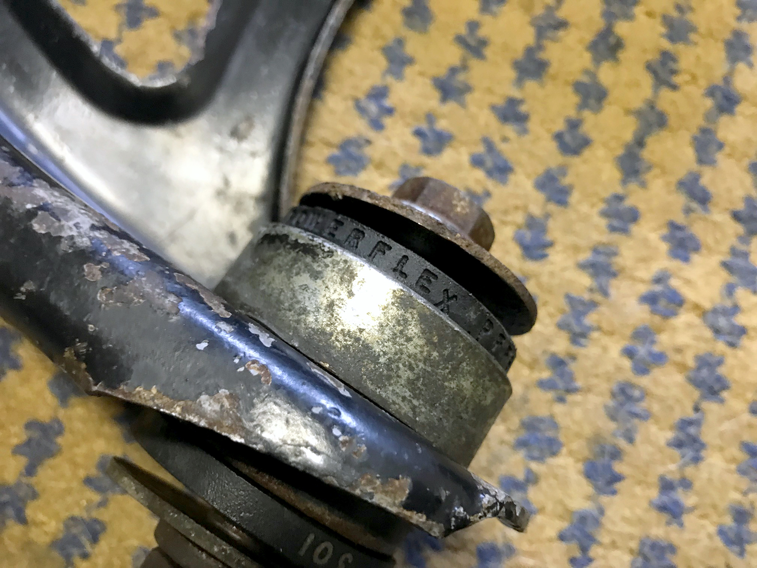

And then changed the upper engine mount to a powerflex insert. Can’t really seem to find a picture but you know what it looks like :wink: Also changed the actual upper engine mount for a new oem one. Did the same for the one under the battery.

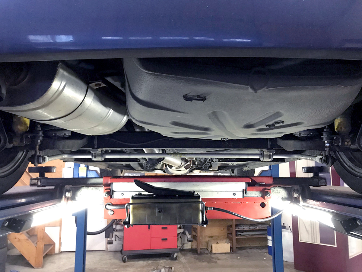

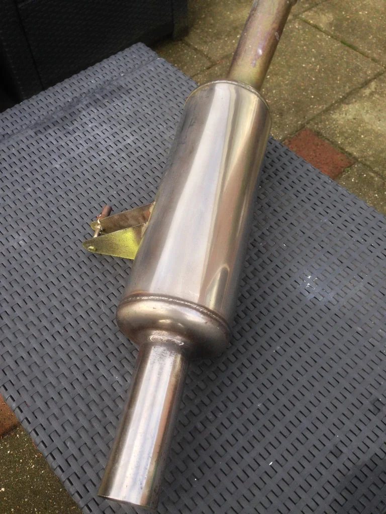

Orbisoud rear silencer:
Fitted a genuine Orbisoud cup rear “silencer”. It’s loud…

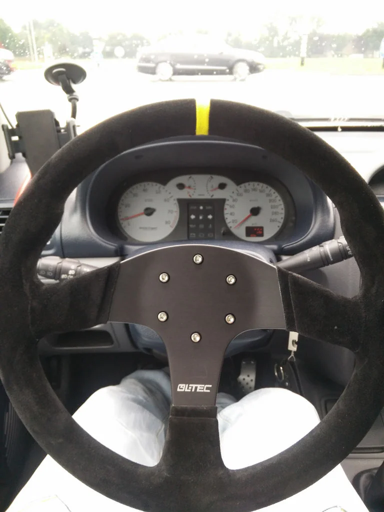

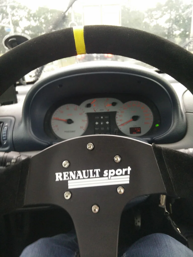

New steering wheel:
The previous owner installed a horrible QSP JDM DRIFT YO steering wheel. The suede was fcked so I bought a new steering wheel. I’m a fan of the Renault Sport version but I can’t justify that much money for something which will look s**t after a couple of months. Got this one instead.
Removed the logo and added Renault Sport

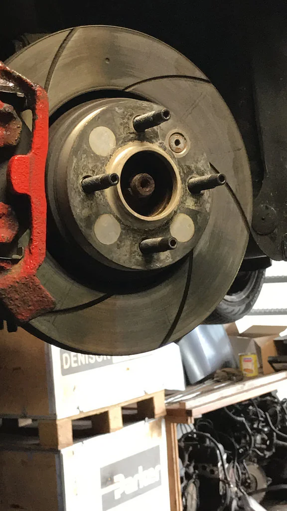

My brake pads were OEM and didn't survive the Ring. One caliber was also sticking so something had to be done.
The front brakes were properly fucked. Decided to change those asap. Went for K-tec discs and Ferodo performance pads. Also fitted some refurbished calipers on both sides.

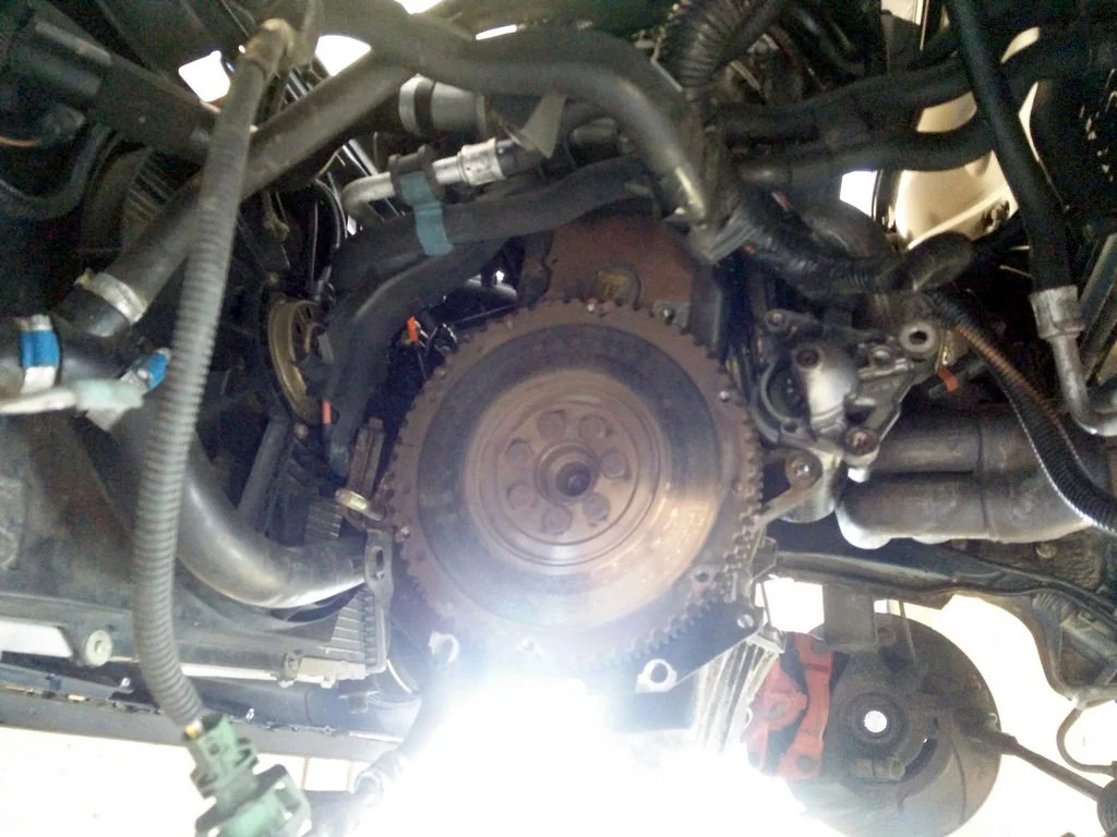

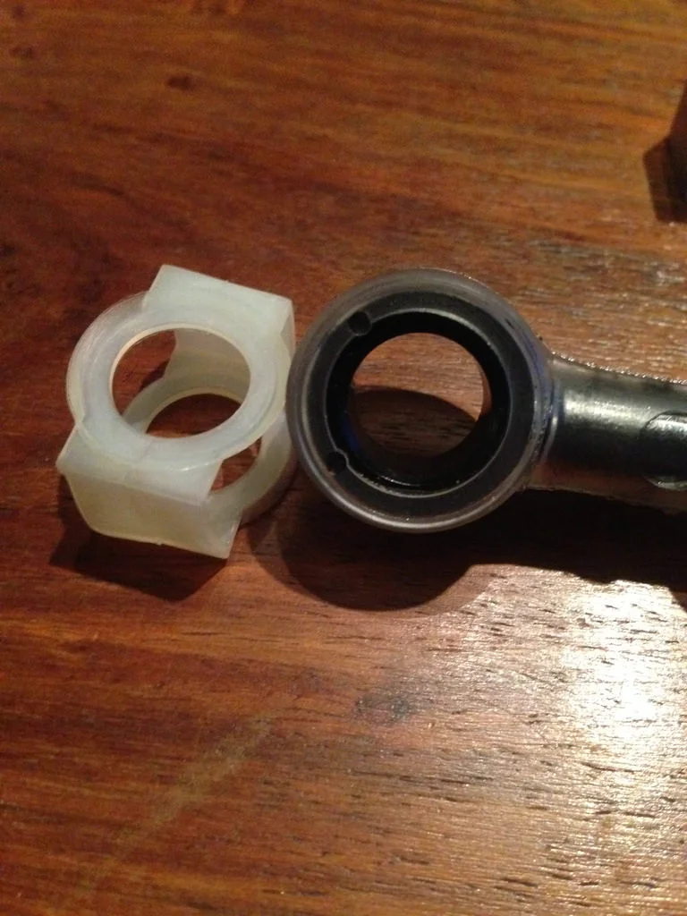

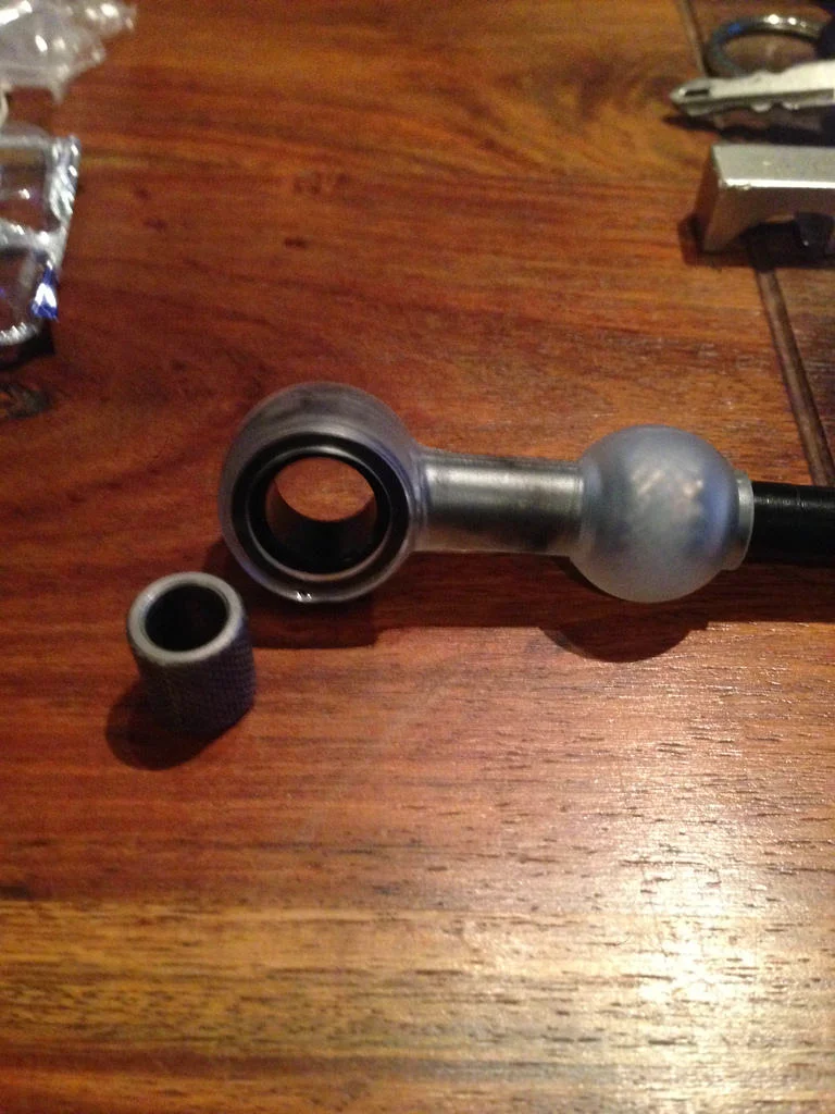

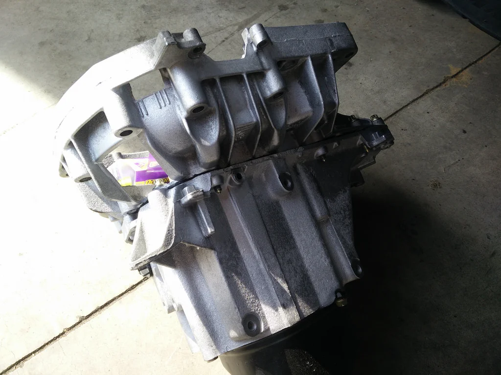

Gearbox rebuild:
Sadly, I needed to do some very expensive maintenance tot he car. The gearbox started to make noises and crunched in 3rd. It was time for a rebuild.
Box out:

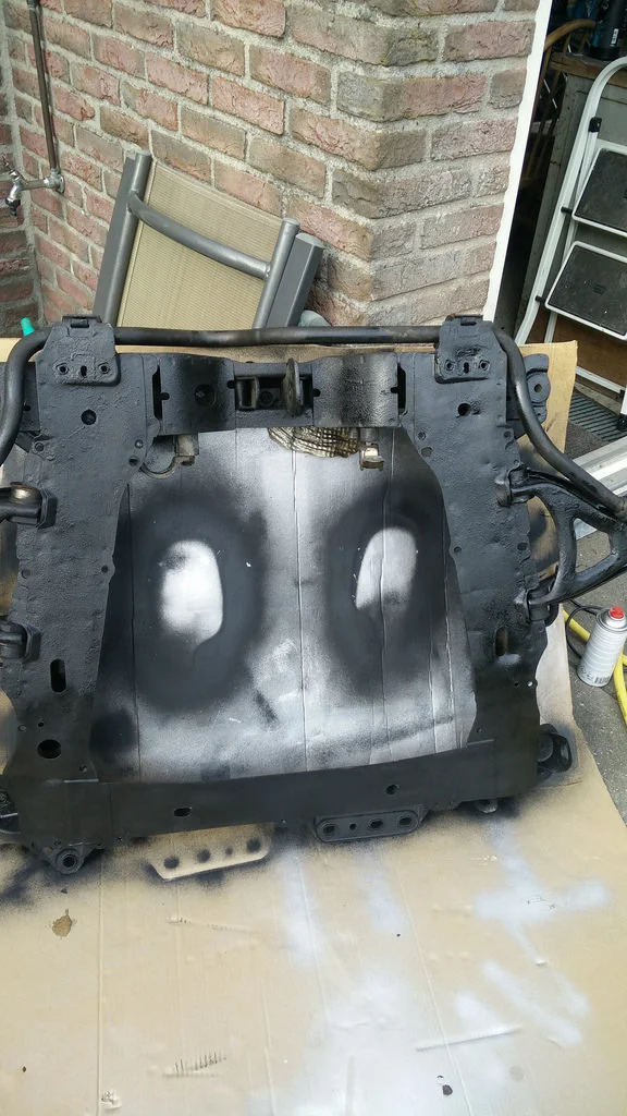

Gave the subframe some love:
Freshly rebuilt box:

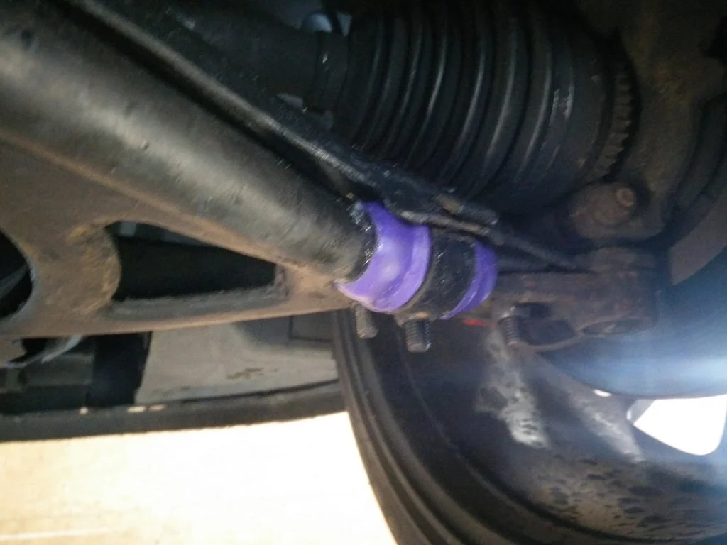

Also fitted some new rollbar bushings:

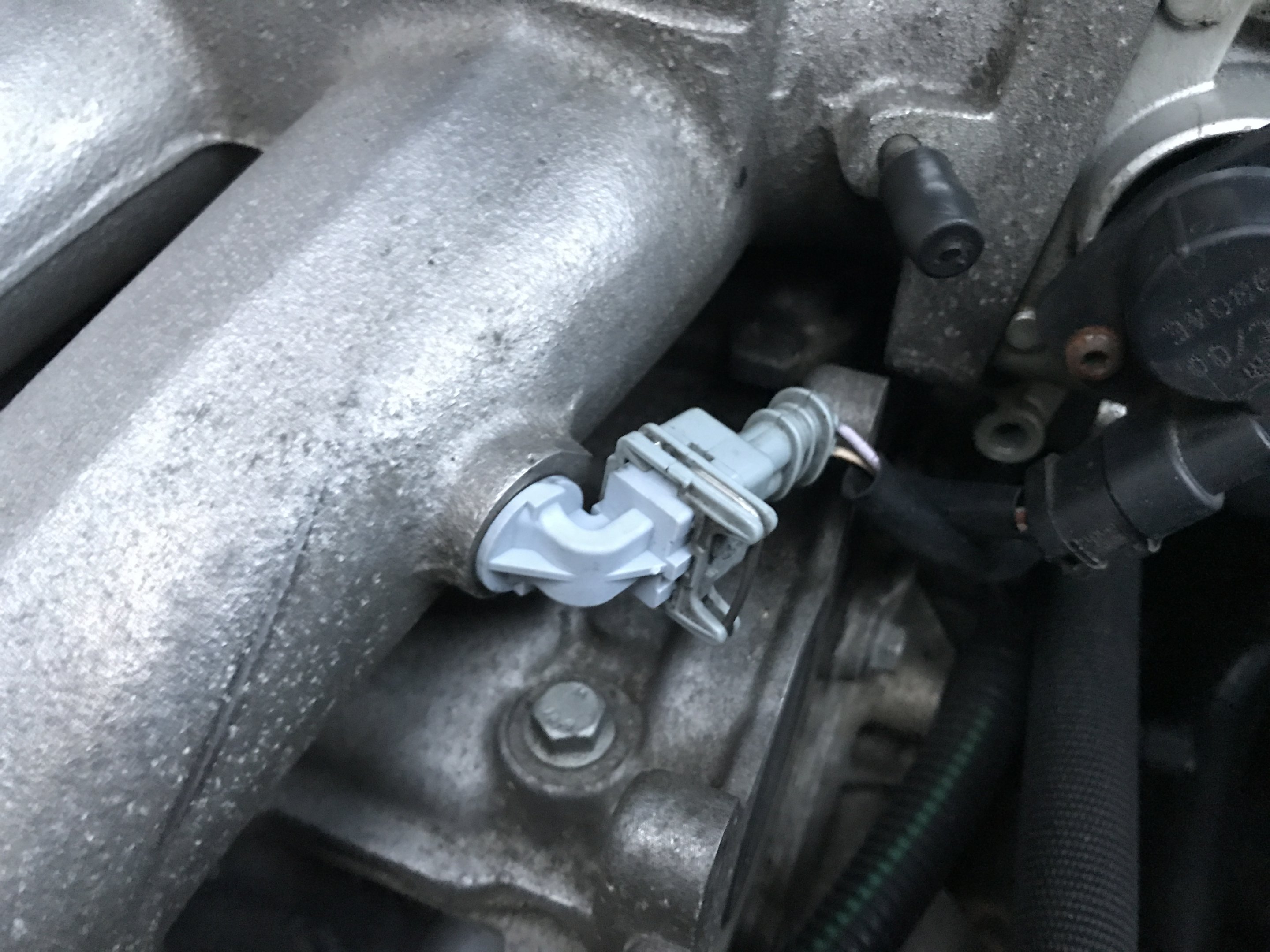

Finally installed the 182 inlet manifold I had laying around. It’s a nice and cheap mod which I recommend to every 172 owner. While i was in there I did a compression test. The results were very good :smiley:

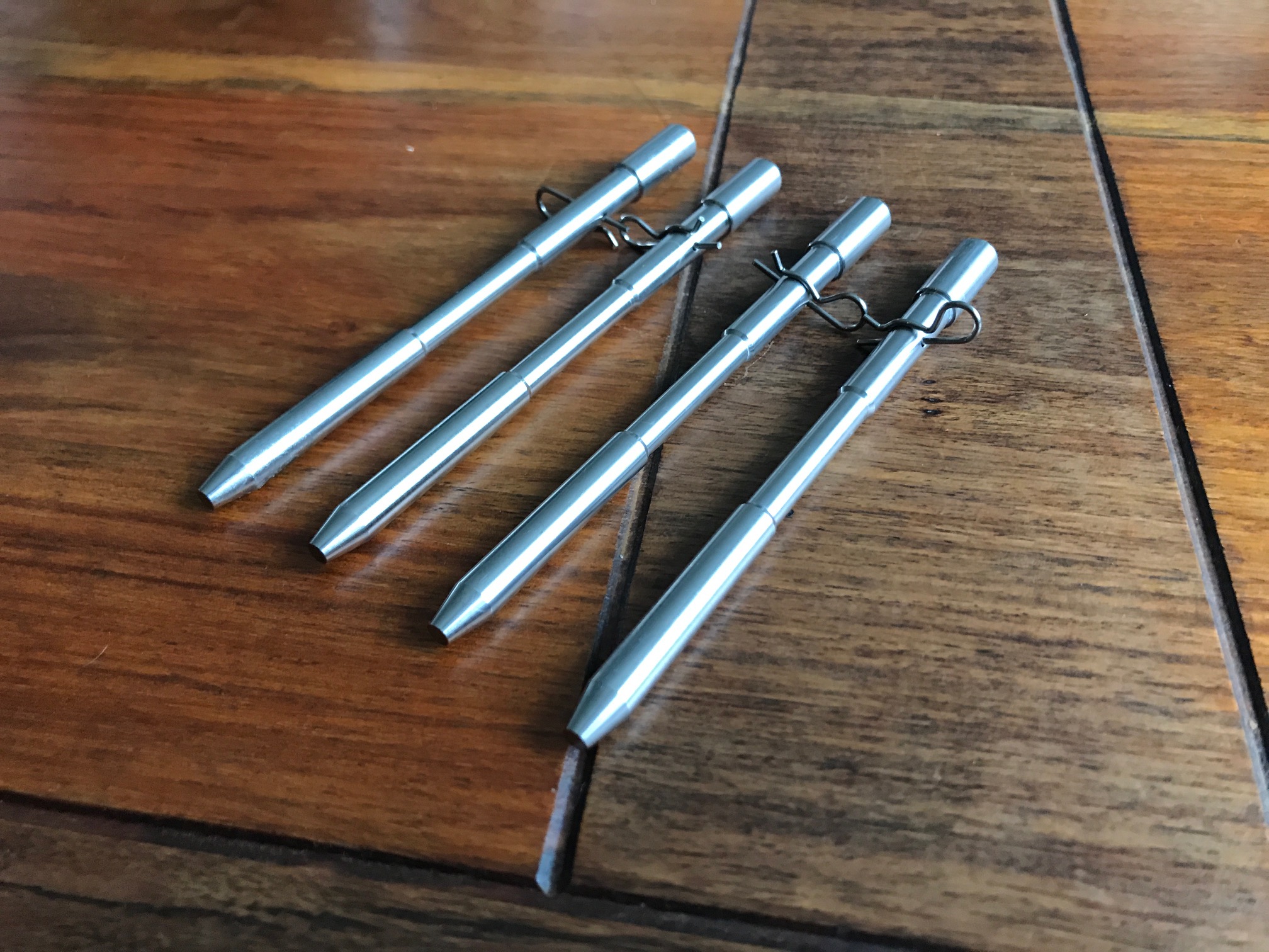

Decided to use wheel studs since it makes your life a lot easier when changing wheels.
Studs installed

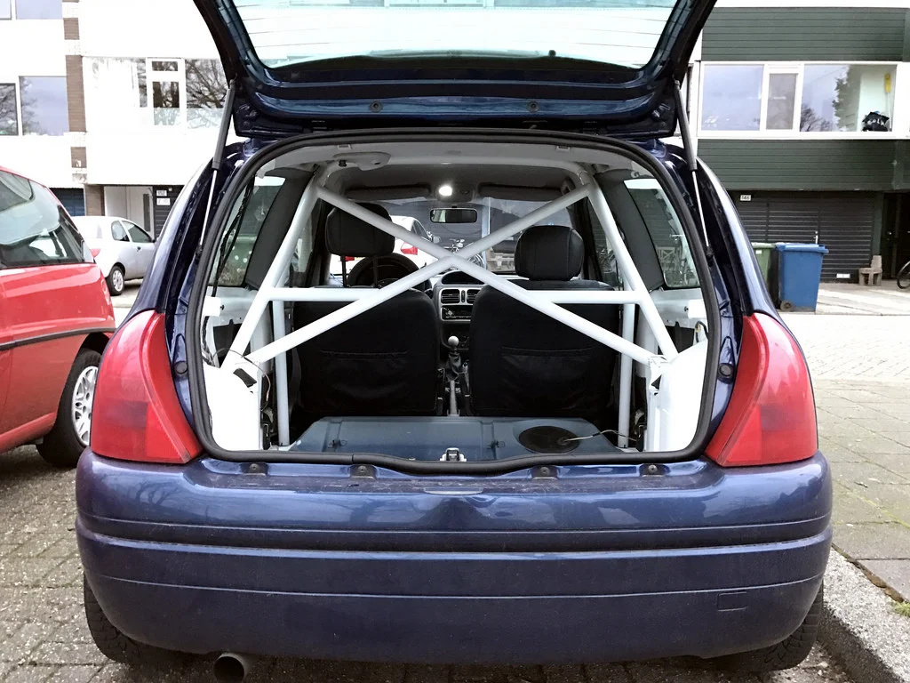

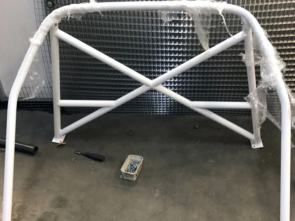

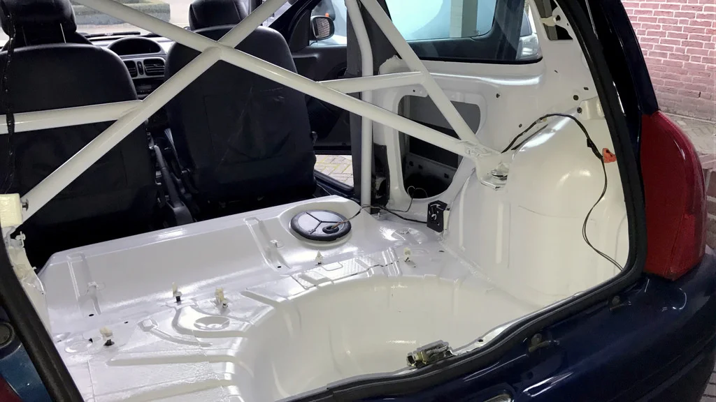

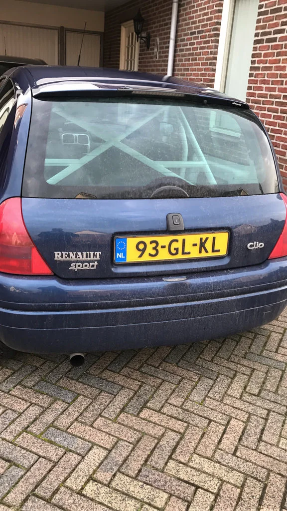

Fitted a custom made rollbar/half-cage:
Painted the rear which was a horrible job but well worth it:

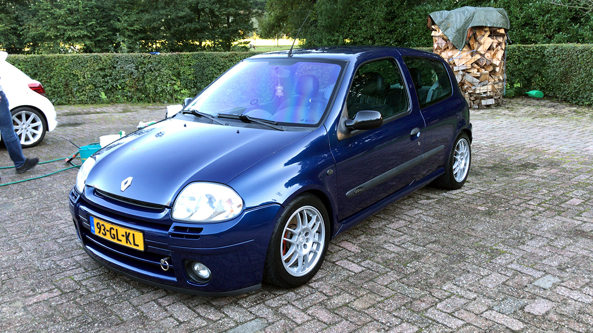

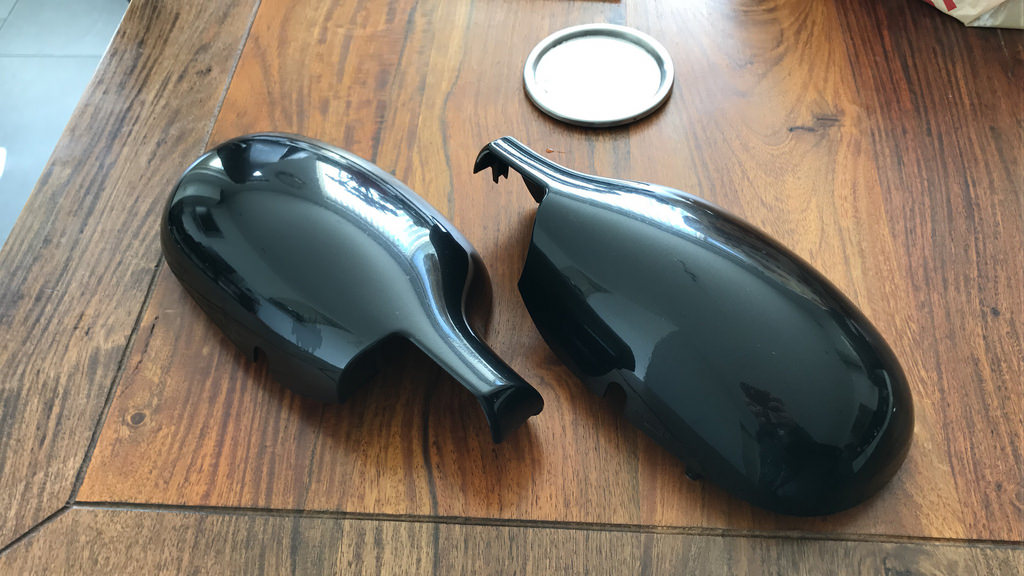

Got some black gold mirror caps/covers from the wreckers. These replace my already wrapped caps. I just think that painted ones look better. Still undecided if I want to put the ELF sticker on it. I still have two yellow ones but I also have two white ones.
Cleaned her up a bit. Put the Rota's on again.

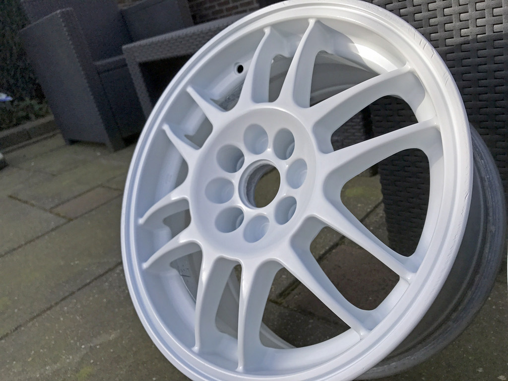

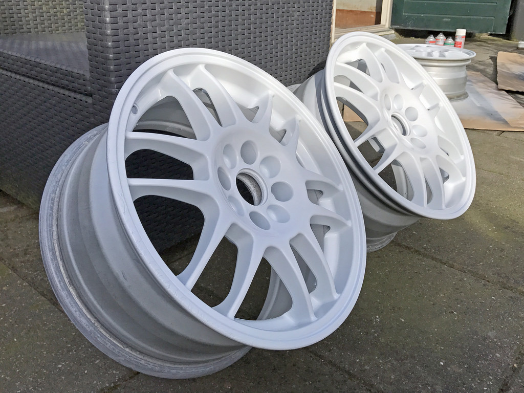

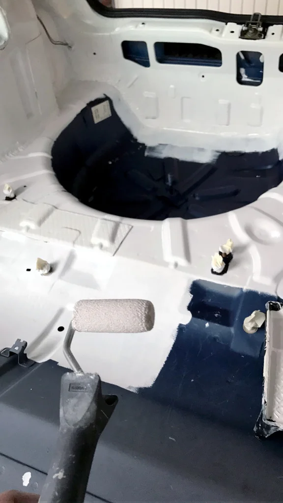

Painted my track wheels white. Didn't bother to make them 100% perfect but it turned out pretty nice anyway. I think the white wheels will work well with the blue paint.
Before:
After:
Still not sure what semi slicks to use. R888R's seem very interesting and they aren't that expensive either.

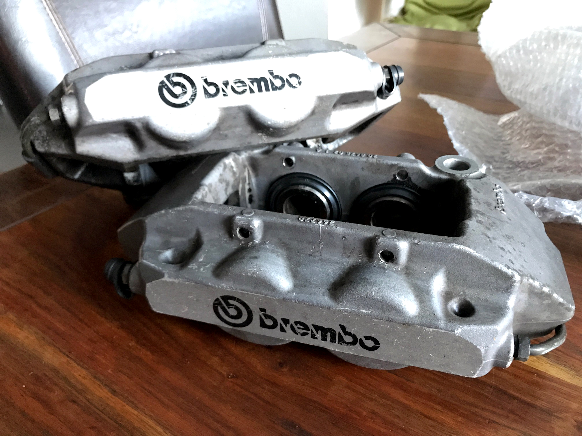

Did some trackdays with the car, felt great. Upgraded the discs and pads to Brembo HC and Carbone Lorraine RC5+ pads. I can highly recommend these. What a fantastic compound.

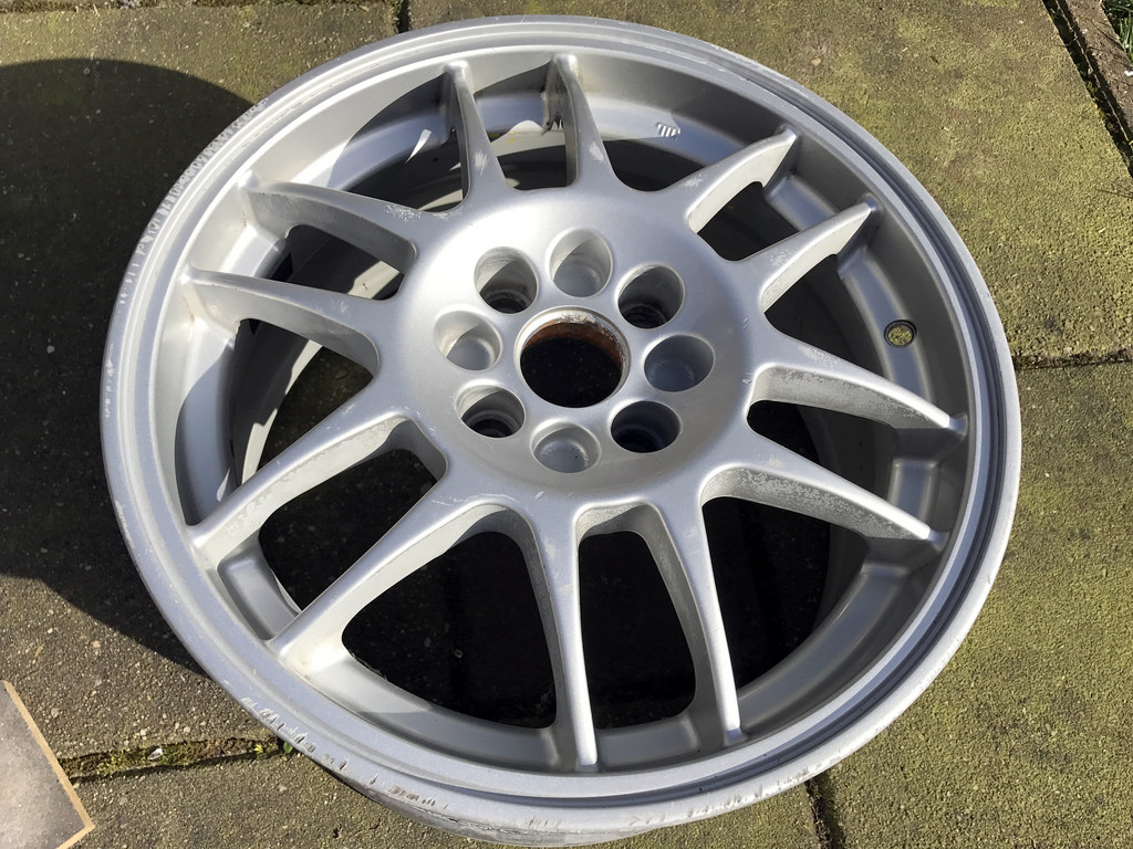

I sold the white OZ F1 wheels and got some originals. Also sold the 16" Rota's. Wrapped the "new" f1's in Federal 595rsr.

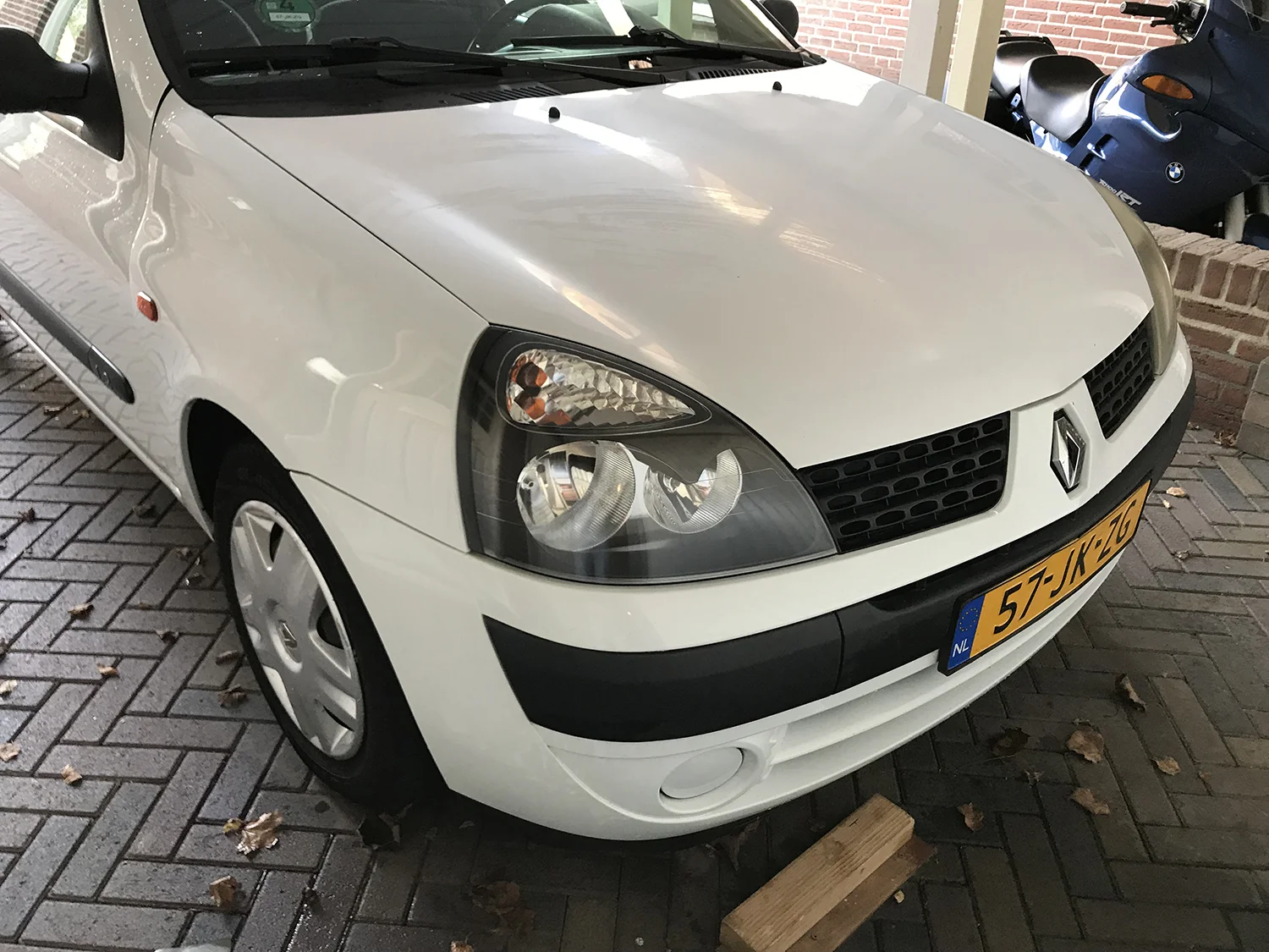

In other news, I picked up my "new" 1.2 for this winter:
I polished the headlights, but that's about all the love she'll get:

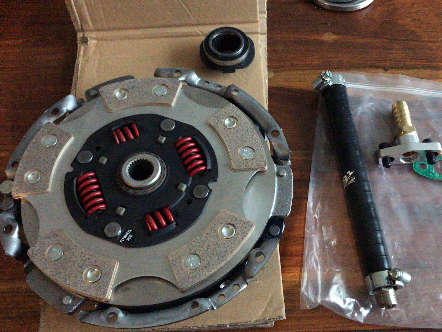

Now back to the ph1, I received my uprated clutch from Engine Dynamics. Also ordered the oil return kit so i can fabricate some sort of plug since I want to drill and tap the oil return feed while the engine is out.
The clutch looks like a decent bit of kit. Very excited to get started...

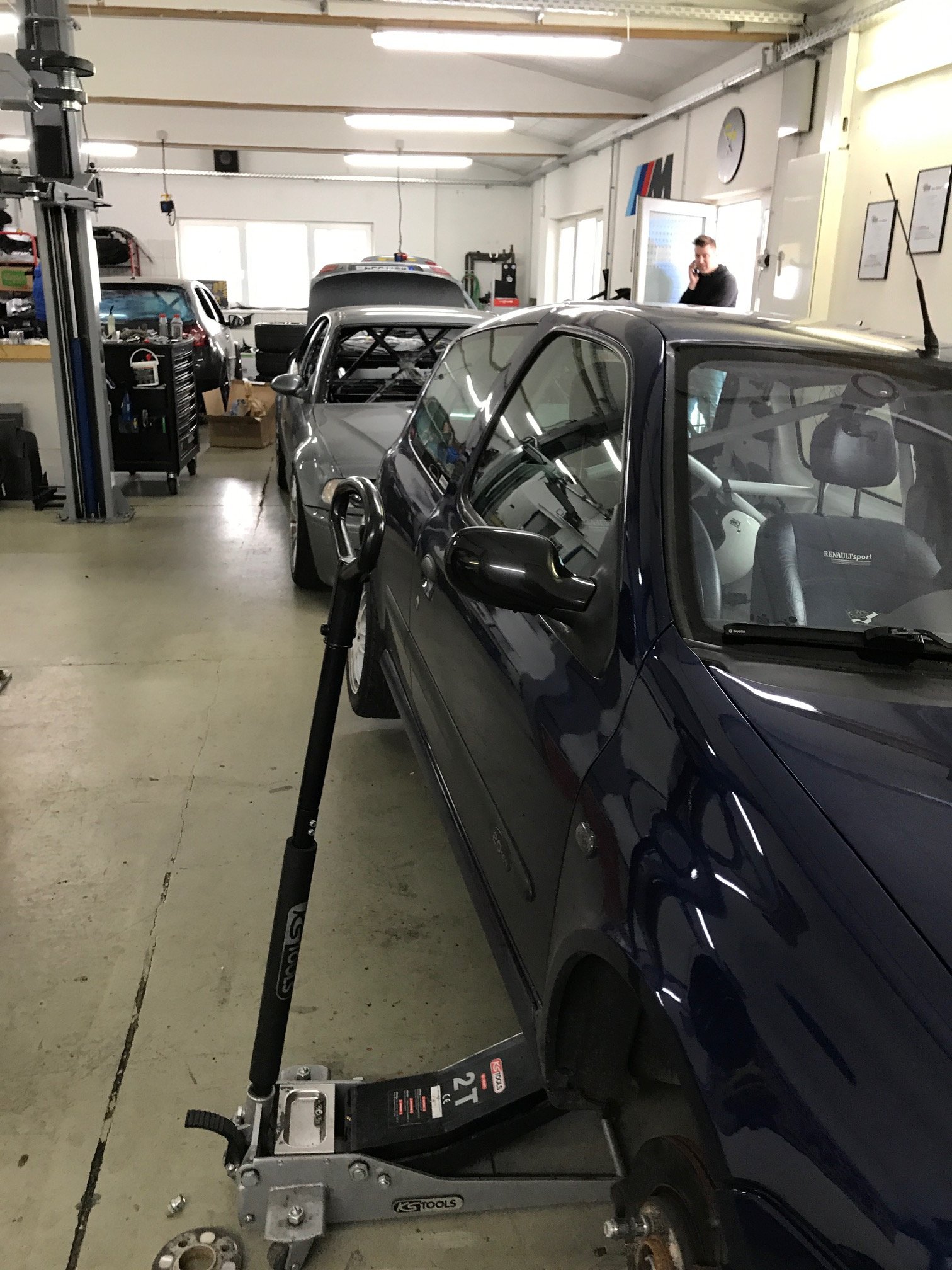

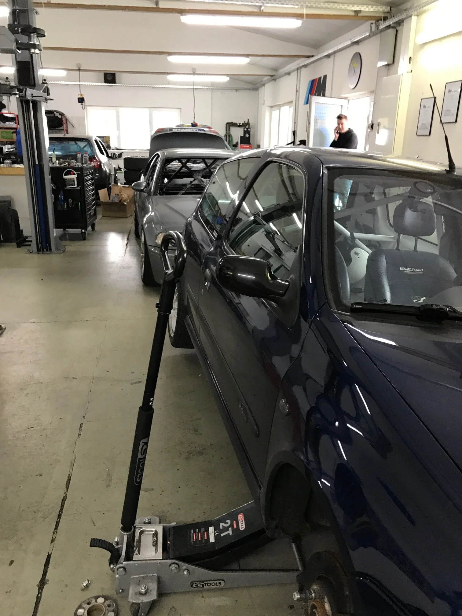

A while back my mates and I were going to the Nürburgring for three days. We decided to stay at Hotel Rieder, which is a fantastic hotel. After unloading all of the stuff we went to do some laps on the Ring. All was fine until I noticed a slight noise coming from the front left side. As my arch liner has some rubbing issues, I thought it was just a piece of plastic that would eventualy fall off. I decided to go for another lap. The noise was still there but I didn't notice anything wrong with the car. Everything felt great!

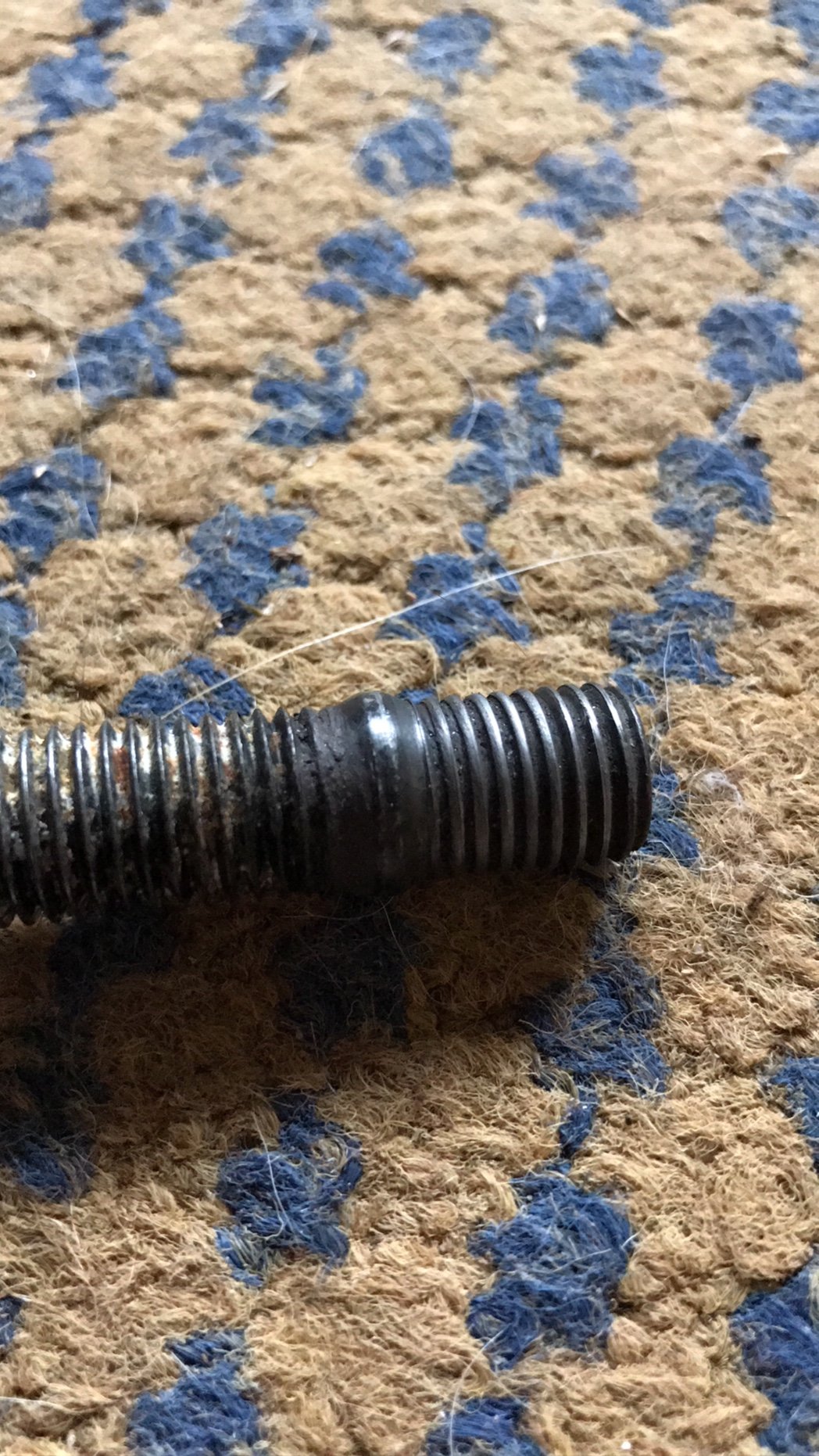

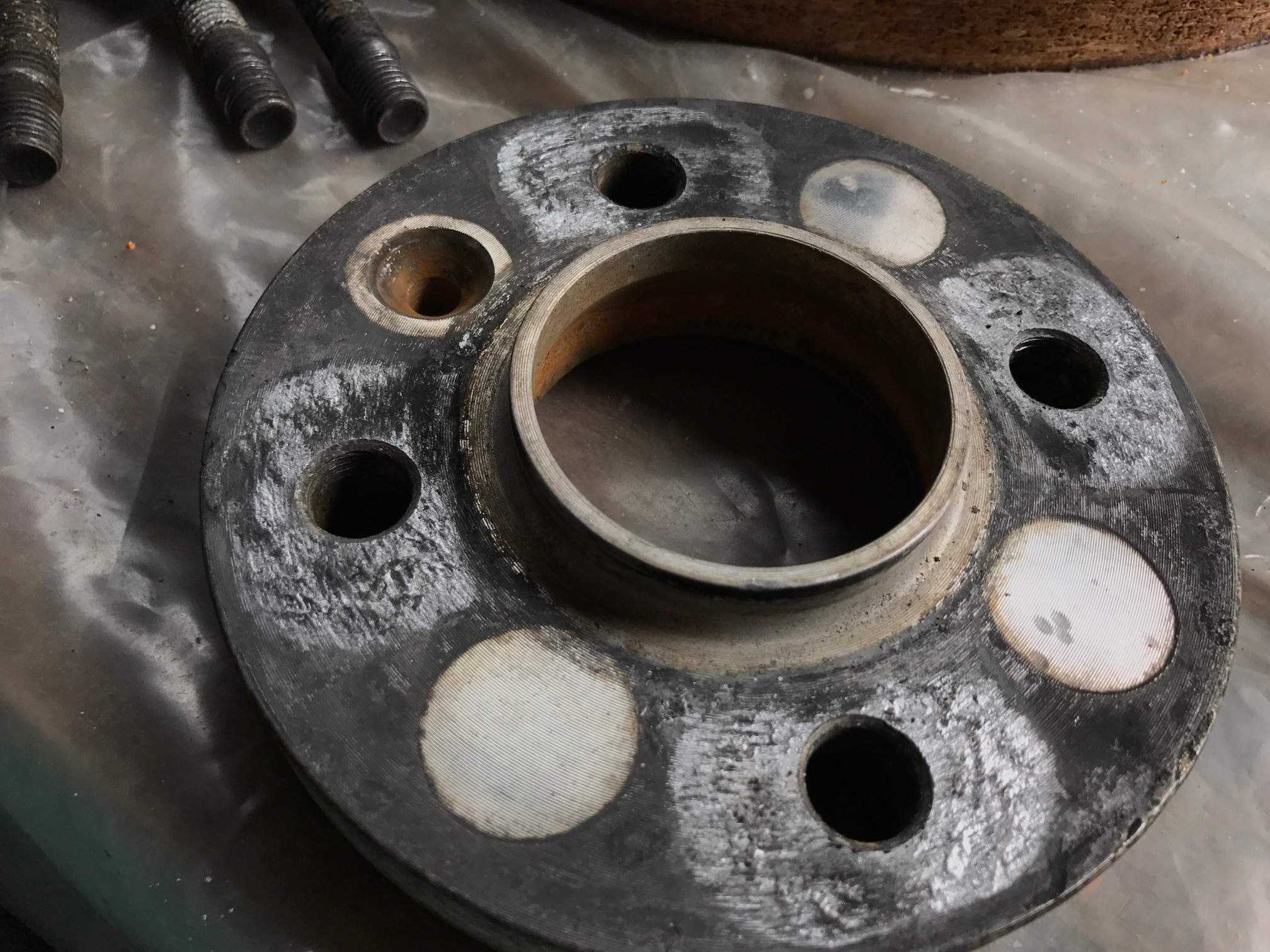

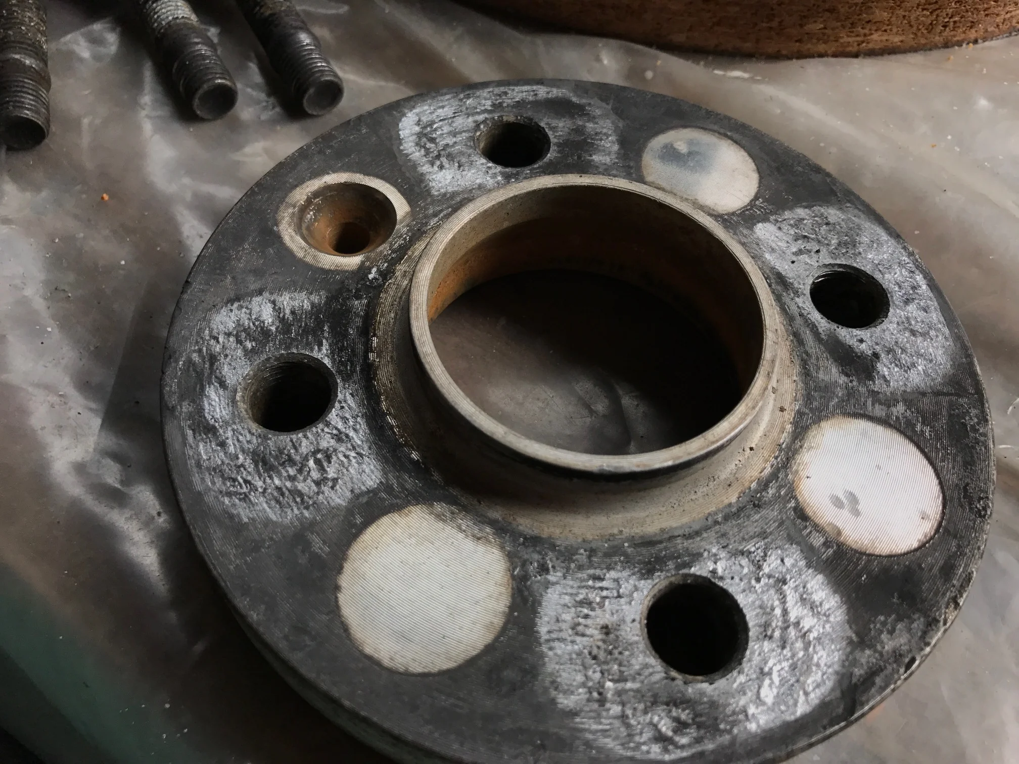

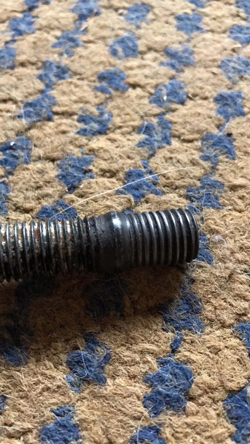

Eventually I decided to have a look and noticed that some of the the studs (did the conversion a while back) had come loose. I could undo two by hand! Not ideal, to say the least. I baby'd the car to the hotel and we decided to try and fix it. I brought some basic tools and a friend of mine luckily brought spare wheel bolts. He only brought regular bolts that wouldnt fit when a spacer was installed. Also, there were still two studs in the hub that didn't budge. Ofcourse I didn't bring the right tools with me so I was stuck. F*ck.
At our hotel there were some lads from the UK with RX7's. I'm not really the person to walk up to a stranger and ask them for anything, but I didn't really have a choice. Luckily they were very nice and after some hate on Clio drivers they gave me some tools to sort my mess out. I managed to remove the two other studs, remove the spacer and bolt the wheel on with my mates wheel bolts. All was fine for the left side. But what about the right side? I didn't want to run the studs on the front anymore since I couldn't trust them. I wanted them out! But since the spacer needed to be removed first, I was stuck again. The little bolt holding the spacer on wouldn't budge. We tried almost everything, but we also had to be carefull not to strip it. There was no way we could remove the studs with the spacer on since my mate had only brought the OEM short bolts. I had no choice other than to leave the studs and spacer on the right side in place.
Me being the stupid pr*ck that I am, I wasn't going to just sit around the ring. I wanted to drive!. Keeping a close eye to the studs on the right I did a few laps but decided it wasn't worth it. The car pulled a little (lol) when braking because only one spacer was fitted but other than that it felt fine. When I look back on it now it was a very stupid and possibly dangerous thing to do.
Of course I still wanted to properly solve the situation by removing the spacer and studs from the right side because I wanted to lap the car on sunday too! On saturday afternoon, when hanging out at Adenauer Forst, I met some crazy drunk Germans. We started talking and I explained that I was having some issues. Luckily they knew a place not too far from the Ring. They called the shop's owner for me and made sure I could visit the next day. The name of the shop is Custom Racetec. On sunday morning I drove over there. He had the spacer and studs off in around 10 minutes lol. The guy even fixed my slightly sagging exhaust. I paid the guy and left. I think I did around 5/6 laps after that. The car felt fantastic.
You truly meet the most amazing people around the Nürburgring. People are allways willing to help eachother out. You just have to ask! Language, culture, colour; None of it matters when you share the same passion.

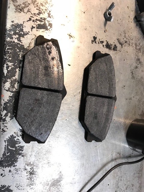

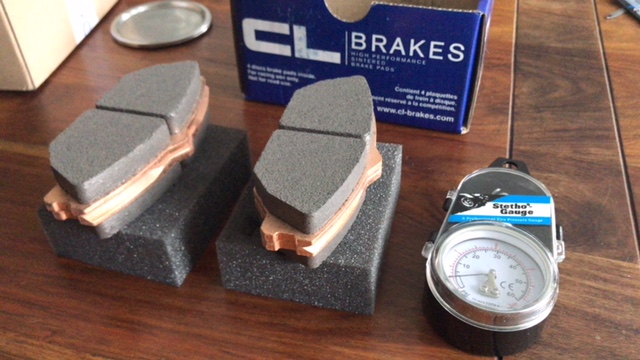

My brake pads felt kinda bad so I decided to get some new ones. Good think I replaced them as the old ones started to fall apart :/ In their defence, they have been through a lot of heat cycles.
These Carbone Lorraine RC6 pads replace my RC5+ front pads. I was really happy with my old CL pads so I decided not to get the DS2500's like most do.
These are even more agressive than the RC5+ pads.
The box says "Not for road use", which means it must be good, right?
Also bought a tyre pressure guage.

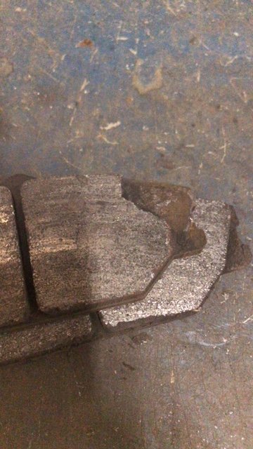

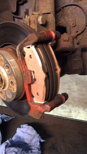

Left side pads were not looking to good...
Right seemed relatively fine but also started to crumble.
New shiny brake pads installed
After bedding them in they felt great. They brake so hard that you feel your face moving forwards lol. Sadly, no track testing until next year...

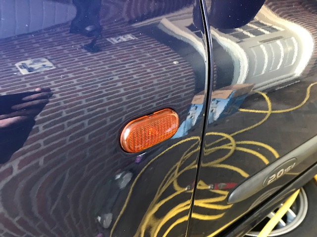

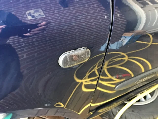

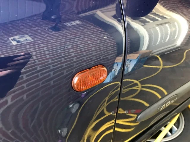

First changed the smoked side blinkers to oem orange.

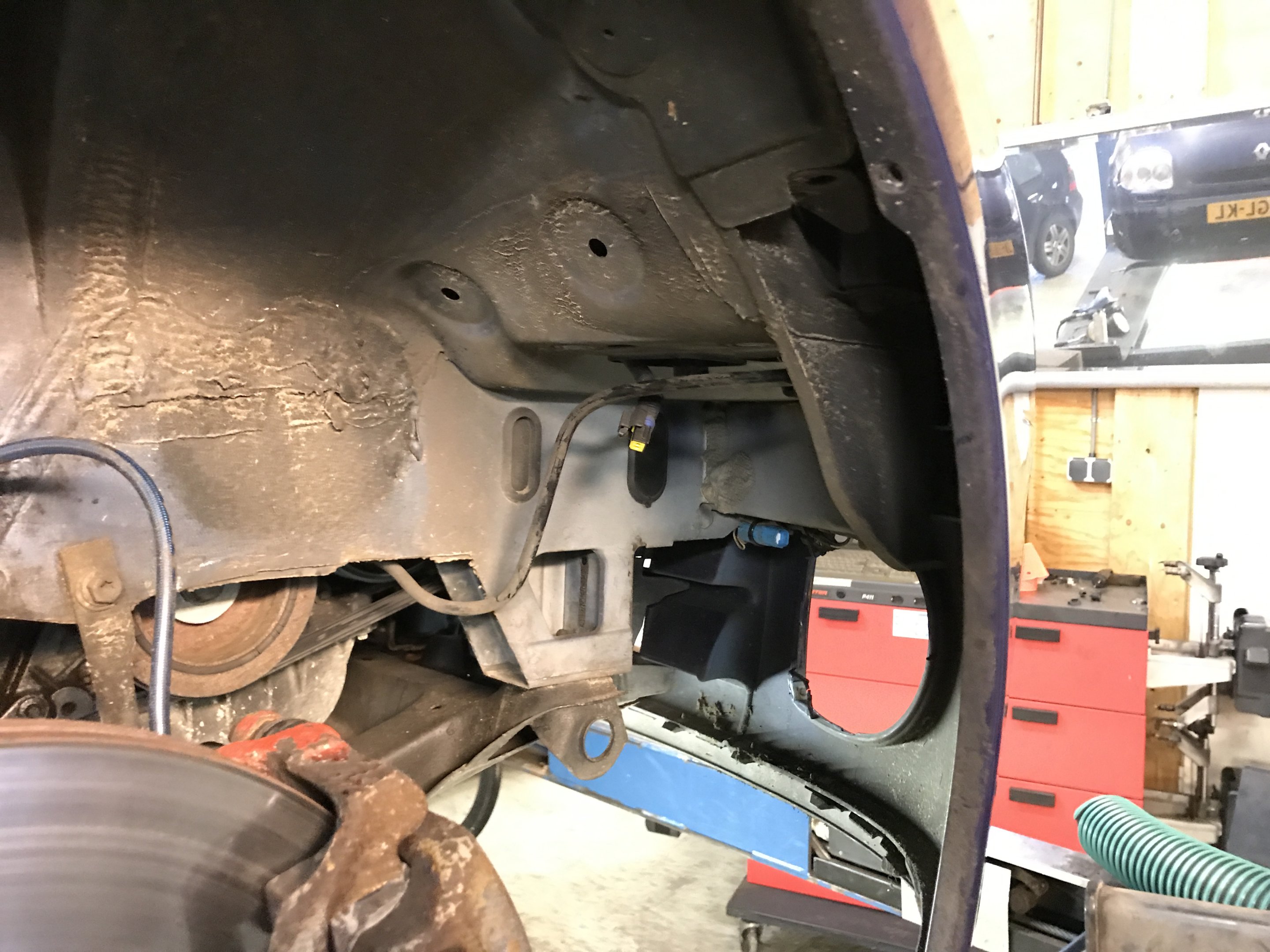

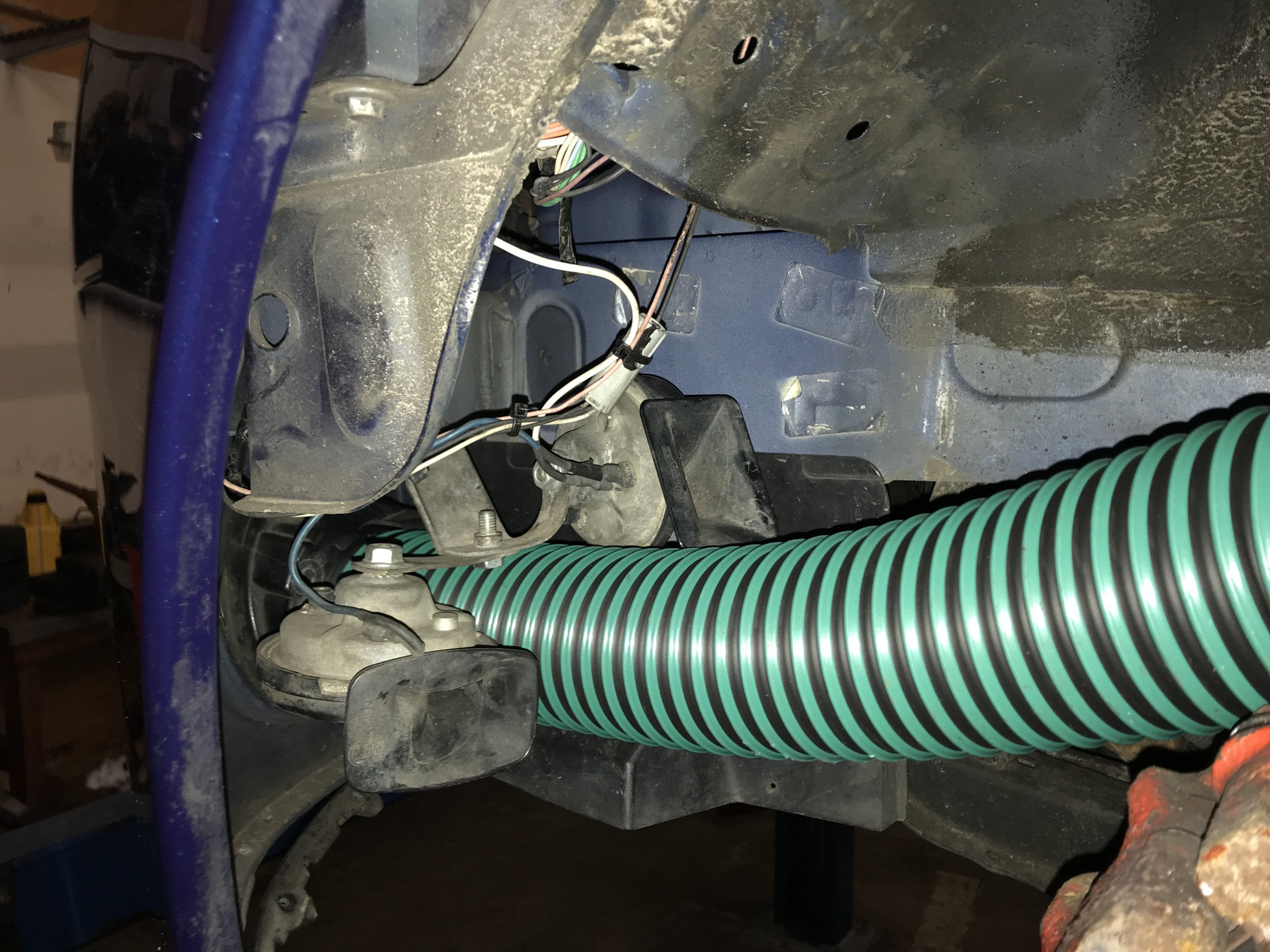

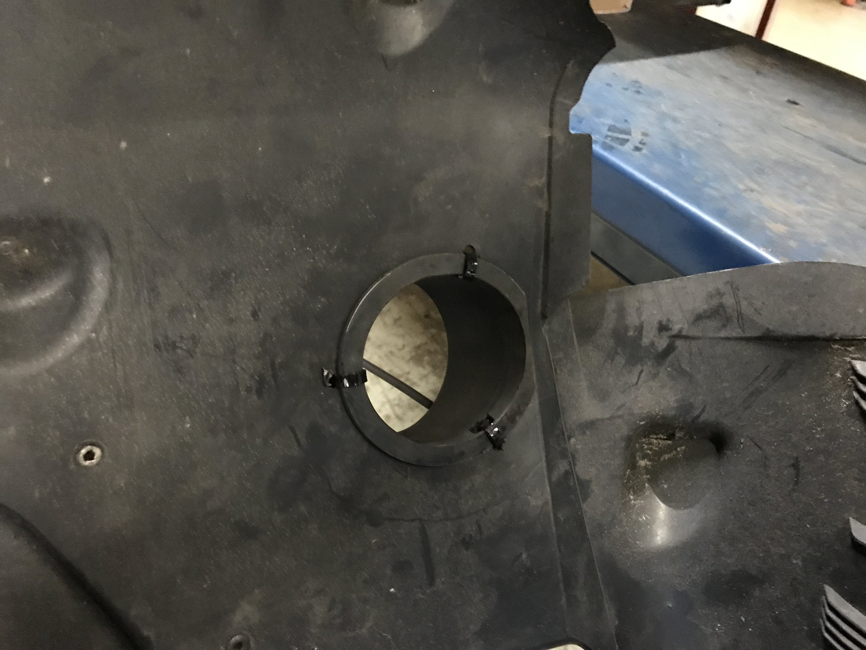

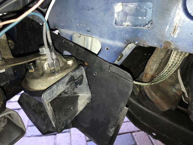

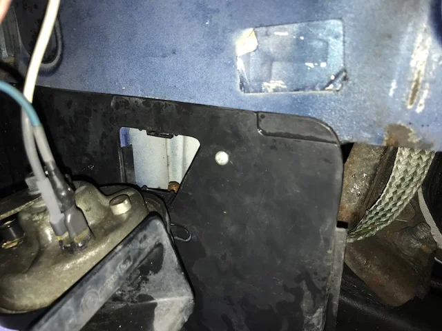

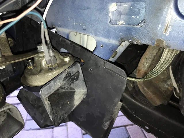

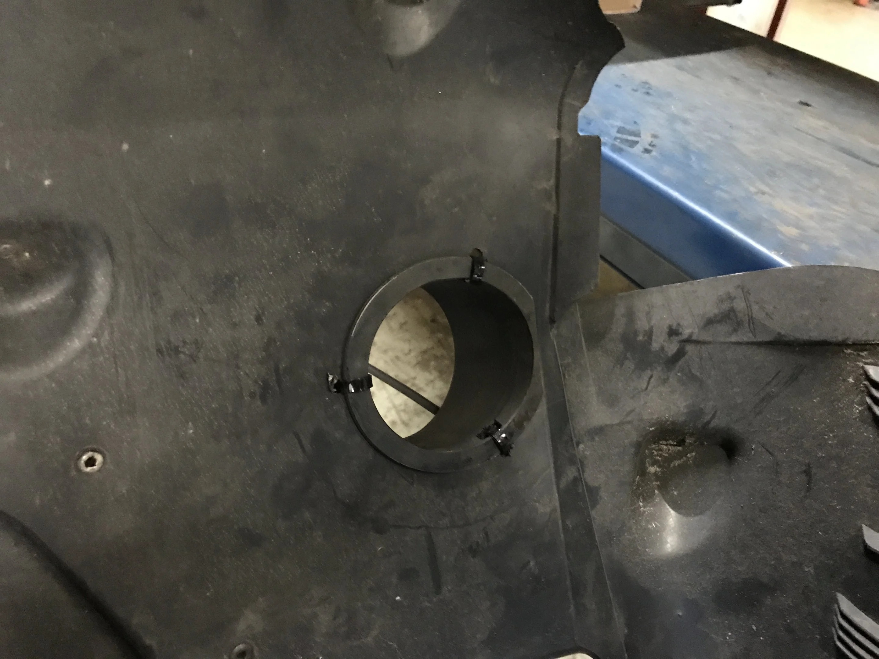

Decided to clean the front arches as it was quite dirty. Saw this stupid plastic guard thing flapping around again. It always comes loose for some reason. I was fed up with it so decided to drill a hole and screw it in. It's not going anywhere:

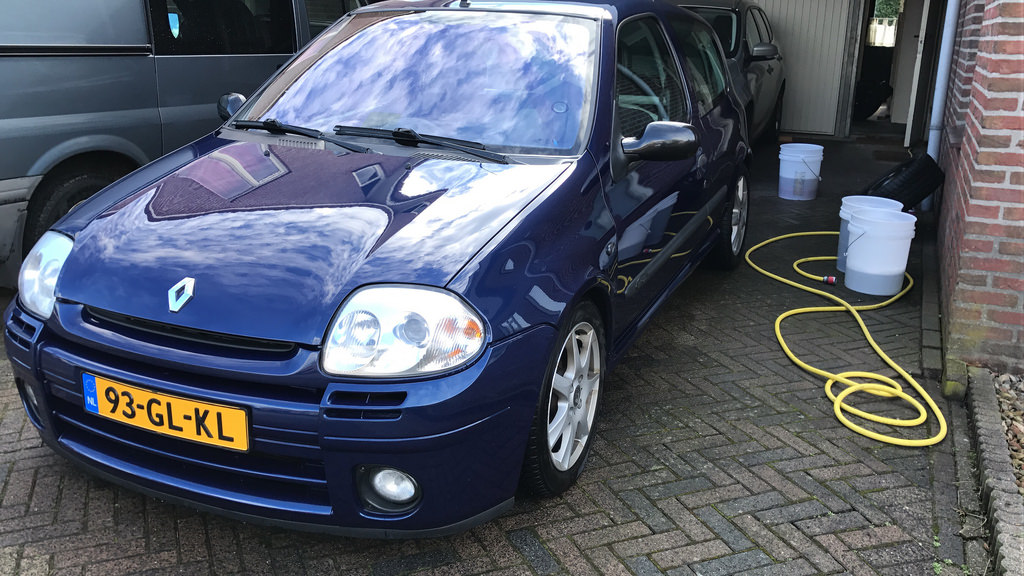

Then I proceeded to clean the entire car, but ofc it started to rain when I was done. The only upside to this is that I didn't need to dry it off. :/

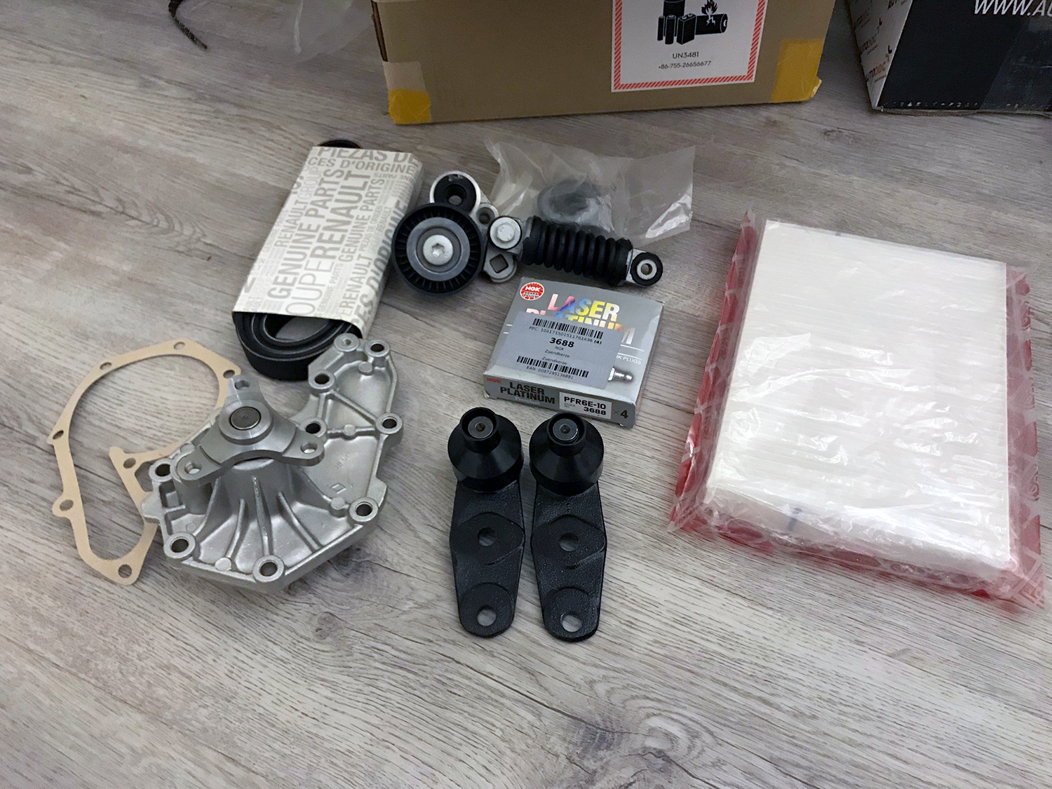

I've been slowly gathering a few parts, these came in recently.
CUP wishbones with PowerFlex BLACK series bushings from a member on here. They will need some love though. Interested to see what the added castor does for me.
And some other various parts:
Aux belt kit (New from a member of this forum)
New spark plugs
New Valeo waterpump
New balljoints
New interior ac filter
On top of those I have found and received a few new centre caps for my OZ f1 wheels. The centre caps are becoming quite rare as they often break so I thought I'd just get them before anyone else does.

The only "turbo" bits I've already bought is the 5 puck clutch, but that could be used for a ITB kit too, and a oil return kit from Engine Dynamics.

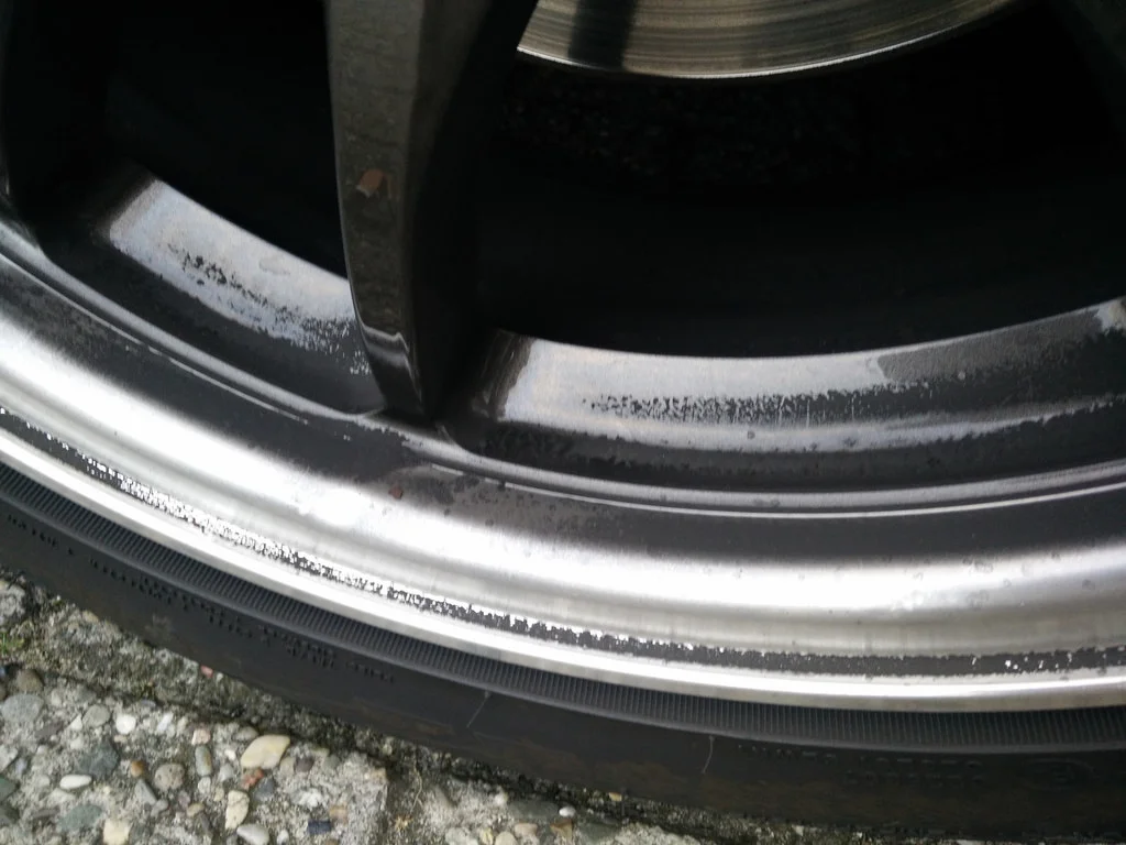

Really loved the feel of those CL RC6 pads on track, but I think I might have boiled my brake fluid. The brake pedal feels kinda squishy on my way home so it will need a full flush again. Going with ATE Type 200 this time.
Other than that the car felt great, can't fault it on much really. Could do with new suspension and brake cooling. And more power.

I've never thought brake fluid would turn to shite this quick during trackday, as it's quite new. Probably down to those CL RC6 pads creating a lot of heat. Will look into brake cooling asap...

Not sure, bad rebuild, lack of mechanical sympathy from my end or just bad luck.
The company who performed the rebuild only rebuilt mine because of the issues I had with their JC5-129 box. They had a JC5-129 for sale which I bought since they had rebuilt that one. I traded in mine (JC5-089) as you usually do. The 129 turned out to be shite as I couldnt properly get it into 2nd gear and I could hear a faint whine coming from it. After talking to the company who sold me the box they suggested to rebuild my old 089 and swap them over. I think they just cheaped out on the rebuild and only replaced a few synchro's.
A year later the box started to pop out of 3rd gear and crunch when going from 2nd to 3rd and from 3rd to 4th.
Luckily I already have a replacement box in the garage. And another one in my storage unit.

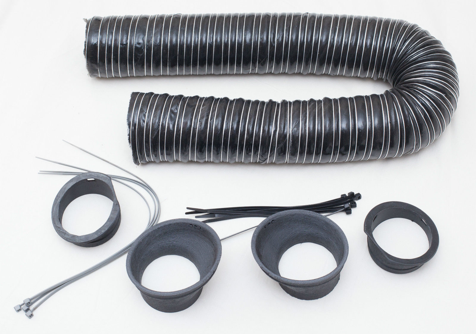

Ordered a brake cooling kit from eBay. The price was a bit high but it's a nice bit of kit. Includes everything you need and has good fitment. Only need to fabricate some sort of deflector plate. Might do it out of some kind of heatshield.

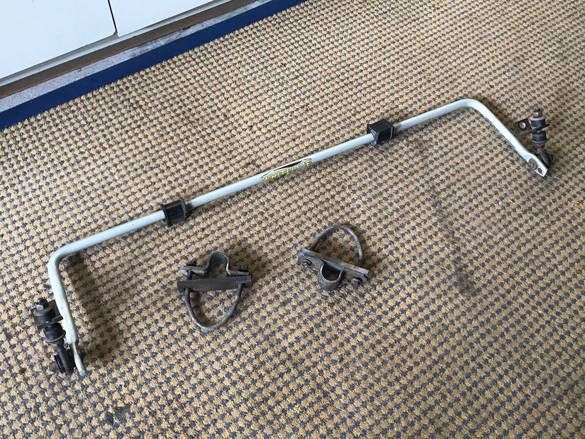

Also found a Whiteline RARB for sale for only 65 pounds. Jumped on it and got it delivered. I believe its the older version but for that money I can't complain. I installed it and the difference is noticable. It's still on the softest setting but it's too cold/wet for a proper drive anyway. (pic below on hard settings but changed that obviouslly)

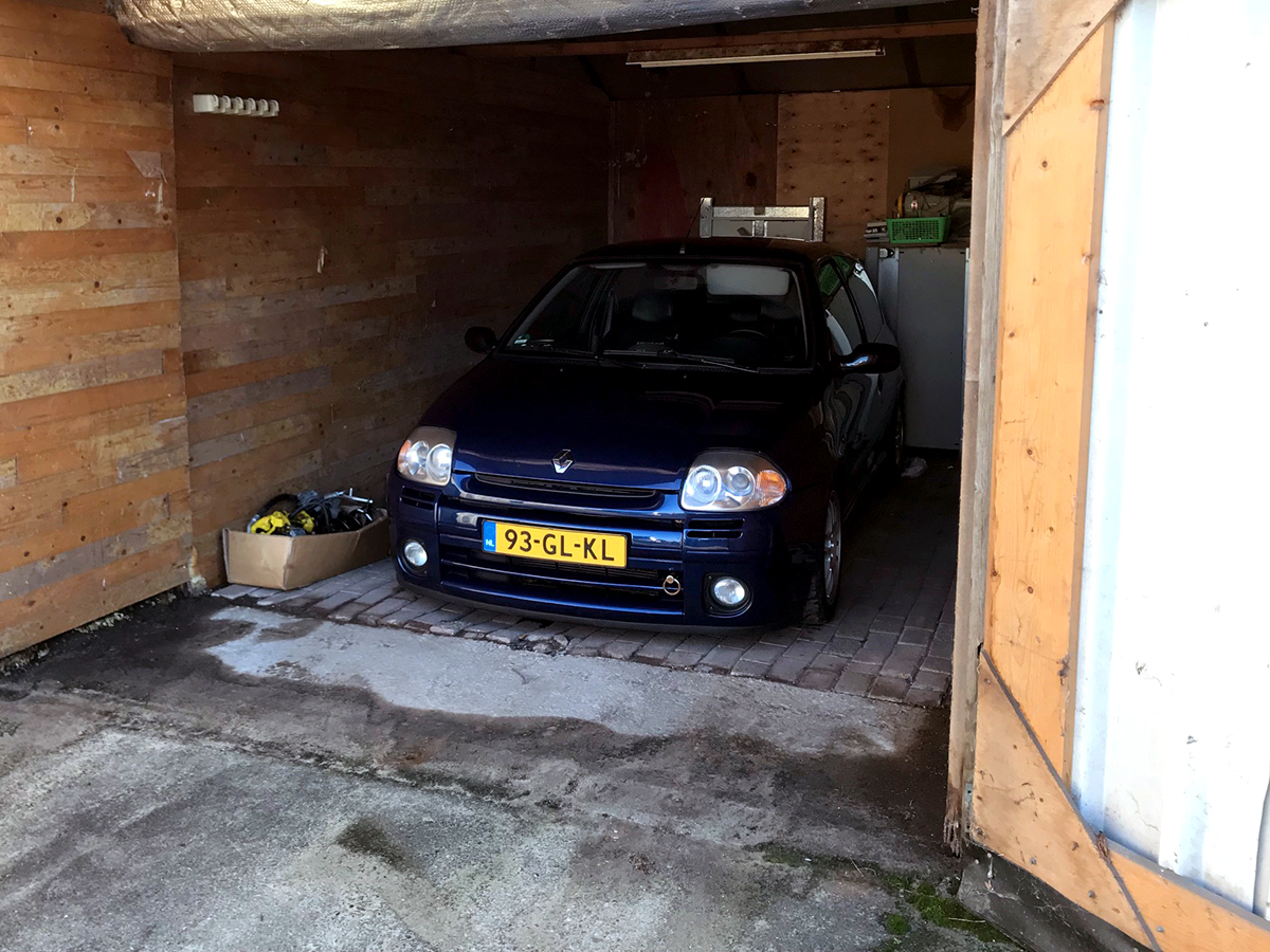

The car was in storage and I only took it out to install the Whiteline RARB. Gave the car a good clean and put it back into storage. Will start serious work on it in the beginning of february. The engine should be out on the 3rd.
Due to other costly things the turbokit will probably be pushed to somewhere in april/may. Car will be properly prepared for it anyway so should all be a bolt-on job.
Also thinking of geting the BC racing DR coilovers which are currently on sale at KAMracing. Probably 8/8kg springrates.

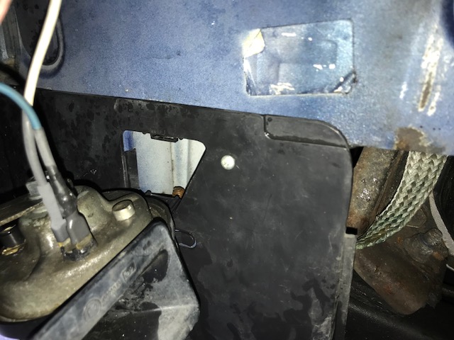

Decided to get the car out and install the brake cooling. I talked about this previously. Hopefully it will help, but I still need to make some kind of deflector plate.
Installing the cooling was relatively easy. The horns could be bent out of the way so the left side was done quite quickly. The right side is where the carbon cannister lives. I tried routing the hose around it but eventually gave up. Decided to get rid of the carbon cannister :) It's quite easy to do but still have got to finish it up. I wasn't planning on removing the cannister so I didn't buy a 22/23 ohm resistor. Also didn't have a one way valve for the tank breather to go to. For now its just venting in the wheel arch. Plugged the engine side off with a sillicone cap, which works great.

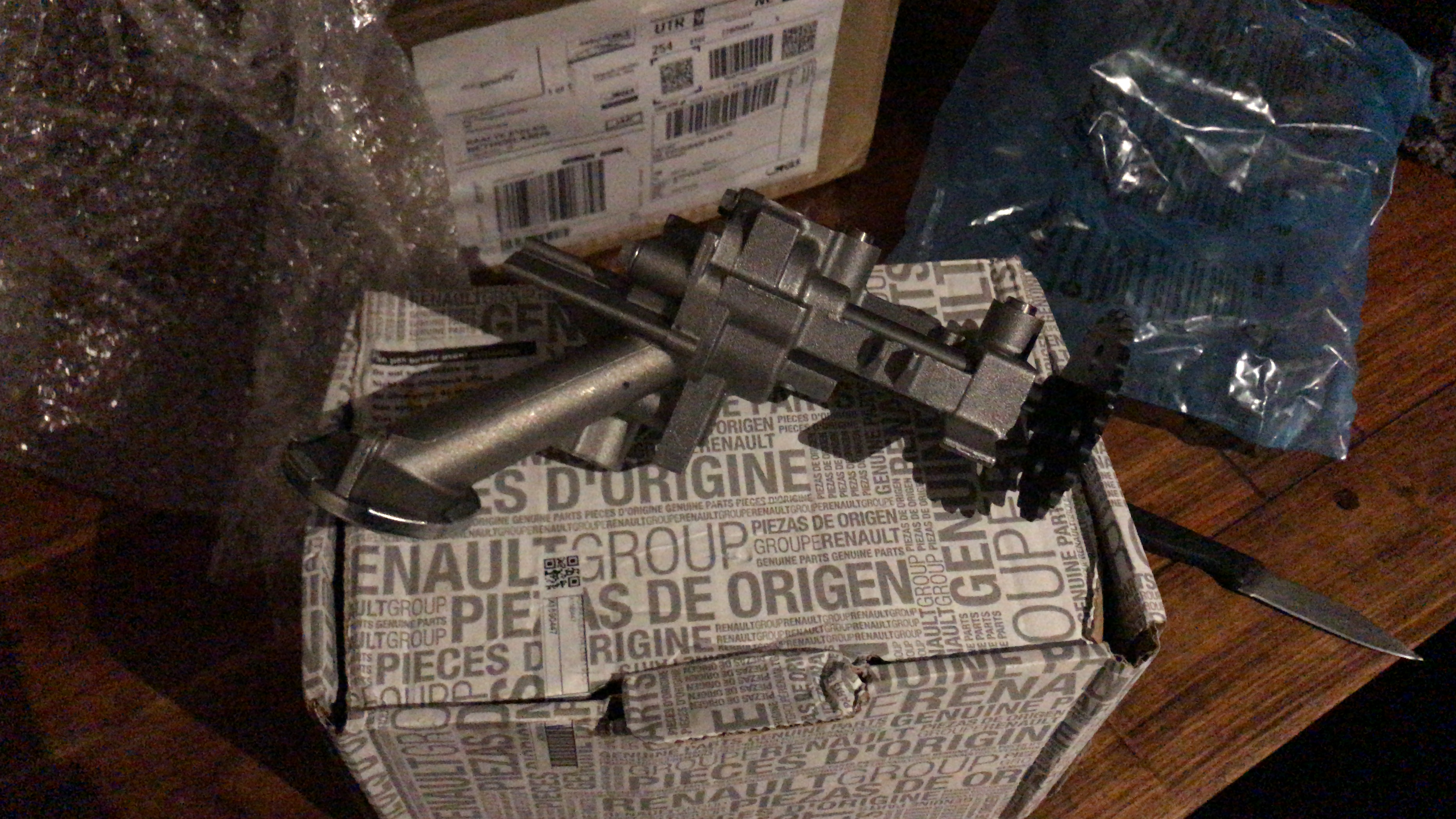

Received a new oil pump, which will be added to the pile of new parts for the rebuild.

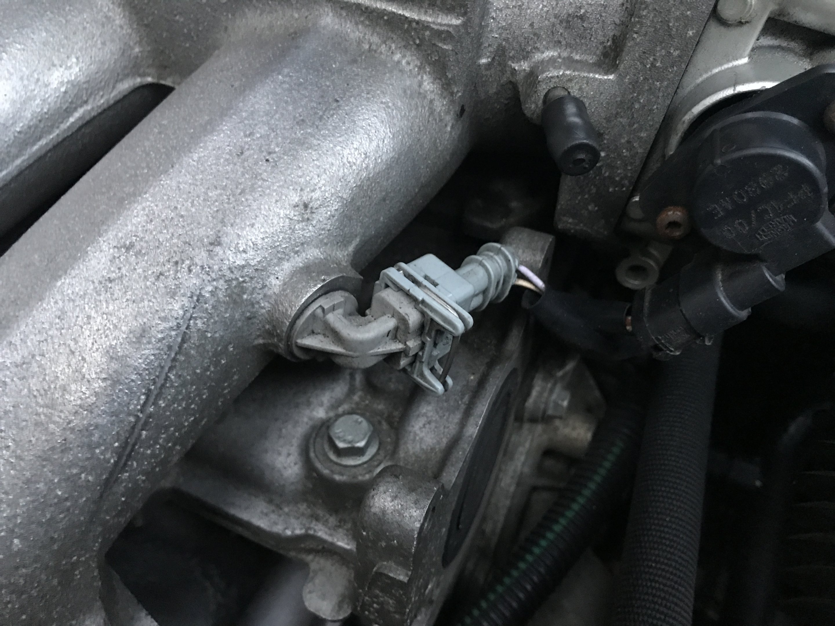

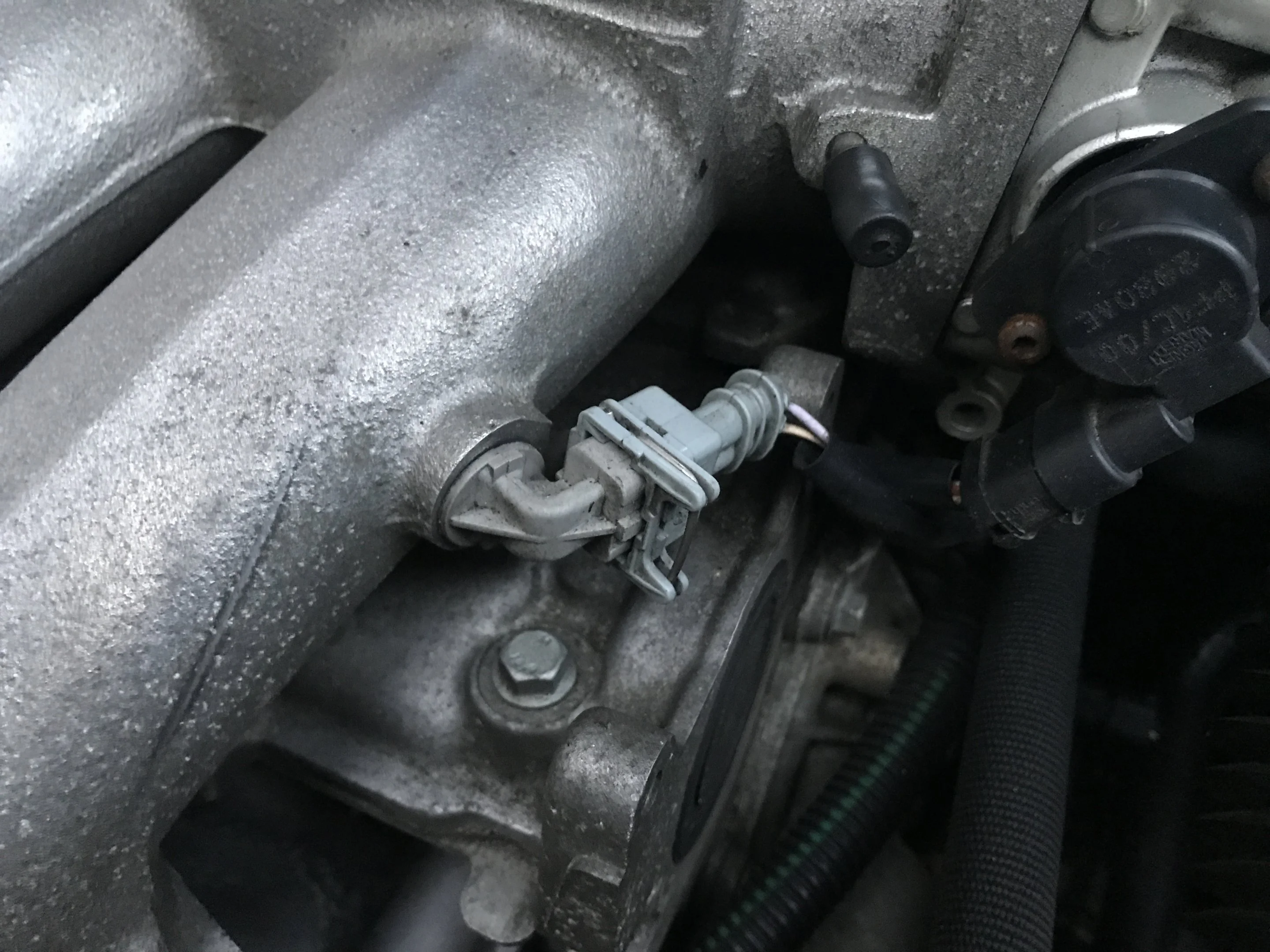

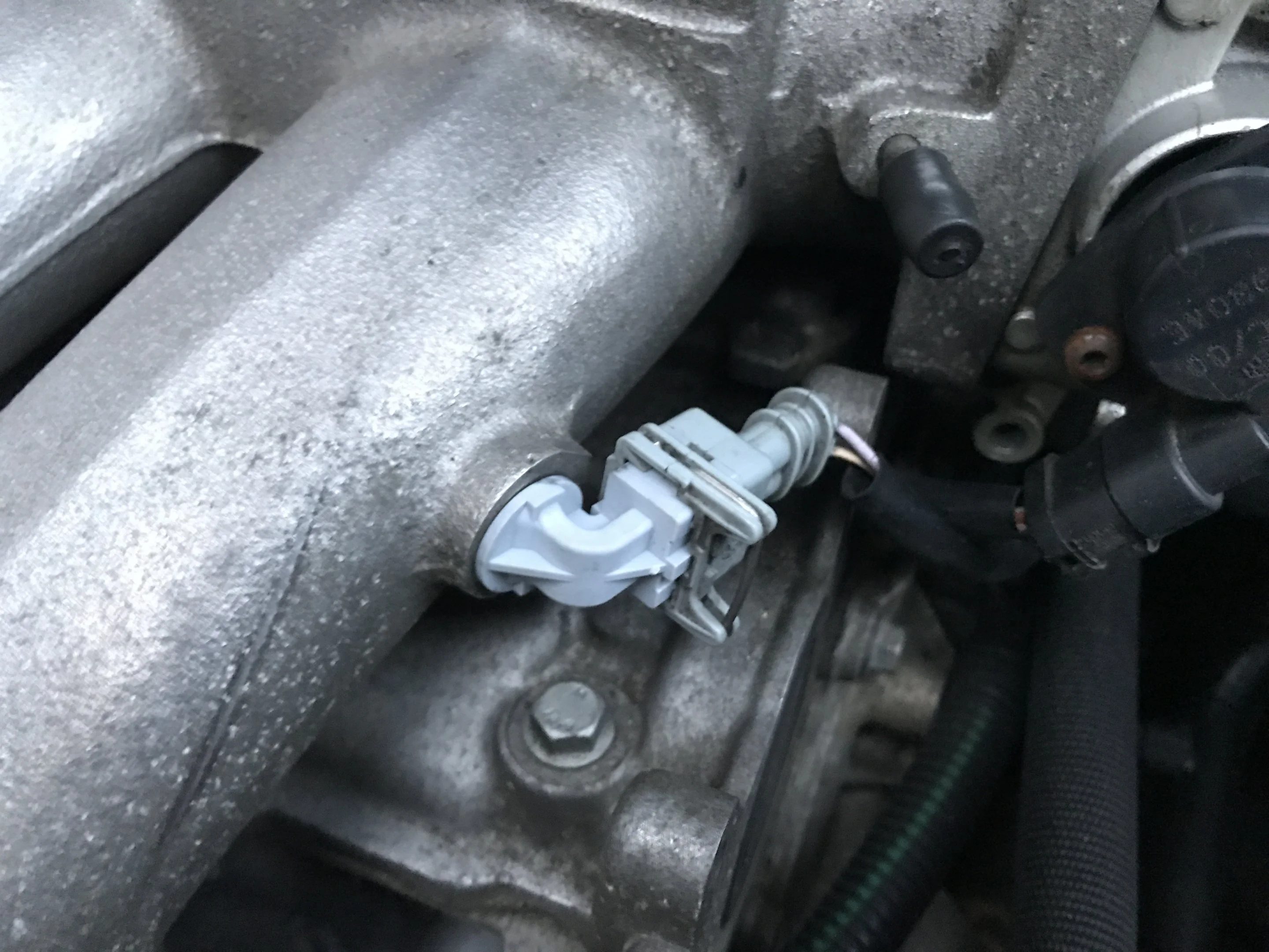

Major update! Replaced the inlet temperature sensor. Had some issue where the idle would be very lumpy for about 5 seconds on cold startup. Replace the damn sensor and fixed!

Also ordered a new OEM headgasket set, OEM crank pulley with key, OEM head bolts, and OEM cambelt kit.
Along with the intake temperature sensor (which I already fitted) I also received a new coolant pipe that sits on the block as the current one is a bit old and I would sleep a lot better knowing it will be replaced along with everything else. So, all the parts are currently waiting and sitting to be installed.

Are your ducts the eBay kit?
They made such a difference it’s the tyres giving up now!

@green It is yeah. Choose the stealth one though. Did you make some kind of deflector plate? I feel like it needs it but obviously haven't tested anything on track yet.

@hostler ive just vented into the wheel well..I cut the hole in the inner arch so the air goes between the wheel and arch when driving straight. I did think about doing the deflector plate but I never get any fade on track with the way they are..not even after 30mins. I’m running 4pot Brembo’s ds1.11 pad.

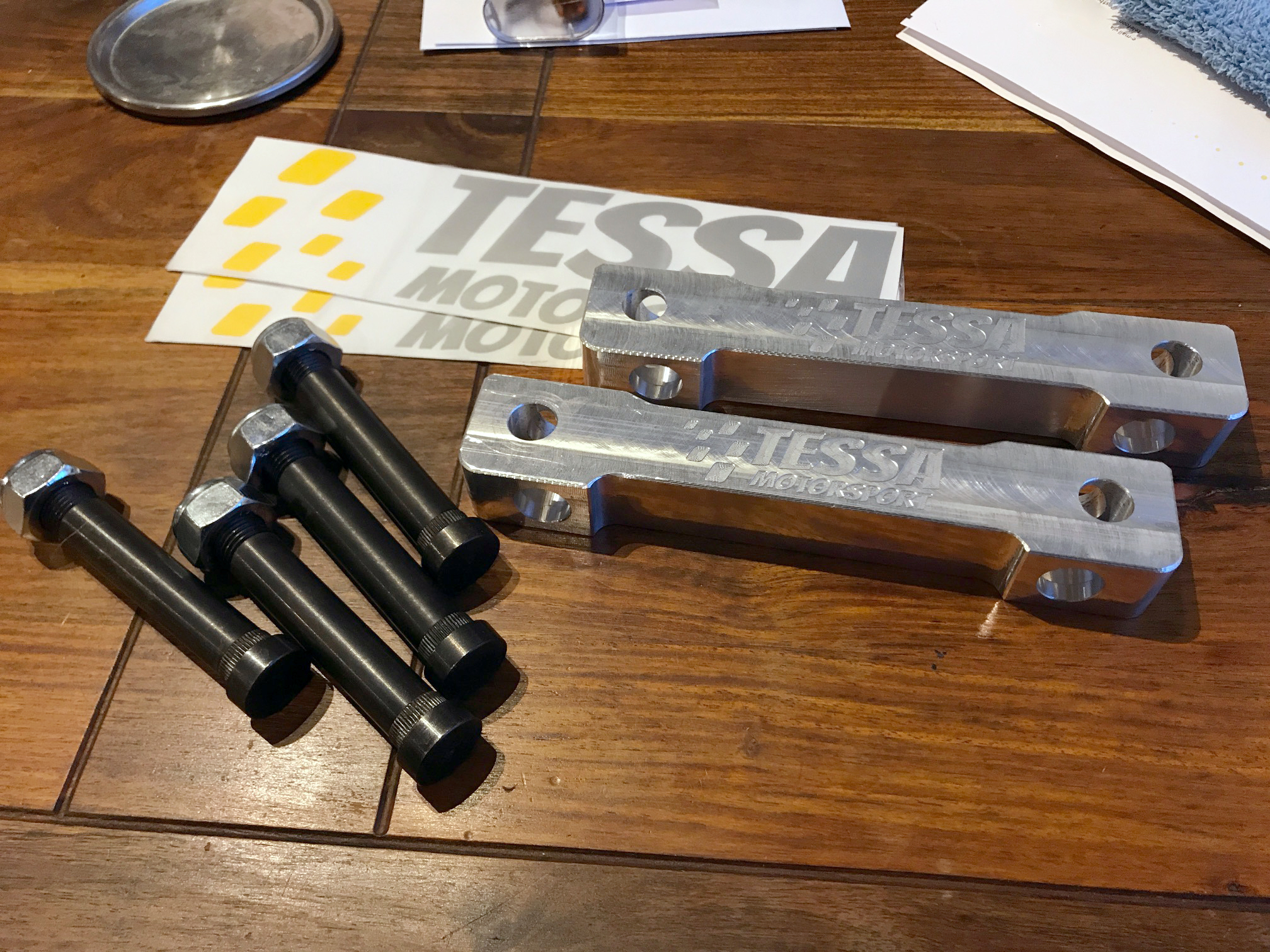

Decided to buy some parts. Found some pretty cheap Brembo's for sale so decided to jump on it. It's a nice upgrade imho.
I want to keep using 15" wheels so I went with 280mm Tessa brackets. The calipers are currently at the machine shop to have 5mm machined off from the mounting points.

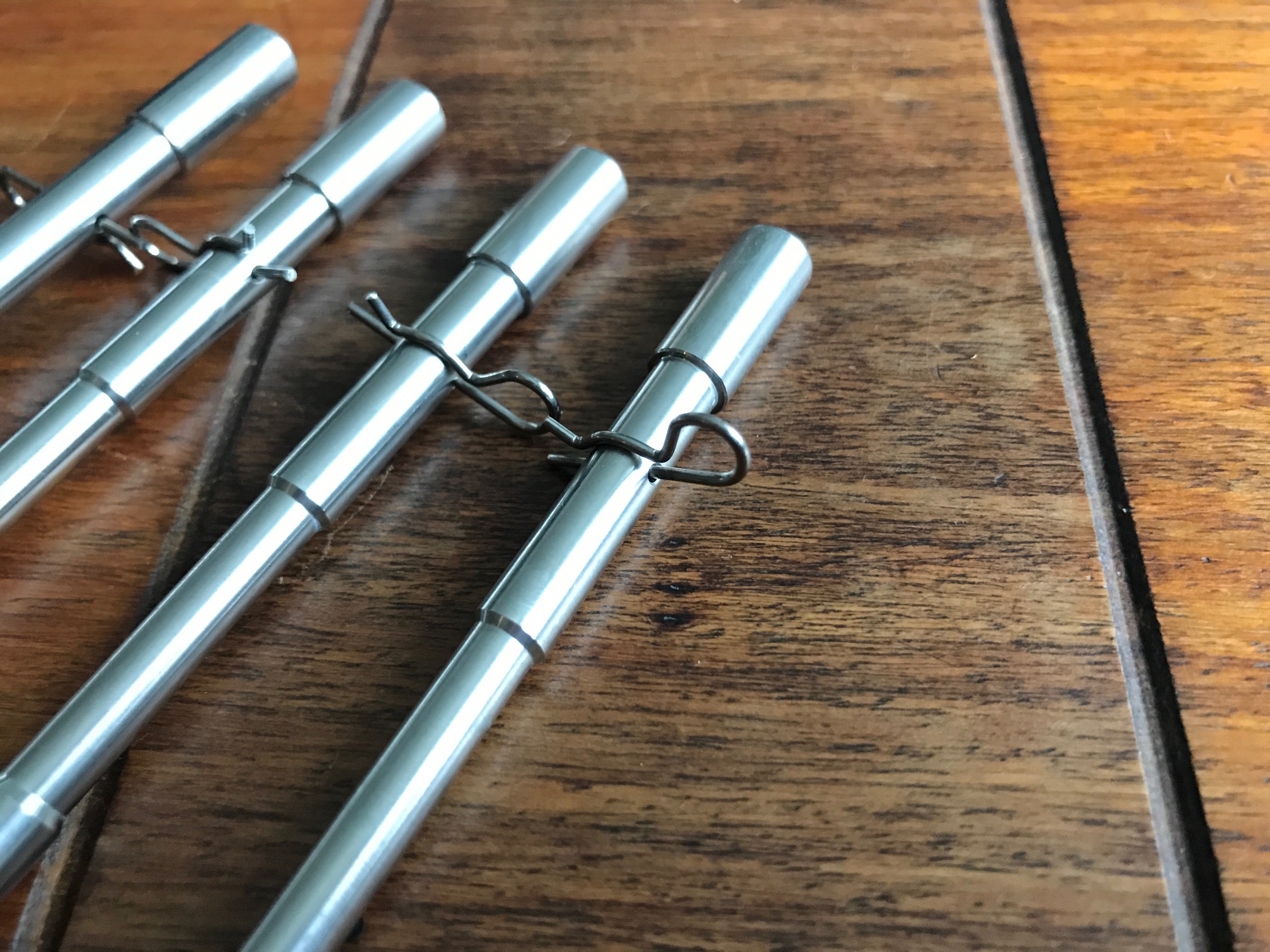

Also got some MrPink pins:

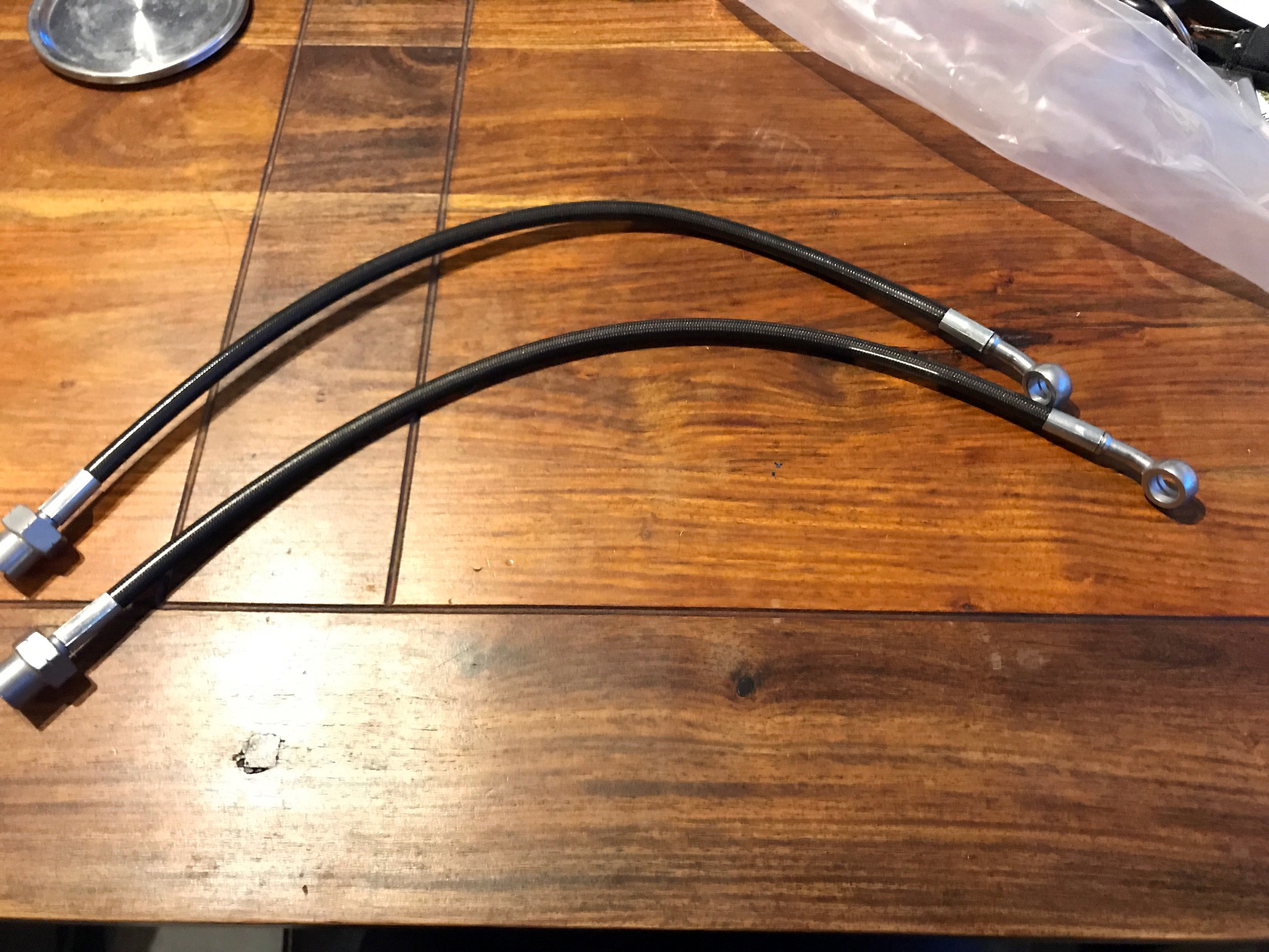

And PMS brake lines:

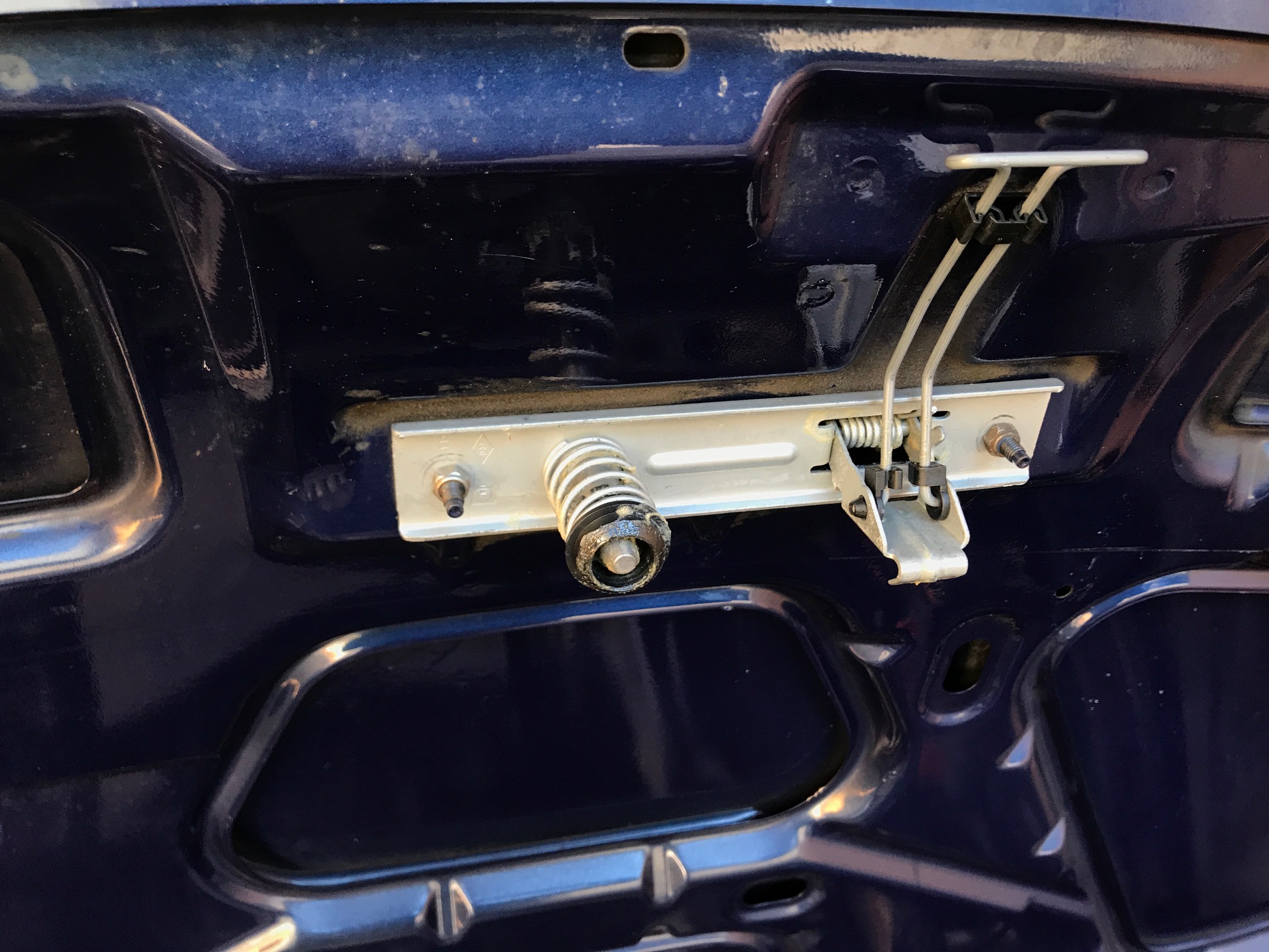

Also changed out the bonnet catch as they tend to fly open by themselves:

How you finding the new fluid and the RC6's? Im also running RC6's, braided lines and Motul RBF600 and constantly boil my fluid, although I do need to sort out my cup racer ducts so they actually point more at my calipers but as I have my front bumper off all the time it makes it abit of a pain to sort out, or I guess it might be that I just brake last minute constantly... :/
