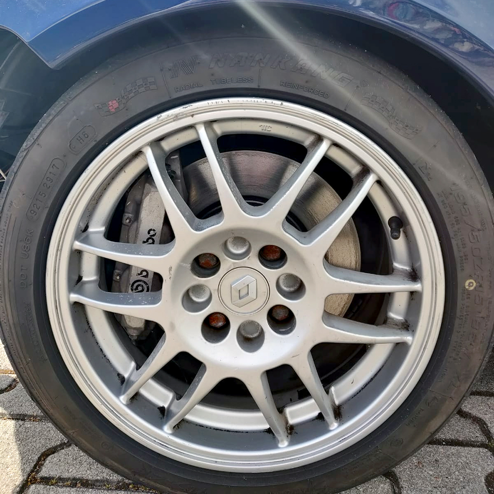

Actually, I've been having issues with my brakes as you can see here: https://www.cliosport.net/threads/i-keep-boiling-brake-fluid.816376/
Can't really comment on the brake fluid as I've boiled it again. I kind of narrowed this down to a sticky caliper though. RC6 pads are amazing. They do not fade, ever. No issues with delaminating pads either (I use them on the street as well, but not daily anymore). My old RC5+ pads did break down a little after driving them on the street for a long time.
Last minute hard braking is better than medium long braking since you build up a lot less heat.
Will probably me going for RC6 pads again with the Brembo calipers.

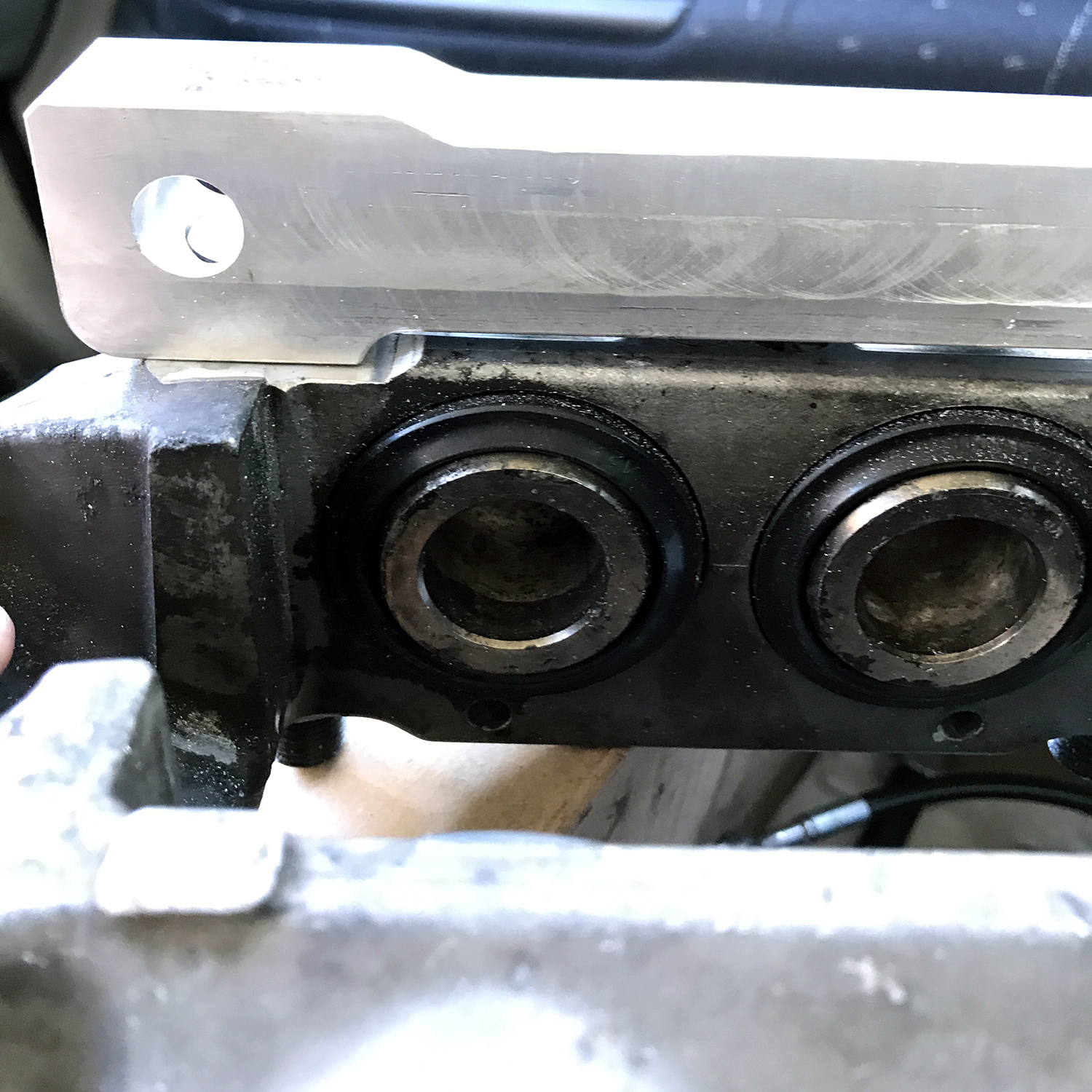

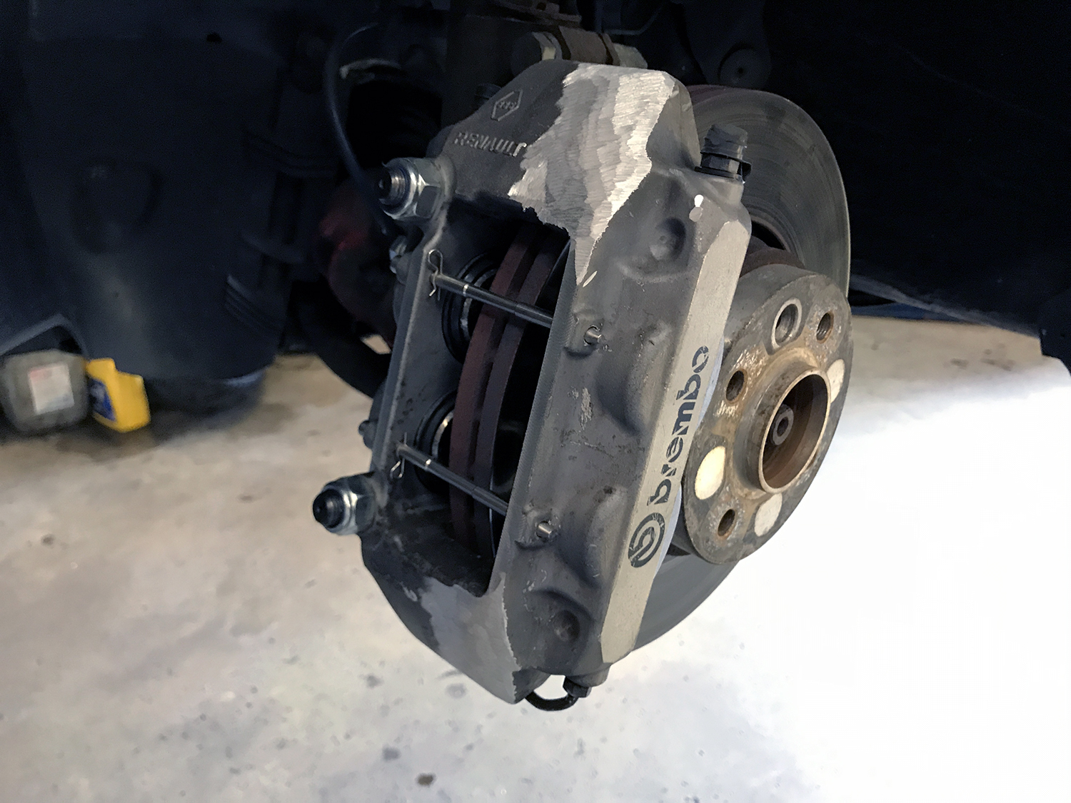

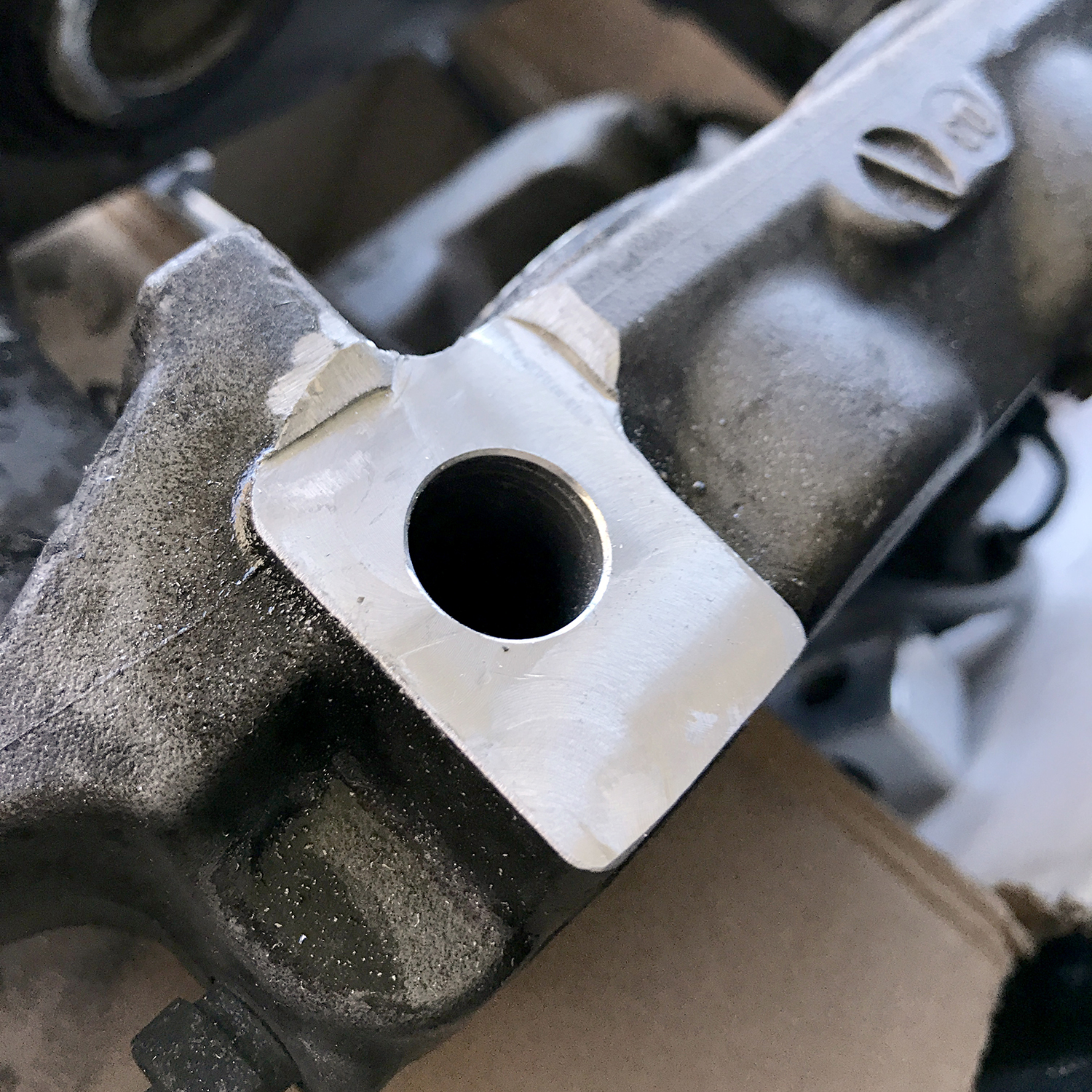

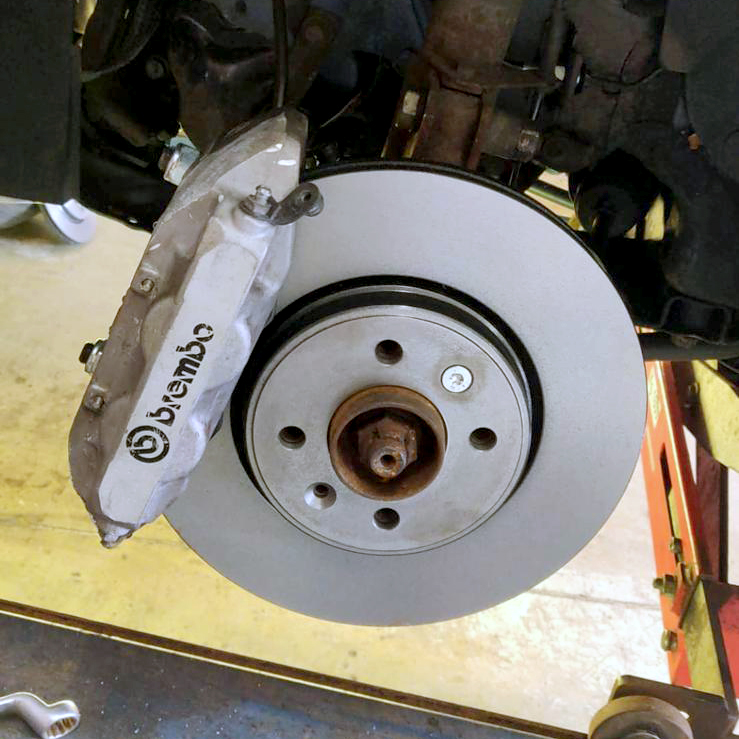

Got the calipers back from the machine shop. They charged me €45,-. 5mm has been machined off from the mounting points.
Brembo HC discs also came in. Still not sure on which pads to buy though.
Will test fit them soon I think.

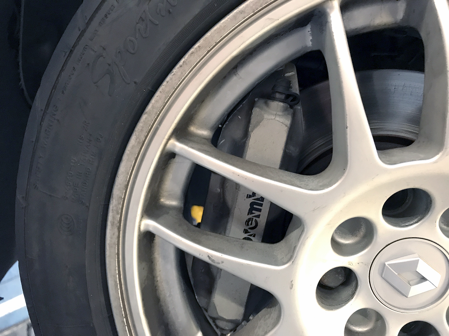

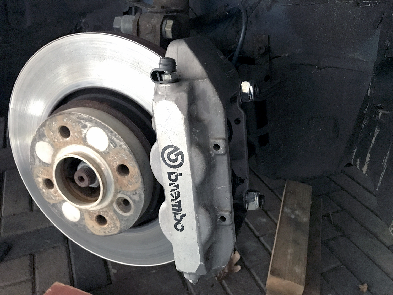

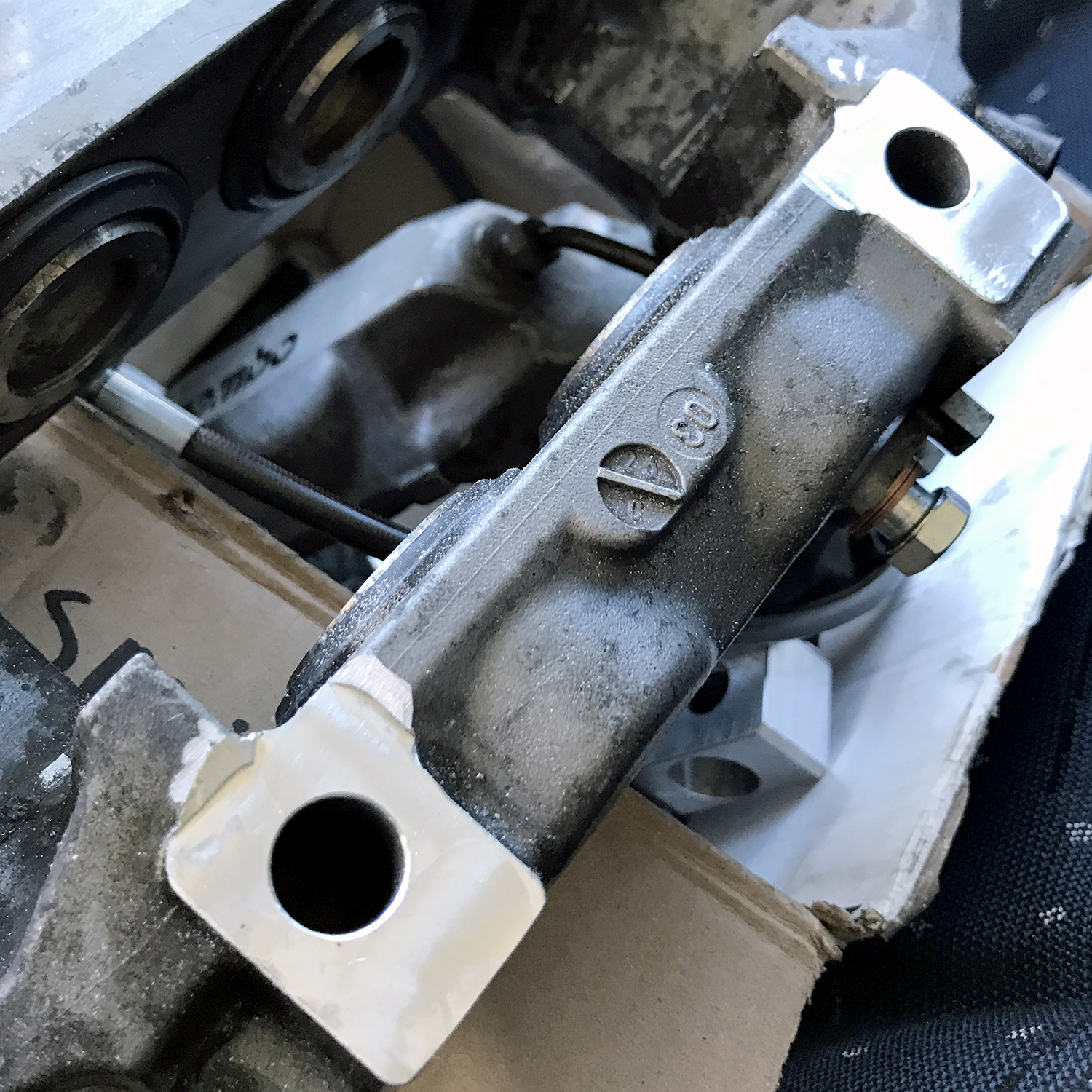

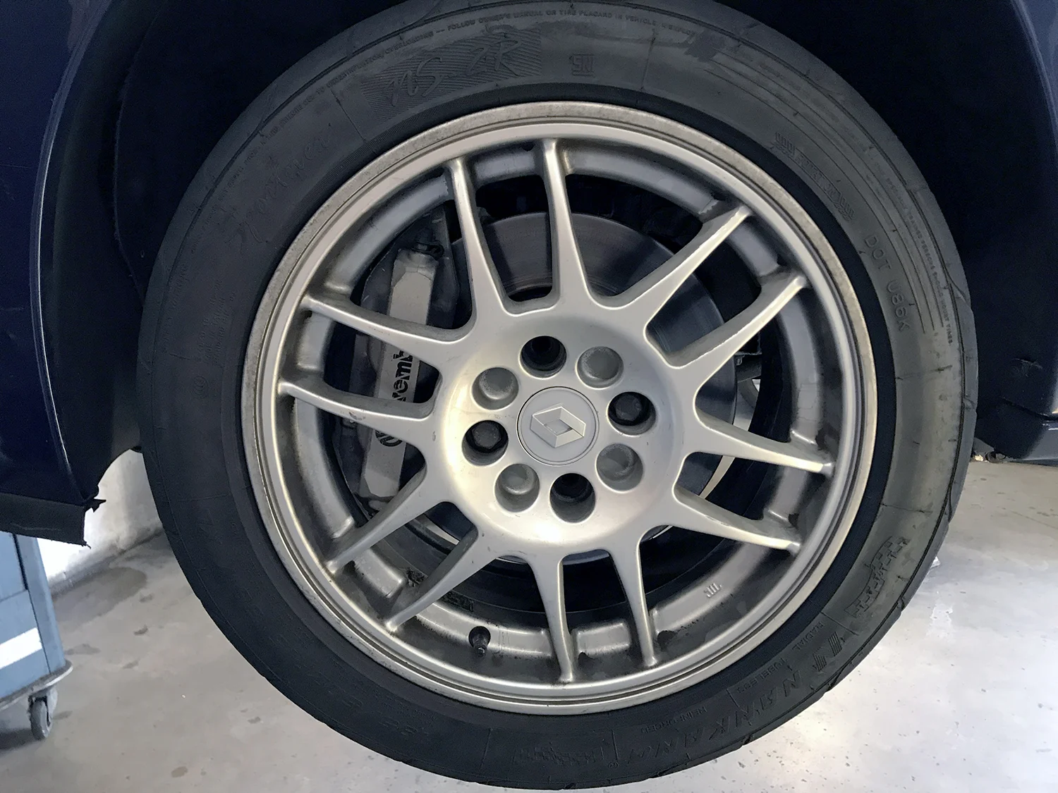

Testfitted the brembo's on one side. They hit the wheel weights so will have to get those moved. Might need to grind some material off the top and bottom sides (facing the inside of the wheel) but I couldnt test fit them properly due to the wheel weights. Getting the wheels balanced this saturday and then I'll try to fit it again. Is grinding the sides of the calipers needed when they're already machined? I had 5mm taken off from the mounting points.
Atleast it looks cool.

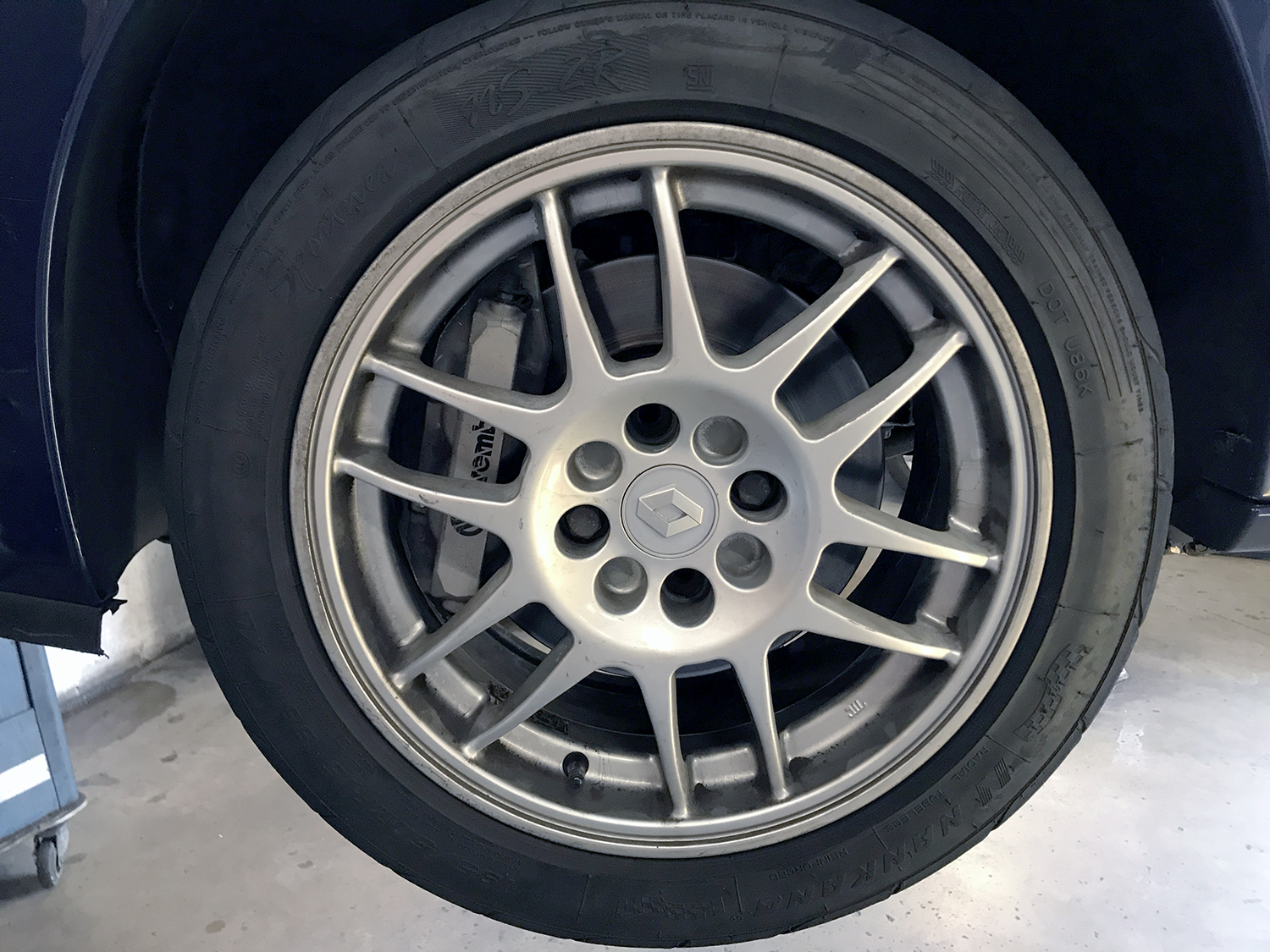

The wheels are OZ f1 15" and the spacers are 20mm.
Test fitted the Brembo's one last time. With a bit of grinding they clear the 15" OZ f1's. Will smooth the grinding marks out with some sandpaper before painting them. Probably going to be yellow. Heatresistant stickers already came in. Pretty fun to actually make something fit instead of just using bolt on parts.

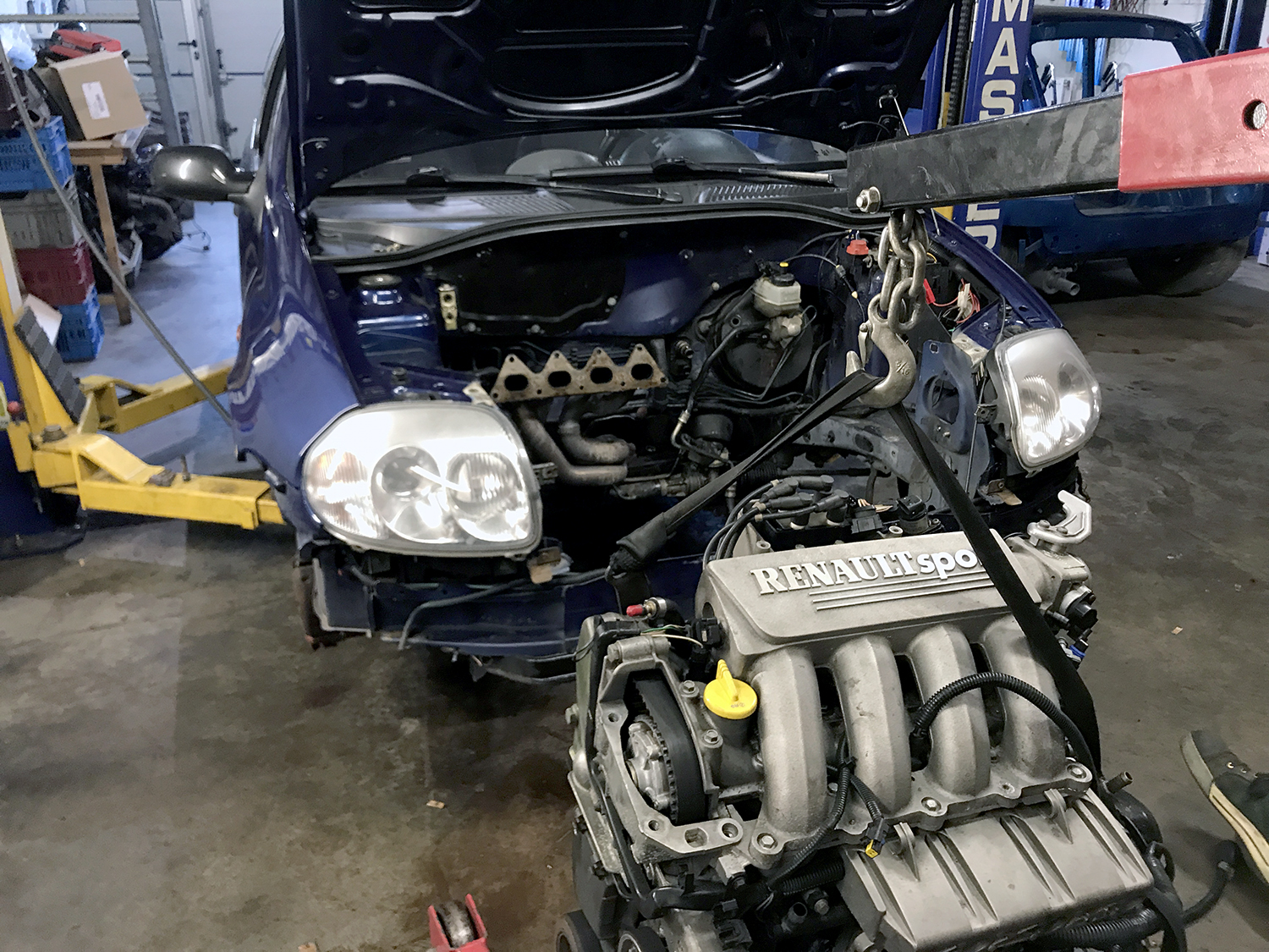

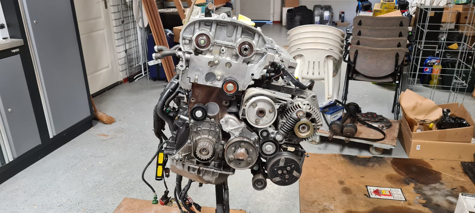

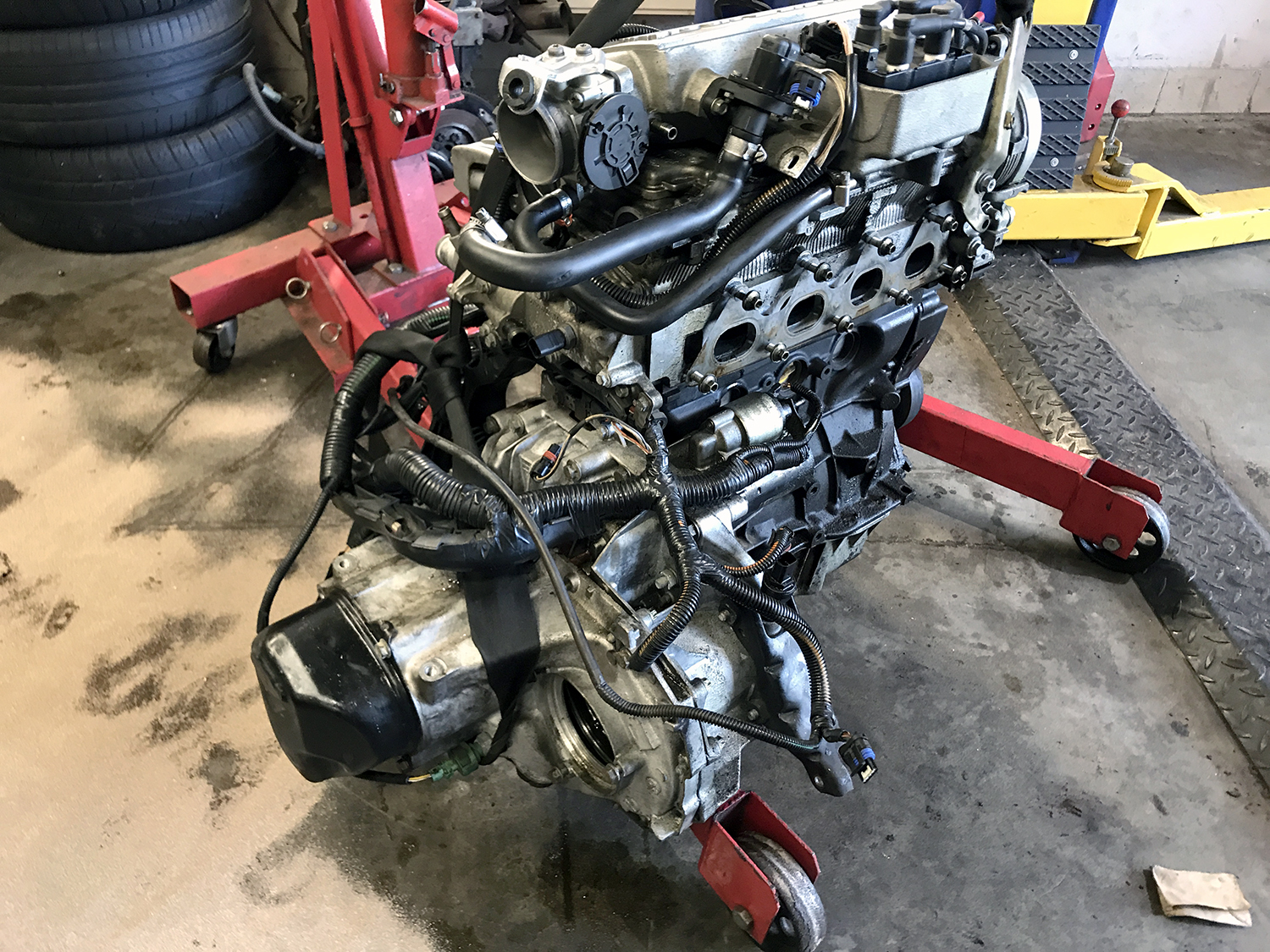

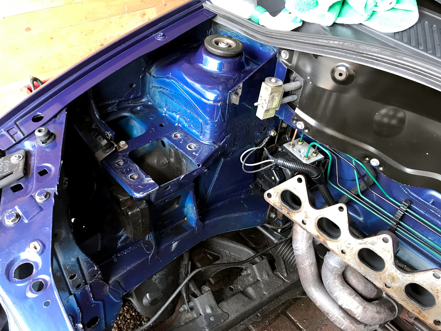

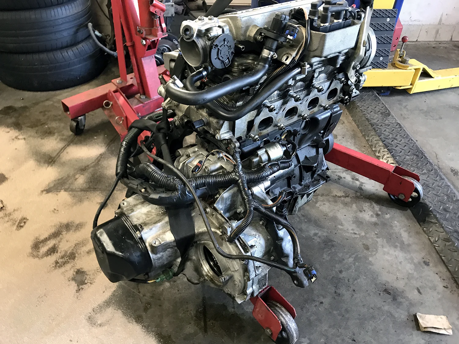

Took the engine out today.
What a mess
Sadly found some issues and broke some bolts. Three headbolts snapped off so I couldn't take the head of to inspect further.

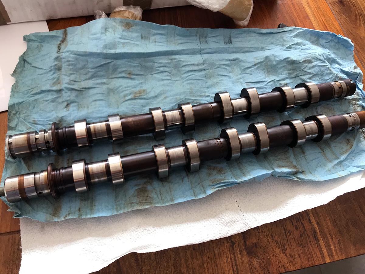

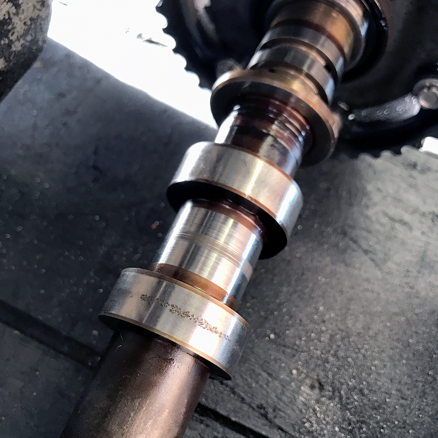

Also the camshafts are quite badly worn. Will need to source replacements.
Sent the engine to a shop that can drill those broken headbolts out. We'll see from there. Kind of disapointed that I need to replace cams and followers as well.
Wasn’t planning on it. Engine went out so easily so it really sucks that s**t went wrong when we opened the engine up. Shop will take a look at drilling those bolts out early next week so then I know what the state of the rest is. Hopefully the crank still looks good. So definitely need replacement camshafts and new followers. Don’t really want to spend the money for catcams so might just order new Oem ones if they are cheap. Or some good looking second hand ones. 197 cams are also a possibility but not sure how that works with setting the timing.

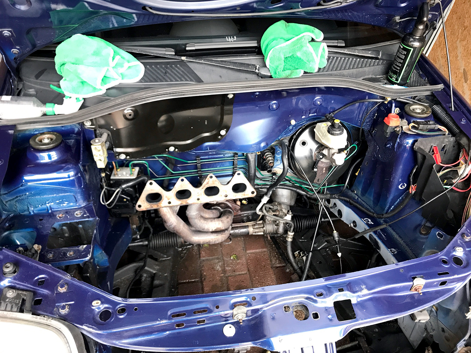

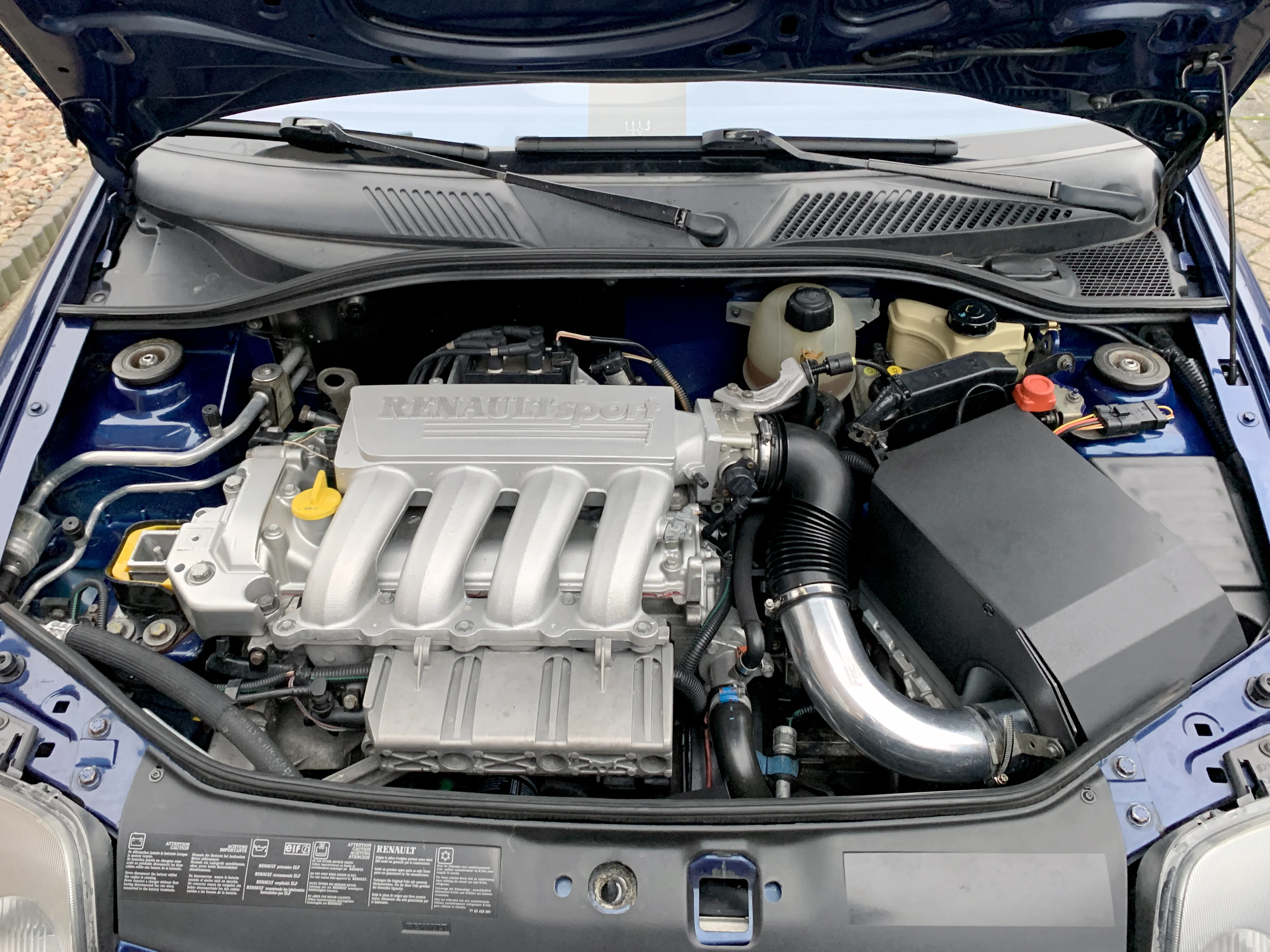

Been cleaning a few bits here and there. Engine bay looks nice and tidy now:
Will be painting the brake booster/servo since its pretty crusty. Other than that no rust anywhere and no signs of previous damage which is good.
Subframe needs doing but will do that when I have acces to water. Using a jerry can isnt ideal.

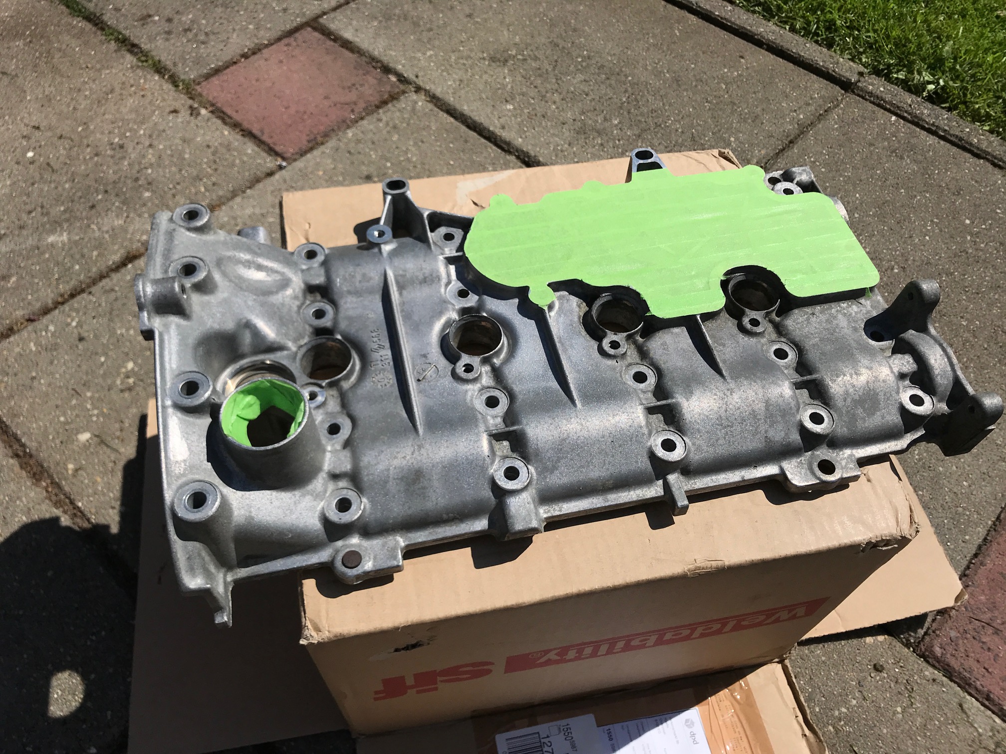

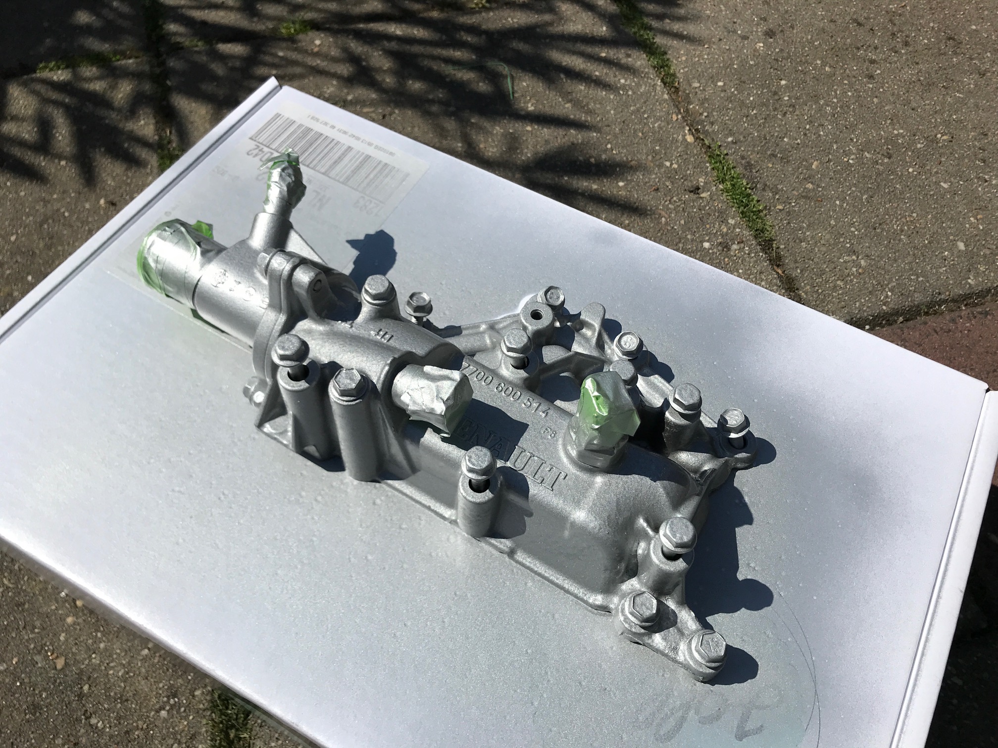

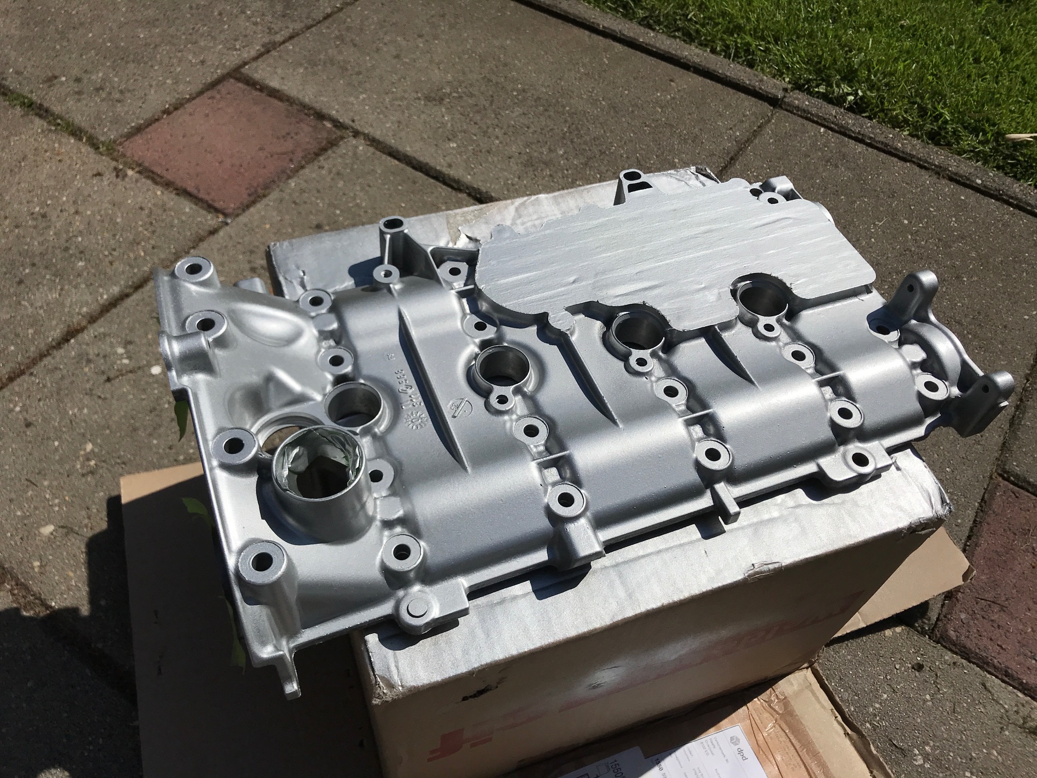

Valve cover came out really well. Almost looks like it's been in a cleaning bath.

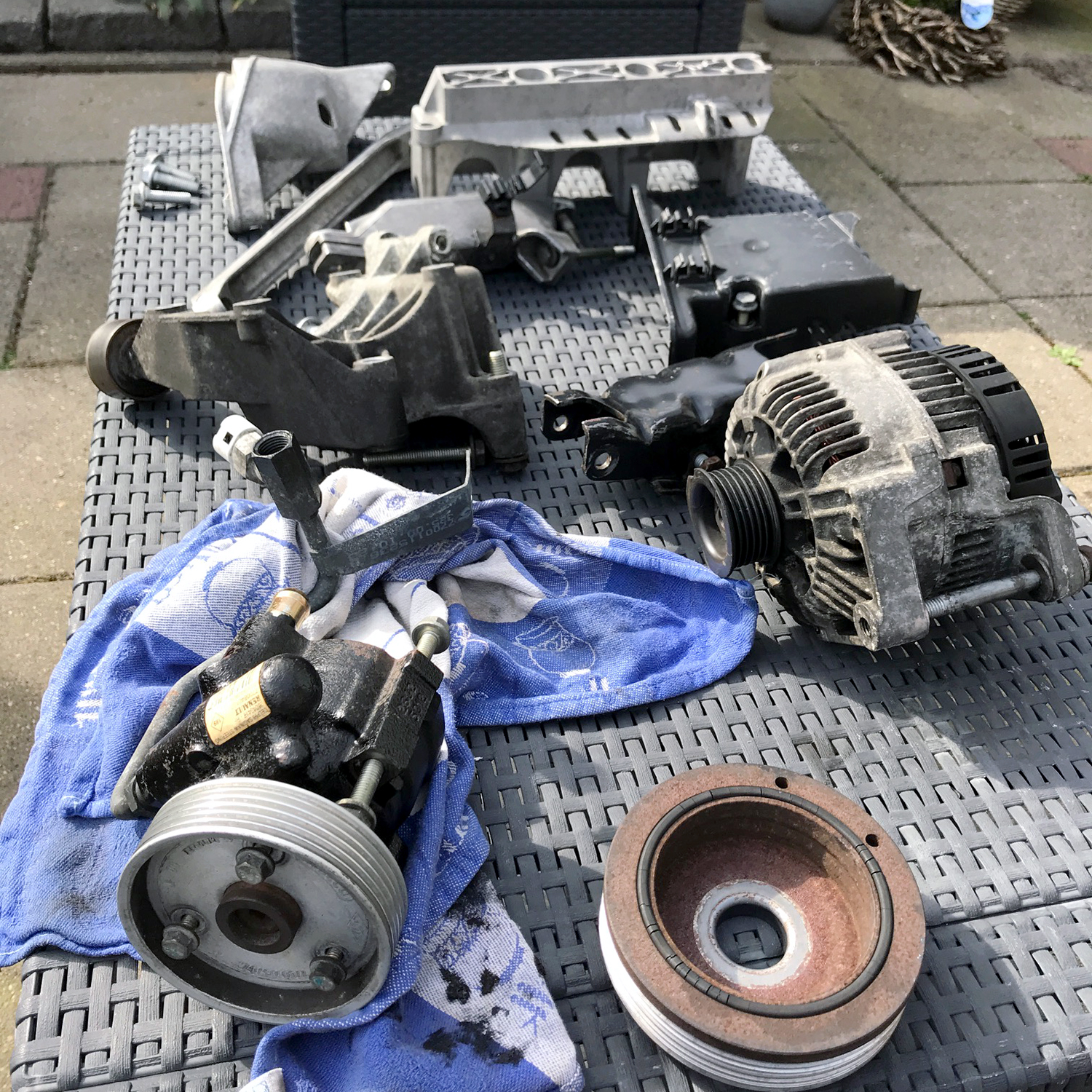

More parts... Also broke the pulley of the alternator so will need to sort a replacement pulley for that. When putting the engine back I'll mount the alternator after everything is bolted down.
Also recieved a new engine mount from a member on here. Will be looking for uprated upper mount and gearbox mount as well.

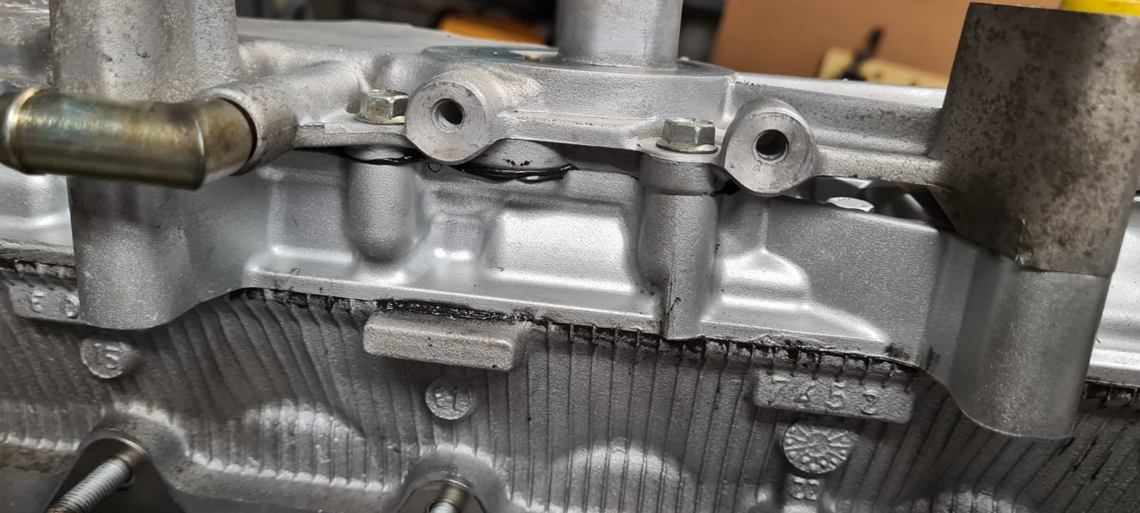

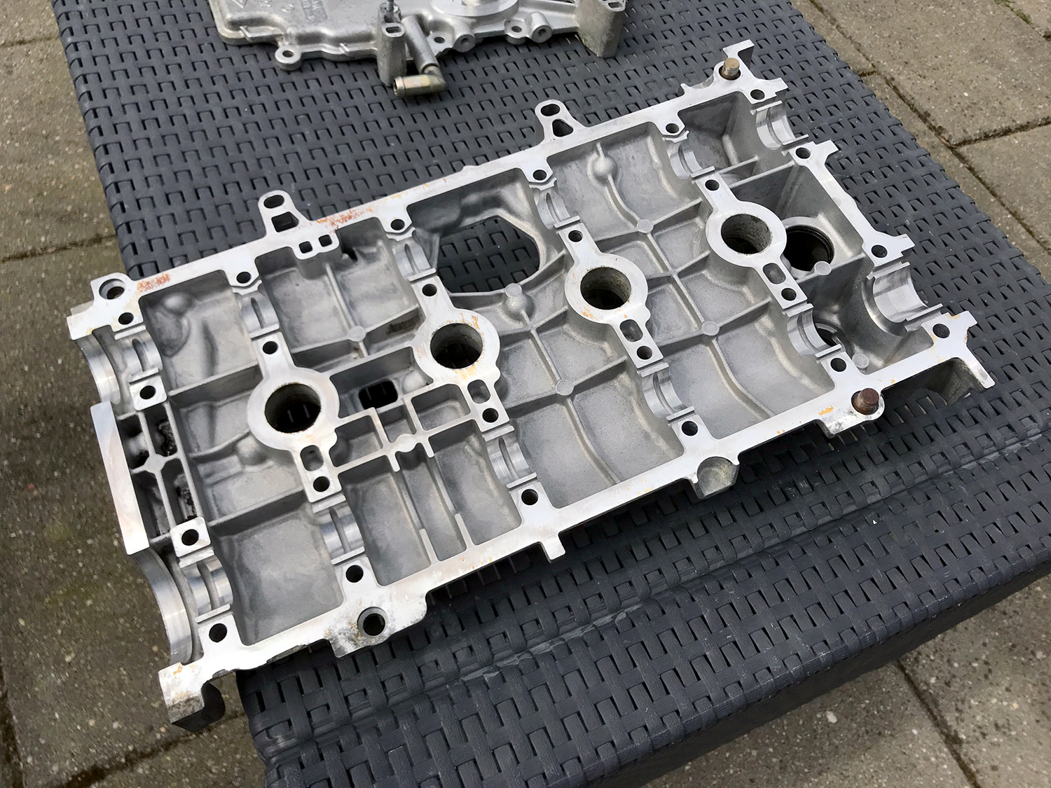

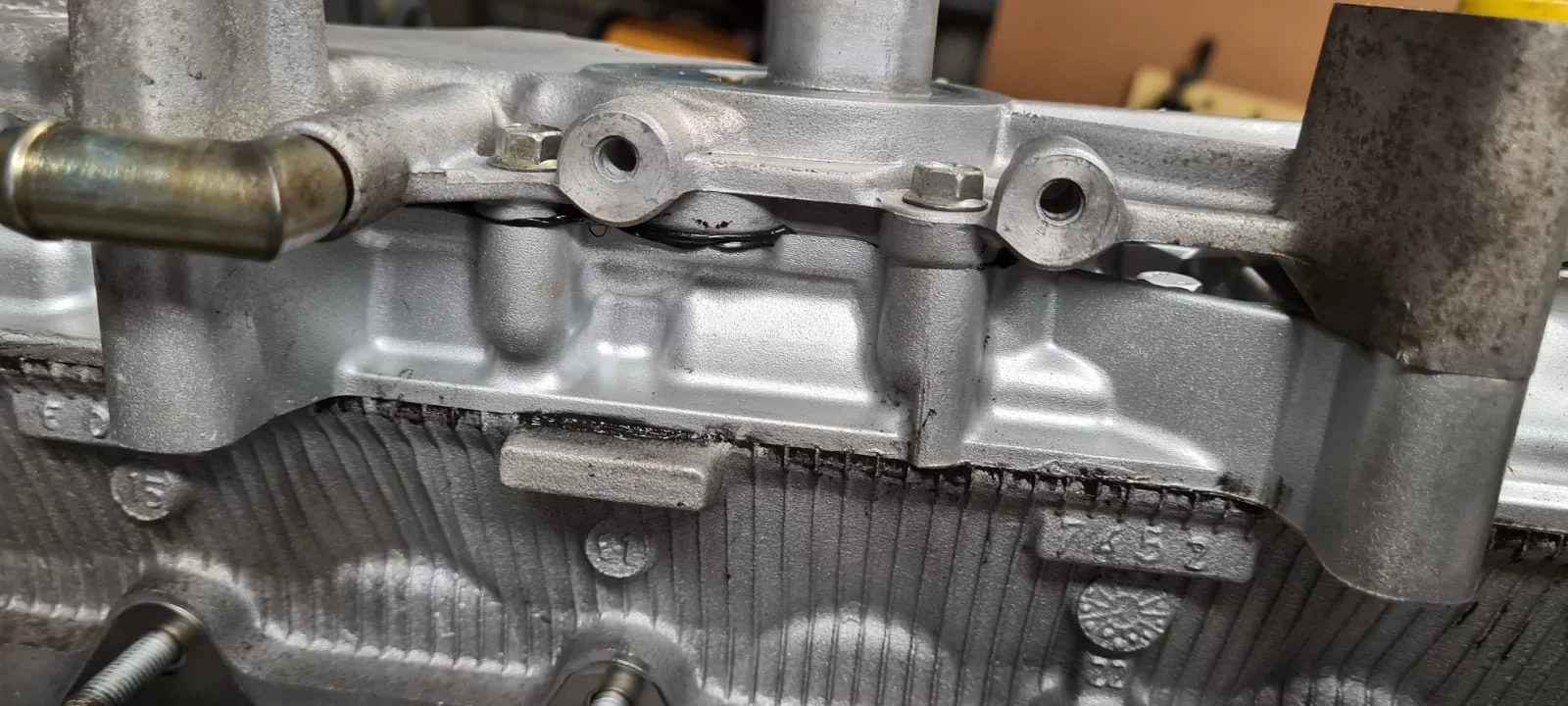

Finally heard back from the machine shop. They drilled out the head bolts and got the engine dissasembled. They quoted me a fair price for the bottom end rebuild so I came by and collected the head. Also dropped off the oil pump, chain and sprocket so they can install that as well.
They measured the crank and cylinder walls and everything was within spec so they will only need to polish the crank and hone the cylinder walls. They also already cleaned up the pistons and crank.
Should've asked them to remove the valves when I collected the head... Oh well. Head doesnt need much doing so thats good. Cams and new followers will arrive soon and everything needs a really good clean (there are metal shavings all over the place from drilling).
Got a few more things done. Nothing mayor since the bottom end isn't back yet. Machine shop told me it should either be late this week (but tomorrow is a national holiday) or early next week. Will probably start assembling everything on the 18th of may and engine should go back in on the 22nd of may. Then all that needs doing is mounting the Brembo 197 calipers, alignment and MOT (APK).

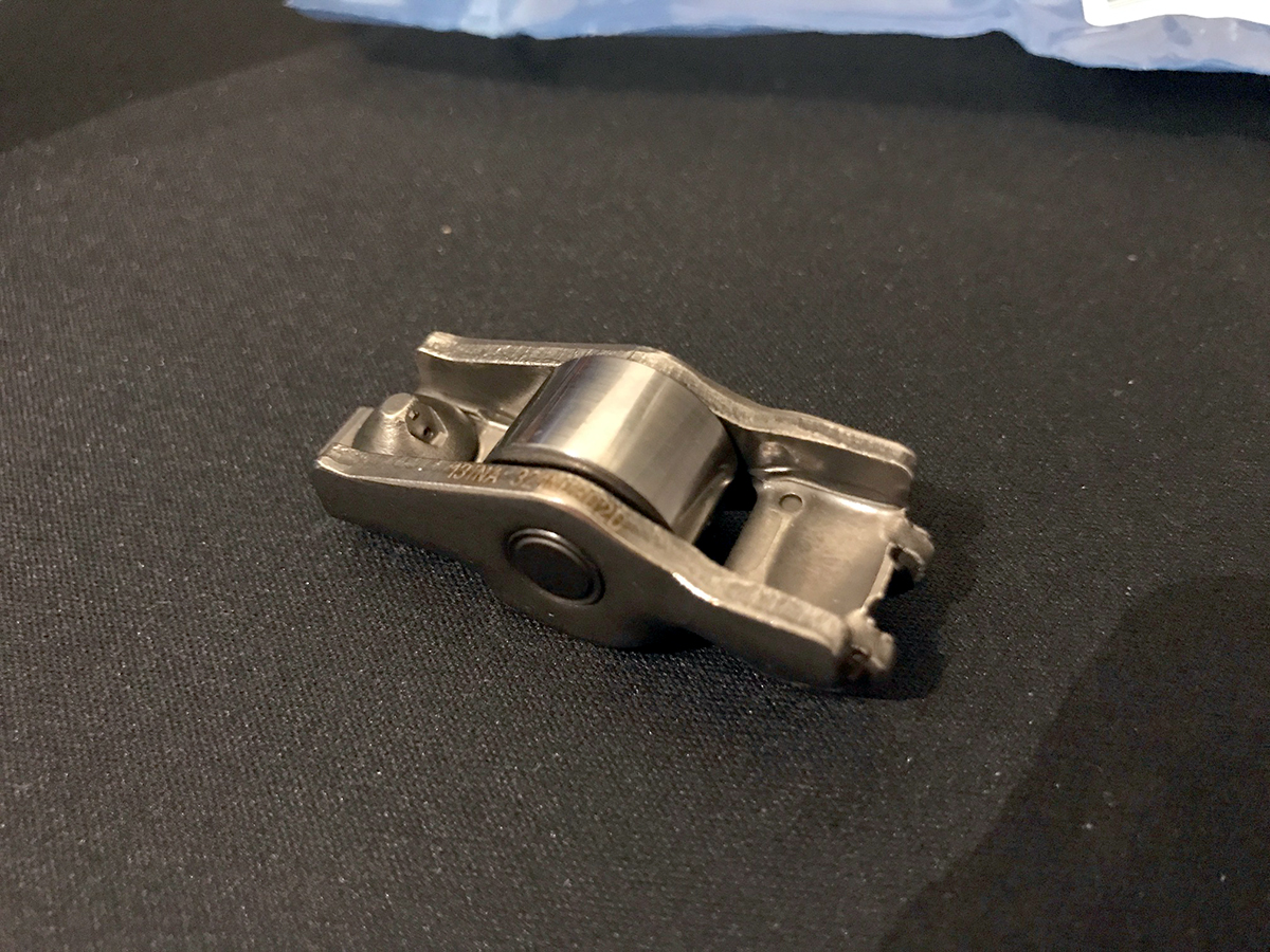

Since my cams were worn badly I sourced some different ones. Relatively low miles. Didnt want to spend the money for uprated ones.

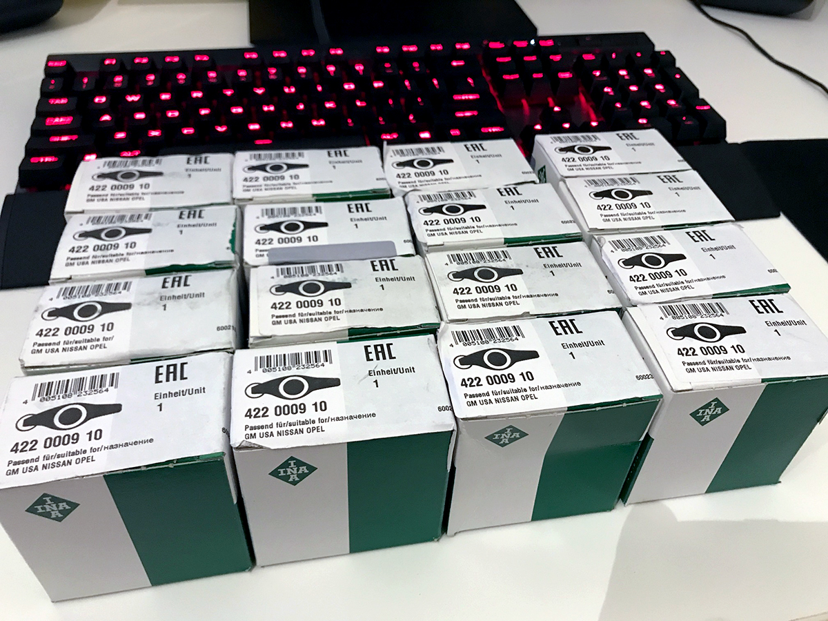

Also got new cam followers

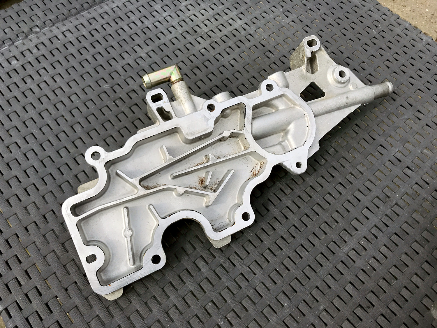

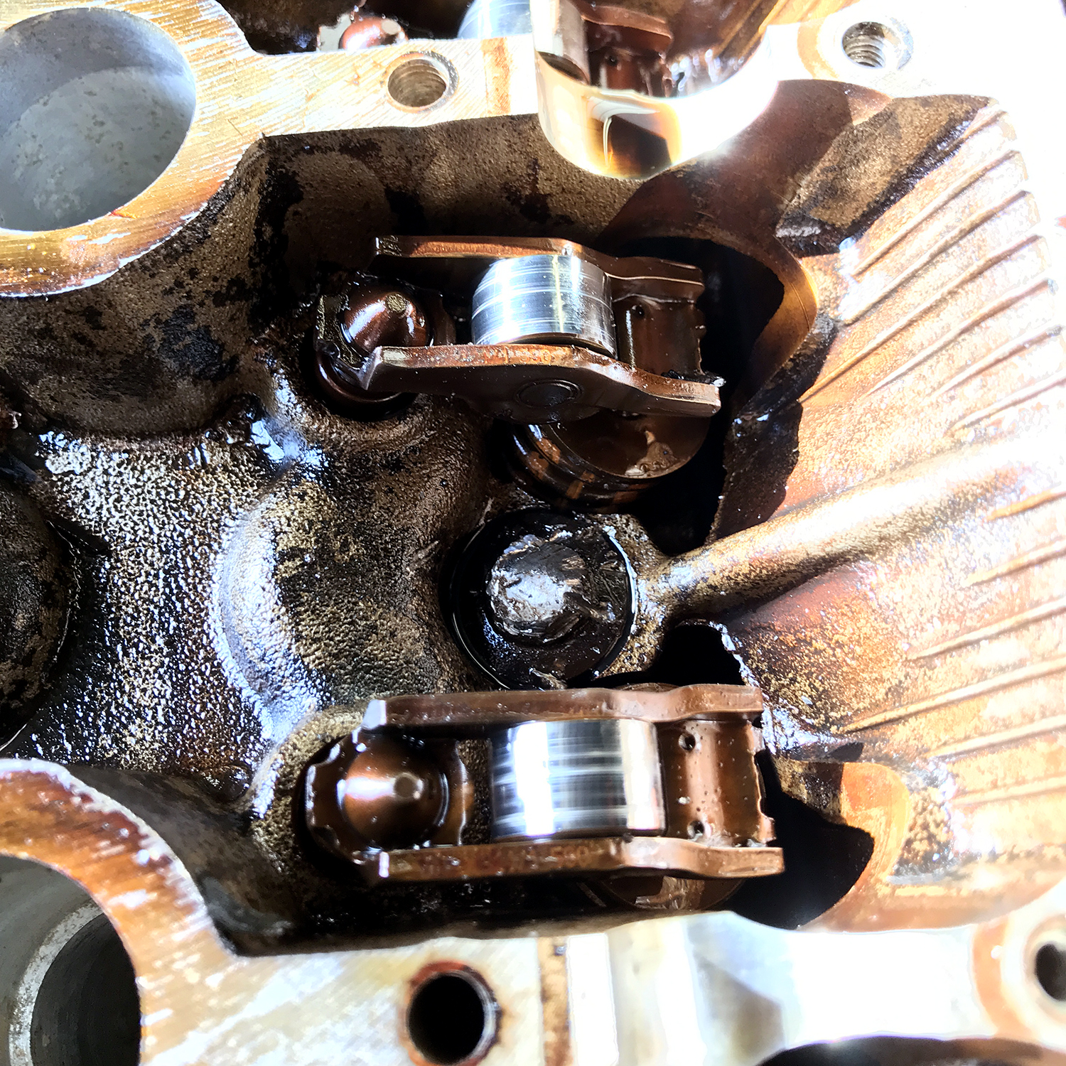

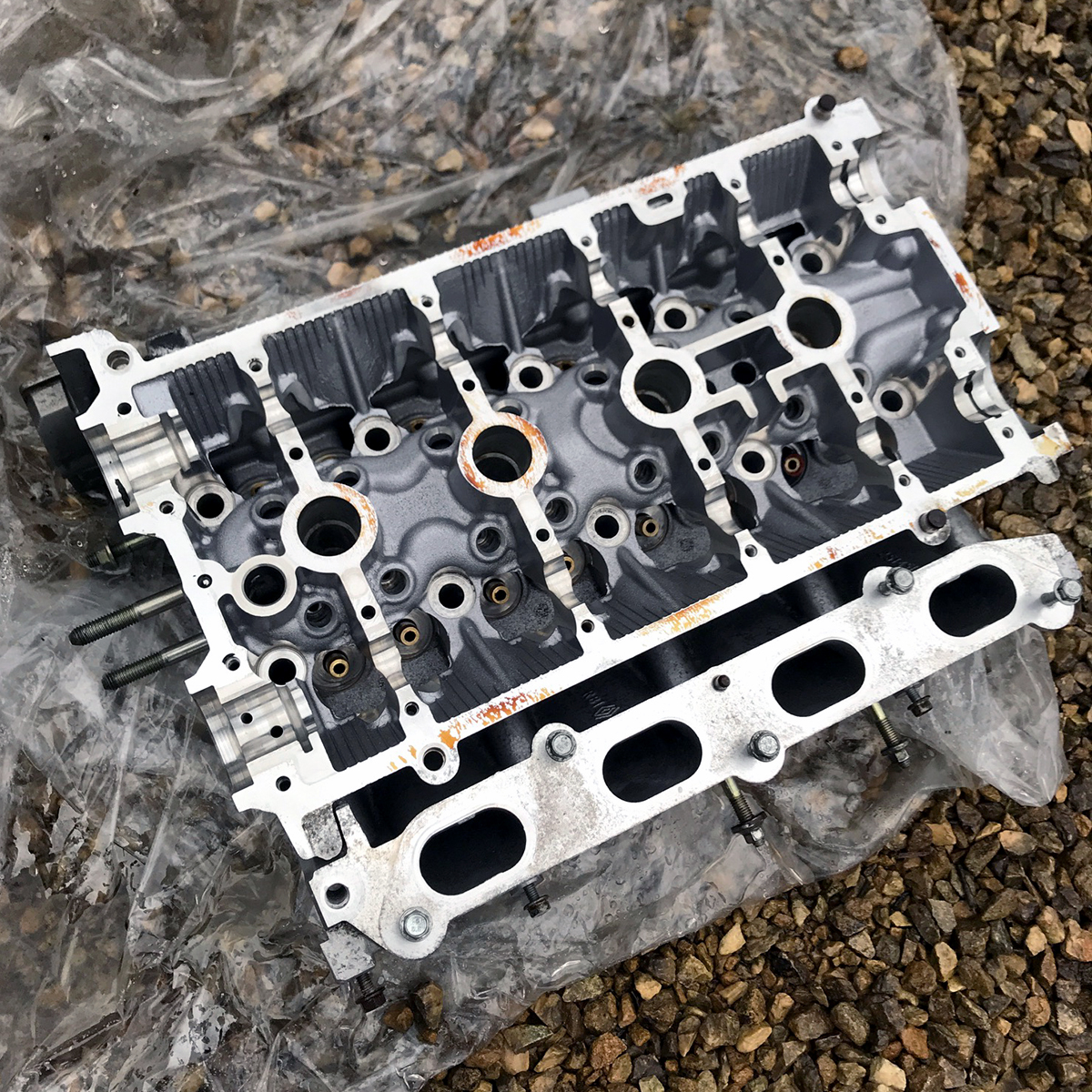

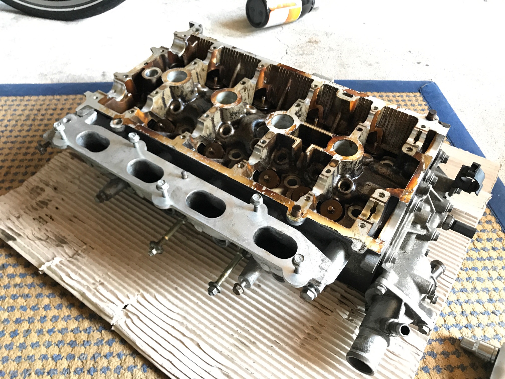

Removed all the valves, springs and valve stem seals to give the head a good clean. Some of these stem seals were a b#tch to get out. There were many metal shavings in there due to the head bolts having to be drilled out. The head came out really well but needs another clean to make sure there aren't any shavings in tere anymore.

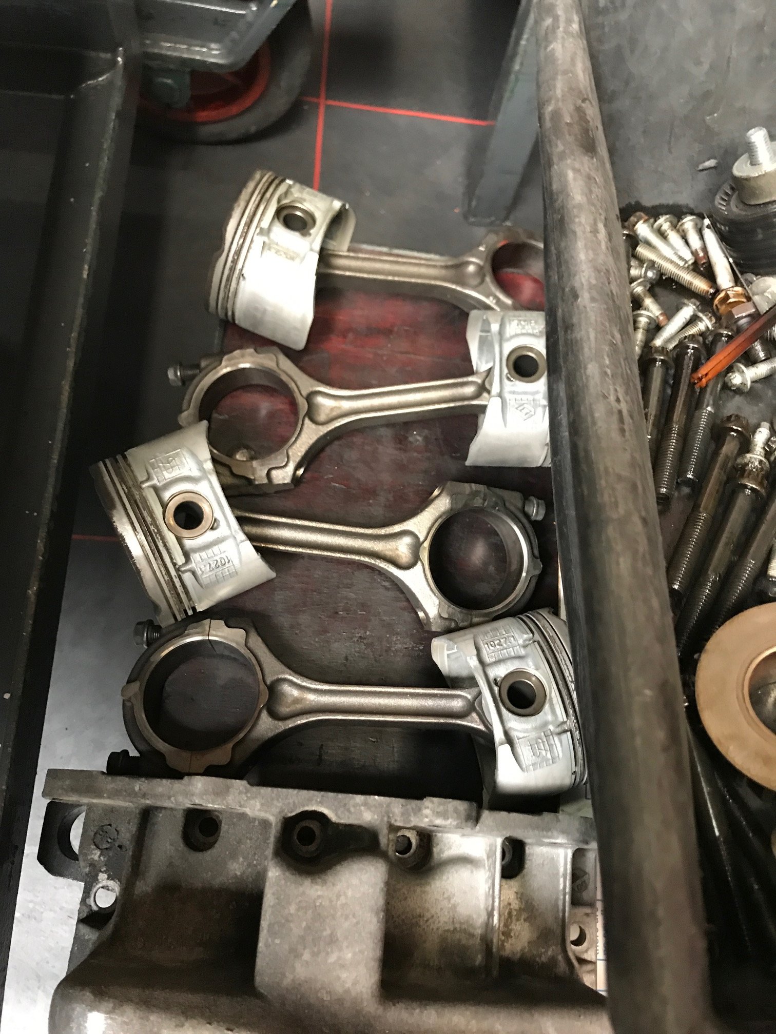

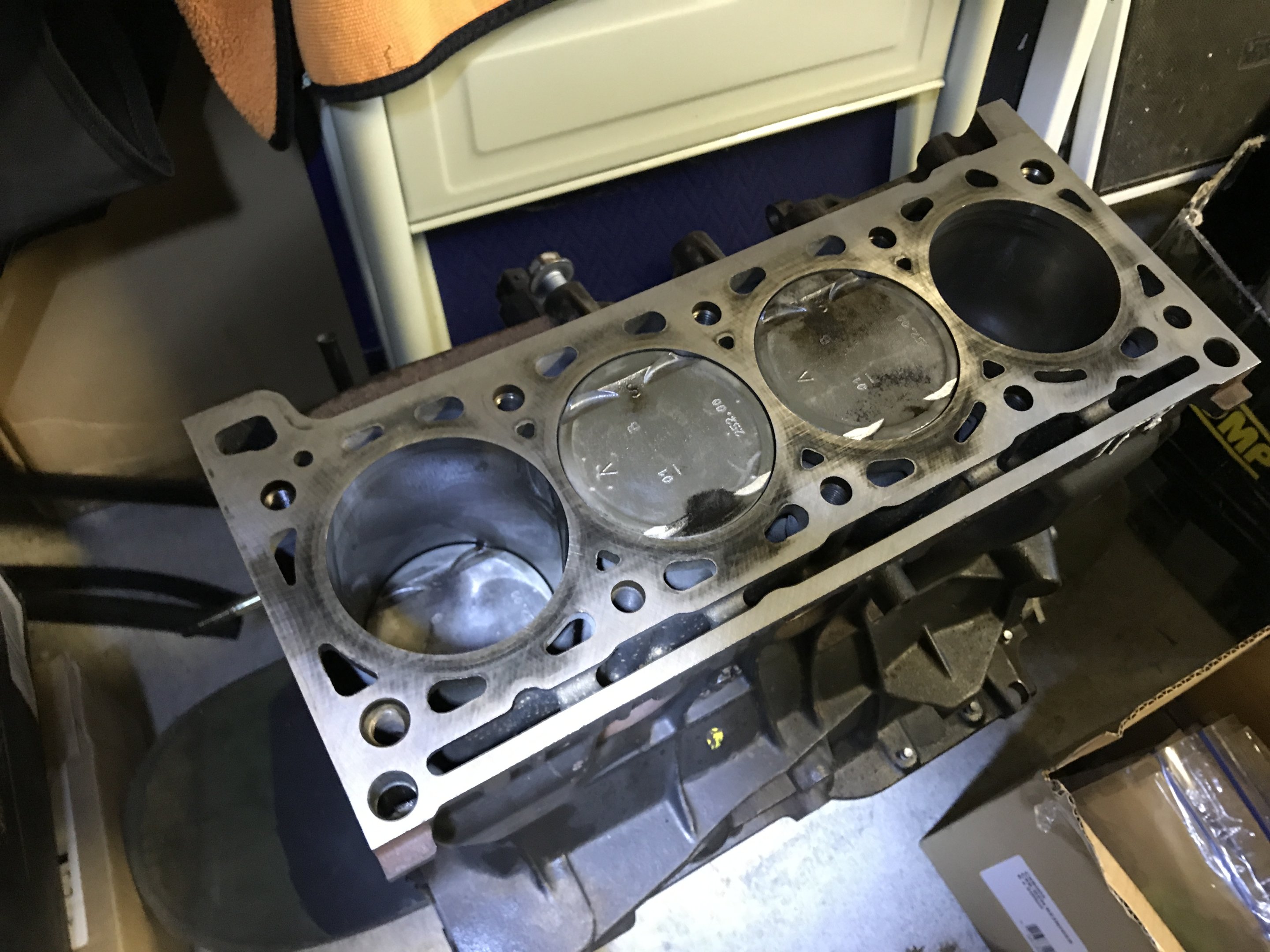

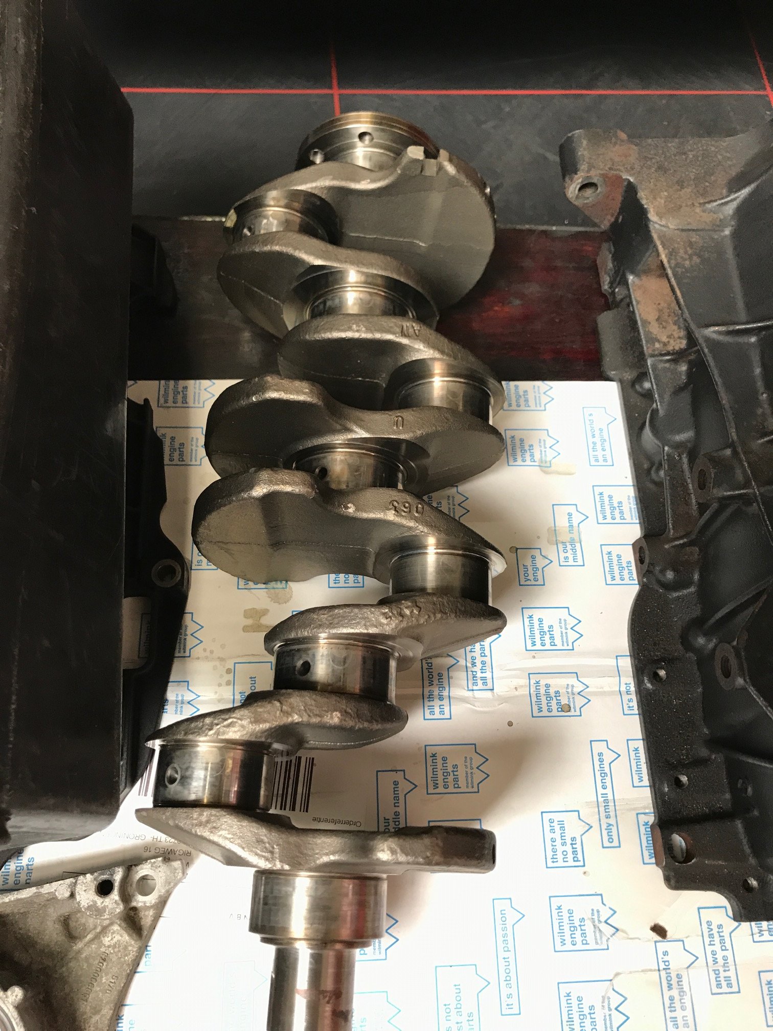

Picked up the bottom end last friday. Finally!

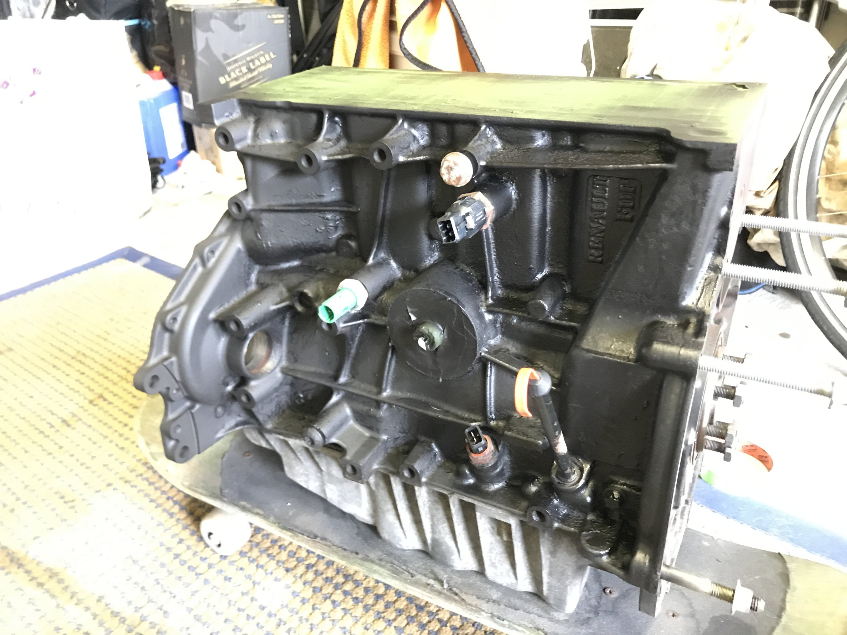

New bearings, arp conrod bolts, new main cap bolts, crank measured and polished, new piston rings, cylinders honed, new oilpump + chain and ofc all new gaskets.

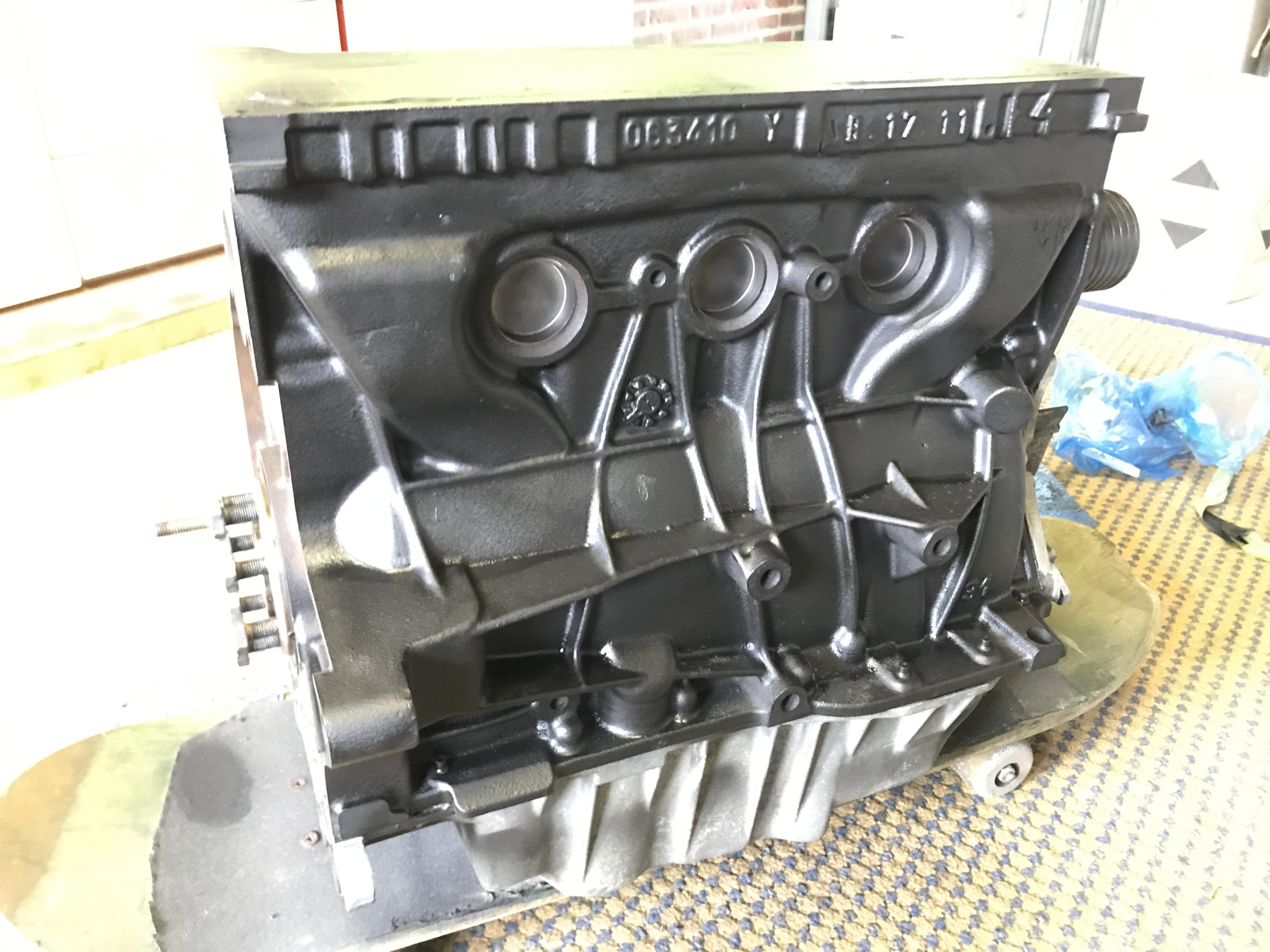

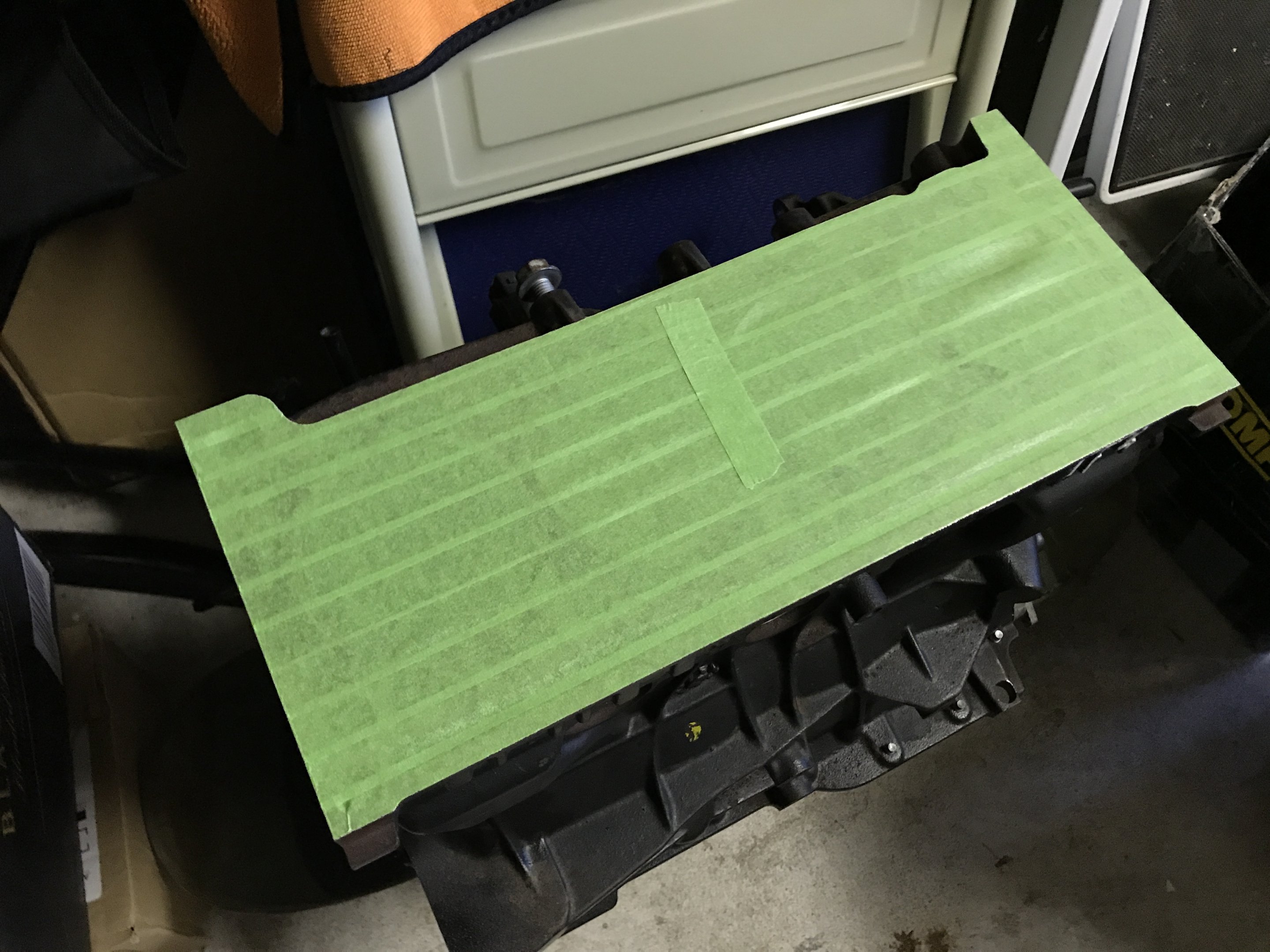

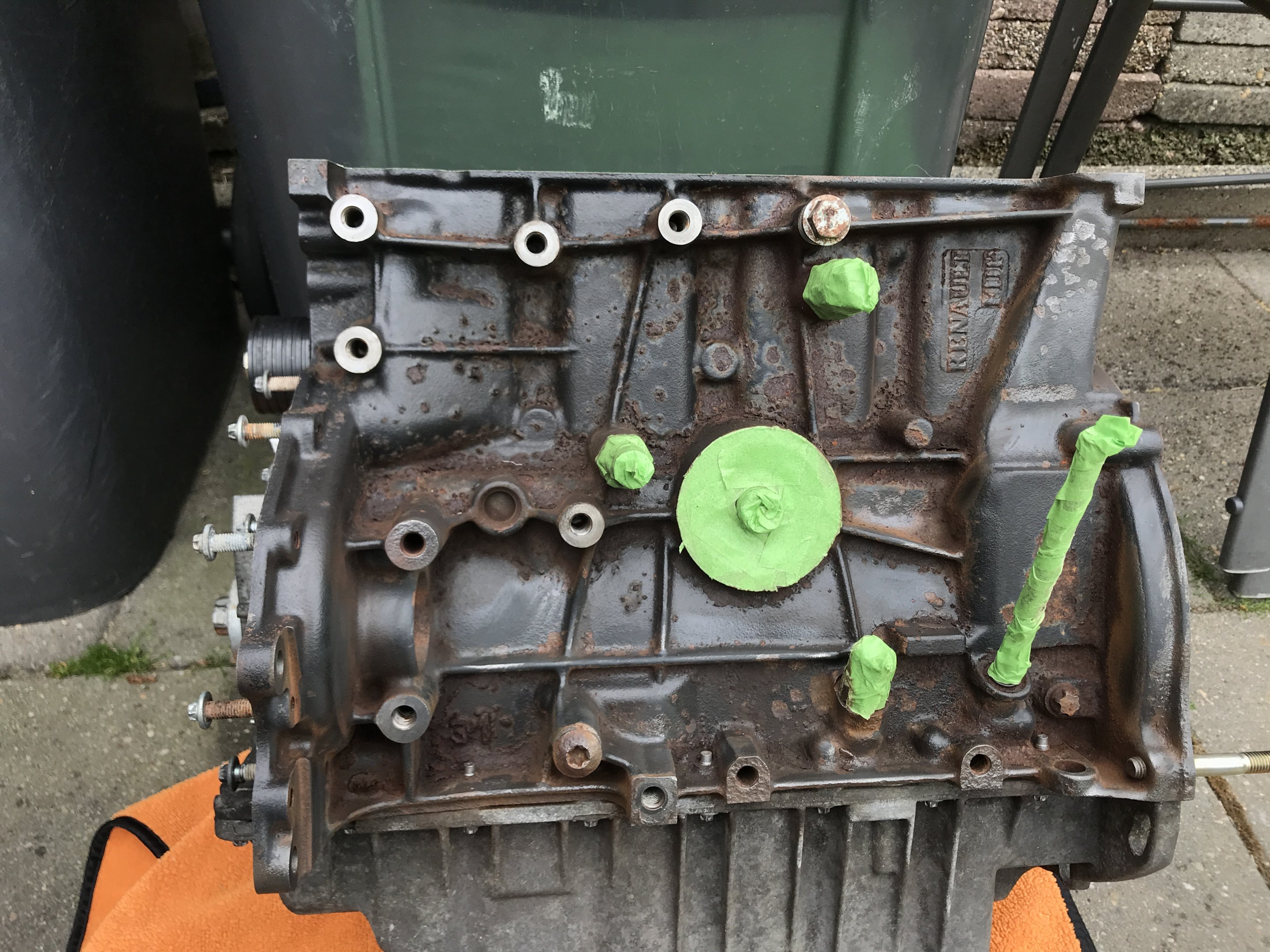

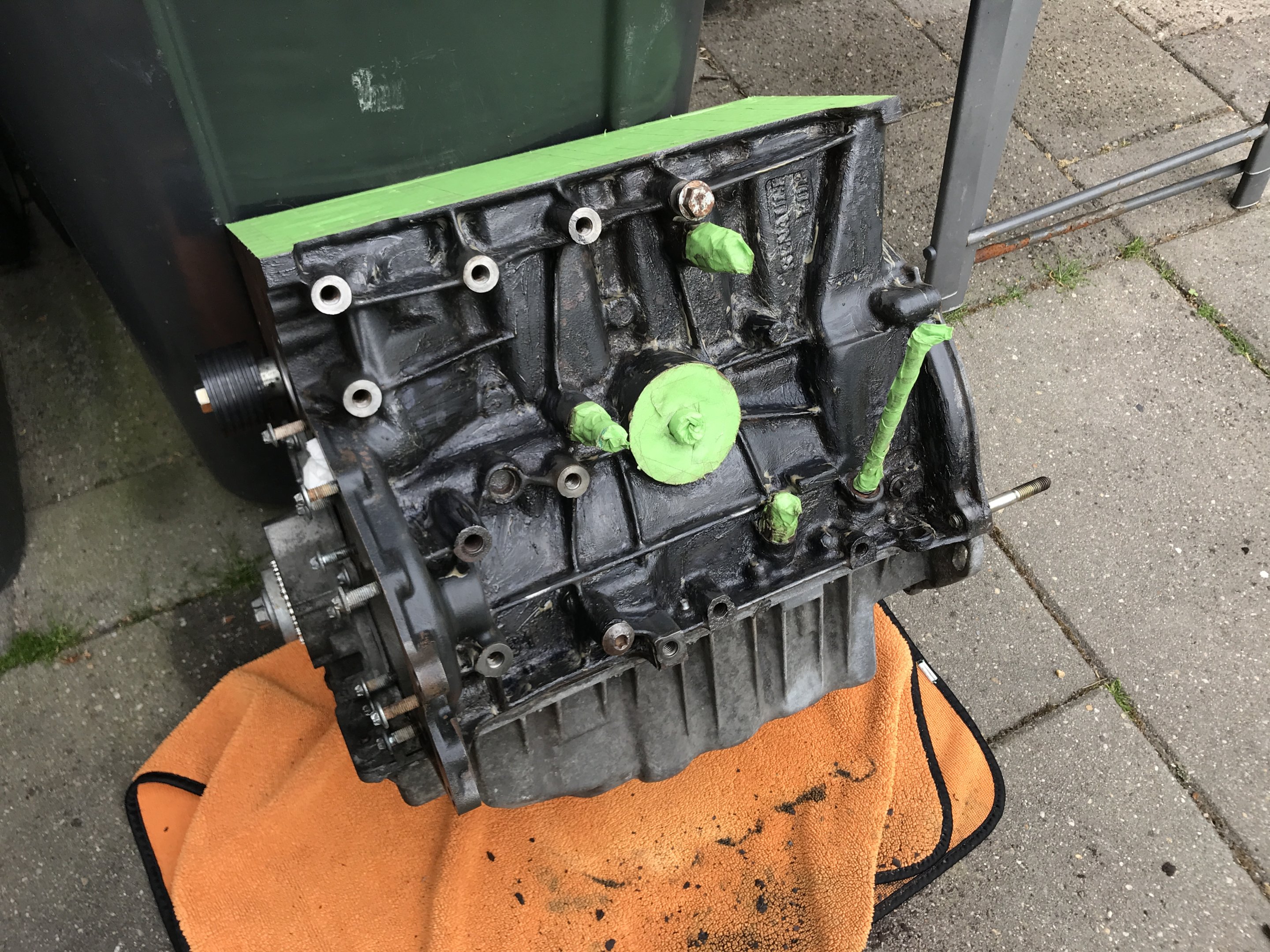

Then started to prep the block for paint. I've seen people put painters tape over the block and then rolling a screw driver over the edges to make the perfect cut so I thought I'd give it a go. It worked perfectly.
The bottom end was quite rusty so it took some time to remove all of it. Used a wire wheel and a wire brush. Never again.... Should've had the block blasted.
After that I put some anti rust stuff over the worst parts.
Painted the block the next day with some flat black heat resistant spray paint. Looks decent. The anti rust stuff kinda makes the "front" of the engine look meh but whatever.
All painted. Much better than the rusty mess.

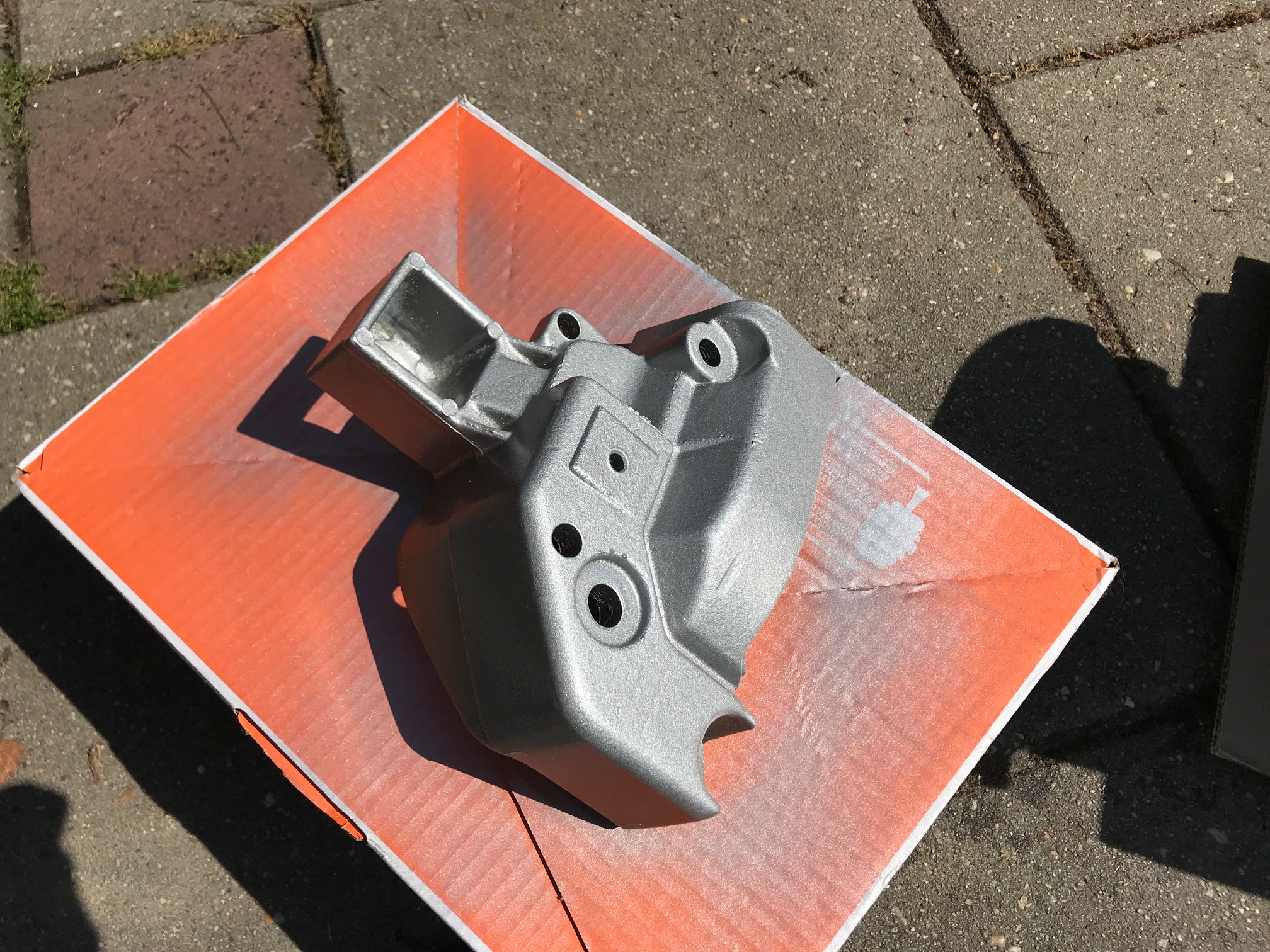

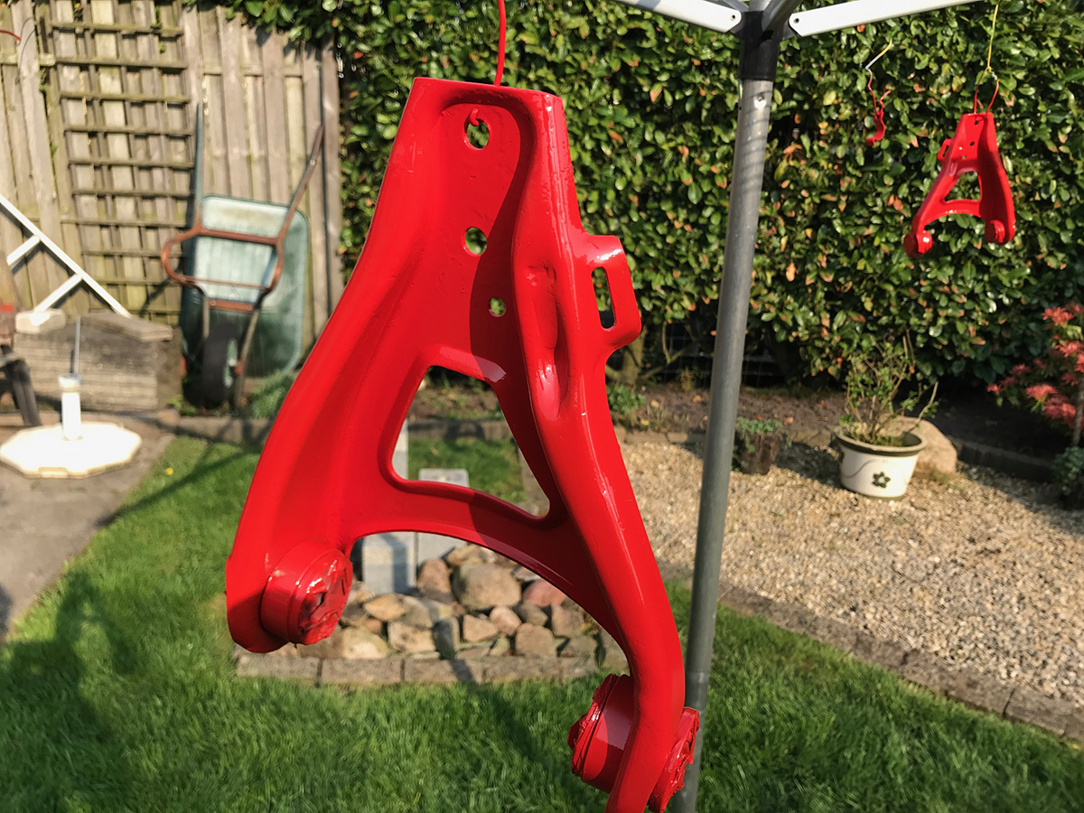

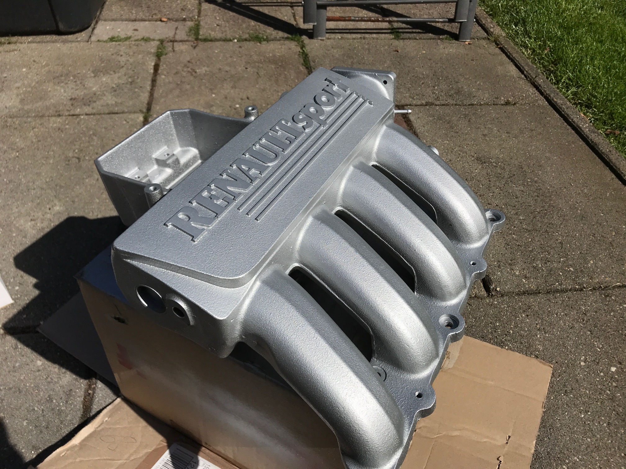

Meanwhile I did some painting on some parts to make it look nicer.

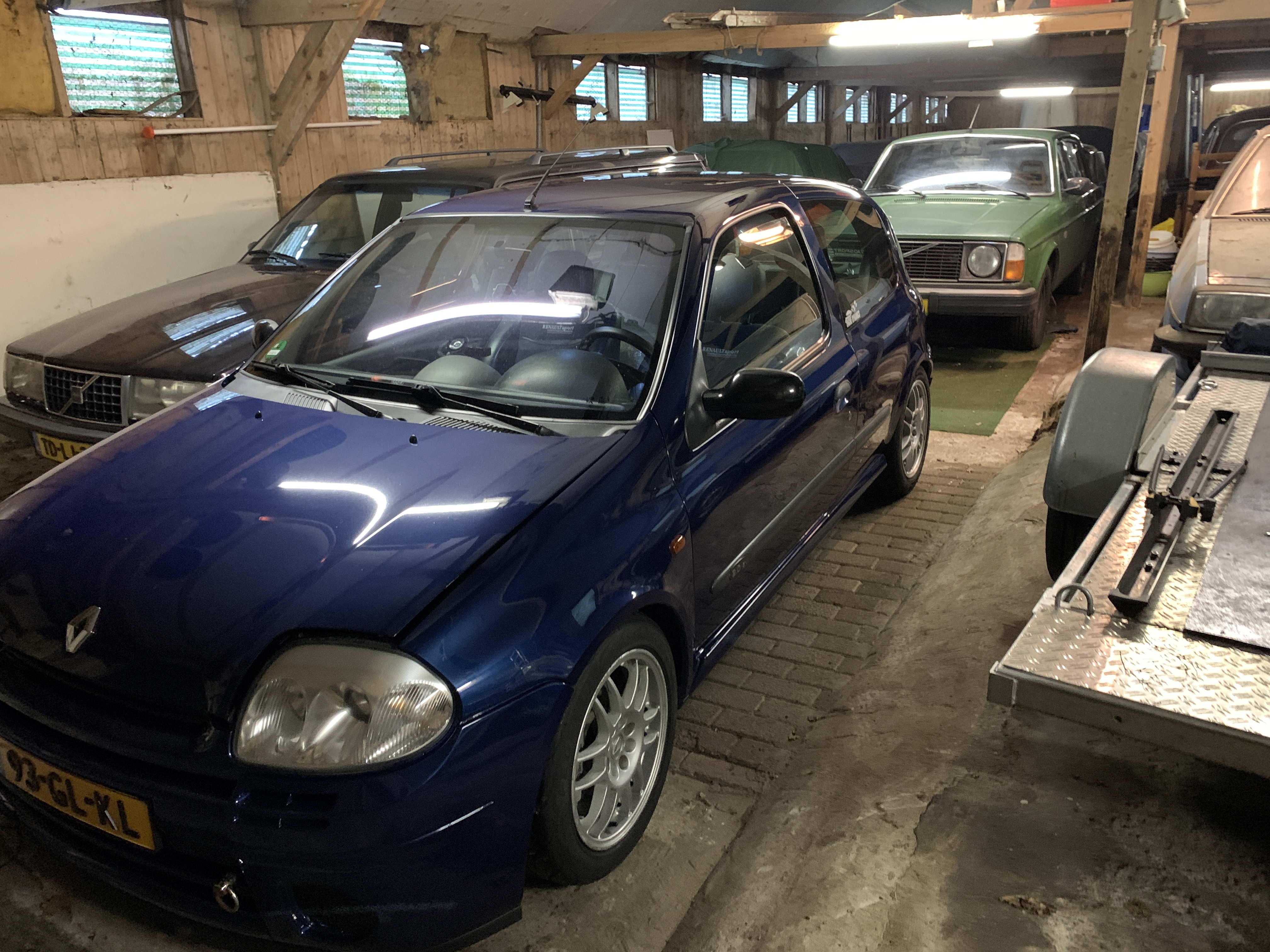

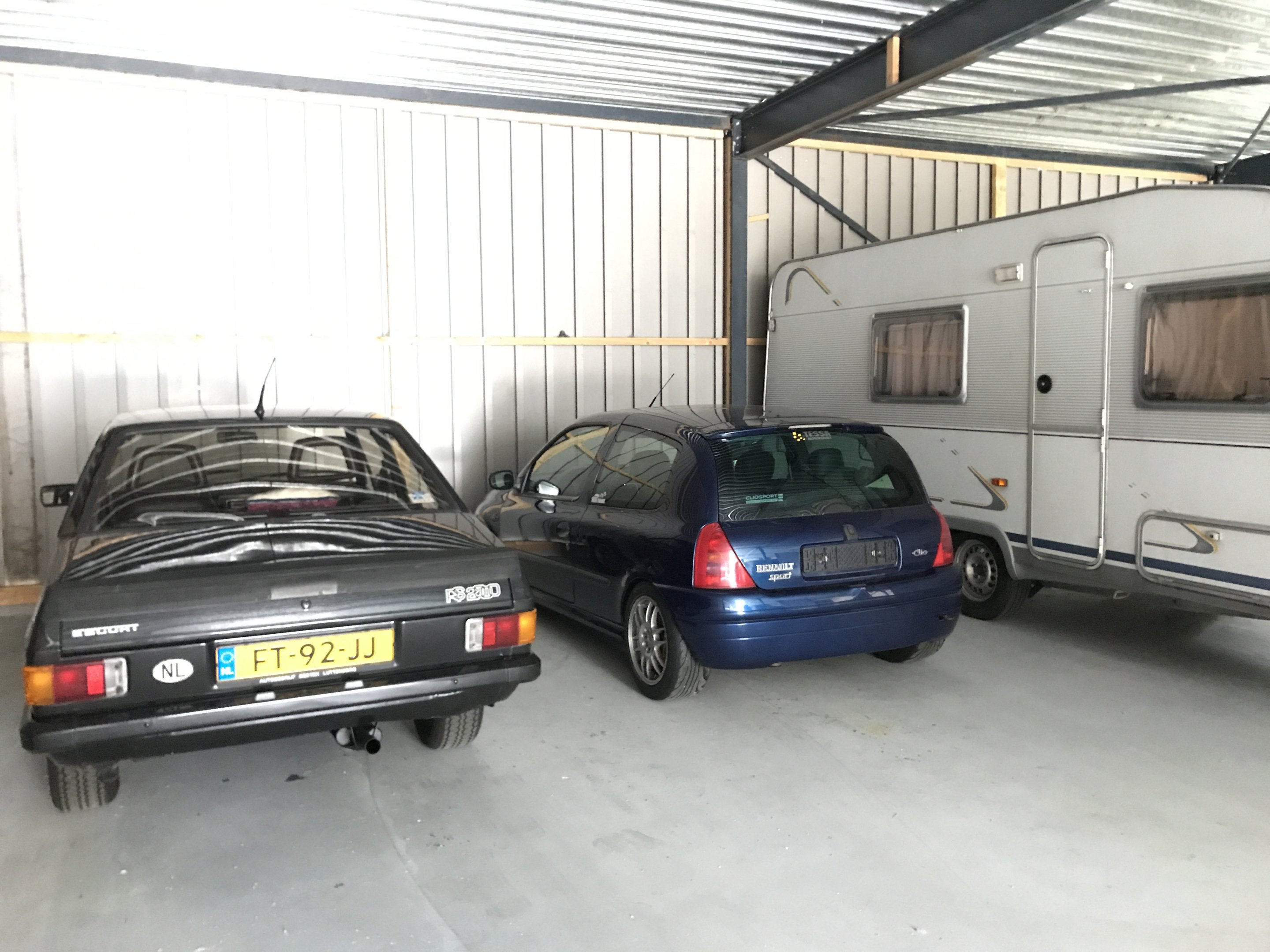

Really lost interest in this. What a ride it's been. Parked the Clio in storage and wanted to forget about it but started watching some old clips of it on track and ugh, I just need this stupid french pos back in my life. So lets start on the basics...

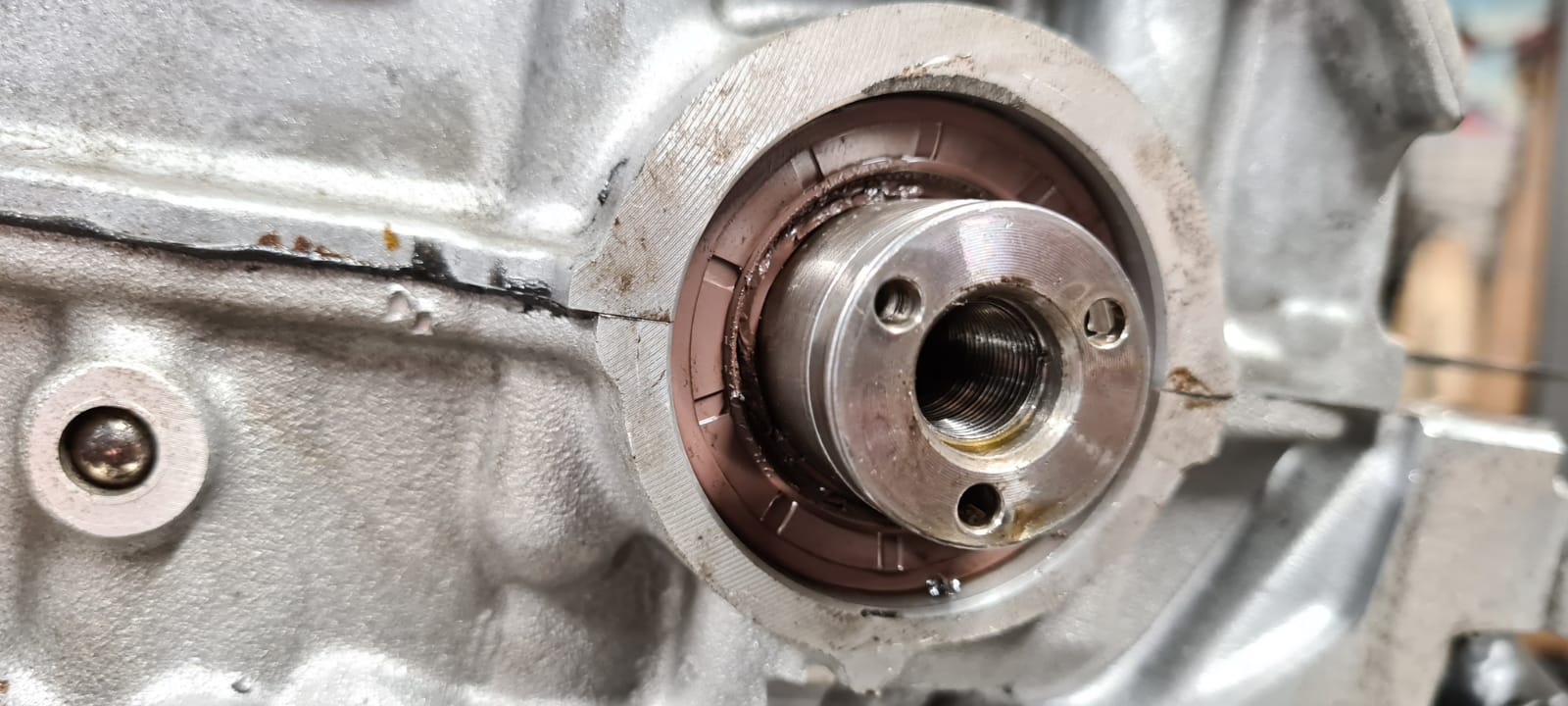

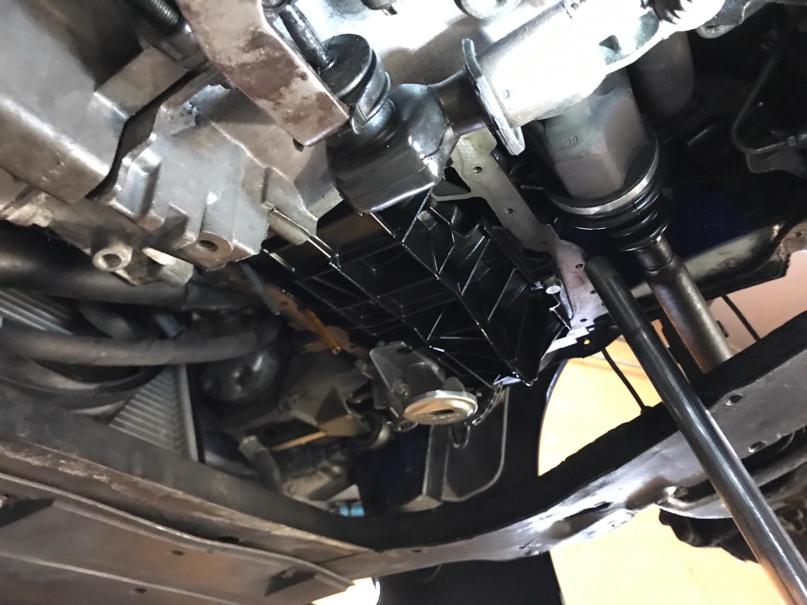

The sump was cracked so that was up for today. It leaked so bad I had it parked up without any oil in it since the last post.
Surprisingly we didn't strip any of the bolts but even with the engine jacked up we couldnt get the sump out. Decided to loosen the subframe on the passenger side (UK drivers side) to get one or two more extra centimeters. This did the job and we could wiggle it out. Looked nice under there, which isnt too strange since it's only been driven for 1000km after the rebuild. No sealants or anything in the oil pickup so atleast we did something right during the rebuild.
Buttoning everything back up was a much simpler process. After putting fresh oil in it, it started right up. Drove it for a tiny bit on some private property and everything seems to be alright.

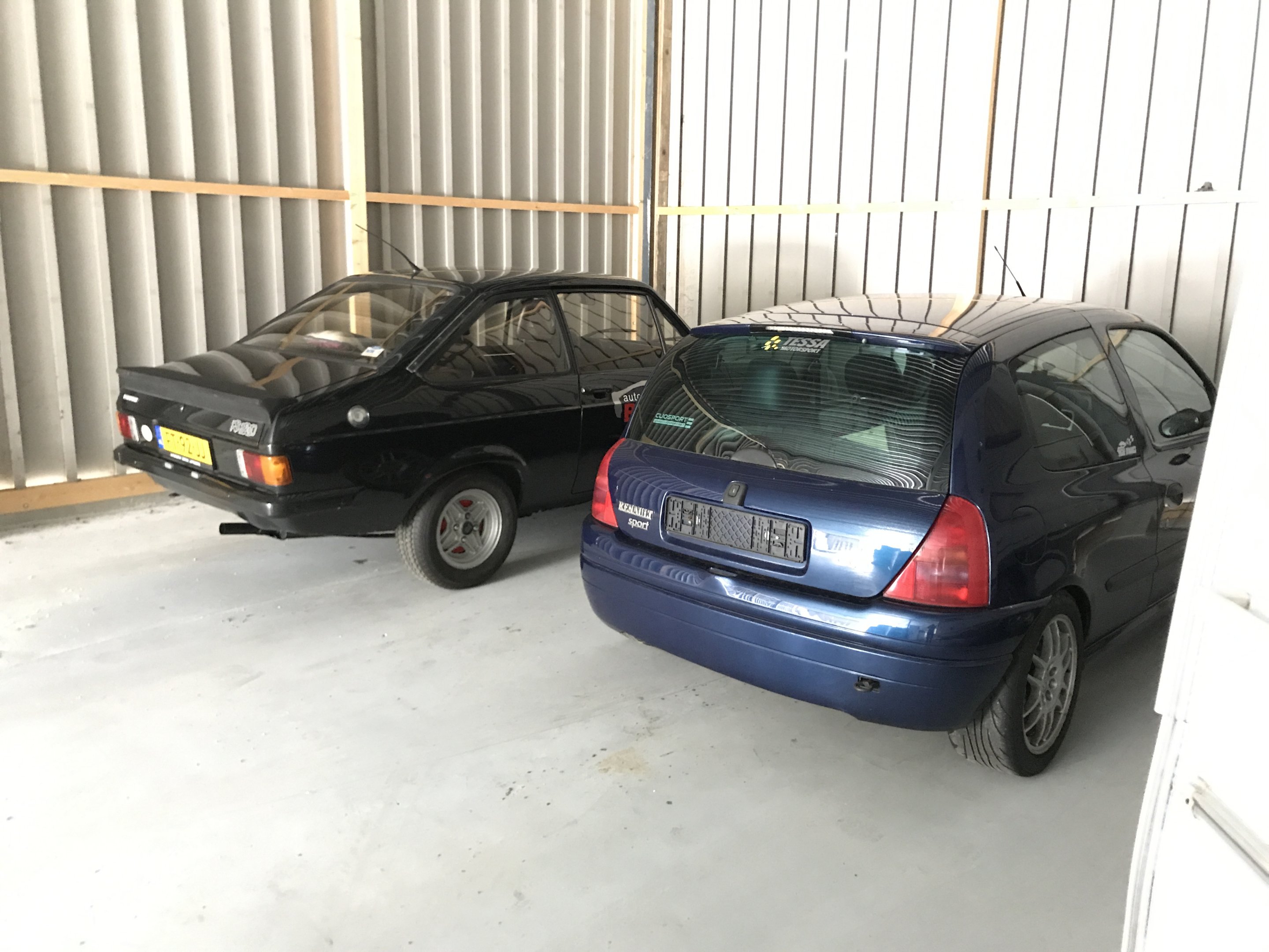

The car is back in storage now. Been really busy with a lot of things and have a few holidays planned so can't really do anything to it. Main thing now is the valve cover leak and broken gearbox. Will sort that sometime early next year just before the season starts again.

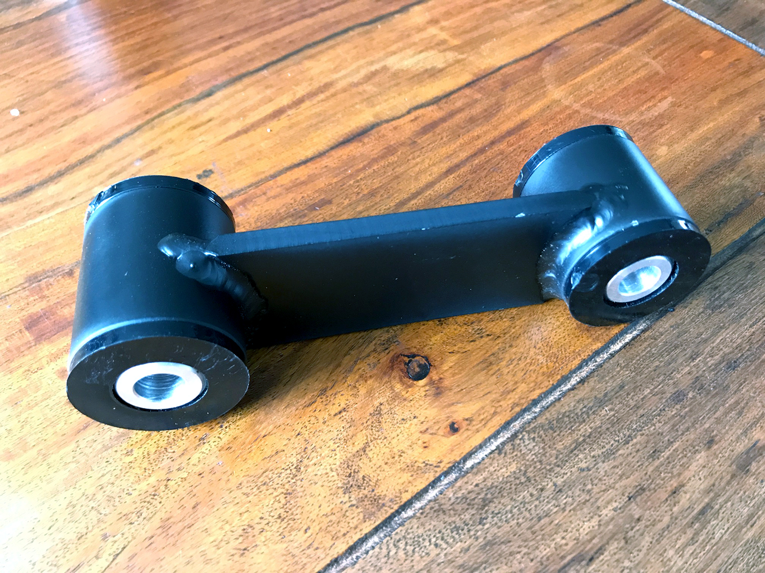

Install keyed crankshaft pulley

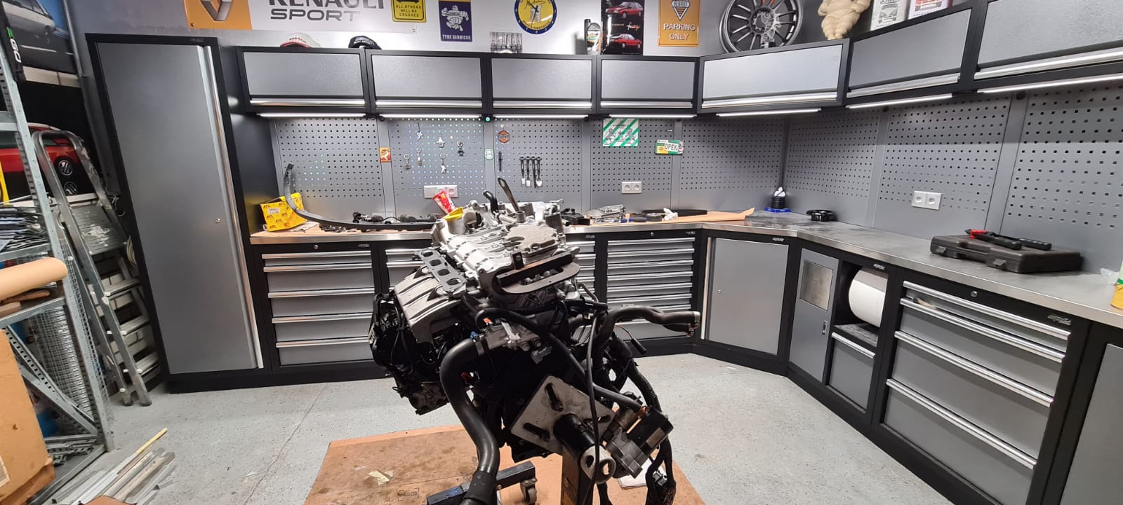

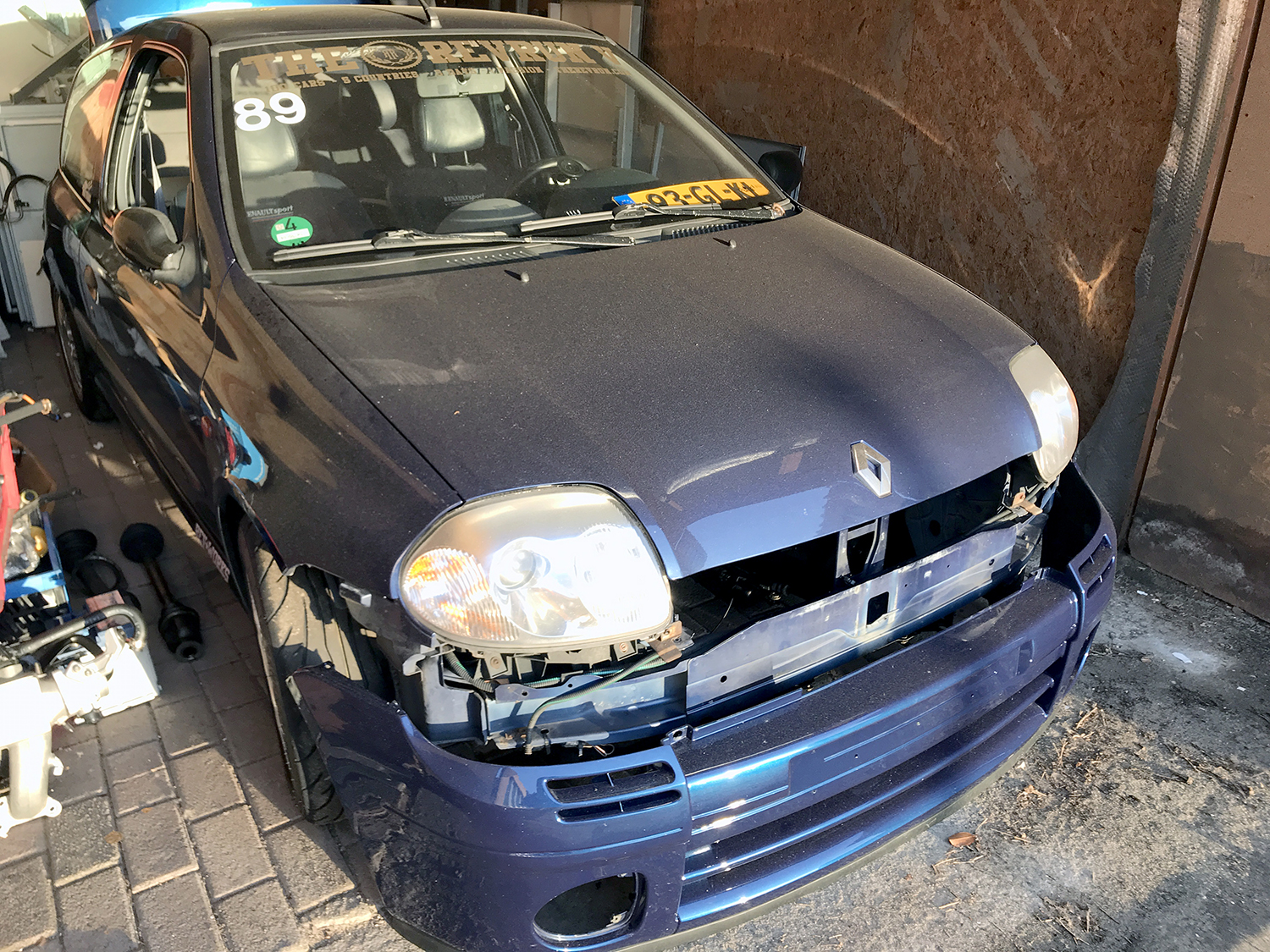

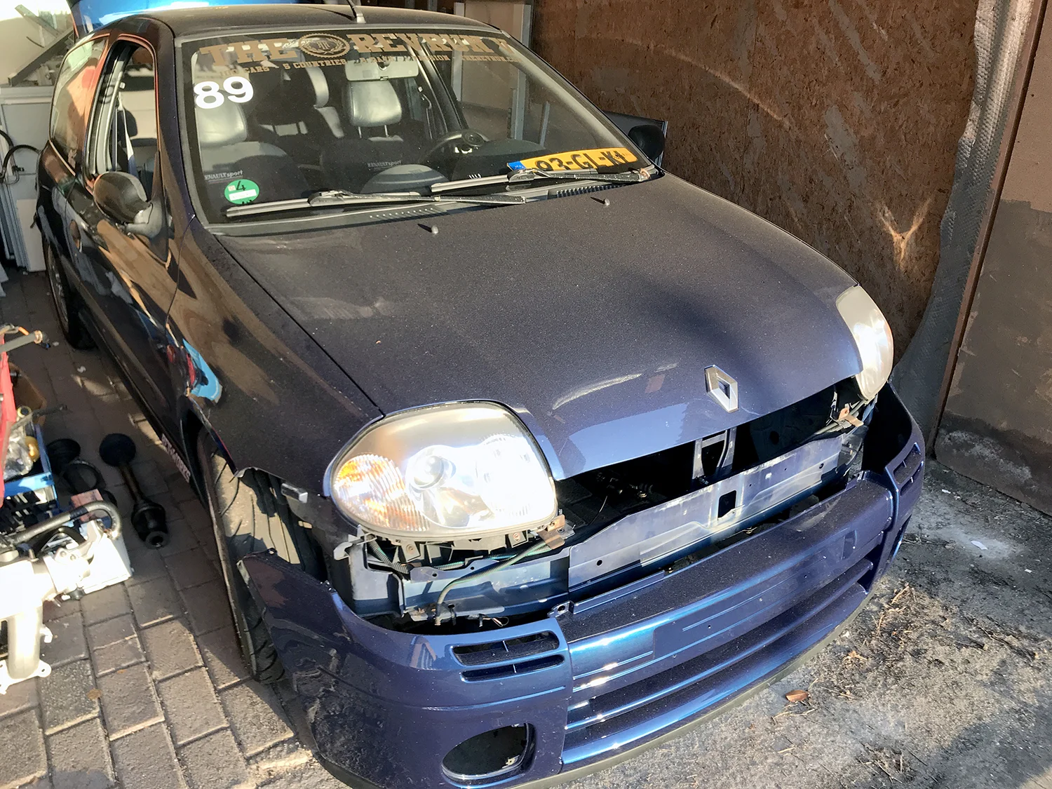

So there's actually stuff happening now which is very exciting. Below a pic while the car was being strapped down.
There's stuff happening in the background. Engine is out again and there are a few things that stood out. The wrong type of sealant was used for the valve cover, one cam seal was completely destroyed and the starter motor wiring is getting too hot because there doesn't appear to be a heat shield (looking for this!!)
Here are some pics:
I've got a fresh gearbox that will be going in, ordered 4 new semi slicks (Federal 595RS-PRO), flywheel is going to be lightened and resurfaced just a tiny bit and I've found a new cambelt cover since one of the threads was stripped.
Good things are happening. Will update when there's more to share.

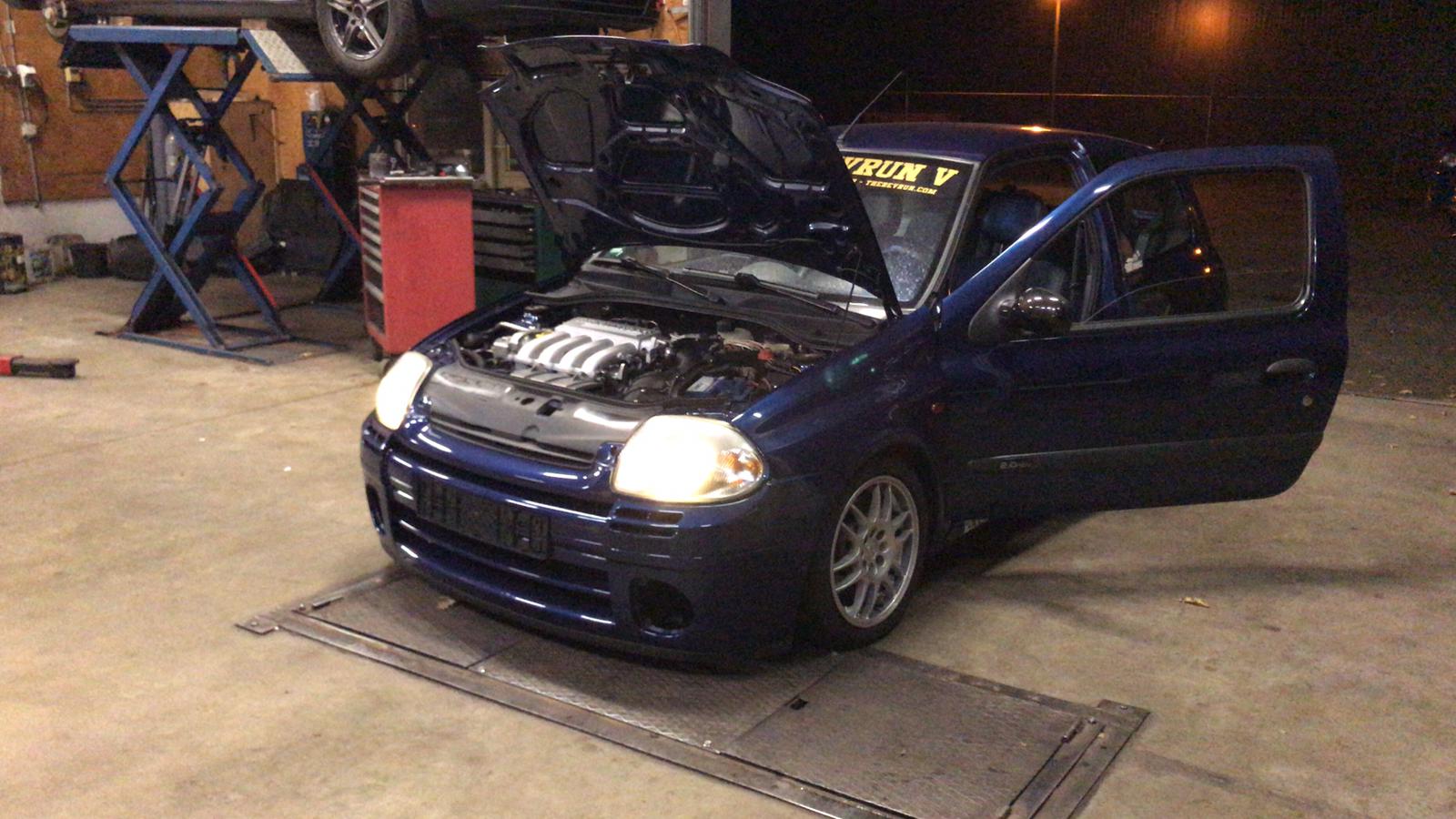

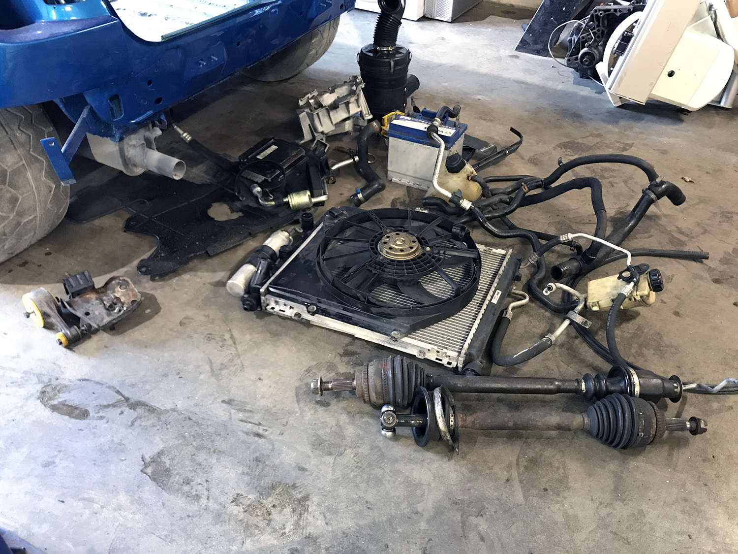

Well it only took 2 years but she's back! The following has been done since it was last on the road:
Engine out again
All new seals in top end
New timing belt
Keyed crank pulley installed
Renault rebuilt gearbox (low miles, tried and tested)
4 new Federal 595RS-PRO tyres
Wheels balanced
Alignment
Oil and coolant
Good once over
Engine bay tidy up

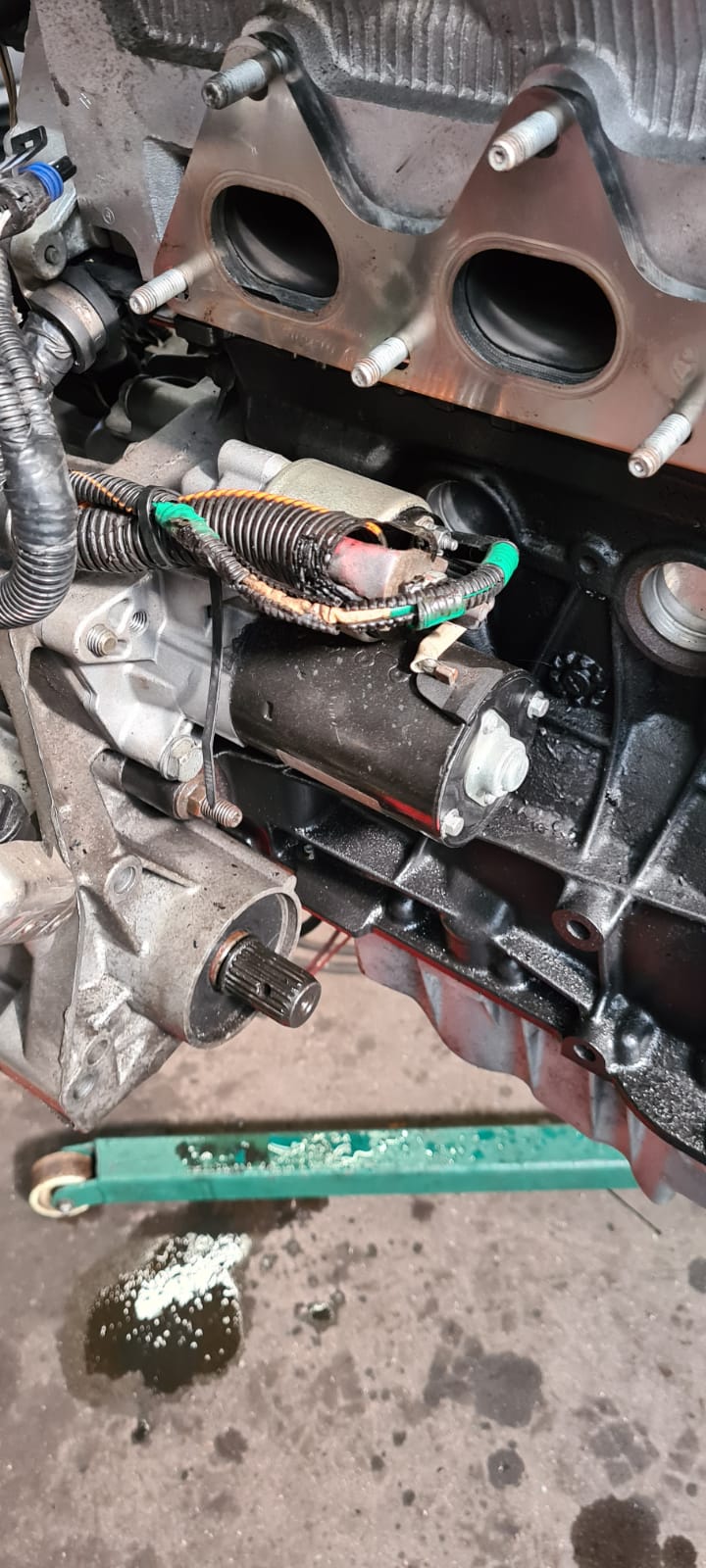

OEM starter heat shield installed
APK (MOT for you guys)

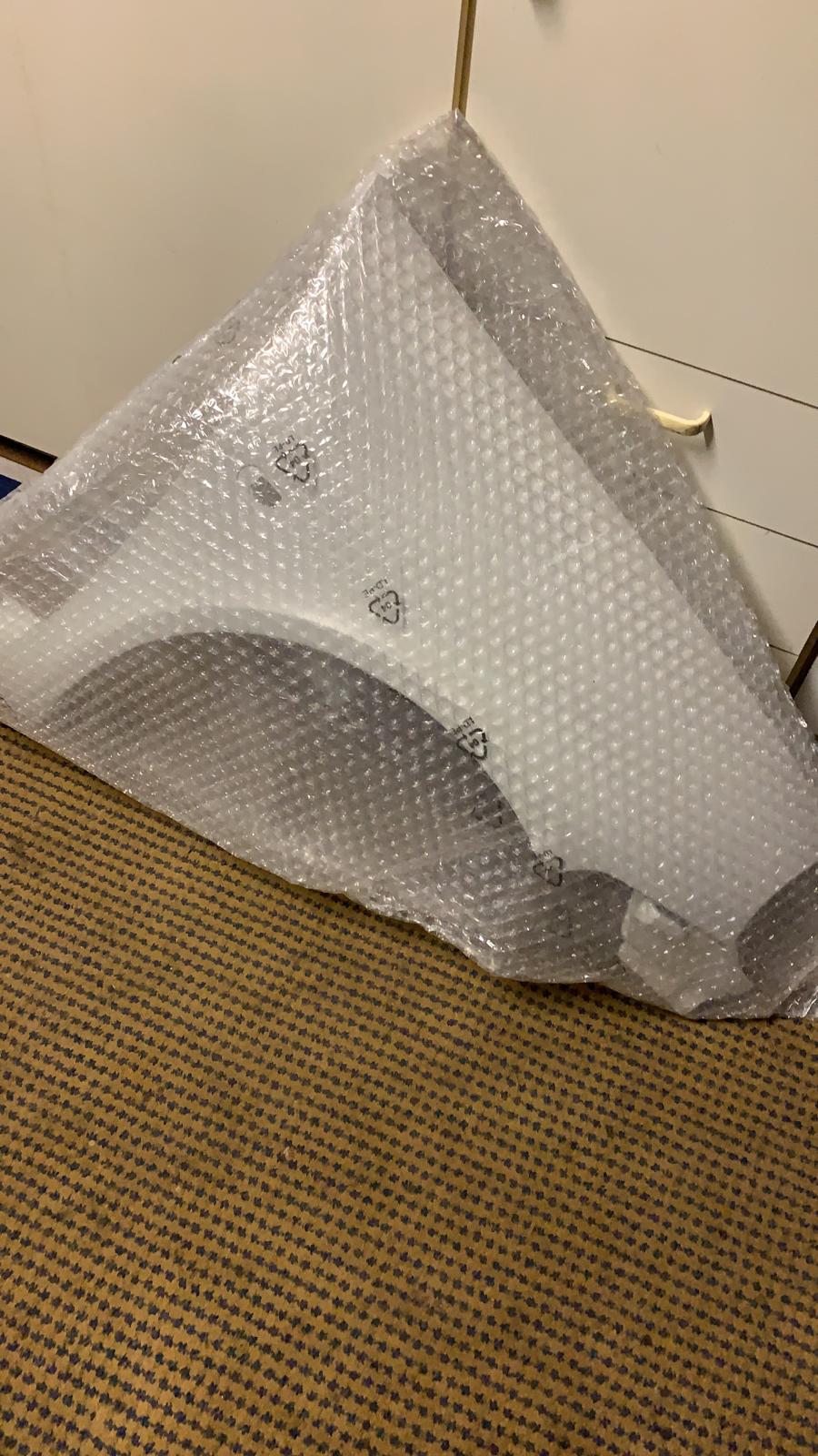

I've also sourced a brand new ph1 172 front fender for only € 140,- . It's unpainted and straight from Renault. Never opened. My front right fender has a small crack under the side repeater so I figured I might as well get a new one since I could get my hand on one.

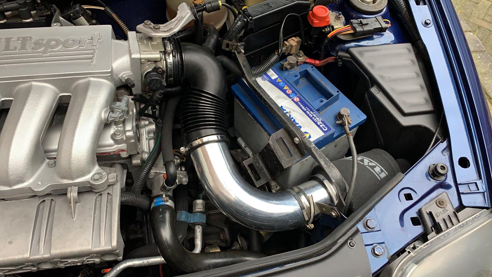

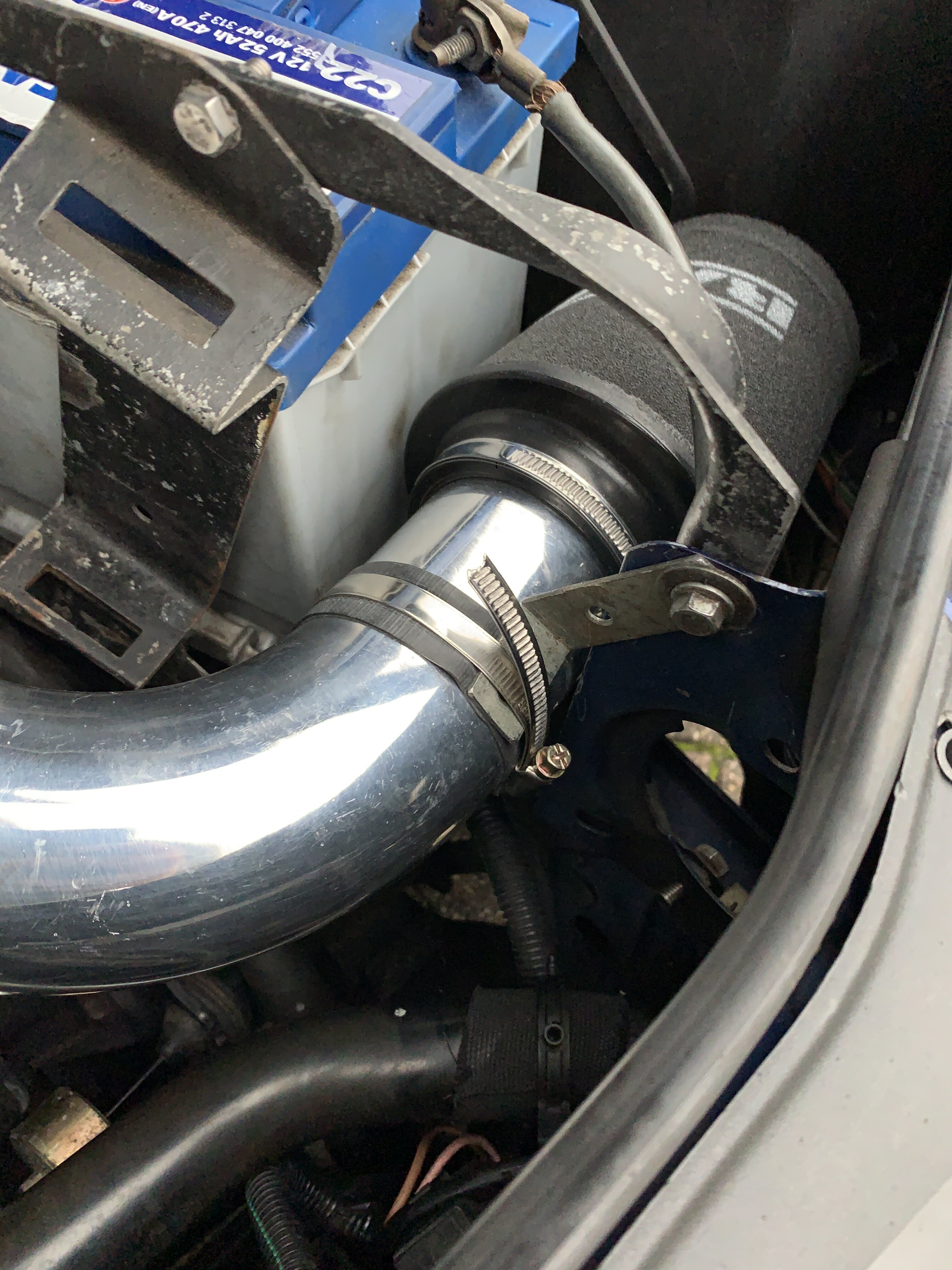

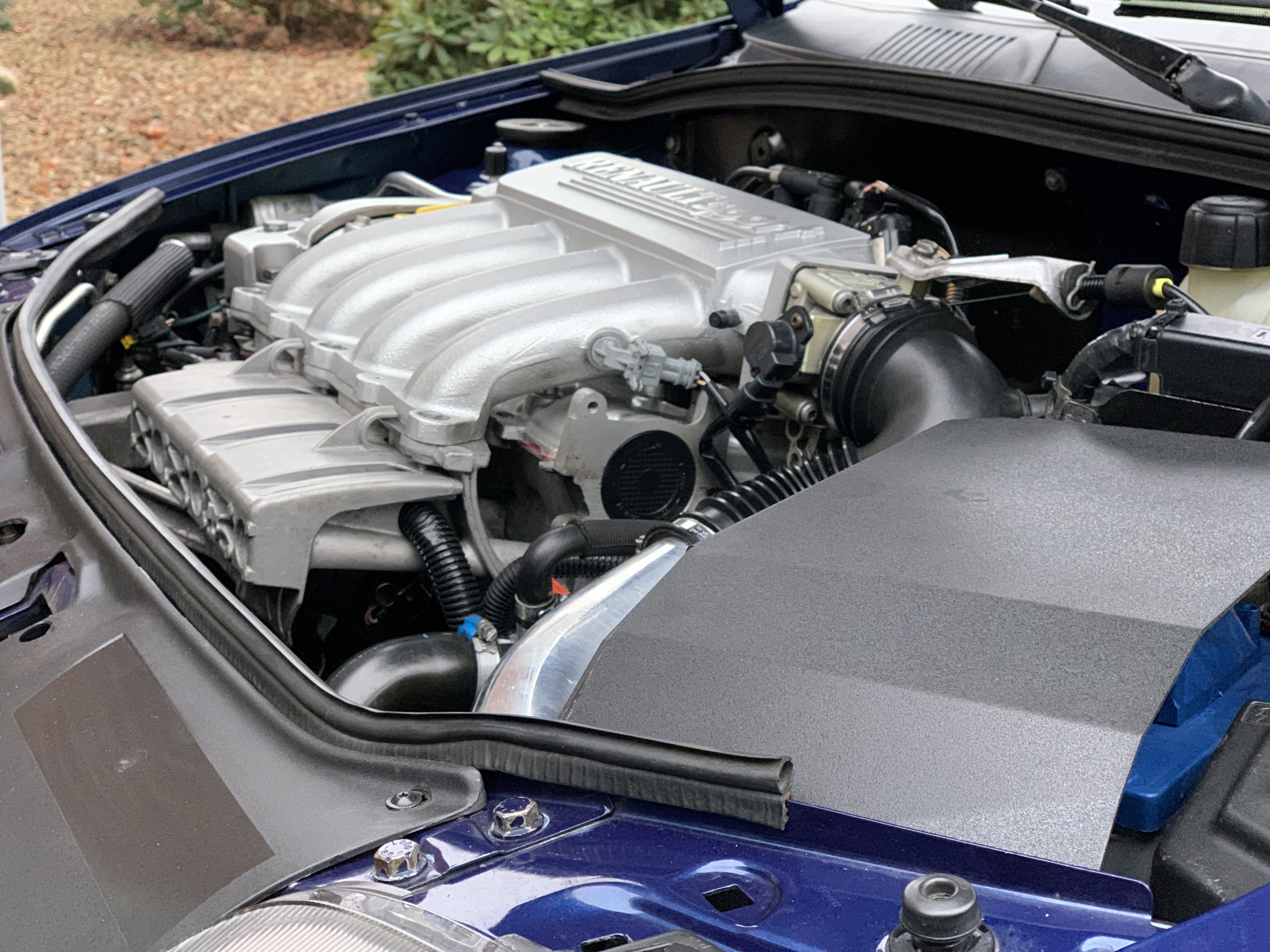

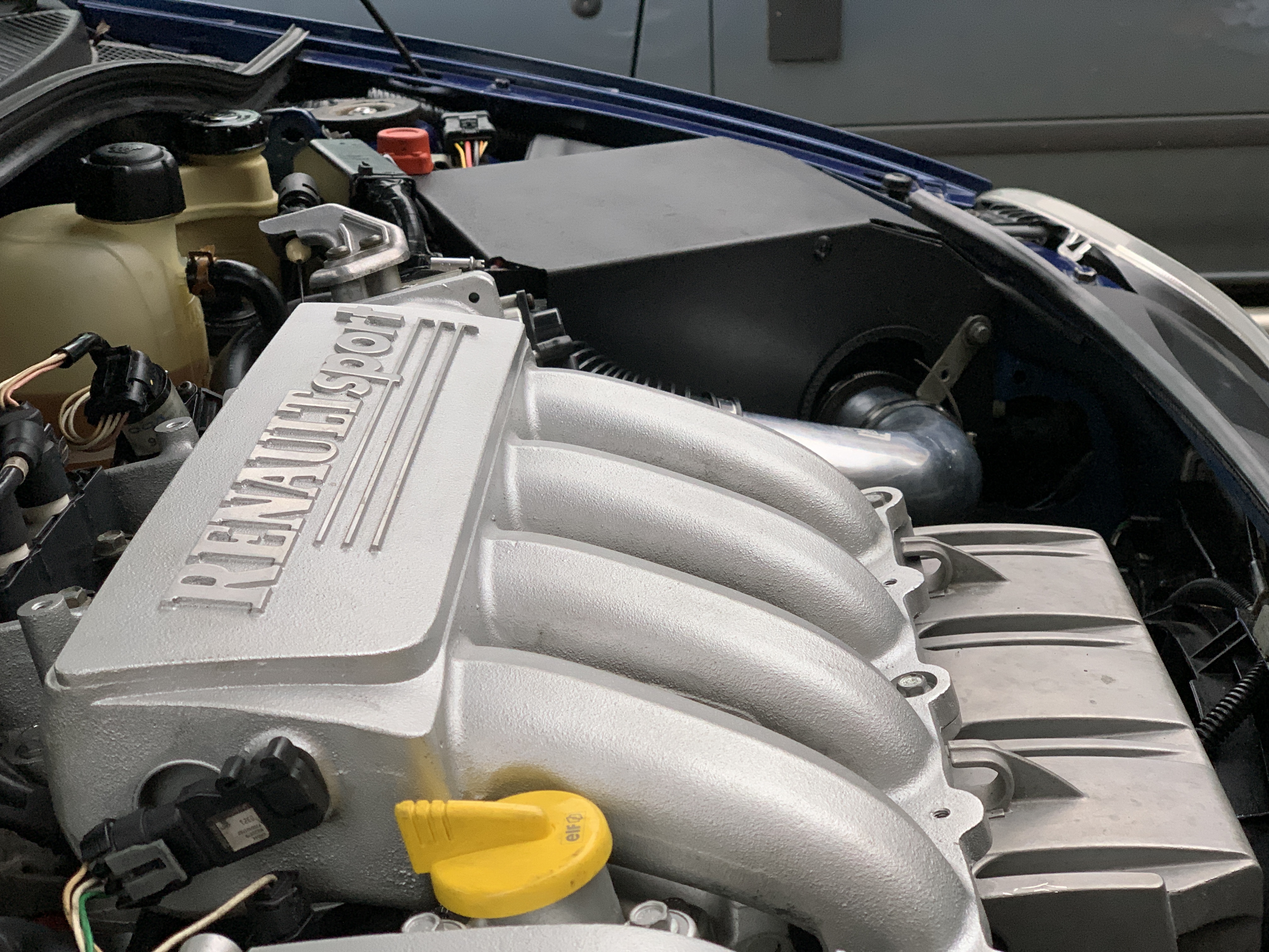

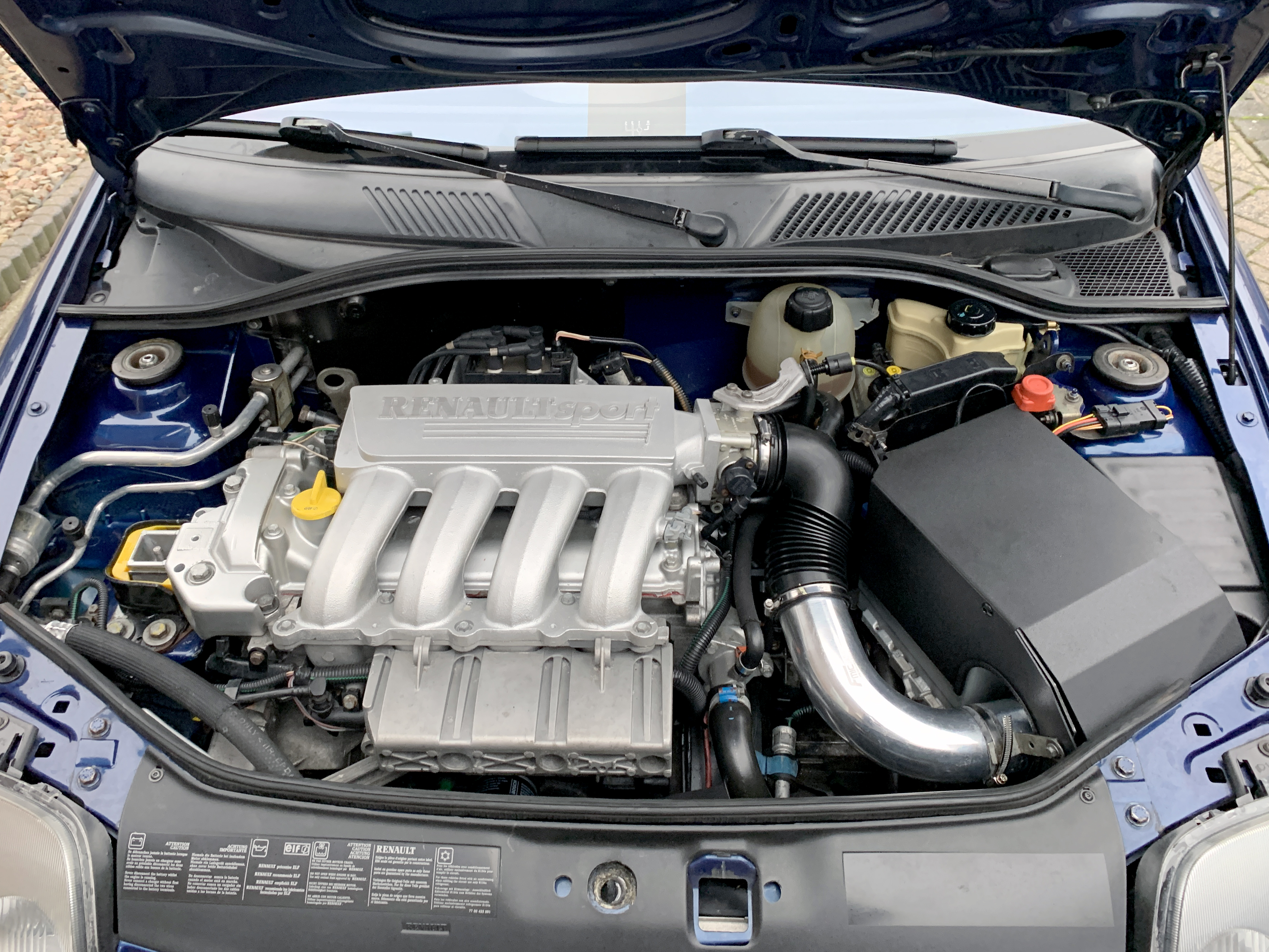

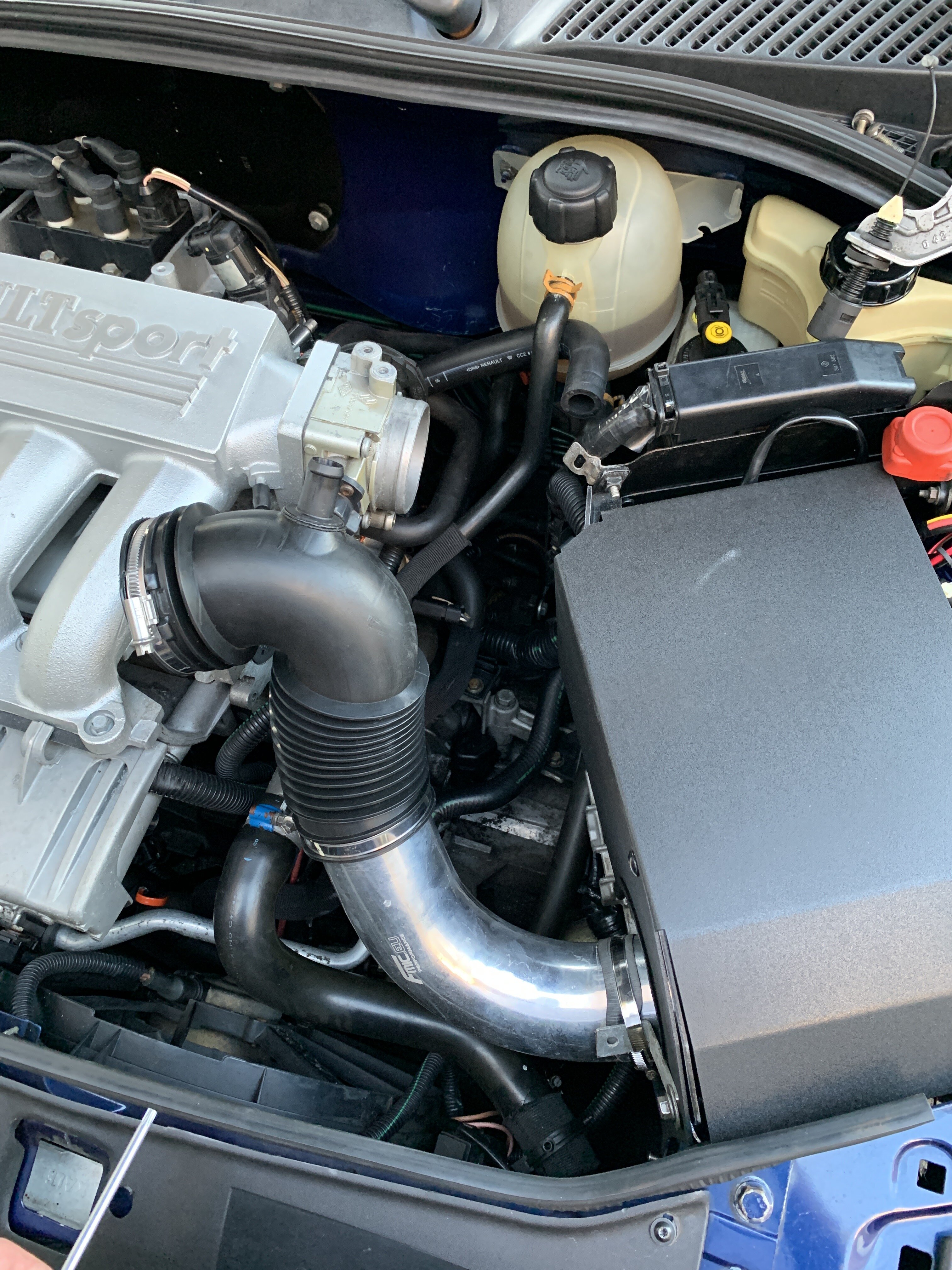

"Fatty" induction installed. Make a simple L bracket to support the 90 degree bend. The sound is alright but I feel like I'll get bored of it quickly.

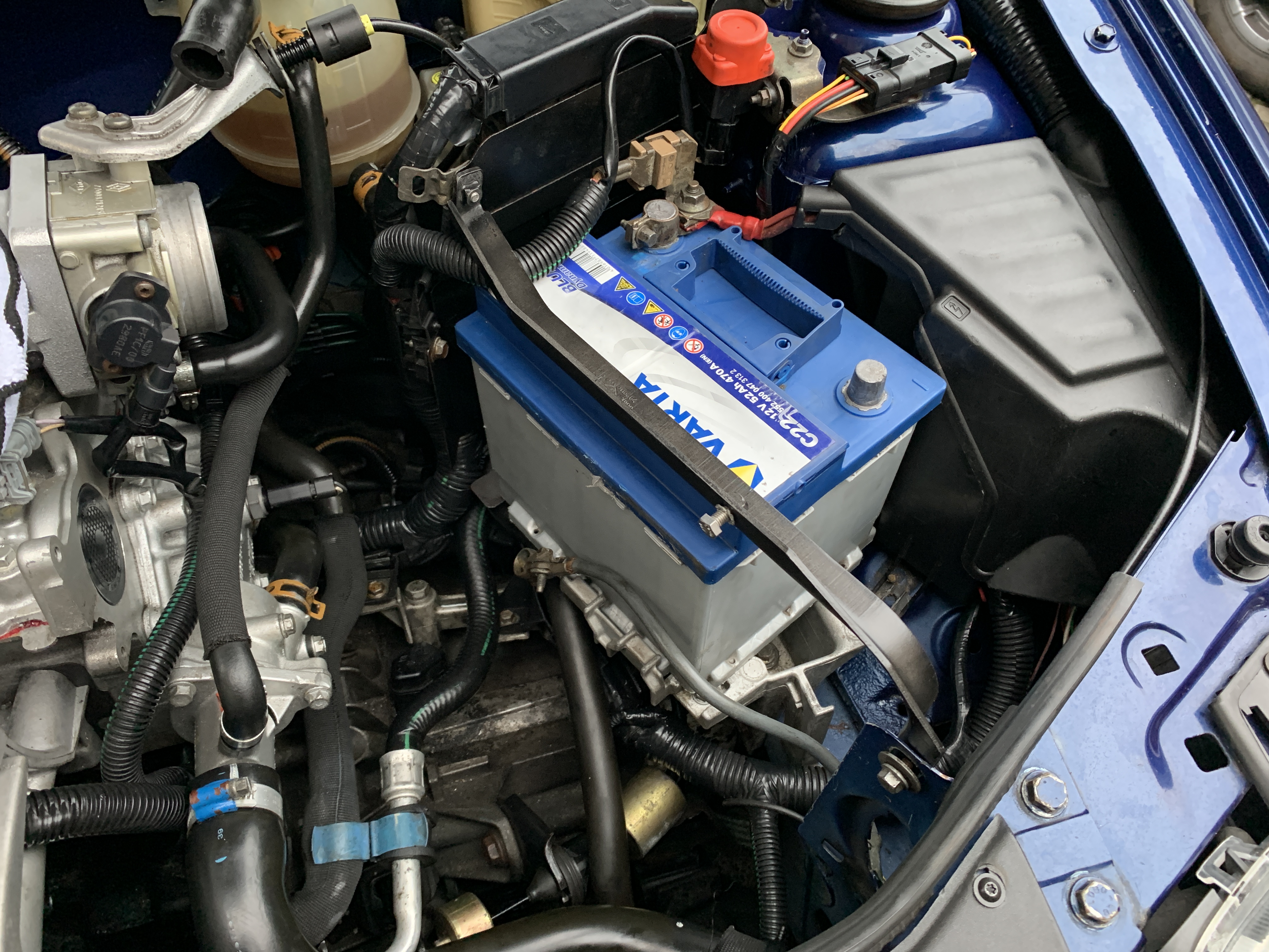

Installed a battery and intake cover. Also painted the ECU bracket and whatever that other bracket that goes over the battery is called. Also give some stuff a bit of a clean.

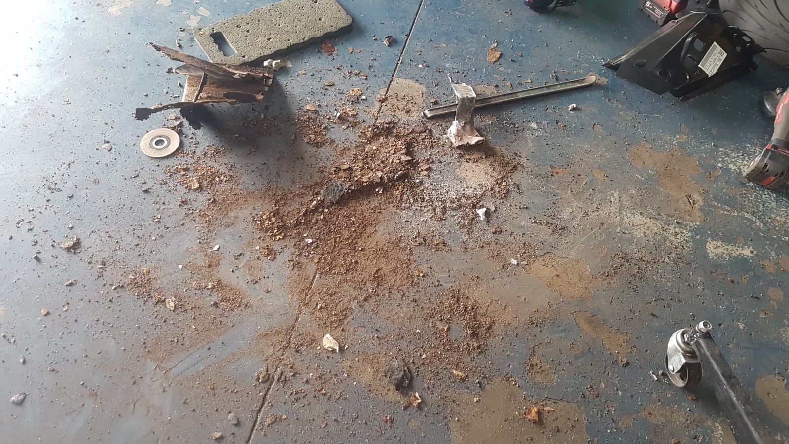

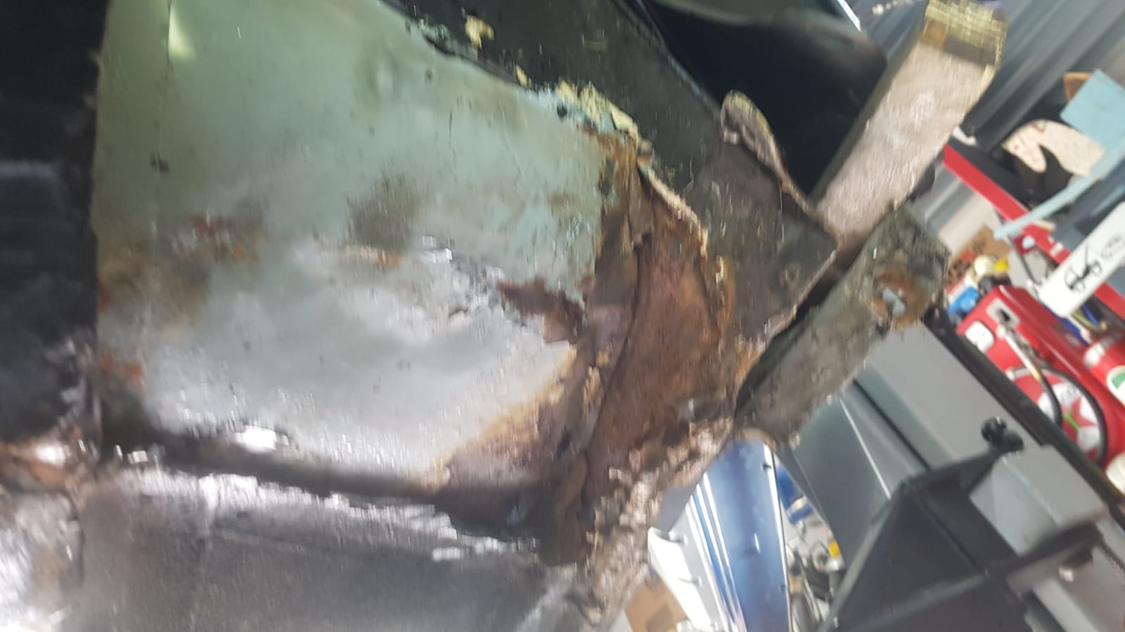

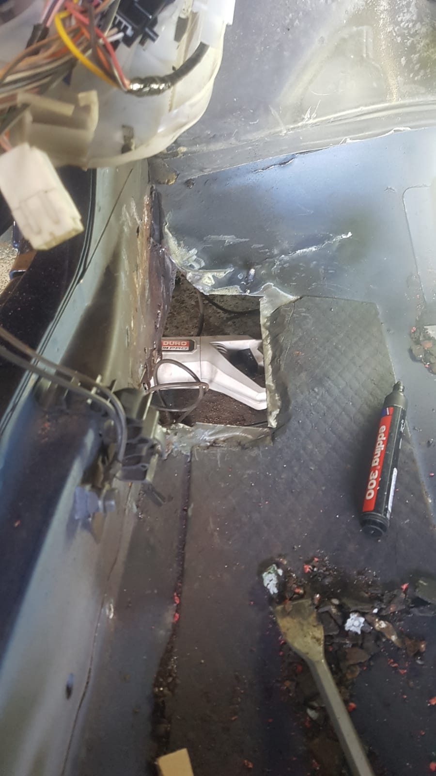

Another issue I had with the car was rust. Someone dented the floor while improperly jacking up the car and it was never fixed properly by the previous owner. A new piece from Renault will soon be welded in. Since I have no clue on how to weld properly I'm having some else do it. I'm also having new PowerFlex black rear beam bushings installed since mine had some play in them.

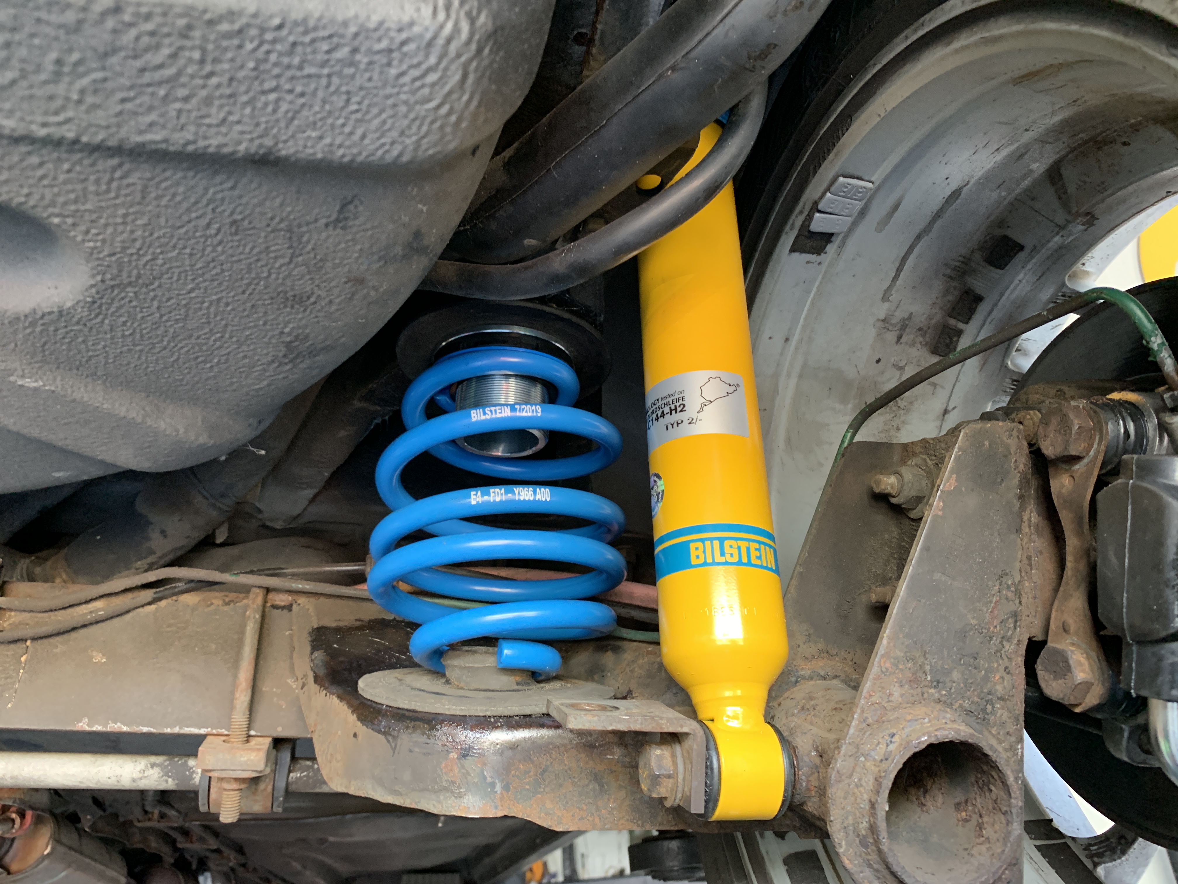

Managed to scoop up a brand new Bilstein B14 set of coilovers for the Clio from Autodoc for only 673 euro's. That's 580 pounds. Great deal. The funny thing is that on the website it was listed for 750 euro's, and through the app it was 673 euro's,

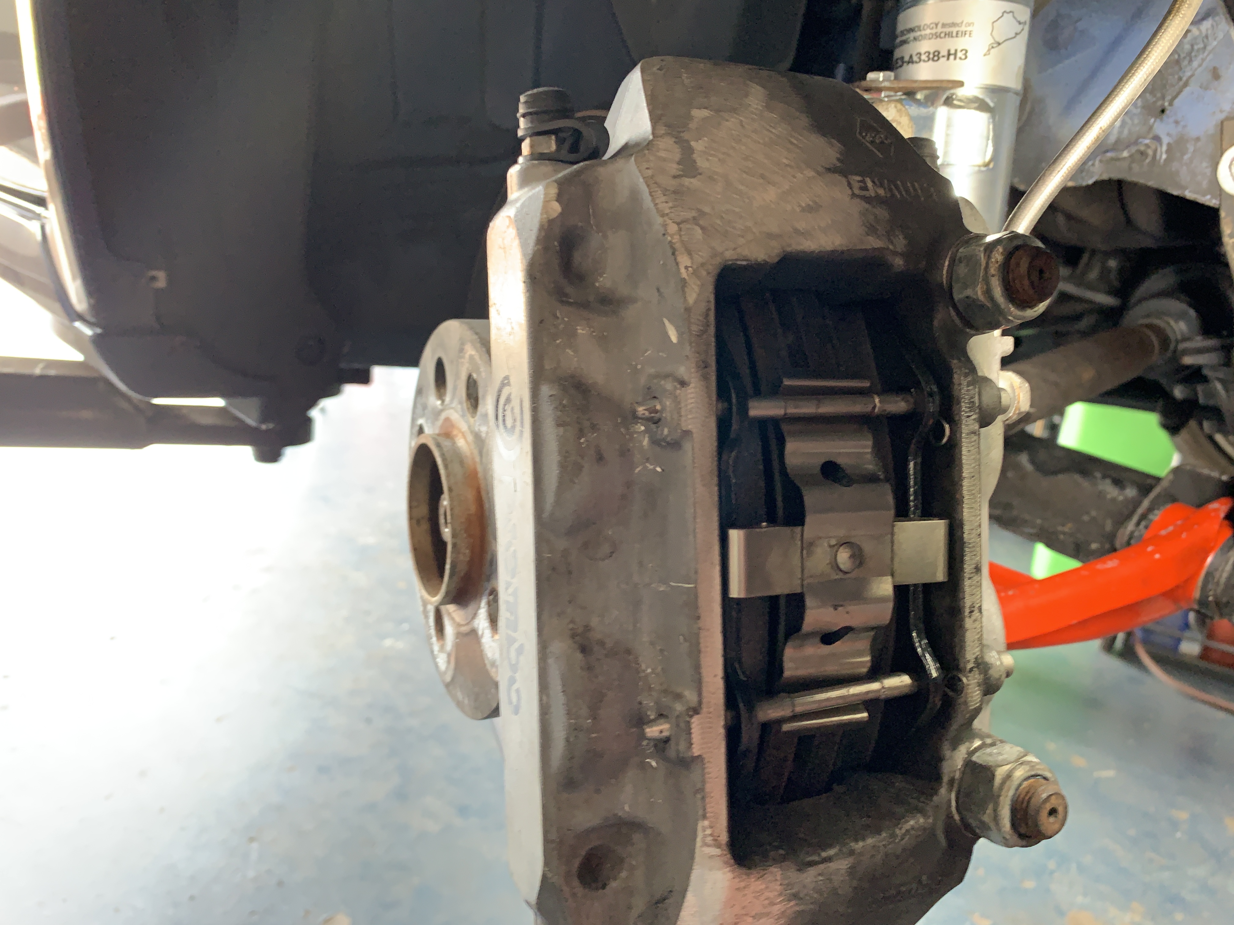

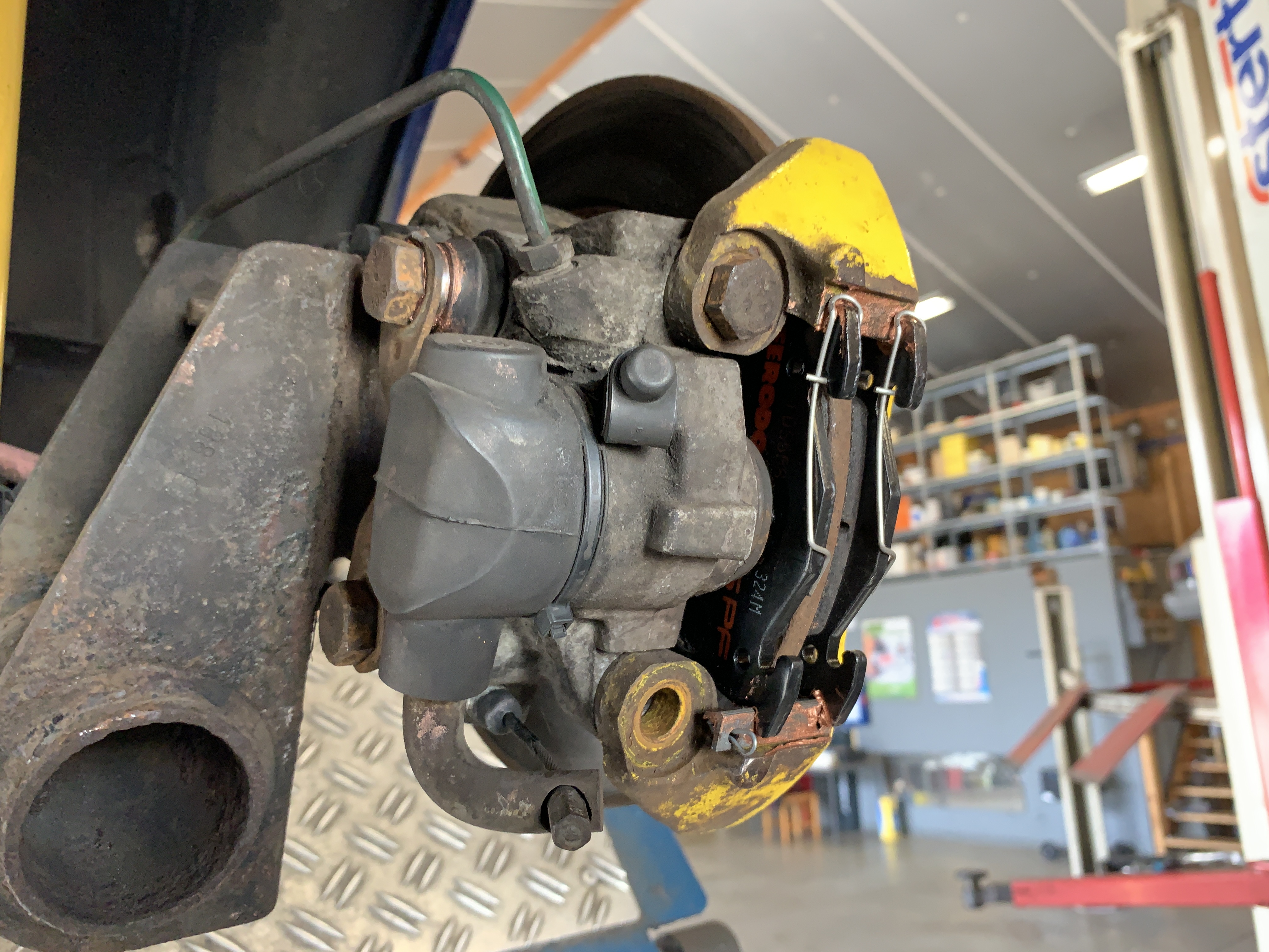

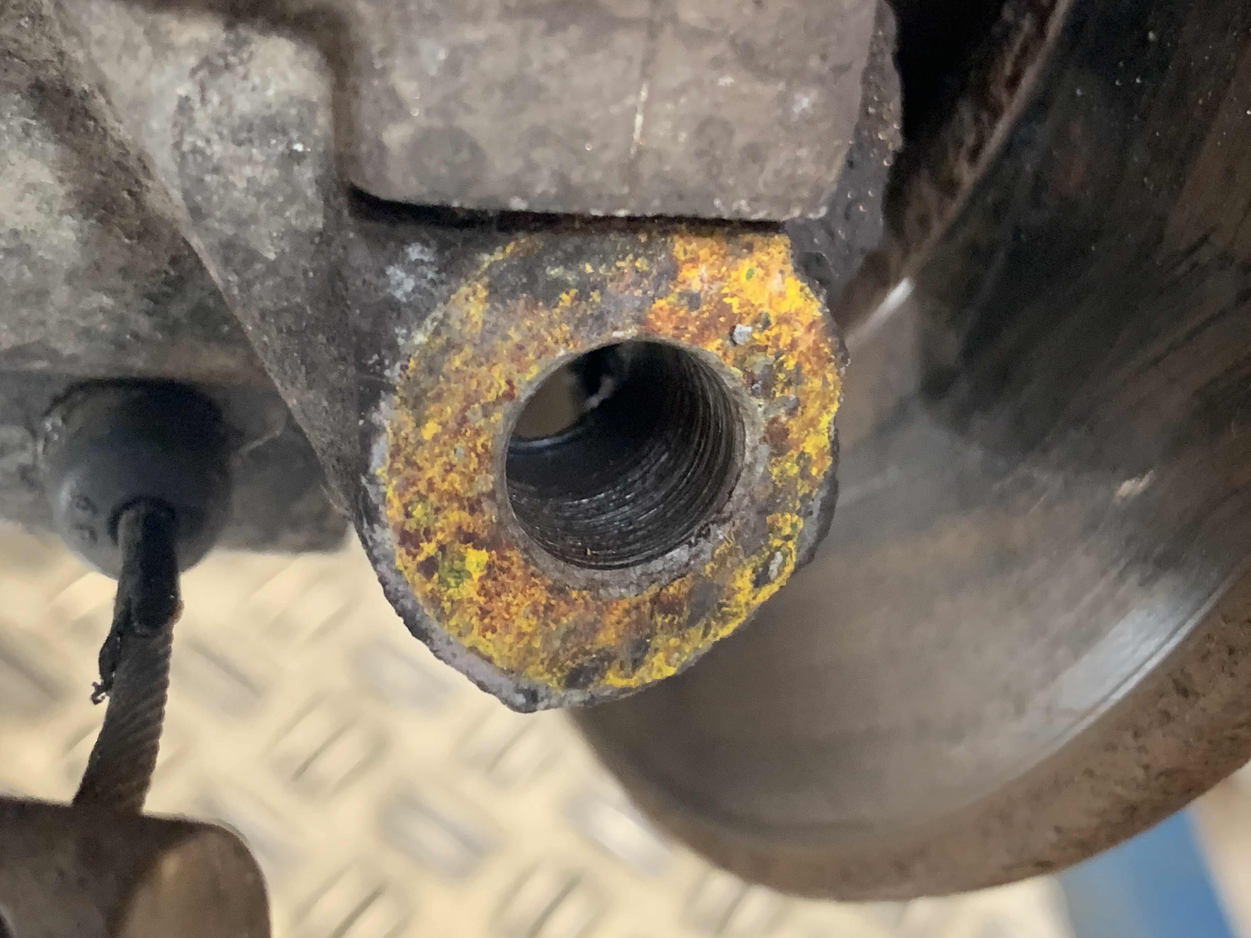

Put the Ferodo rear pads in. Stripped one of the threads on the right rear caliper........ Turns out someone has already been in there before and it was already tapped once with a larger bolt put in so no point in trying to fix it. Going to put a new caliper on soon. Thinking I might as well just do both sides.
Sliders were also seized on both sides but got them loose eventually.

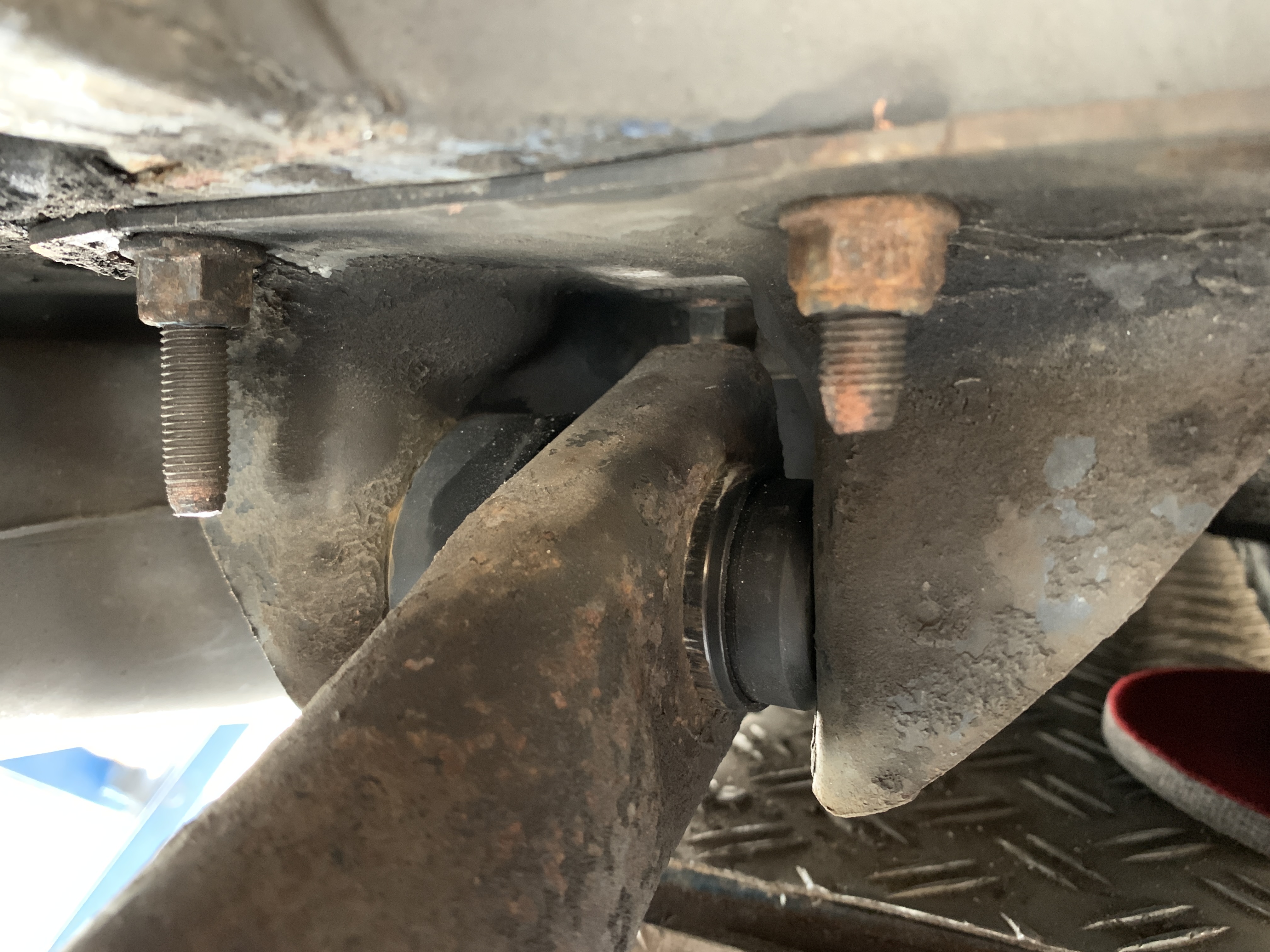

Powerflex black rear beam bushings:

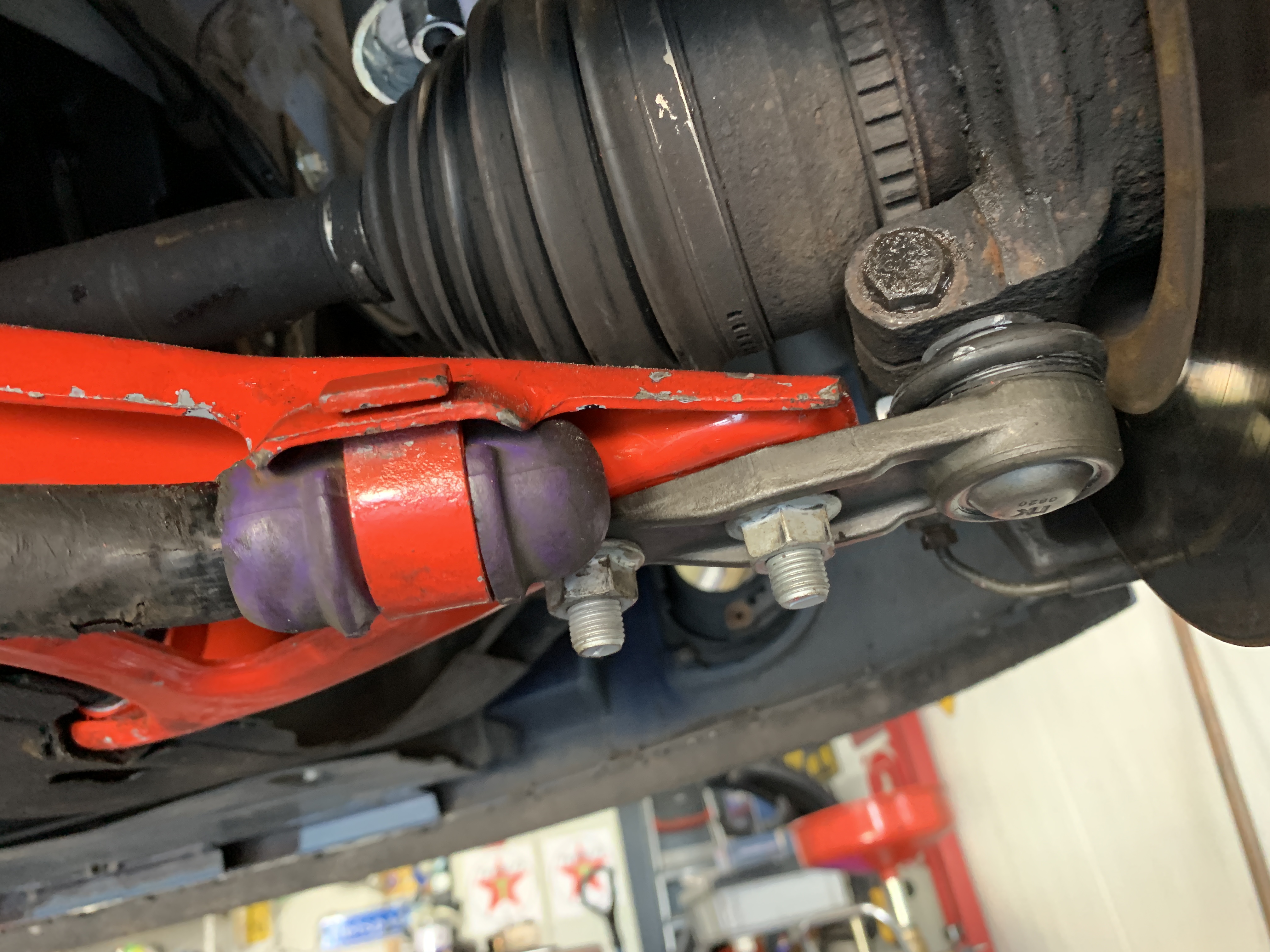

Got busy installing some parts today. Lots of new but also a few used bits went on:

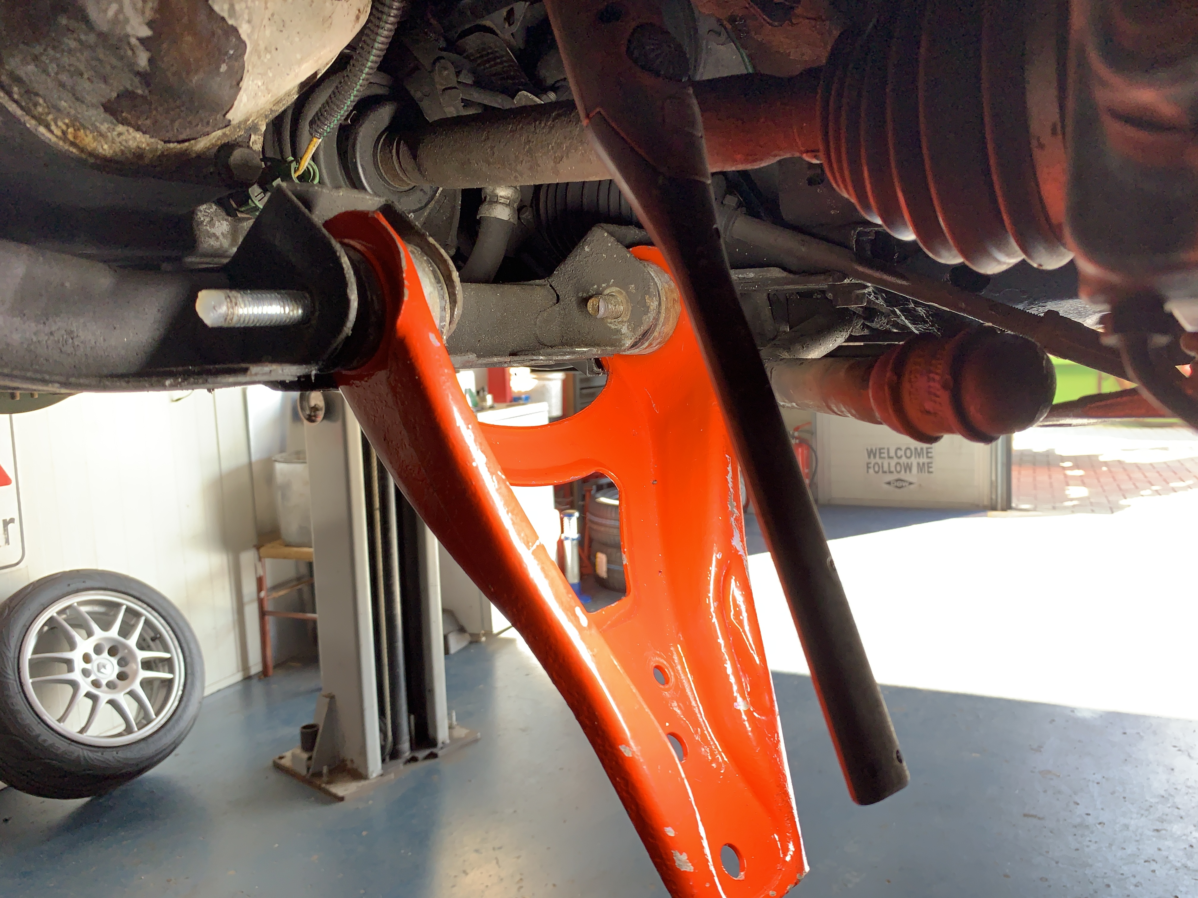

Cup wishbones with Powerflex Black
New ball joints

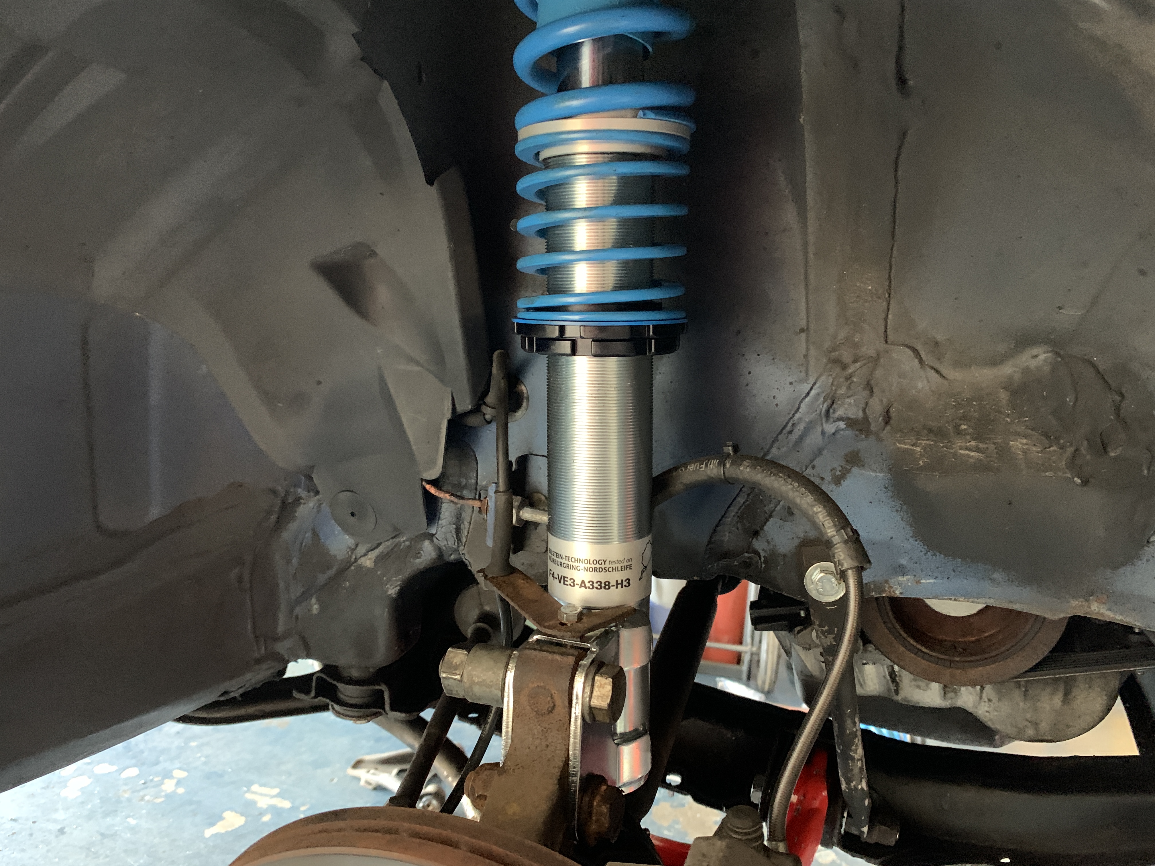

B14 coilovers with new OEM top mounts

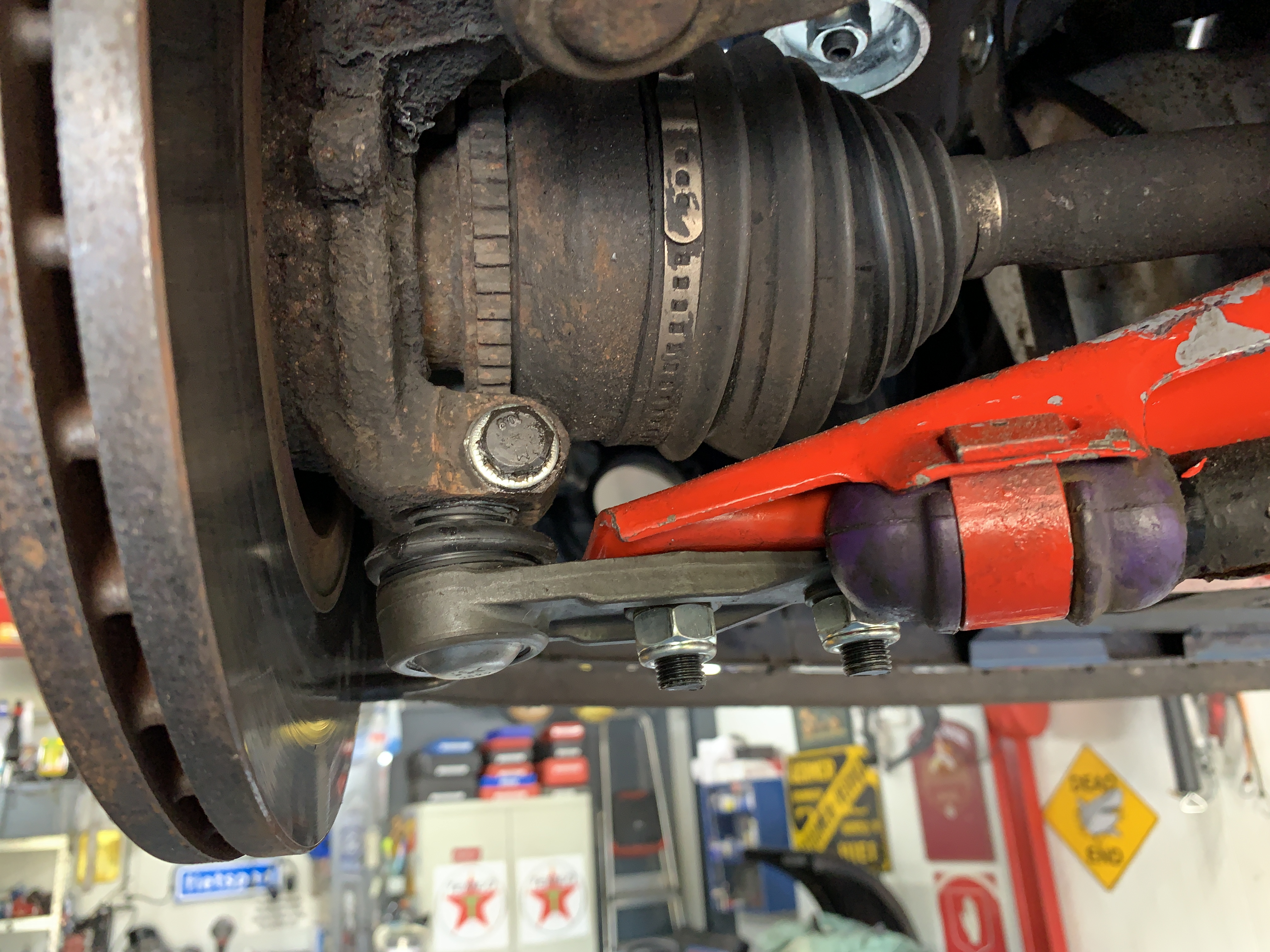

Cup wishbones installed with new ball joints:
New right rear caliper:
New B14 coilovers:
DS2500 front pads installed with Mr. Pink pins:

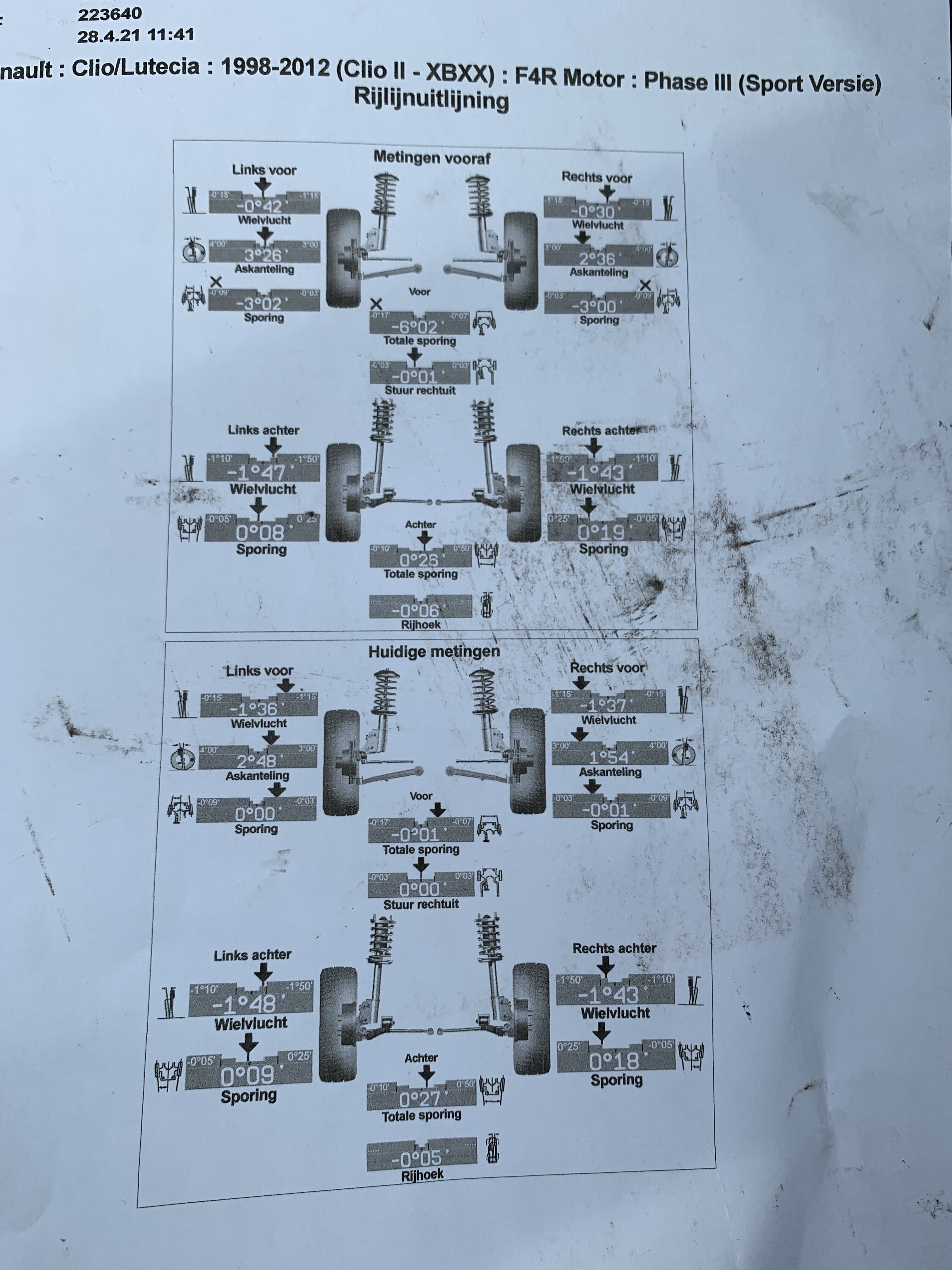

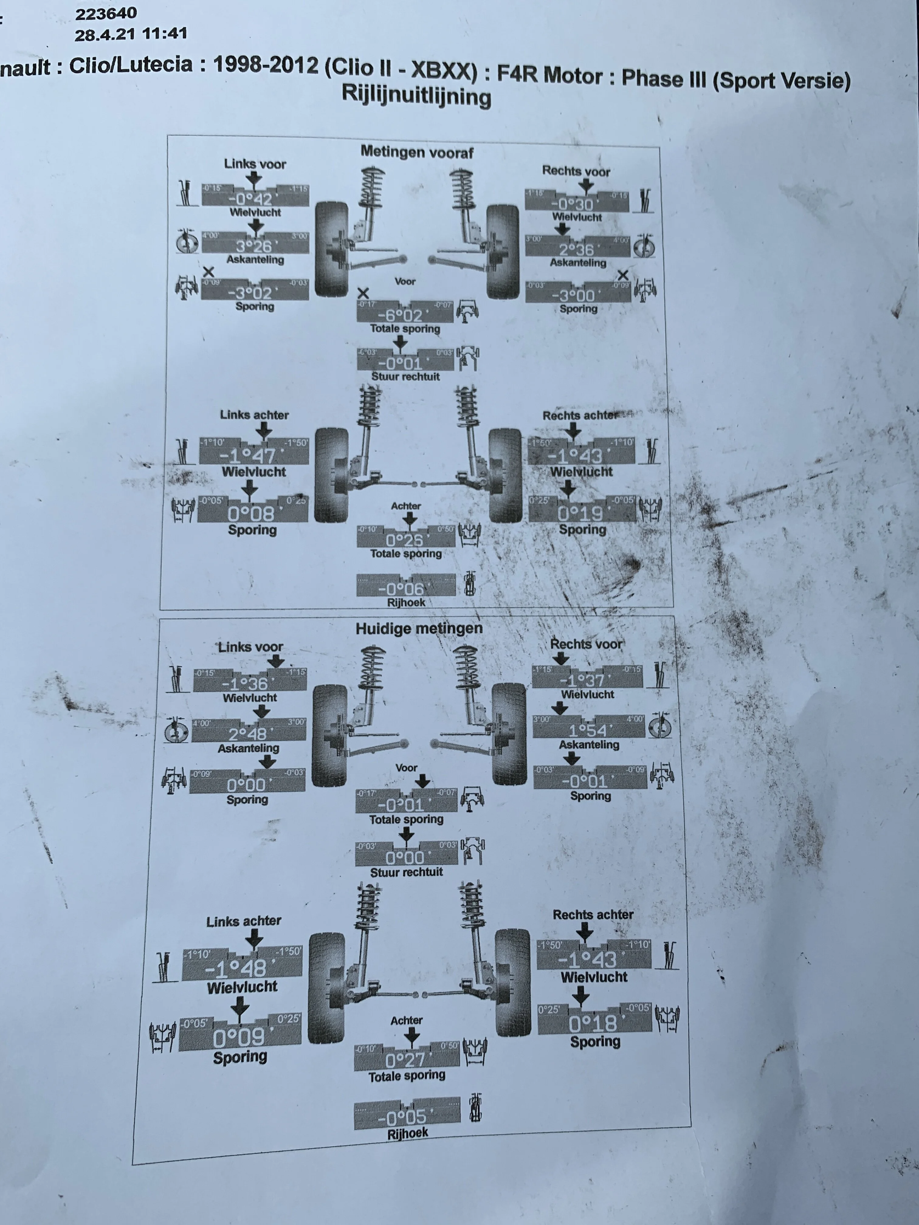

Also had a full alignment done but not too happy with the result. For some reason the camber bolts I've got only allowed them to go about 1.32 degrees of negative camber. Going to have to look into different bolts. I believe mine were from H&R. I know a place relatively close by that does a lot of motorsport alignments so I'll probably go there to have it corner balanced and to have another alignment done.
The alignment (first one is before, second one is current):
There also seems to be a pretty big difference in caster. 2.48 on one side and 1.54 on the other side. Does anyone have any idea what this could be? Subframe possibly not on straight or something? Would also love to hear some recommendations for camber bolts that I should be using.
Anyway, the difference between these Bilstein's and the old crappy FK Technix that was one there is massive. It rides so much better. Well worth the money imho.
