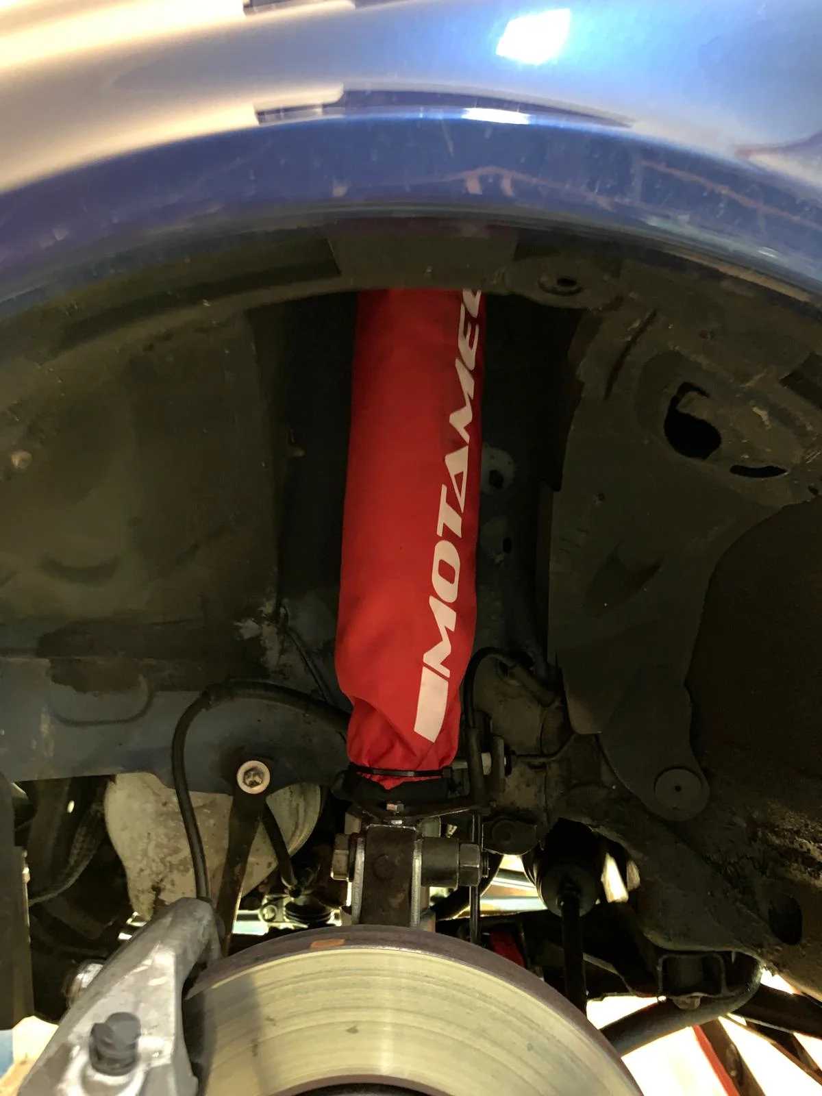

To protect the B14 coilovers I got some nice covers, sadly only the red ones were still in stock but you can't see them anyway so its all good. I'll remove them in about a month time to check if they don't trap any moisture but since i don't really drive the car in bad weather anyway it shouldn't be too big of a concern.

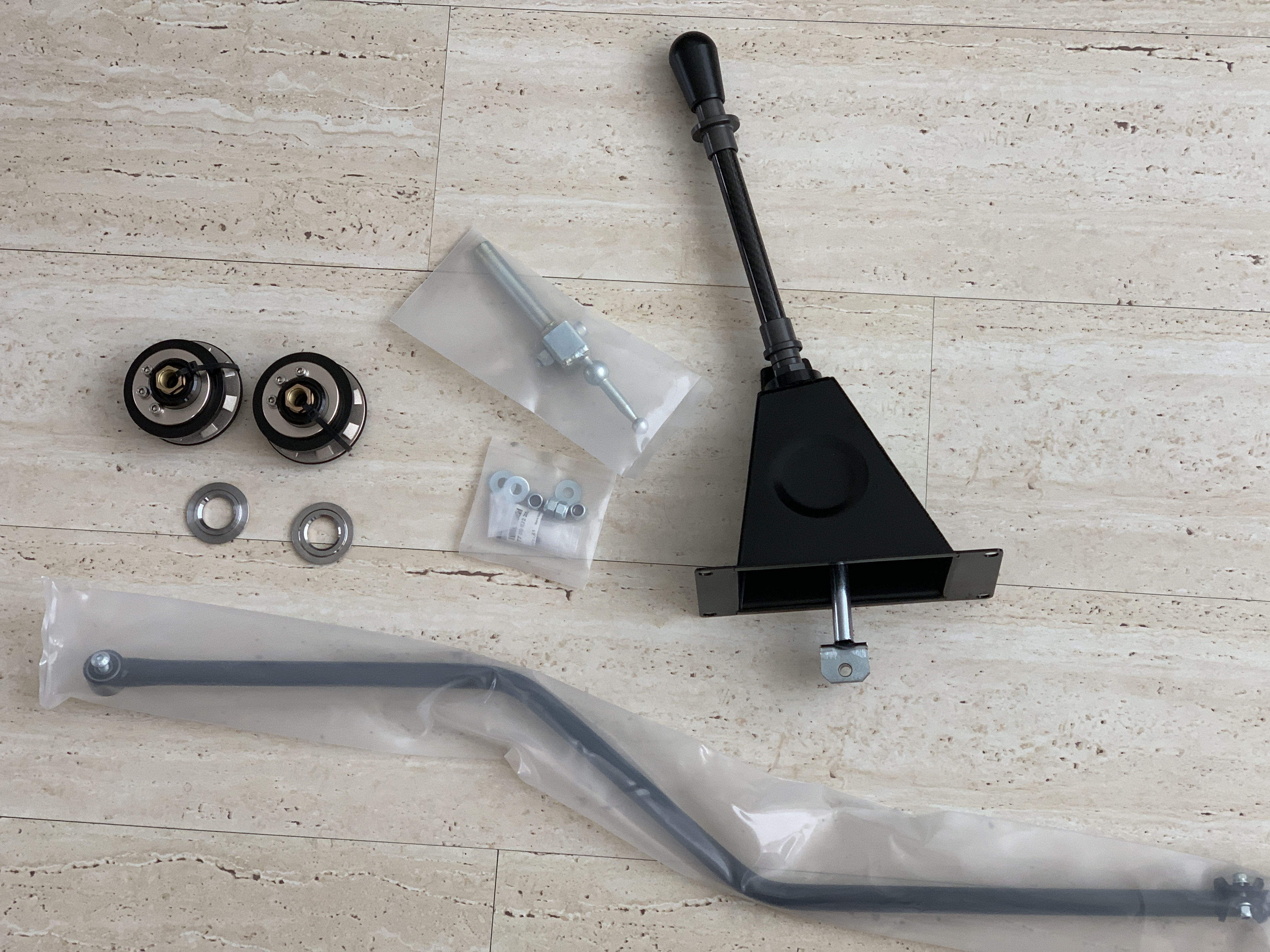

Oh, and I've also ordered the PMS shifter kit through KAM so that should be fun too.

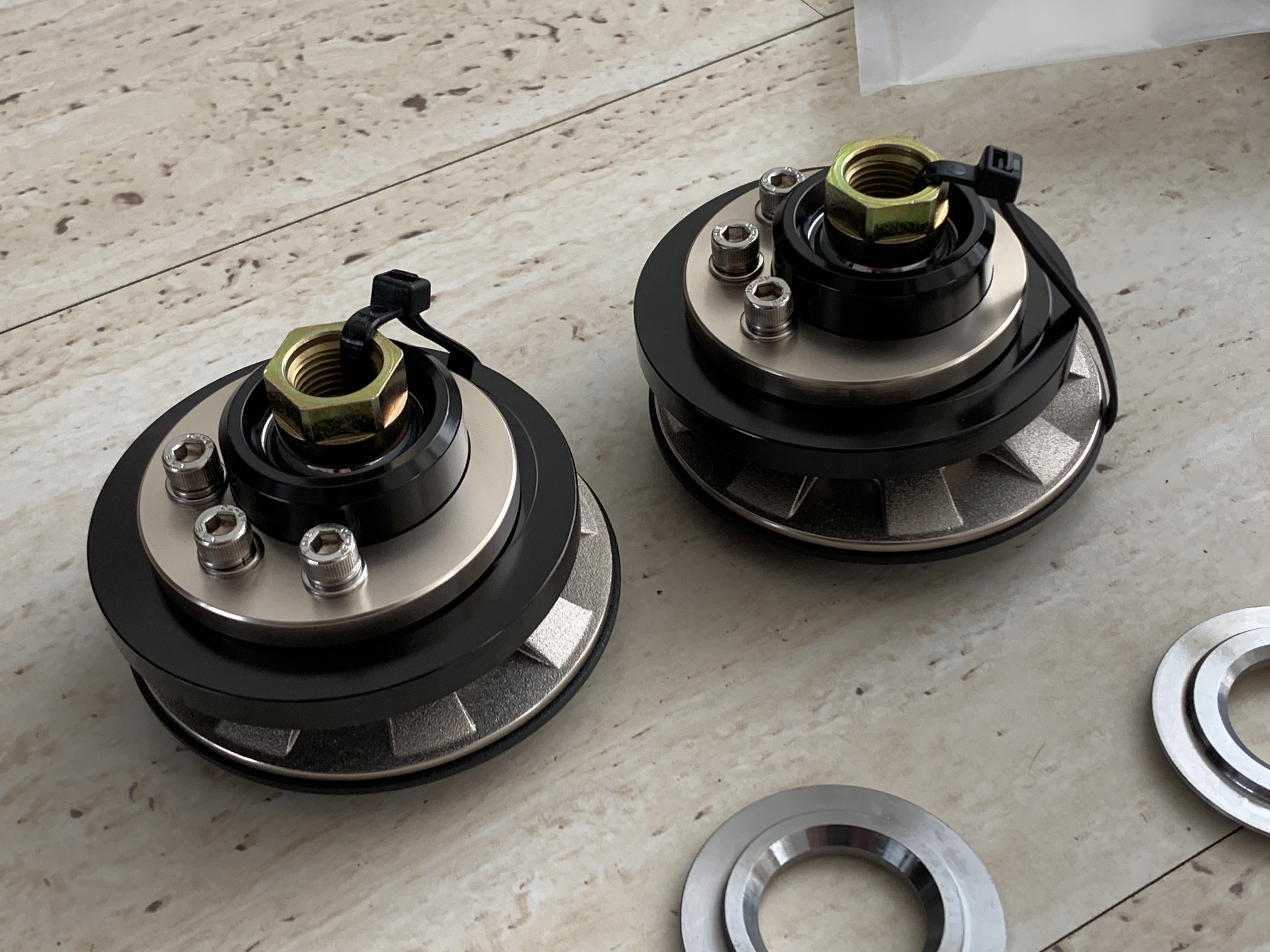

BC Racing topmounts in and also fitted the PMS shifter. Shifts are so nice but my god this rattle.... Did pack everything full of grease but it didnt help. I know of another method which is putting some tension on the shifter shaft with either a spring or something elastic. If that doesn't work ill probably replace the bearing like a few others on here also have done.
Cant really upload a second pic as this forum seems to have some issues but you already know what those topmounts look like. Sadly I couldnt achieve the alignment specs I was after so next step is probably to fit a 172 subframe and potentially switch to BC racing coilovers too.

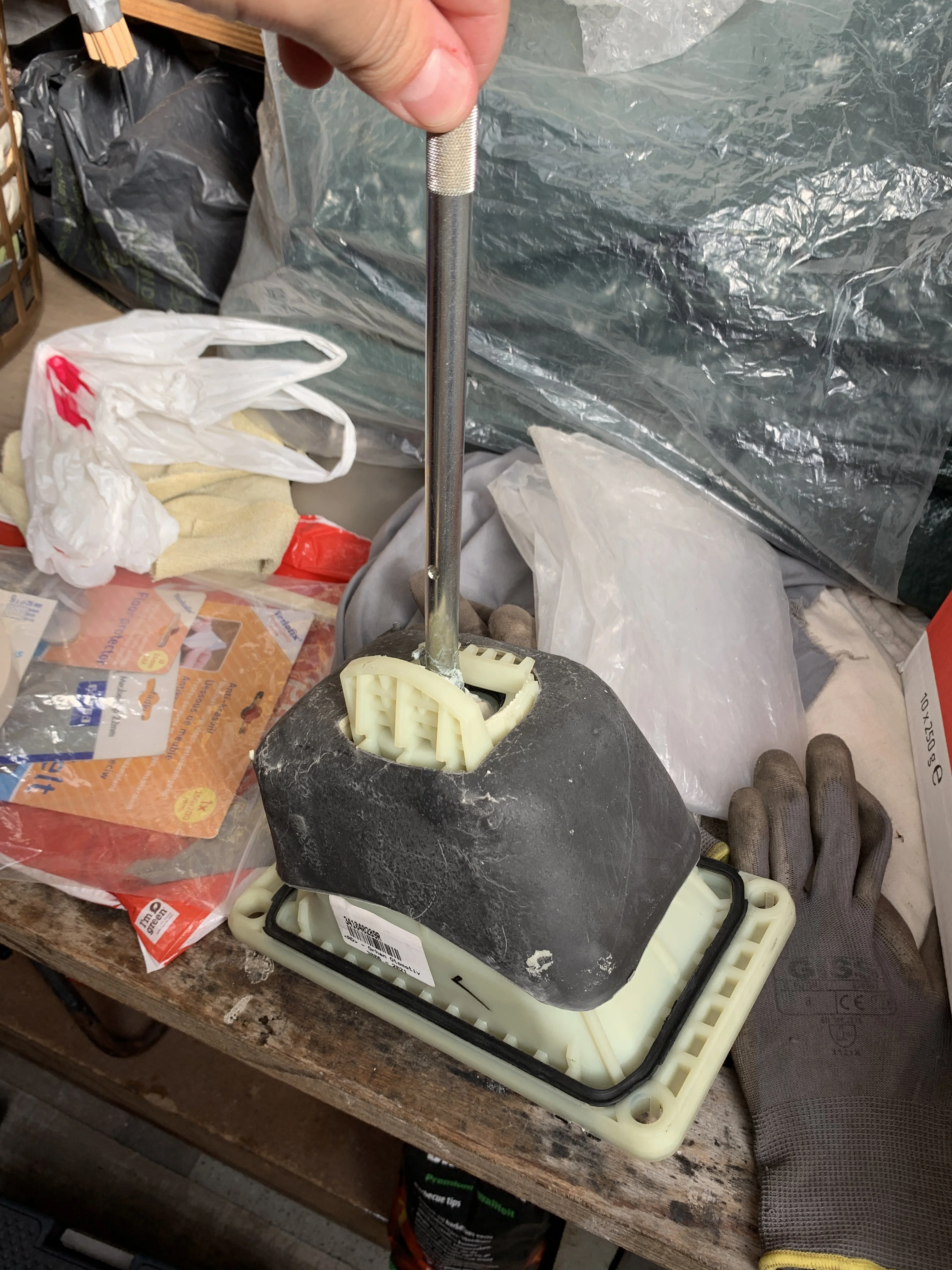

I couldn't deal with the rattle the PMS shifter gave me. I opted to just renew the entire shifter assembly for new parts from Renault along with some other parts. I'll try to put in all the part numbers in case anyone ever needs it.
The shifter assembly without knob or reverse mechanism 341040289R

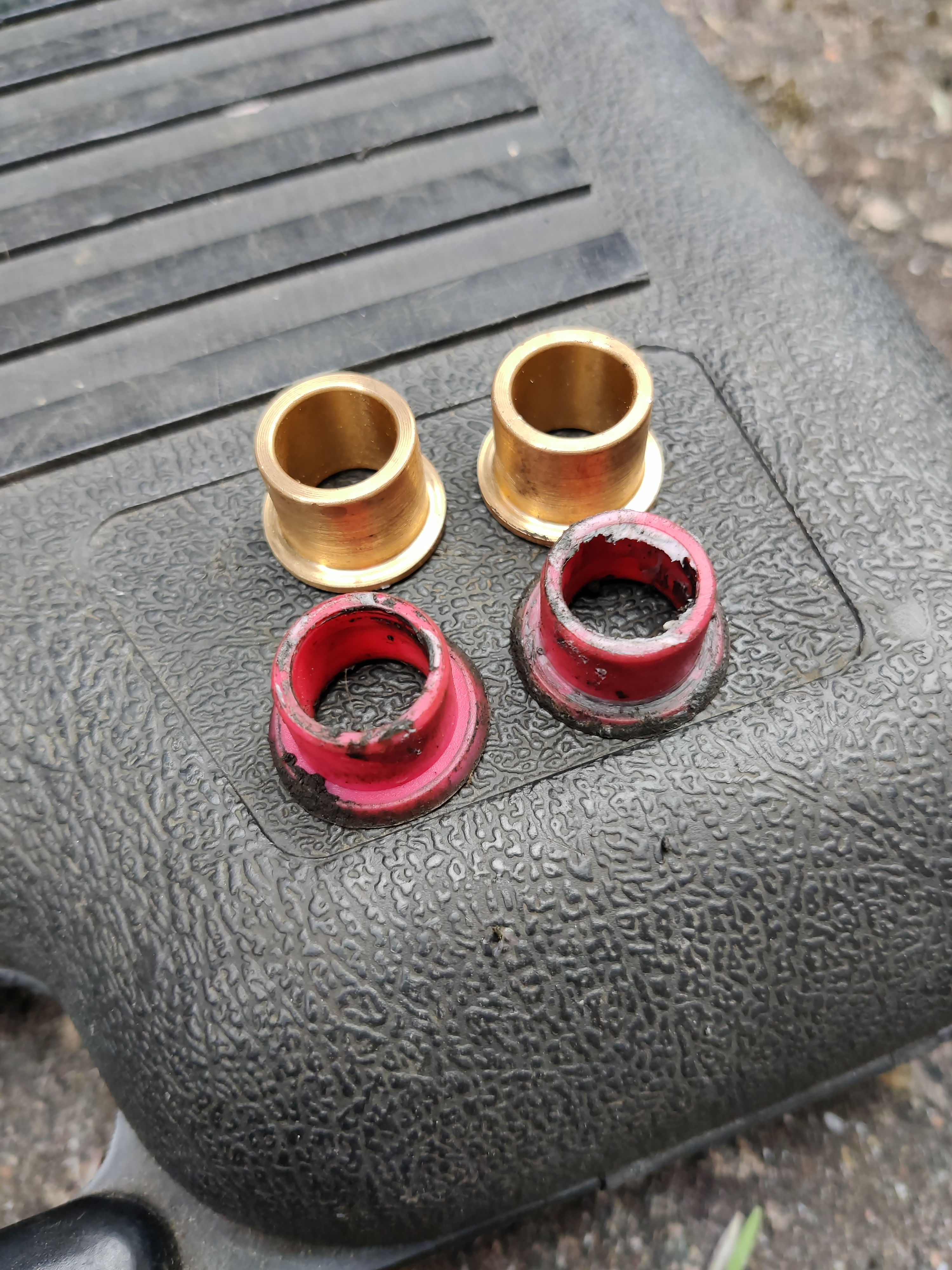

Replaced the new stock bushings with brass ones from someone on the forum.
(not my pic)
The other new bits:
pivot bush thingy 7700872205 (with circlip 8200328305)

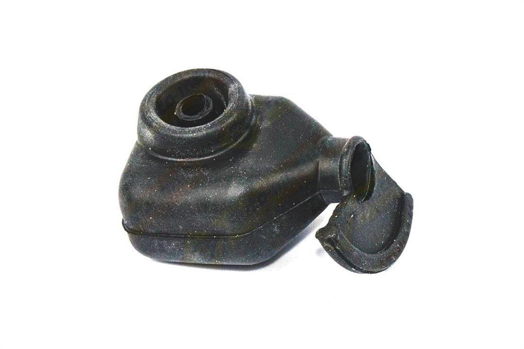

Dust boot as mine ripped 7700718856

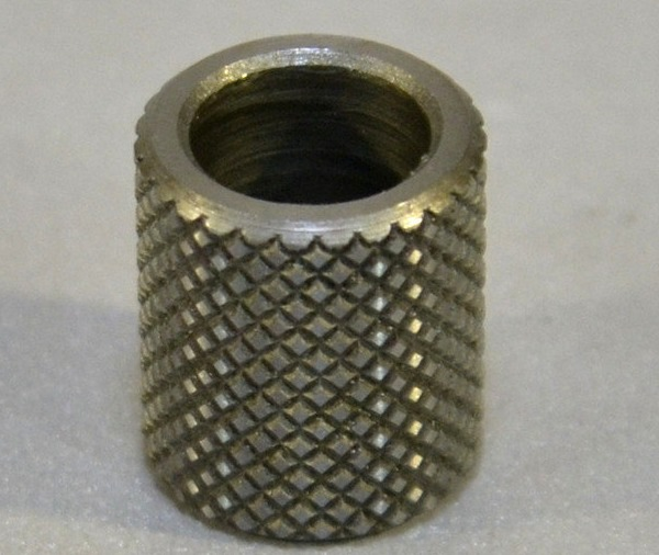

New metal sleeve 7705010093

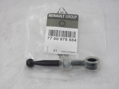

New gear lever selector 7700875584 (note that this is an updated version where you no longer need a small ruber piece that goes over the part where the above sleeve sits)

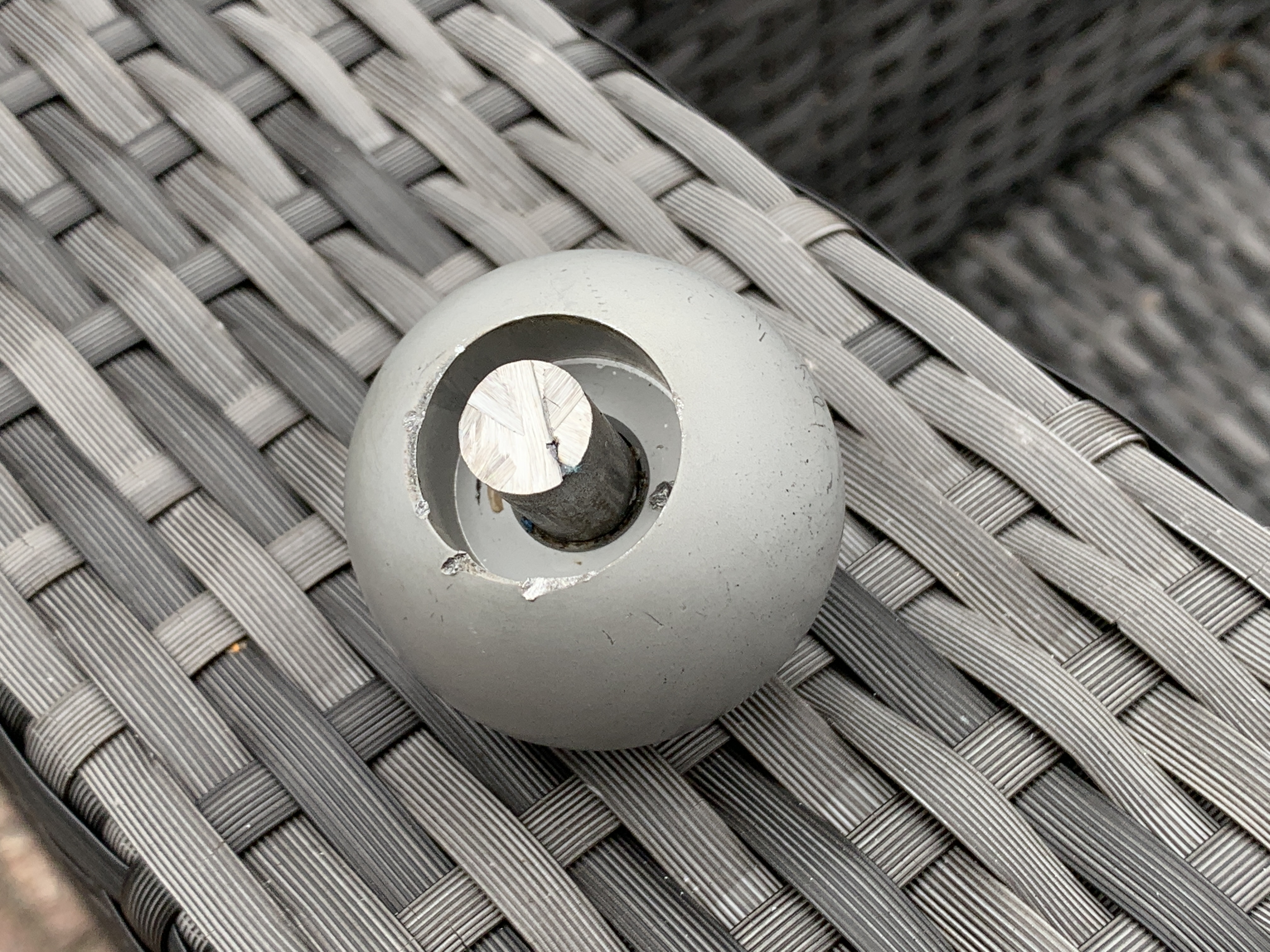

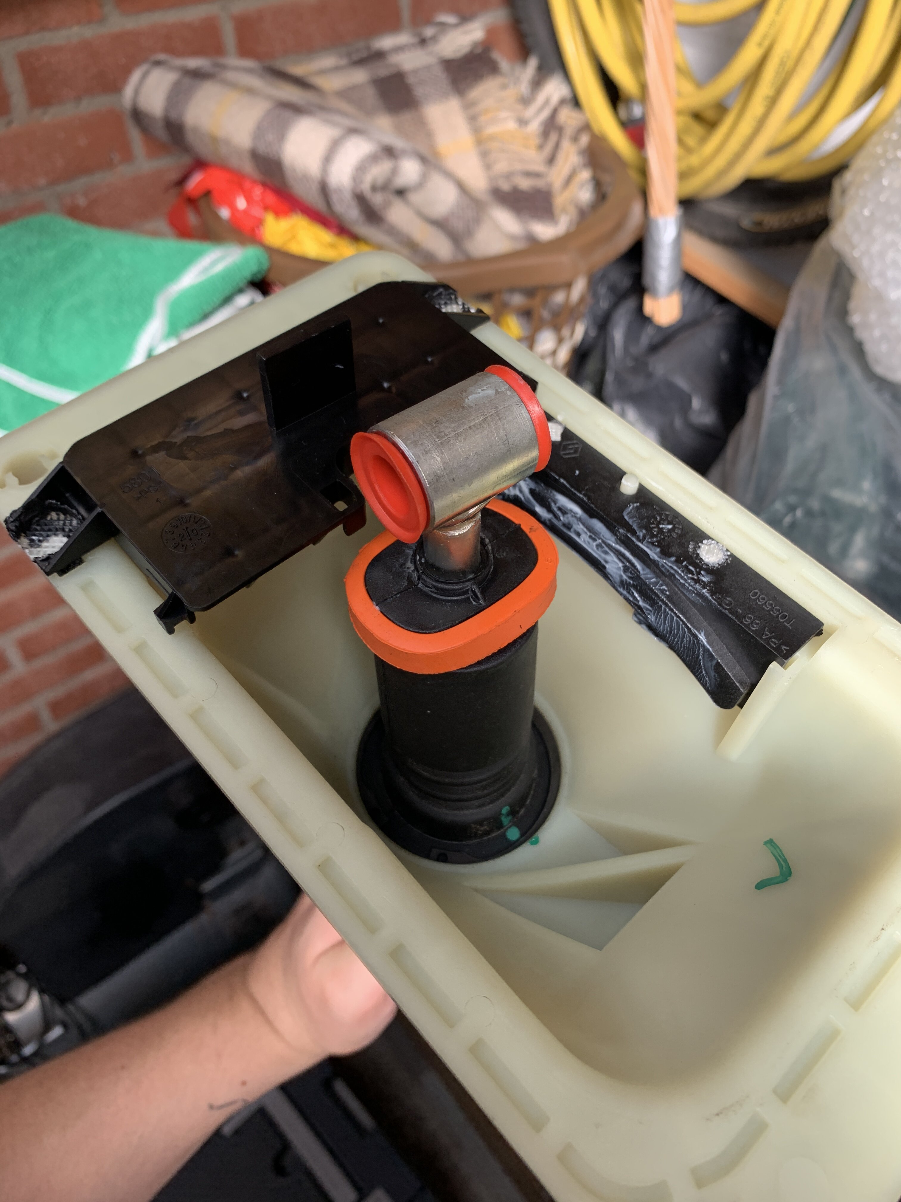

So fitting all of this was kind of a pain. Obviously I couldn't get the ph1 gear knob off as its pressed on but I had to remove the reverse selector mechanism from the shaft.
So off it goes...

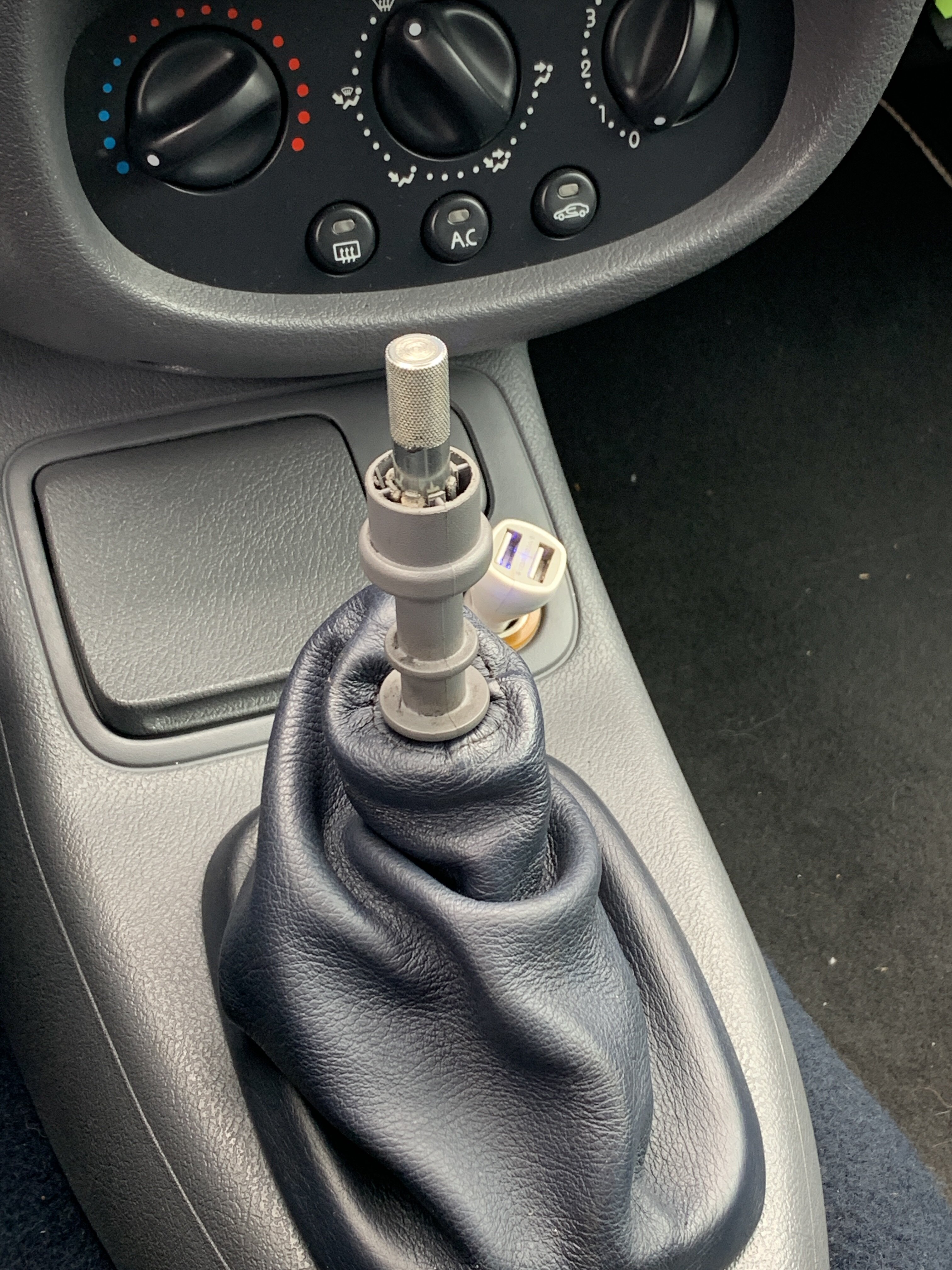

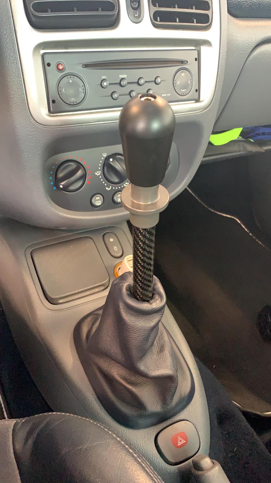

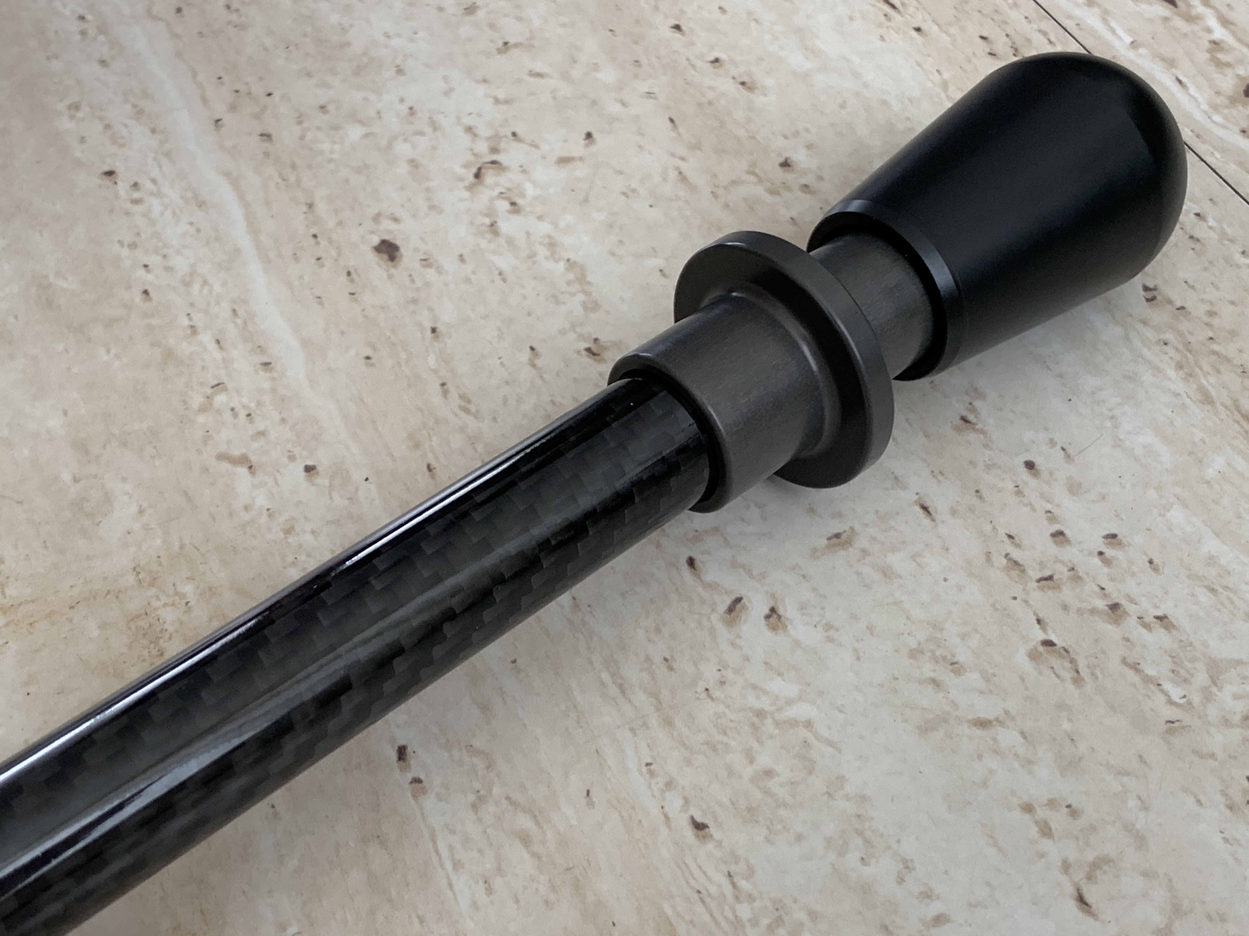

Managed to transfer everything over and after some adjusting it all fit very well. This only leaves me without a gear knob. I might be able to drill the ph1 knob out or I'll have to find a replacement. At least my shifter is now rattle free. Al though it does hurt to shift now so I'm not sure if thats an improvement :p
Shifts extremely nice and tight. No play at all. My old one was all over the place (before the PMS shifter) so I'm very happy.
