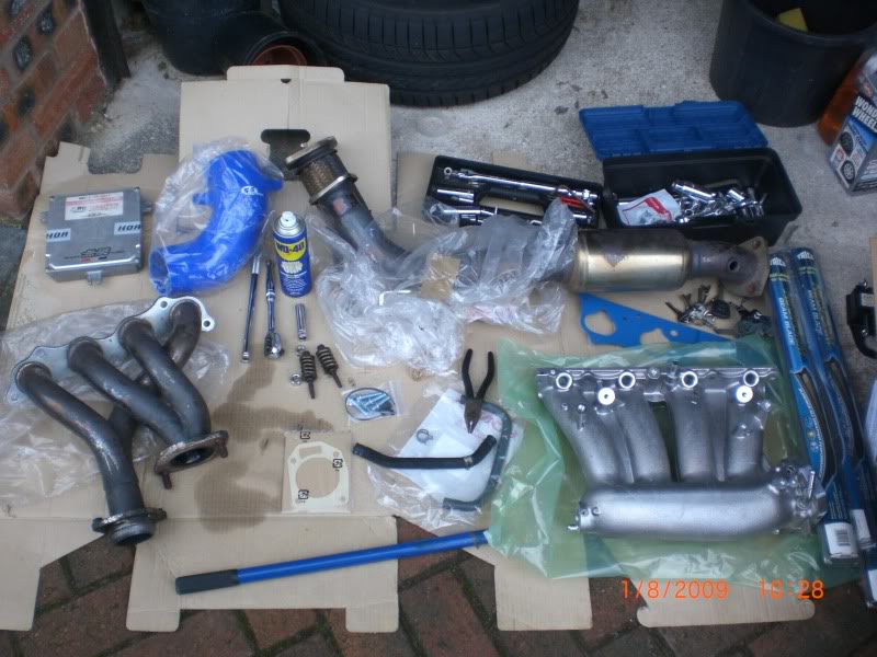

This is a pic of all the bits, an RBC inlet manifold with PTFE Hondata gasket, an SFS silicone hose, Mugen N1 ecu, and a Spoon 4-2 and 2-1 (decat) manifold. Also some new neoform wipers from opie oils as for some reason the ones fitted to mine were tiny!

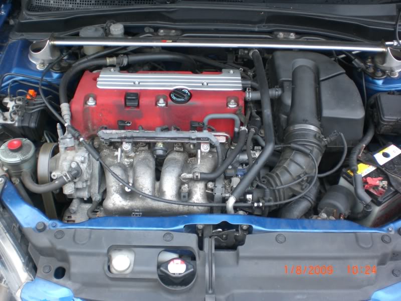

Before:

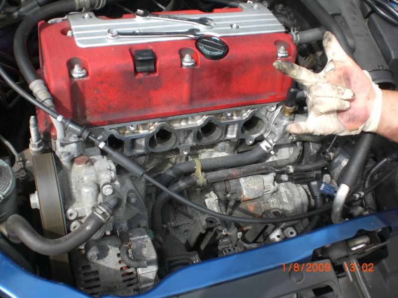

During:

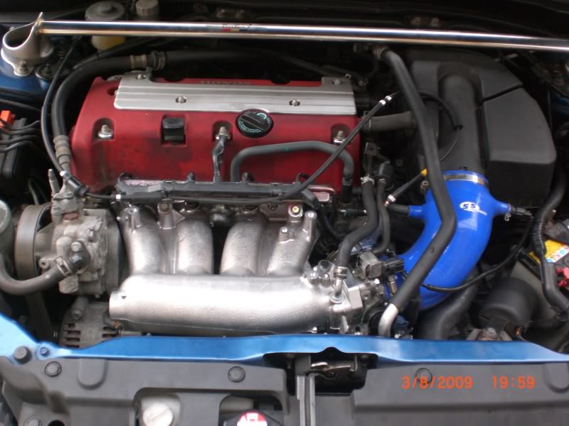

After:

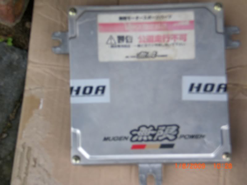

Can I ask what's the crack with the Mugen N1 ECU?
I remember an old friend telling me his CRX had a Spoon ecu but never paid attention to know what difference they made.
Do they work in the same way as a remap only you're changing the whole unit?

it will be a standard ecu with a new chip in it that mugen put a map on for fueling...
The US Honda boys would s**t a brick if they saw you with the bonnet up fitting stuff without cleaning up the bay too. Could have at least cleaned up the cam cover ;)

You can't remap them, they're designed by mugen for breathing mods, alot cheaper than buying a kpro as you dont need to map it everytime you change something
Yeah i know mate it needs doing, i hardly get any time at home as i work in France. I'll do it next time i'm home for ya when i get the mani fitted ;)
lol thats what i was thinking lol. still its an awesome car, always wanted one of these but high insurance just put me off.
  Golf GT TDI, IS220d
Yeah i was thinking about it but it will have to wait till i get back, that why i wasnt gonna spend ages cleaning that one. There's a cuy on the ctr forum that does good cam covers so i might get one off hime, not sure on colour though. I keep thinking blu but maybe that will be too much blue then

there's alot of mods availiable and its alot easier to get more horses out of the K20 than it was with my 182 but its not cheap. For example that ecu costs over £1000 new, you can't just remap like you can with the clio ecu's. The exchange rates have gone so bad betwen the yen and gbp that it was cost about £900 for a GruppeM induction kit where it cost about £450 not so long ago
