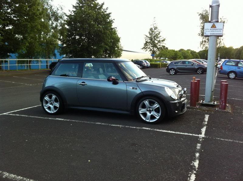

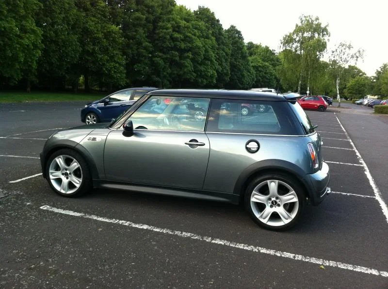

I like the standard wheels - I agree with your standard looking/naughty inside conclusion!

Looks good, and I'm over the moon the ricer wheels have gone. :)

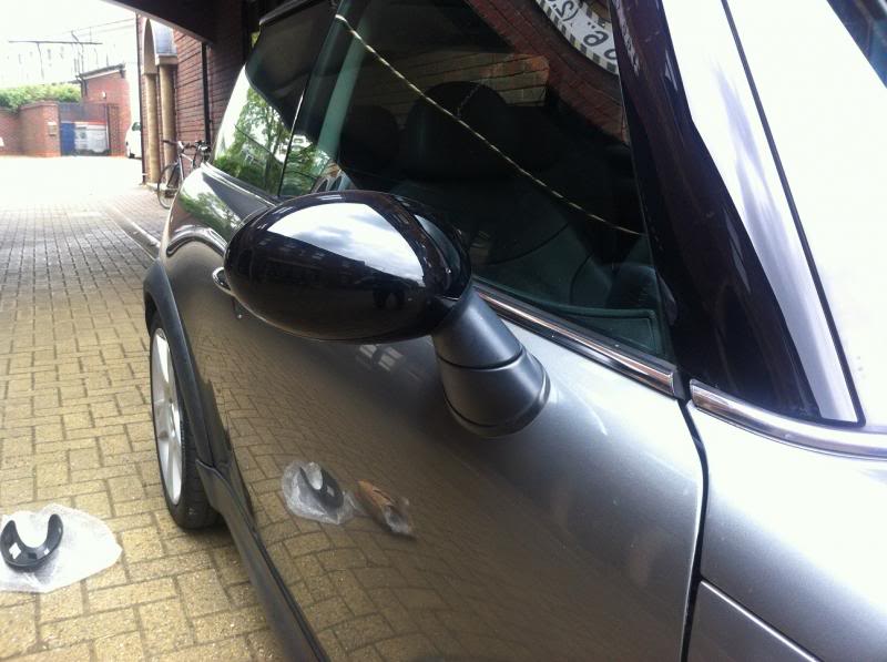

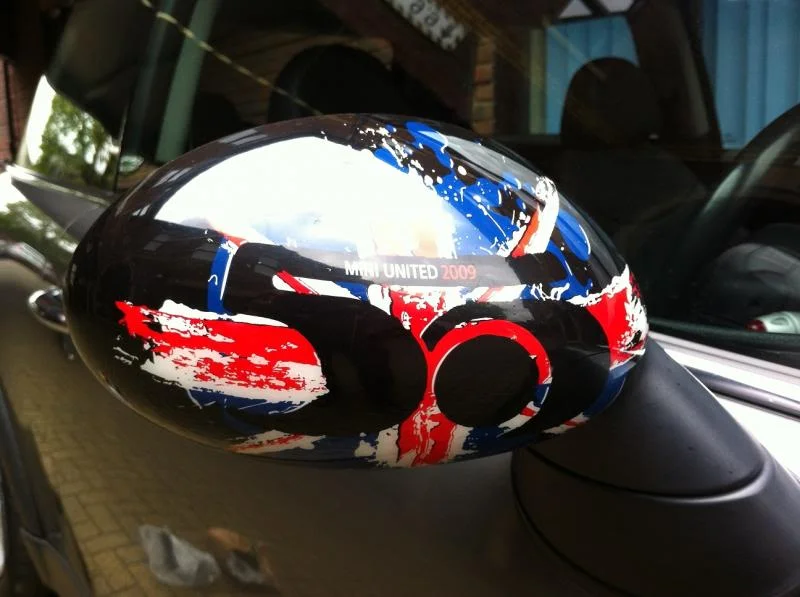

Then this morning, a small package arrived which will partially remove the homo from the sides of the car. Something that has angered me from the day i bought it tbh. What possesses some people?
​2 mins ago, i went from this:
To this:
Which now results in this:
Needless to say, i feel 100% less gay now.

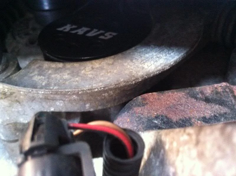

Just booked it in for the following work at Minicraft on 17th July. Wahoo:
Supply & fit 15% Kavs pulley, belt & NGK plugs

That was one of the best looking R53s online that I found when looking for mine. Plain and simple but very effective!
Seriously? On a set of terrible TD halfords wheels? Behave man!

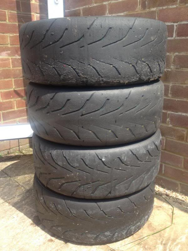

Runsh4ts now sold, Hankook V12 Evo's in the post from Camskill. Wahoo.

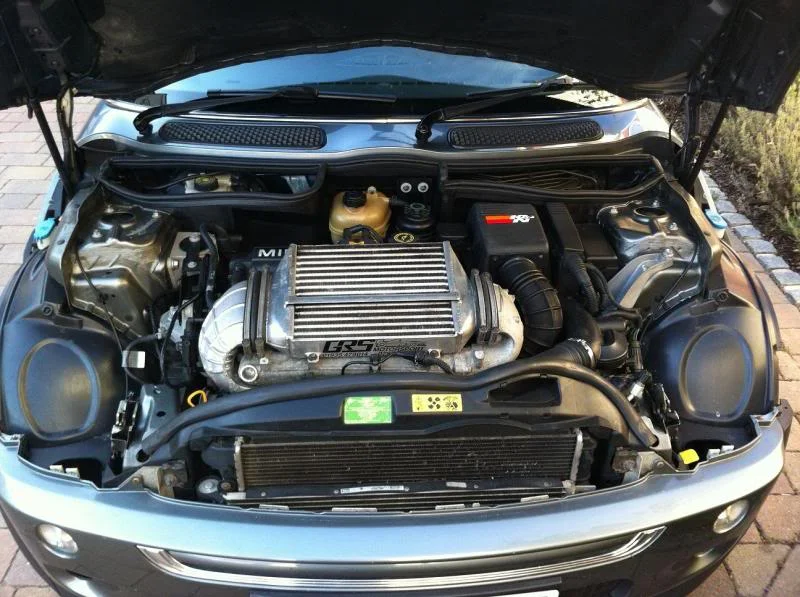

​This is the problem lol. Unlike the clio, which is very good out the box, & so obscenely expensive to get power out of, i was always happy to just to the basic suspension/braking changes. The mini is so cheap to get decent power out of its almost rude not to, & the suspension needs more tinkering with to be perfect.
In the short term, im just going for a 15% KAVS pulley to add to the GRS Motorsport intercooler & DaveF airbox that ive aleady fitted, longer term will probably involve a Newman cam (£175), 550cc injectors (£250 or so) and a tune (£400). Then maybe a Janspeed manifold & 1320 'tomcat' (£450) to finish it all off. Sarah's brother got 240bhp sans manifold and that thing goes like a rocket, so ill probably not bother with the Janspeed - dont want any more noise either tbh.

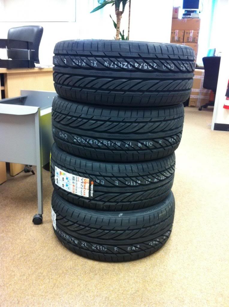

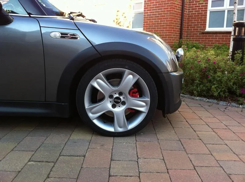

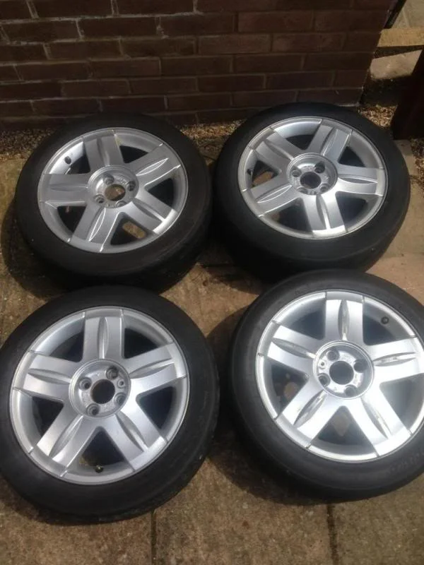

​Sh1t tyres be gone!!! Had the Hankooks fitted yesterday afternoon and well, all i can say is wow, feels like a completely different car lol!!!
Steering is lighter, it doesnt follow every ridge or bump in the road and even some of the interior rattles have gone. Win.
Arch gap is slightly increased, but c'est la vie, ill just have to buy coilovers :clown:
Also picked up a slightly more fruity setup for tracktime ;)
Clio wheels on a mini i hear you say? Well yes, same fitment (need 60.1 to 56.1 spigots) but clio owners are very much known for charging 9/10 of f*ck all for everything, very much unlike mini owners!! 16's as well, so will be slightly cheaper when the R888's need replacing ...

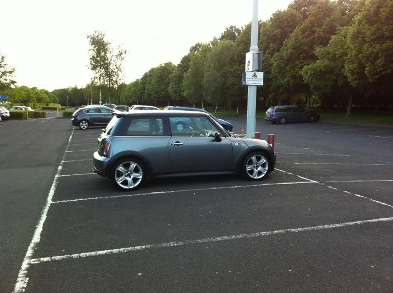

lol. Went home to Cornwall, & the car scraped all the way down my parents drive, so i didnt see the point in keeping them.
​They've now graveled the drive. FFS.
Raise them? Novel concept I know ;)

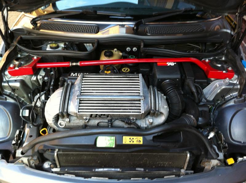

So i collected the car from Minicraft last night and well what can i say? BIG difference lol. The extra power from the 15% pulley is really obvious, no extra 3bhp from exhaust/filter/remap like on the 1*2's here. On a ruddy hot day, their DD dyno showed an improvement from 164-199bhp, & whilst i never quite believe a tuners own figures, im sure it'll make similar at my next outing to Surrey Rolling Road! Brakes are hilarious, nearly put my head through the windscreen with my stamp on the middle peddle!! Powerflex wishbone bushes have also made a humongous difference, no more play in the steering & a much sharper feel to everything, like a different car now in terms of power, braking and steering ...
Overall Trevor said my car is pretty healthy, & certainly a good example of the breed. Happy enough with that. Only real issue was that the rear R53 brake lines i supplied were wrong (i gave them screw in, but mine were Banjo?), so ill have to get that sorted out at some point. Oh, & the fact that their place was full of properly naughty R53's and R56's. Bye bye money in wallet.

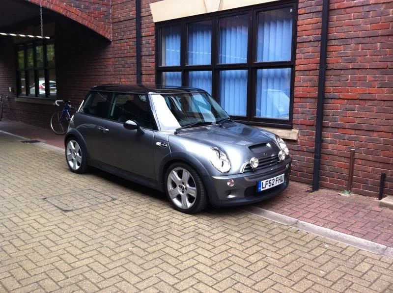

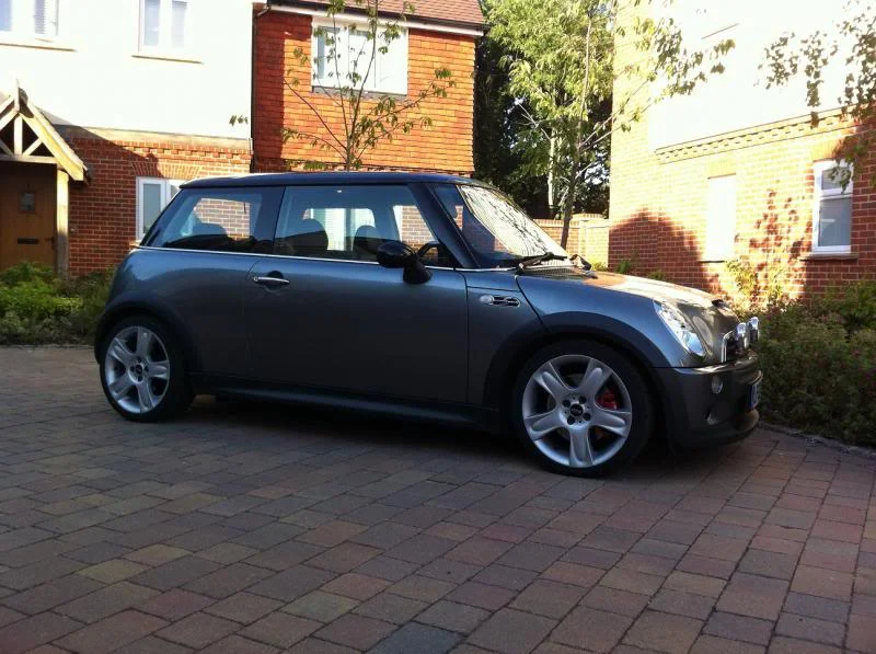

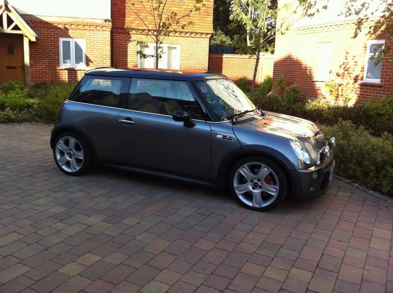

Finally he gave it a quick clean for me, which was much appreciated (i have to park under a tree outside my flat). Some cr4ppy pictures.
More boost:
More braking:
Had a very interesting drive home lol. Much quicker than before!!!
Then got to work this morning and fitted the OMP upper front strut brace that arrived yesterday afternoon. I know they dont offer as much of a benefit when compared to the lower one, but for £25, who cares lol. Ill get the lower at some point in the future.

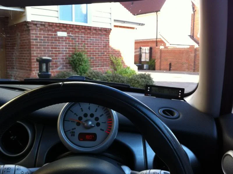

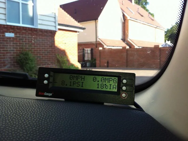

And finally, fitment of a scangauge, partly so that i can keep an eye on various 'things' (not sure what is most important yet lol), but also as my early mini doesnt have a trip computer and speedo in the rev counter - which drives me nuts. Central speedo looks nice, but i hate having to take my eyes of the road to see my speed!!!
And a couple of clean shots at home:
Overall, i think its brilliant.
The whine is addictive and all the (very small) changes ive done to the car have improved it 100%, posh clio FTW.
