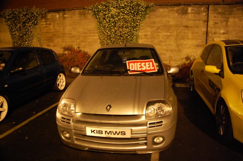

A mates 172 sounded like that at one of our meets, he said it was just the belts needing done.
Was funny too - "Mikey, are you sure yours is petrol?" :rasp:
