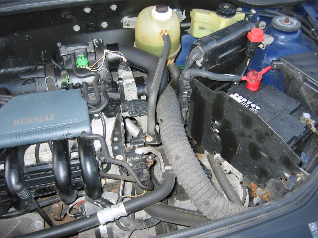

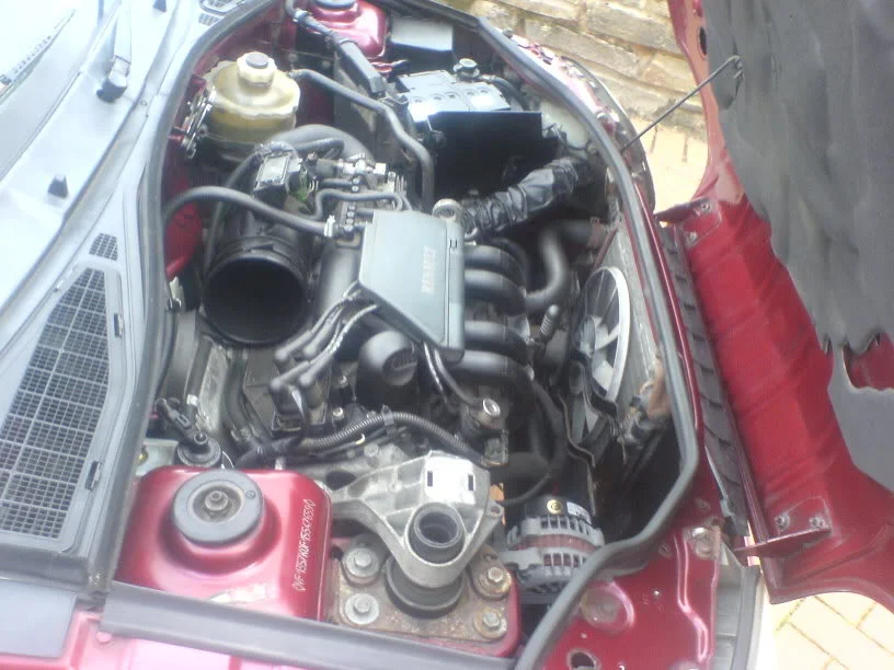

Sorry but its that time again for another noob question. Basically i want an induction kit for my mk2 ph1 1.2 8v, but i see it as being more complex than other cars. By this i mean there is a large black box behind the engine(with the green clip on it), i assume to control the incoming air temp etc, and the pipe leading to this does not have anything on the end of it, now do i simply put the induction kit on the end of this pipe? Or do i have to fiddle with the black box to make the induction kit effective. Ive seen a BMC universal closed induction kit i like, so may go for this one. To explain this muddle of what ive just said is a pic below of my engine bay, hope it makes sense.Thanks!...phew...
Thats thing with the green clip is the MAP sensor its a GM part ironically. It looks like the pipes pluged in though else the engine would run funny.
Least that whats my tired mind thinks.

wouldnt the new kit replace that long furry pipe?
  FOR SALE!!!
hmmm the long furry pipe is just ya air feed my 1.2 8v engine does not look like that all my sensor are plugged on to to the tb meening i could just take the black box out and the pipe work and run what ever i wanted did not need anyhink speacil i have unversail filter from halfords to start then got a cheap piper cross and just joined these on to the orgnail pipe soz for spelling hate been thick lol
  MINI Cooper S
its a second hand one off Ebay and is just the filter so i would have to buy pipe separate. I would rather not mess around with sensors and stuff tbh, so would it still make a difference if i bought some new pipe and wacked it on the end of that and ran a pipe from the front of the car into the filter? And yes it does need a good clean :)
Same engine as me. D7f engine.

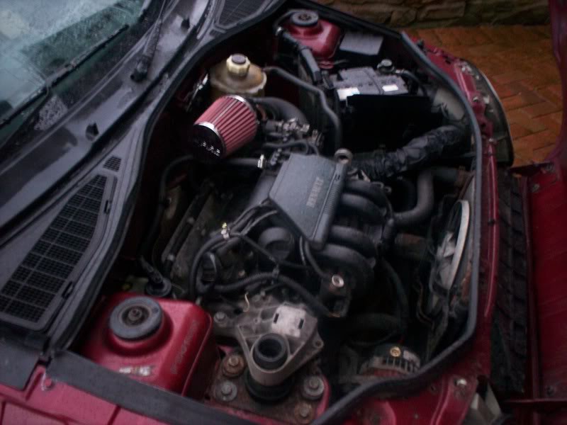

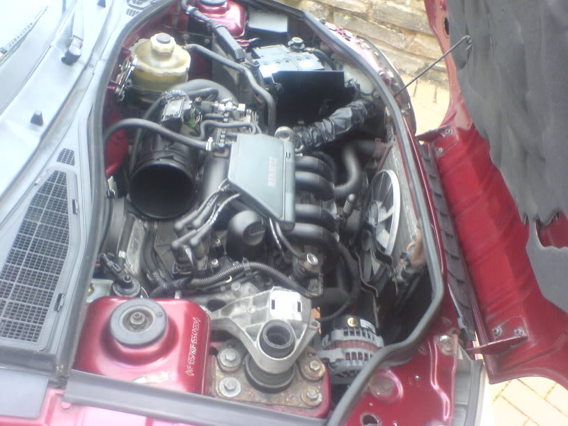

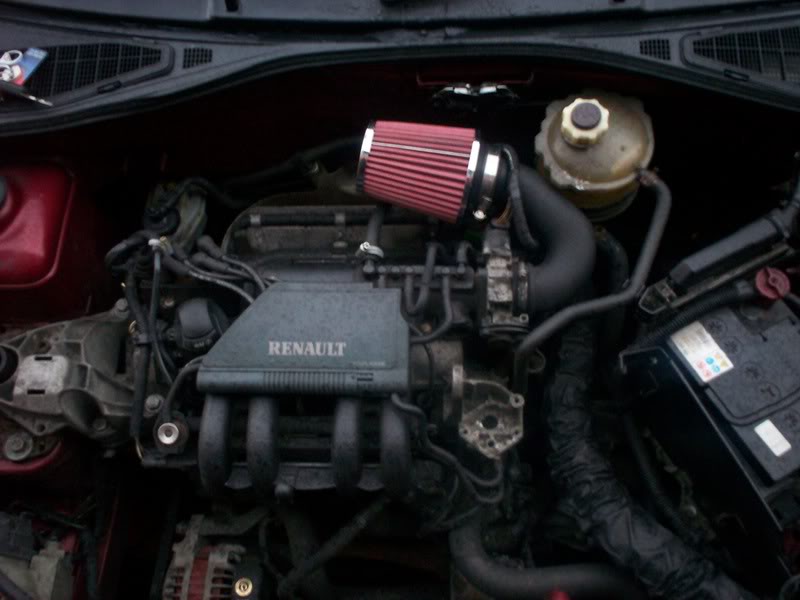

That big box at the bag all comes out and the Induction kit fits in its place. Its a 15 min job.

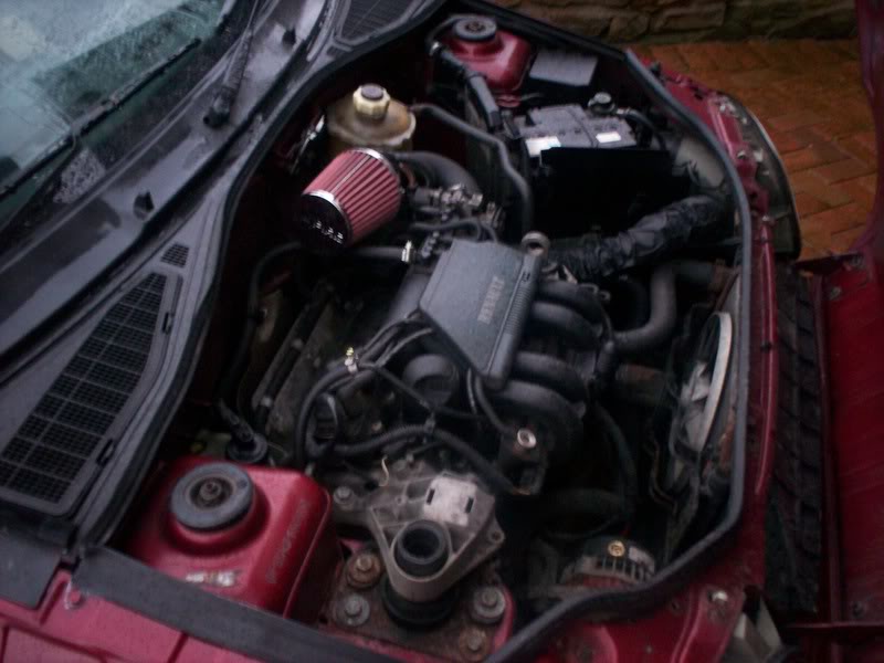

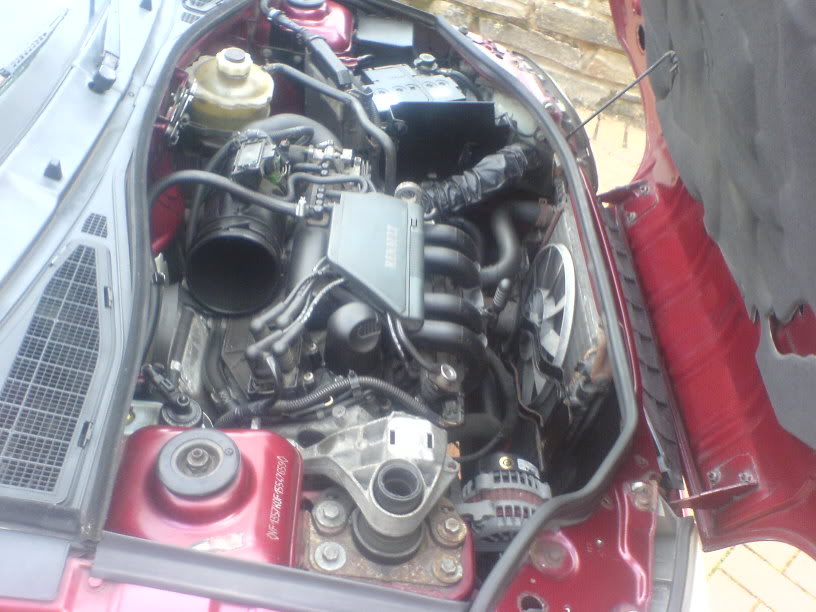

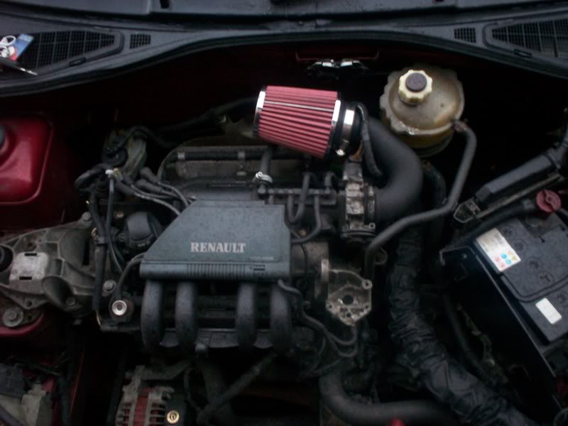

Please see the before and after photos below. (JeSus - I hope you don't mind using your photos)
The only differance between the above pics and my car is, I have also put in a cold air feed as the IK is so close to the engine; and was just sucking in all the hot air.

Yea the big cloth looking pipe going into the engine at the back and running to the grill is the cold air feed pipe. I think you can just take that off and when you order an IK it provide a peice of plastic or rubber tubing which attaches to it.
