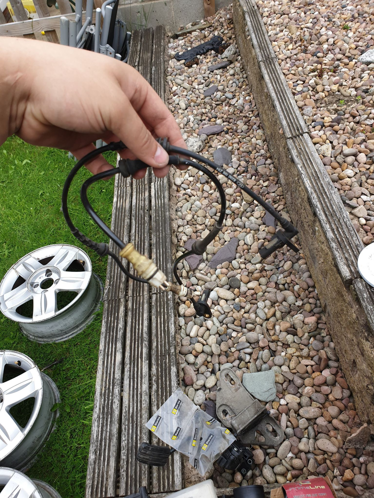

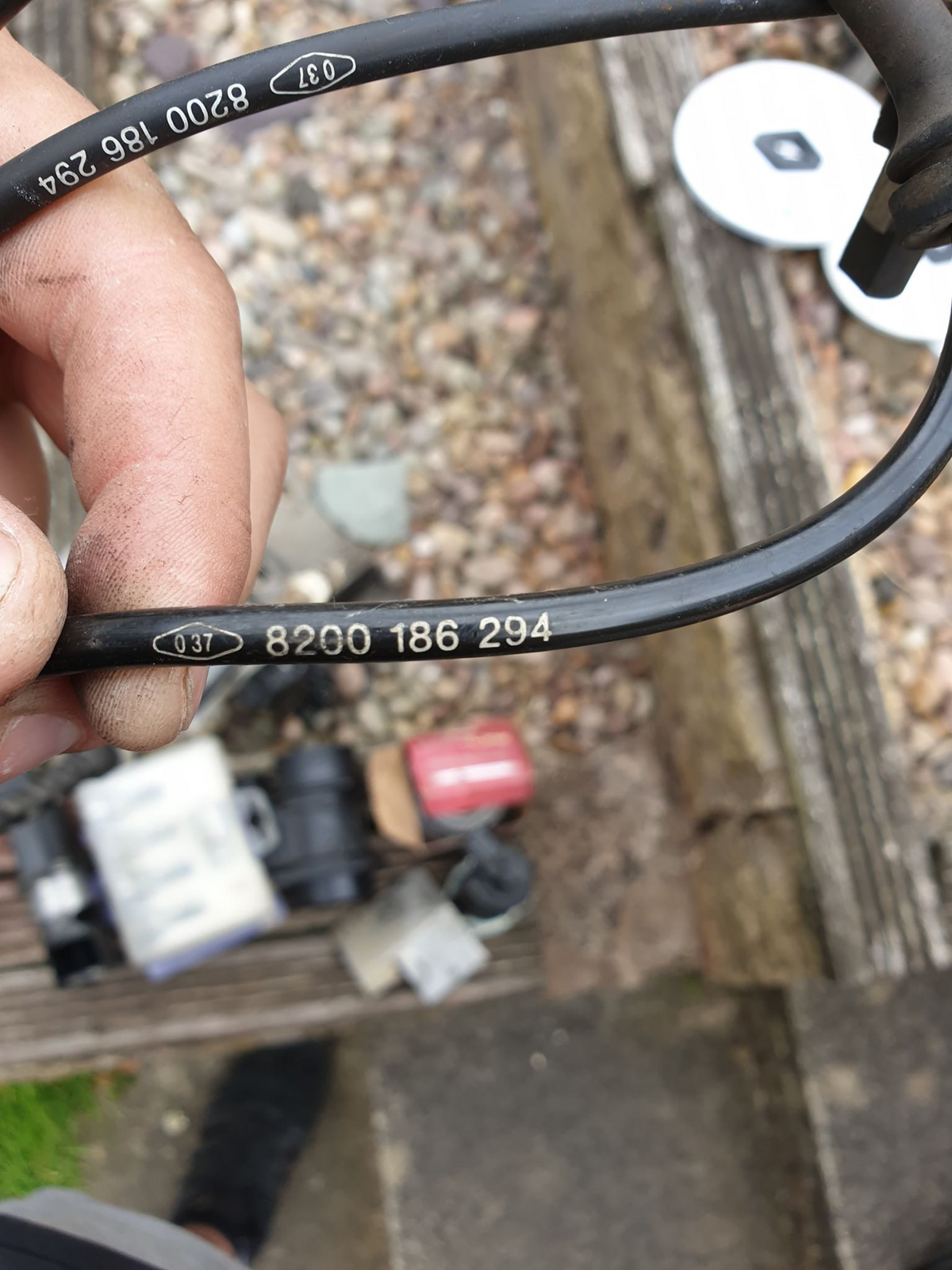

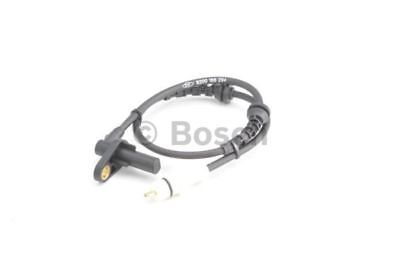

I don't suppose you've got a link to the bosch part number for the front?
I've just tried to fit one of these and it is definitely not the right one.
