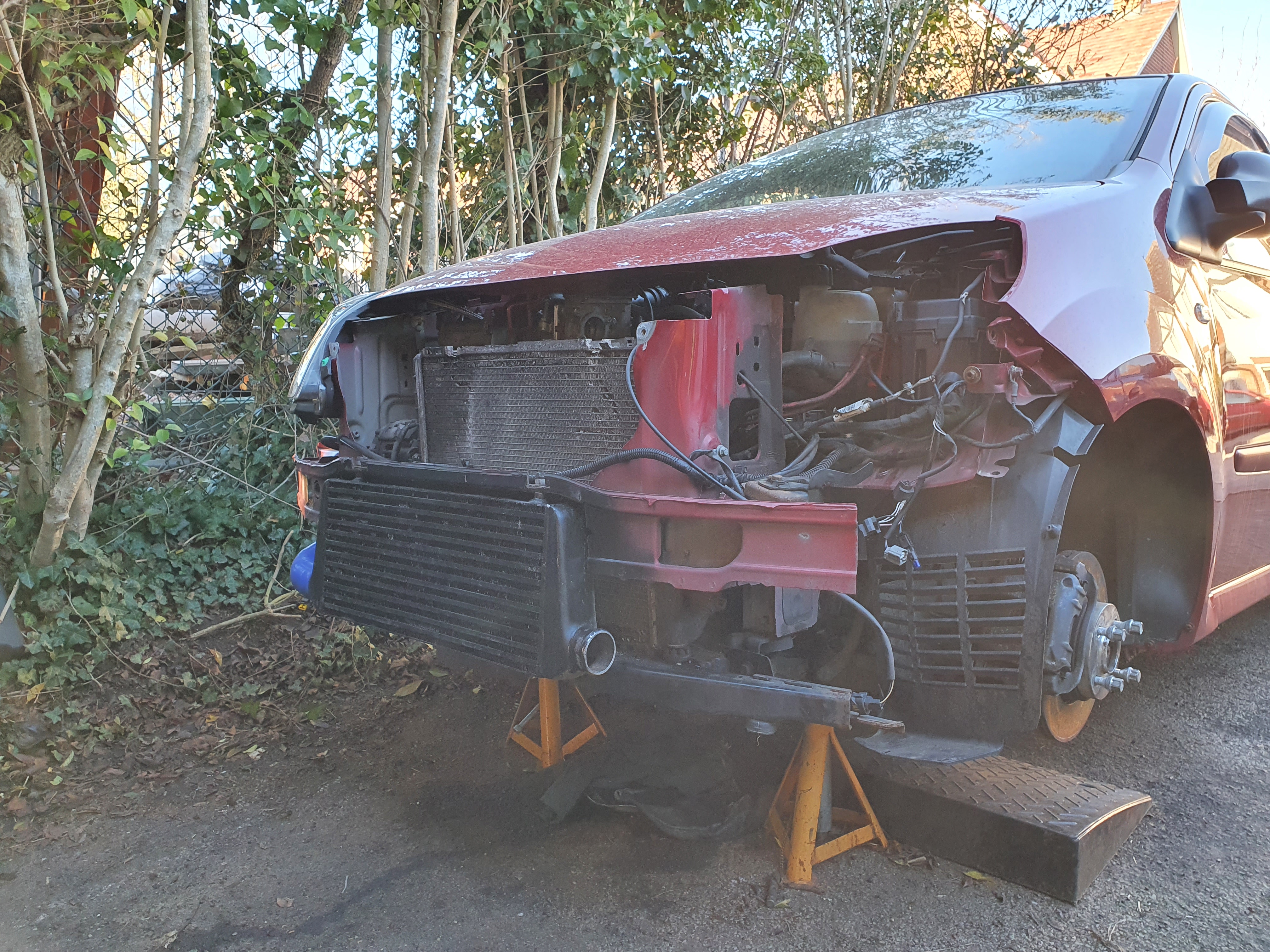

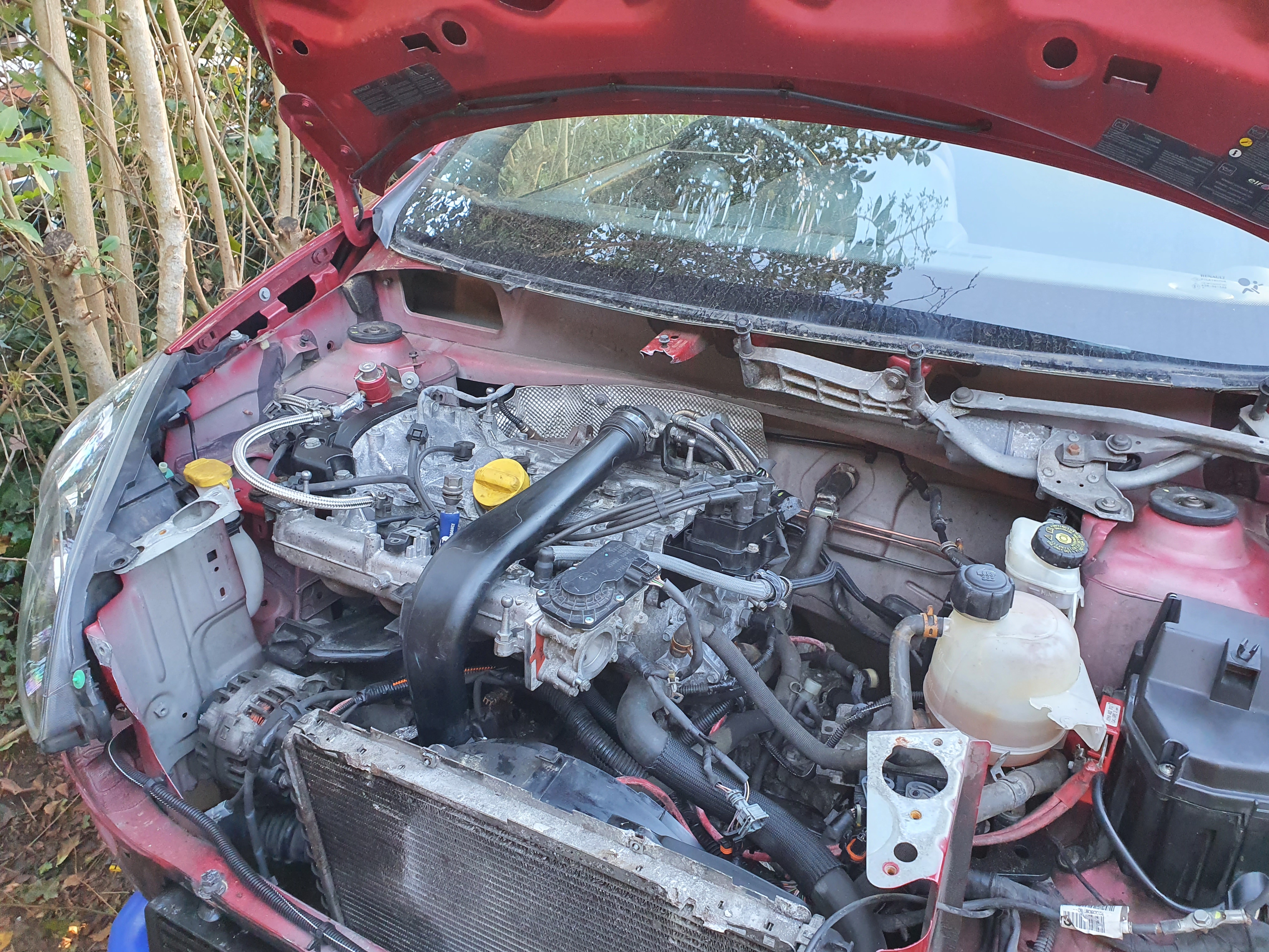

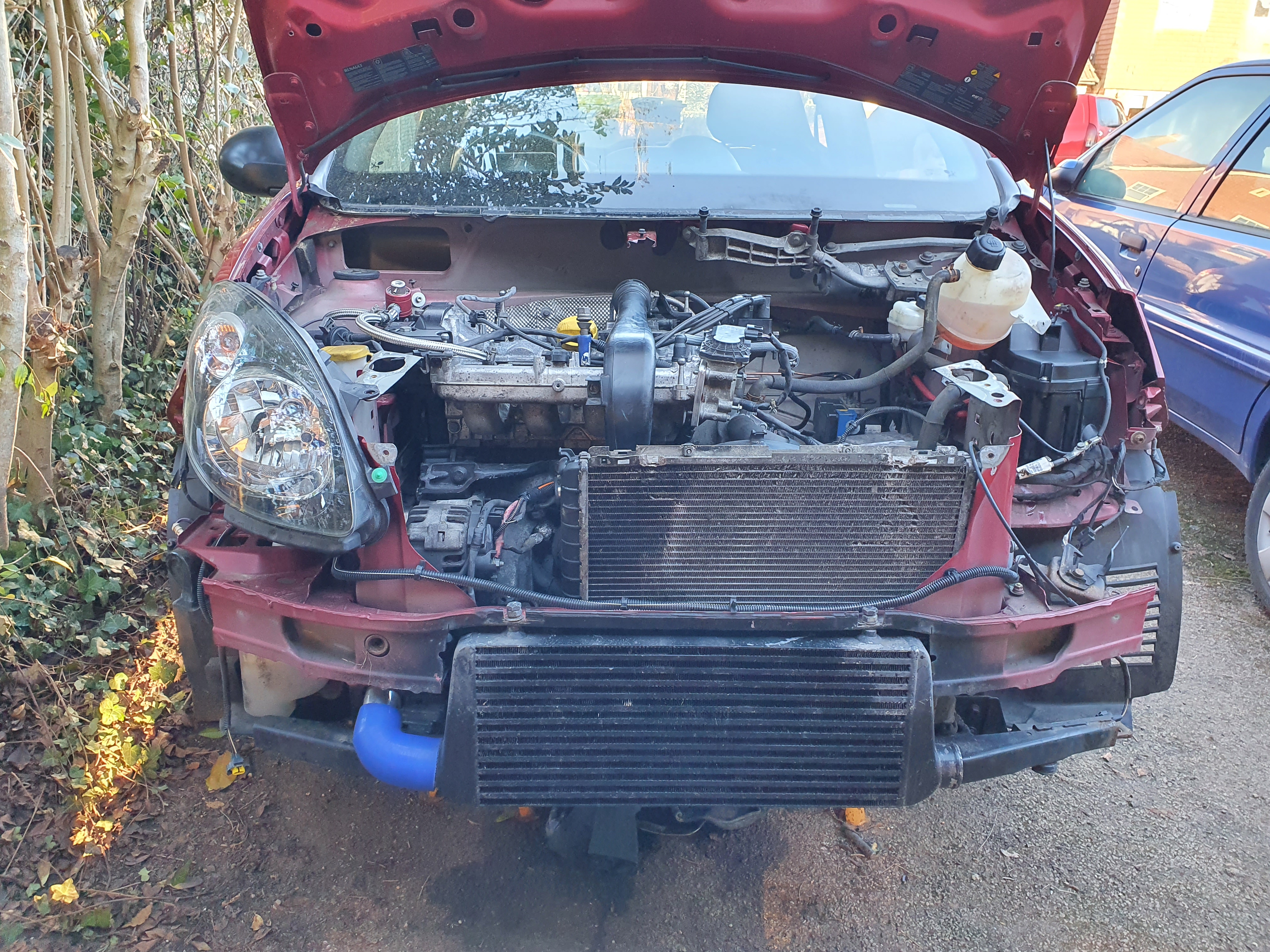

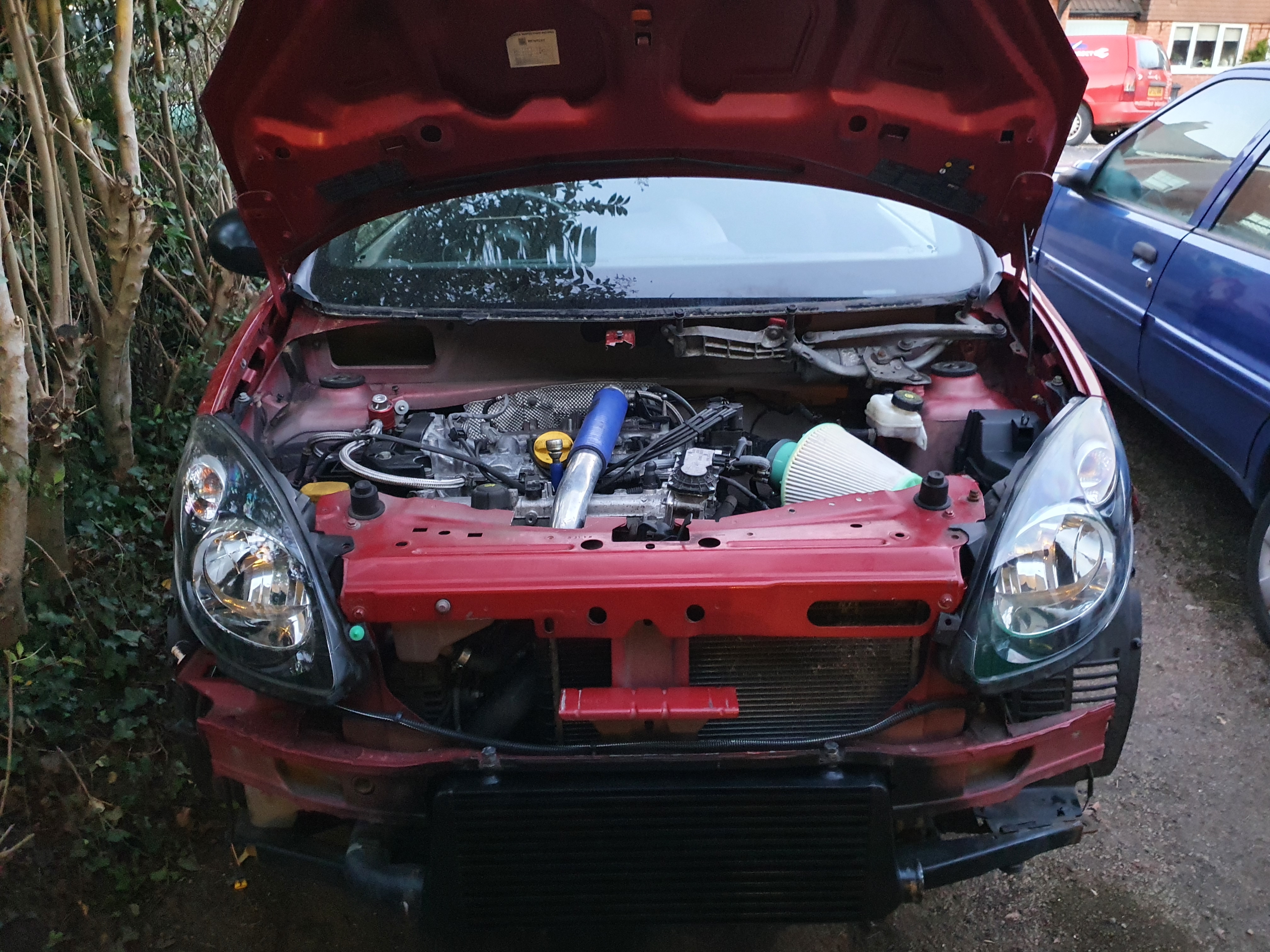

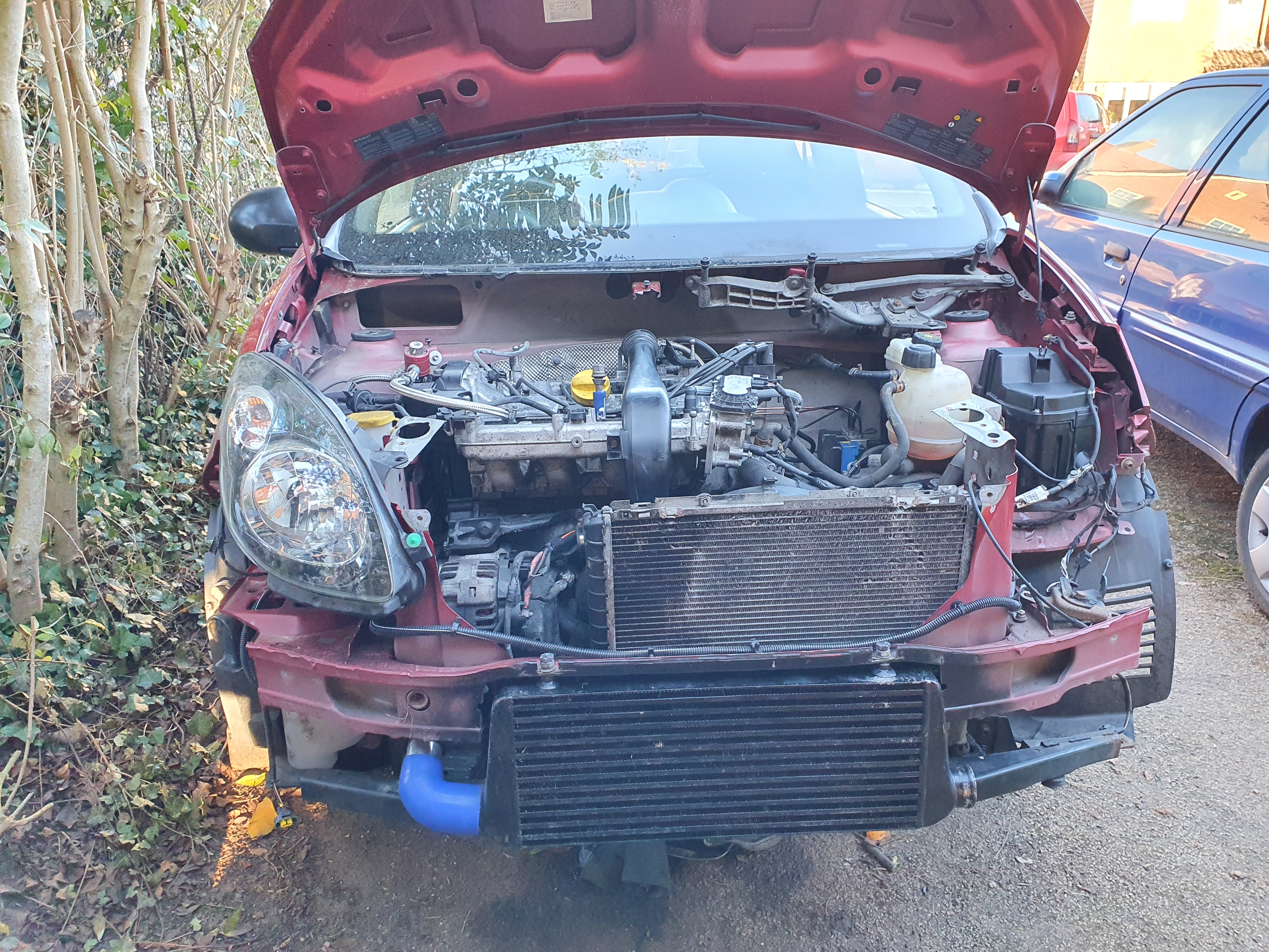

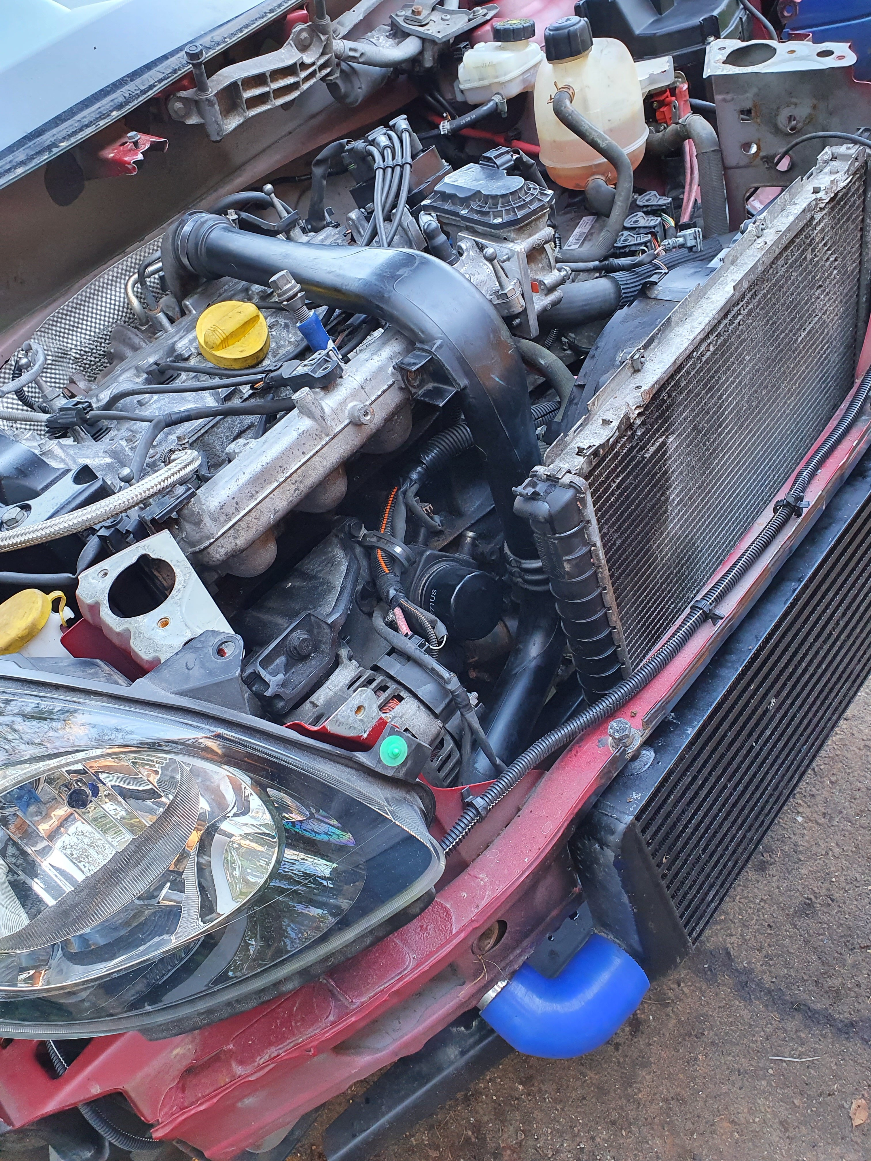

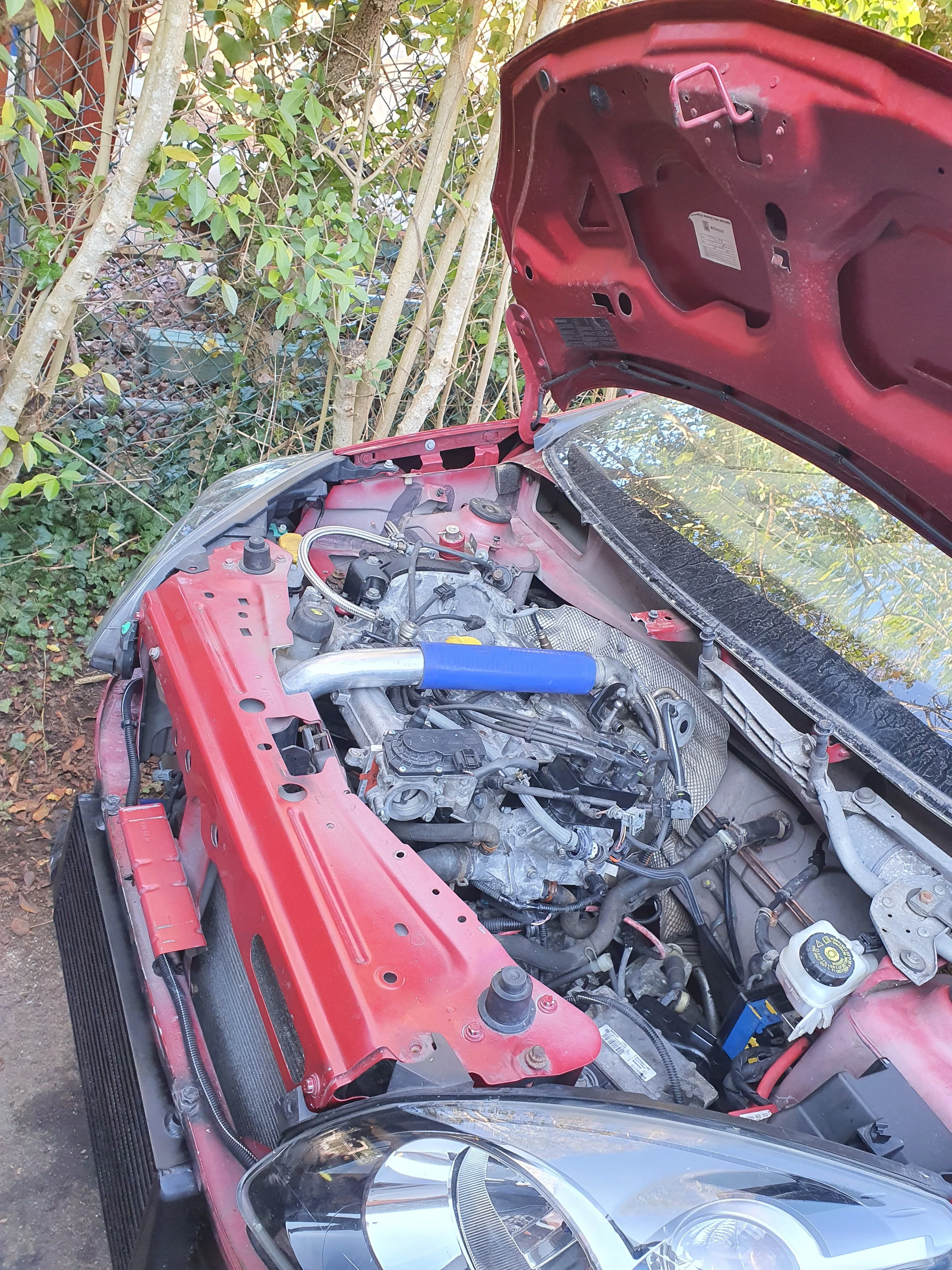

Looked at the boost pipework, the laguna boost pipe lines up lovely with the fmic and should do the job nicely, just need to trim a little of the fan shroud to give it some space.
Piped up the brake servos vacuum, used part laguna joined to the stock GT line and clamped it to the coil bracket.

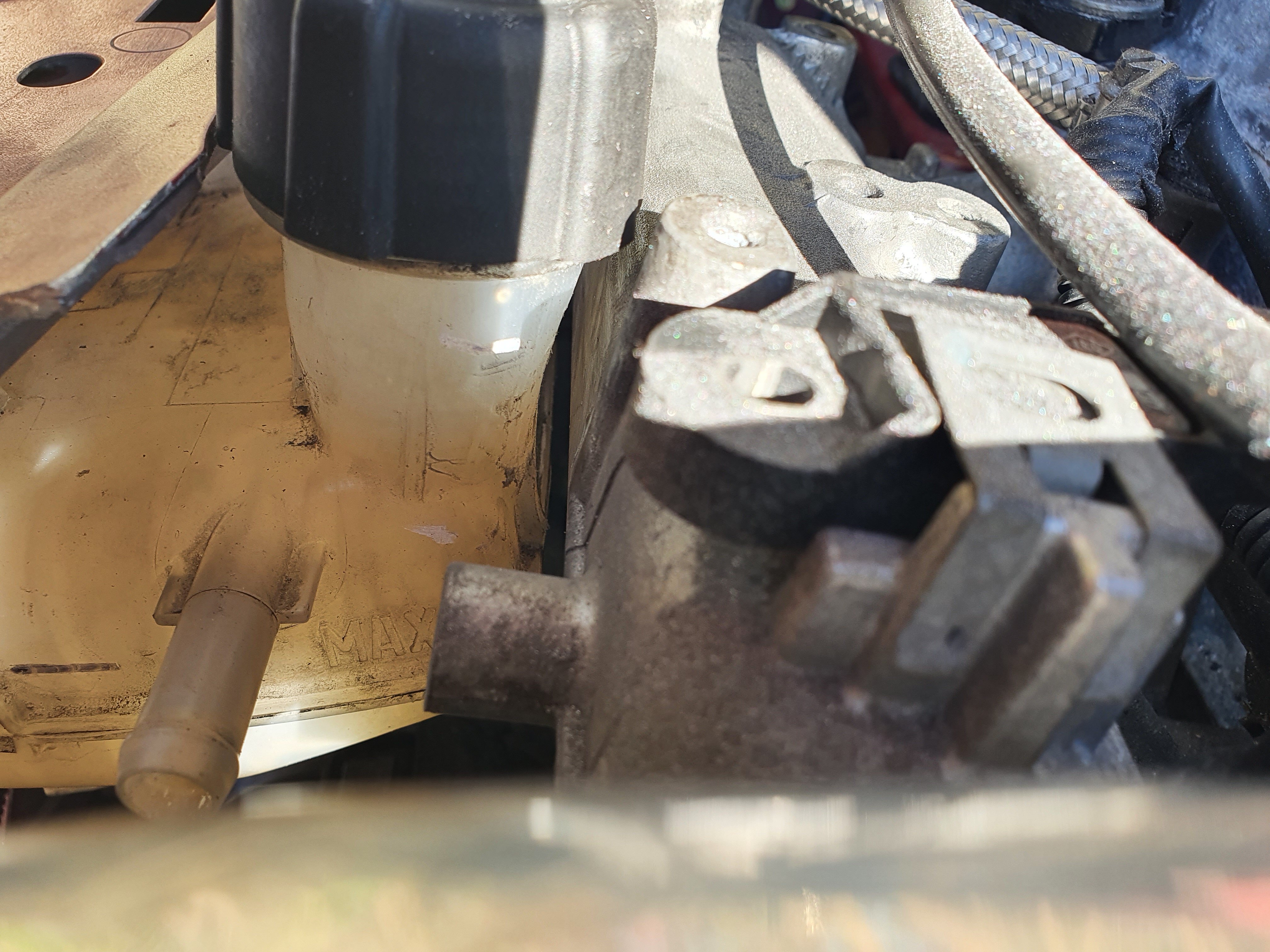

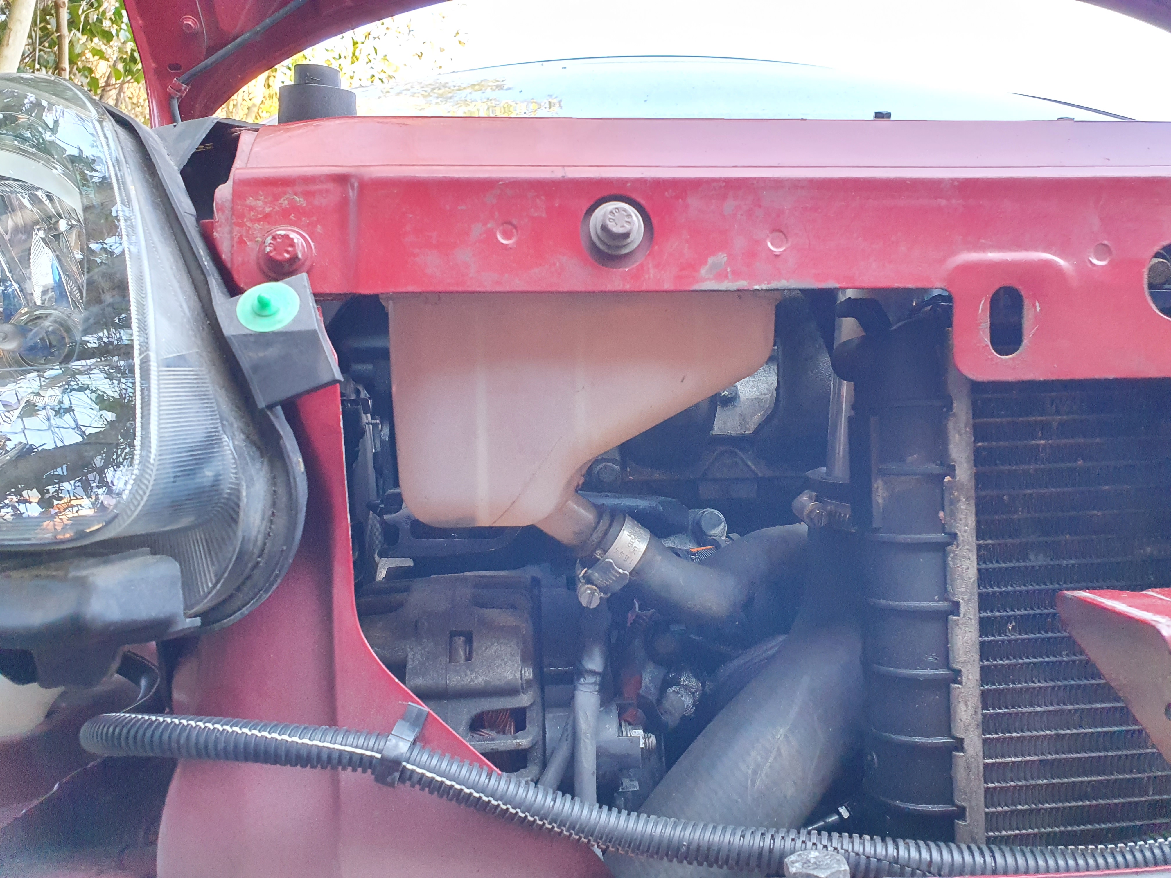

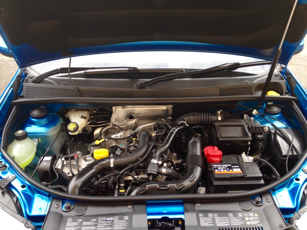

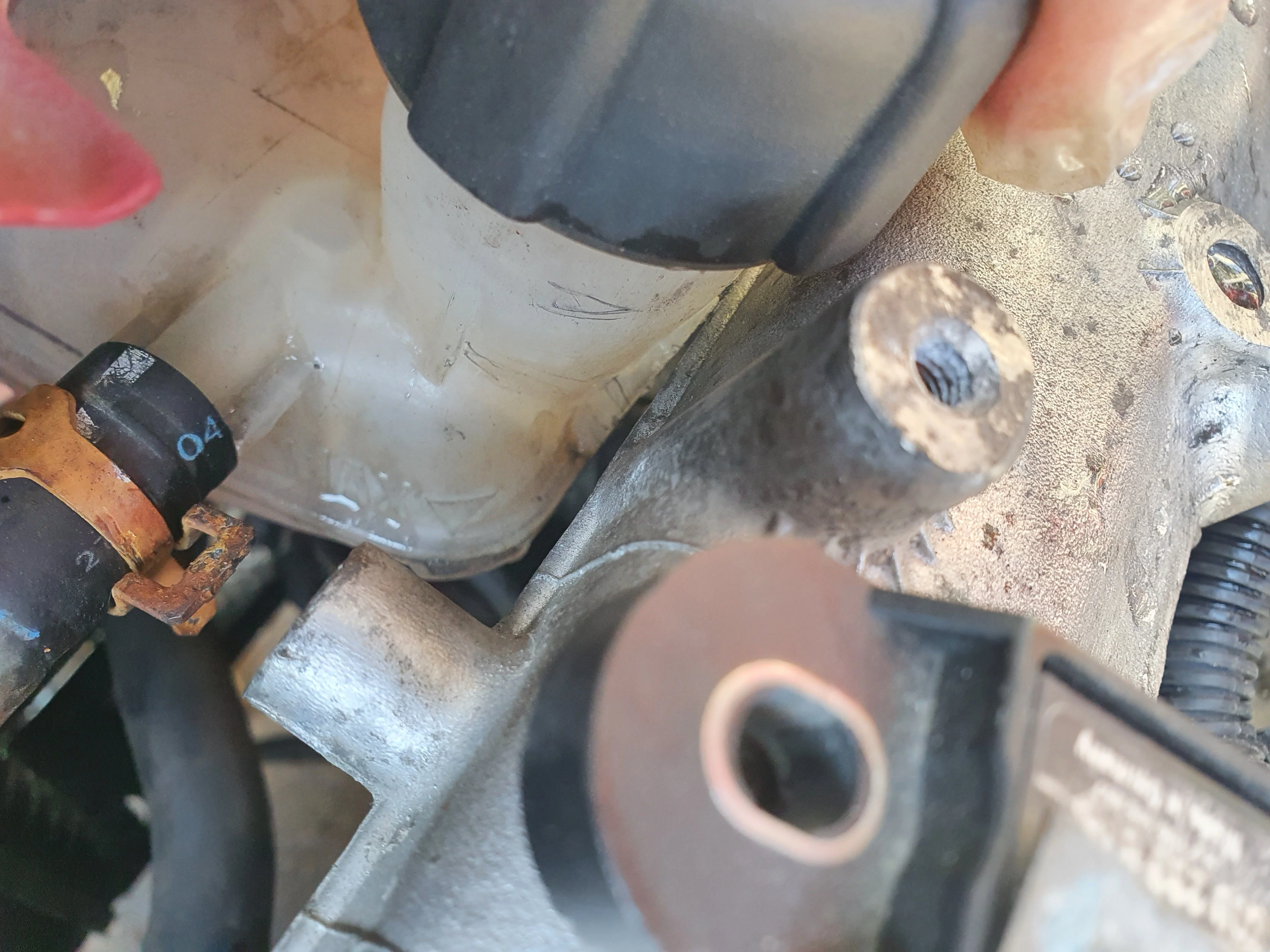

Briefly I thought I may be able to use the twingos original header tank, would be amazing though the inlet manifold touches it, I'm tempted to see If I can maybe remould it a little to suit as it would be a way neater to have it beside the rad than the Clio one on a bracket above where the battery was.
Still plenty to do but another good day of progress.
Adey.

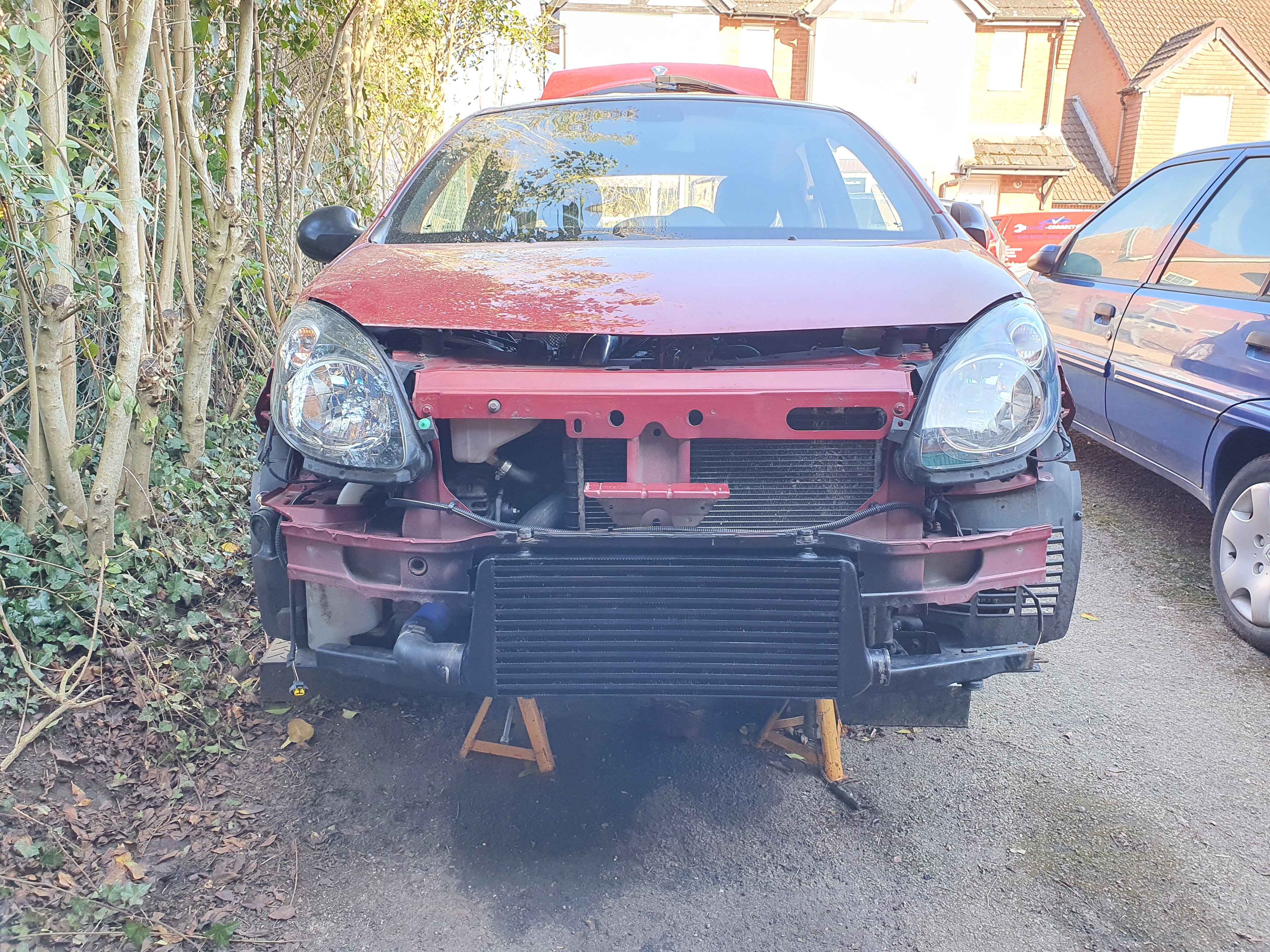

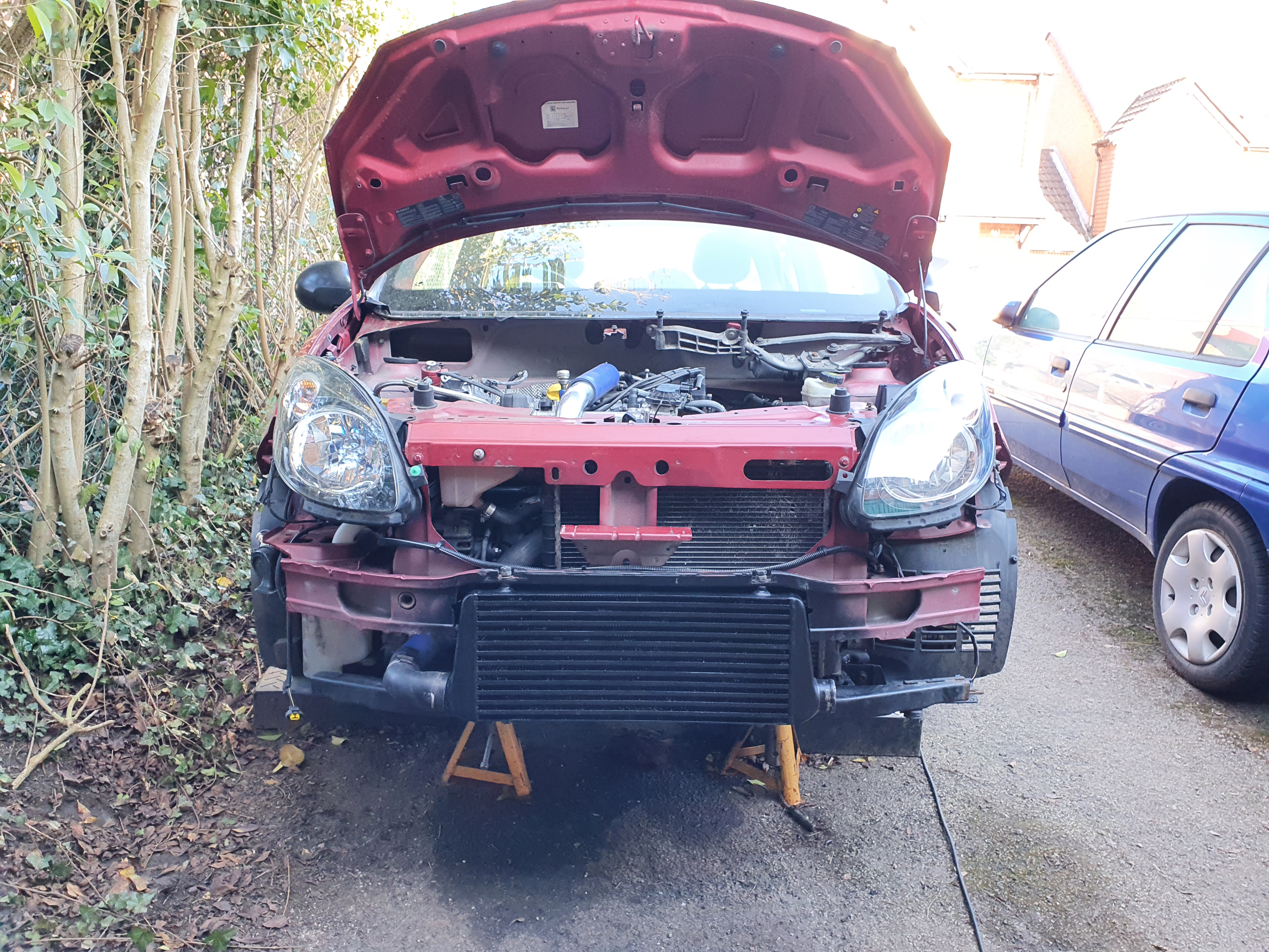

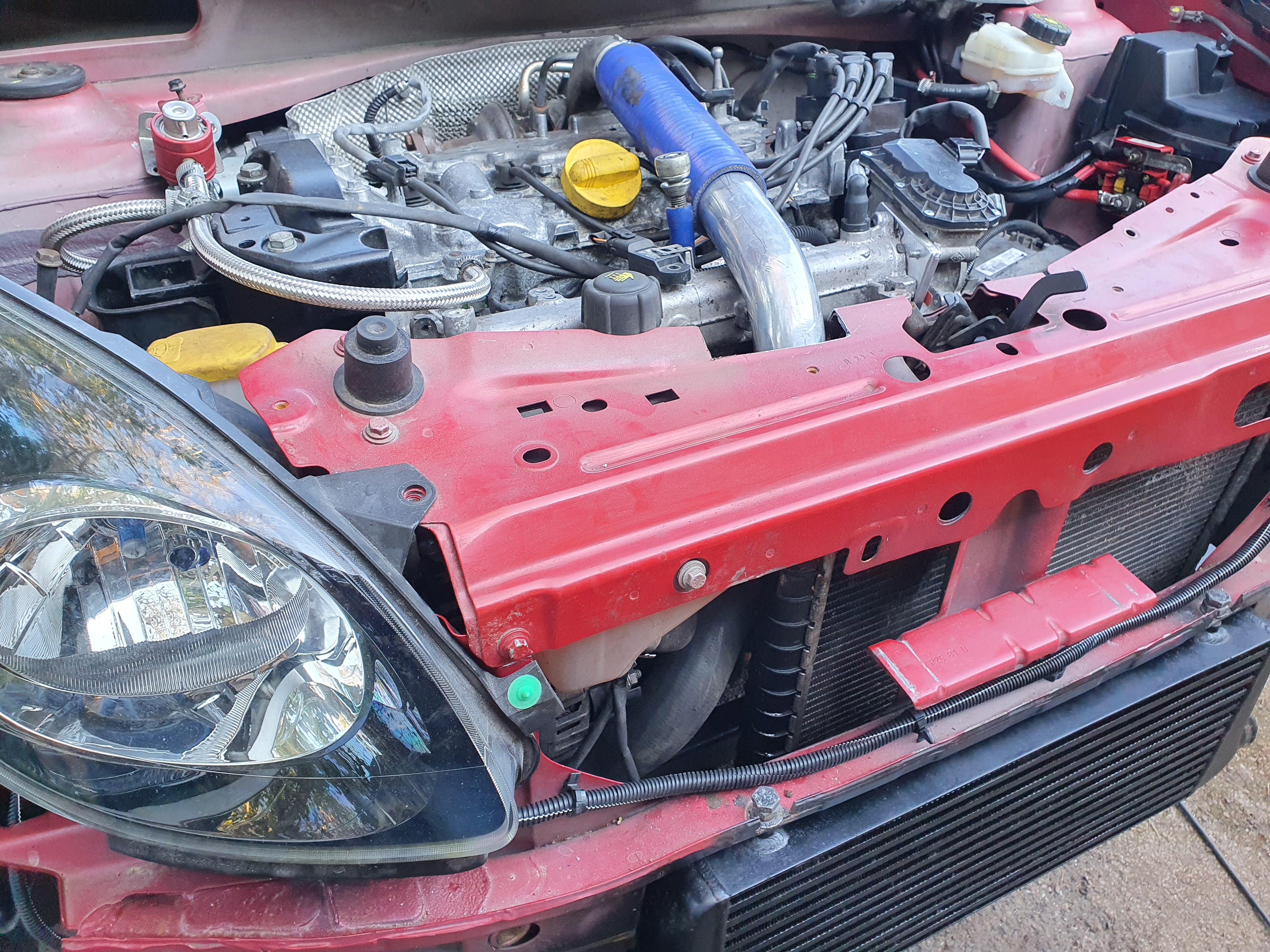

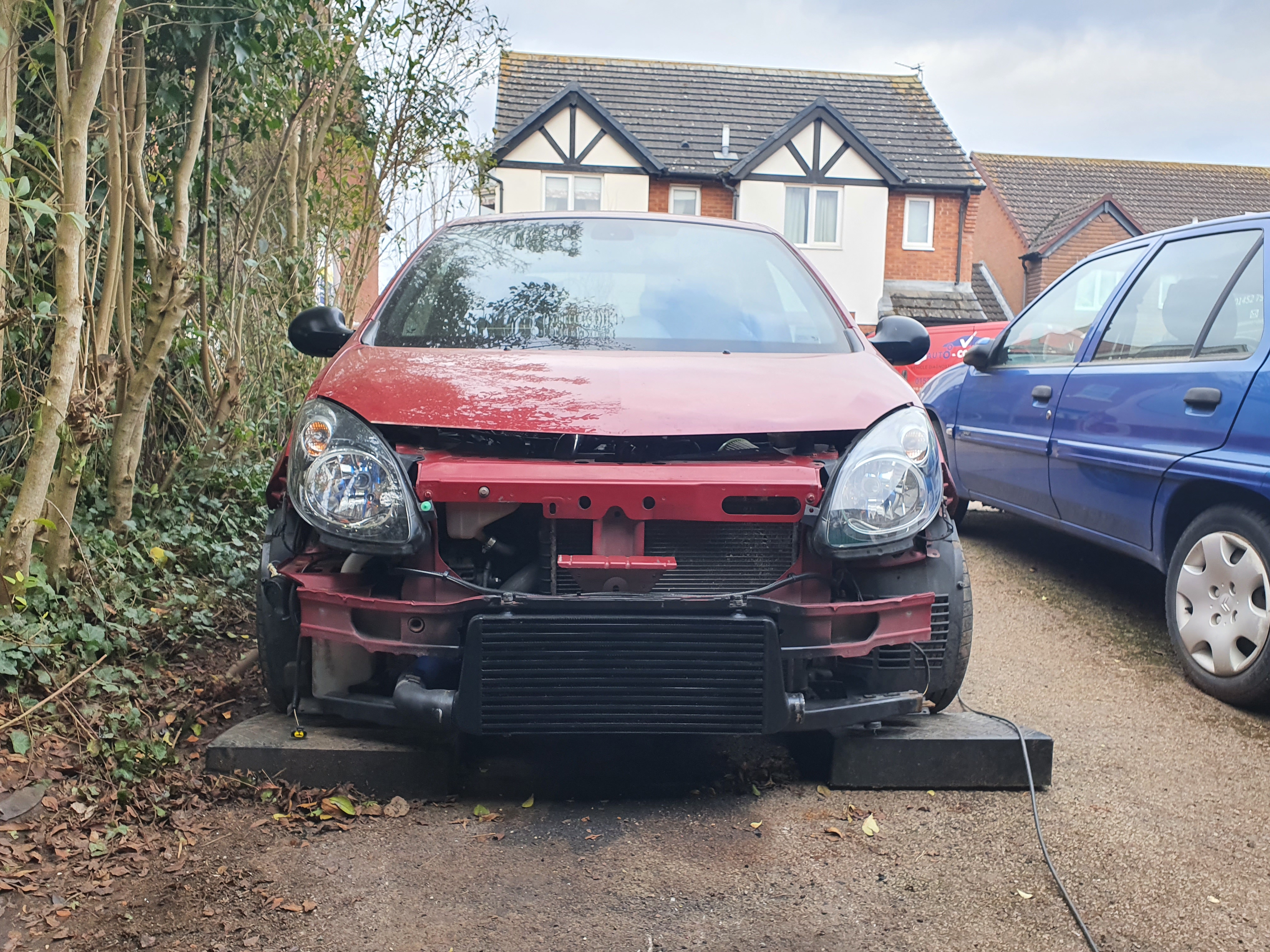

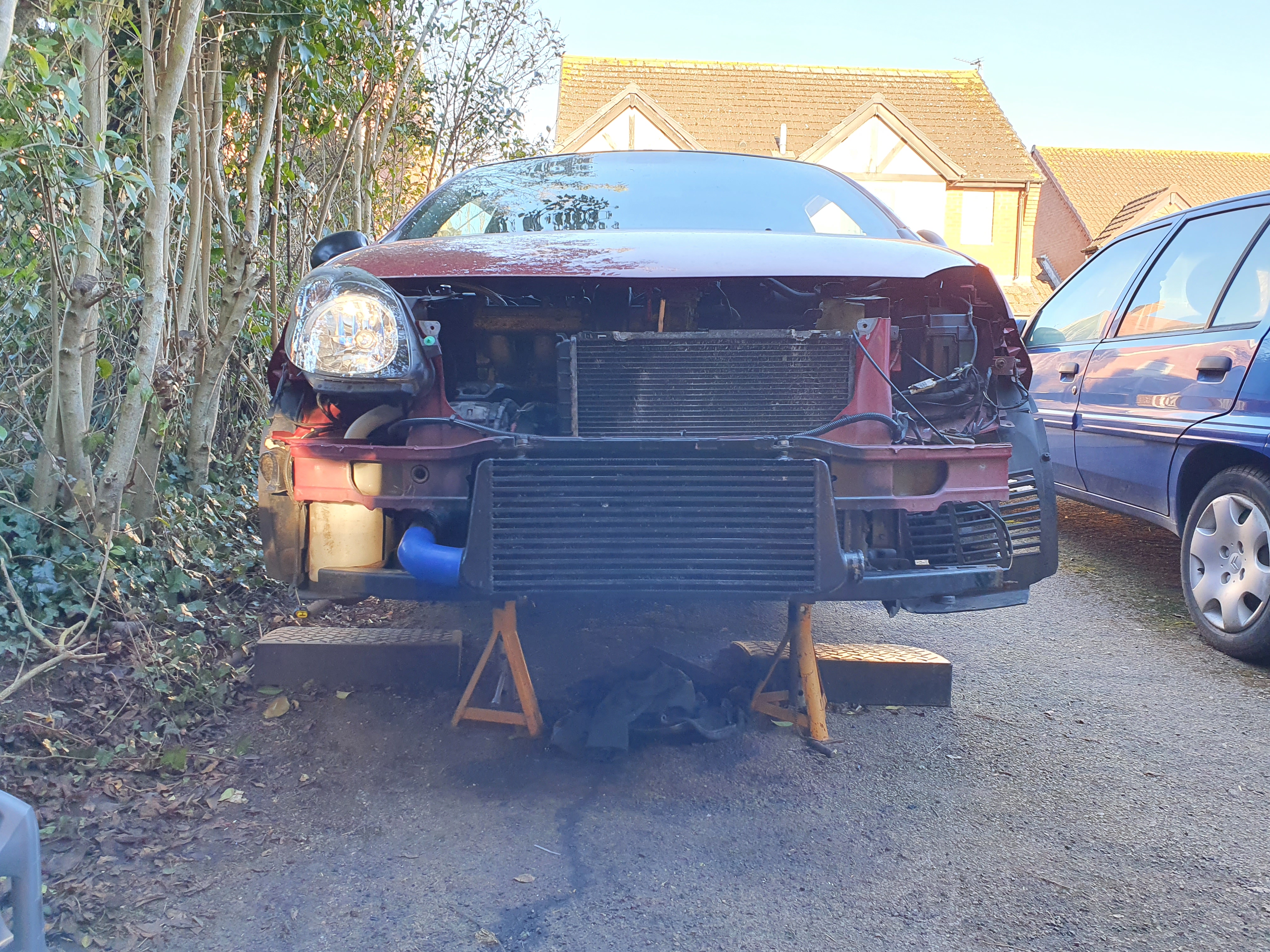

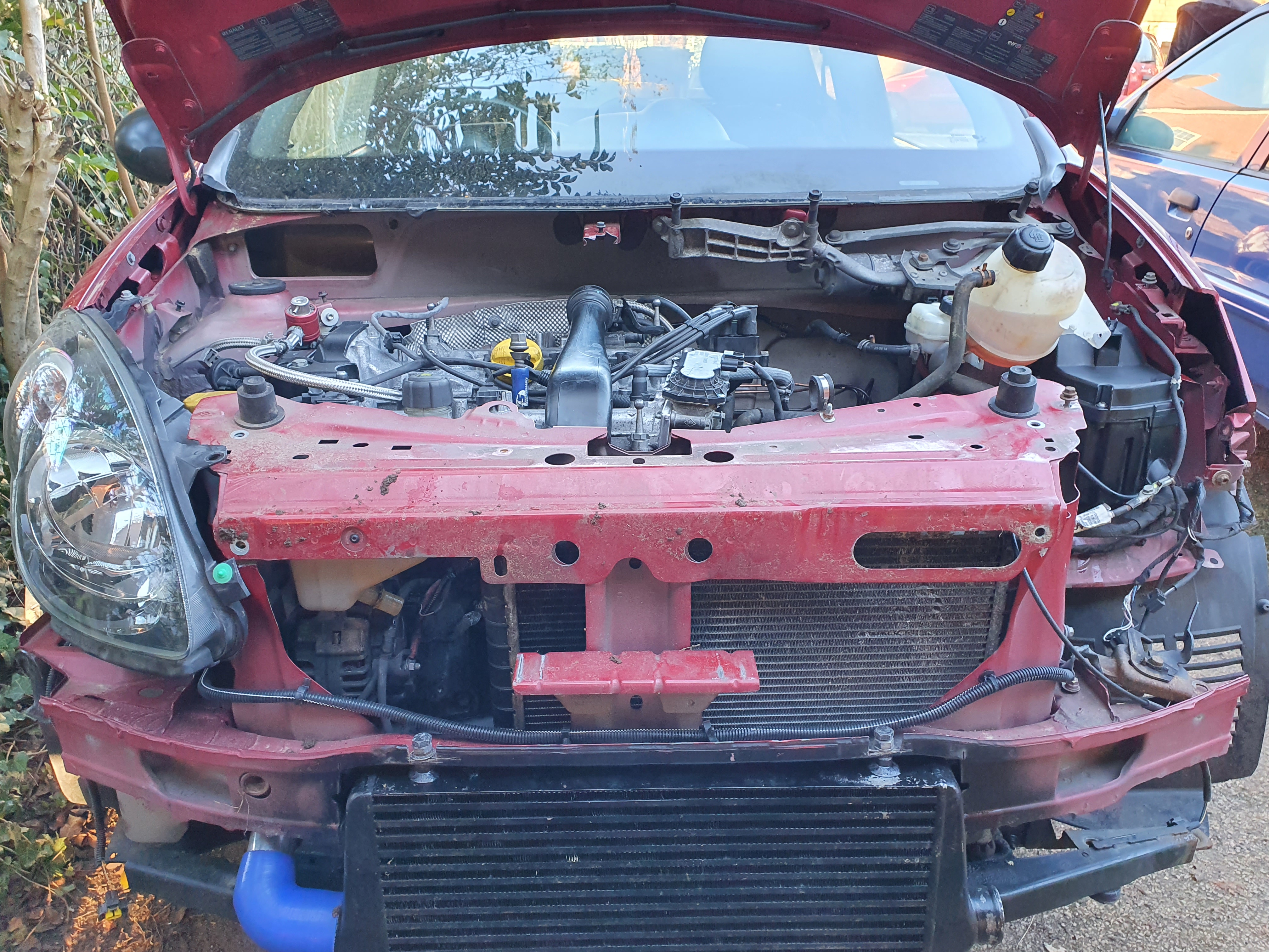

It's all getting abit snug in there now. I trimmed the oem header tanks mounting points to shift it back 5mm but really it needs more. I will shave the webbing off that's close by and may try warming it up and reshaping it a little. Would be great if it works as it frees up space elsewhere. I also had a good look over the boost pipe on @Moggy's advice and found a very well hidden but big split. No big issue as if I use the oem header tank I cant fit it in as well so out with some spare pipes to rough out the boost pipe run. Will need one top pipe making but nowt major to overcome on the hot side.
Also started loose fitting the front end on to get a better idea of things. It all need to come back off when I replace the rad but it all fits quite well back there. A lot more cramped than the old 1149cc unit but not actually that bad.

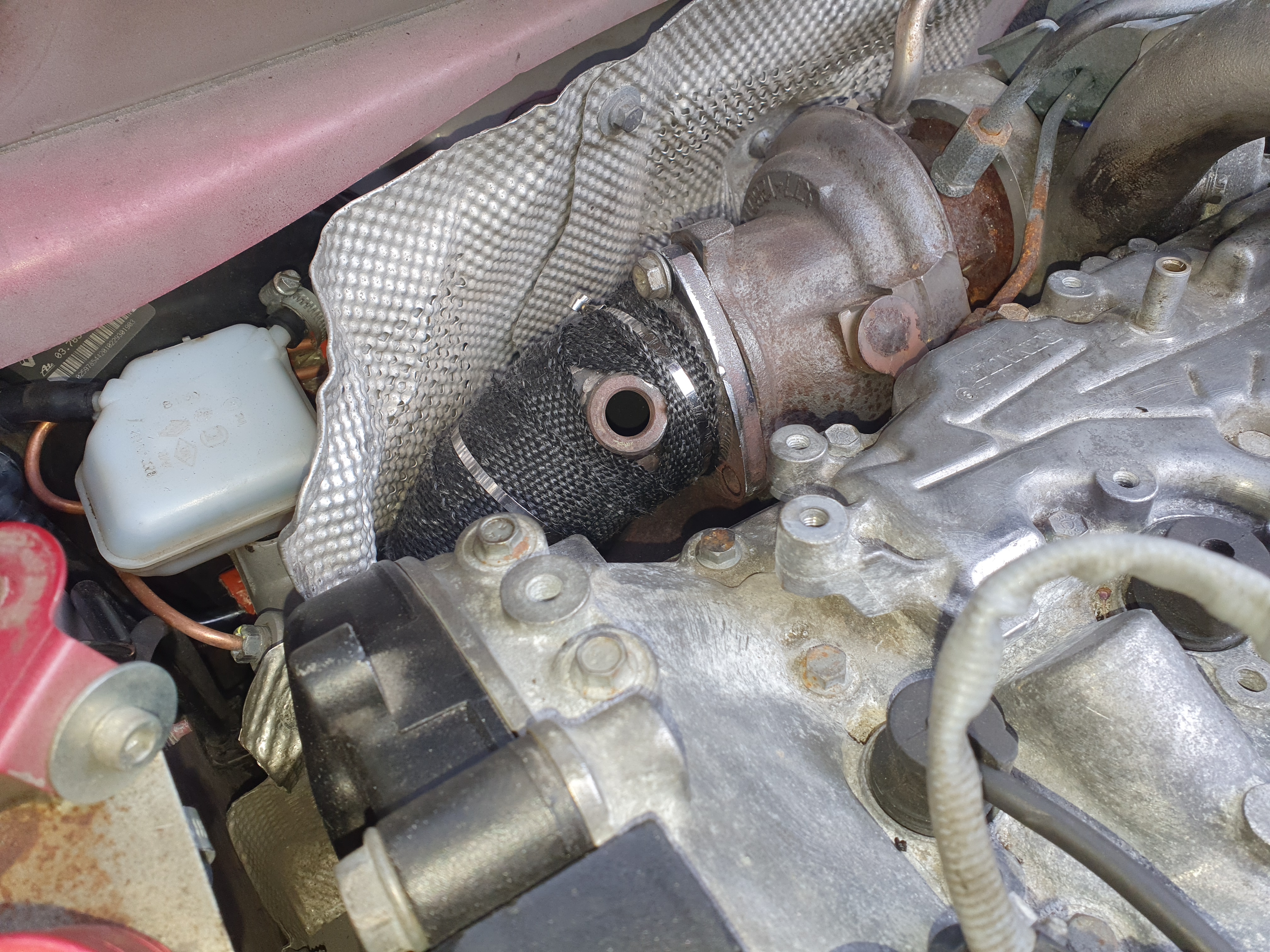

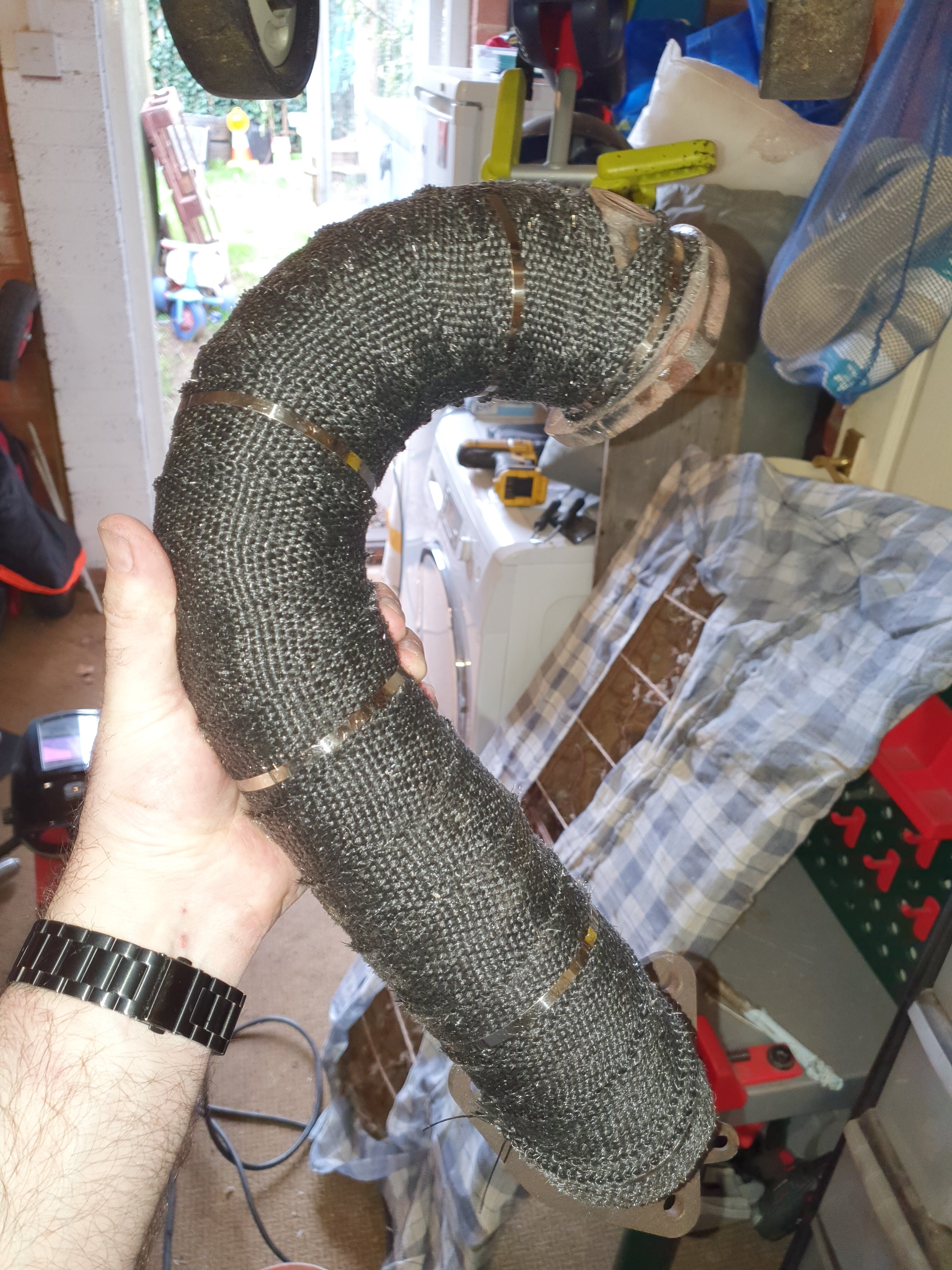

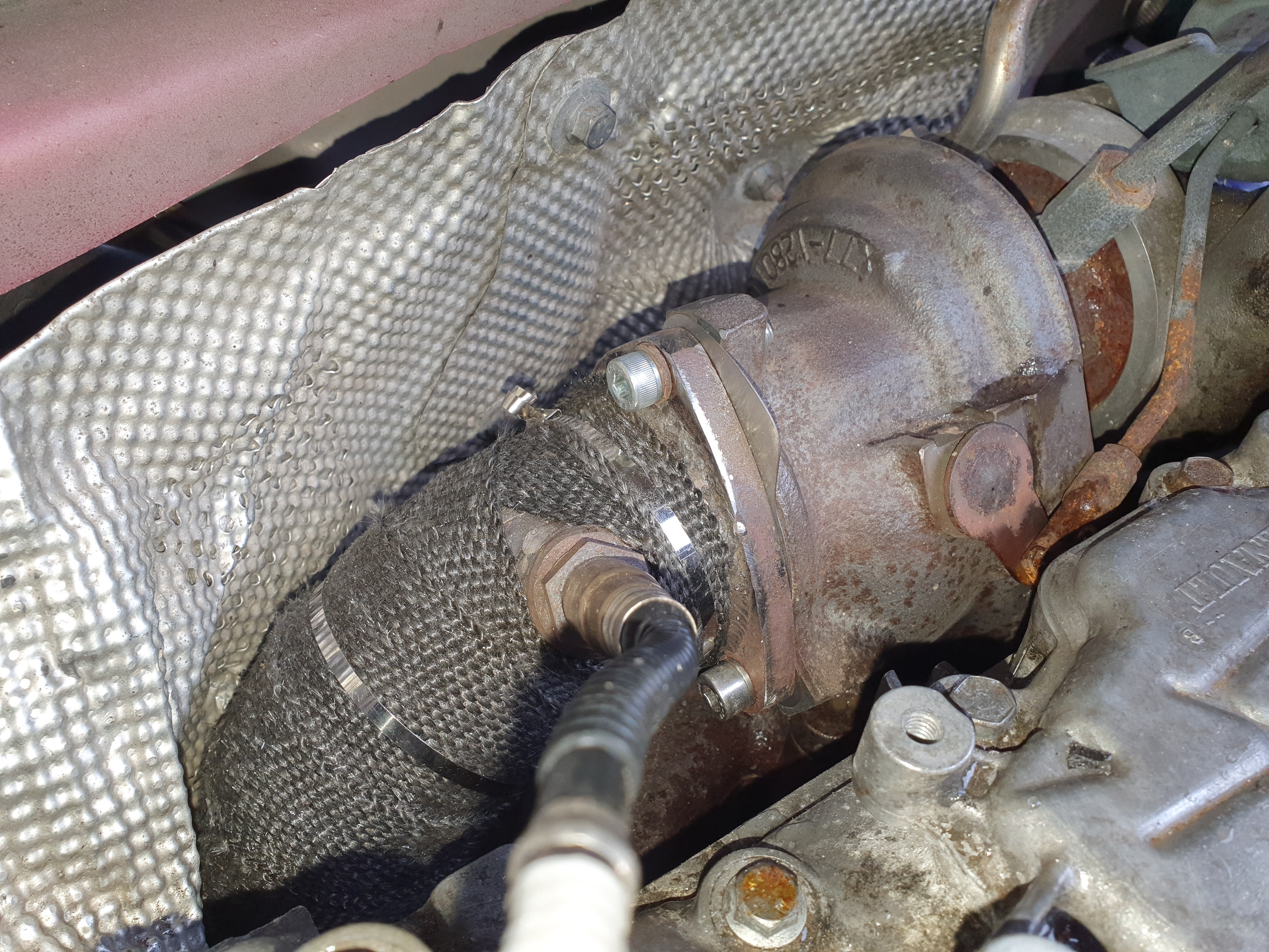

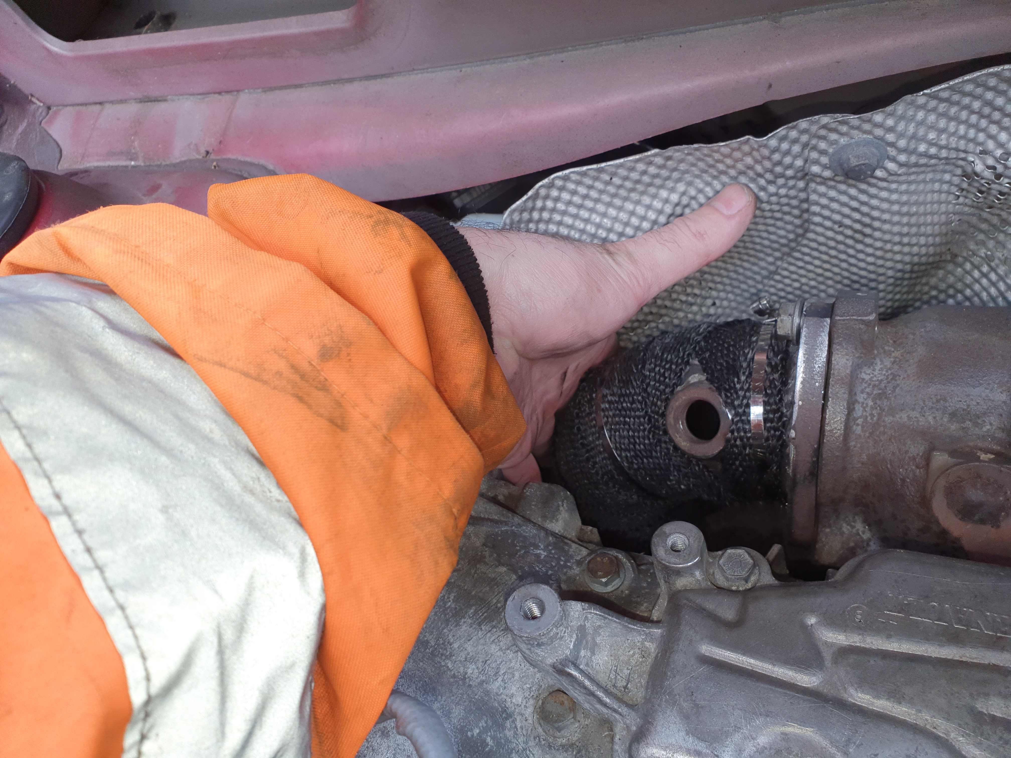

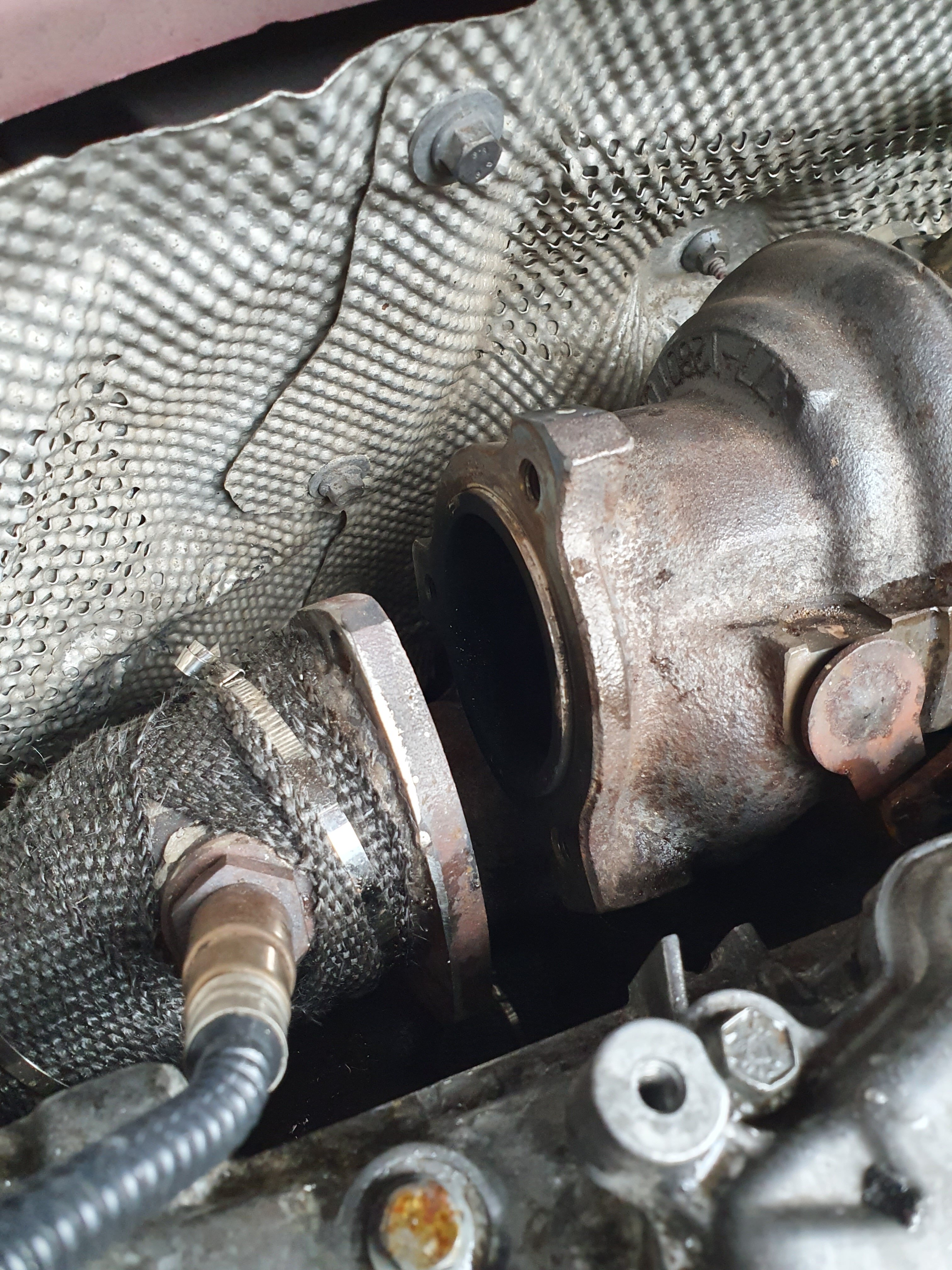

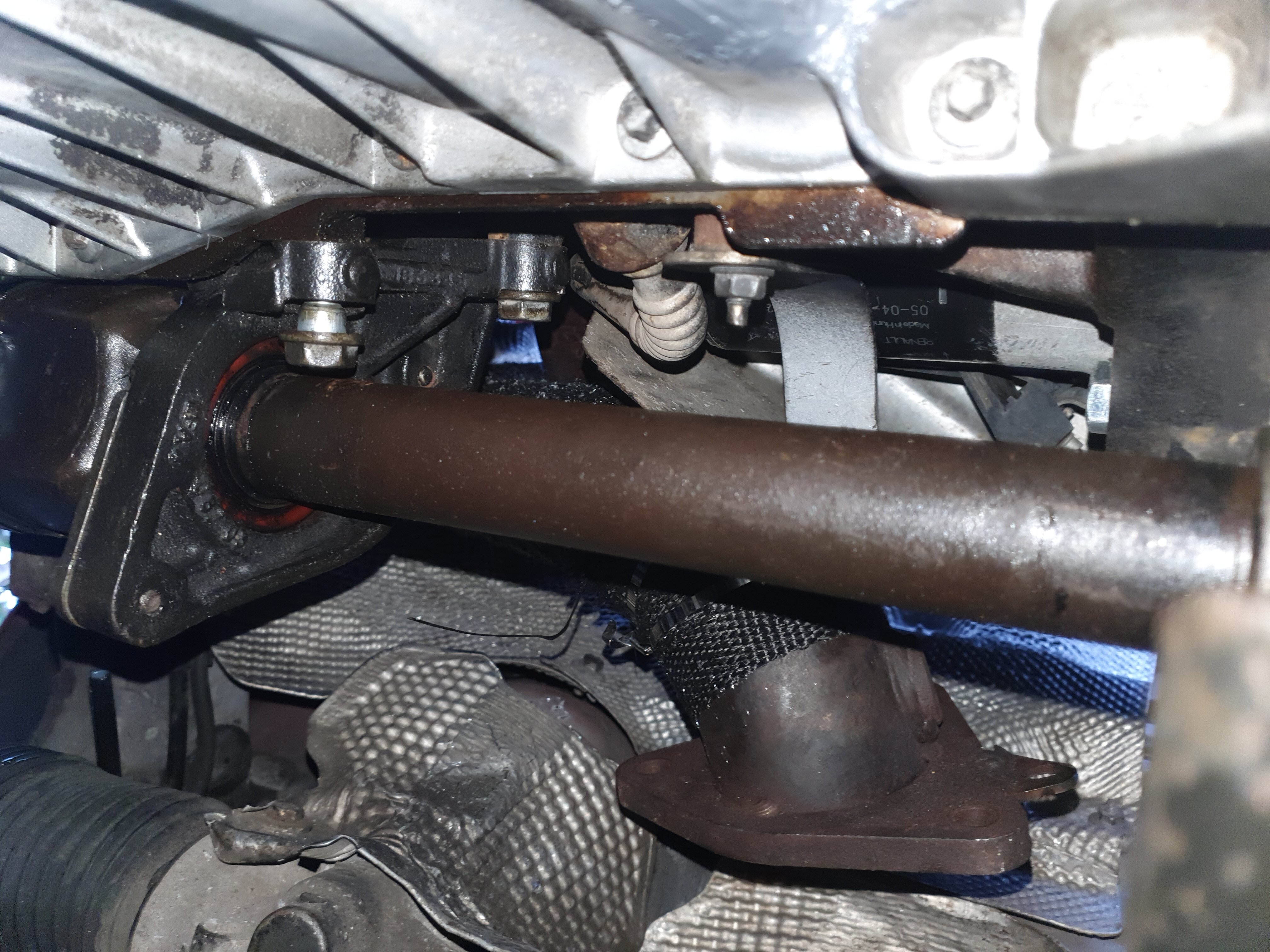

I won't embarrass myself with pics of my poor welding repair on the down pipe but it's done wrapped and back on, just need a gasket so I can clamp it all up. Wrapped up there's space for me to stuff my fat fingers between it and the heat shield so hopefully its got enough clearance not to cook everything 🤞🏻 if it does we will just have to have a custom one made, or a 2.5 inch version fitting if there is such a thing?
I should have a driveshaft here tomorrow that might be the correct size needed for me to make a usable one, again fingers crossed 🤞🏻

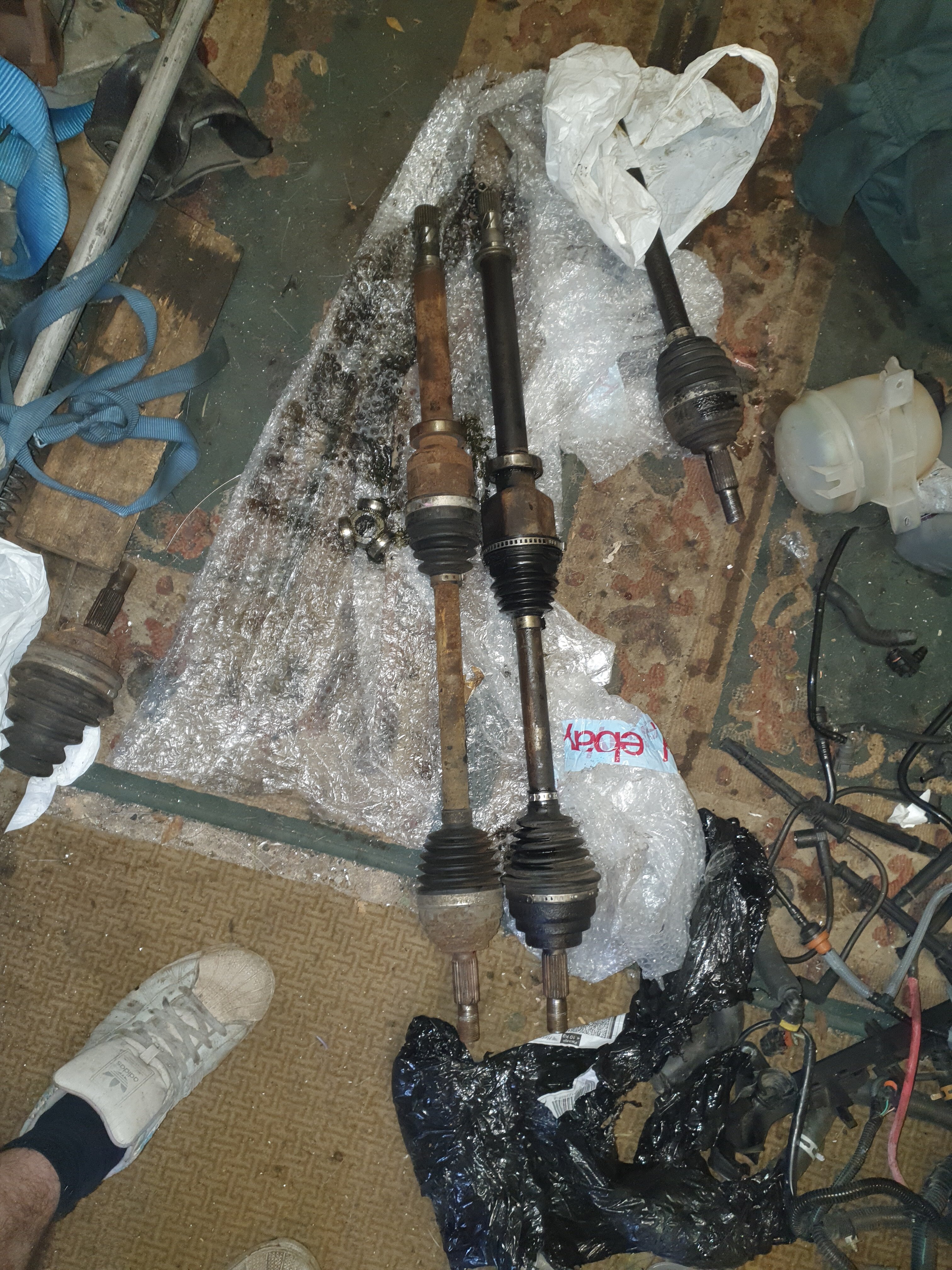

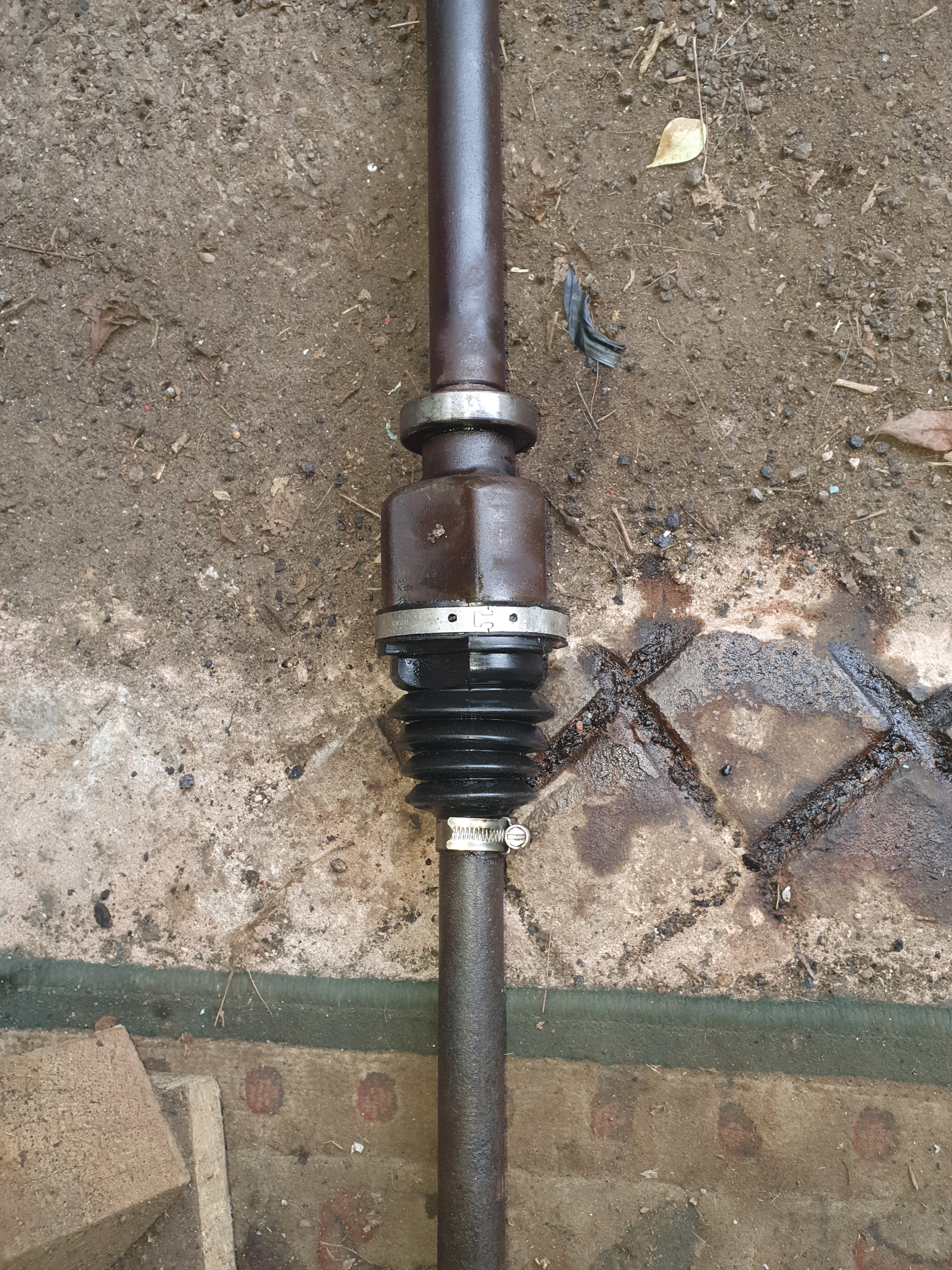

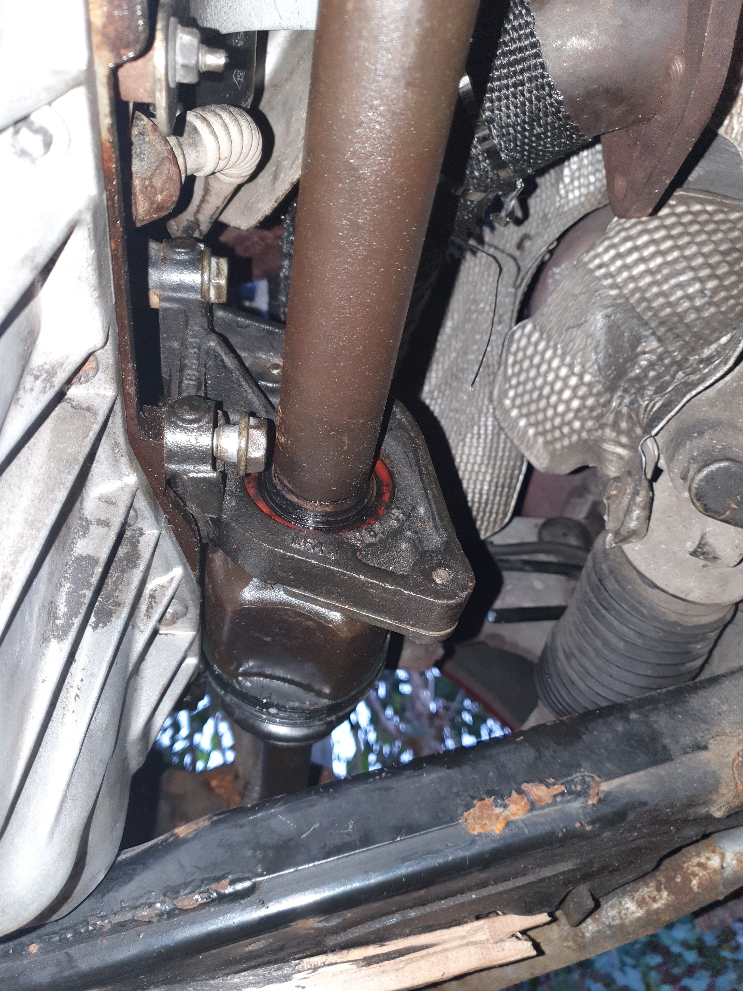

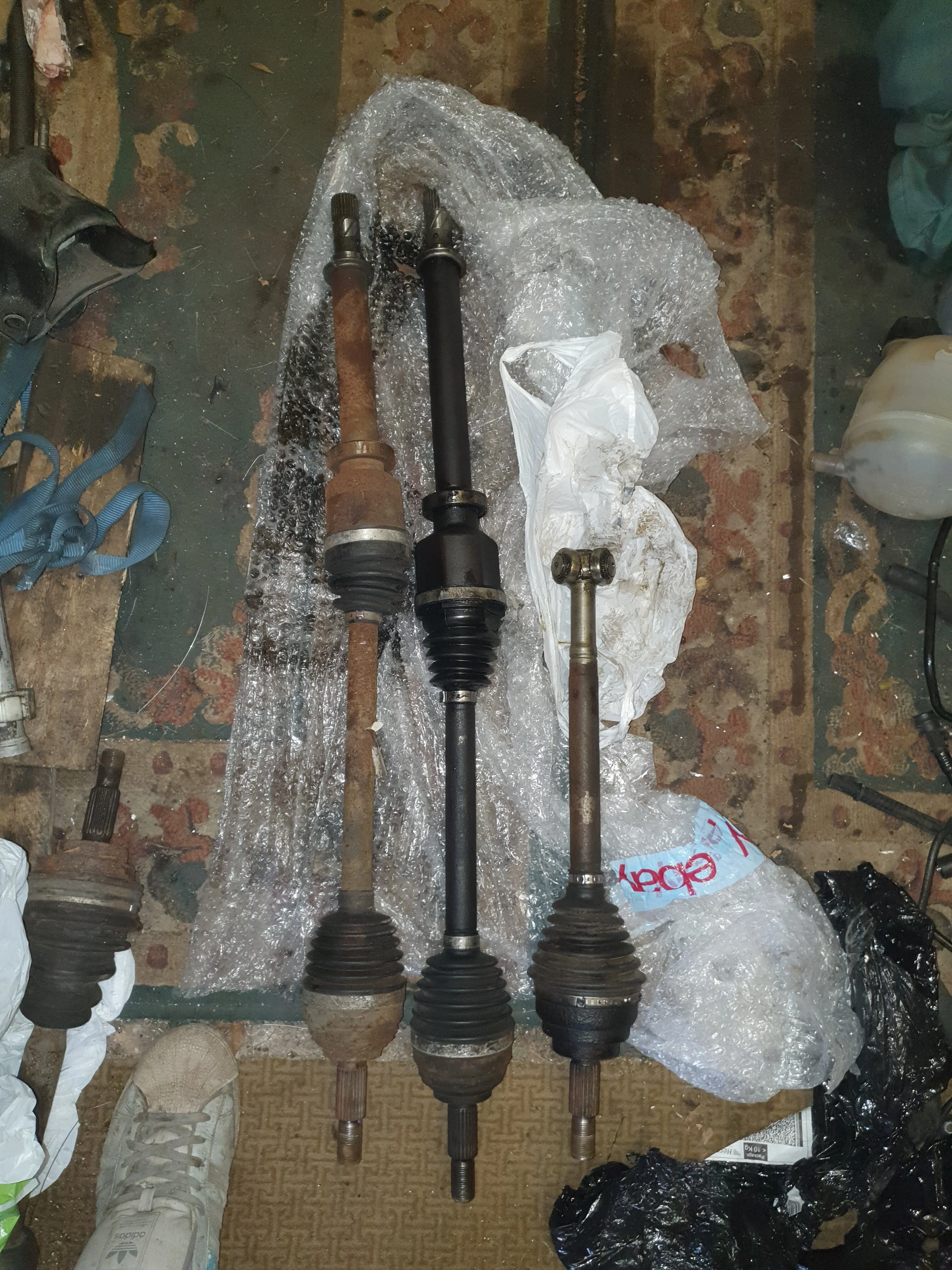

So here's a fun PMT fix after my driveshaft issue. Take one £13 clio mk3 dci shaft and strip it down, rebuild it with a 172 outer half shaft but dci spider and voilà one shaft thats looks pretty suitable. It needs bolting up with a 172/na/f4r support bearing as the one for the f4rt/197/bigger gearbox sits too far from the block. I do need to shave the block a touch to miss the inner cv boot and give a little clearance as that's super close. But Renault parts bin special looks to have saved me getting custom shafts made too 👍🏻😎
pics are crap.
First pic is GT shaft, dci shaft and 172 half. Second pic is the GT shaft and the hybrid.

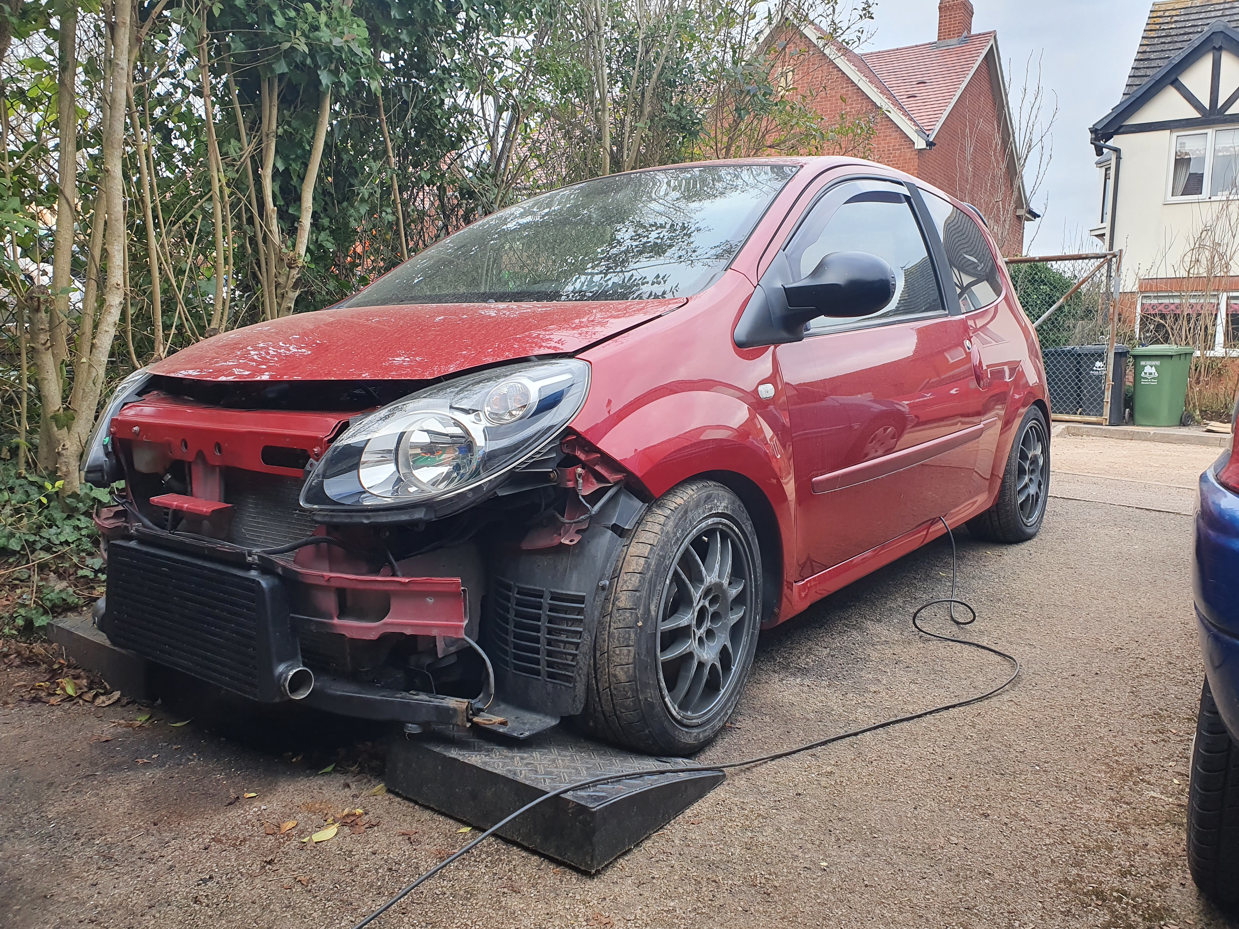

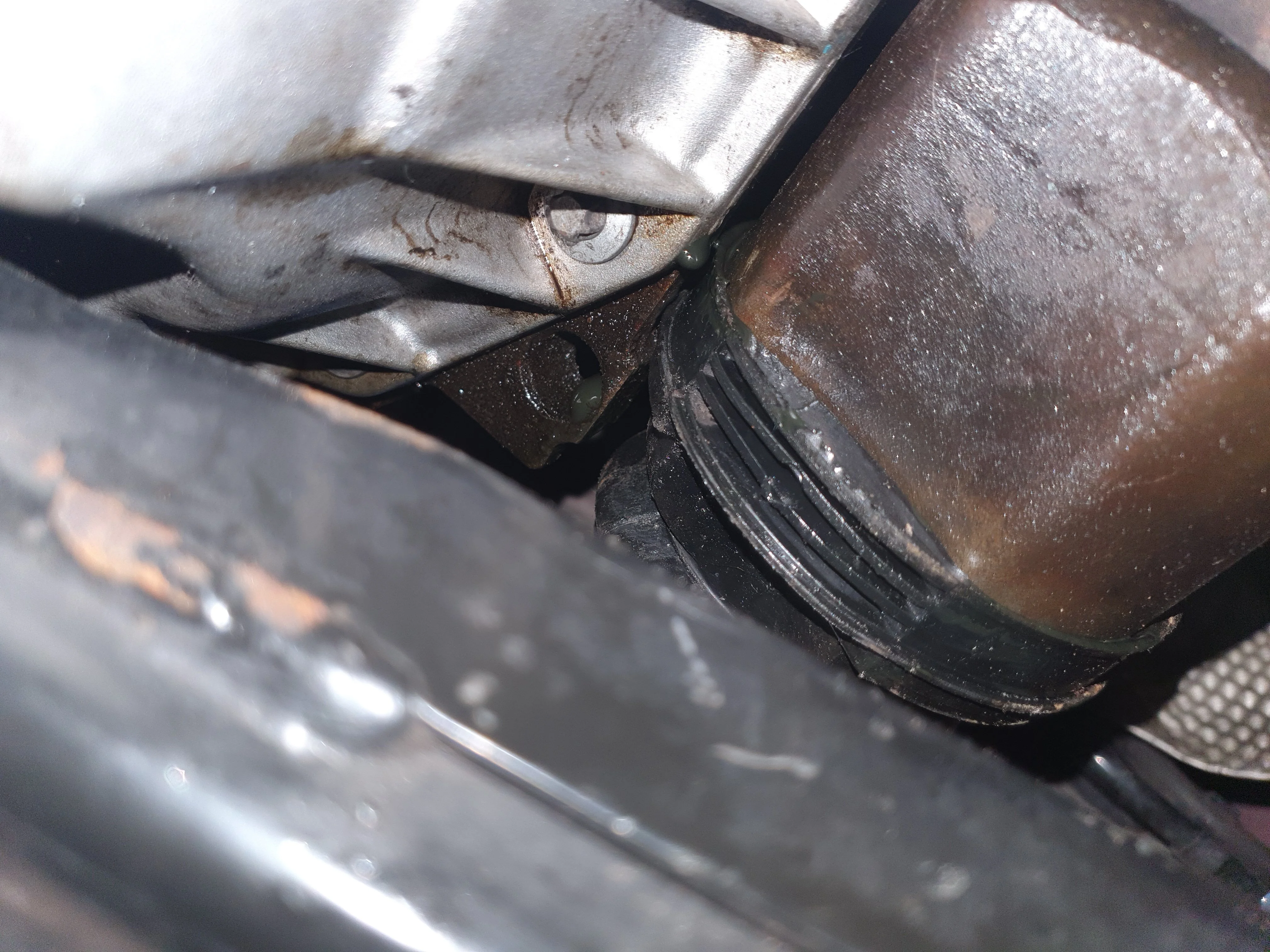

Didn't get as far as I wanted today but I did hit that milestone of putting it back on all 4 wheels. Granted its got to go back in the air again but its a big moment for anyone building any car, feels like one huge step towards driving it.
I removed the driveshaft assembly and took a slitting disk to the block, Im pretty sure it's new casting vs the old 172 f4r but serves no purpose for me other than to being too close to my inner cv joint. 30 seconds with a slitting disk followed by 30 with the flap wheel and jobs a goodun 👍🏻
Shaft was built up for the final time and fitted with the 172 intermediate bearing on the block. I had to pop out for a hospital appointment so swung by the local breakers yard on the way home for 2 hub bolts, I cut one off when disassembling and lost the other 🤷🏻‍♂️ but with them that meant both hubs could be nipped up and the main hub nuts cranked up too.
Wheels back on and rolled back on the drive, I did attempt a start as I want to spin it down the road and make sure all is smooth but the battery was flat. Phone also died half way through so didn't get any pics of the space I created on the block.
Still lots to do and though I've got plenty of time I'm seriously lacking funds so I'll just have to wait. On track for some road testing hopefully in April all being well 👍🏻

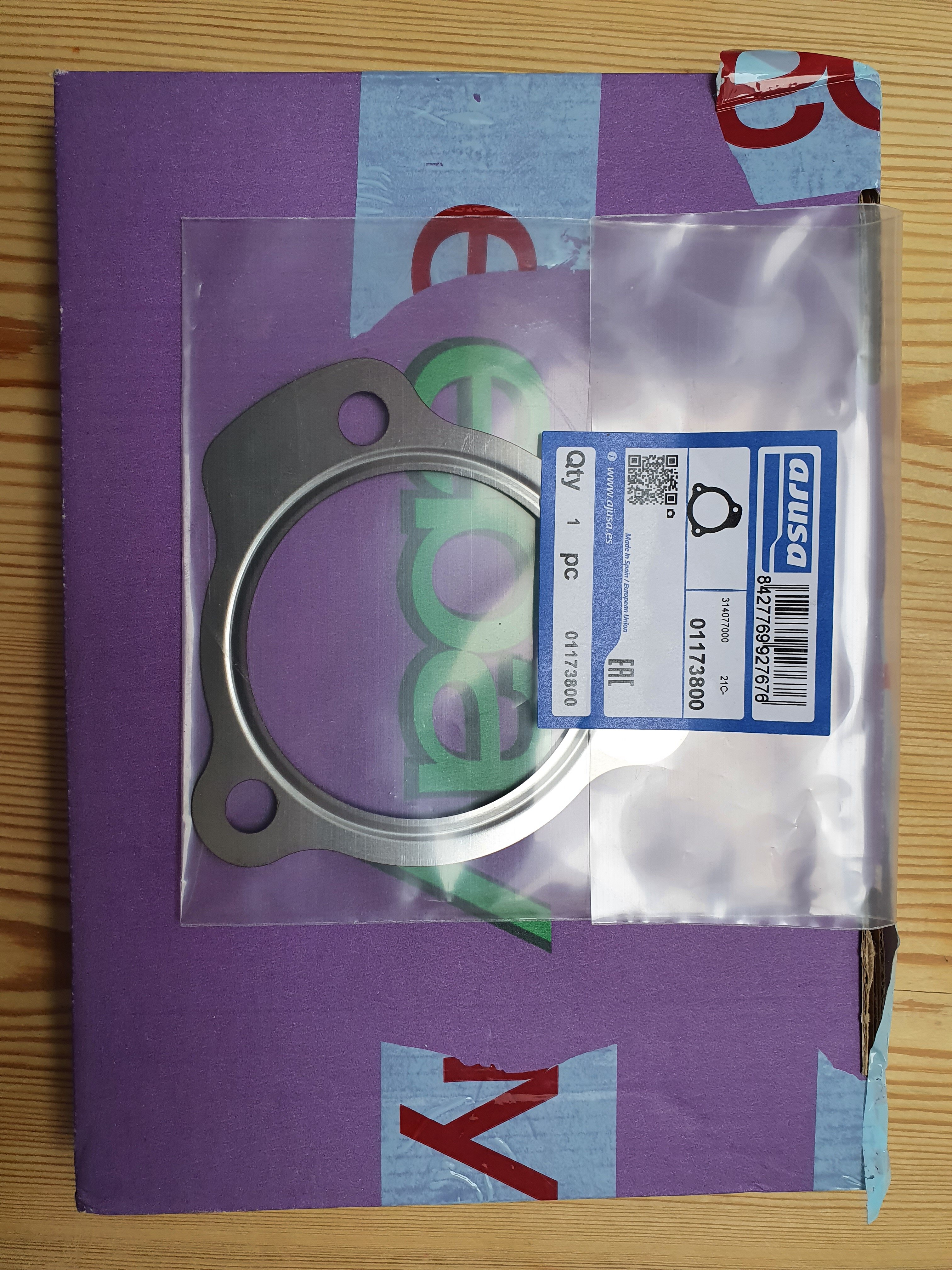

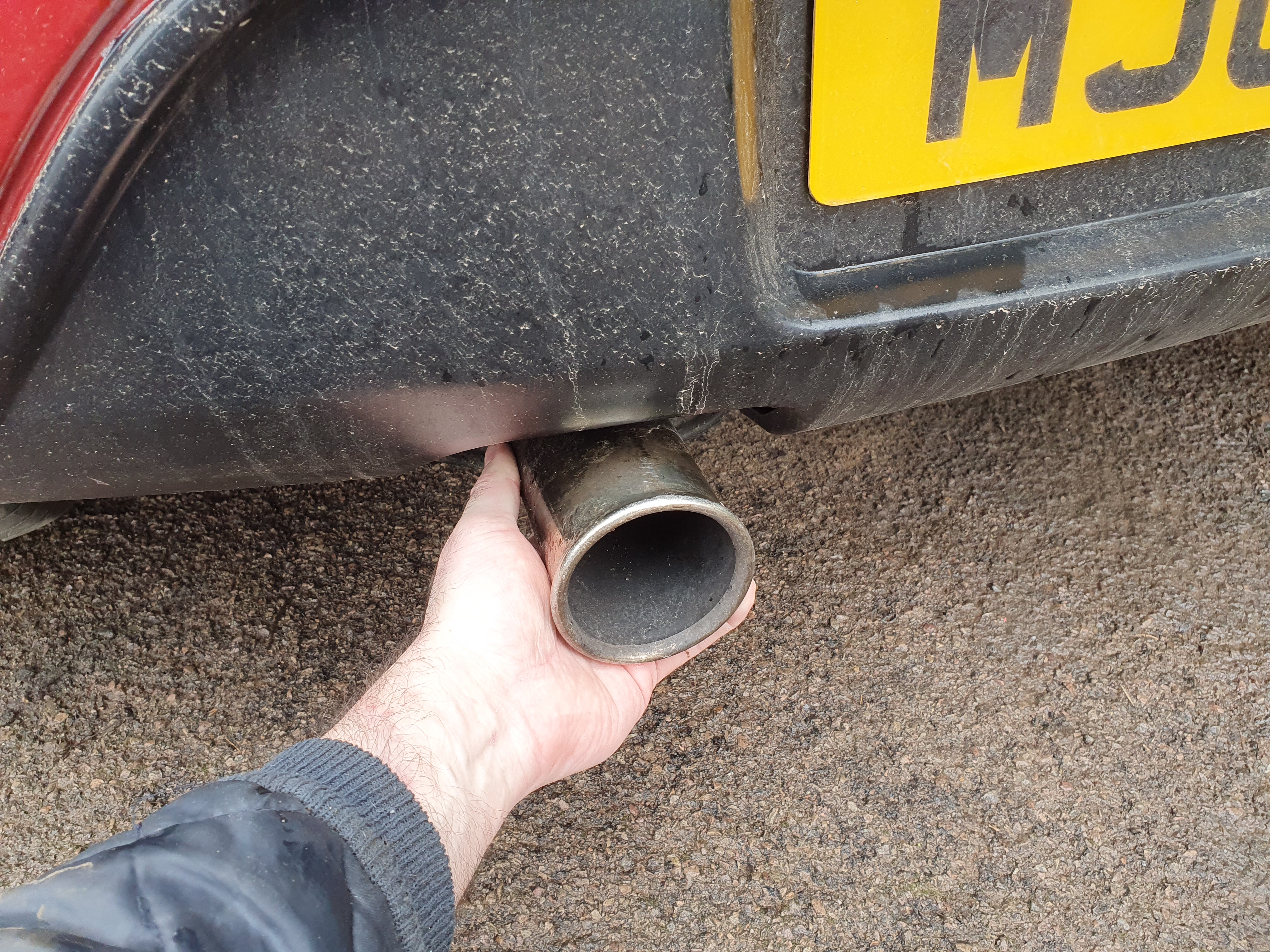

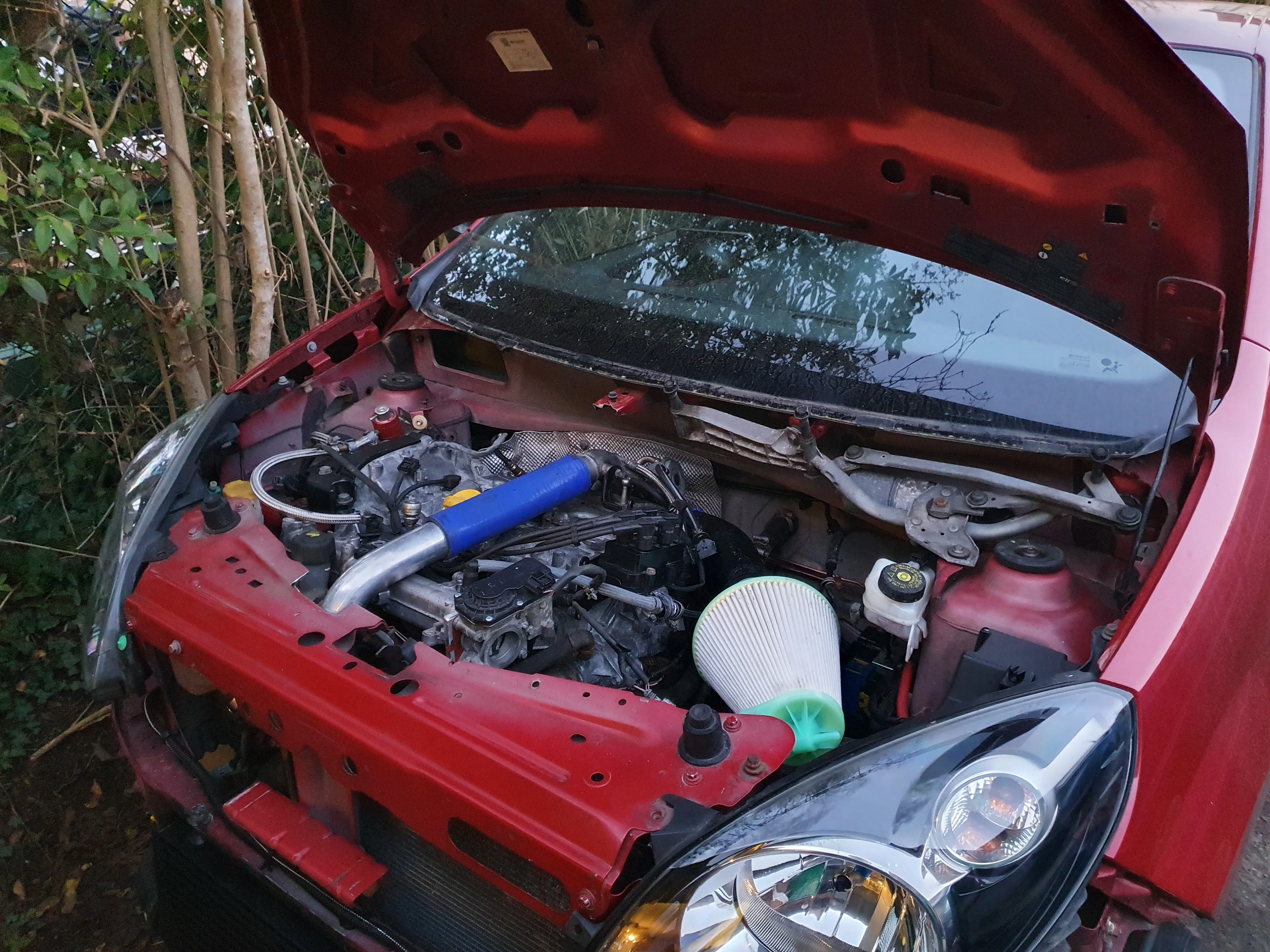

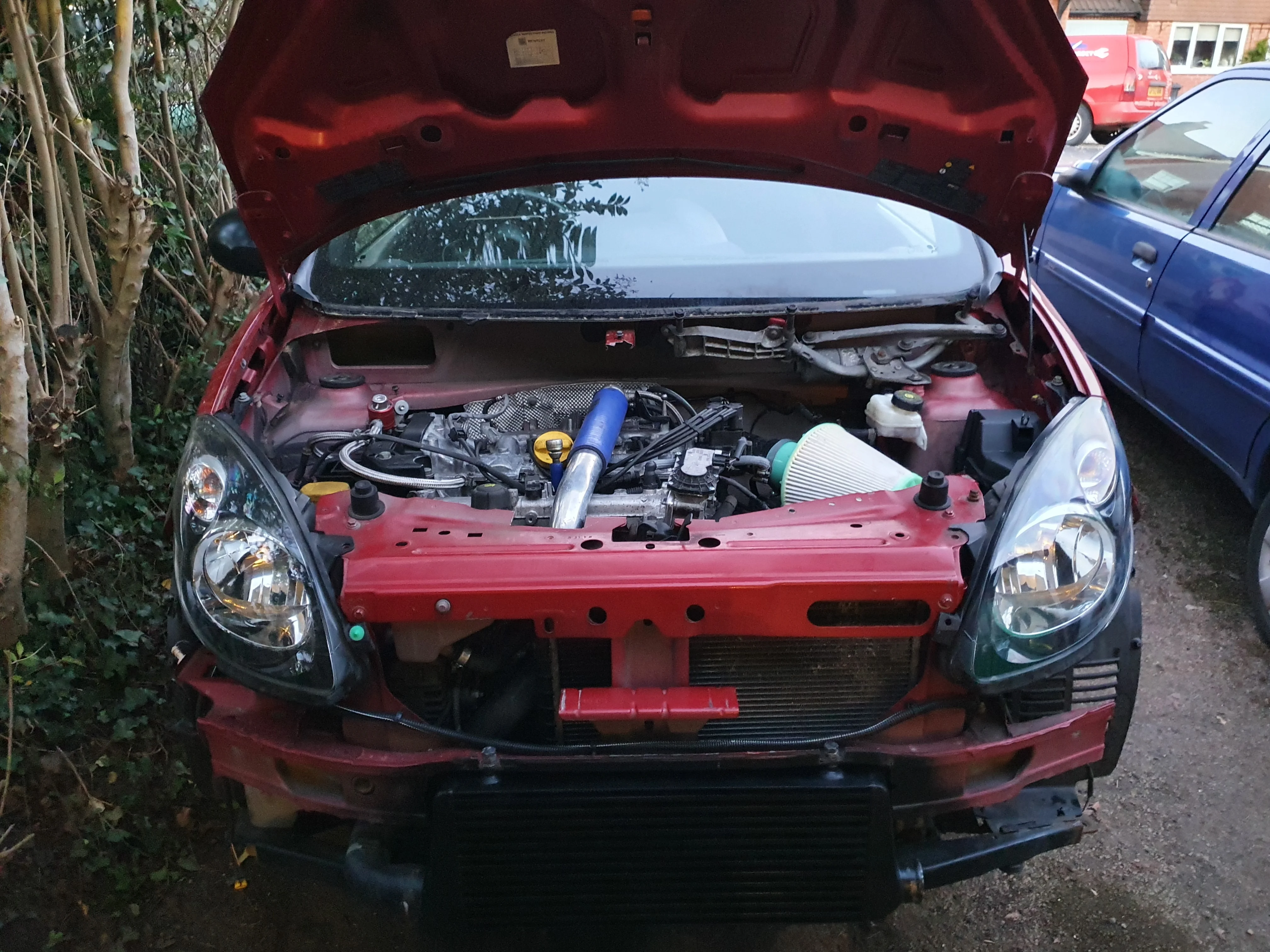

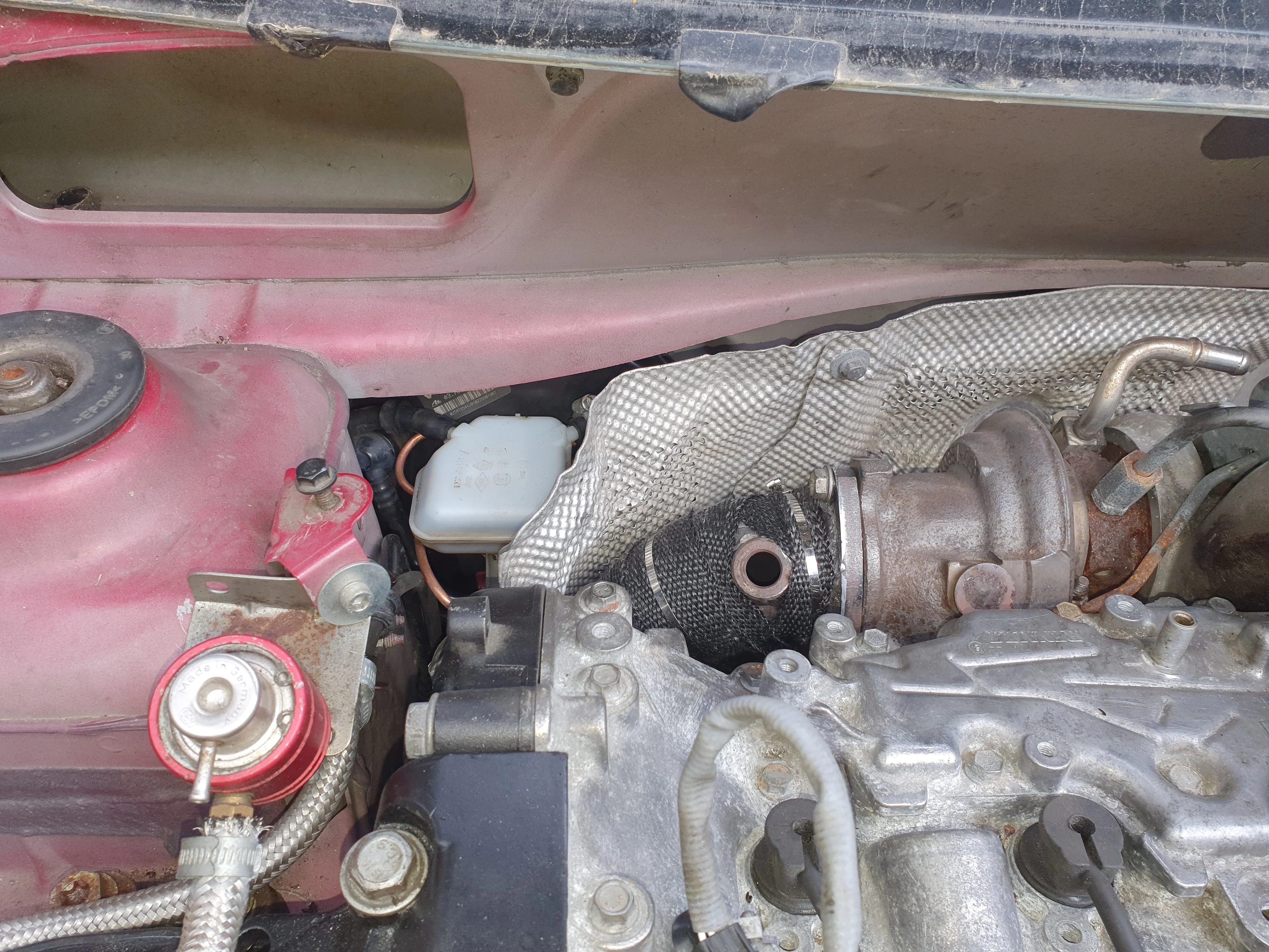

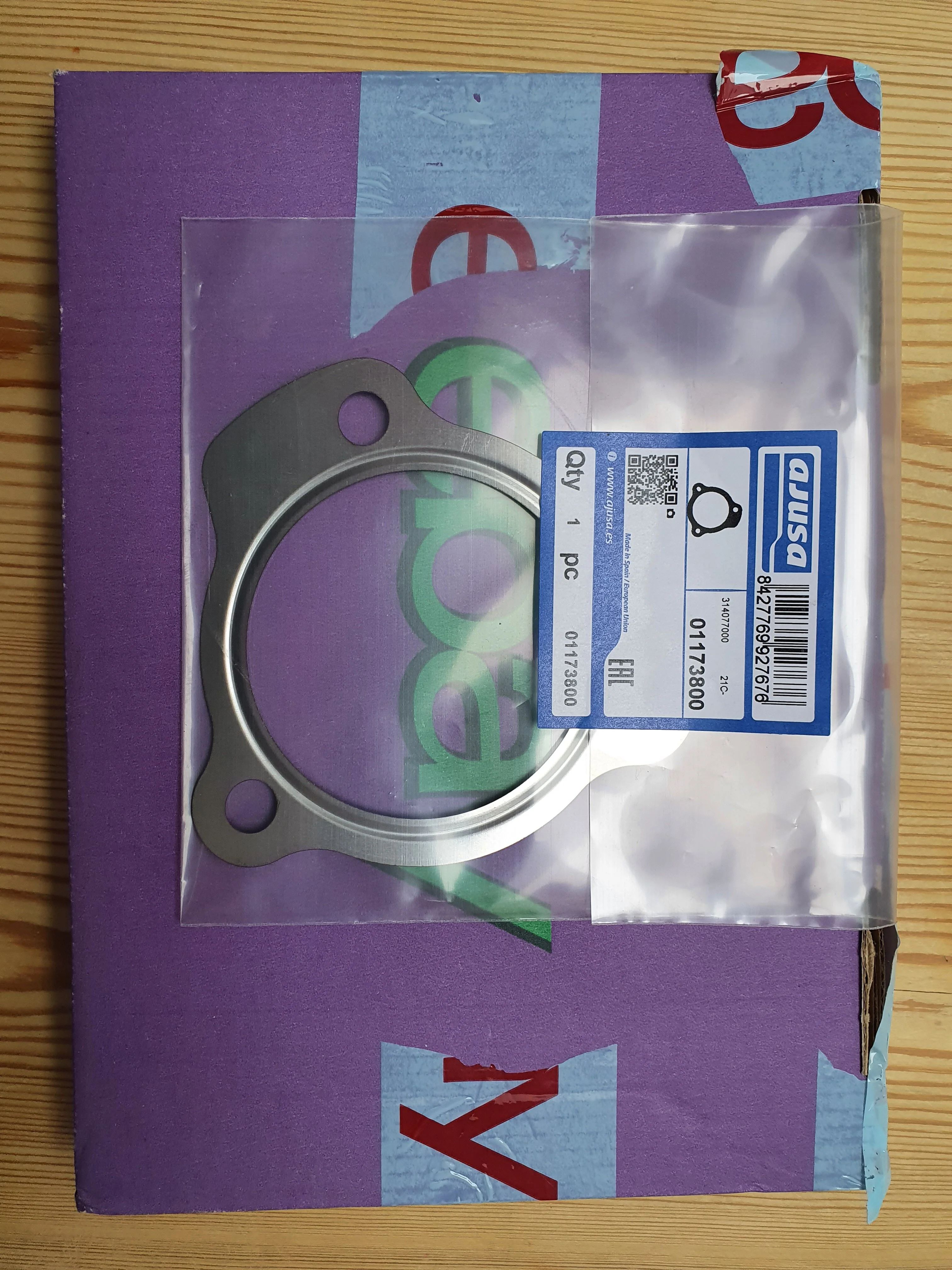

Not much to report as not much has been going on. I re shaped the header tank a little and took a lip off the inlet manifold to create a touch more clearance, looks like it'll be fine but if not there a dacia/meg header tank that might be usable. The turbo to downpipe gasket turned up so that's now fitted. Next week all being well I should have a new radiator, some more boost pipes and some more of the exhaust to work with. @Brigsy is sorting me with a front pipe from his hoard of parts and @jezer101 had an clio exhaust for sale. Its not ideal at 2.25inch I'd but I'll only be using the back box and running 2.75 up to but it fits nice and the tip reminds me of the old GTT exhausts from back in the day. That said I don't really think it will cause a restriction in this setup.
