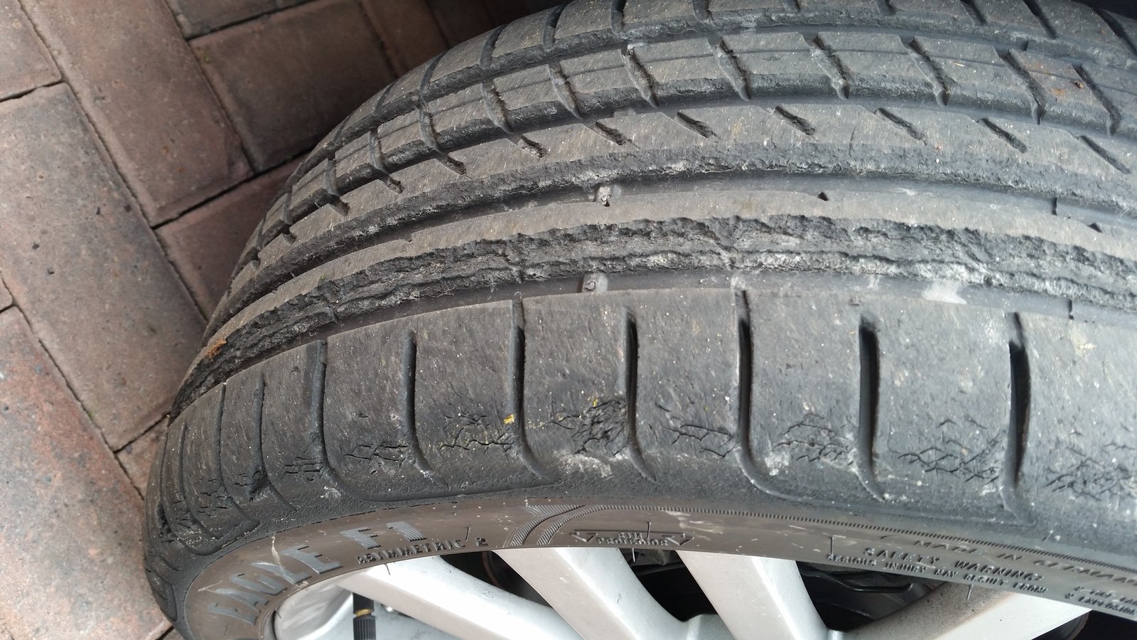

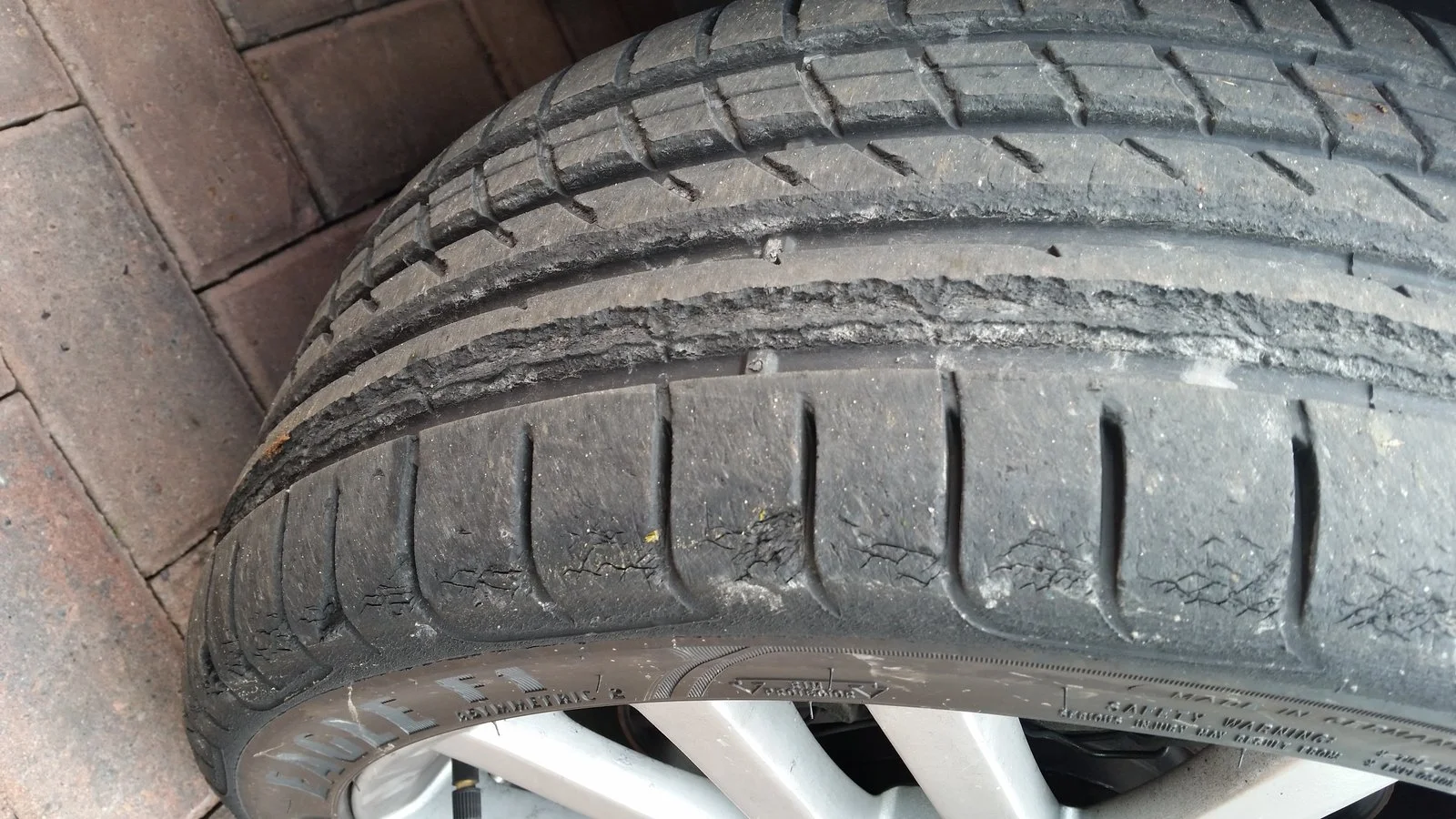

I wouldn't use F1's for a track day, this is my nearside front after 10 laps of 3 sisters (clockwise track), albeit on a heavy AWD car. F1's are very soft for track use on any car if pushing hard, I found this out the hard way.
We're on about OZ F1 wheels mate :wink:
EDIT: Oh you've seen it now.
