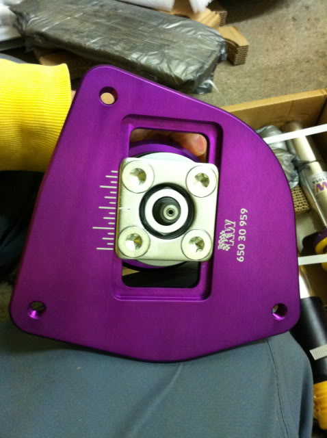

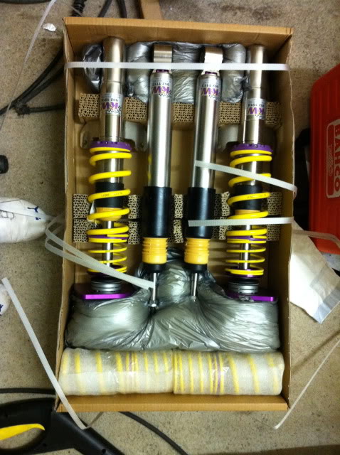

Right, some more goodies arrived for the 200 today:
KW Clubsports with these shexee top mounts:
Getting fitted tomorrow along with the big brake kit, pads, fluid and service. Will be like a new car.
Gearbox has also been changed.

Yeah, the newer 200s (Post August 2010 I think) have a different/revised suspension setup. A member with the newer 200s bought the Clubsports (Which he was told by KW would fit the newer 200s) but they didnt fit as the top mount is quite different.
I have provisionally sold my H&R coilovers so I'll be getting some money back for them so it doesnt seem as painful a hit to the wallet.

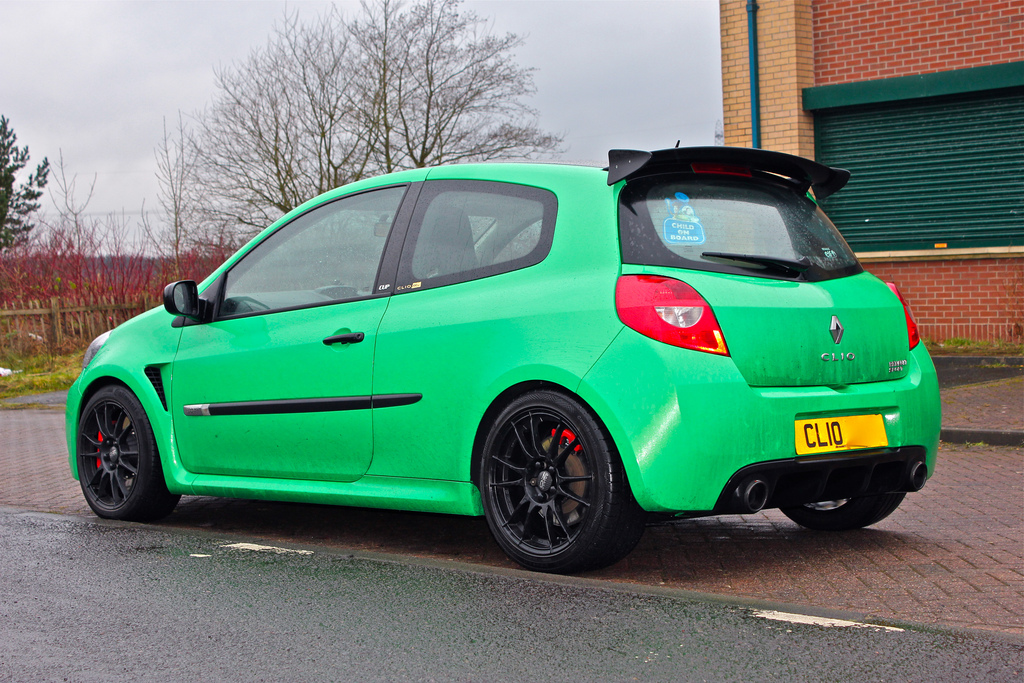

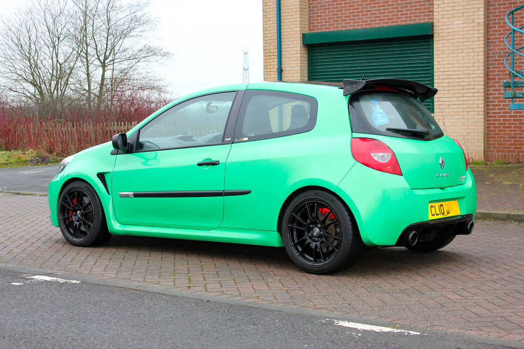

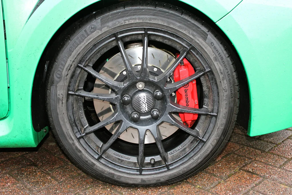

Just picked the little beast up. Very happy with how she is.
First things the brakes. Fudging awesome (Though the brakes that were on were just about finished so really any new brake setup would have been better). Getting used to just touching the peddle as opposed to pressing it a good bit further a la emergency stop when leaving the garage lol.
The picture is quite deceiving. There is a bigger gap between the caliper than it looks, but got the guys to re balance the wheel with the wheel weights further inside the wheel.
Clubsport wise theres good and bad points so far. Good being that the turn in is just immediate, changes directing like a wasp (Couldn't test them properly as its fudging snowing now). Ride quality? Terrible on the bumpy roads. I'm gonna put this down to the coilovers being on their softest settings for running in. Its just so bouncy. Been assured that once they are set up properly (I asked the garage to just install 'em and give me a basic setup to do until I get it set up at Kenny Brown's place in 2 weeks) the bounciness will go away.
Essentially the same ride height as the H&Rs to keep Emma happy lol.
Overall very happy at how she's coming along.

N/S/F looks slightly higher than the rest of the corners. Shouldn't the O/S/F be the highest due to driver weight.
However, it looks awesome no matter how much I hate the cup spoiler.

Got any pics of the top mounts fitted too, they look so pretty :')
Will see what I can do.
The car isnt sitting level, its on that slightly raised kerb you can see. On flat ground it is level but its getting properly set up in 2 weeks time once the new coilies are run in.
