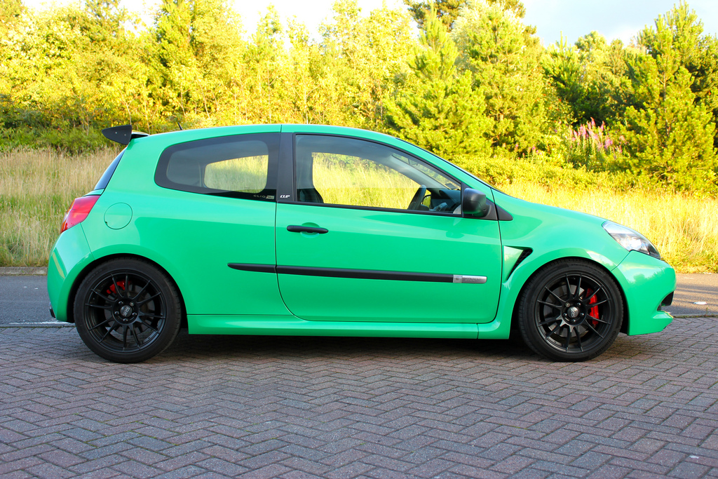

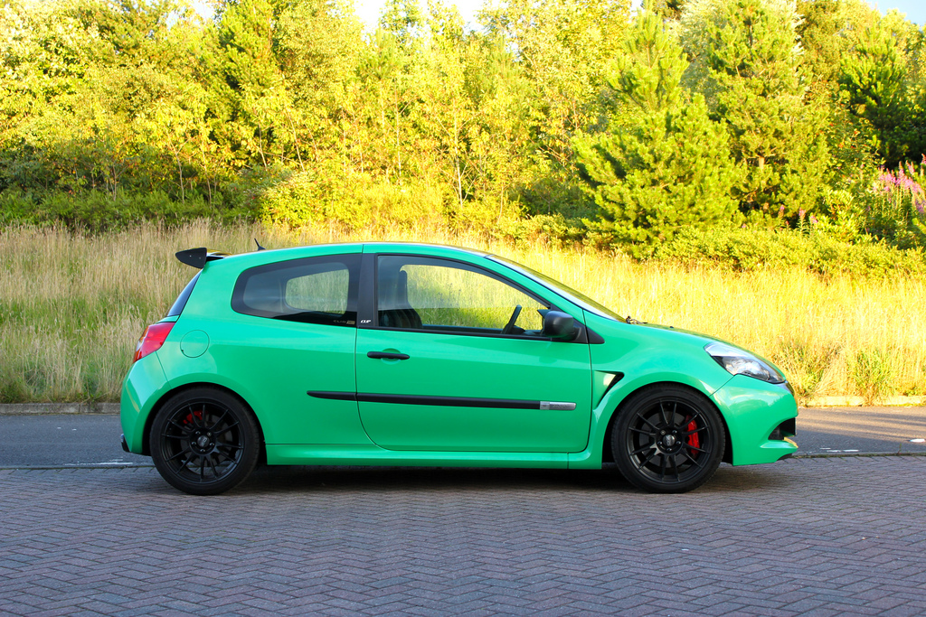

I prefer the black wheels with red sticker.
Did you notice much of a difference with the new exhaust over standard?

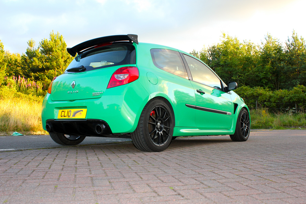

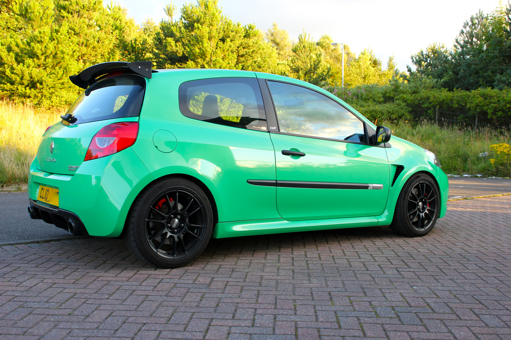

Definitely feels a lot faster. Rolling road says only 4bhp though difference.
Think I'll keep it as is for the time being and once she becomes primarily a trackday car I will start the trasformation from subtle daily driver to garish trackday car.

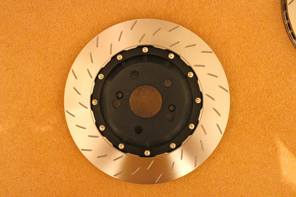

I then get home from work. The nice man at TNT had dropped of a box of goodies for the green one:
They are the 330mm 2-piece discs from K-Tech. Yet to decide on which pads to go for. DS2500s are the safe option. CL RC6s are the other options but they do tend to be harsh on the discs and squeal when cold.

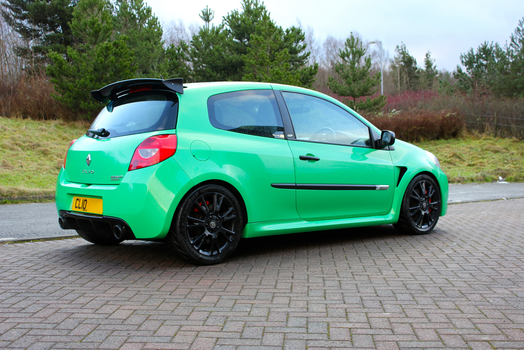

A quick pic of how she looks at present as the Ultraleggeras are off for a good clean:
Gally
Sits so well on the speedlines. Proper cup racer esq.

Lol. Think I've went off the red and stickers idea. Hopefully have the gearbox replaced early next week and she'll be back to her former glory.
