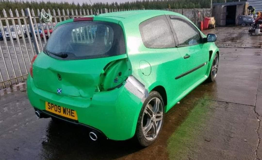

Car was a CAT S but repairable in Sept 2019. Written off with a damaged boot lid, light & bumper. Very, very small crease next to the petrol cap which is why it was probs a CAT S. No other structural damage at all. Everything underneath and inside are perfect. 71K miles and a low 2 owner car.

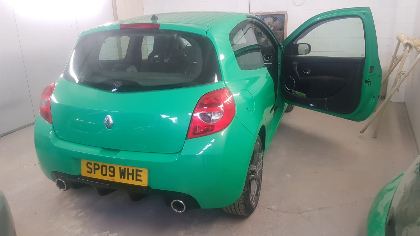

Pic of the damage which is very superficial.
Car went to a local body shop for the repair.

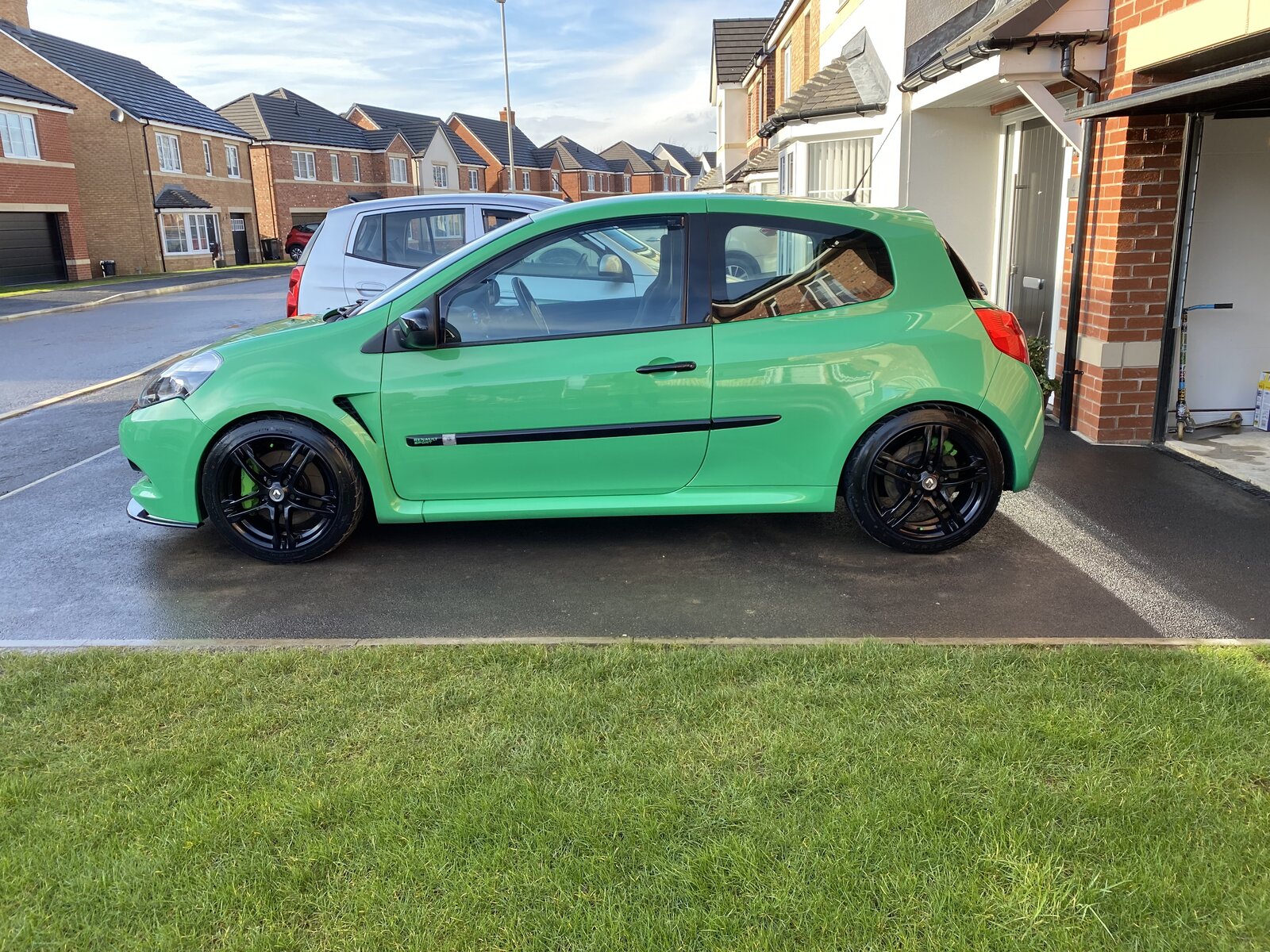

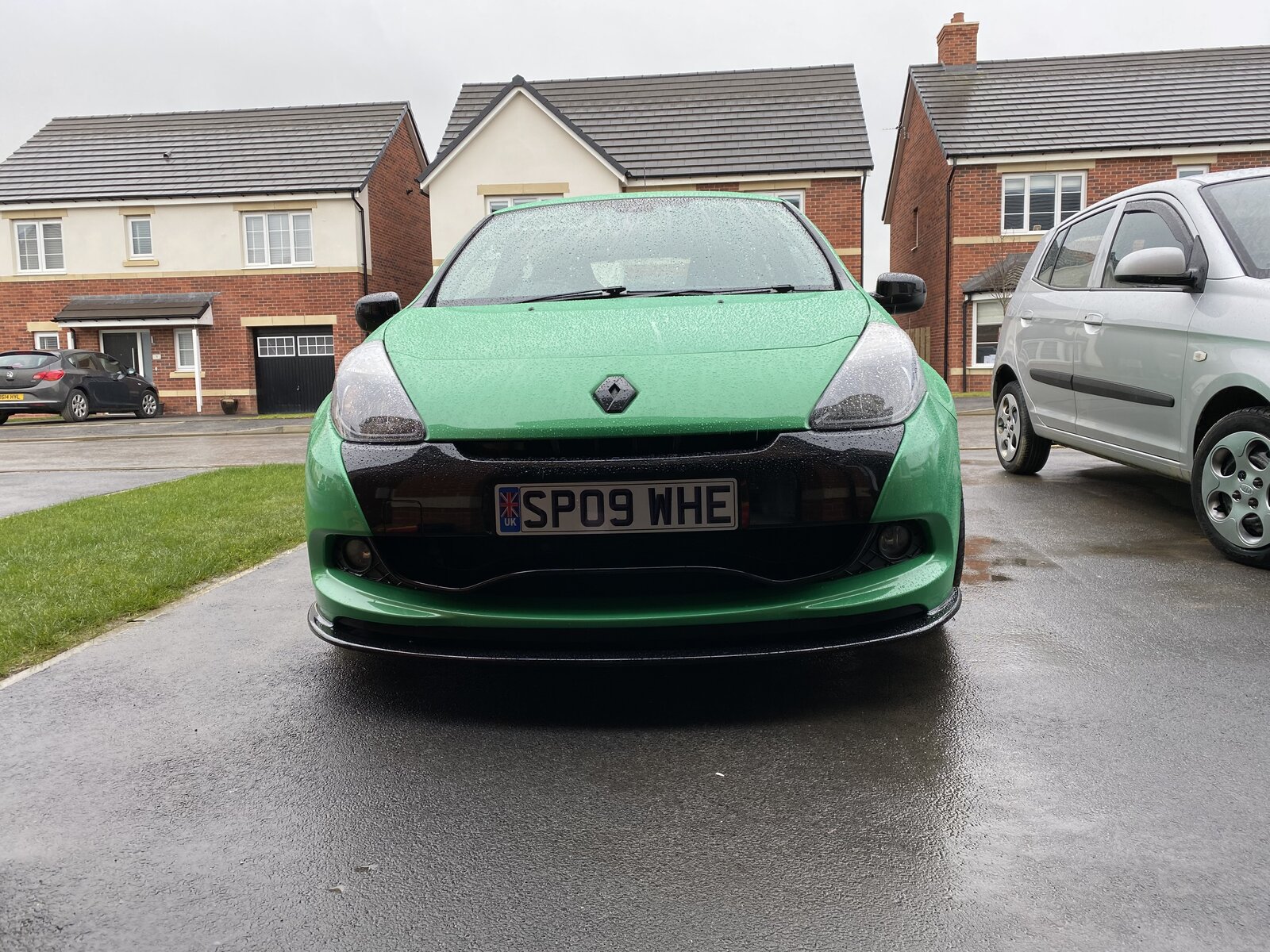

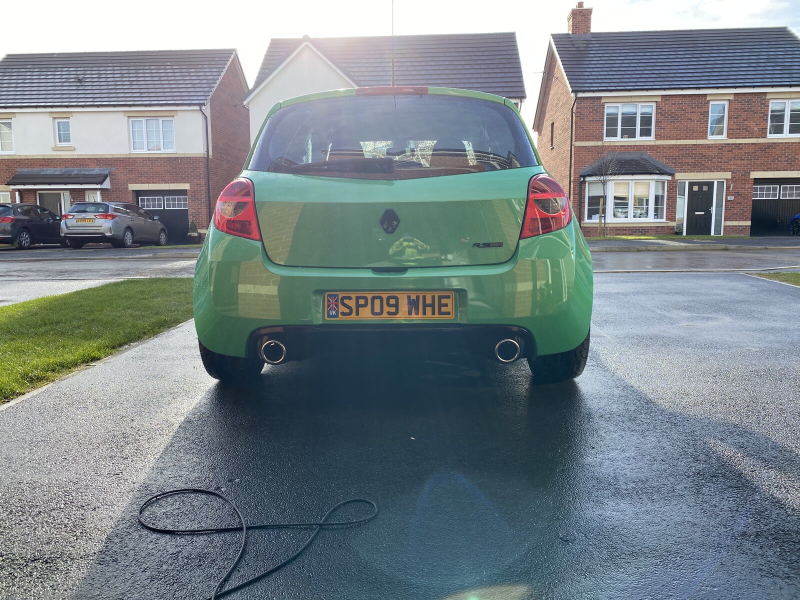

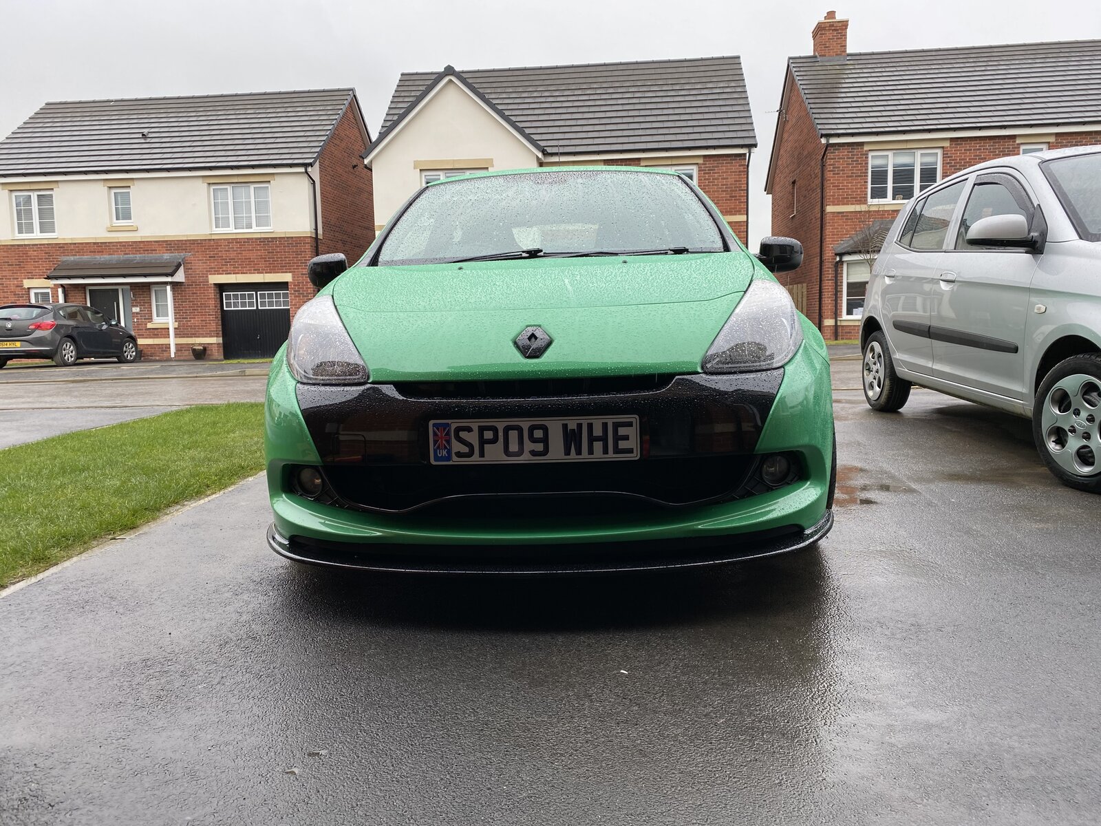

Pic of the car as it stands now. Had quite a bit of work done by me prior to picking up on Tuesday 18th Feb. 2020.

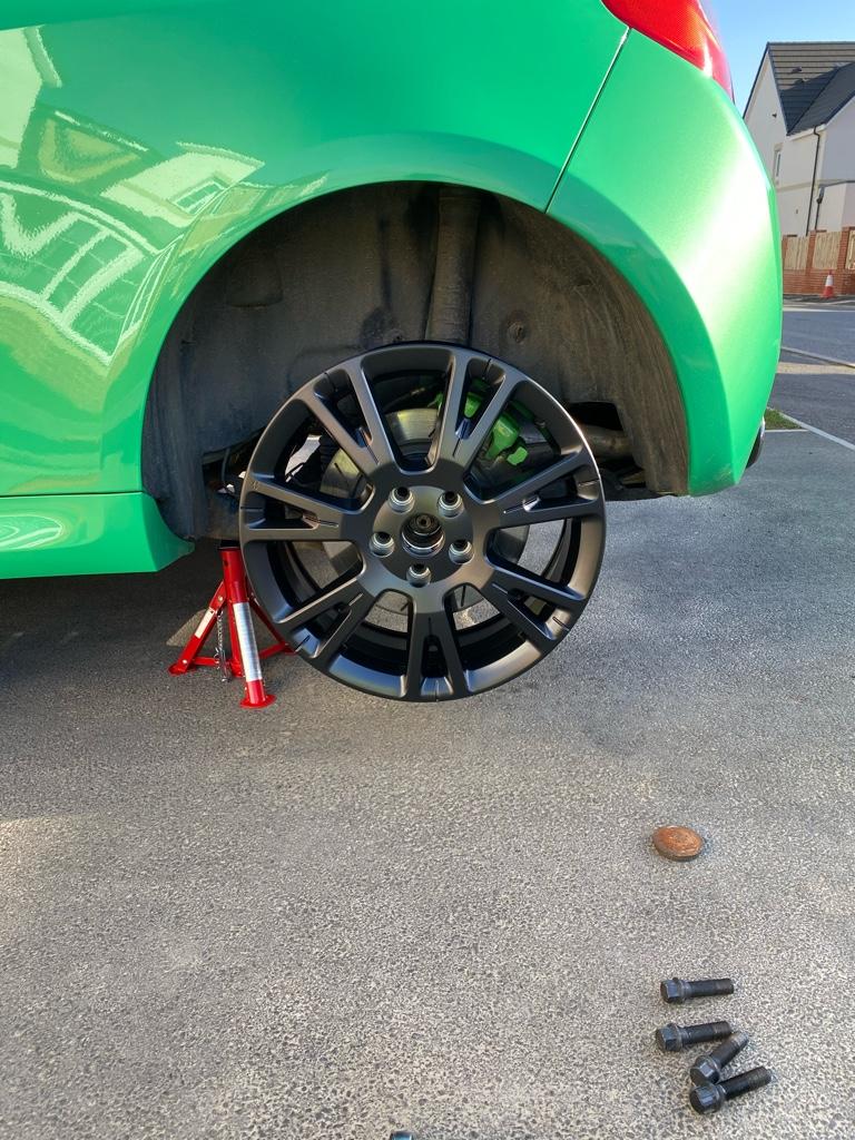

Wheels refurbished in gloss black.
H&R springs fitted.

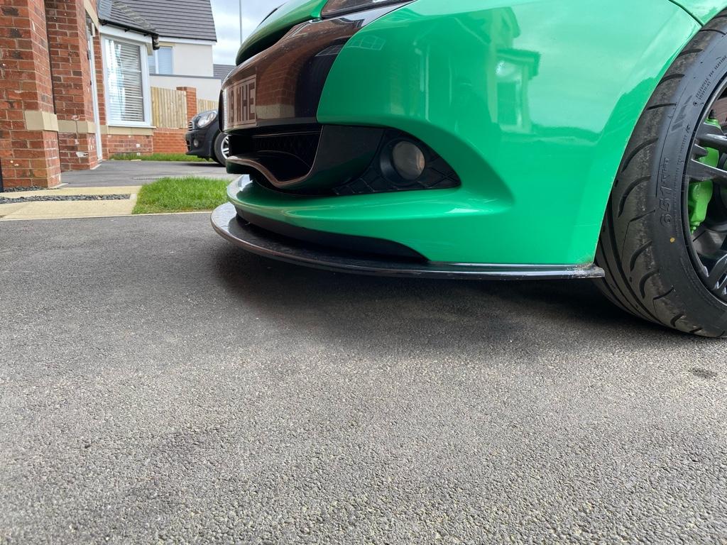

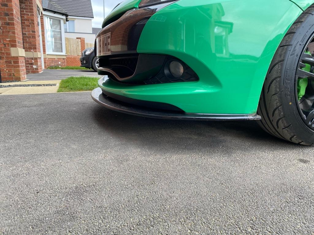

TRC splitter fitted.
Full service inc all belts etc.
Gear box rebuild.
Let the modifying begin.

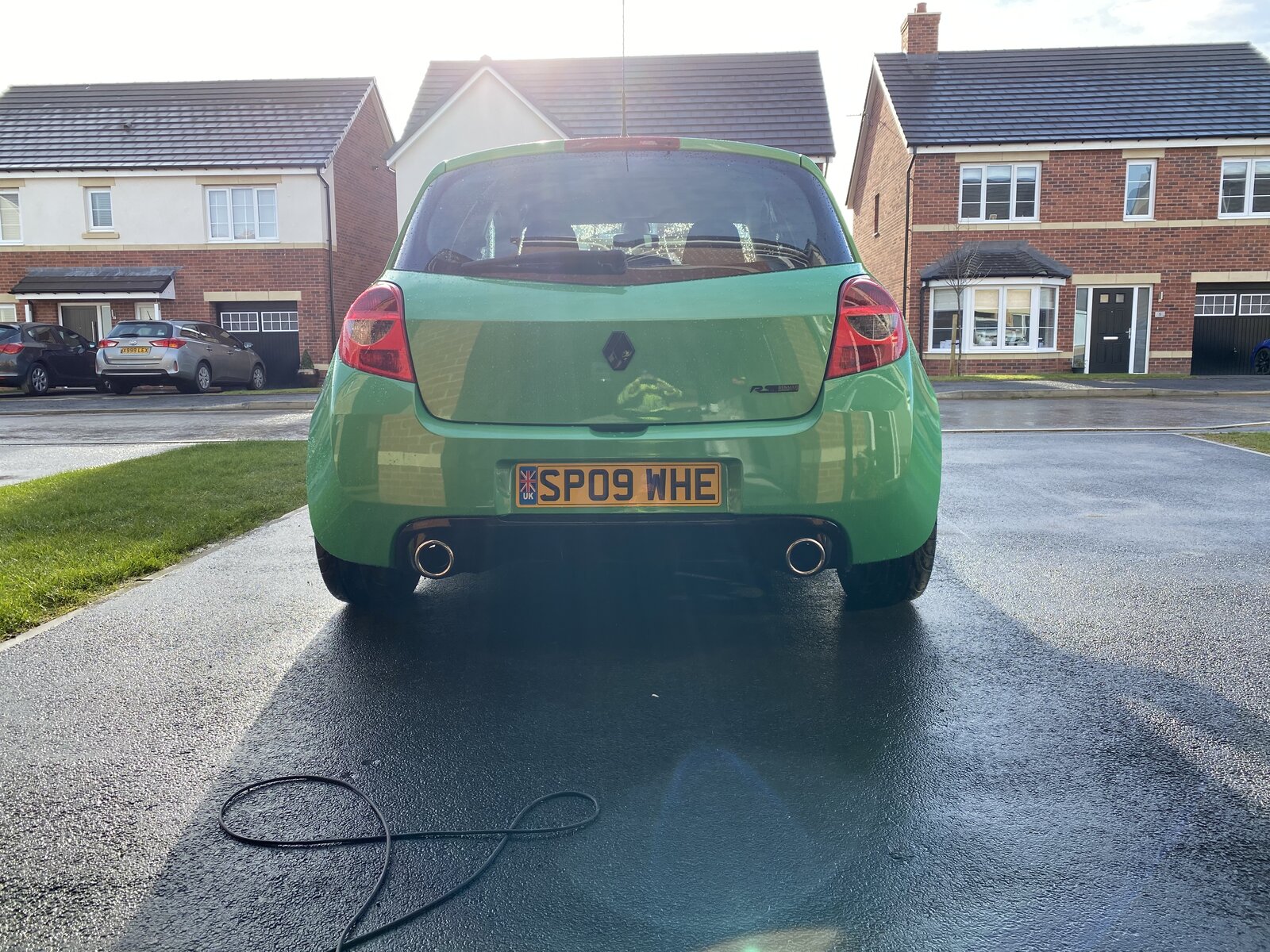

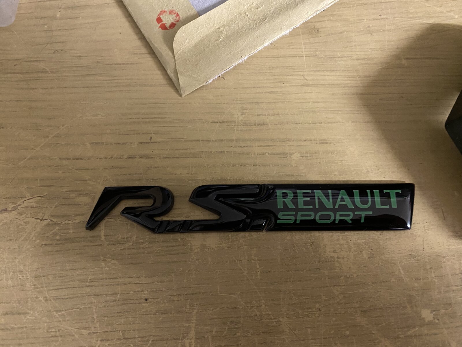

New custom RS badge on the boot now.

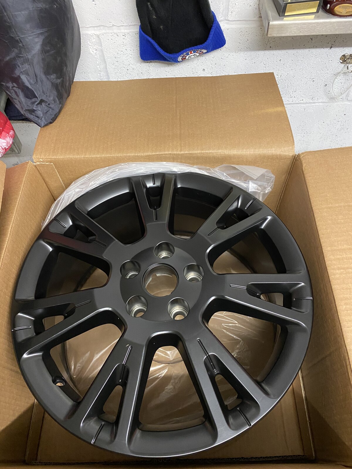

Cup Racer wheel in readiness for the Summer months.

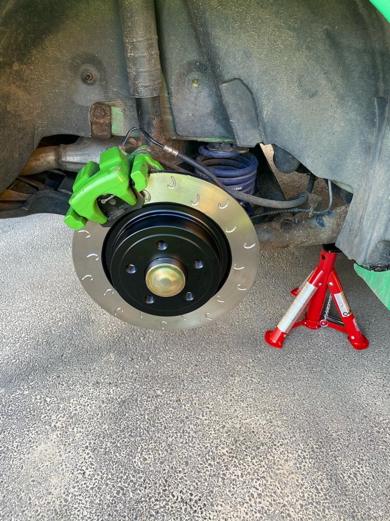

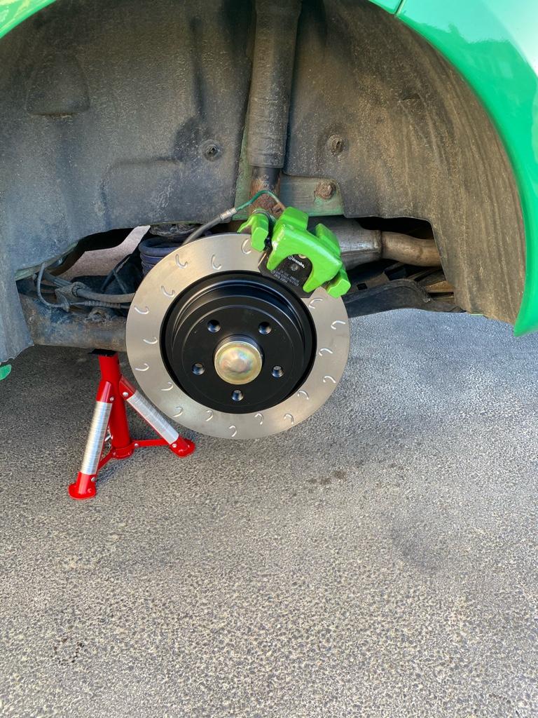

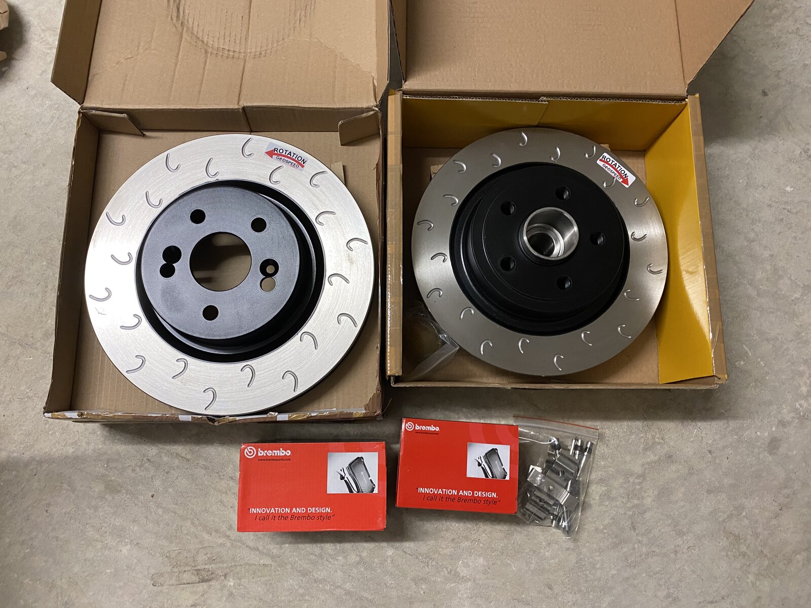

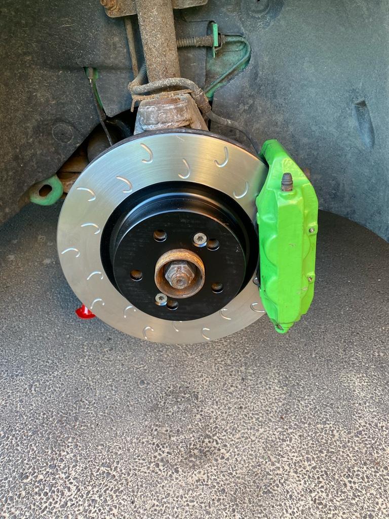

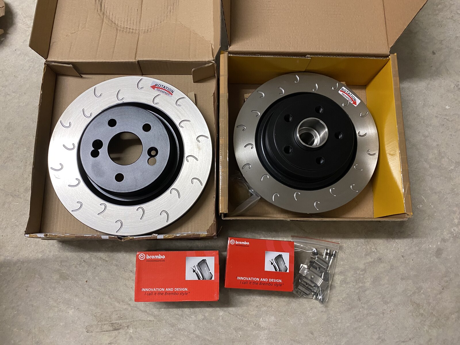

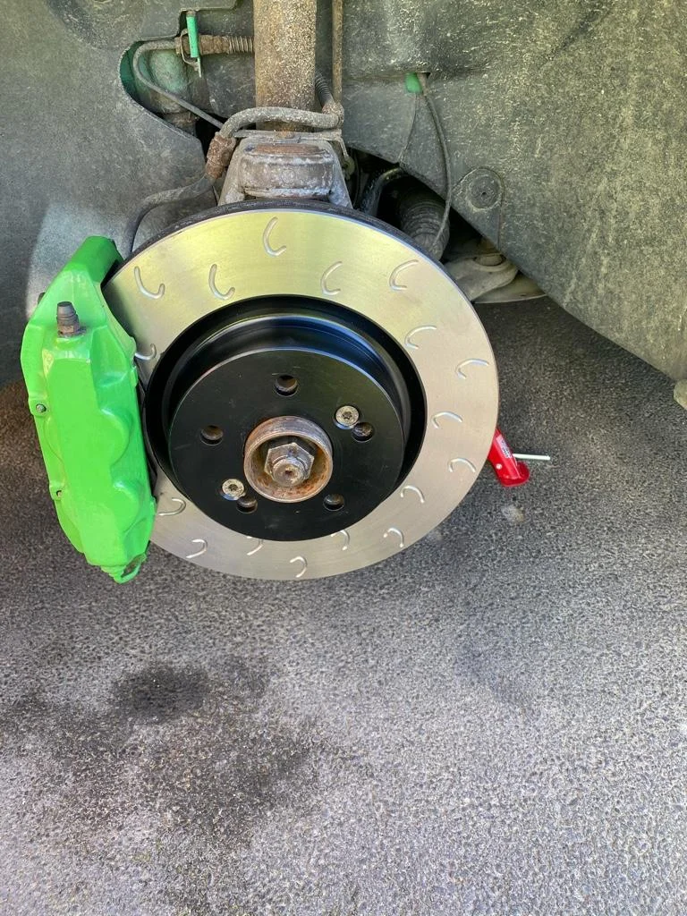

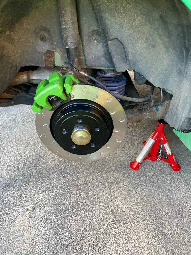

Full set of new Godspeed G Hook discs & Brembo pads ready to go on this weekend.

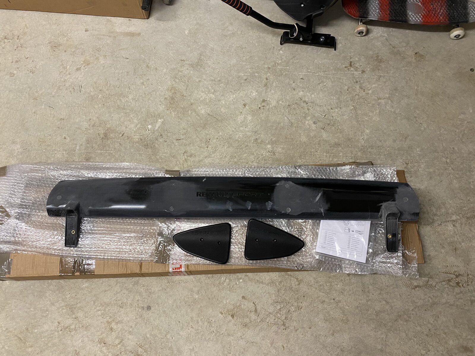

Genuine Cup spoiler. Getting painted in readiness to fit this weekend.

Hi Phil, where did you get the Cup spoiler from? RPD have had them on back order for ages! Car looks great btw.
  RS200
I manage to bag one from someone on a FB page. He was a bit reluctant to sell at first but we came to a good deal.
Yeah they are very rare at the minute any nowhere has any stock of the genuine parts. I contacted at least a dozen companies and everyone said they were on back order or no planned date.
KTR have some of their own brand spoilers in stock.

One of the best looking colours ever and suits the shape so well. Looks great. How is the paint match? Was always told it’s a nightmare to paint alien green
  RS200
Cheers.
Paint match is spot on to be fair. Takes some spotting if you don't know it's been done.

How did the accident actually happen? The lower part of the bumper in the original pic is barely damaged.
  RS200
Not to sure to be honest. Would appear to be from something that rides high based on the damage.
Nothing other than what you see was damaged. It's perfect underneath and in the boot well.

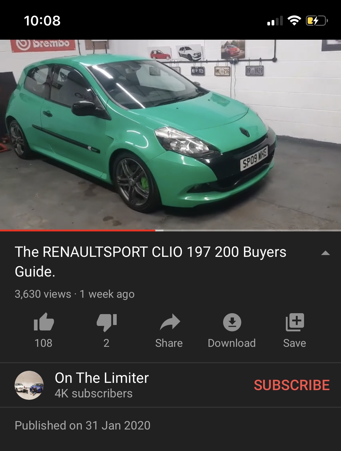

Seen on youtube on a channel - Jan 2020

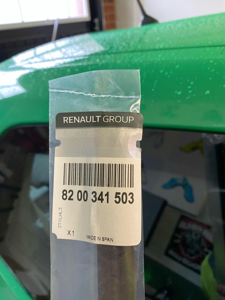

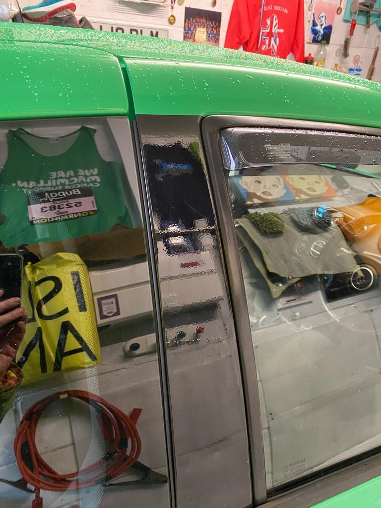

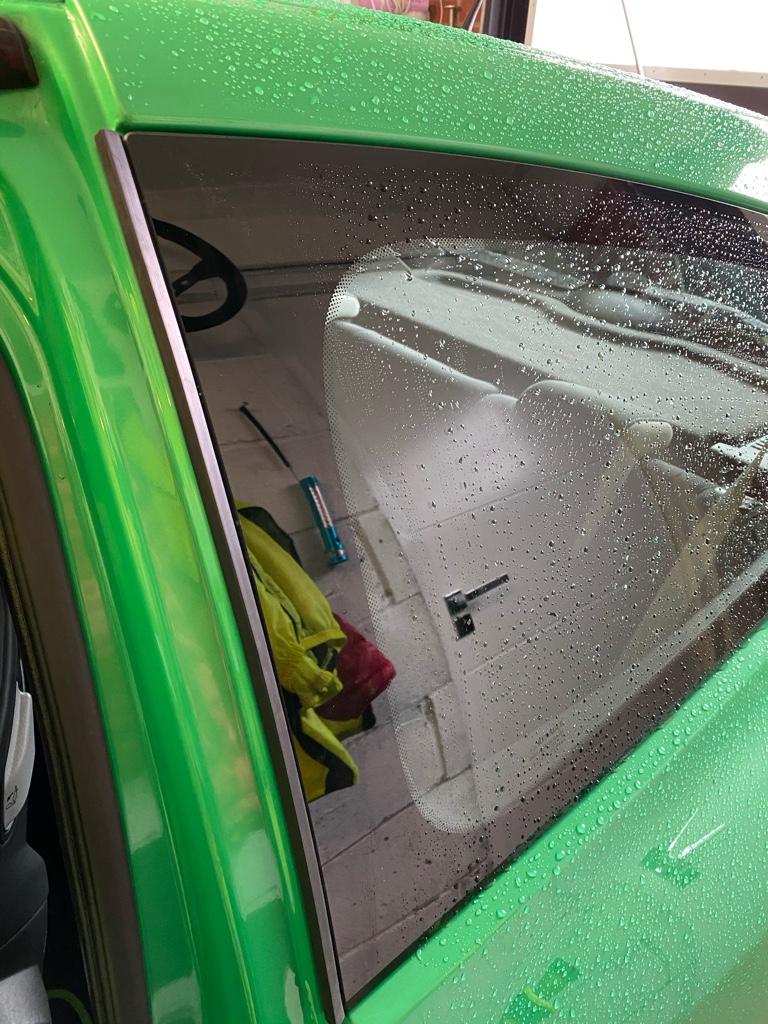

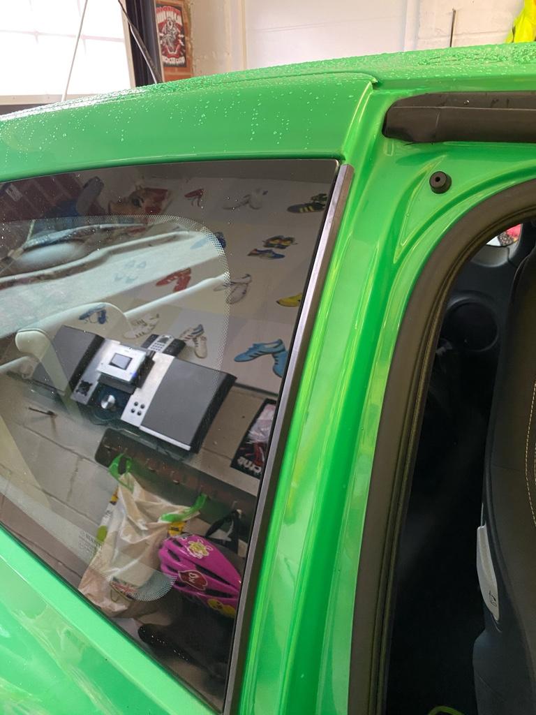

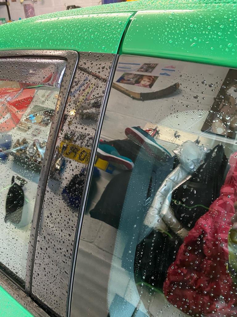

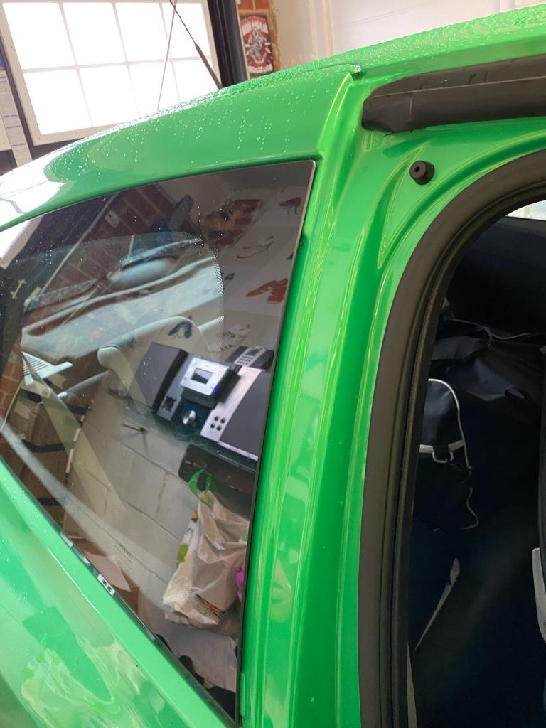

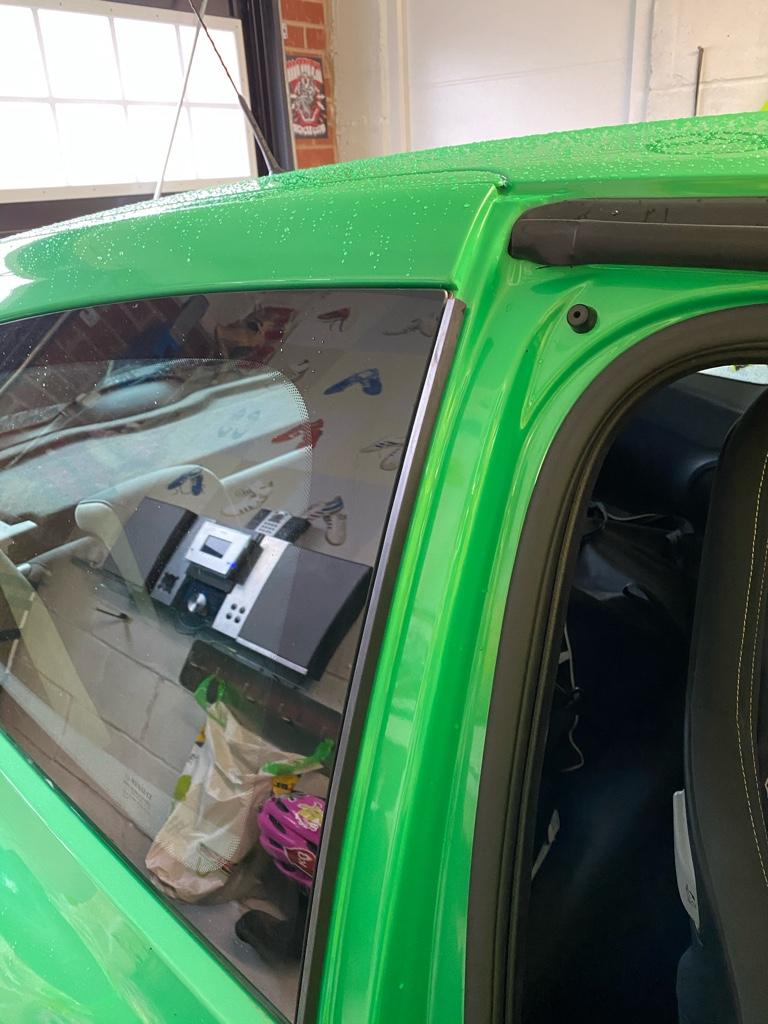

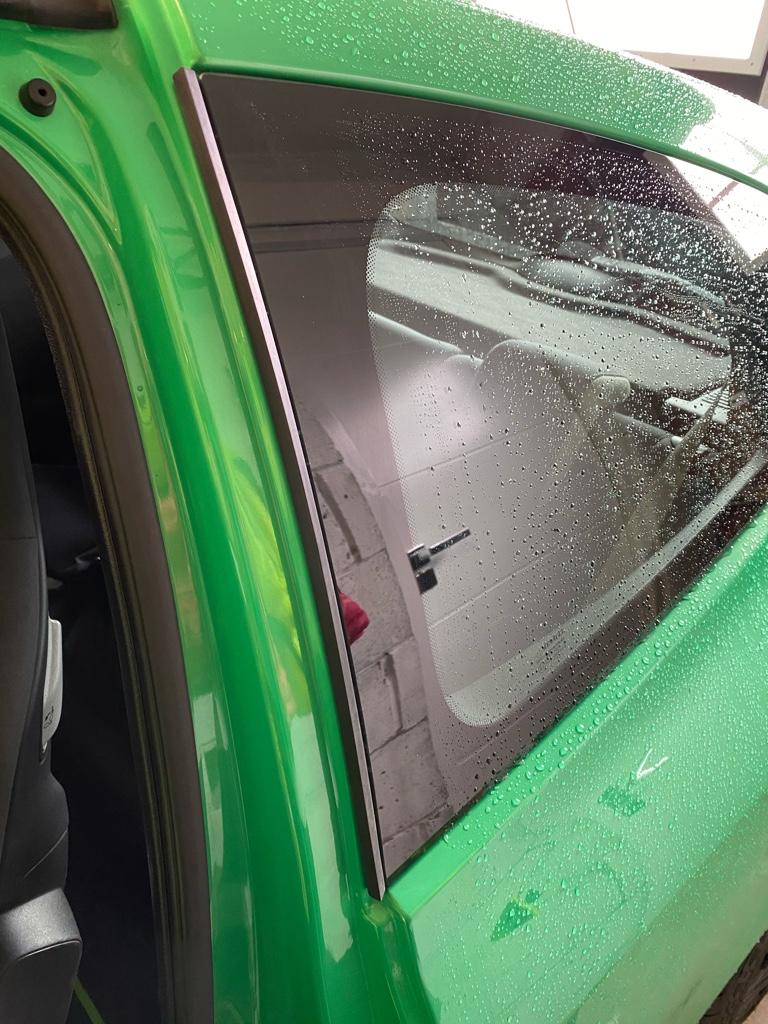

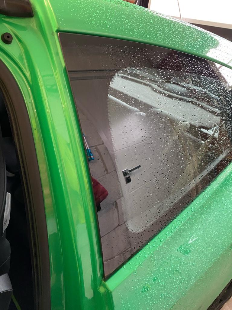

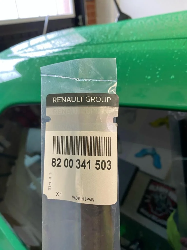

Made the most of a rainy Saturday and changed the door weather strips and change the air filter.
Current ones where in bad shape.
Seals removed and all glue removed etc from both sides.

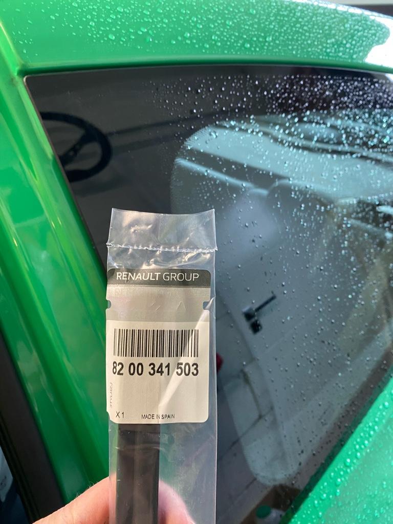

OEM parts used.
Trial fit on both sides.
Both parts fitted and pressed into place.
Doors closed to ensure a good fit along with water test.

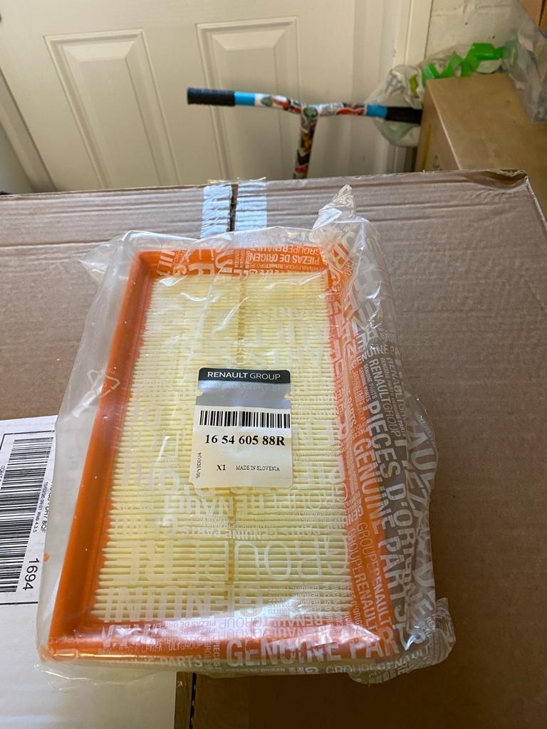

OEM air filter changed. Took all of 2 minutes.
  RS200
Took me about 45 mins to do both. They are behind the window but slot in.
Step 1 - remove the old strips by pulling out slowly from the bottom to top.
Step 2 - clean off all excess glue using glue/tar remover. I use Solvo 7063 as I had some in my garage. Use a sharp blade if required to get the glue off the window edge.
Step 3 - trial fit by pushing the seals in place behind the window. Do not remove the sticker backing. Once happy with the fit move to Step 4.
Step 4 - remove sticker backing and push fit seal behind the window. Push the seal in tight to get a good fit.
Step 5 - press down on the glass edge into the seal. Also use a thin scraper to press the seal onto the metal by placing into the slot between the window and seal.
Step 6 - ensure seals are stuck in place by pull testing.
Step 7 - close the door and check the fit is OK.
Step 8 - water test for leaks.
Hope the above helps.
  Clio 197
It looks like they changed the design of them? They use to be semi-circled on the edge but look to be more square shaped now.
  RS200
Yes they are different to what was on before. Seem to get a better seal too.

@Phil555 please can you advise if the rear brake discs have the ABS rings along with wheel bearings.
Can you also confirm what the wheel bearings inside are as OE renault spec ones are SNR and im wondering what comes in these.
  RS200
How do.
Yes they come with ABS ring and bearings but I am unsure what bearing is used.
These were bought from Kam Racing so Kevin from there maybe able to advise or ring Godspeed direct as they may also be able to advise.
