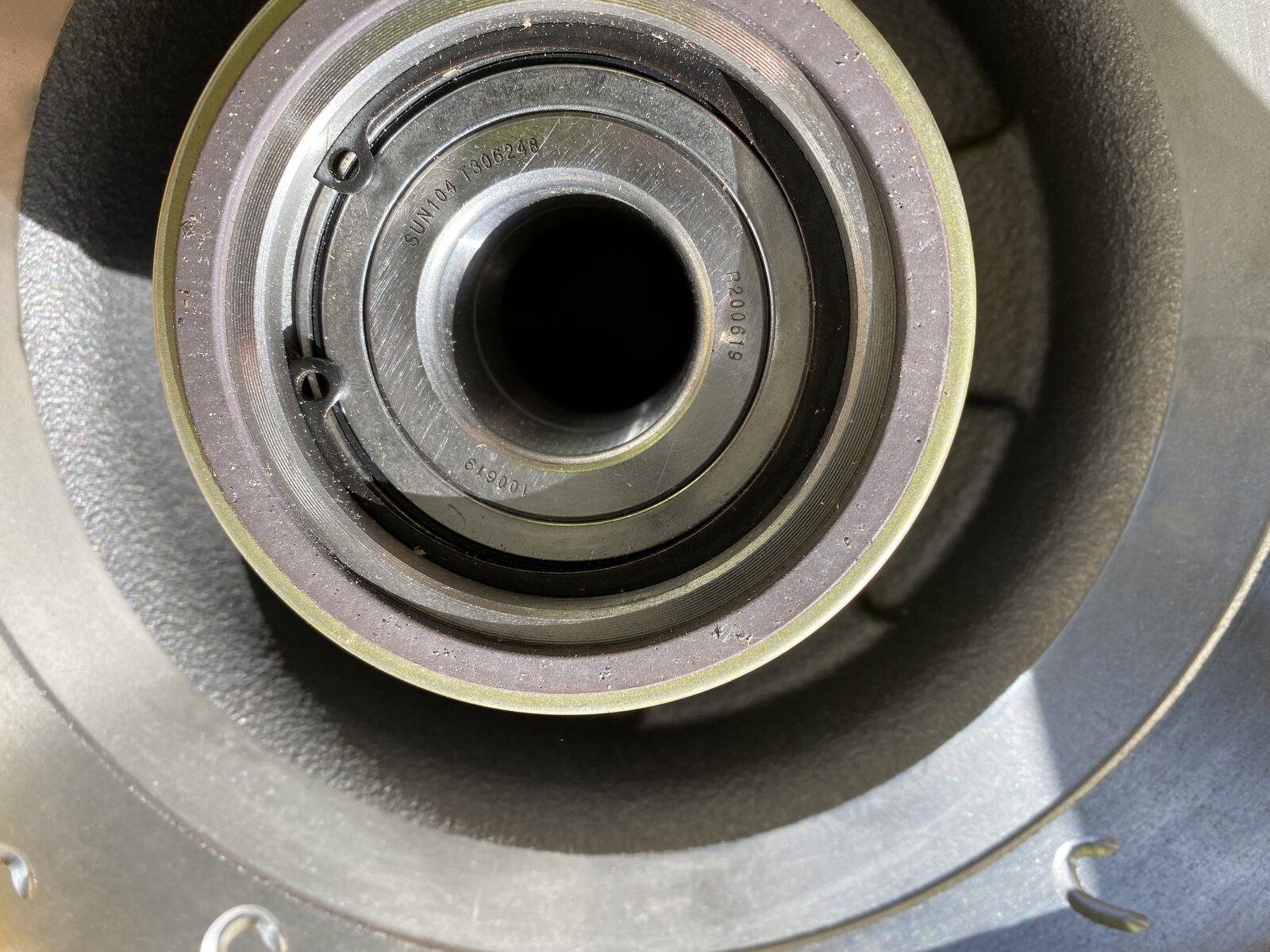

@Phil555 please can you advise if the rear brake discs have the ABS rings along with wheel bearings.
Can you also confirm what the wheel bearings inside are as OE renault spec ones are SNR and im wondering what comes in these.
See below pic of the bearings mate. Took the pic prior to fitting them.

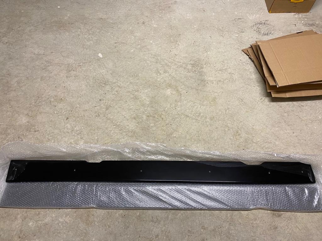

New delivery today.
TRC side skirt extensions. Will be interesting to see how these look when fitted.

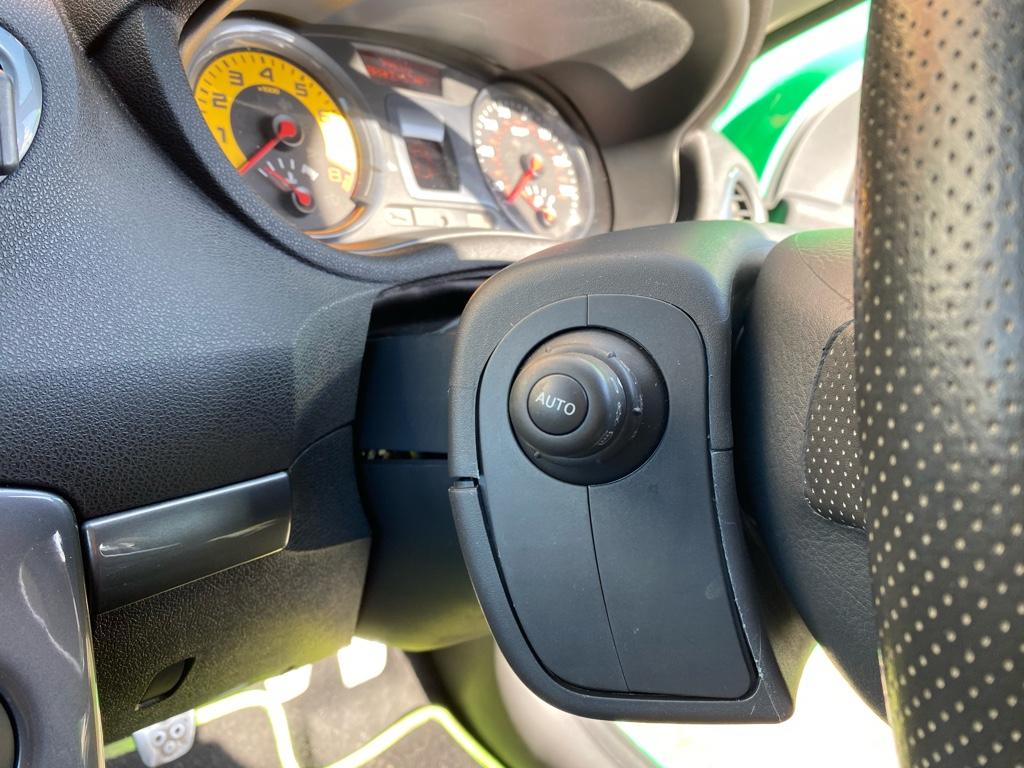

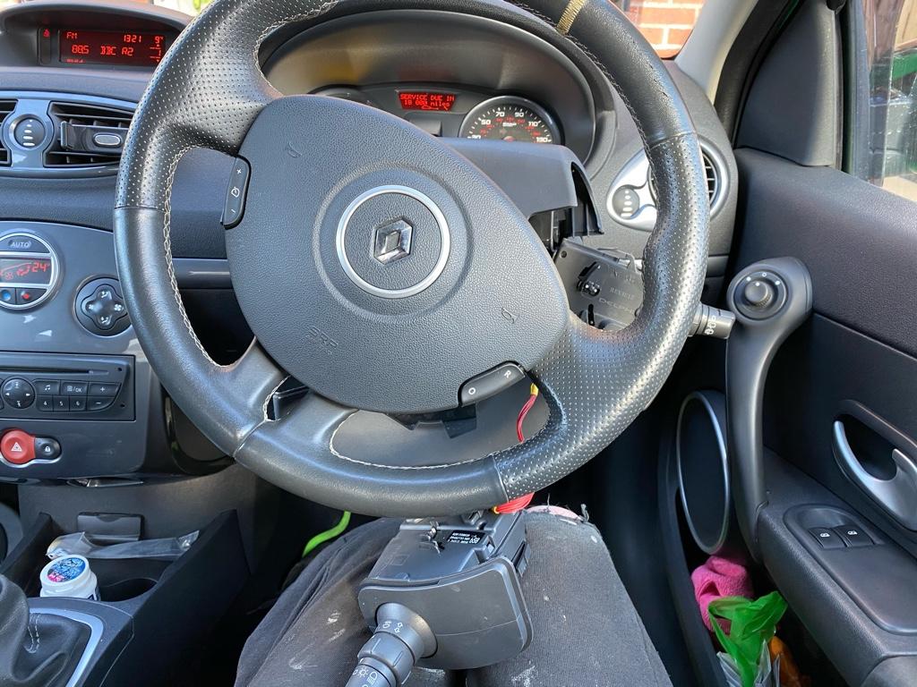

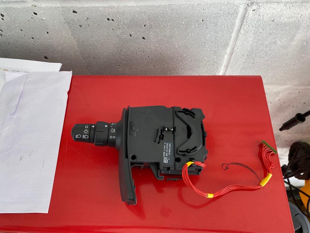

Had an issue whereby the service light would not reset. Bit of research lead me to a dodgy indicator/light stalk wire. The red wires that connect the stalk to the wiper stalk can get worn away over time which stops the trip buttons from working.
Managed to pick up a second hand one for £25.
Quick change over which took about 15 mins. Two screws out and cowling removed. Both stalks out.
New one in place and all working as it should.

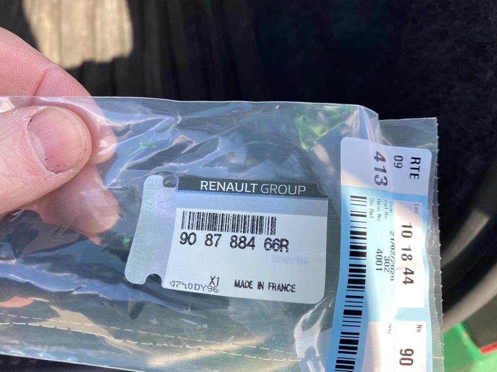

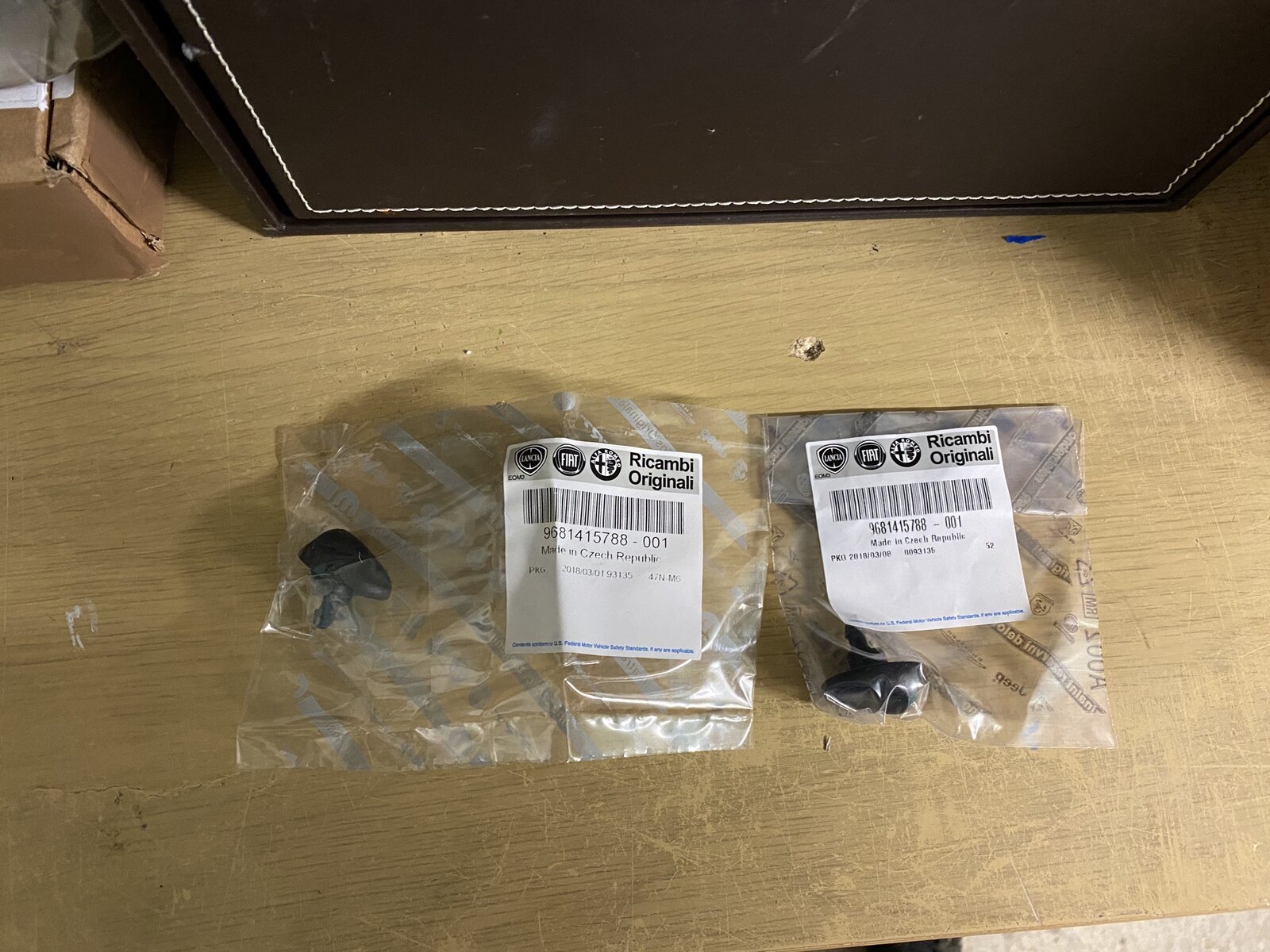

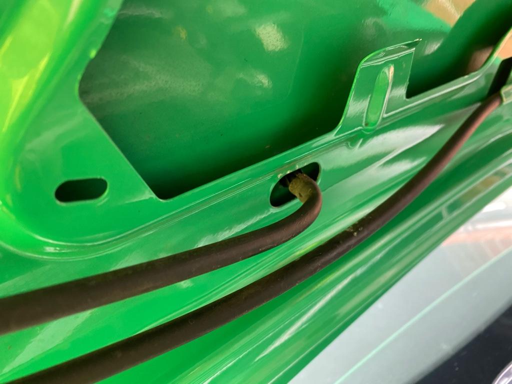

Also my OCD was kicking in as I had a boot grommet/stop missing.
10 seconds later and a new one fitted.
OEM part number for reference. Cost me £2.05 from my local dealer.

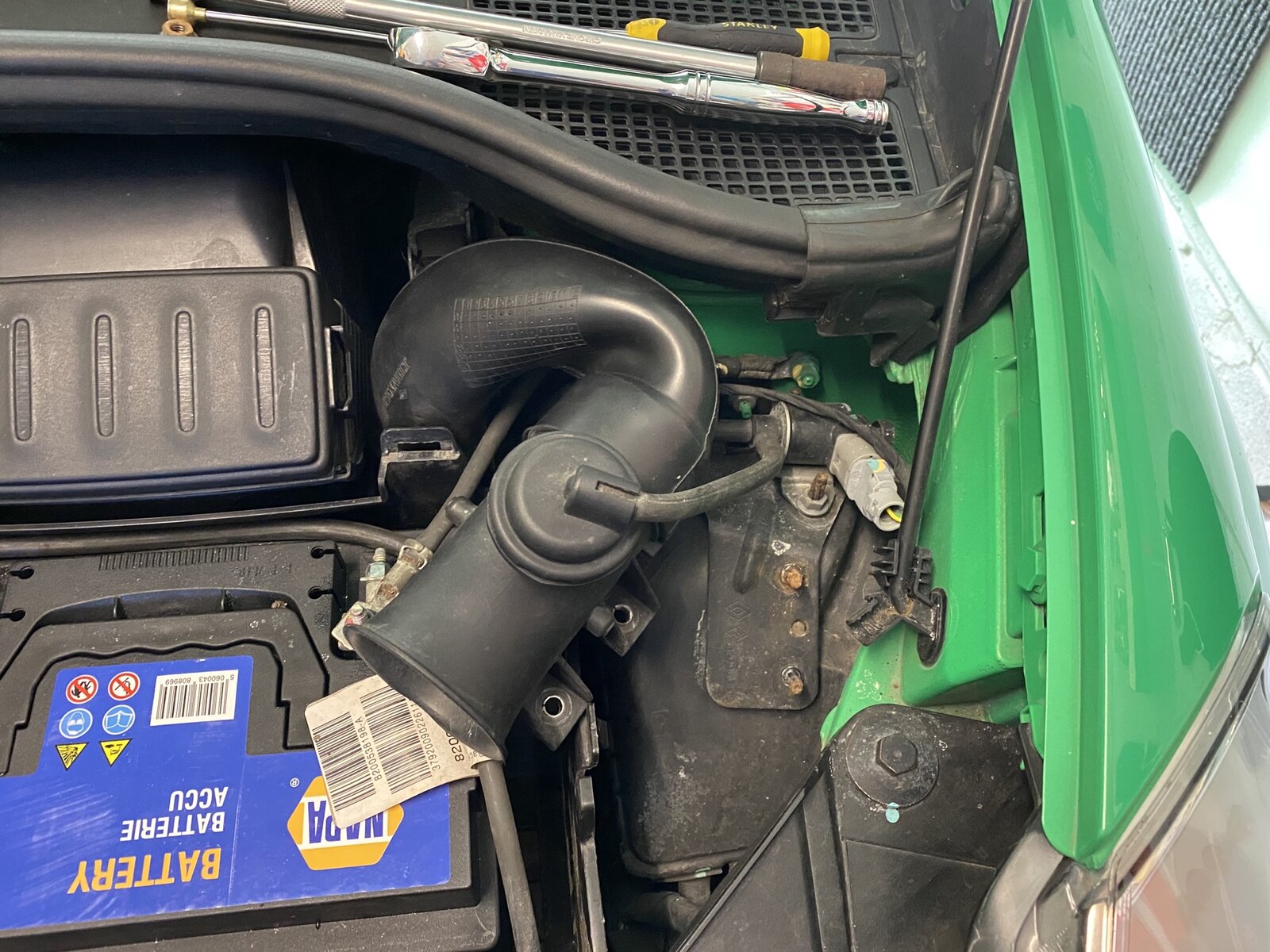

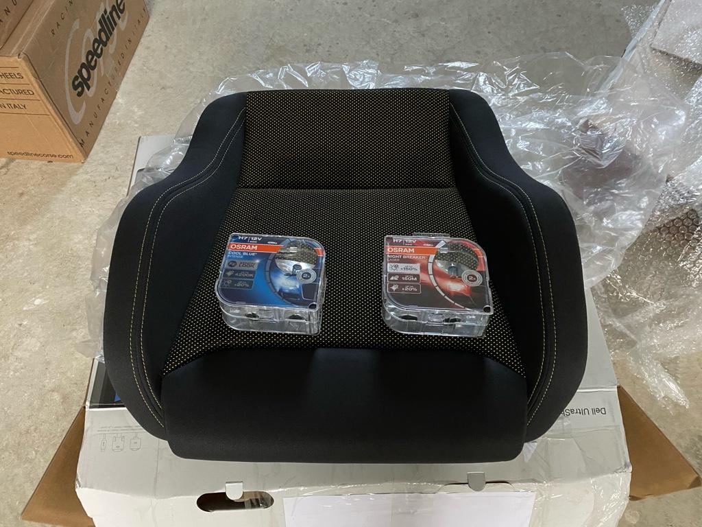

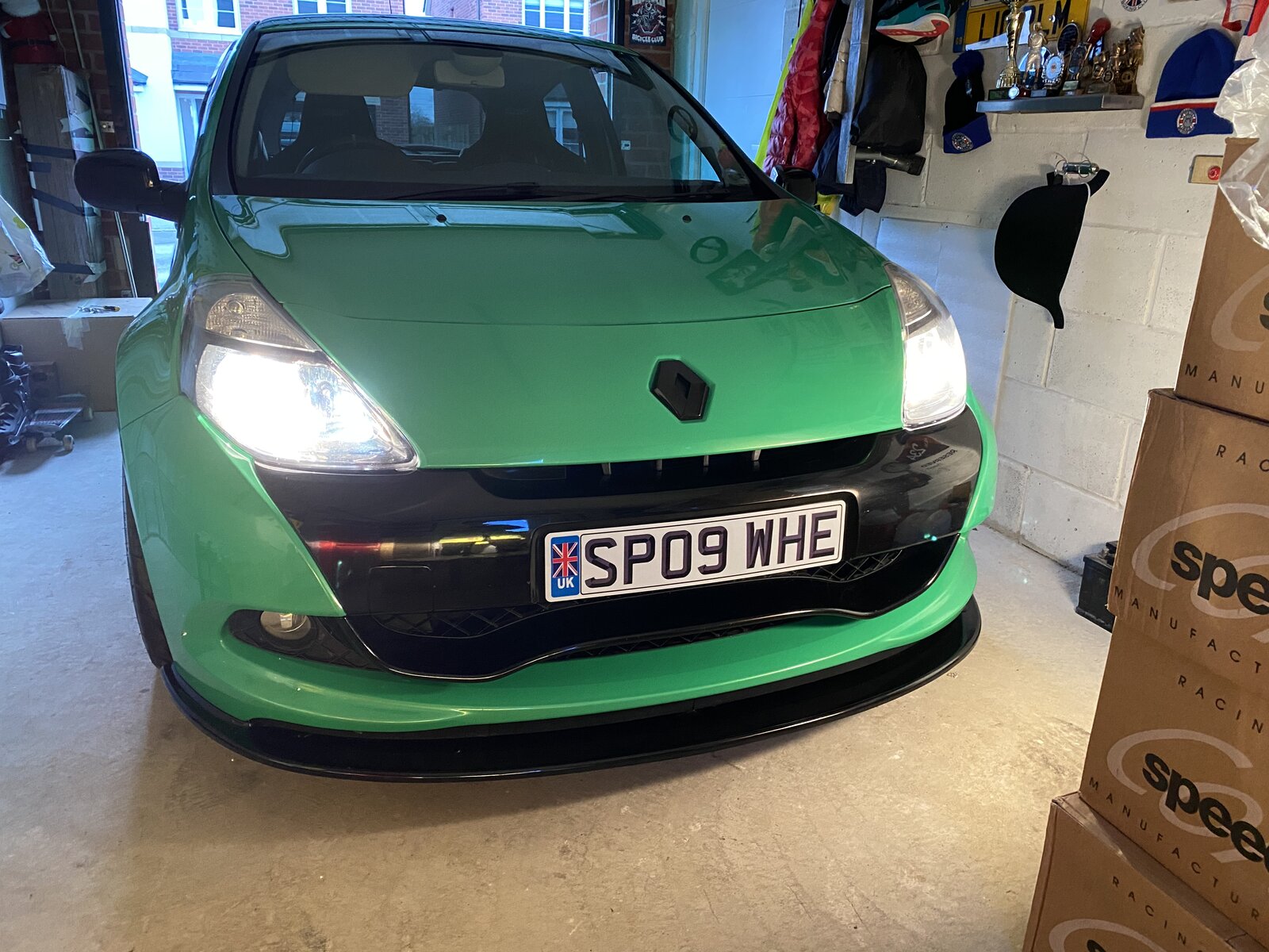

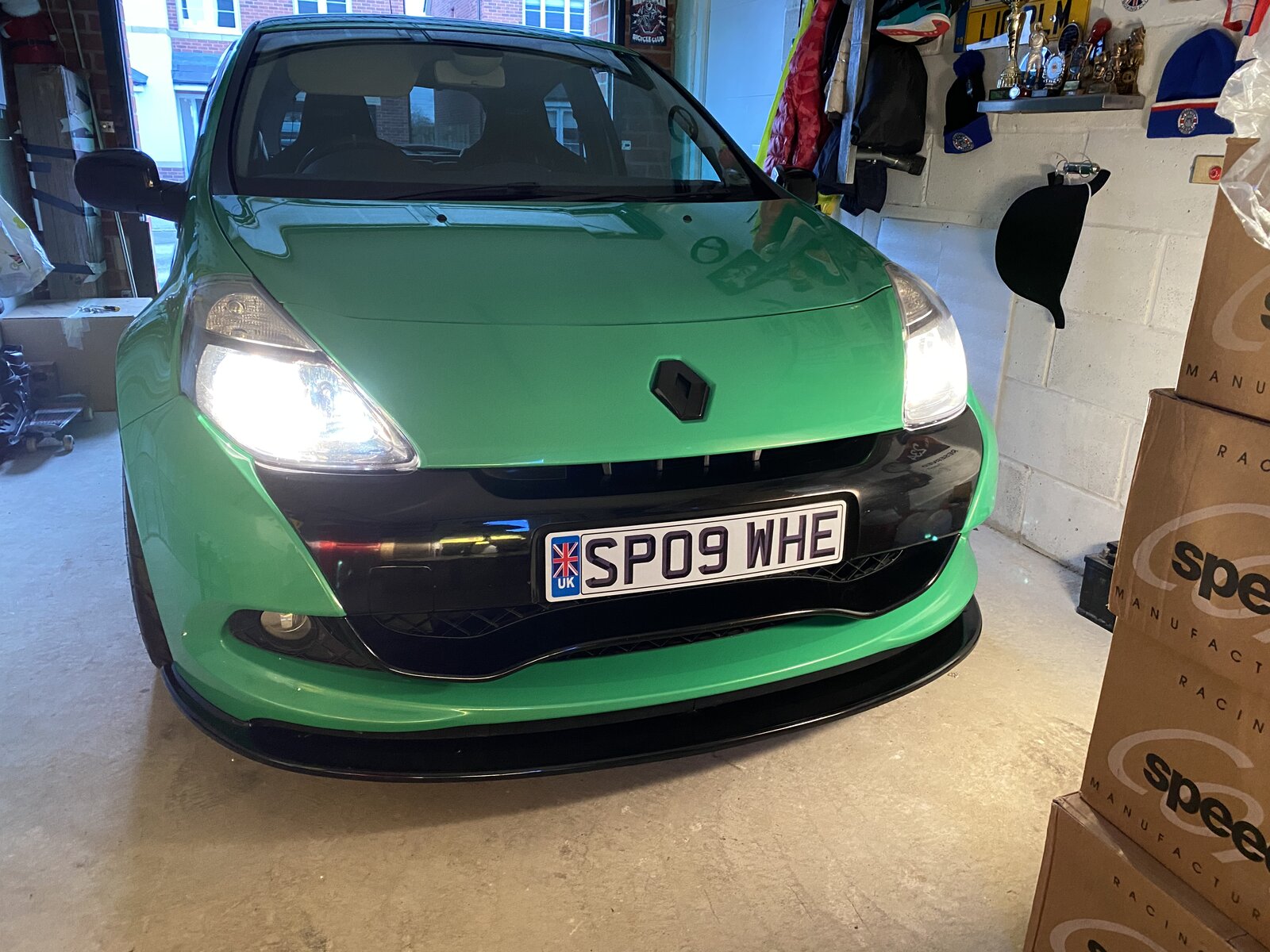

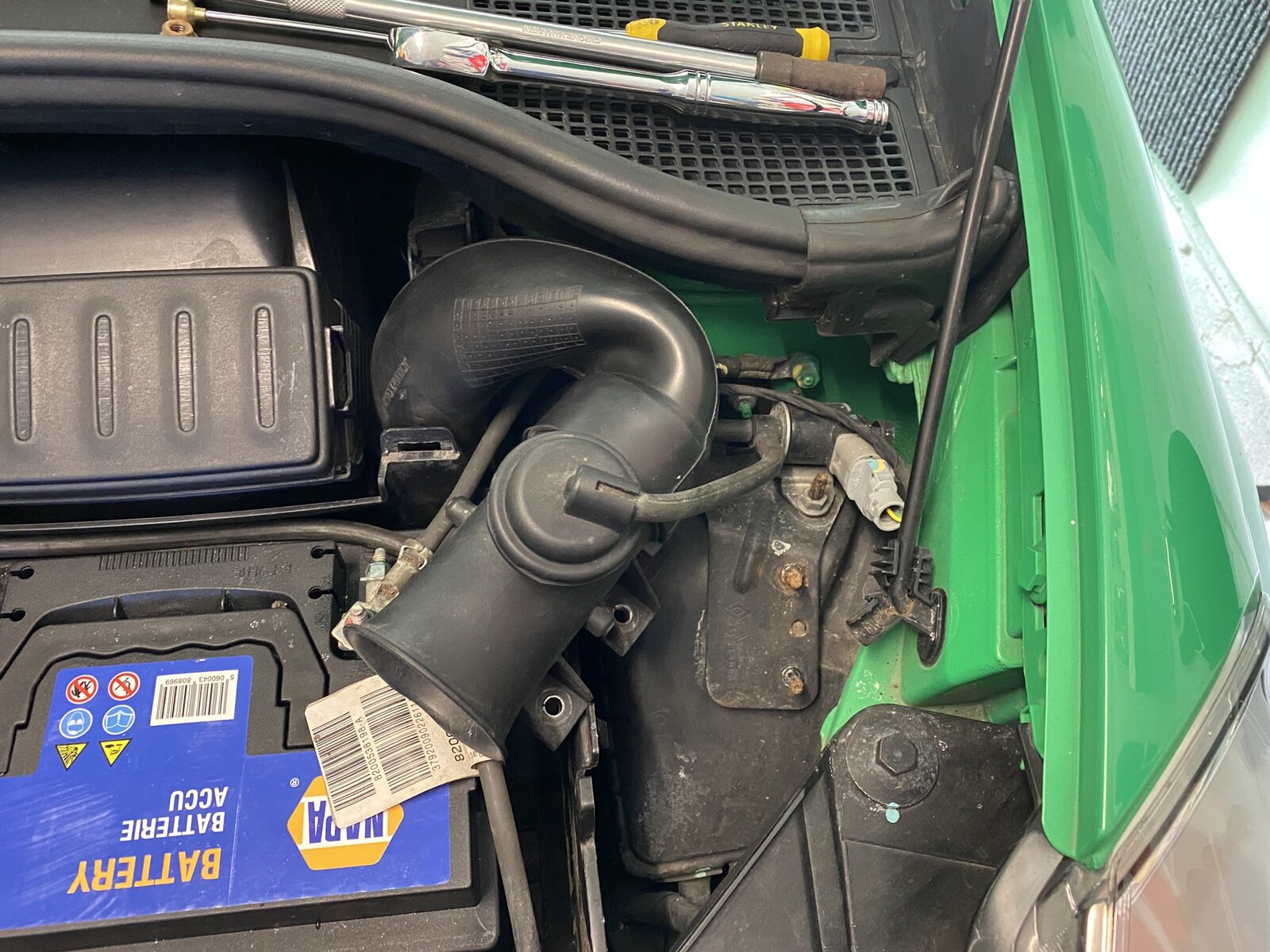

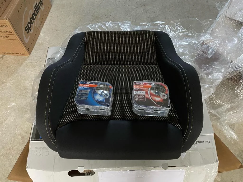

Had a blown headlight bulb so changed the lot on both sides.
Has to be the worst car ever made for changing bulbs. 1.5hrs later, after dropping the covers in the sump guard and after at least a 1,000 swear words they’re in.
Removed the washer bottle filler neck for the drivers side and this part (not sure what it is) but made it easier to get to the passenger side bulbs.

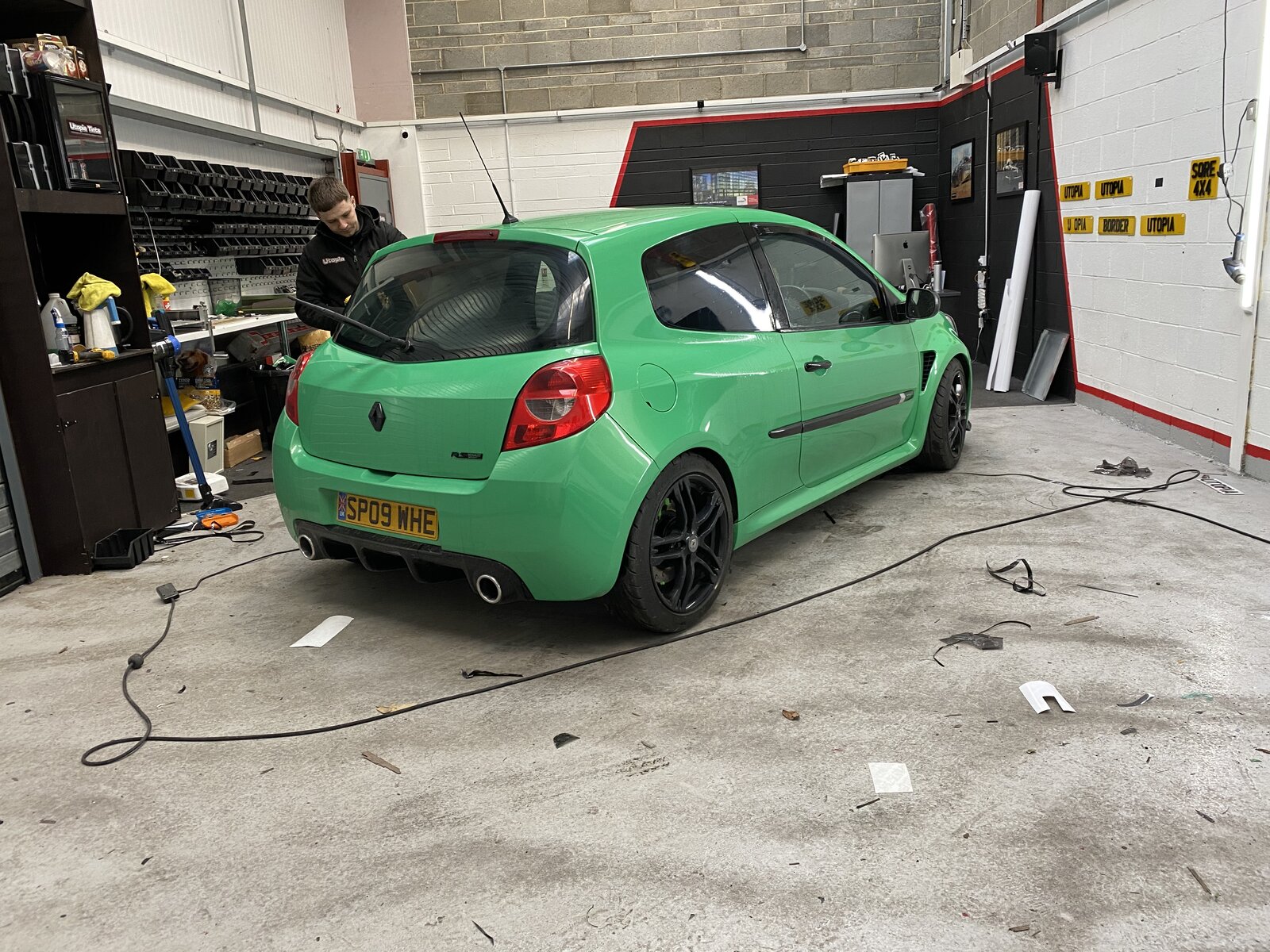

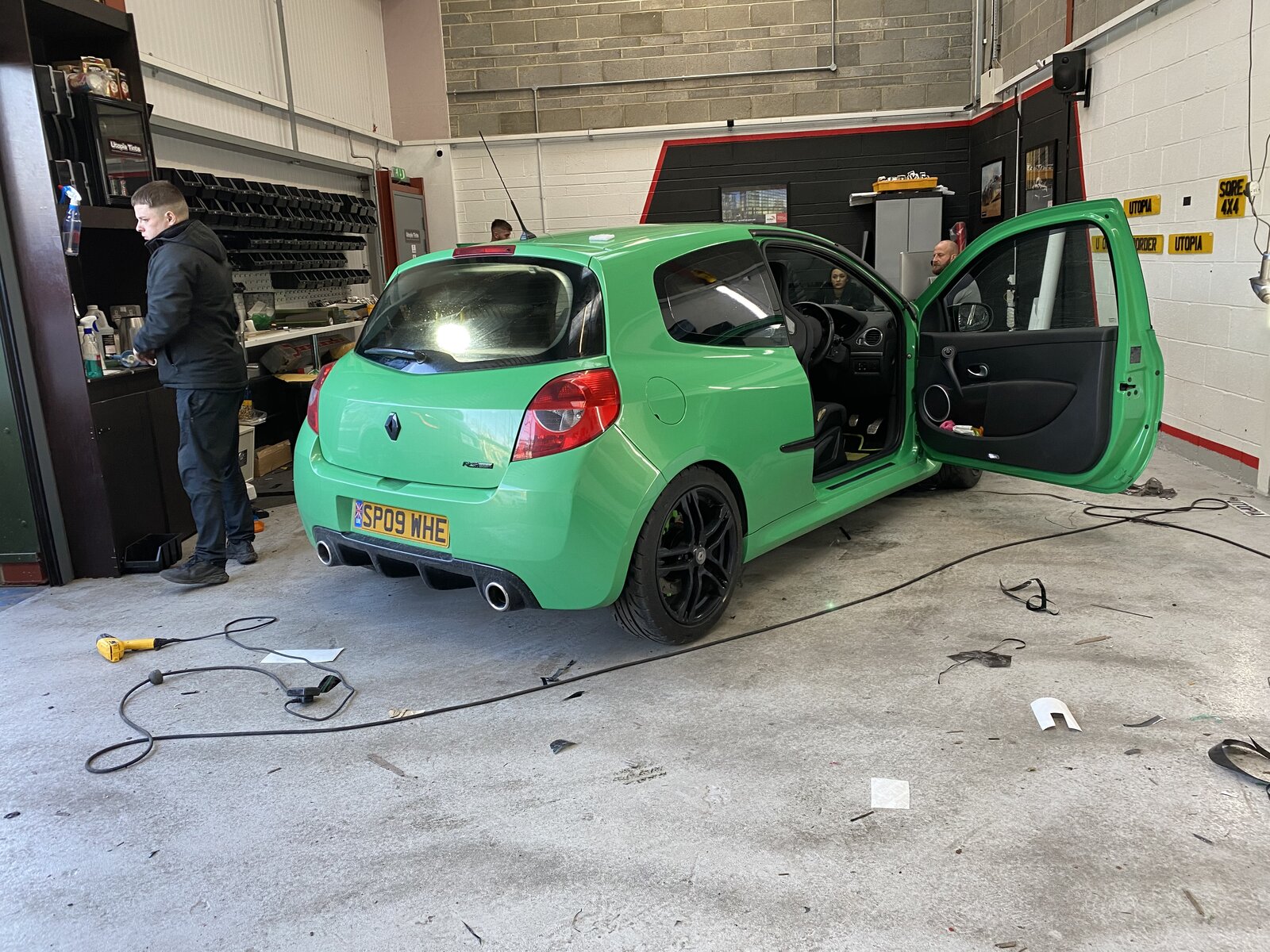

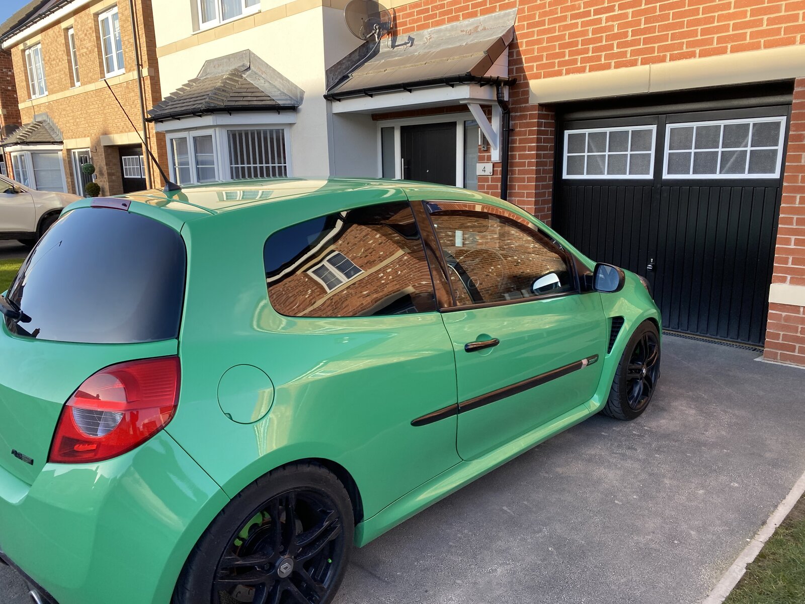

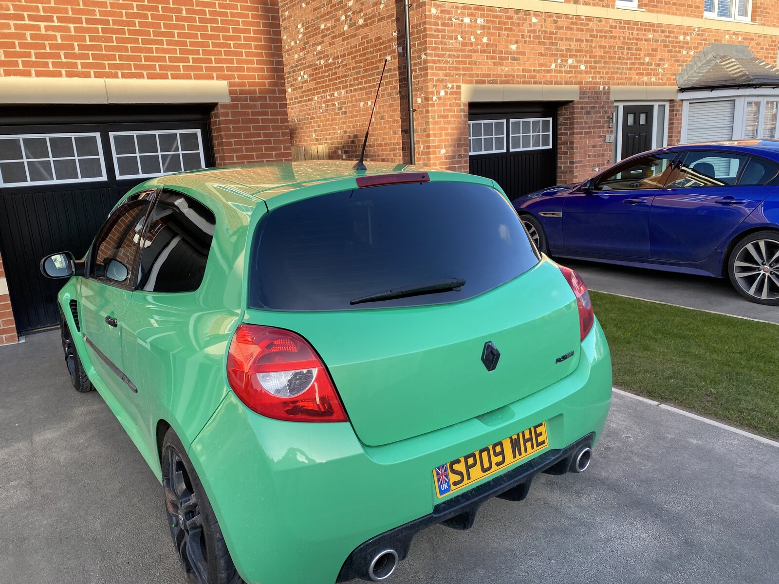

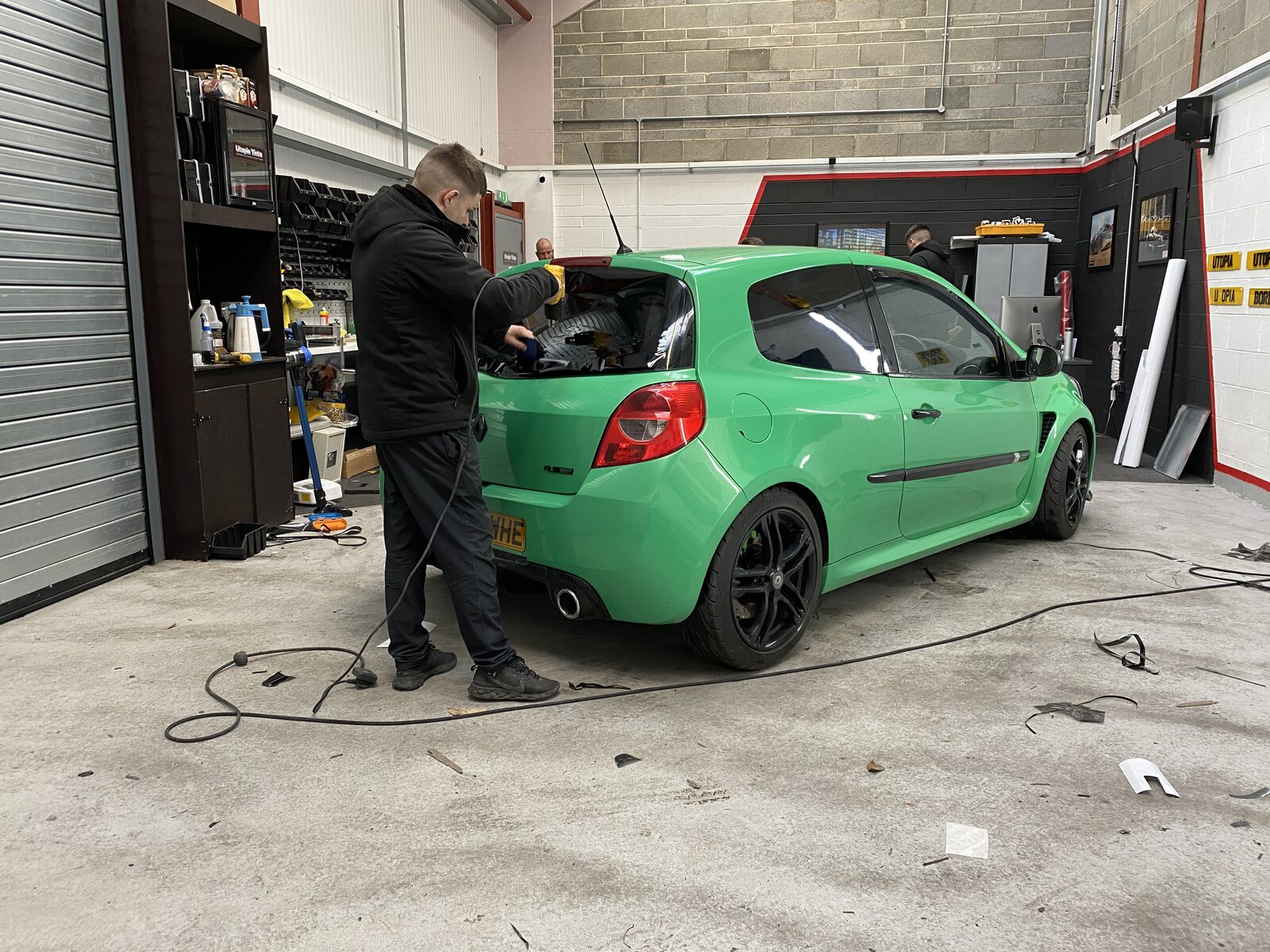

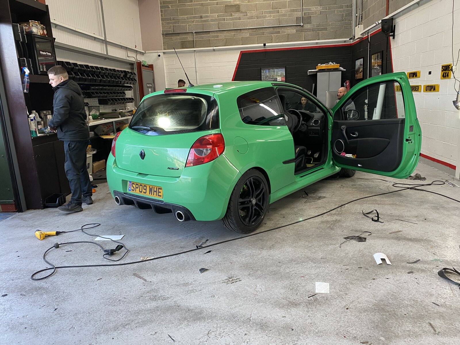

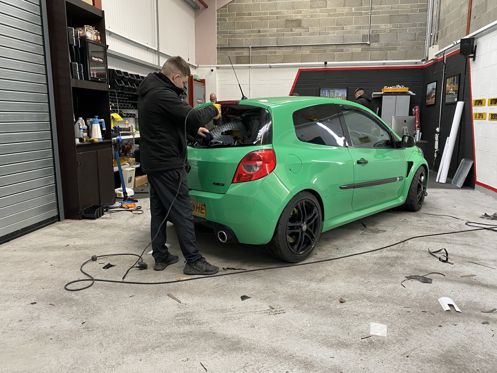

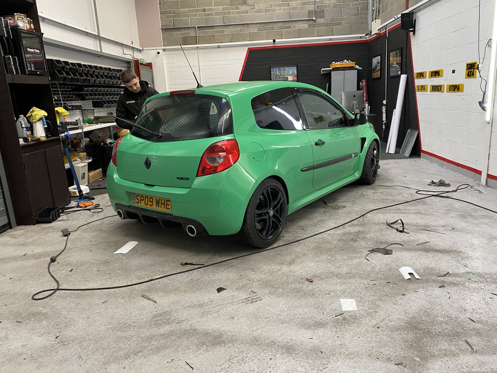

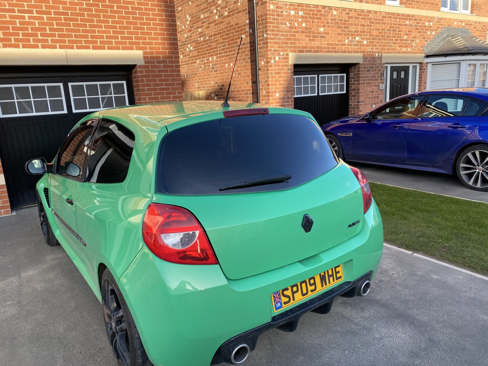

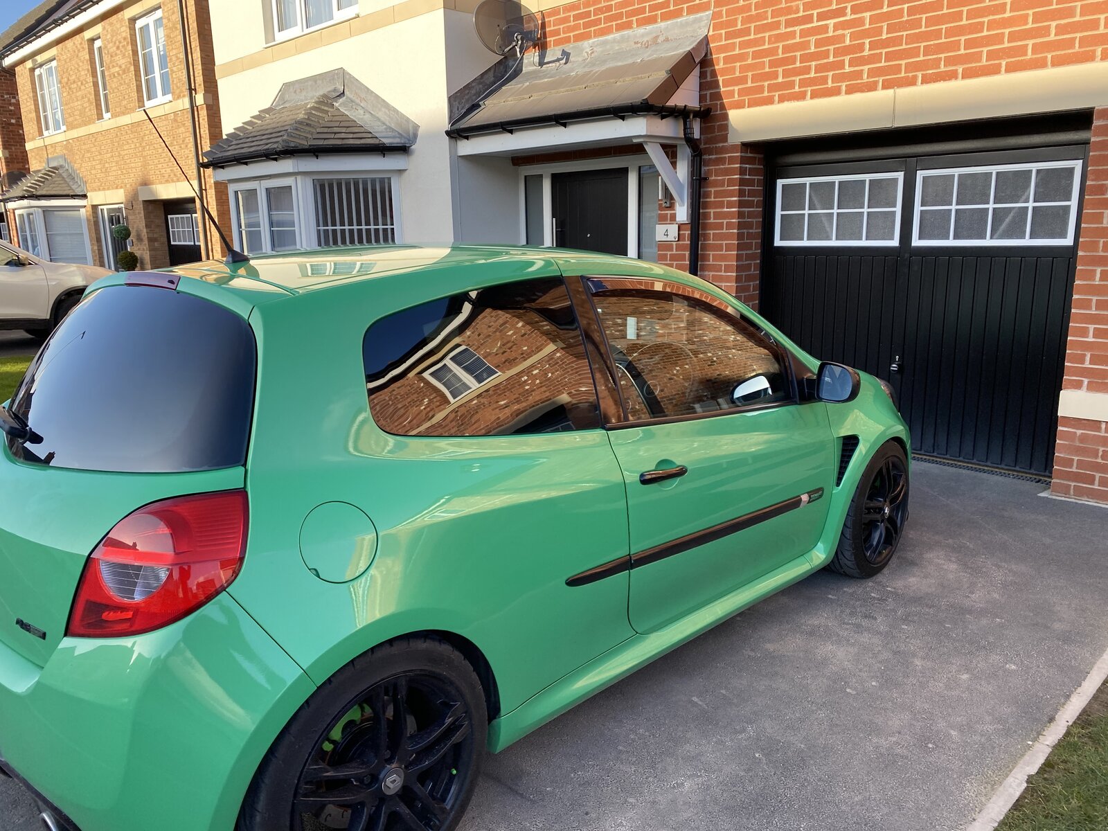

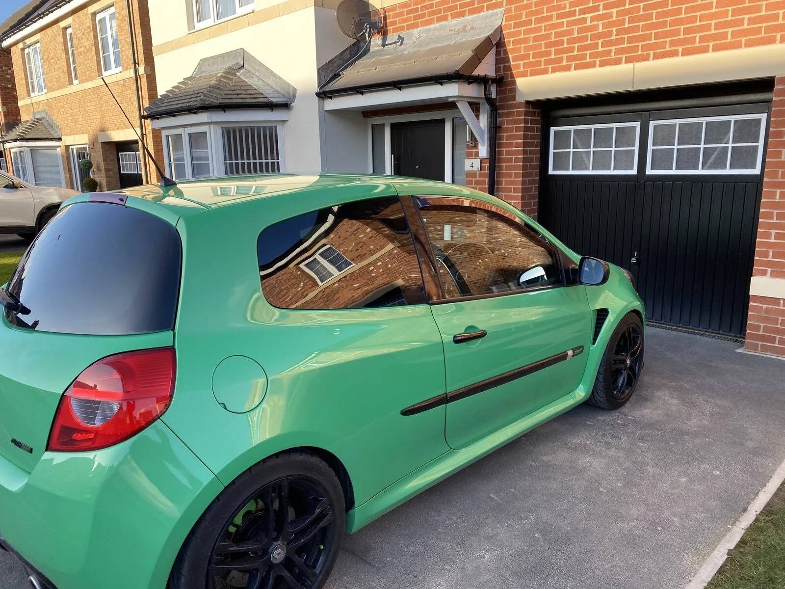

Trip to a local tint company called Utopia Tints. Went for the full on limo tint on the back 3 windows.
Few more jobs planned tomorrow if the weather permits.
Cup spoiler to fit if back from the paint shop.
TRC side skirt extensions to fit.

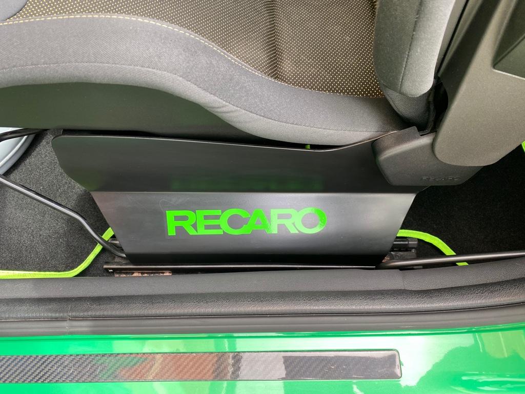

New Recaro seat base.

This was looking great until the tints went on! Dont suit these at all imho.
Loving the rest of the project though mate
  RS200
See how it looks when I have the TRC side skirt extensions and spoiler on.
Tints are easy enough to remove.

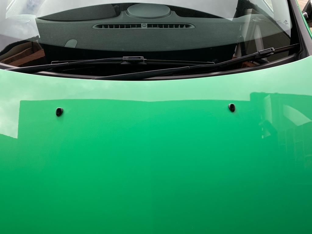

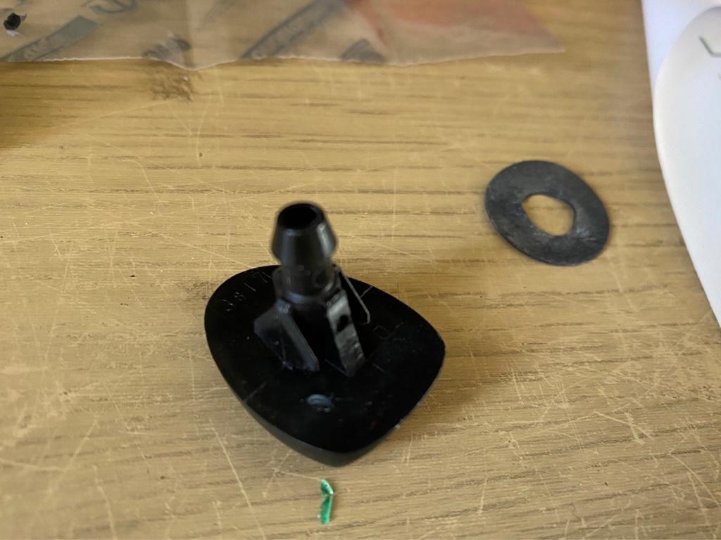

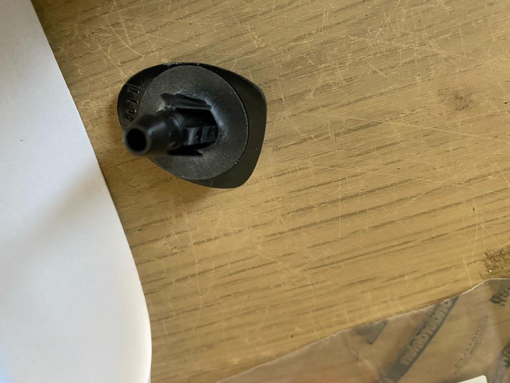

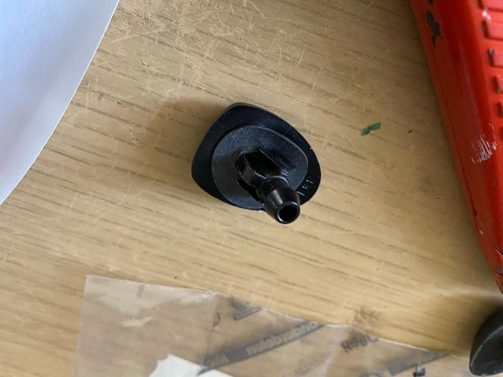

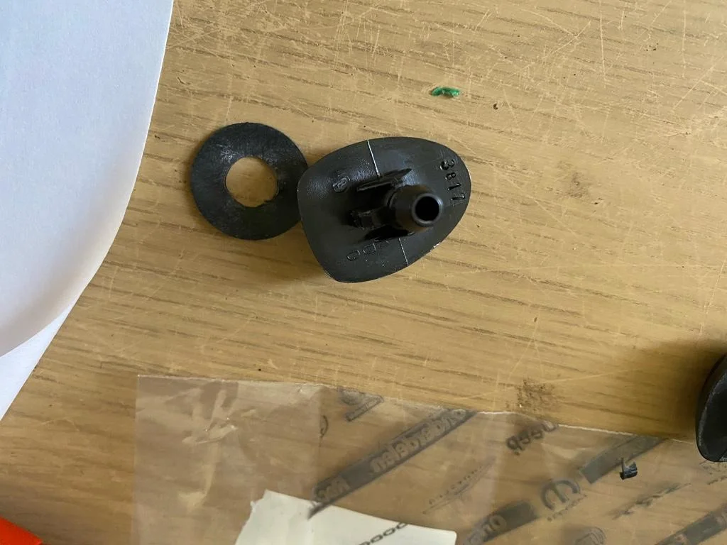

Changed the washer nozzles today. Spray coverage is 100% better now.
Took 20 mins.
OEM Citroen C3 nozzles used.
Slight mod required bu cutting the front section of the nozzle. Ensure rubber seal is removed before cutting.
Push fit gently into place on the bonnet and reattach the hose.
Much improved look and water coverage.

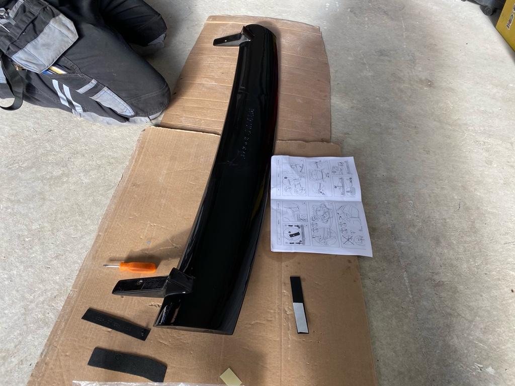

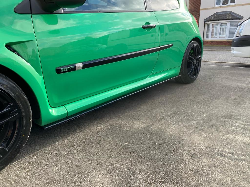

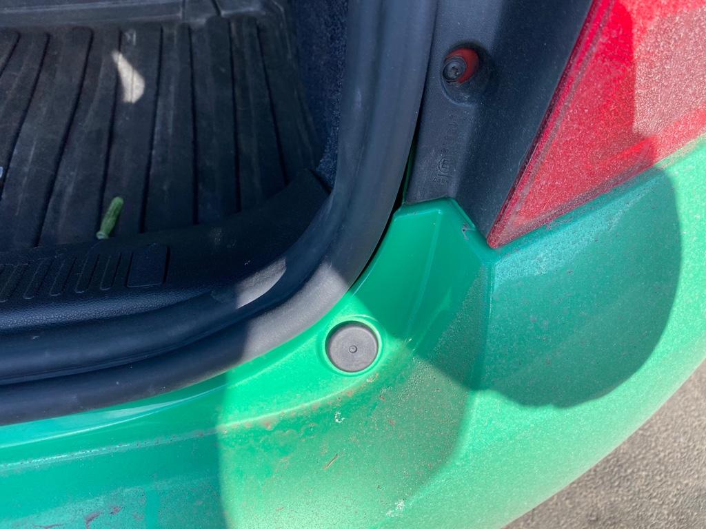

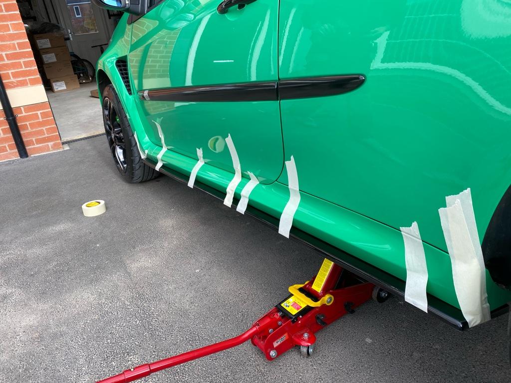

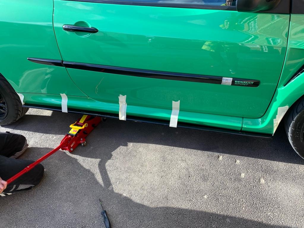

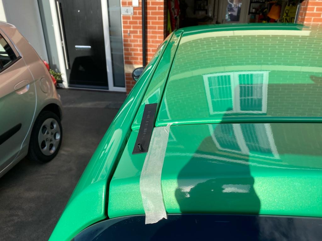

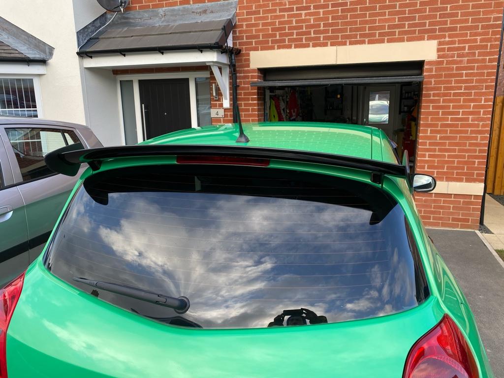

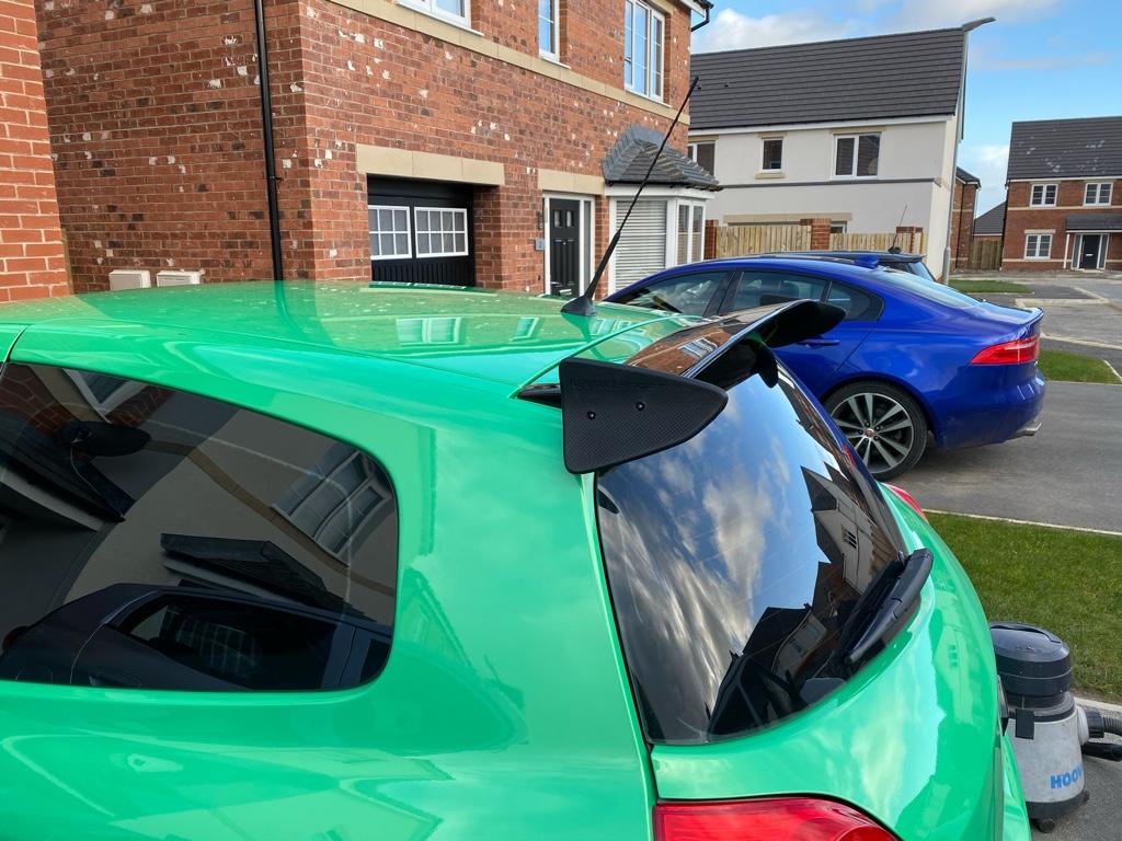

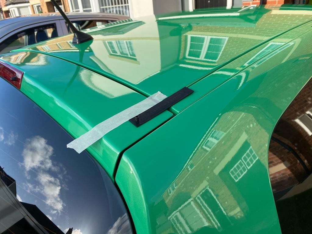

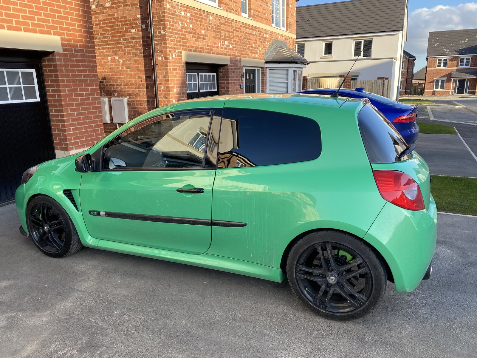

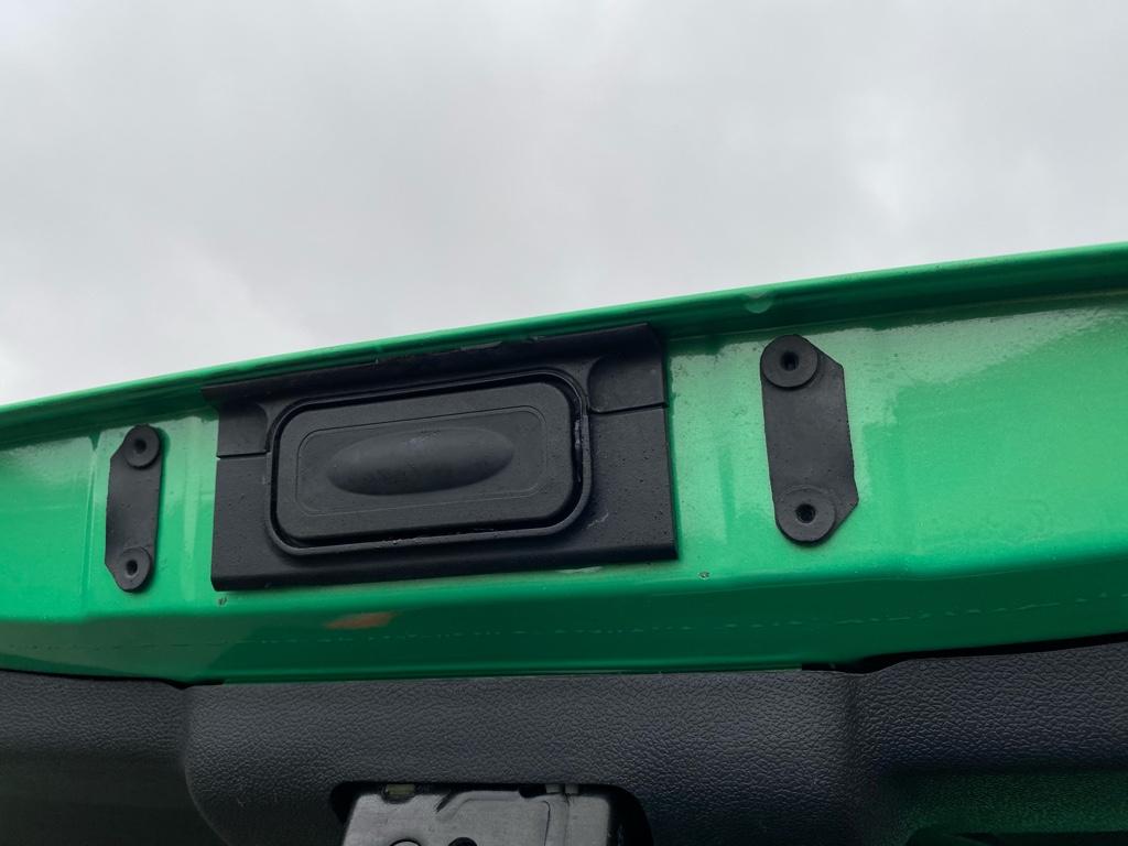

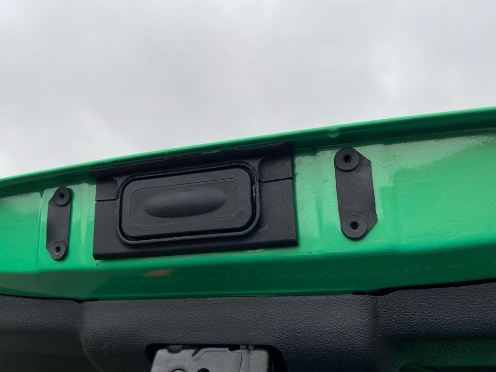

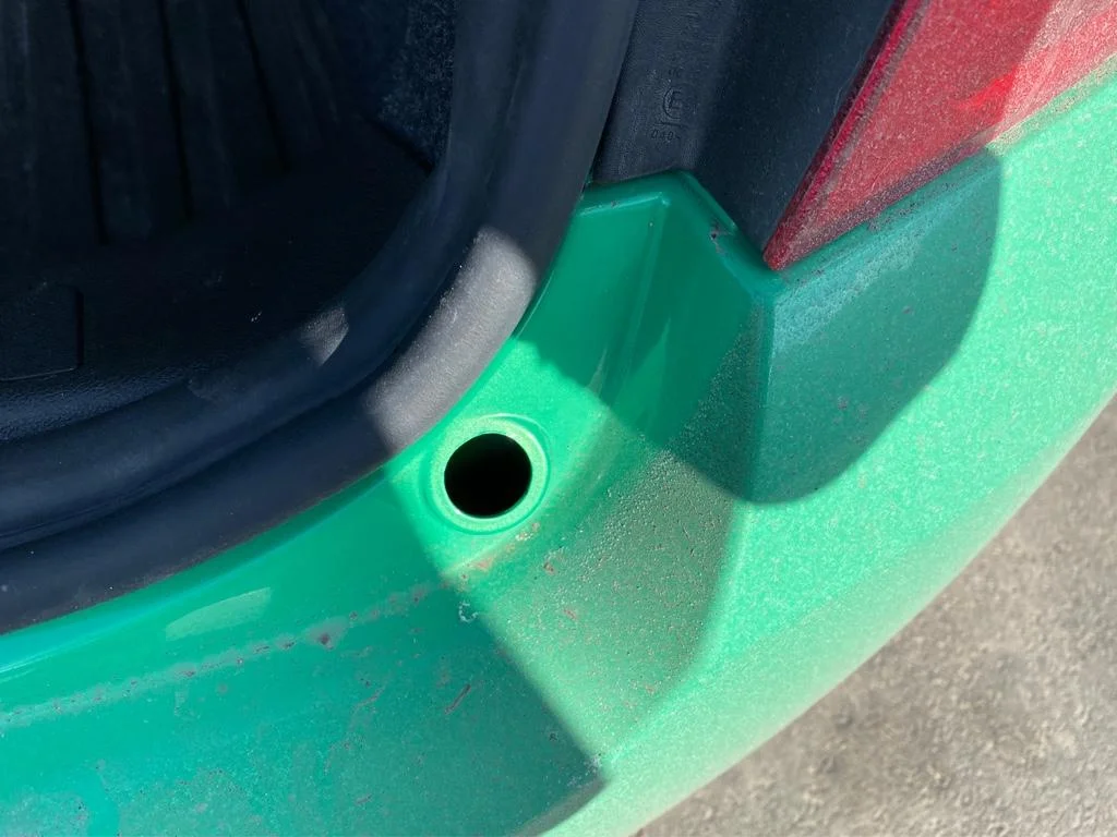

Another very productive afternoon.

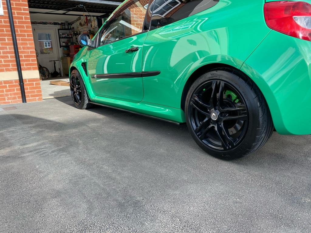

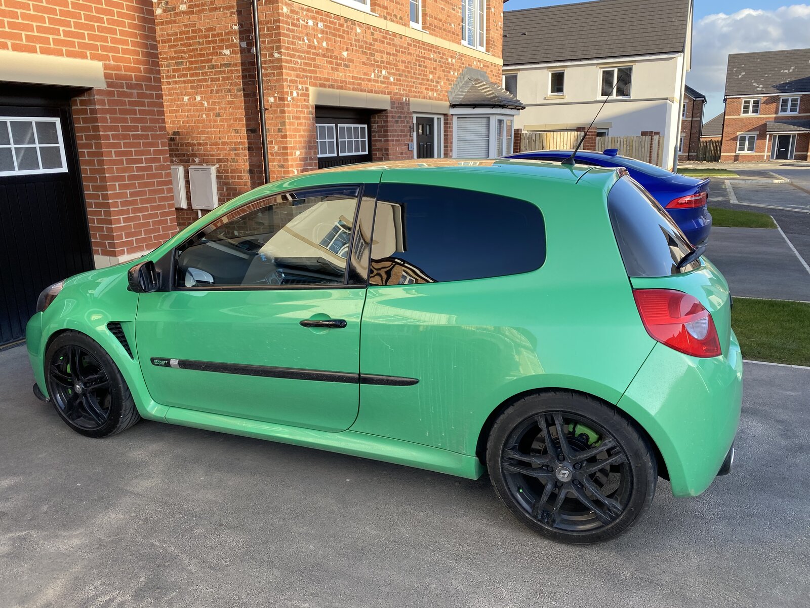

TRC side skirt extensions fitted.

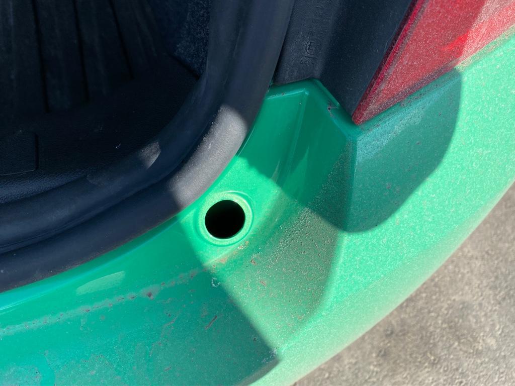

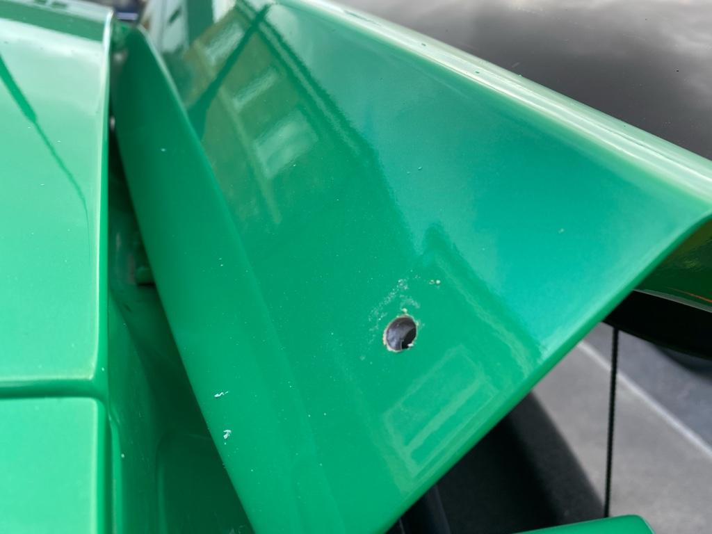

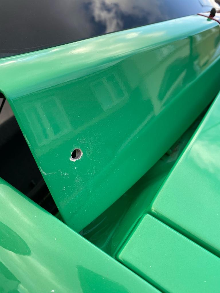

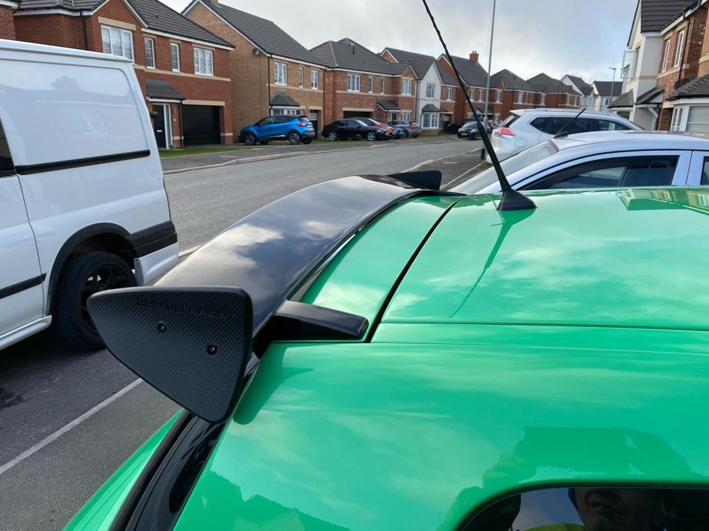

Genuine Renault Cup spoiler fitted. Have to say it was a bit nerve racking drilling the boot. Measure 10 times and drill once [emoji23][emoji1303].
Few scenic shots at a local castle in Brancepeth which is 2 miles from me.
