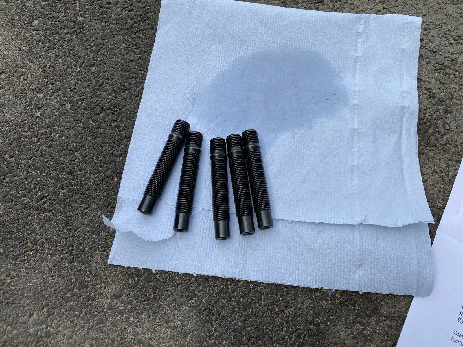

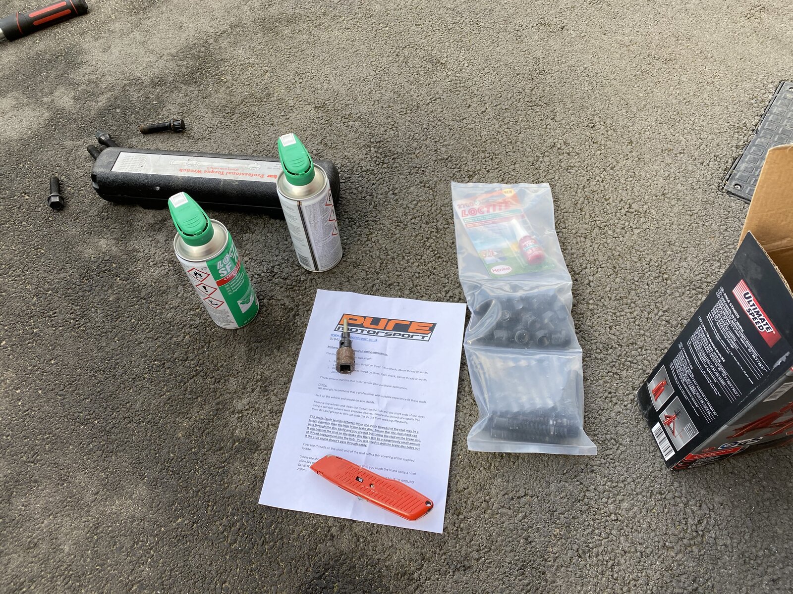

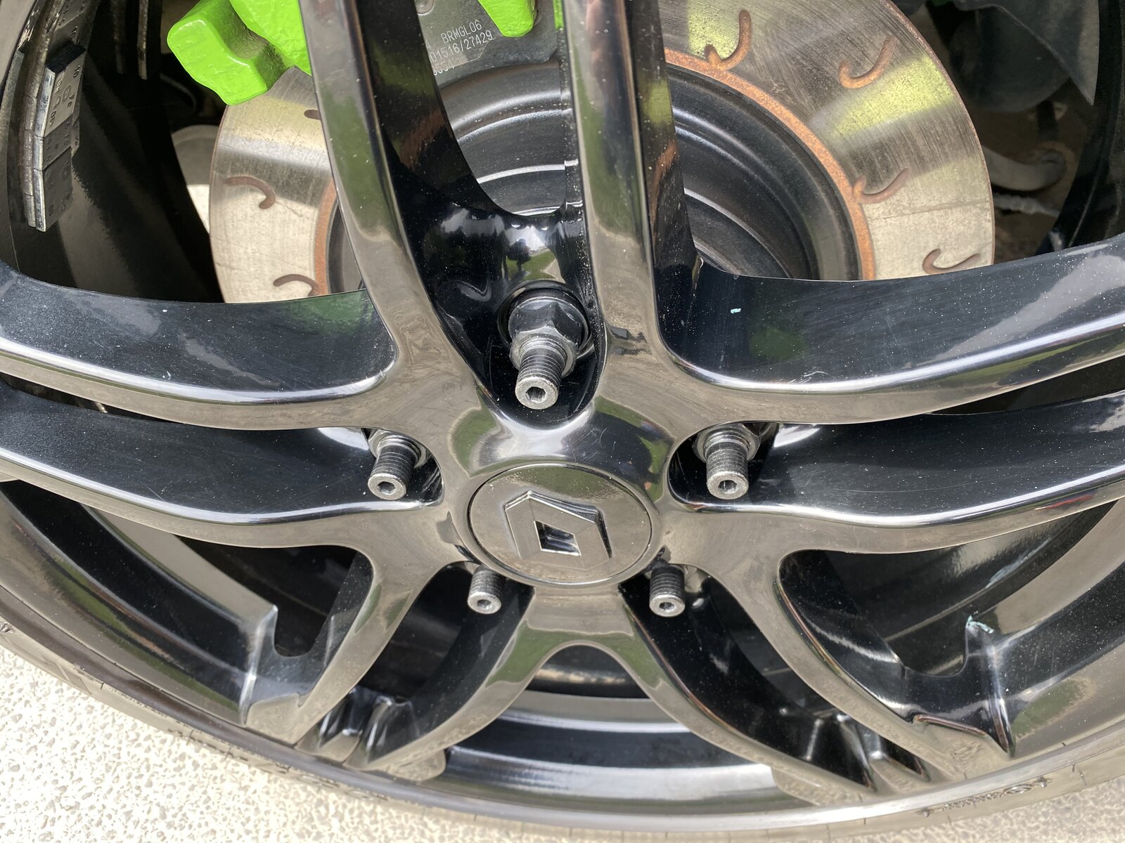

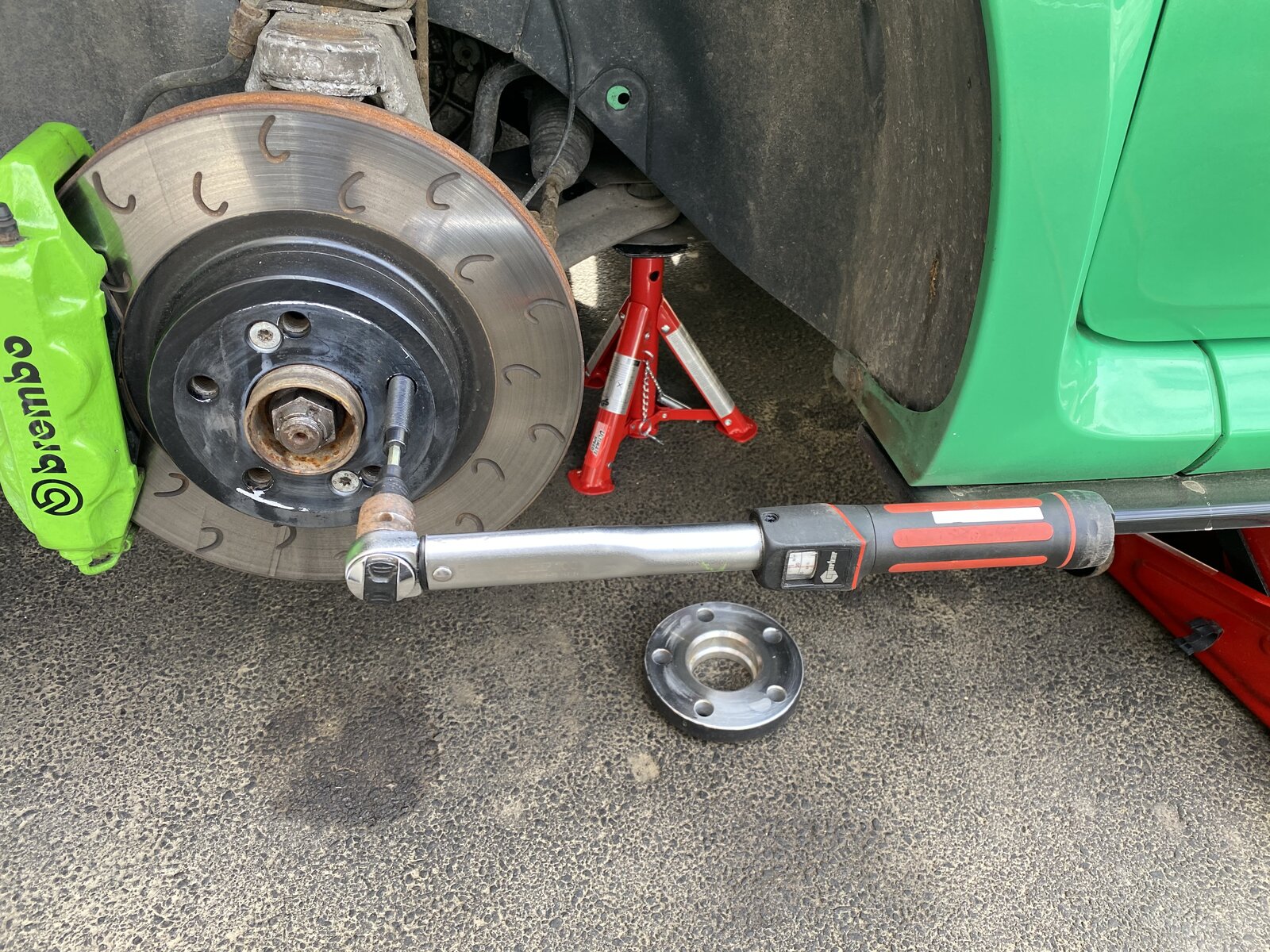

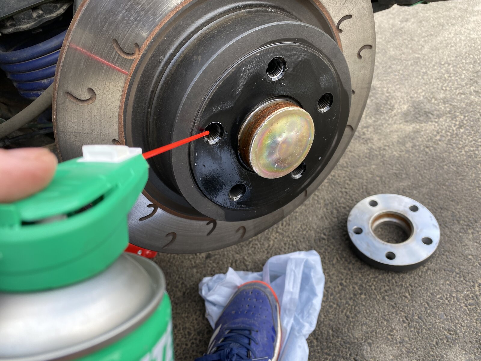

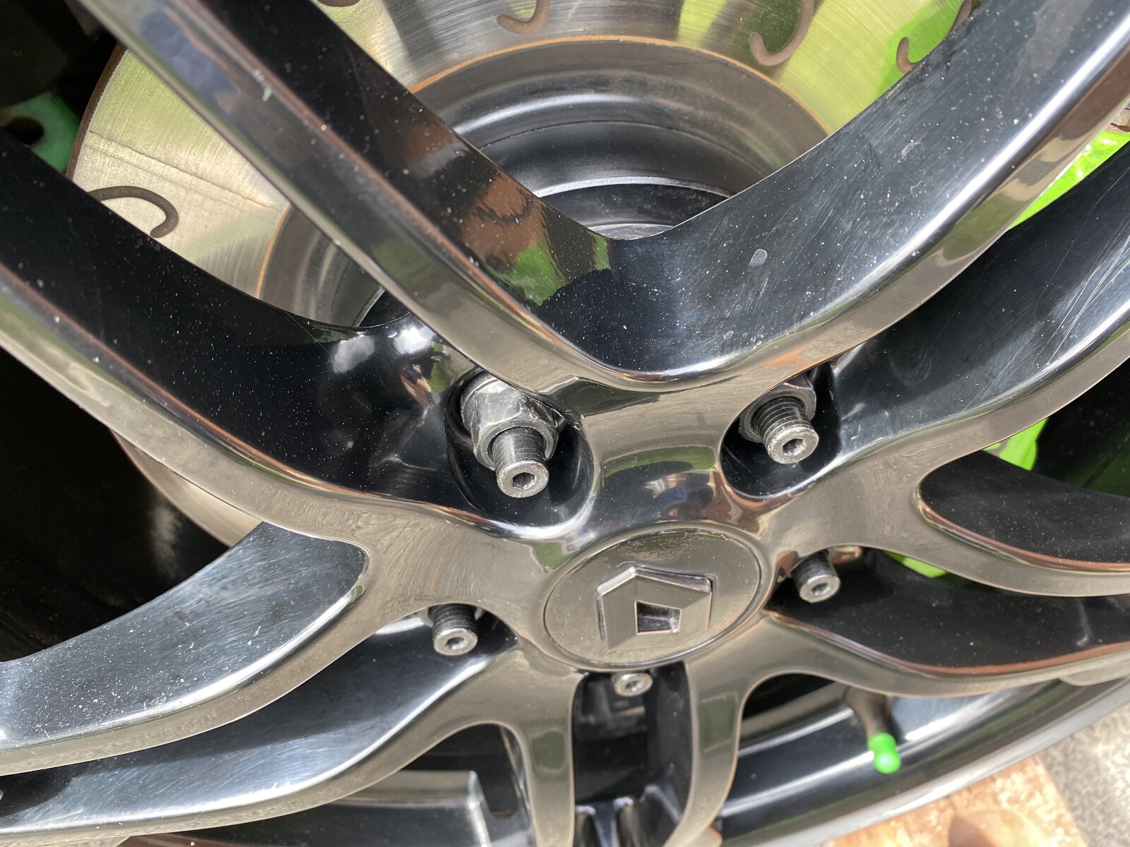

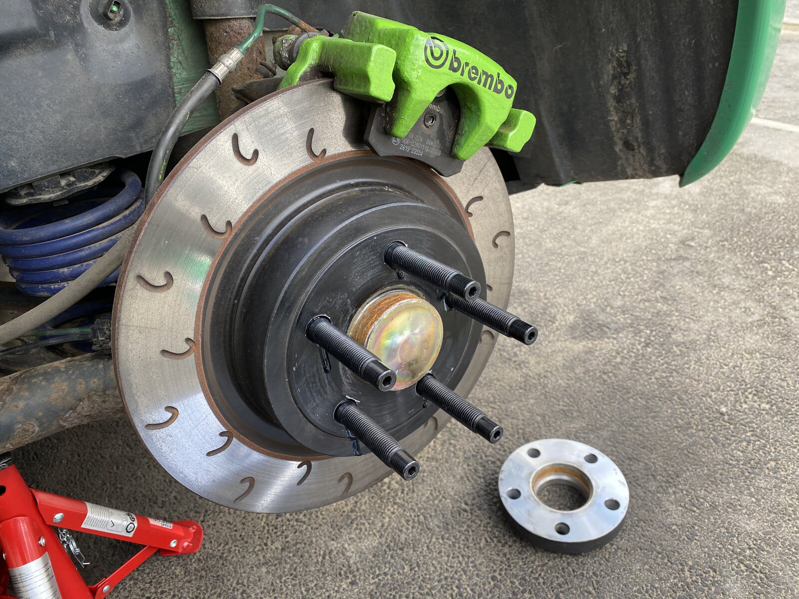

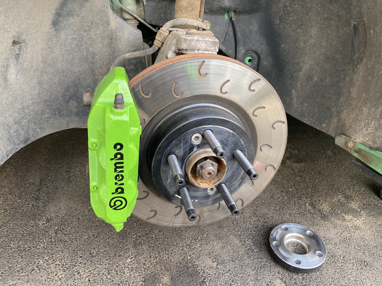

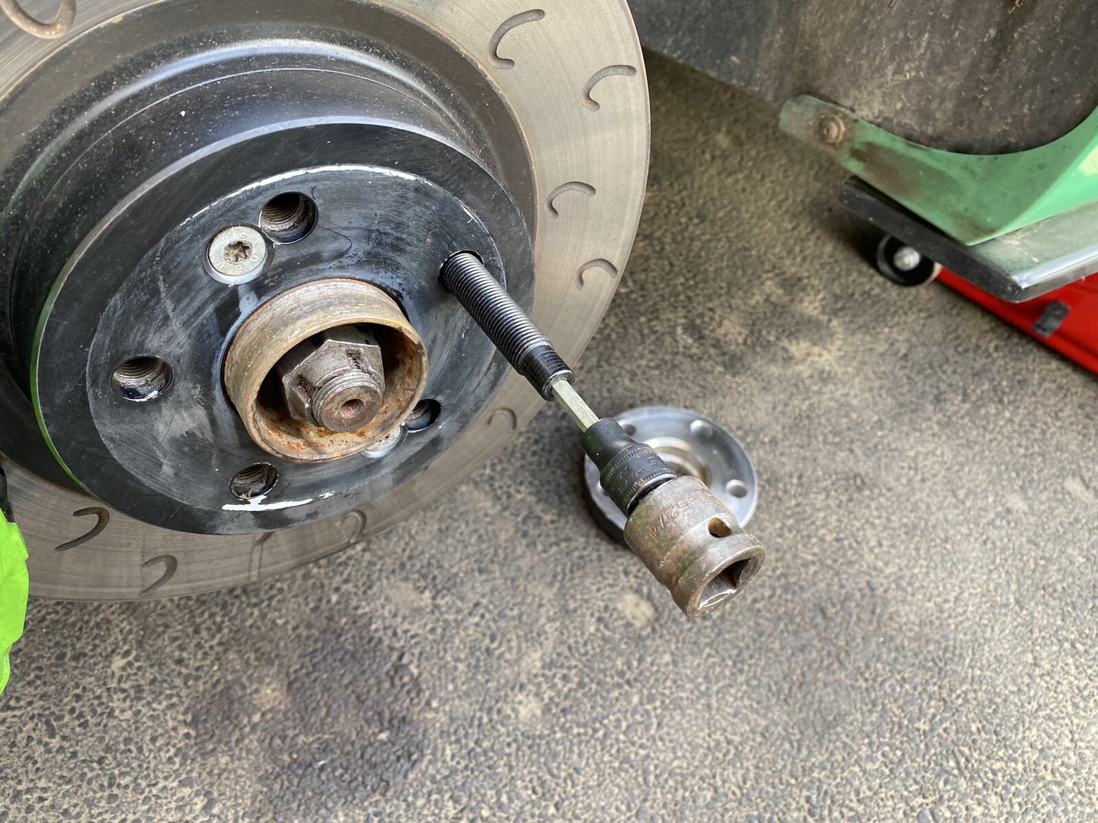

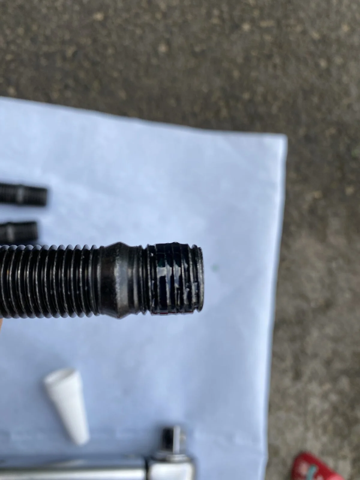

Busy morning today. PMS stud conversion done. Extended studs fitted for the 20mm spacer fitment.

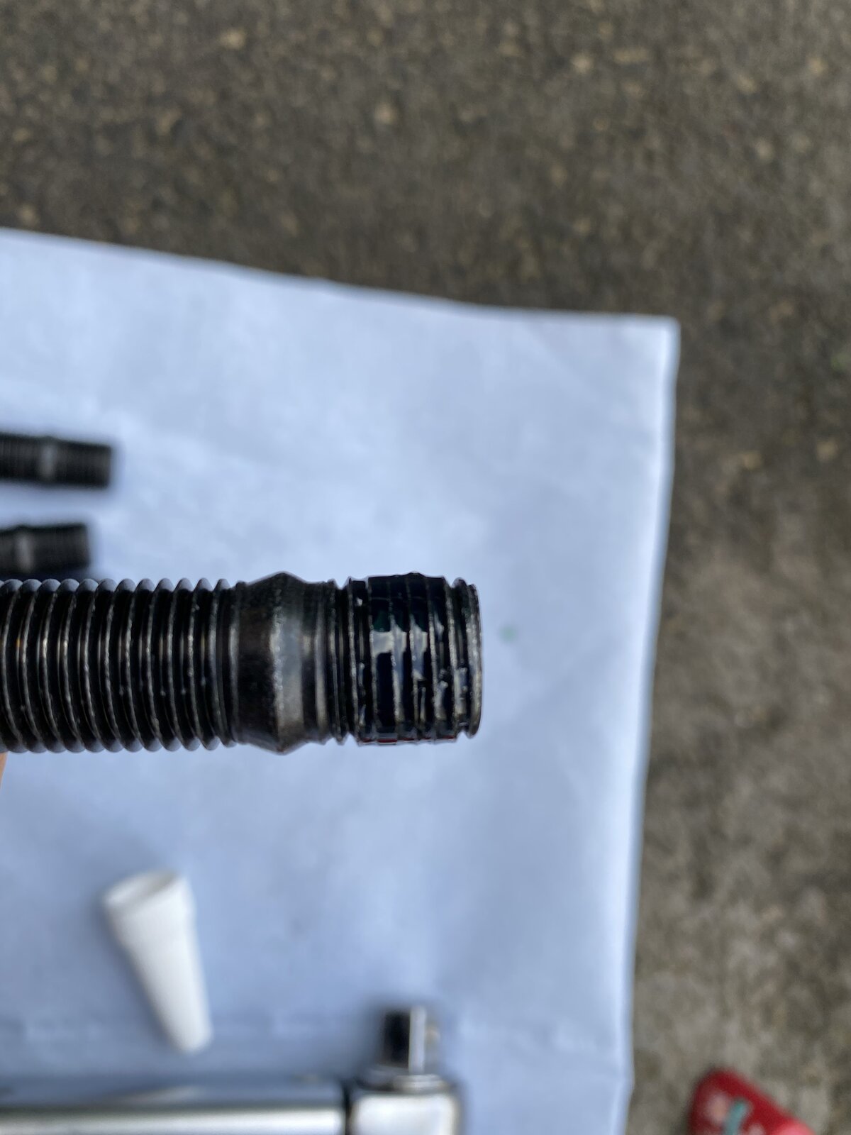

Hubs and studs cleaned with Loctite cleaner.

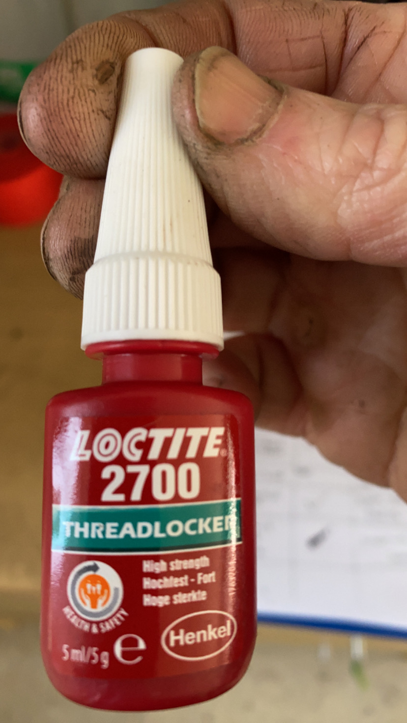

Loctite 2700 applied to studs.

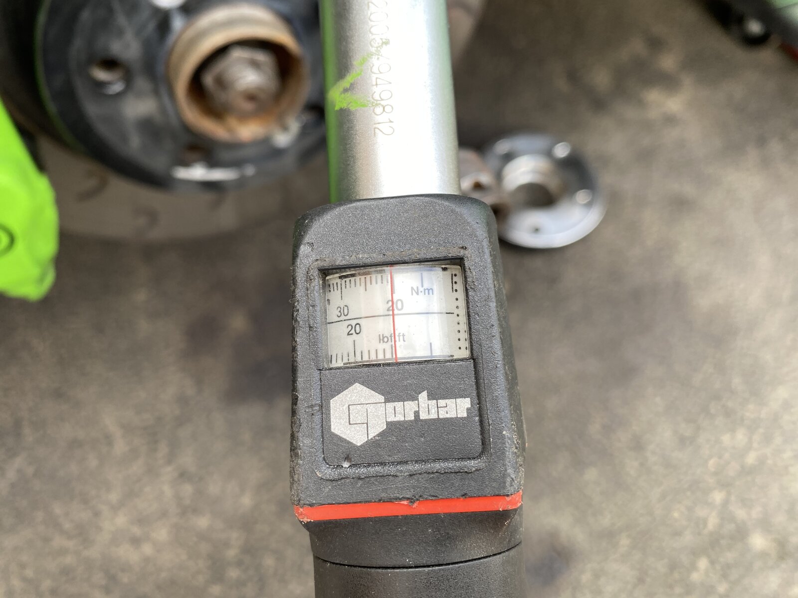

Studs fitted and torqued to 20Nm. Then left to set for 4 hrs.
Studs in place.

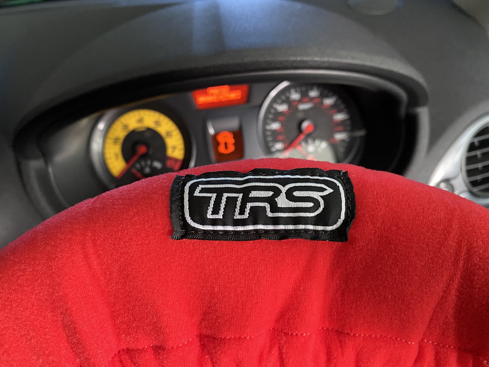

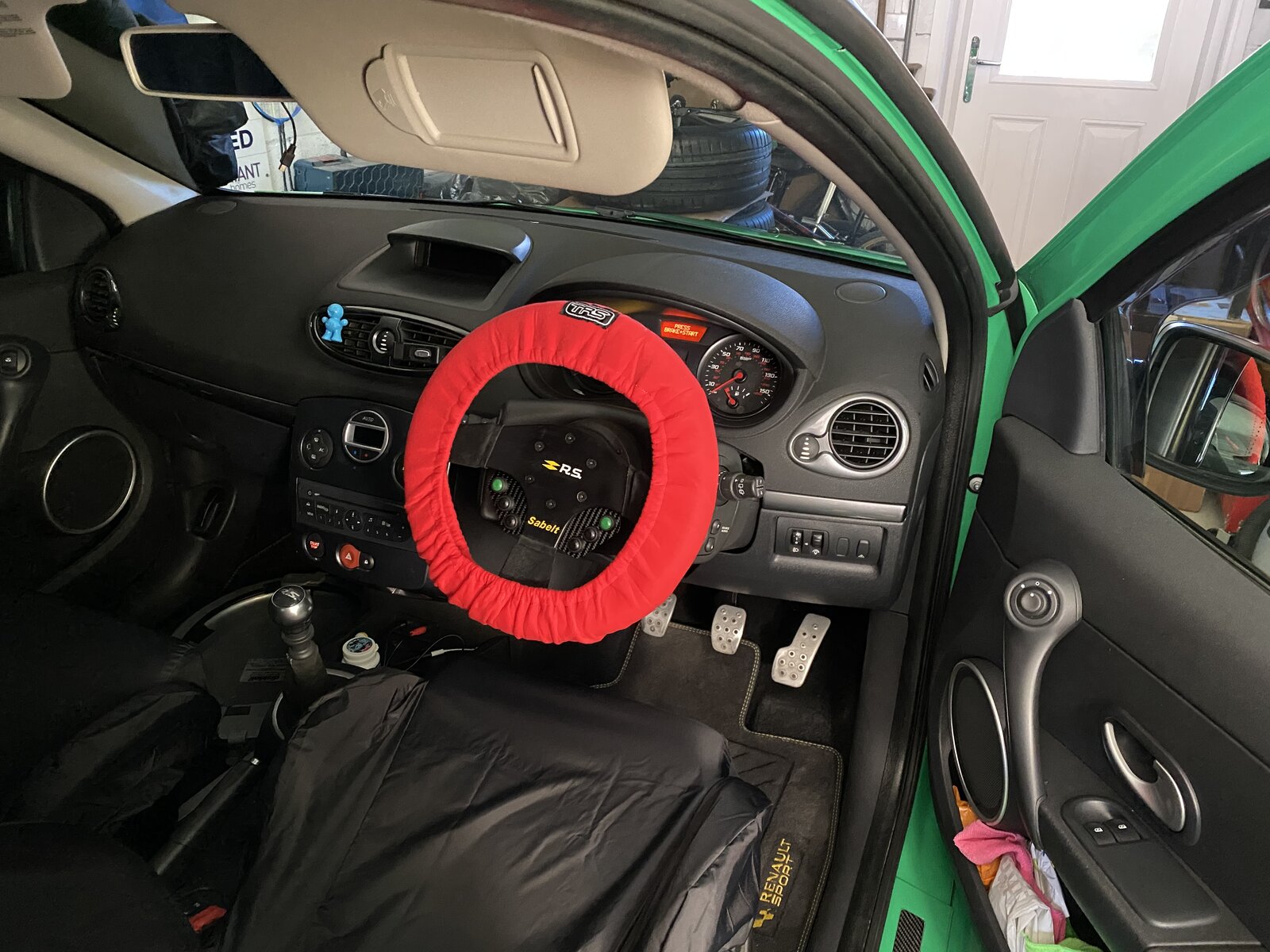

TRS wheel cover arrived last week. Keeps the suede looking fresh.
Looks great with the work you’re doing..

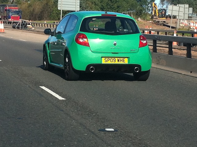

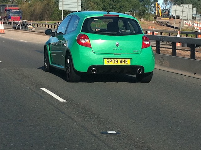

This car could of owned to the traders who bought the chi’s car collection.
Used to see this car years ago and is originally from Edinburgh, It was around alot and it was an older gent it had it.
A720 Edinburgh Bypass - Edinburgh , Scotland September 2012

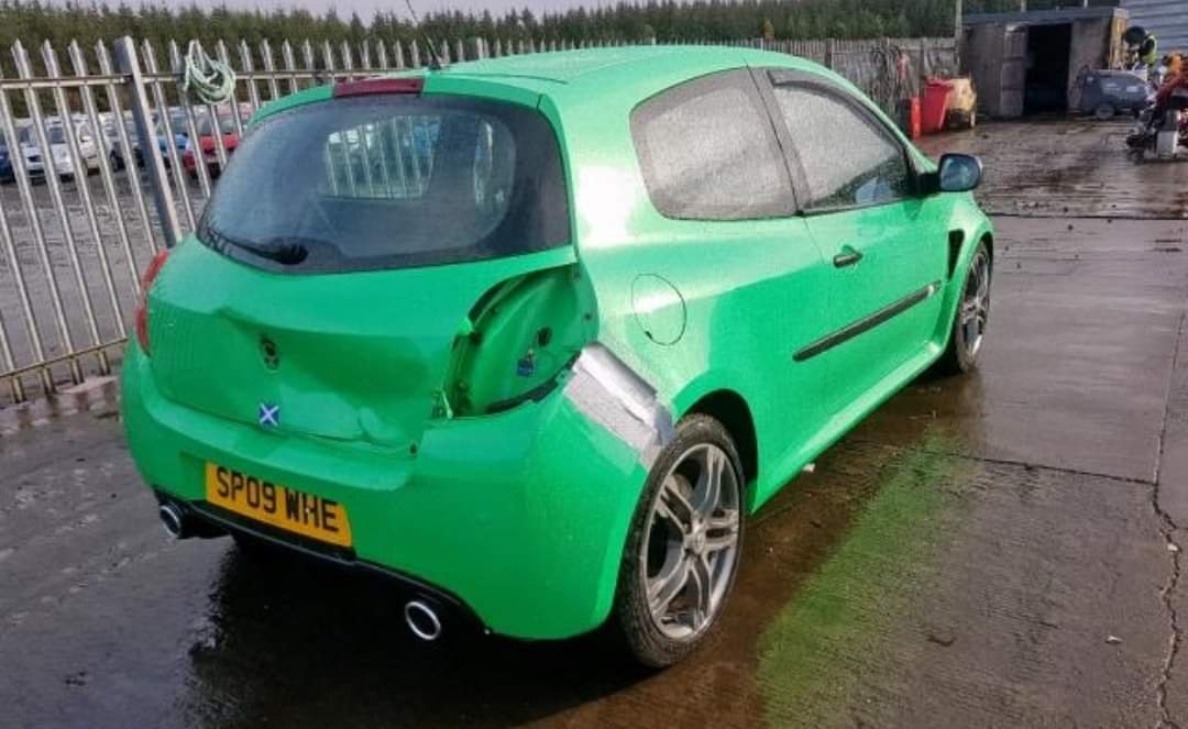

CoPart Auction - West Lothian , Scotland November 2019

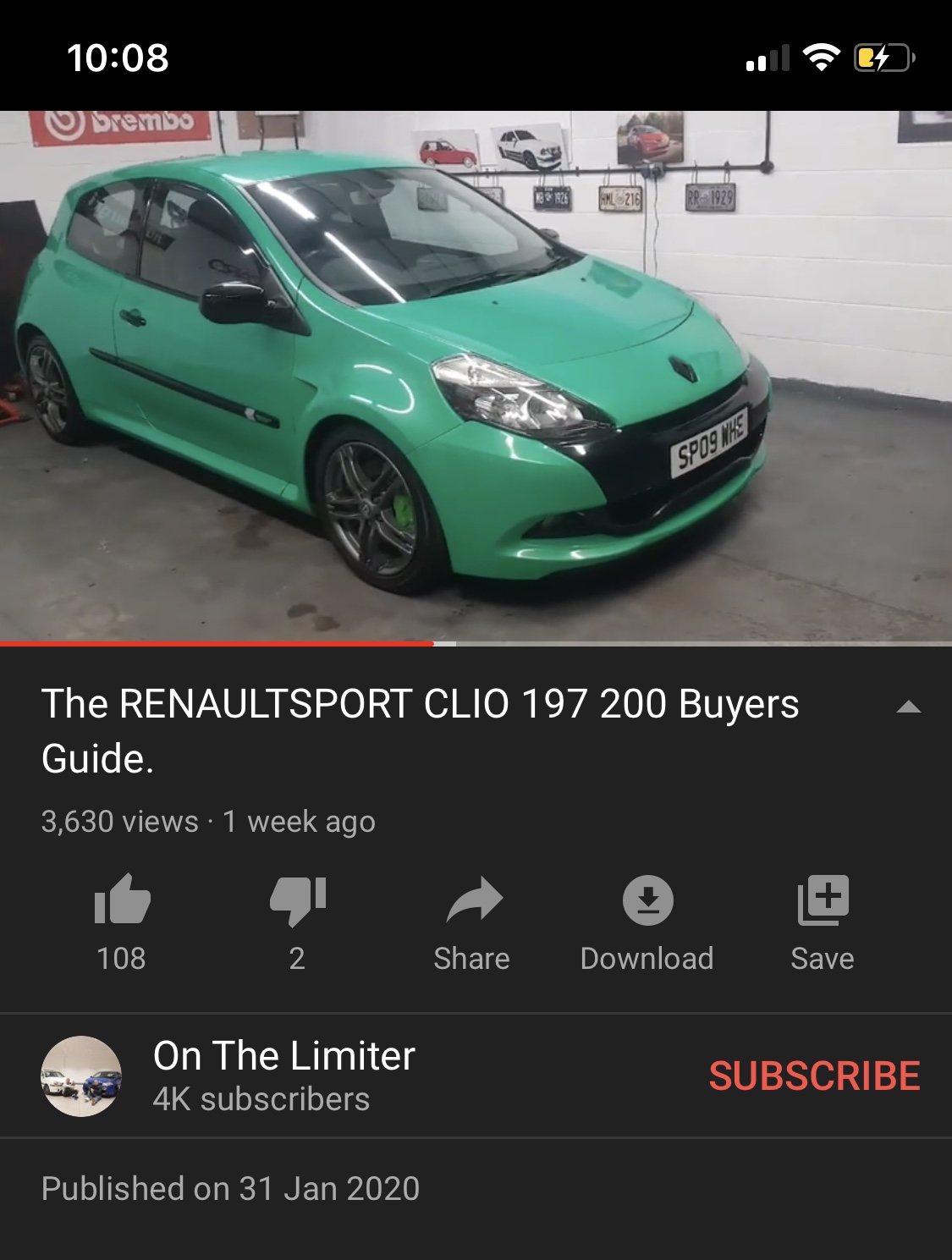

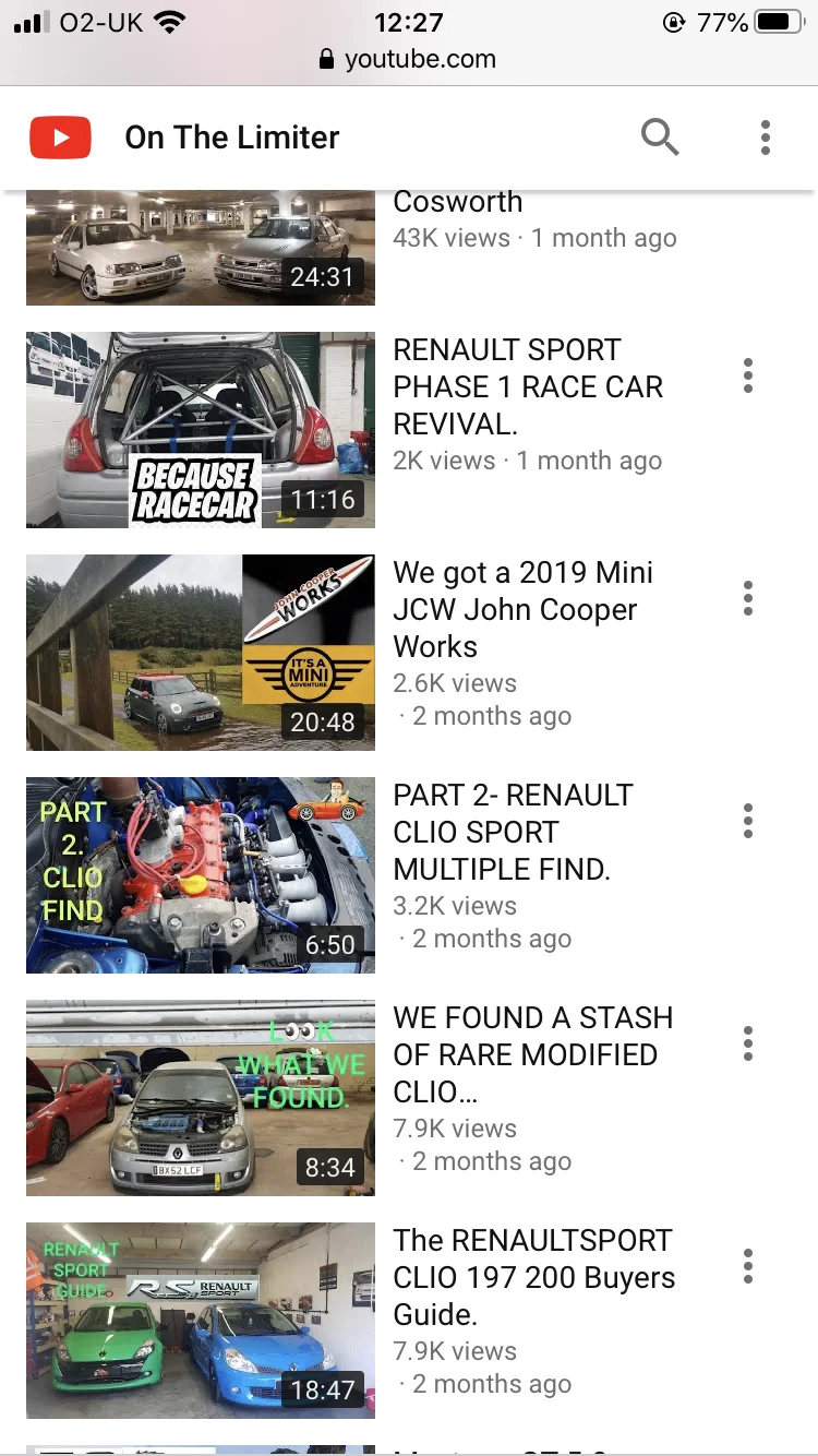

Seen on youtube on a channel - Jan 2020

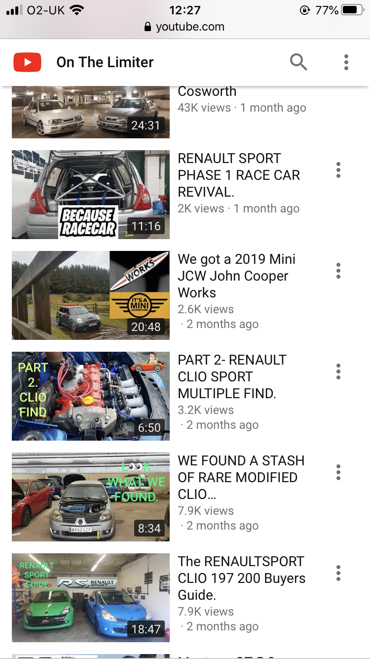

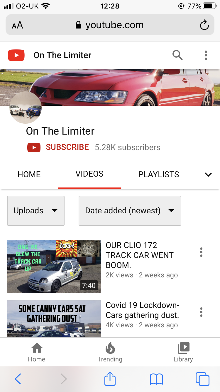

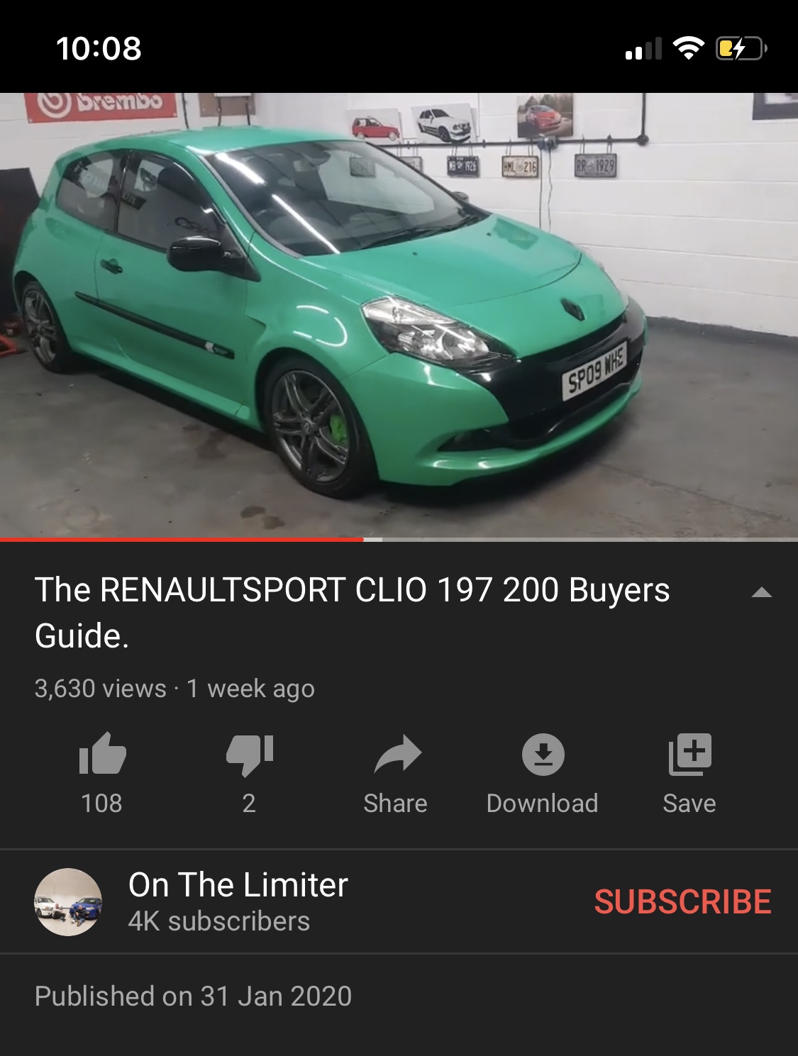

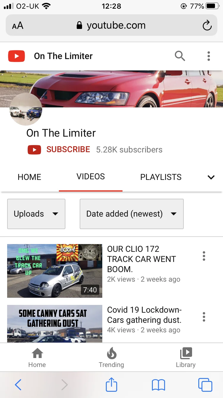

there could be a video of this car Guide on when buying a 197 - 200. I’ve not watched to find out though!
I bought the car from the guy who does those vids.

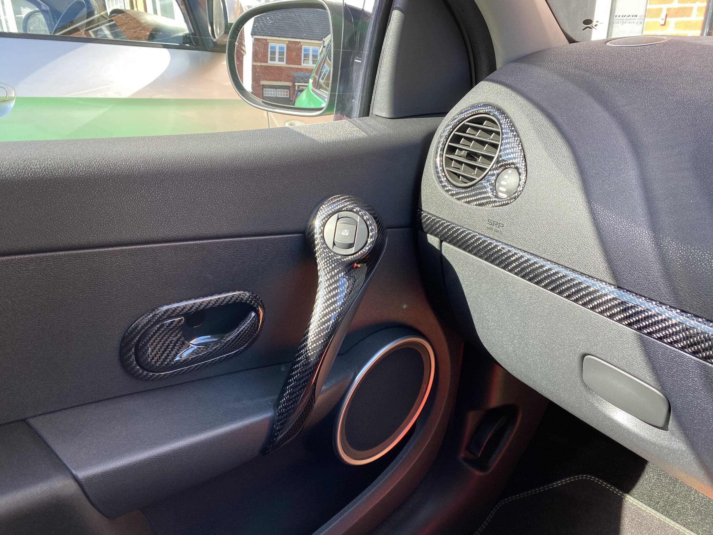

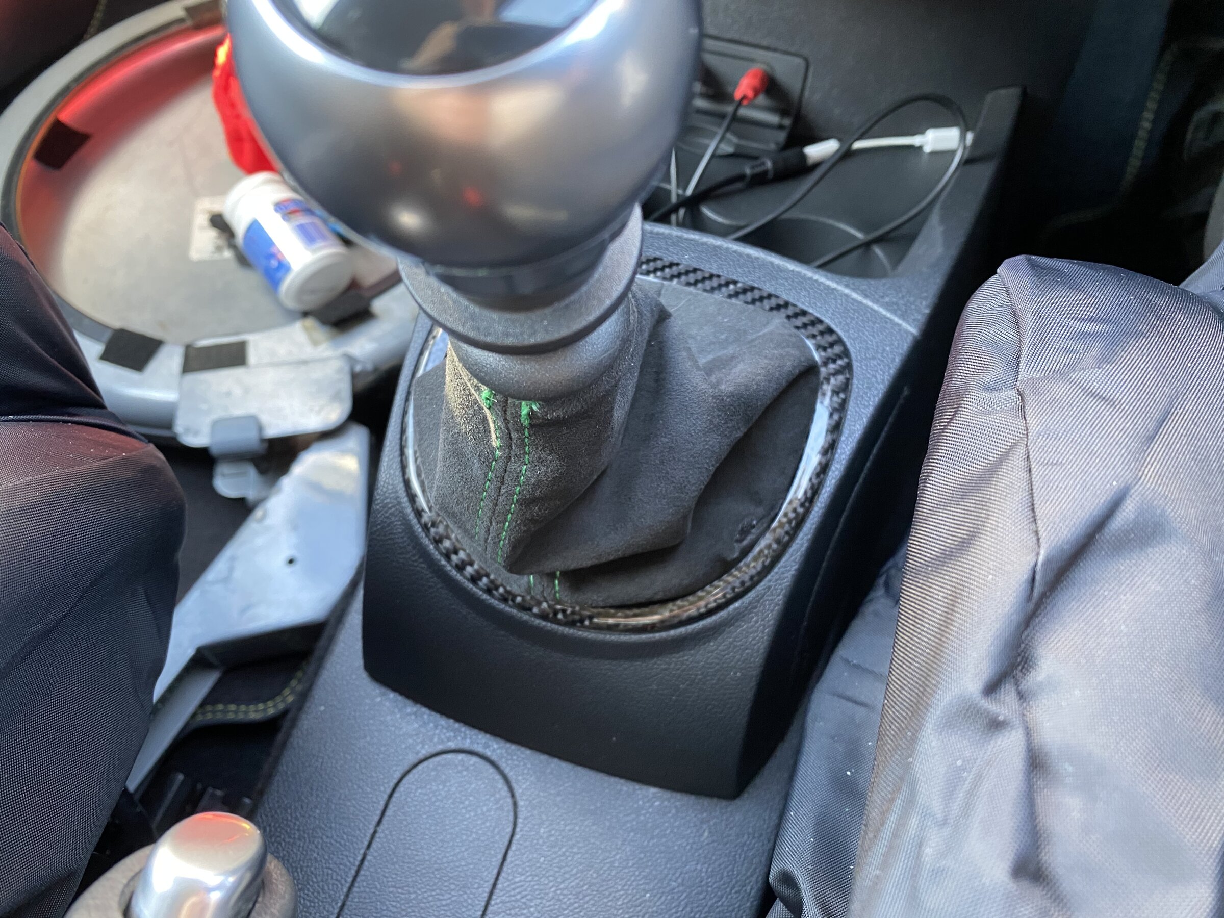

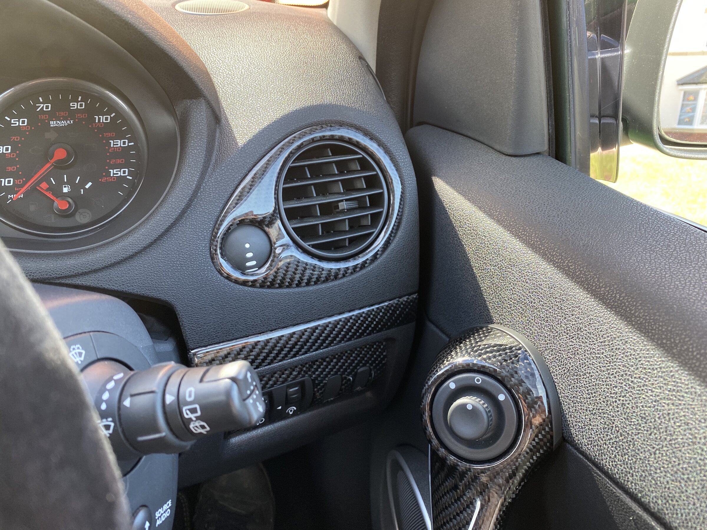

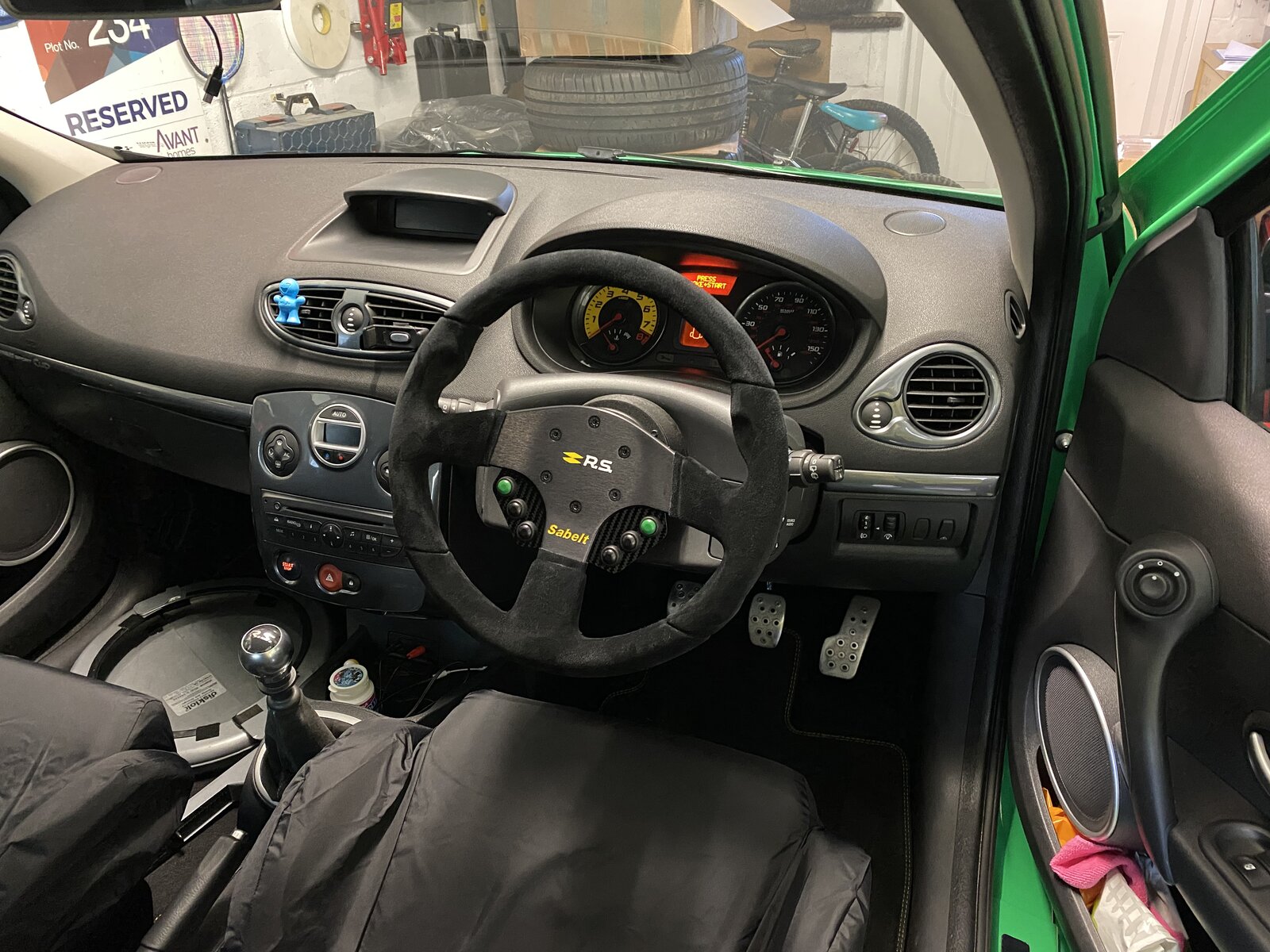

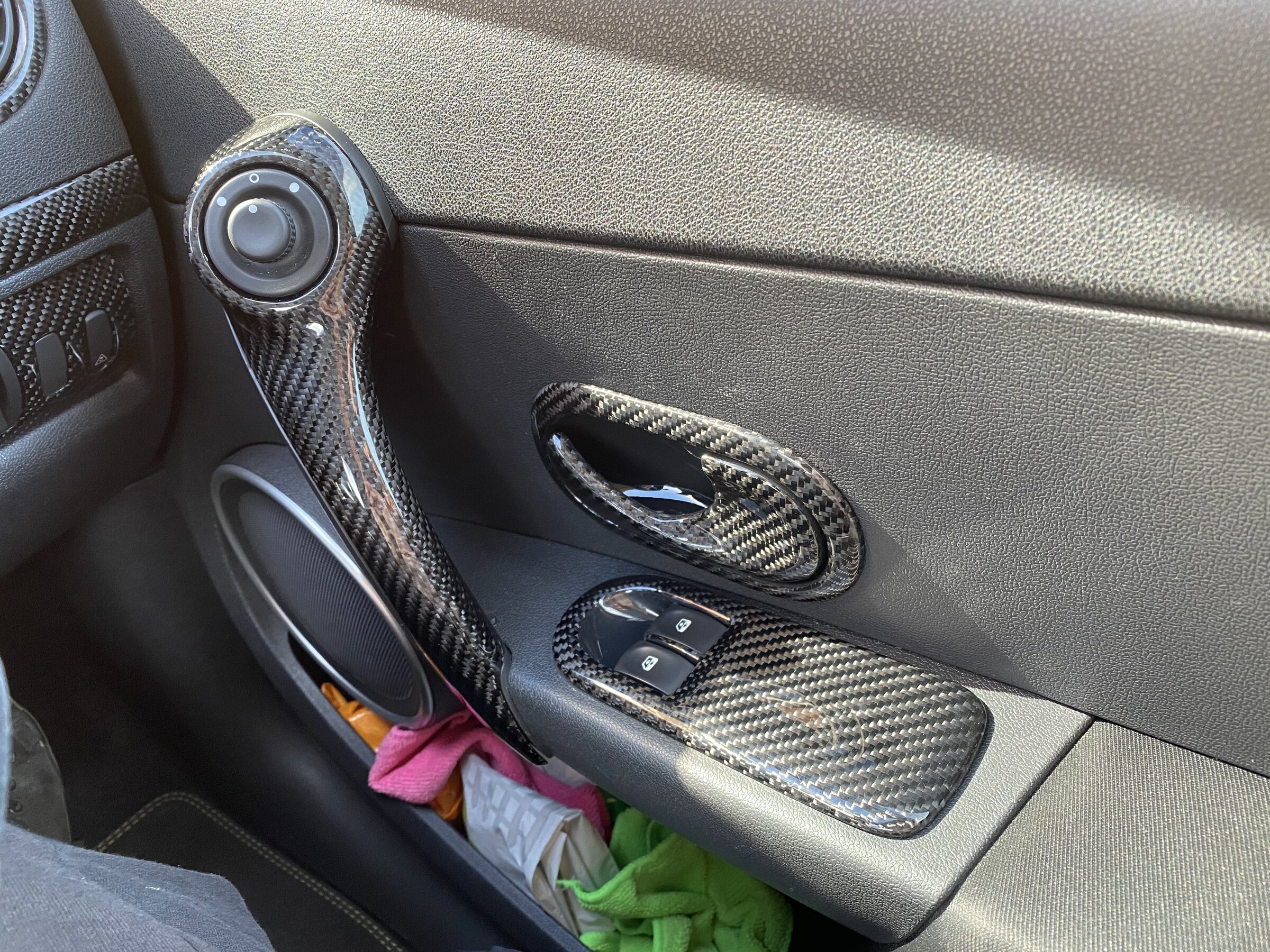

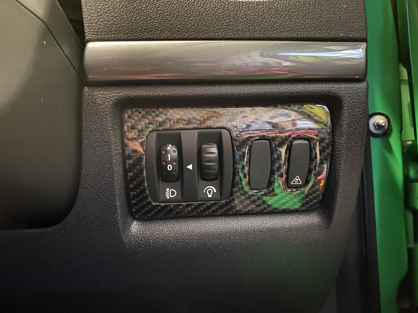

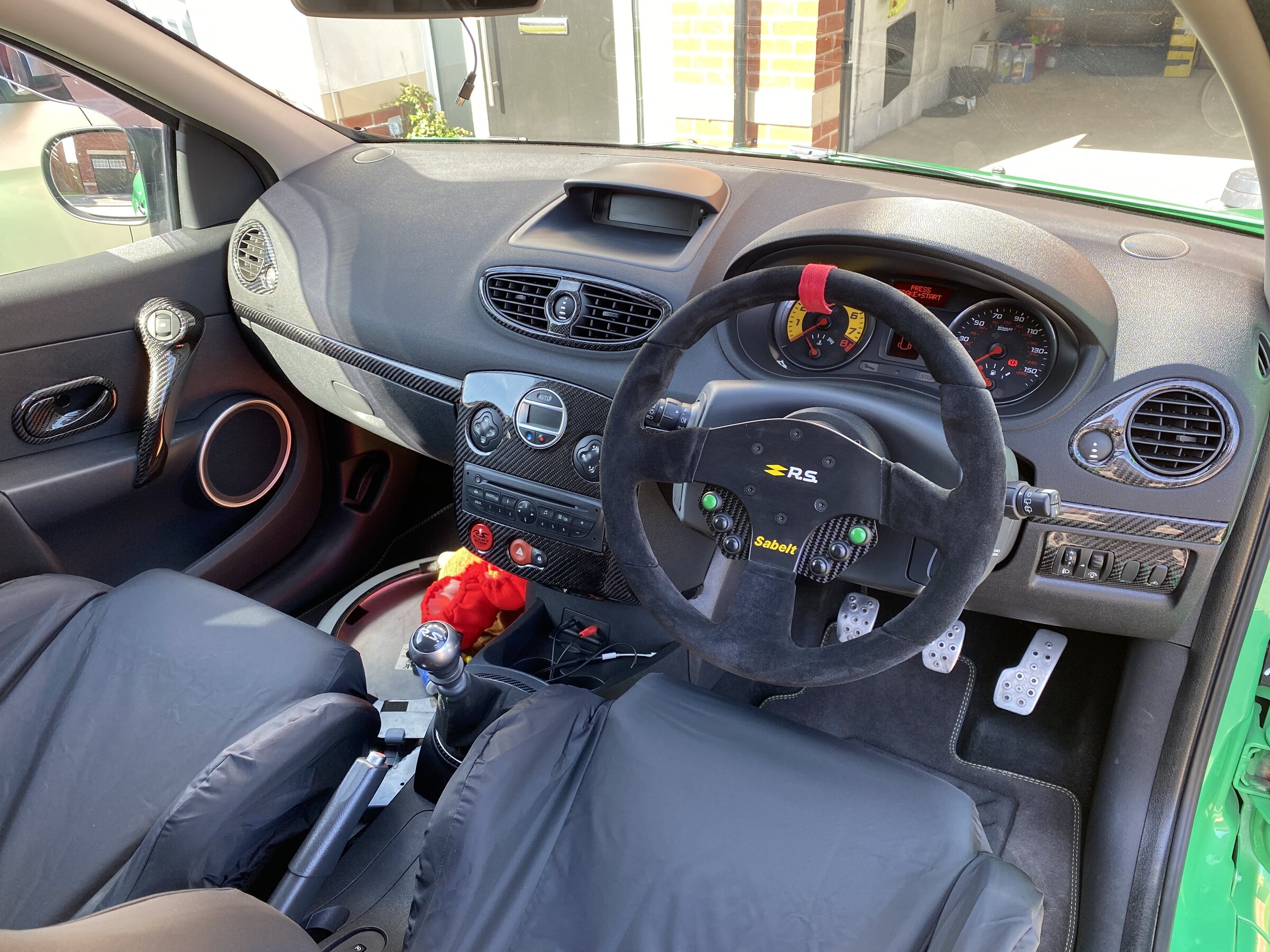

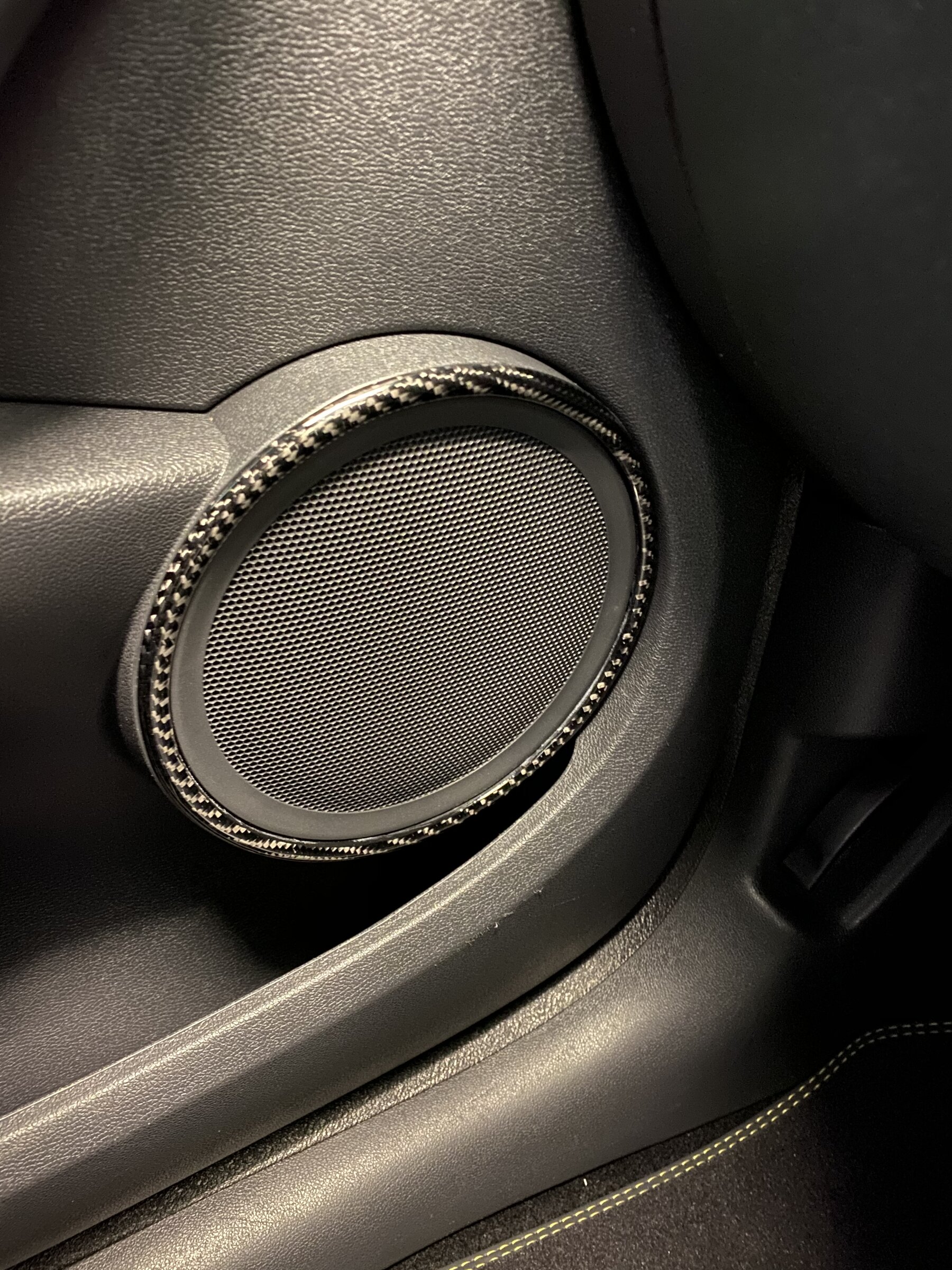

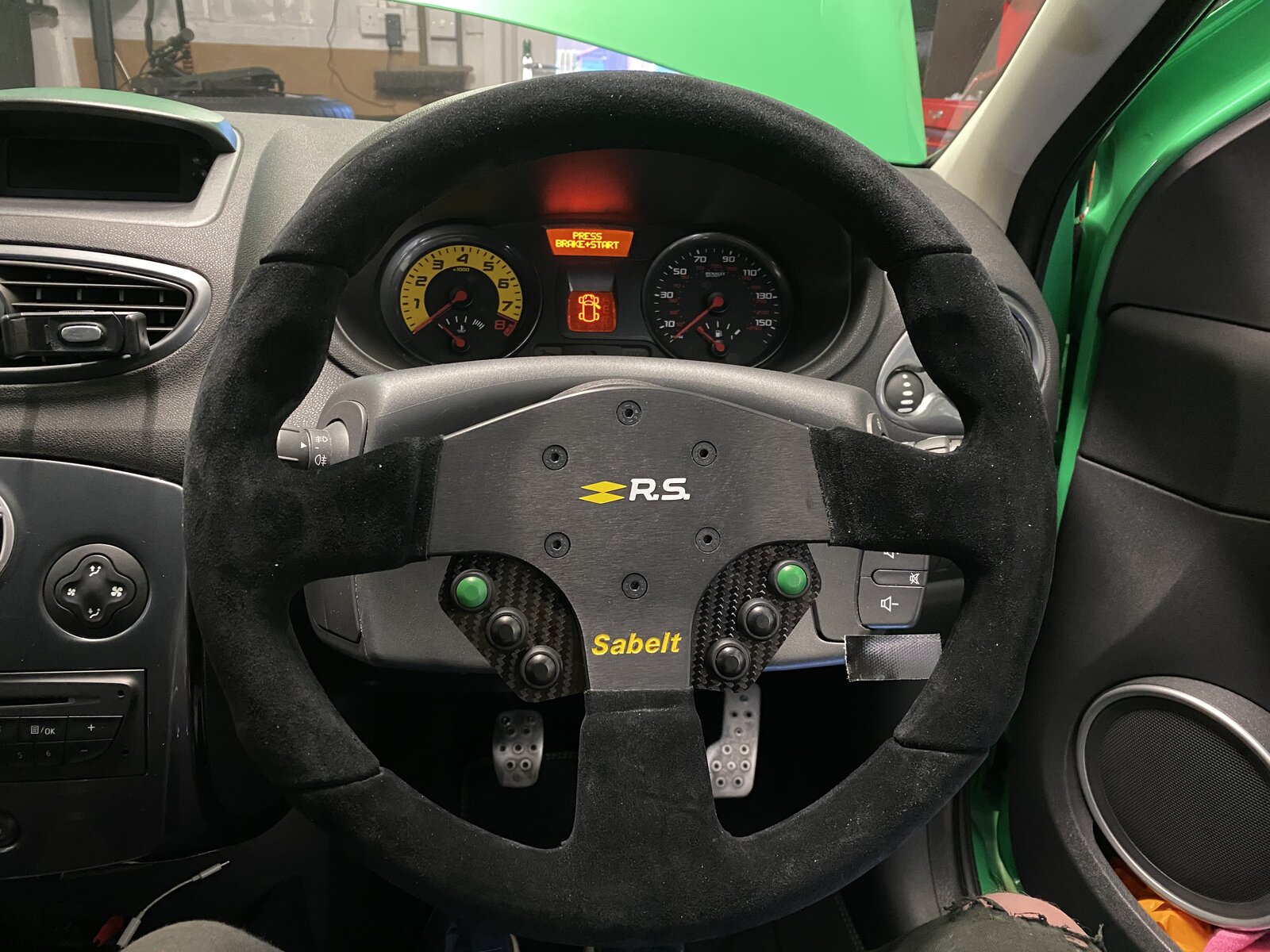

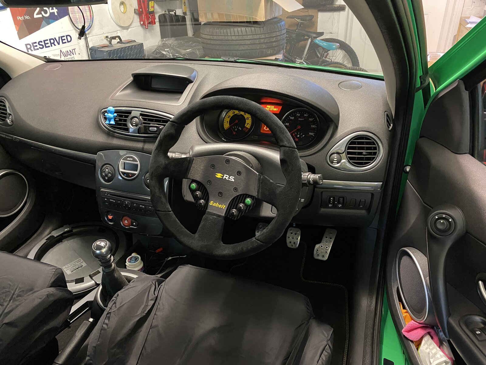

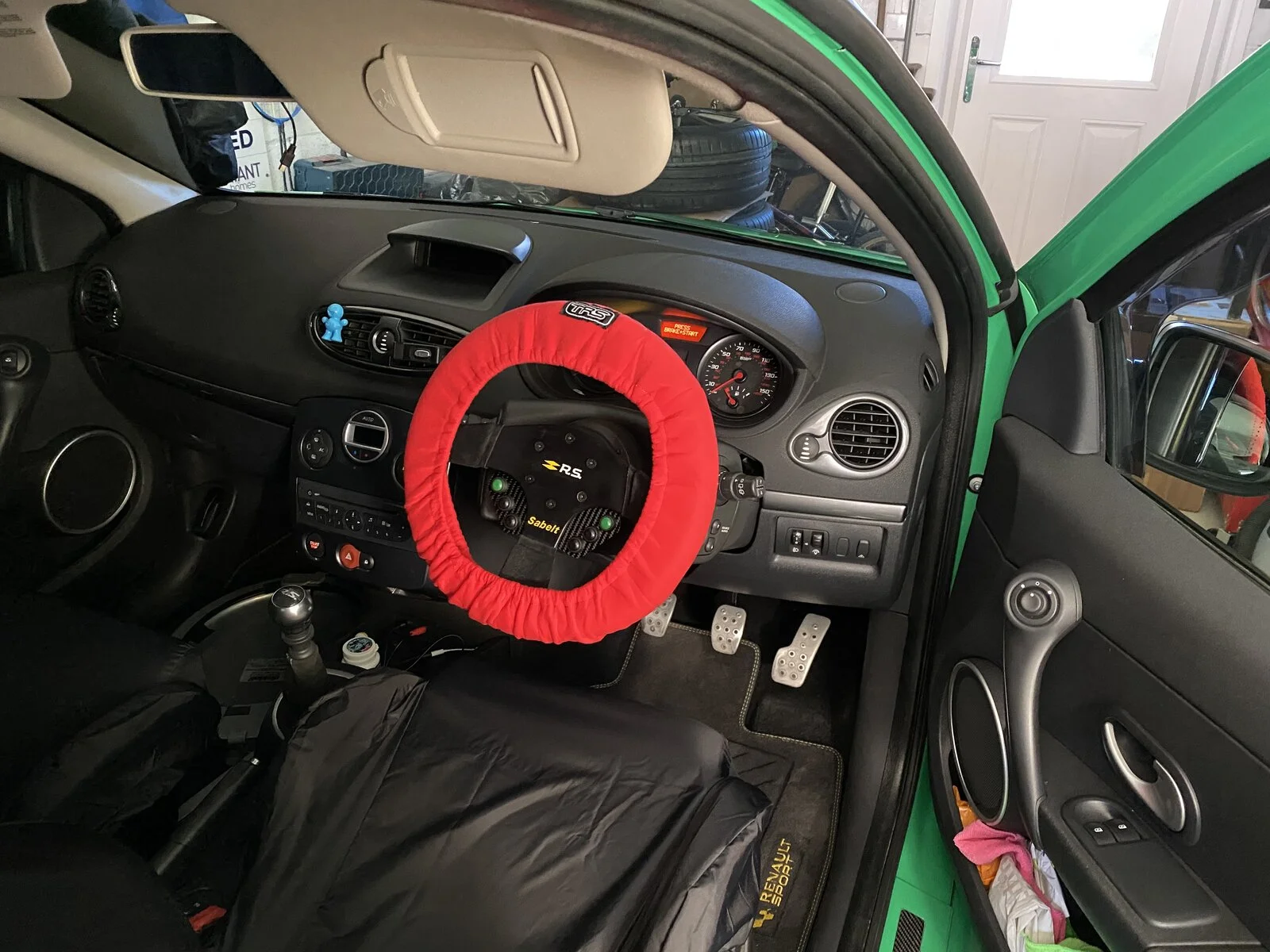

Little heavy on the carbon for my taste, I think I'd put the silver door pulls (bit you pull to open the door) on to break up the doors (with the carbon back/surround) if that makes sense.
I love the gear knob and gaiter though, is that a chop it off job?

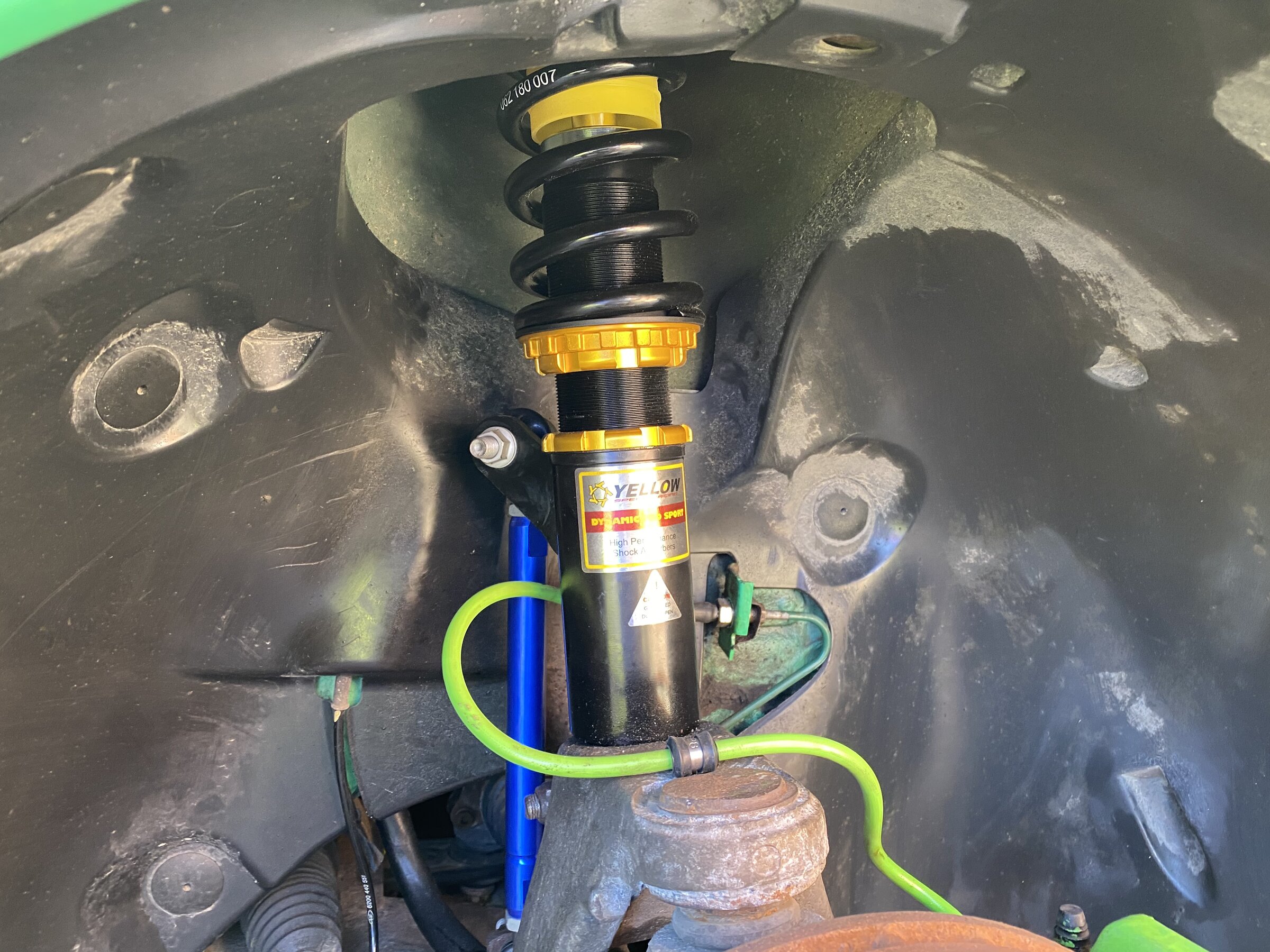

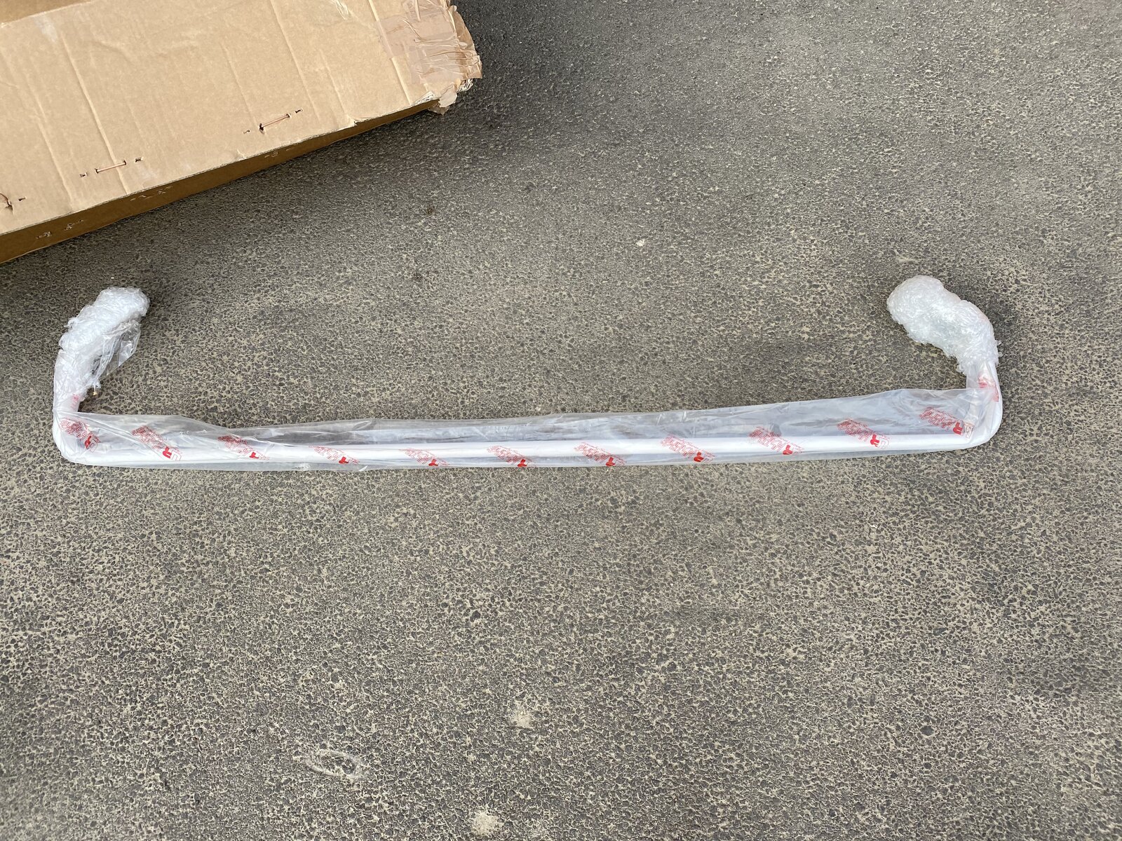

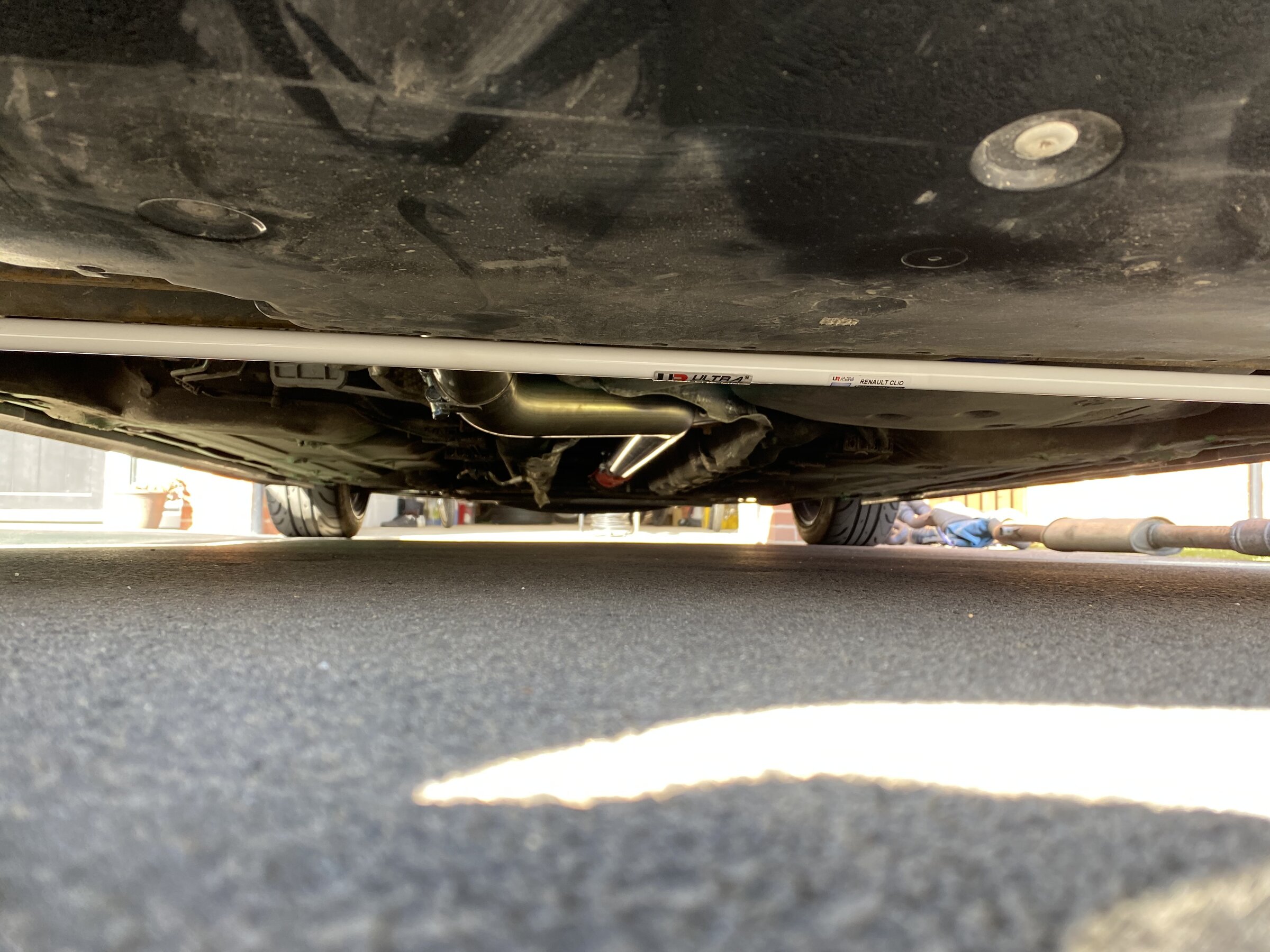

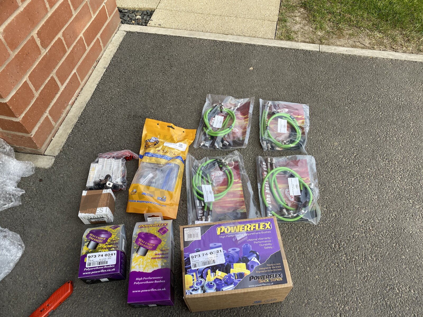

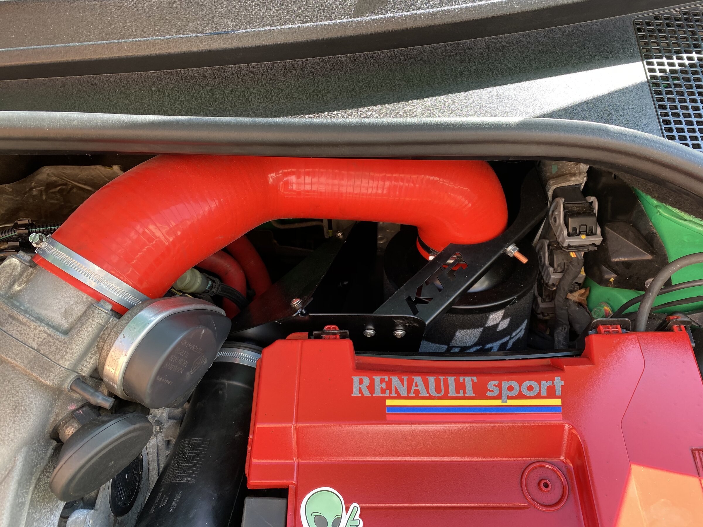

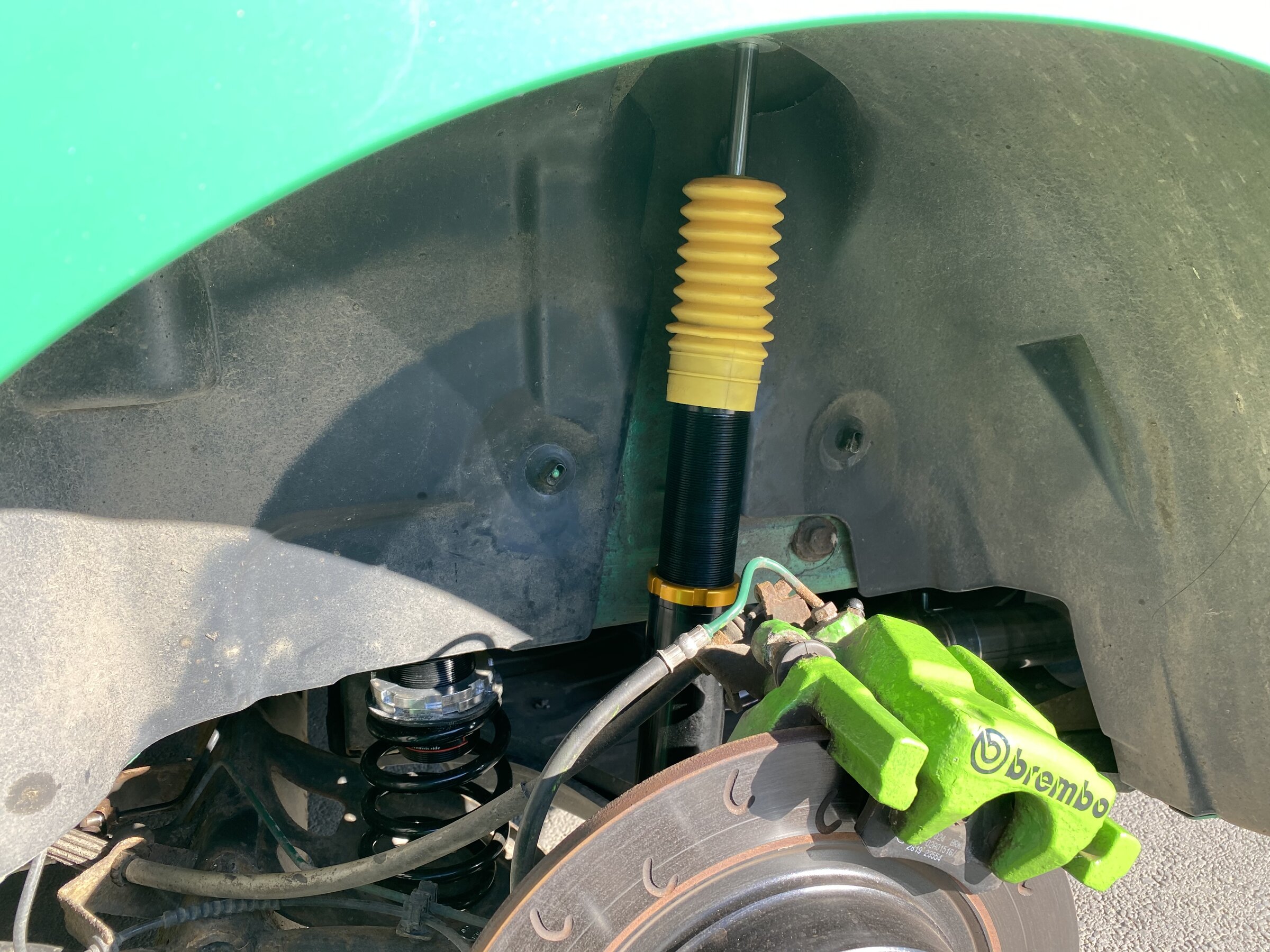

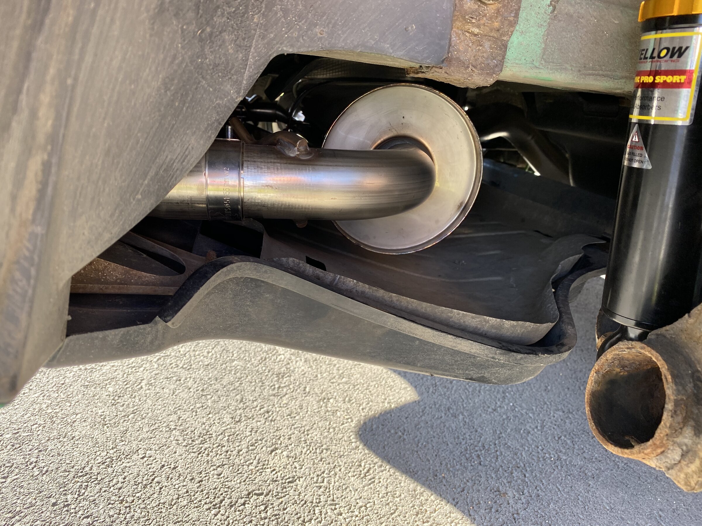

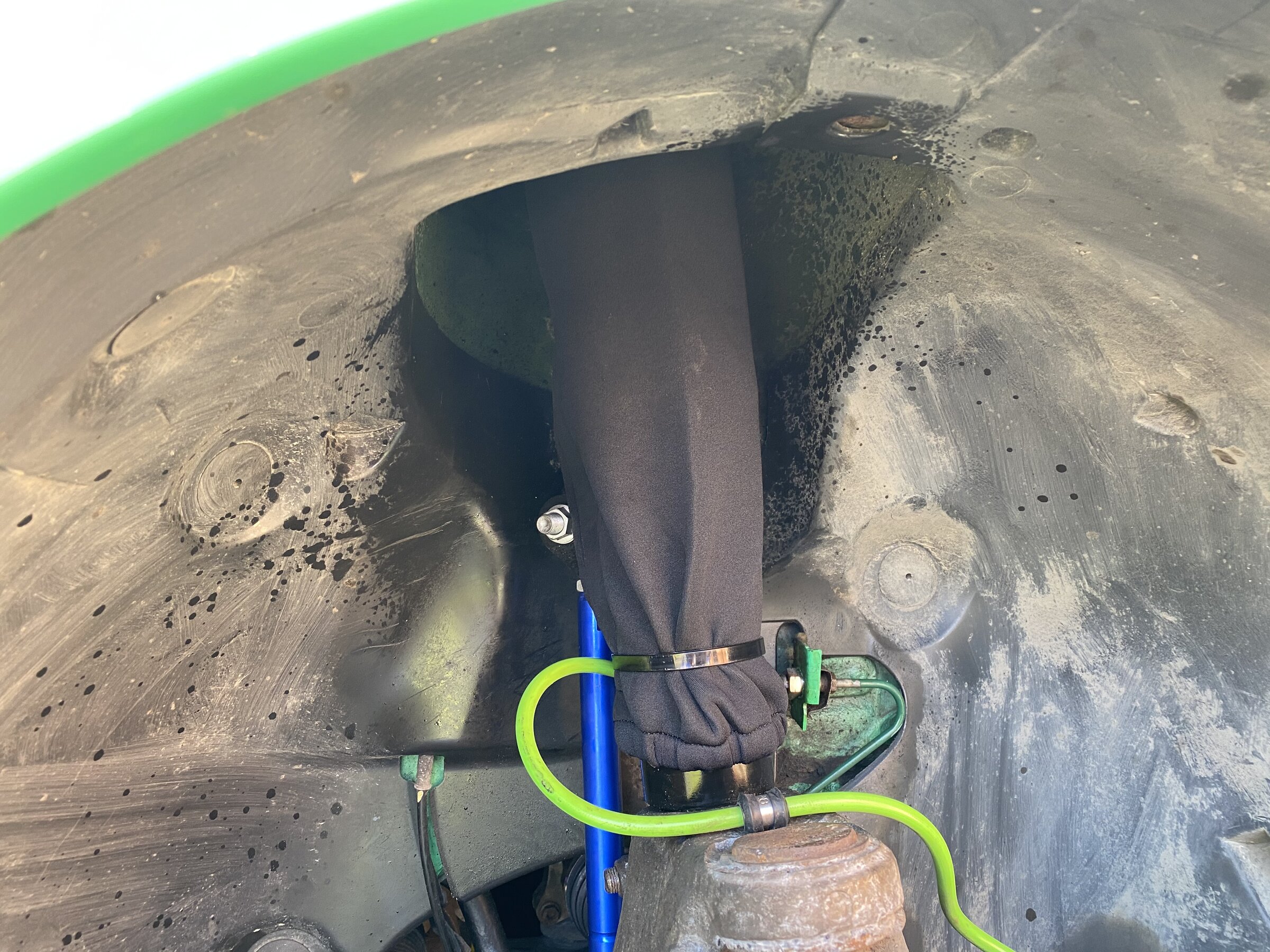

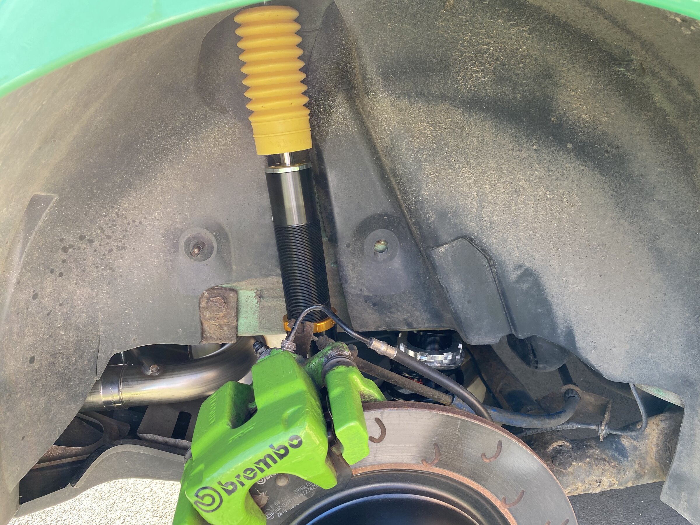

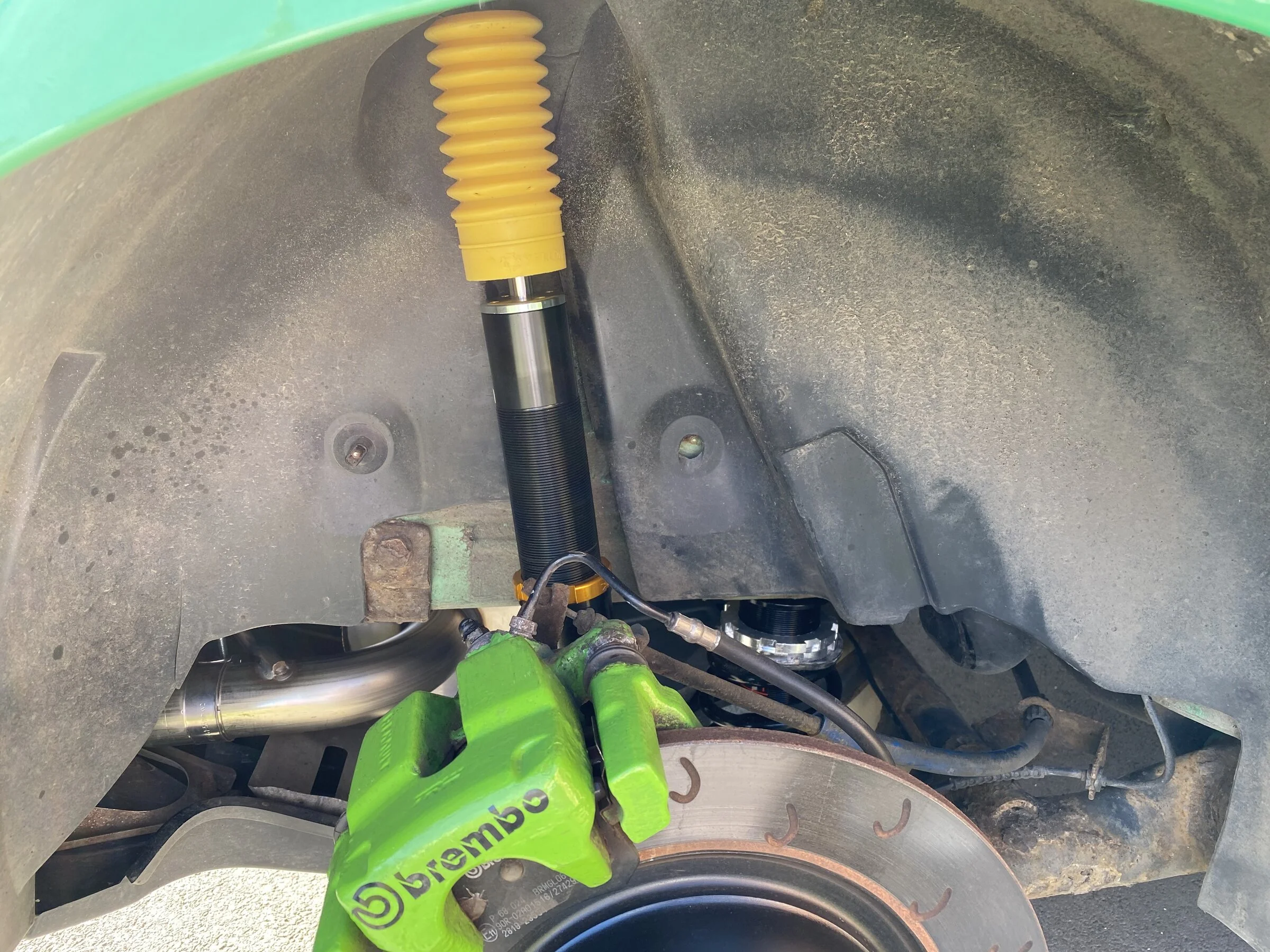

Few new parts now fitted.

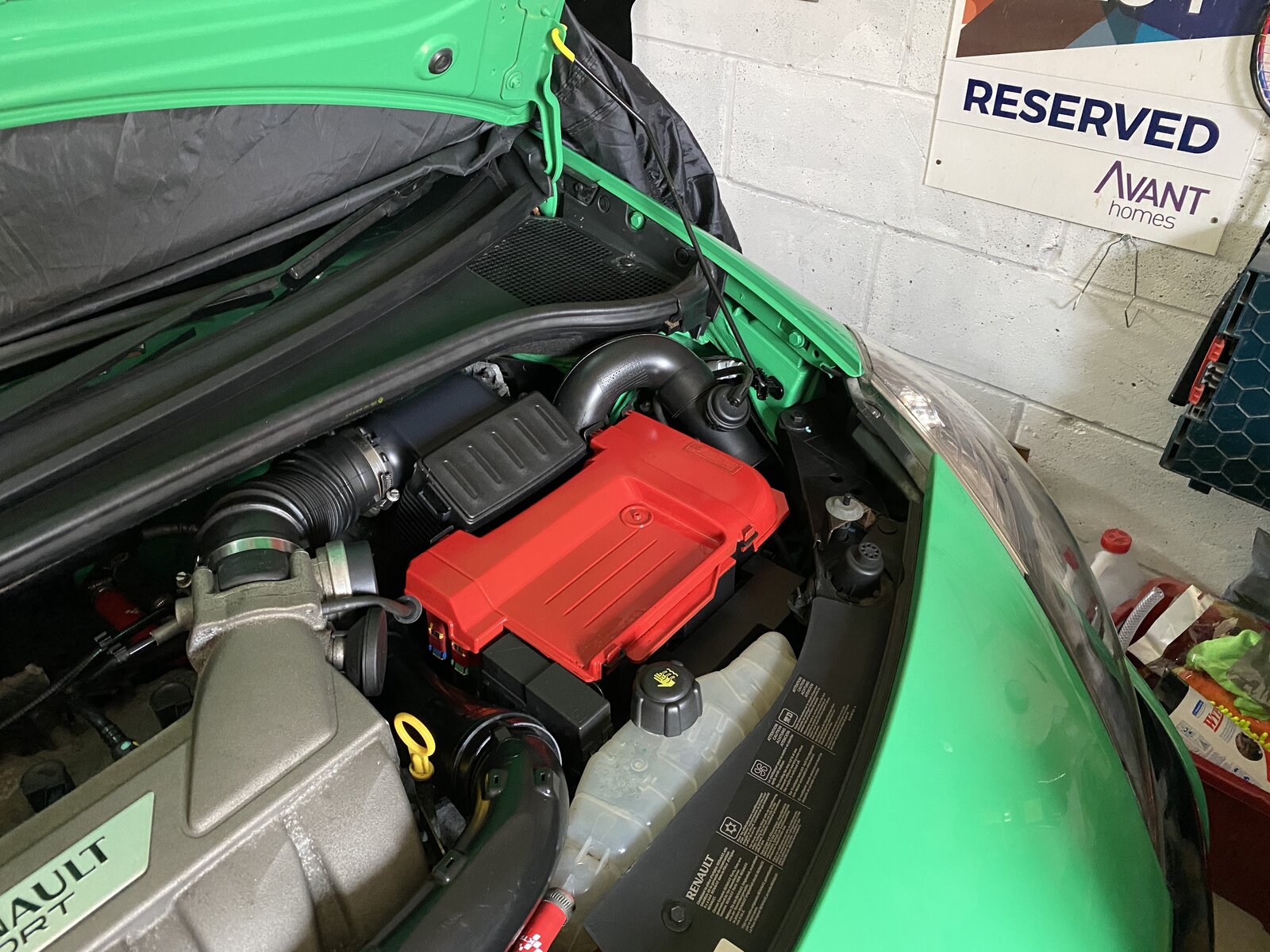

KTR Induction Kit.

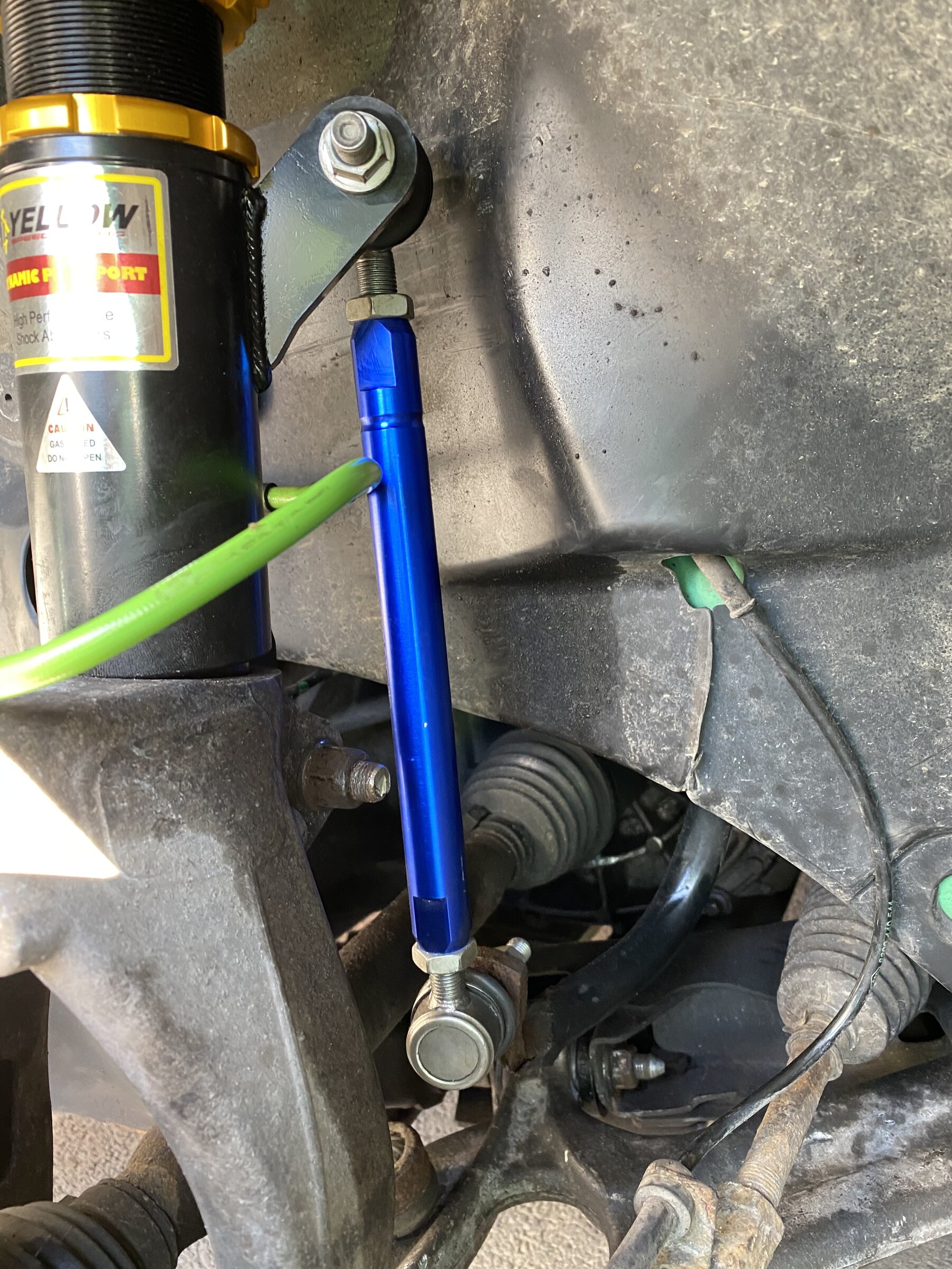

YSR Coilover Kit & HEL Brake Lines.

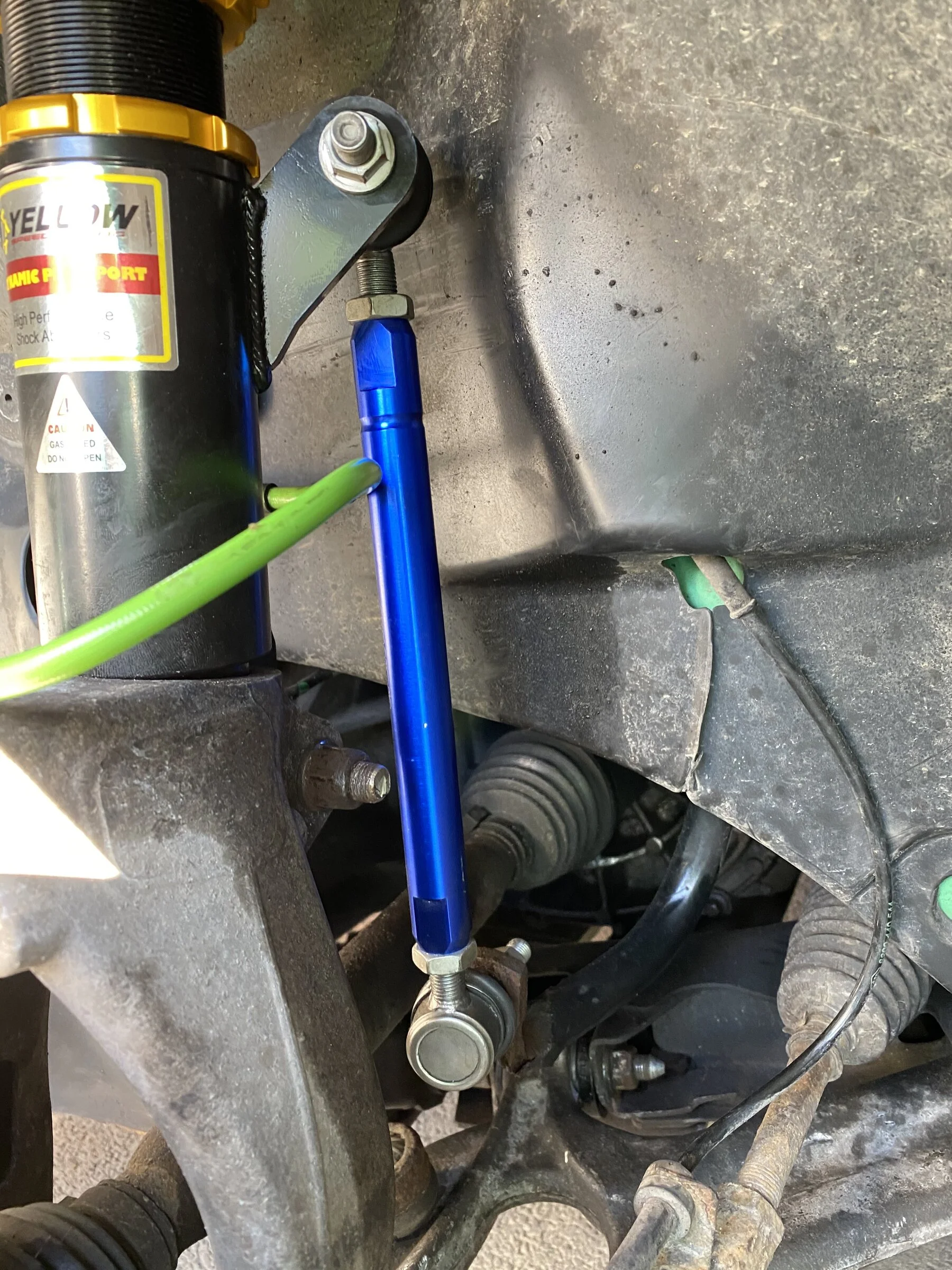

SuperPro Droplinks.
Universal Racing ARB.

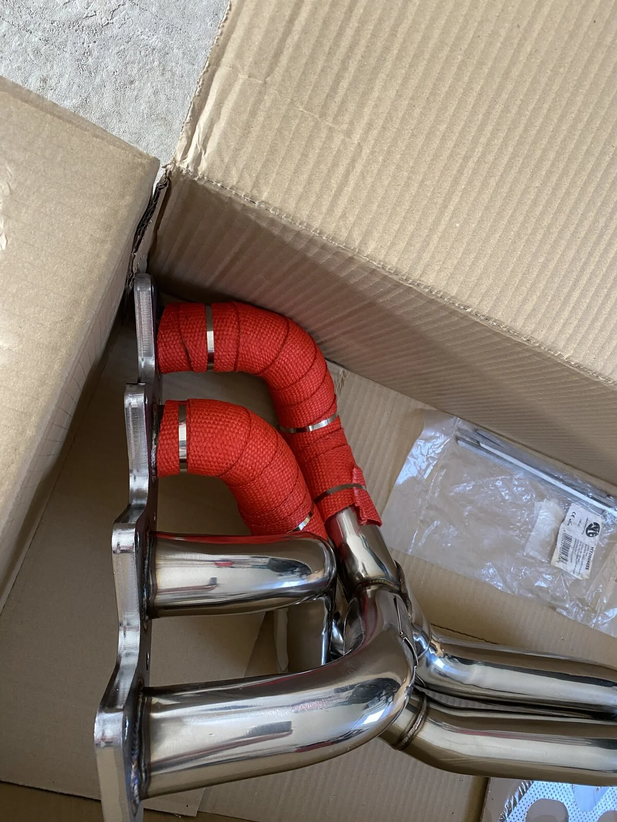

Full Scorpion Exhaust inc De-cat along with Toyo Manifold.
Nice additions. Does it sound half decent now with the manifold etc? They were so muted and dry as standard.
