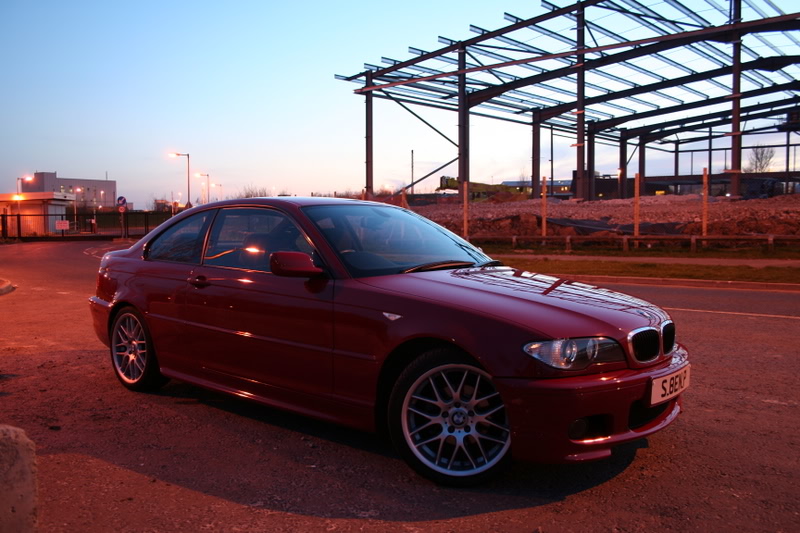

CUT AND POLISH

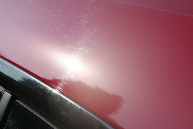

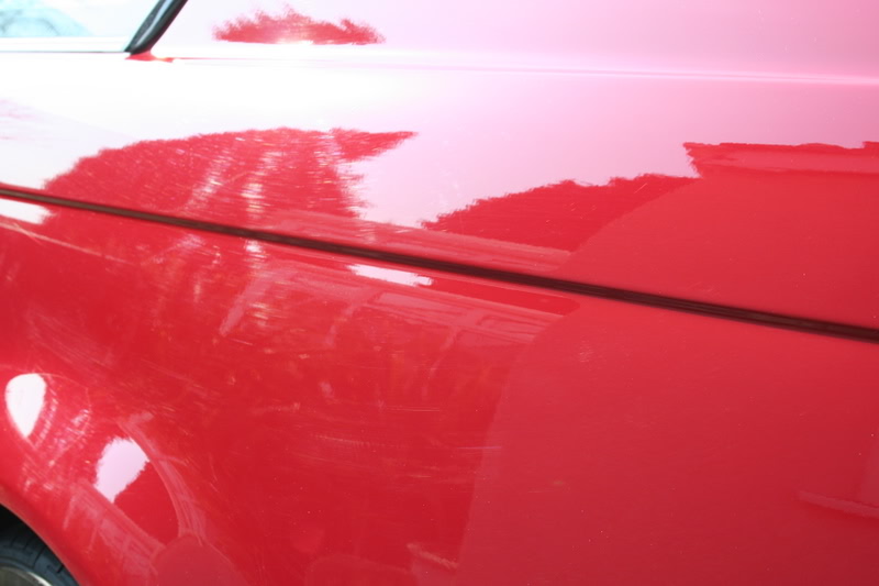

the paint was in poor nick lots of swirls, holograms, dull, flat.... it has been washed in petrol station car wash for most of its life.

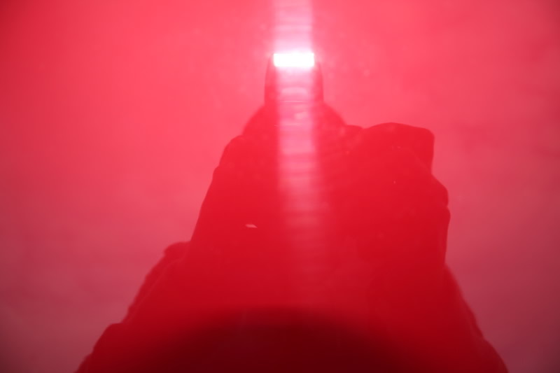

the paint was very very hard, after a few test areas, started with the 91L on a white pad.. no luck, chnaged to a orange pad... still no luck..So got the power gloss out, again on the white pad...removed a small amount, changed to the organge SFX still not much... so out came the LC ccs orange pad. Had to use the slow cut method.. finaly the swirls started to lift out using the power gloss..
process was slow cut on the ccs with the Power Gloss (took forever)
Slow cut with the 91L on a SFX orange
Normaly use with 91L on white SFX pad
2 passes of PO58RD on a white pad (worked for a long time to fully brake down and polish up) << so far this is my faviourt product i have used.
SORRY FOR THE BAD PICS

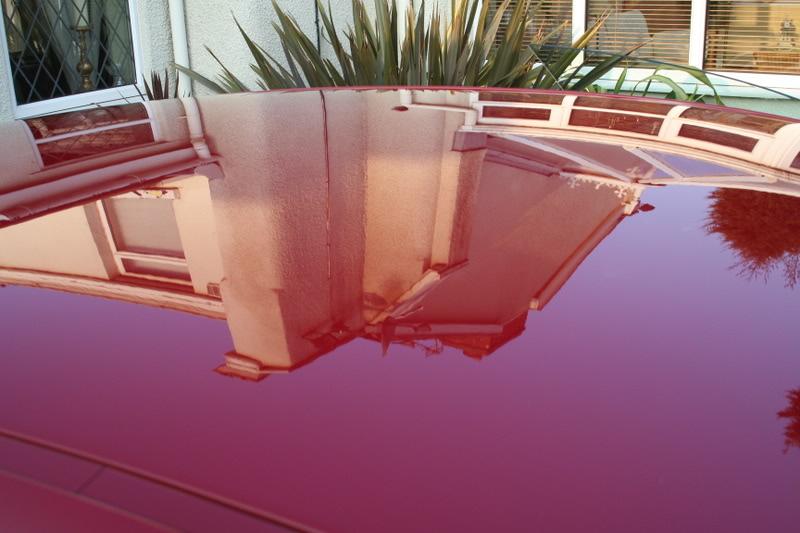

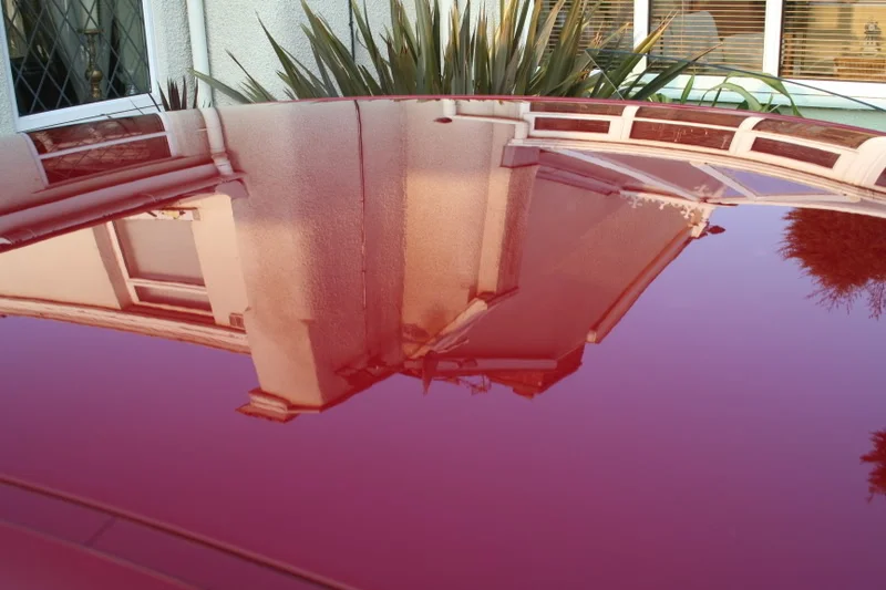

paint before

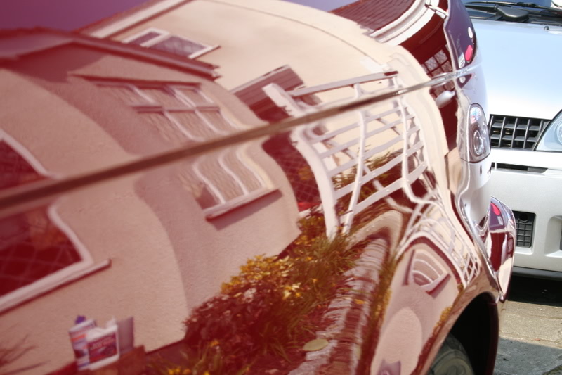

Paint after (26 hours, 3 weekends) LOL
  C63 AMG, F430 & 172

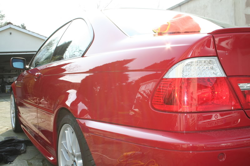

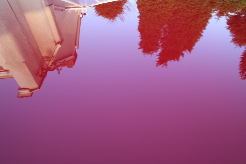

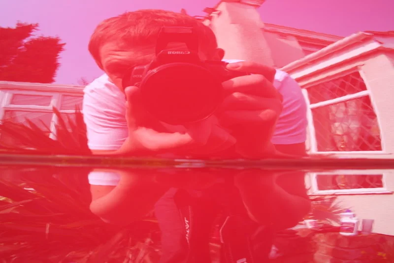

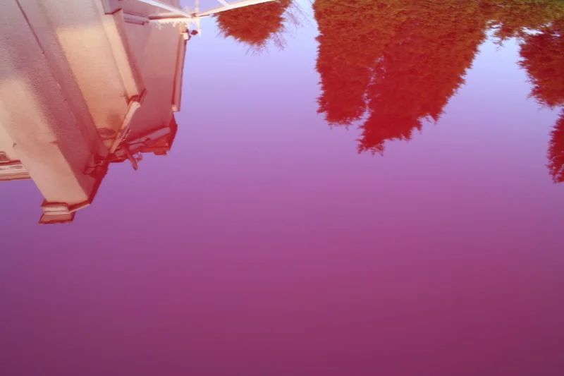

Then i buffed on AG SRP (buffed untill clear)
Three Coats of EGP (3 hour cure time on each)
after the auto glym..

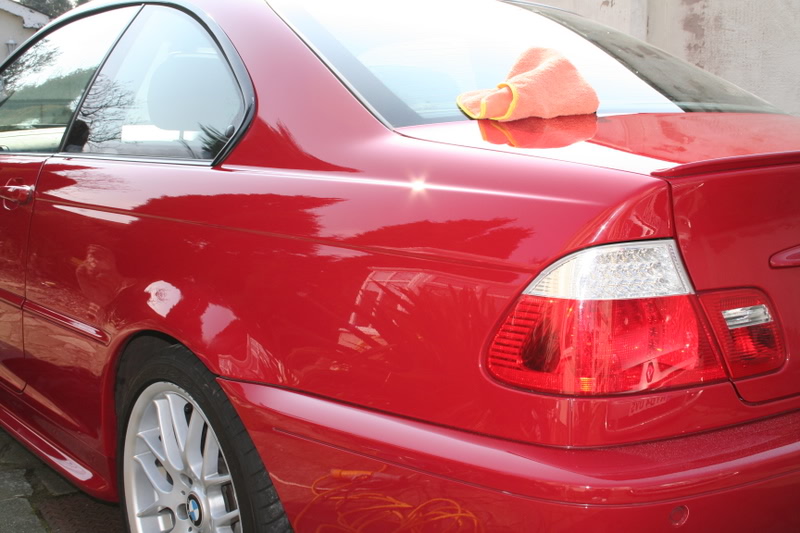

then i got the colinate 647
love this gve really nice depth and strong protection gave the car 4 coats buffed on and off by hand

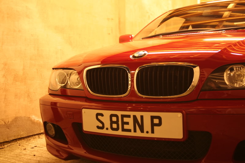

look at the difference
  C63 AMG, F430 & 172
ive a load more pics coming

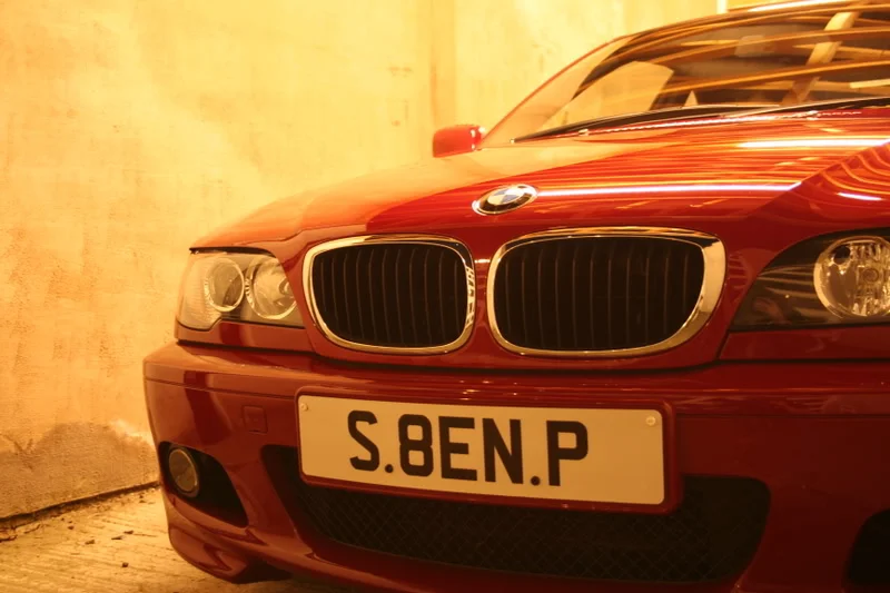

easter weekend i washed agoin and gave some EXP a wirl over the 476 and learnt how to use the new camera lol
looks sweet

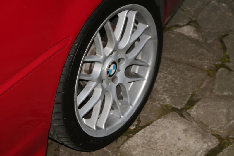

Looks mint mate. What wheels are they? 18" csl lookalikes? And which engine is that?

im getting my wheels refurbed at a place in preston. £25 per wheel!
pep there 18" csl copys m8 :)
