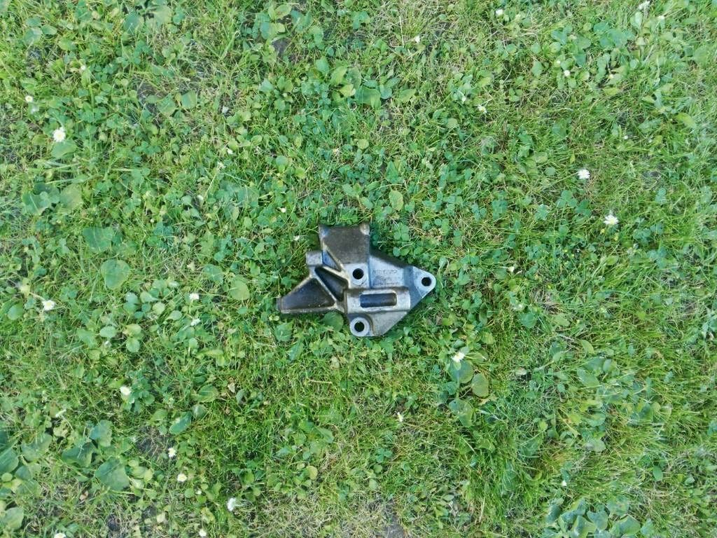

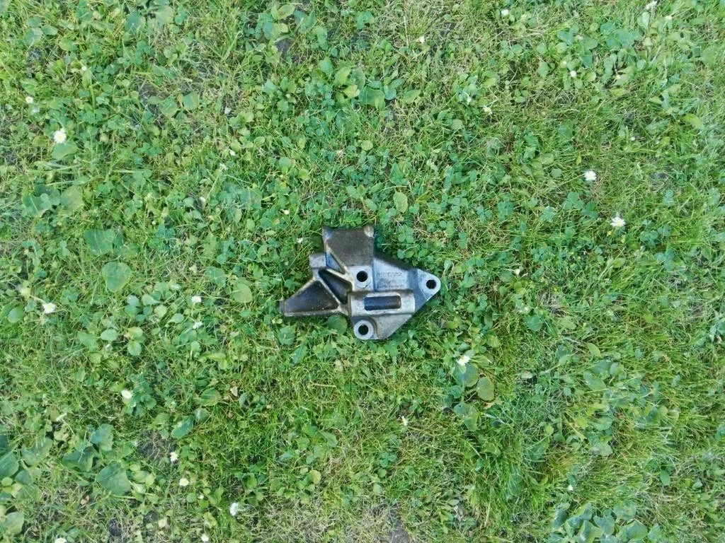

Picking up an old thread, but better than to start a new one on an old subject I suppose. Do any of you think this bracket will fit with this alternator? The add says it is for a Volvo 460/440/480. The bolt pattern seems to look the same.
