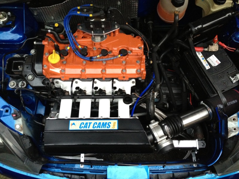

Tom from JMS developed the RS2 intake as part of his degree which did away with both Renault intake manifolds and replaced them with a modified Jenvey manifold and custom made carbon plenum chamber with integrated velocity stacks.
The problem with this was the whole setup was sitting in a confined space which limited the induction length and required uprated engine mounts; he did try a longer system but it meant loosing the slam panel and fitting bonnet latches.
It might be an idea to do something similar to Toms idea but using the standard lower inlet manifold. It would give you more room to work with and be cheaper as there would be no need to buy a new Jenvey manifold and then have it modified to accept the Clio injectors. It would be a lot easier to engineer than playing with induction pipe lengths and you could draw air from the area behind the passenger side headlight the same way the Ktec and RS2 systems do.

All that stuff sounds very similar to what I reading up on when Mike and I had a go at building one.
As James discovered previously! I think a manifold and plenum would offer a lot more scope for final year project. Would be nice to see some alternative designs too.
More info about are manifold in our project thread
  BG182ff,explod Focus
Not too bad Cr33do, how did it work out? I keep intending to try something similar but using the Clio lower inlet manifold like I suggested to Joe but I'm not confident enough in my mechanical engineering to do it.
