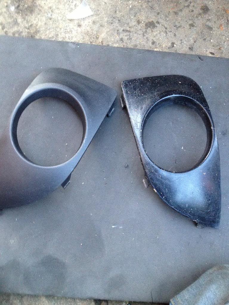

While I couldn't drive my car I did a few jobs that I'd been meaning to do. Refitted front gearbox mount, refitted undertray and a couple of other small bits, including changing the piss poorly painted fog light surrounds for un-painted items.

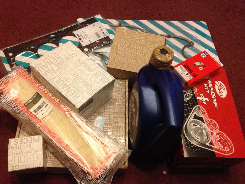

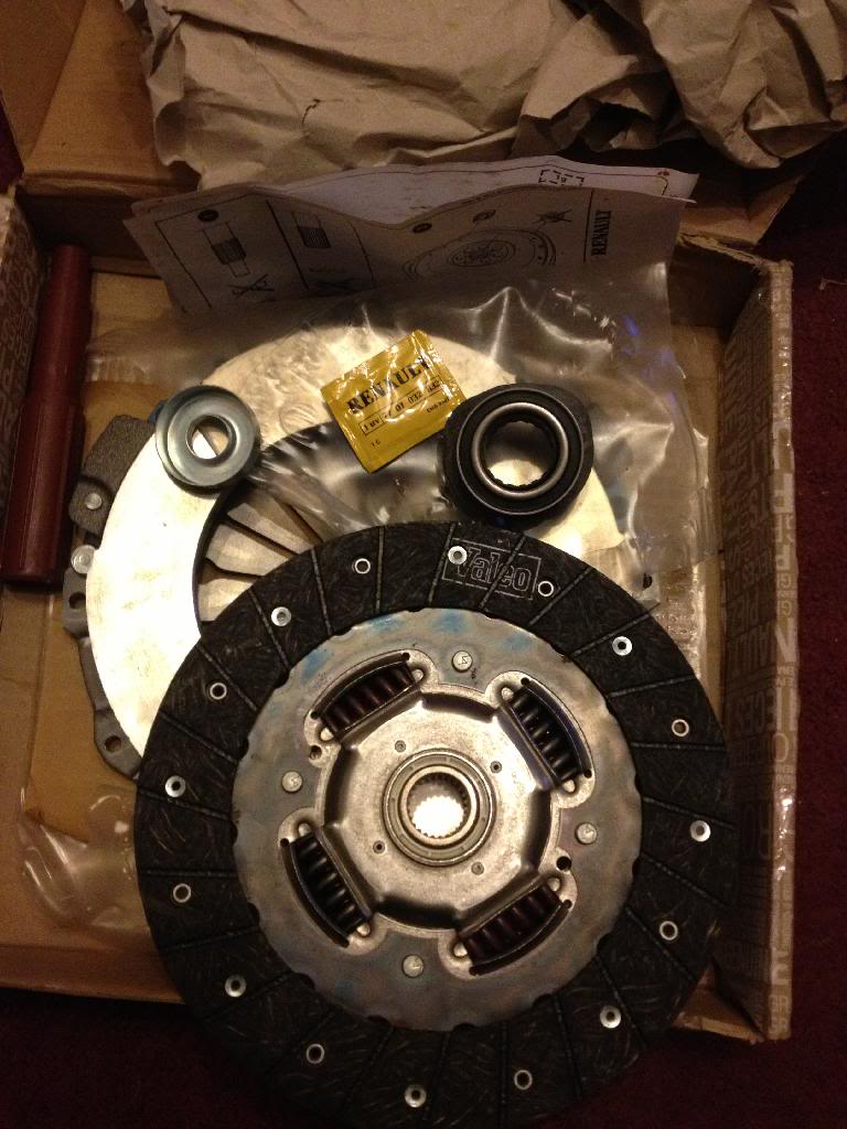

Got a brand new Genuine clutch kit...
Few bits ready for it :D
Hopefully get the engine rebuilt within the next week.
Interesting you go for the Gates Powergrip kit and not the genuine, I have debated the same!
Gates belts are amazing and I wouldn't be surprised if Renault use the same belt from Gates in their kit!
I had heard from Engine Dynamics that the Gates kit now superceed's the OEM Renault one since they use metal bearings for the idler bearings? Tempted to get a Gates kit, but with Adam knocking out genuine kits so cheap it becomes worthwhile sticking with genuine.
I love all these new parts boxes lol, can't beat getting an old car and amassing loads of shiny new boxed items (its my fetish, you should see my car audio stash lol).
Looking forward to the rest of your thread Alex...
P.s - I'm half tempted to sling up a picture of my last Turkish restaurant take out (maybe it will drive the appetite in you lol)
On sports I normally go for genuine due to price (and the fact everybody loves genuine!!), but on this DCi, the genuine kit was a lot more than I could get a Gates kit for, Plus it includes a water pump (good quality too!). I still got lots of other bits from Adam at Wolvo though.
Gates make the Genuine Renault kits, I believe even the genuine kits now have mostly metal inners (can clearly see this on the lower idler), Both the gen kit from adam incs the end caps, and the gates kits do too, so its very tit for tat.

Instructions on the gates kits are good, autodata.

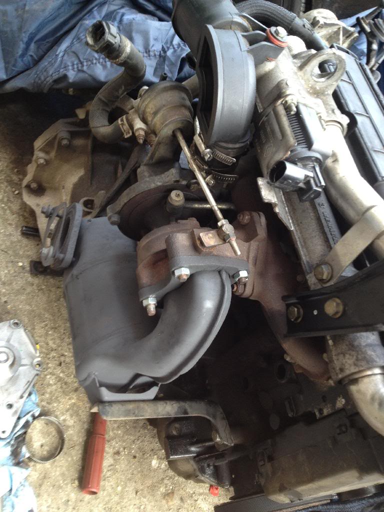

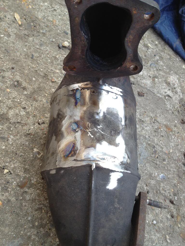

Firstly, Made a decat for the Black DCi, cut open, smashed out, welded back up. I fixed the little pinprick holes in this picture of course. Painted in BBQ paint after photo.

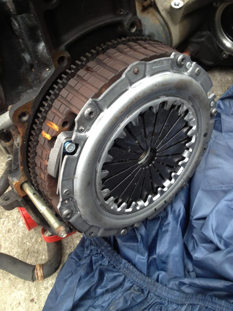

Got the new clutch fitted

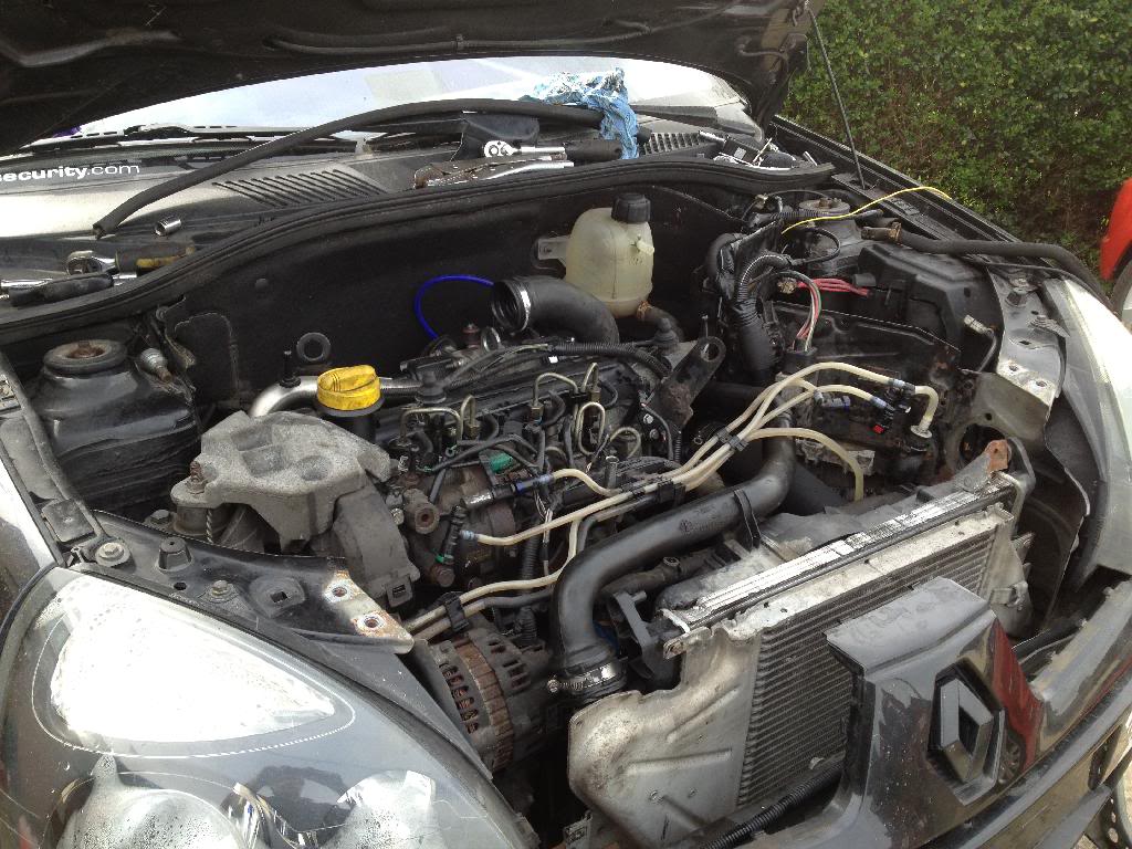

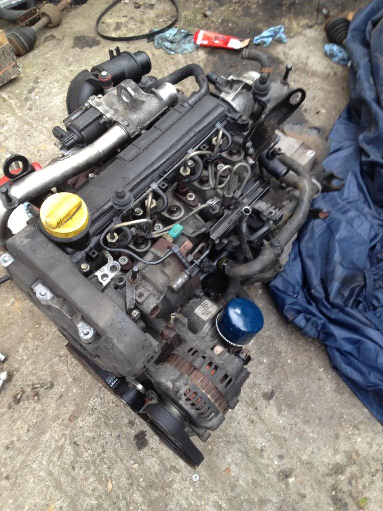

Then something I didn't really get any pics of, but It had a new conrod, new rings, (Bores honed and measured), new big end bearings, new sump gasket, then head gasket (after cleaning the block and head throughly), New Gates cambelt kit, new water pump, genuine filter, New aux belt kit, probably lots of other stuff. Bolted it all up and got this...
Inc decat (new nuts used)

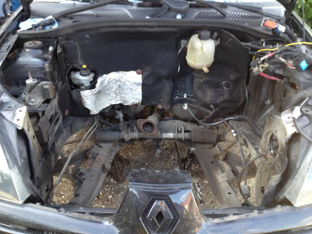

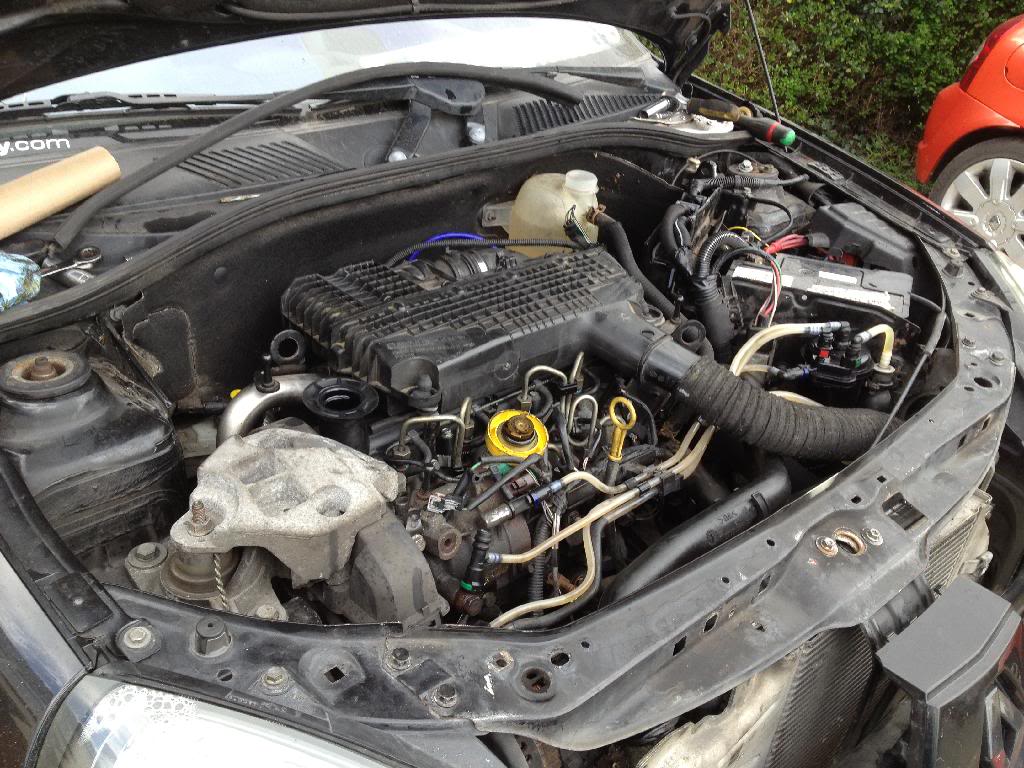

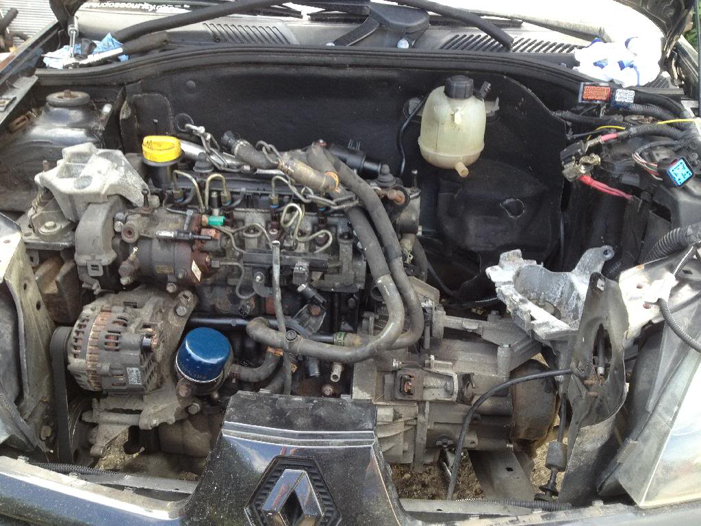

Then this morning started off with a bay like this...

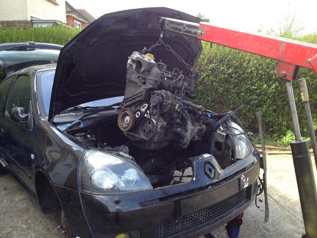

Borrowed my mates engine hoist again
and in

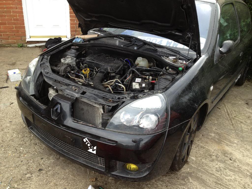

Few more bits on, getting there.

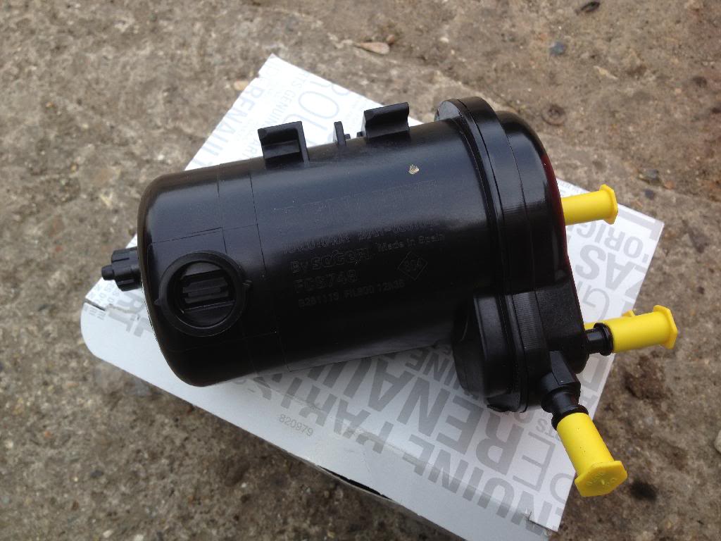

New genuine filters
Mostly there now
Then, span it over to build oil pressure (important for a fresh build), before putting the glow plugs back in, connecting up the injectors and firing it up.
I'll admit it didn't fire up straight away, took some easystart to get it fired up the first time, but after the first time, it fired up perfectly after that, ran like a bag of s**t for a couple of mins but cleared and now runs 100% spot on.

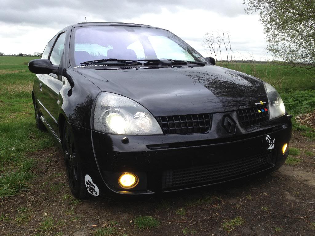

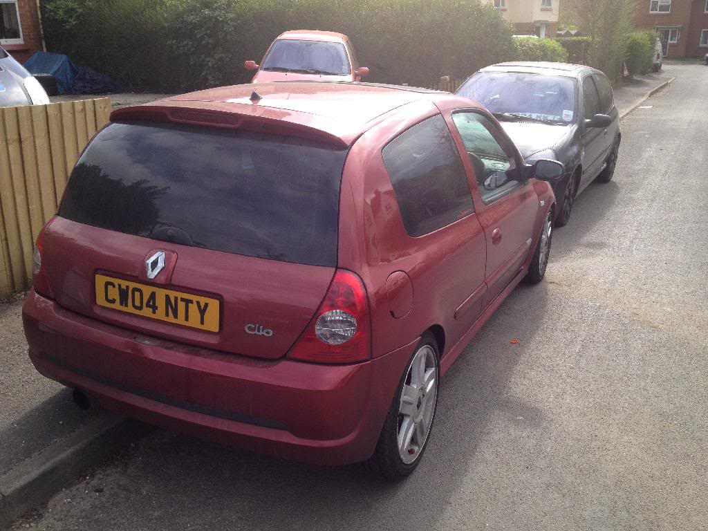

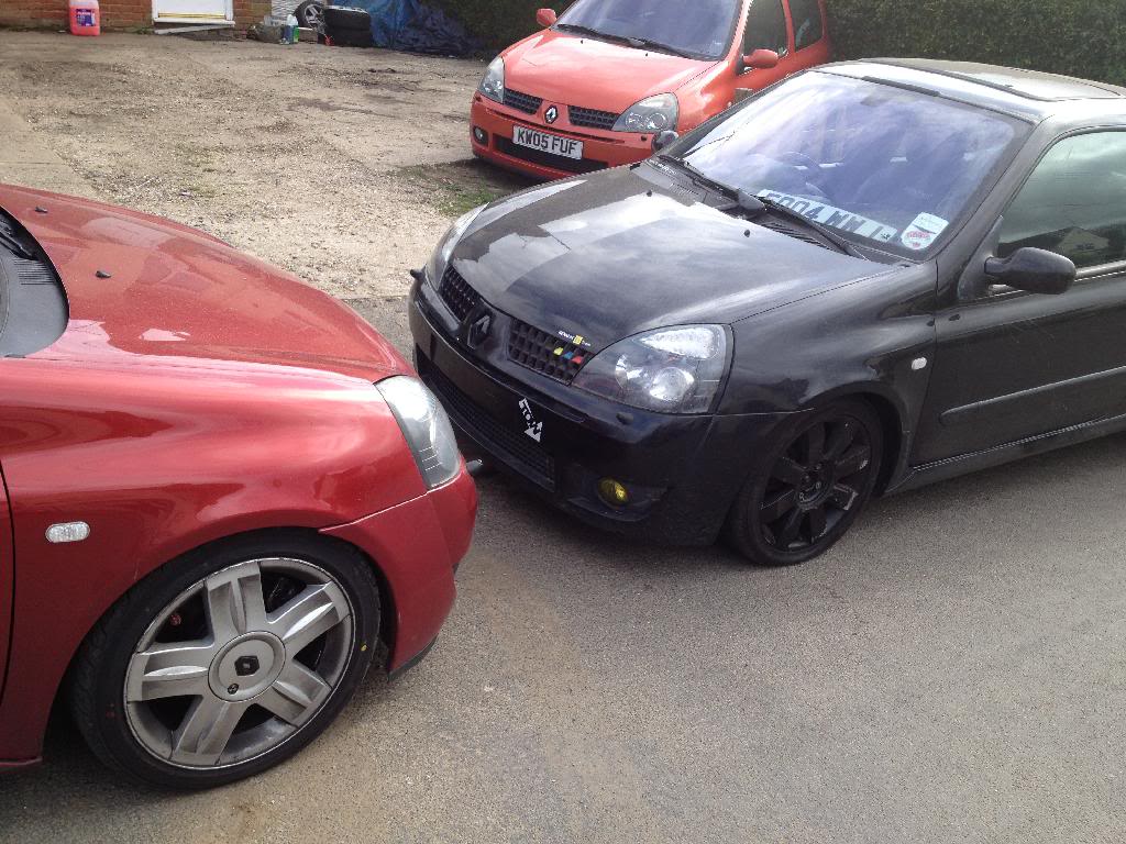

So got some pictures of my Two Clio DCi Sport reps :P

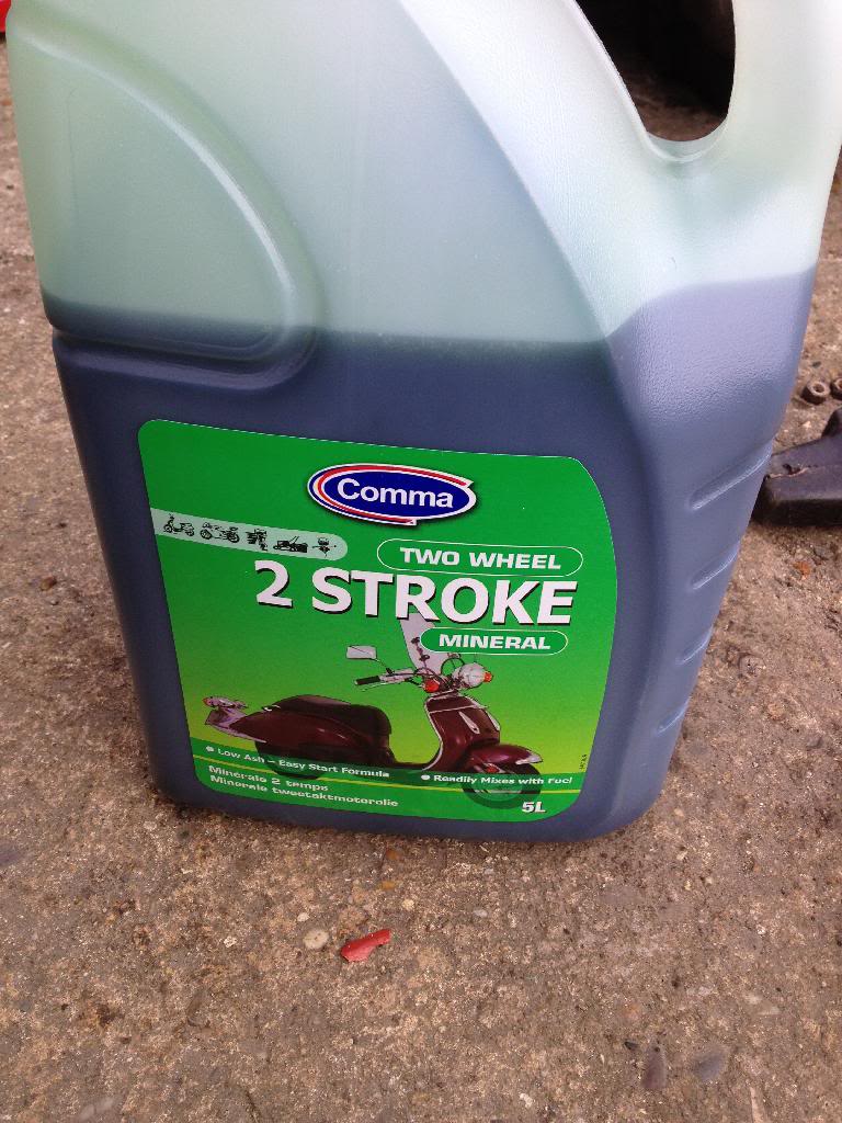

Got myself some new 2 stroke oil too, should last me a little while.
Plan for tomorrow is to get the black one cleaned, few final touches, get a few more miles on it to run it in.
It is quicker than mine, but it is remapped whereas mine isn't. Does smoke like a goodun though.
Thats all for tonight.
run some diesel cleaner and twostroke through the black one alex.
ment to run cleaner through after touching the injection system.

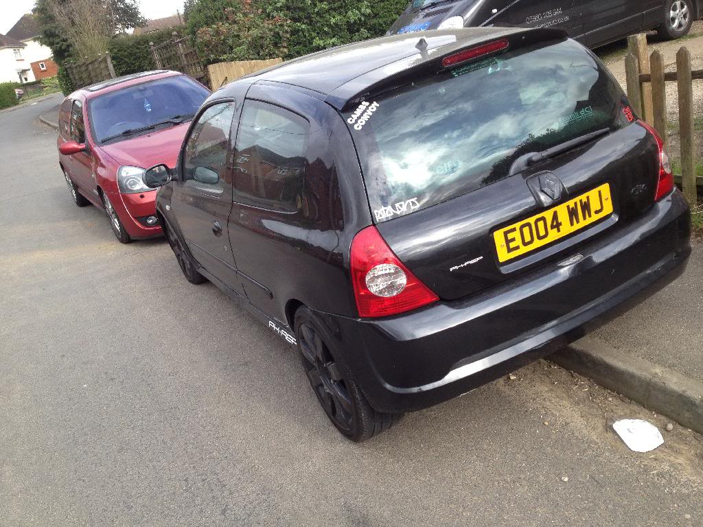

Nice clear drive way. :approve:
Yeah wanted to get it done this weekend as I'm severly lacking time. Plus the longer it sits around the more I'll find to do.
Its one of the first times every Clio on my drive works and can be driven I think.

I may run some cleaner through it, I haven't stuck any two stroke in it yet either, will do that when I fill it up, stuck some in mine tonight.

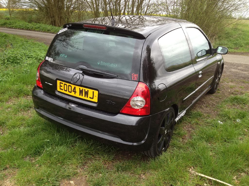

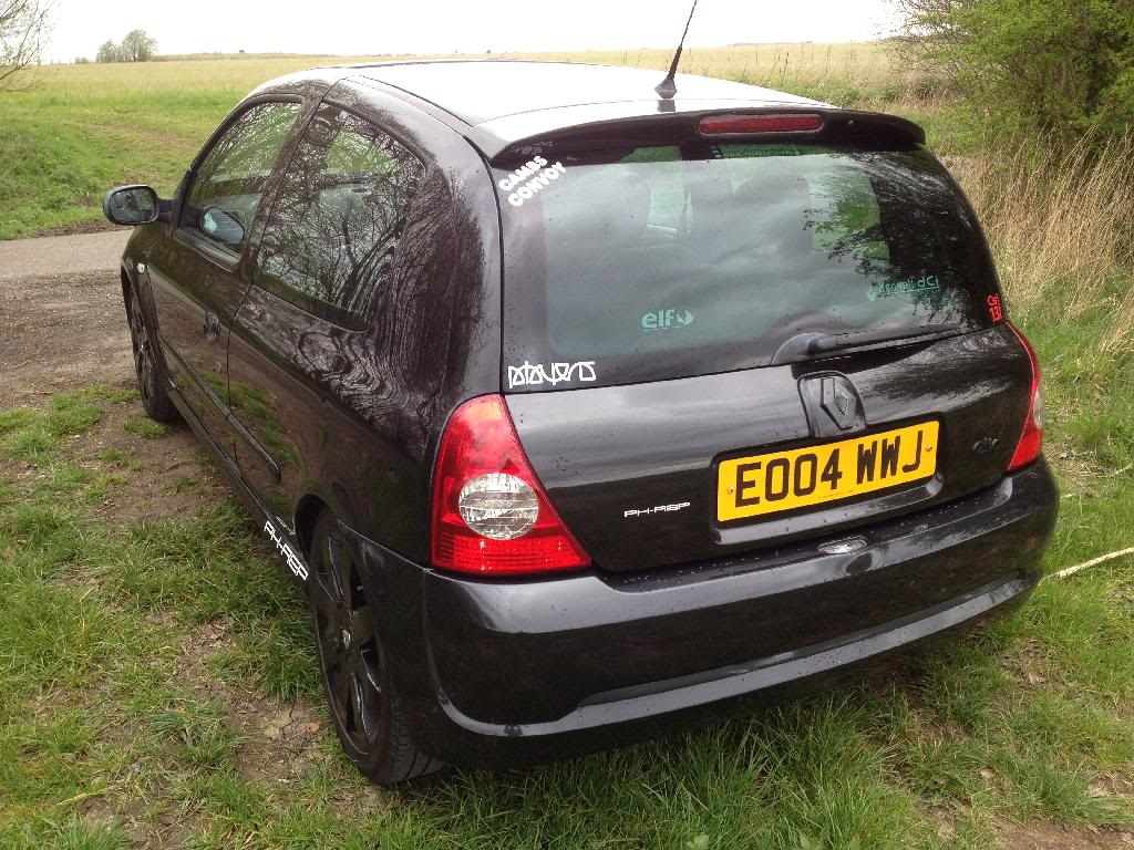

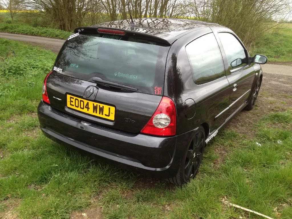

Have been driving the Black one, got the wrong key out twice, and was confused when I saw a Black clio rather than a red one where I parked my car.
Pics later, going to clean it now.
Yes it does look better clean >:(
Looks redicilous without the spacers!
Looked good dirty too. That has 16mm front spacers (not the ones you had on the back, they were cracked as you hadn't removed the hub nut cover), none on the rear. Keeping an eye out for 25mm fronts, but its not a huge requirement considering I'm selling.
Spacers necessary, but that looks really wonderful.
I can hardly take any credit for it, I'm just improving the running and sorting a few little issues.
Why no spacers? Is this why you asked if I had any for sale?
Loose some of stickers as it would look better!
Joe I bet your kicking yourself for not fixing it ;)
See above about spacers, I sold the 20s as they didn't fill the arches anyway.
Would look better without all the stickers I agree, I'll leave it up to the new owner however.
He'll be kicking himself even more when I take him out in it soon.
