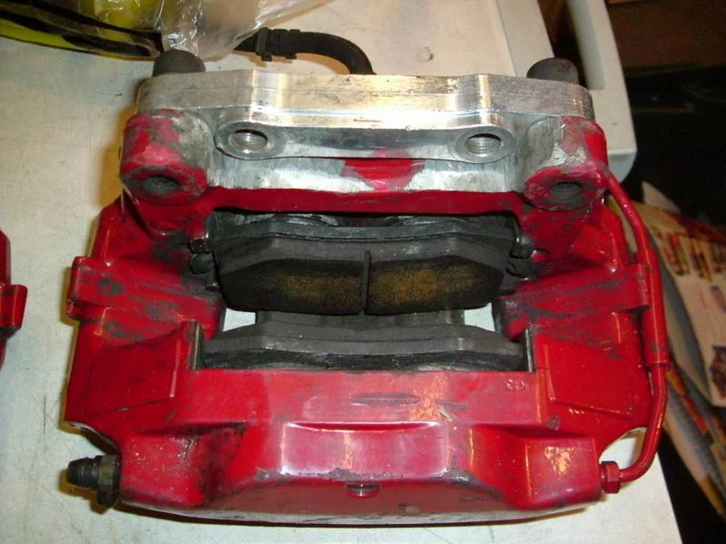

Maybe these photos you can understand better what i mean.
these are 406 with custom brackets to fit 300mm.
These are the alfa romeo with 150mm spacing holes fixings
Think this can bolt straight in the clio, plug n play.

Its not just bolt spacing and the disk width you have to worry about, the offset of the caliper is important although washers could be used to go one way or some machining to go the other.
  F4R mk2 ph2
The fixing holes of the calipers, stay aligned with the holes of the hub (paralel to the brake disk imo), so not even a chance to make any kind of bracket. Was hoping to get way around but stays too far from the brake disc almost not touching.
