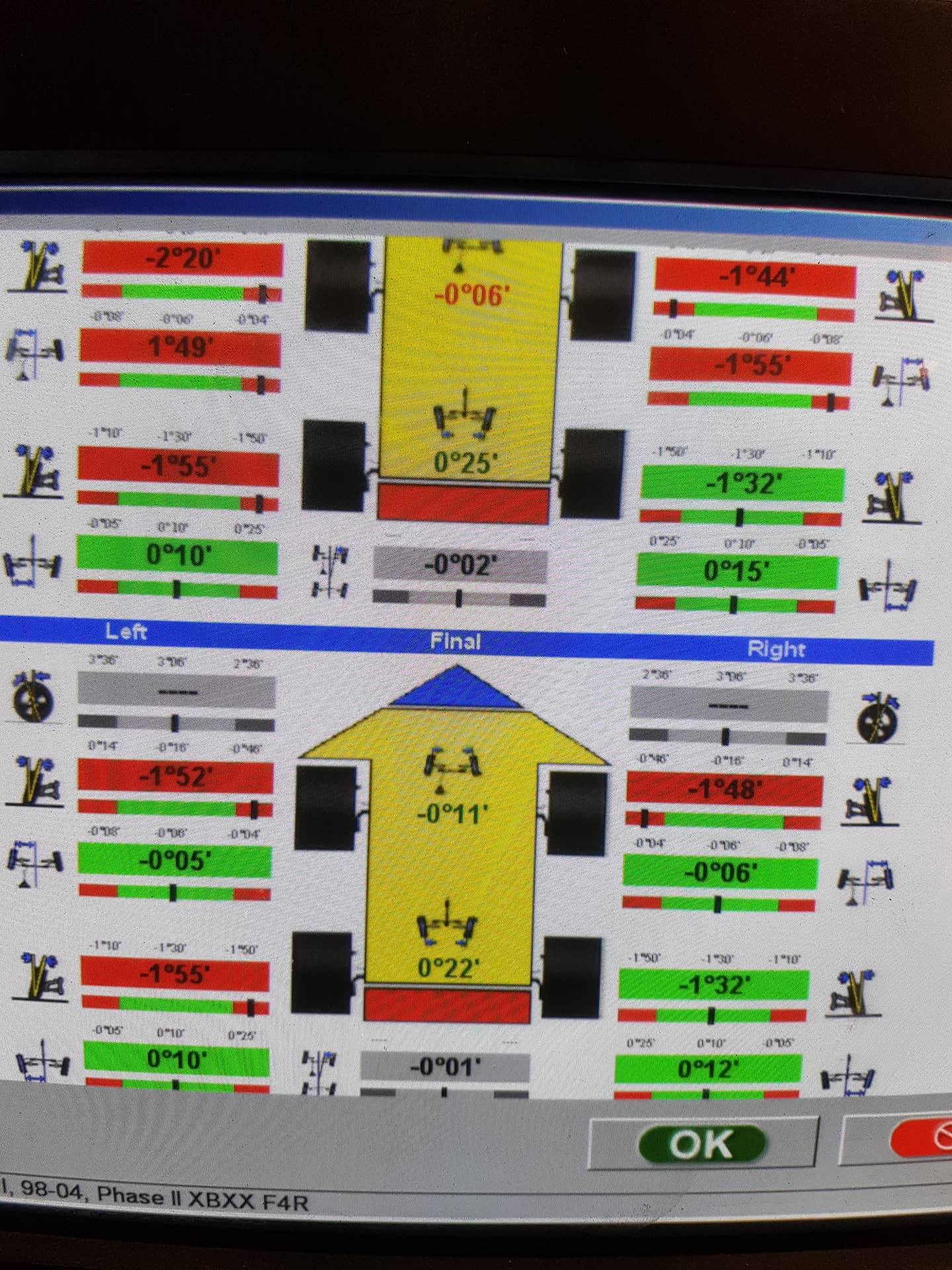

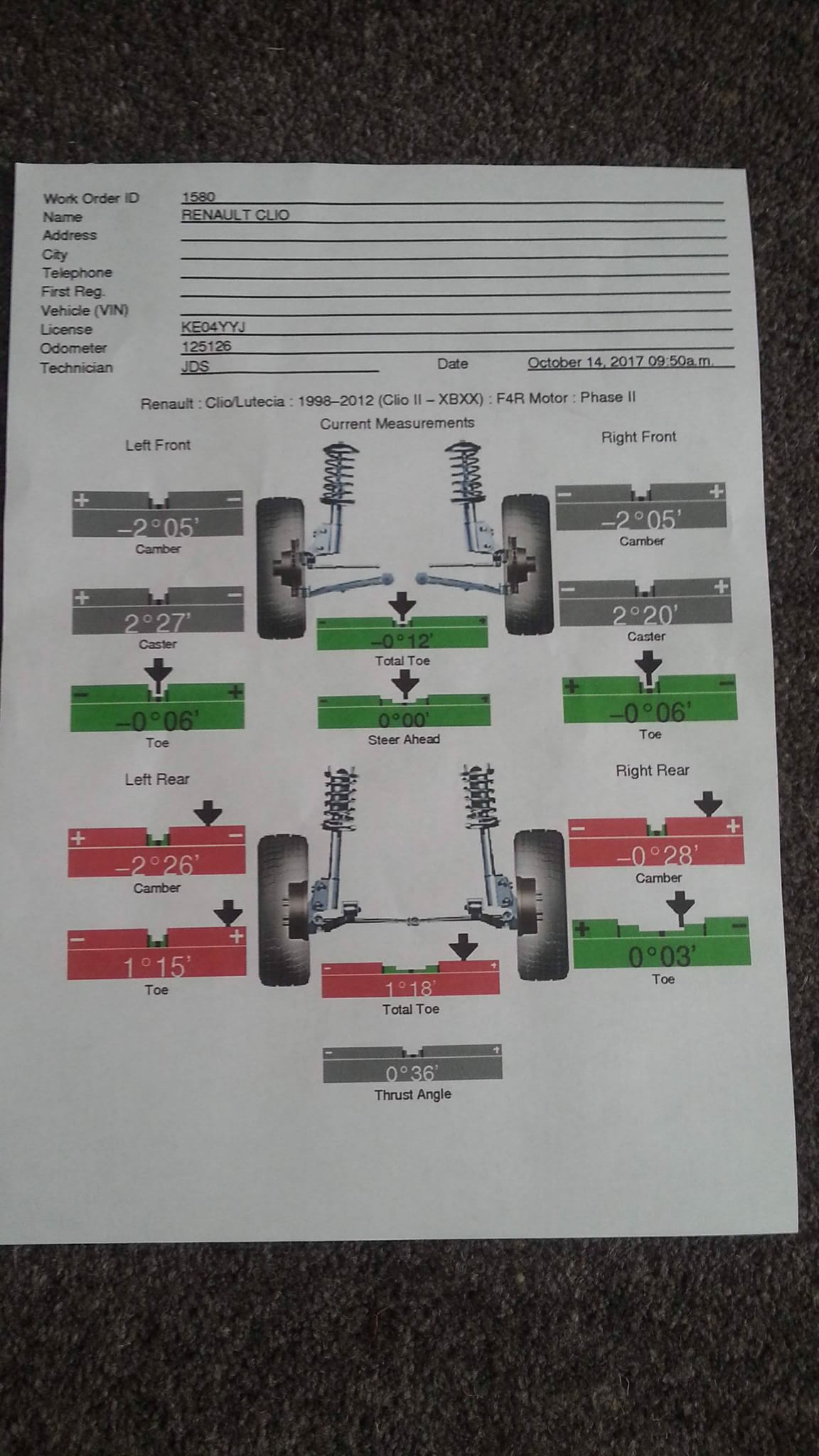

Top is before. Look how all over it is. I understand the toe to a certain extent but the camber? We got the toe to 0.06 both sides after this photo.
Udder Nonce
I Park Like a C**t
The photo above is after my brother aligned it (bottom are the new readings, top as it went on the ramp).
These are the readings when it left allcartyres in Huddersfield with the old cambered spacers on the rear.

The camber bolts were set up on the ramp then torqued off it, so maybe knocked it as they're quite sensitive? My brother just leaned into it on the ramp and got it FT which is a million times better

So the camber bolt they set up at 2.05 was lose when you drove off then
It was tightened on the ramp as best he could, then he took it off the ramp took the wheels off and torqued it up. I suggested getting it back onto the ramp to recheck but was told it would be fine as he said the bolt didn't move.
Seems he was wrong.

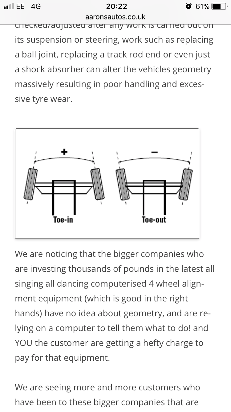

Butting in here, if you don’t mind.......does negative toe indicate toe out?
Thanks :up:.
