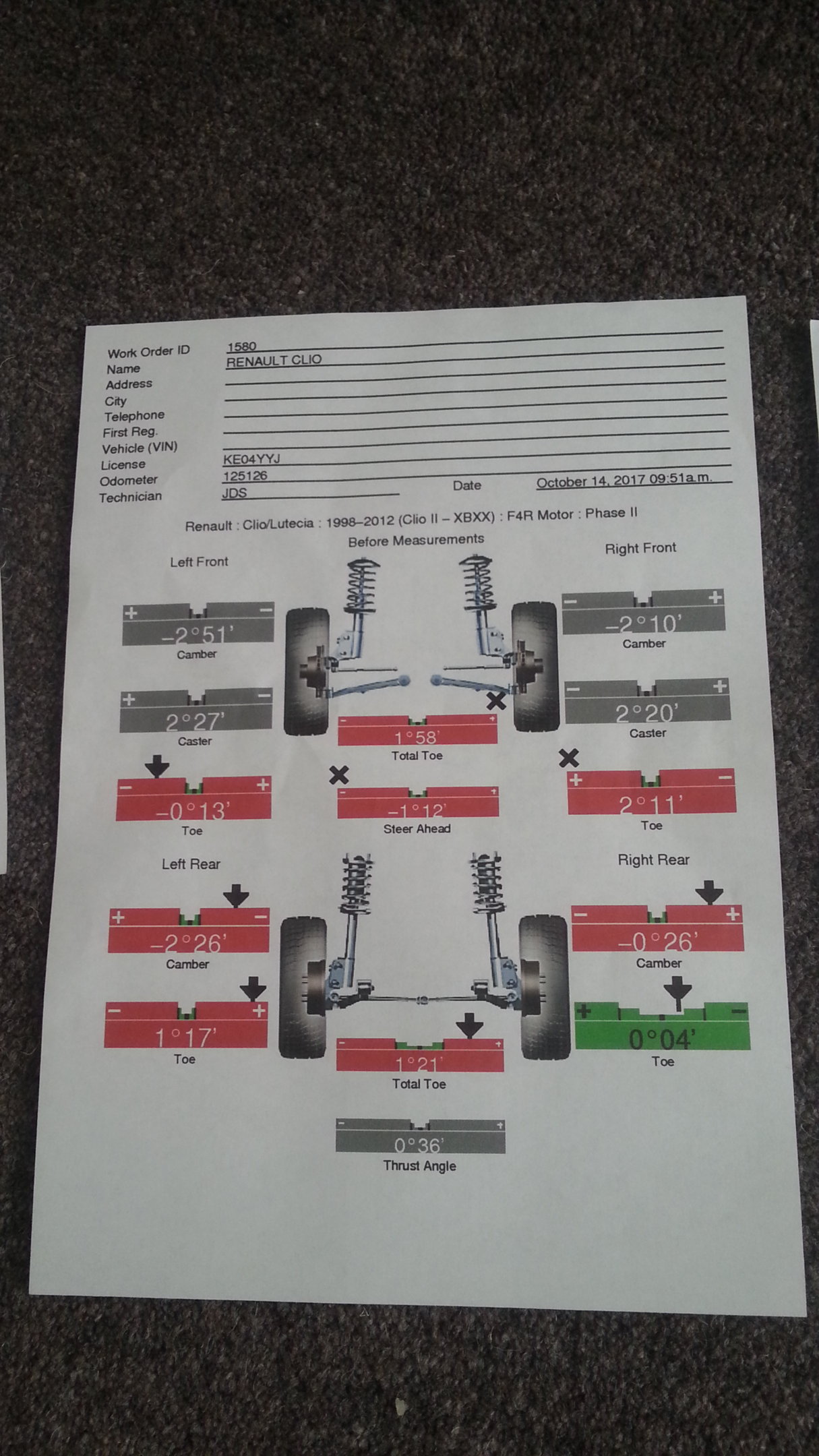

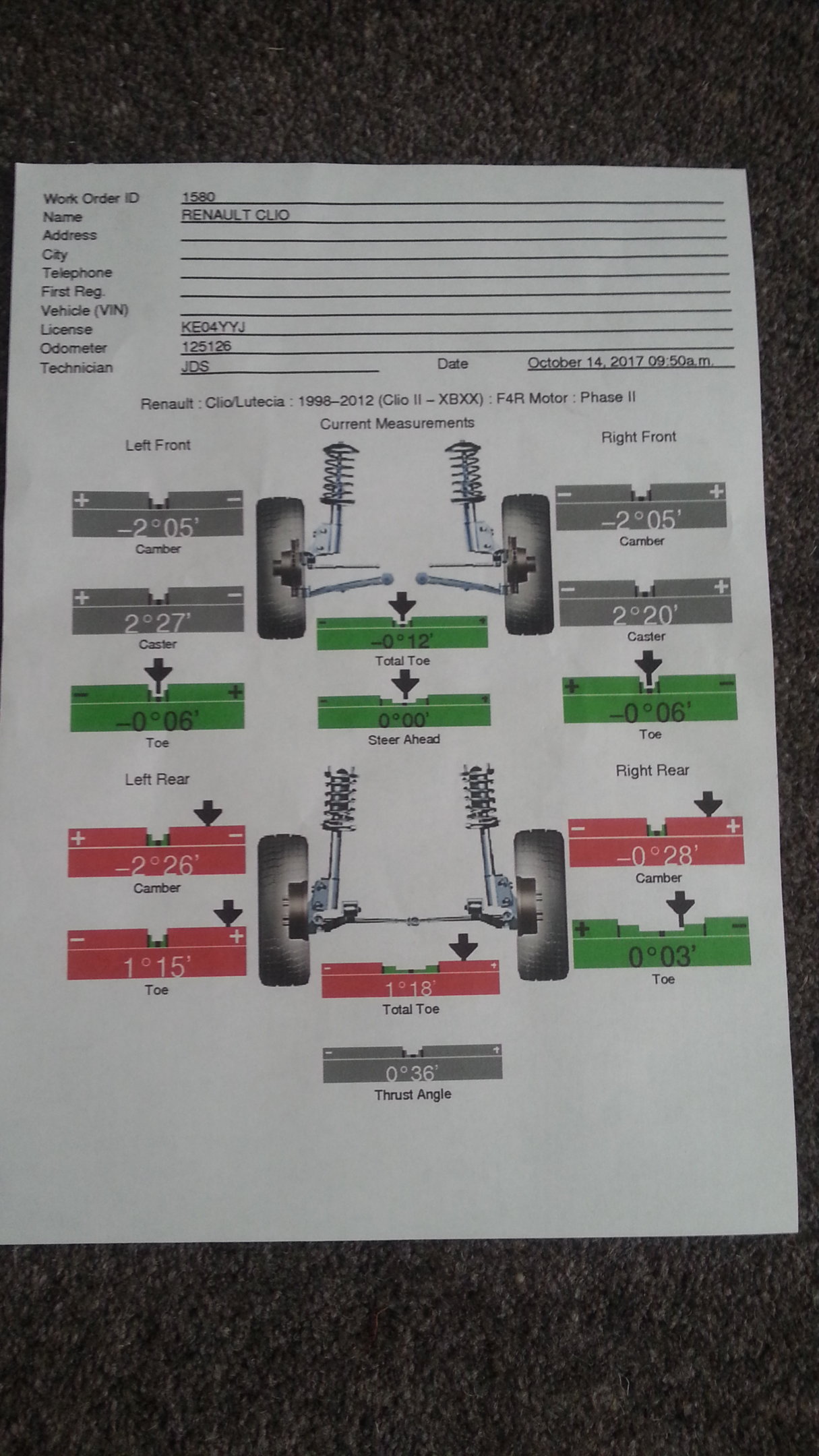

Well I just got back after my aligment and it's good and bad news.
All went smoothly and I got -2 front camber and -12 total toe out, but both were new parts so easy enough.
The rear however is a bit of a problem, it apears to be our pretty badly? I'm still getting a slight pulling left (even after going back once) but this must be down to the rear end. Is my hub bent? What shall I be looking for to resolve this?
Im going to head back next weekend and just make sure nothing has moved since coming off the the ramps but otherwise nothing can be done?

If you get busy with some shims, left hand rear with a total of 1.5 degrees will give you - 0.35 toe and the same -2.26 camber, and for the right hand rear 2.0 degrees to give you -2.28 camber, with 0.25 degrees to give you 0.28 negative toe on the assumption that they are machined that accurately!

Could also be a bent beam or bent where the stub mounts on the beam.
Mine was out pretty bad and I fixed it with shims from pms

Just been out washing the car and you're right, it is quite noticeable to the eye. To be honest i've never really looked before but the car has always felt a little 'odd' handling wise. Kind of squirmy in the rear under breaking, but i put it down to the budget tyres.
What is the best way to go? @STEVE.M's idea is good with just using shims, but am I best off finding the route cause of the problem?
It seems kind of silly going back to the alignment place when the rear end is so messed up. What would others do?

On thinking, that disc did seem to take a little persuasion to come off the stub, related? The little spacer behind was also bent in slightly.

Depends how far you want to go. Could be a new beam, stub axle etc.
Or throw a shim in and job done.

I'll get it measured up tomorrow to see what the score is. I hope it's just a bent stub axle, as that's cheap and easy. I presume i'll be getting uneven tyre wear with it like this? Travelling to london tomorrow...

Yeah ref the tyre wear but wouldn’t happen over night.
It’s not uncommon so don’t be to pissed off mste

Get a rear stub axle and rule that out
Better to shim, 5 @£17.50 by my calculations. Job done.
If it`s the beam that twisted, you are back to square one & out of pocket, not to mention time wasted, and alignment fee down the pan.
Most shells get weighed in with the beam still attached, and you could probably get one for nothing if you are prepared to remove it, but then there is no certainty that it will be straight.

It be worth trying the stub axle rather than sticking a load of shims in.
Get the company to recheck once fitted. If they are half decent they won’t charge you.
If it was slightly out I’d agree getting a shim fitted.

I'm going to give them a call on monday and let them know that it's still pulling and get it back on to be checked next weekend. If I can get a new stub on in the meantime that's perfect. Surely having the front toe perfect along with the camber means that the problems at the rear 100%

There is always the possibility that shims have been fitted in the past, and someone has stripped it down without realising their purpose, and has reassembled it with the shims aligned in the wrong position.

4 shims should sort that. 1 x 60 min (1deg) + 1 x 10 min for the NSR toe and 2 x 60 min shims on the OSR to get the camber even. Done.

I have recently just fitted 10mm spacers on the backend, but they were 2nd hand. I checked and I'm sure they didn't have any camber, surely it'd be fairly obvious? The edge would visible chamfer off?
Thanks for the help so far everyone. I've got a stub on the way too.
