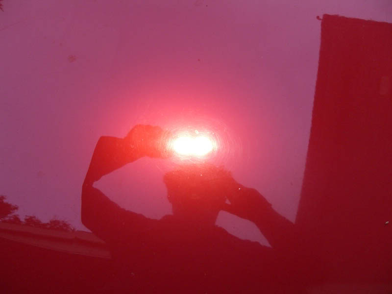

Unfortunatly the dealer did a ‘rush’ job on cleaning it. The car is absolutely brand new and was for a brand new car quite badly swirled and in some places very deep swirl type scratches, which after 3 passes with a rotary, did not shift!! Being a brand new car I took the cautious route and left them there rather than compounding.

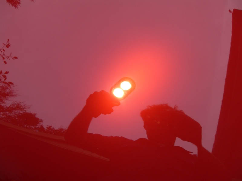

Before pictures of swirls in bonnet

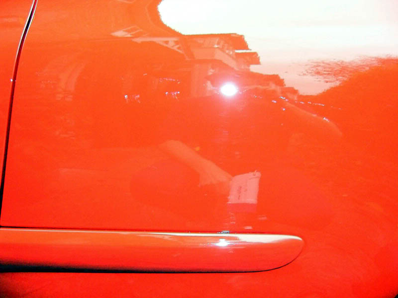

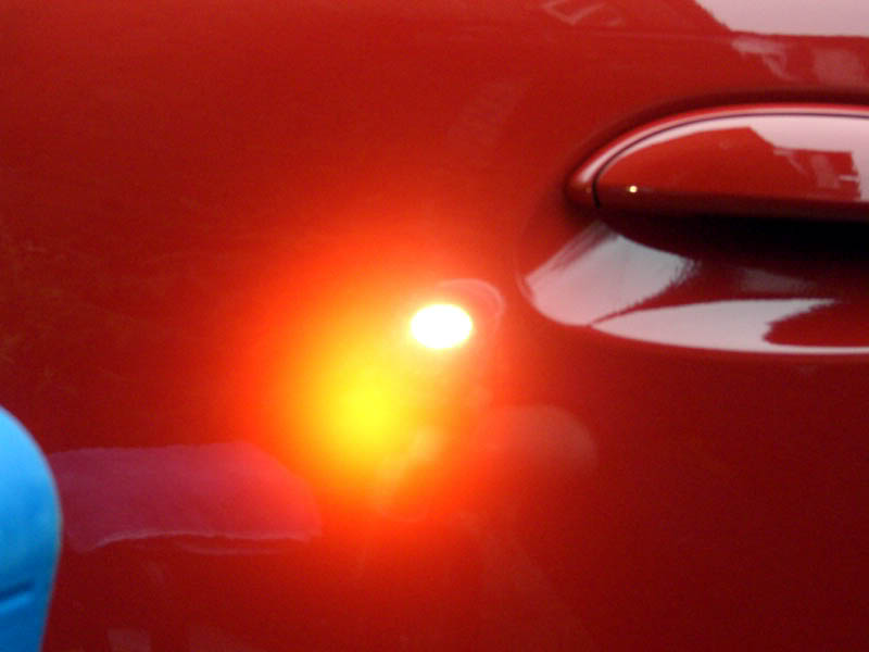

Less obvious swirls in side

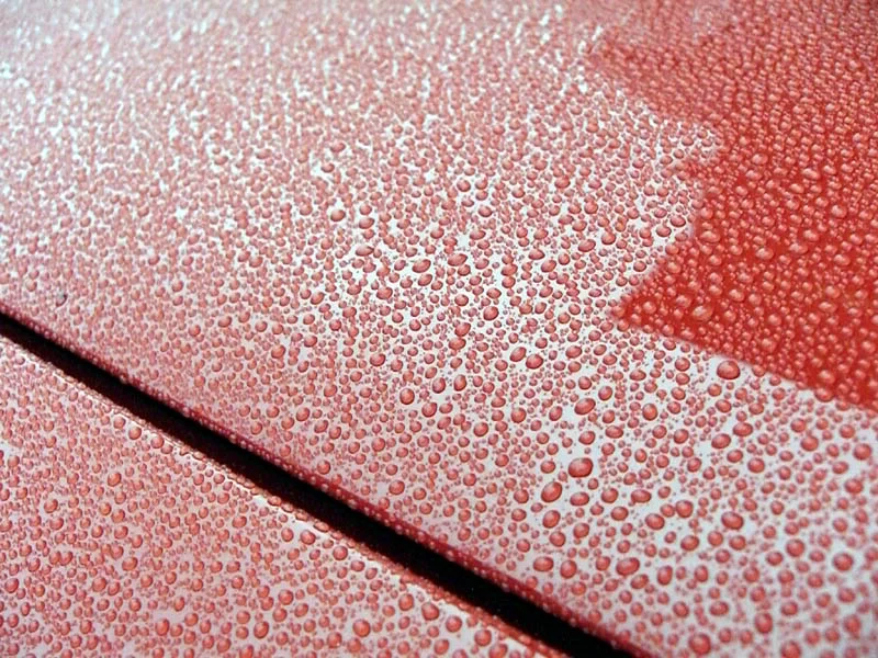

Strike wanted maximum durability and with it being too wet/moist cold for sealants to work properly I went for Collinite 476s. This is known to deepen the paint but isn’t best known for its reflective look. So I decided to spit shine it with sonus carnauba spritz.
I used the ‘wax as you go’ (WAYG) technique on each panel as very light rain was forecast and I didn’t want to be caught out with a polished car and then have it rain before the wax went on!

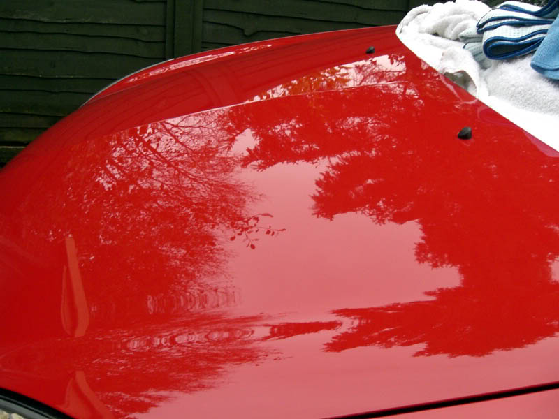

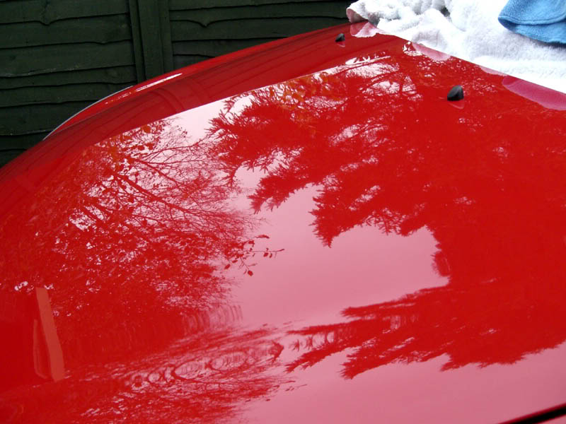

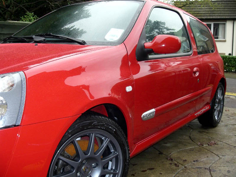

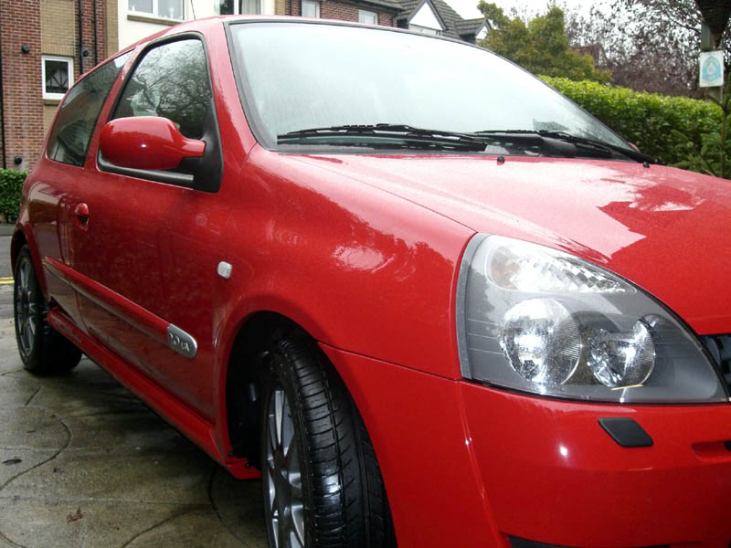

After pics of bonnet and door after polishing
After pics of door
wide shot of bonnet after #80
Bonnet after spit shining collinite

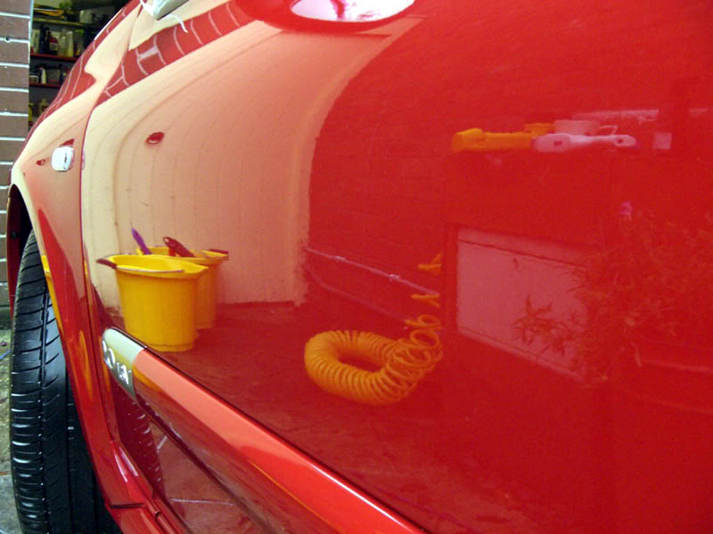

Side shot after spit shining – I was especially impressed with this as I achieved my aim of reflection and depth
