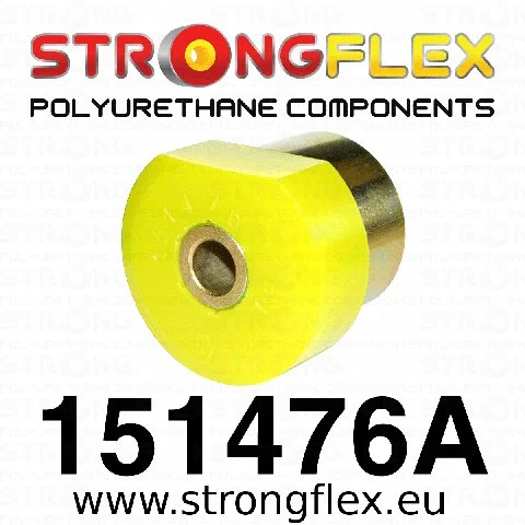

alternative to powerflex?
downloaded a piccy off their site, looks likke a different design to powerflex ones.

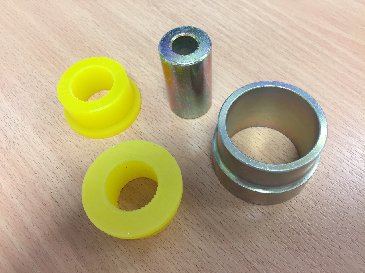

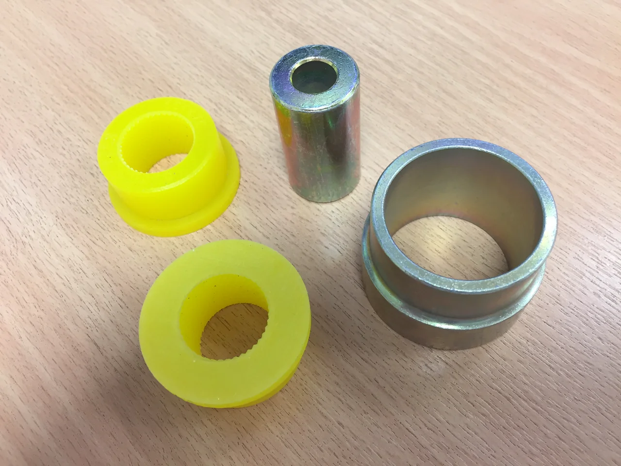

I bought a set of yellow strongflex out of curiosity...they are the same design as the old powerflex, the bushes are galvanized (can that be welded?) the yellow ones I have feel slightly harder that the purple Powerflex ones (scientific nail indentation test).
I like the new design of the powerflex, but with the black bushes I think they might be too stiff for everyday use, so i'll be using the old style purple ones.

and the strongflex being the same design as the powerflex, they would have the same pittfalls.

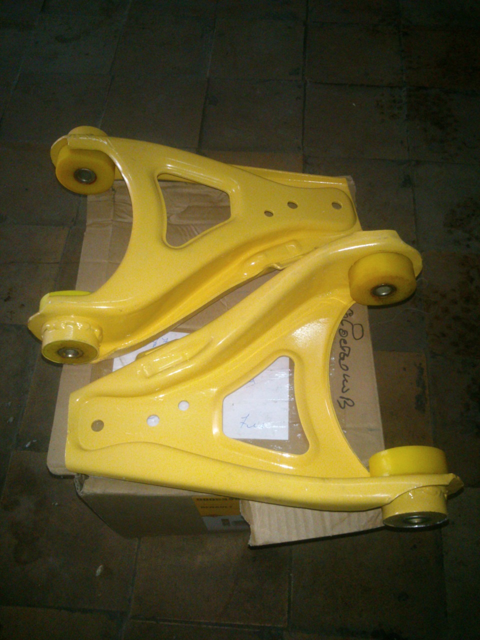

I'll be fitting Strongflex wishbone bushes to my 182 track car this weekend so i'll try and keep people updated as i use them. I know a lad who races in the trackday trophy who's just started using them, so I'll see how he gets on.
