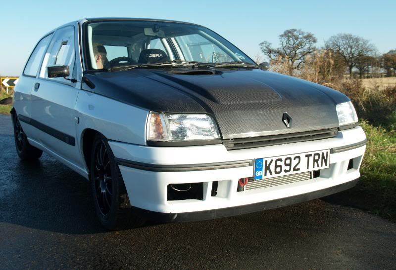

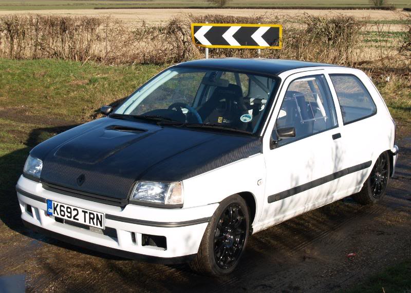

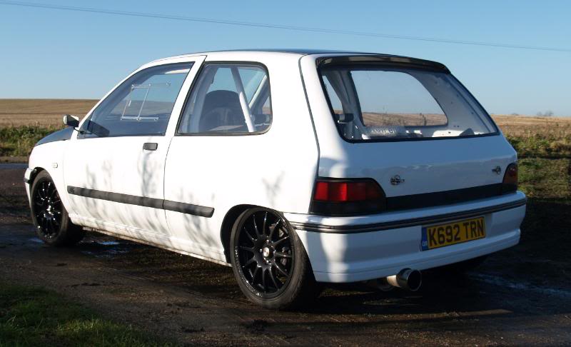

Well, sorry for the big gap since the last post but as you can imagine the internet hasn't been top of my list for the last week. Right so the Clios' been on the road for a week and I absolutely love it!! It's thrown up a couple of teething problems this week but nothing we can't handle yet.
Although it did scare the life out of us when it blew the feul pipe off the rail on the A1 at about 85 lol.
All i can say is it is very fast, I've not managed to get a clear race with anyone to be sure of how it stacks up except a quick 30mph roll on against Moo's saxo VTS which was a masacre 8)
So now that it's out and about my dad and i had the chance take it out and grab some better pictures. I'll stick a couple on here but put the rest on a seperate thread just because really.

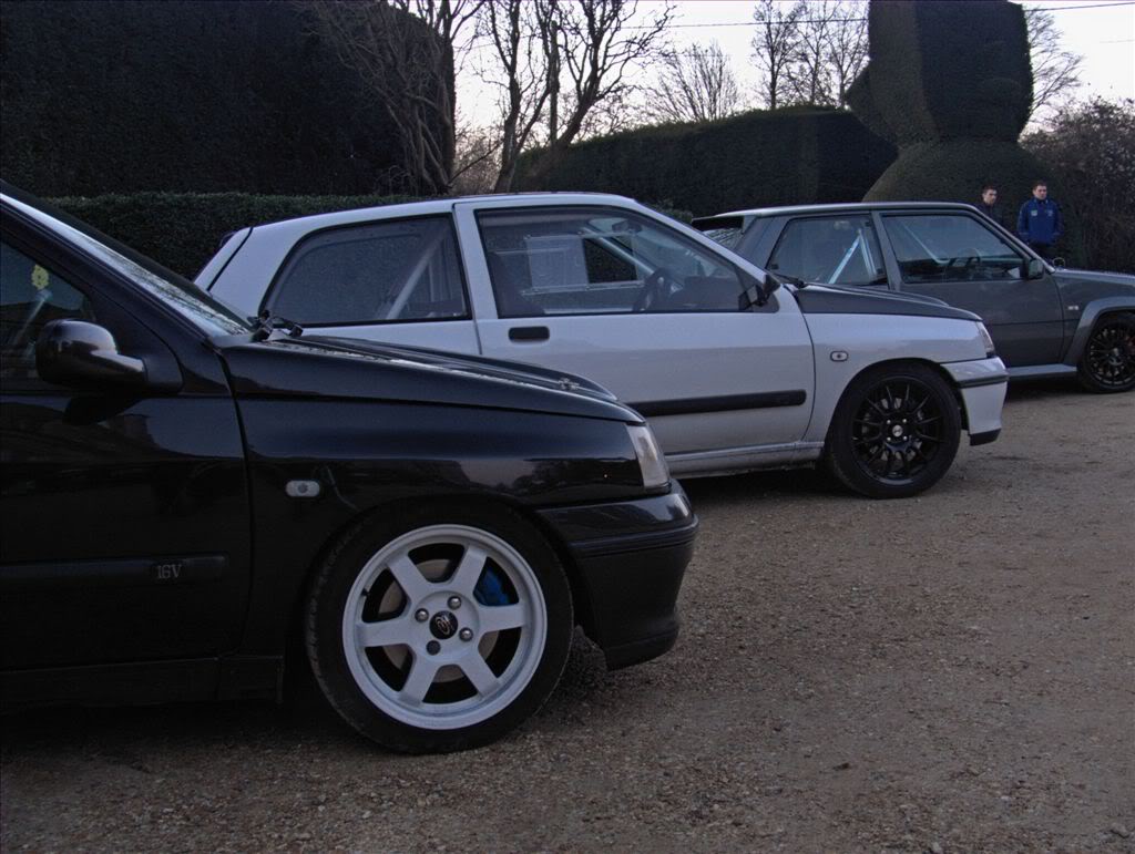

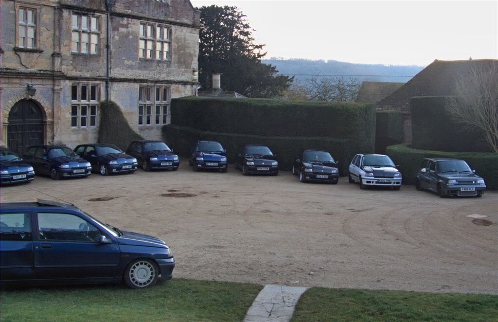

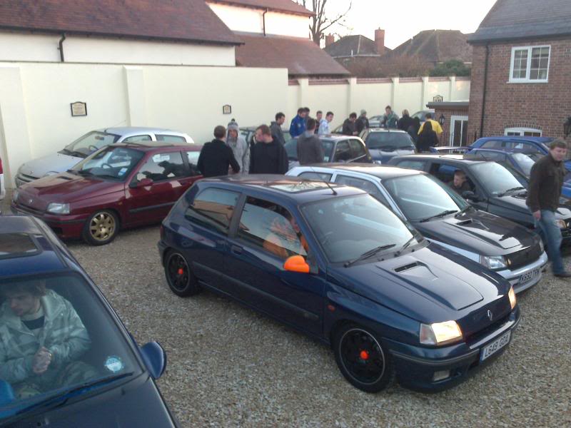

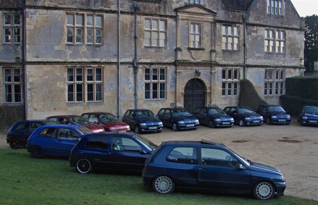

Cheers matey glad you liked it. Well as mentioned above the clio is out and about doing the rounds still and loving it. This weekend moo and I decided to take our lives (and hearing lol) in our hands and did the 3 hour each way 320mile round trip to the valver south west meet. The car performed brilliantly only throwing up a couple of little glitches but nothing we didn't have asneaky suspision we'd need to look at lol.
Even better though was the reception the car got when we arrived! So many nice things were said made us feel so good about it all. Just thought i'd stick a few pictures up of the meet but mainly because i kinda miss posting on the thread lol.

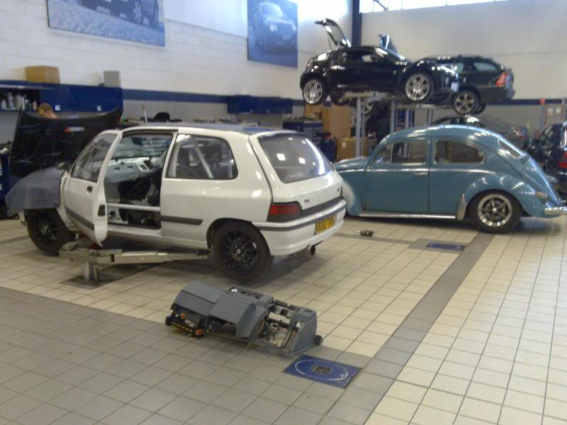

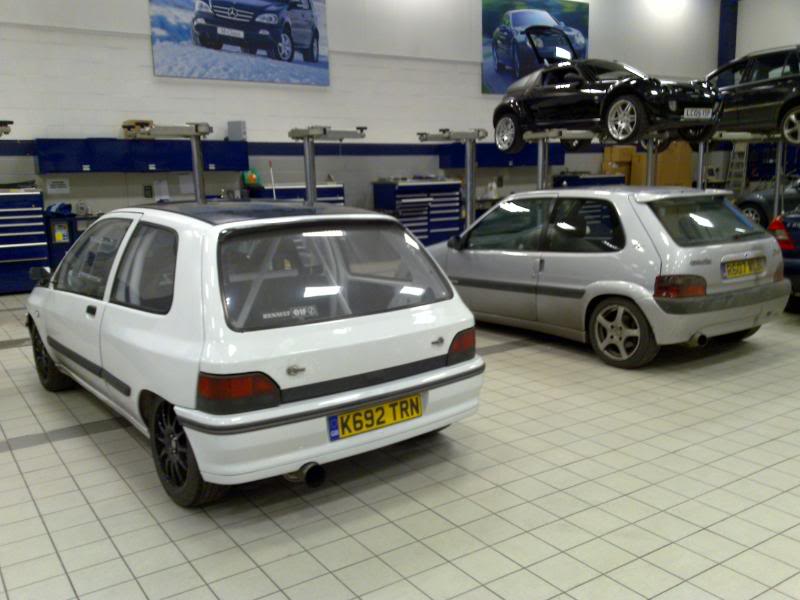

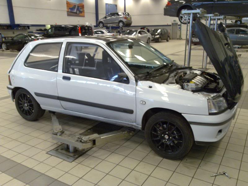

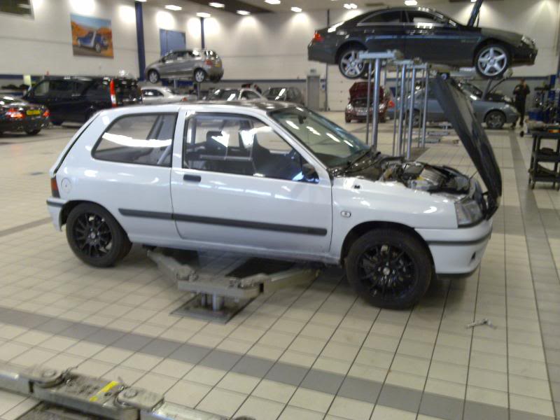

Today we managed to run the Clio into Moo's work to sort out a few little things which have come to our attention during the miles its been on the road for.
First thing to do was get it on a ramp and do an oil and filter change as we've had the engine for 2 years and not done it, and have no previous history to it.
So getting this done was quite a weight off.

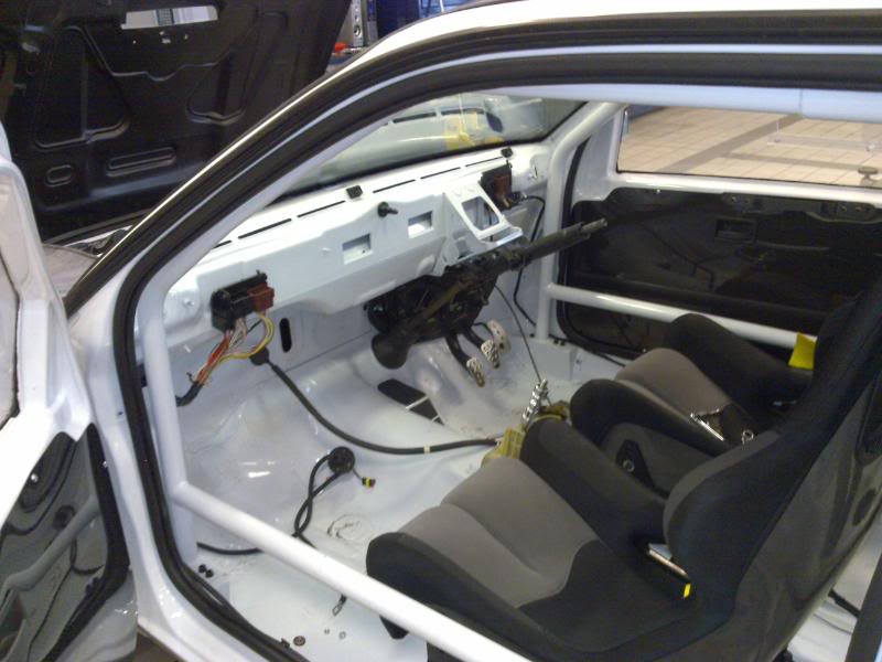

Next was to service the cooling system, we noticed on the very cold trip to Dorcet that the heater blower wasn't working and also the heater wasn't getting hot, so we whipped the dash out (easy once you've done it as many times as we seem to have in this project) and replaced the blocked heater matrix with a new one, and while the coolent was drained replace the stuck thermostat.
So we now have a fully functioning cooling system with a heater, making it a much more hospitable place to be and the engine now runs at a hotter and much better running temporature! BONUS!
While we had the dash out we also decided to rethink the brilliant idea of blue led dash illuminations that were absolutly useless and looked awful, so we replaced them with normal bulbs again, making the dials readable at night! Also BONUS!
Also lubricated the gear linkage, tightened the door pins and loads of other little jobs.
I know none of this seems like much and the car doesn't look any different, but the car feels (in our heads more than anything probably) much better and healthier than before.
Hopfully if we keep going at it we'll have all the little problems sorted by the time the weather cheers up and the car can finally be used for what we made it for!
