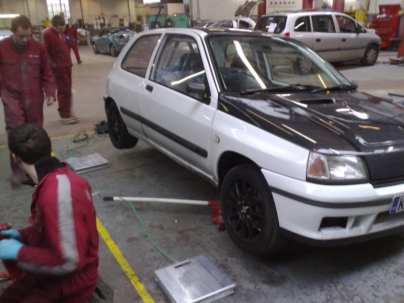

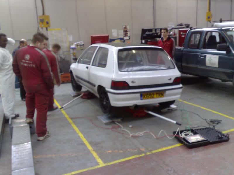

Right! This is without a doubt going to be a controversial post but i'm making it anyway because a lot of you are very interested. Wednesday Dodgy Nick from work who races formula 2 stock cars did me a favour and generously brought in his very accurate corner weighting scale set.
The car was then jacked up with a great deal of interest from everyone else and even a sweep being taken on what it would weigh in at.

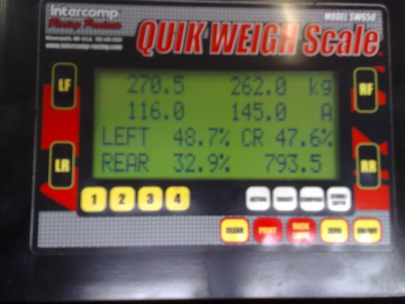

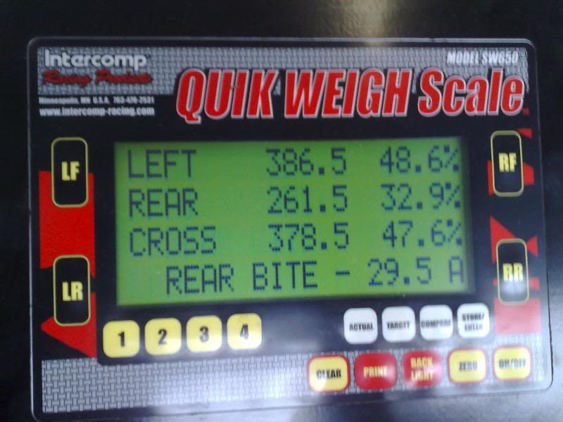

The results are as follows... and i suspect there will be a fair few who will question the result etc but this is a FACT and is accurately weighed.
So thats it then, the clio weighs in at 794kg that in our opinion is damn good going for a fully caged car which still has a heater, decent dash and a standard sized fuel tank.

It seems from scanning the web that standard weight is between 980 & 1030kg so we've managed to drop around 200kg and that obviously includes the addition of a 30kg cage and the floor bars for the seats so we're pretty chuffed with the outcome.
