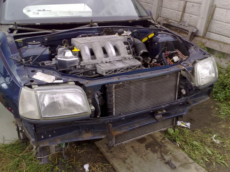

This conversion is obviously becoming popular but we're very pleased with our work all the same. What started as a simple tart up, mot and track day hasnow started to turn into a full on project starting with...

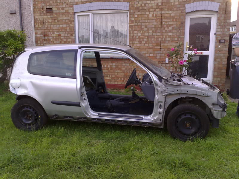

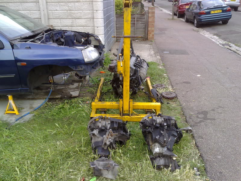

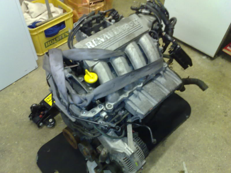

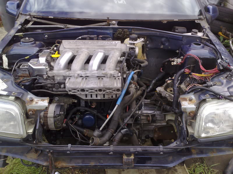

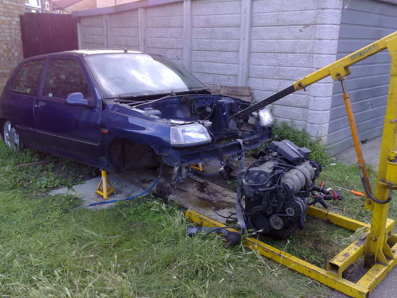

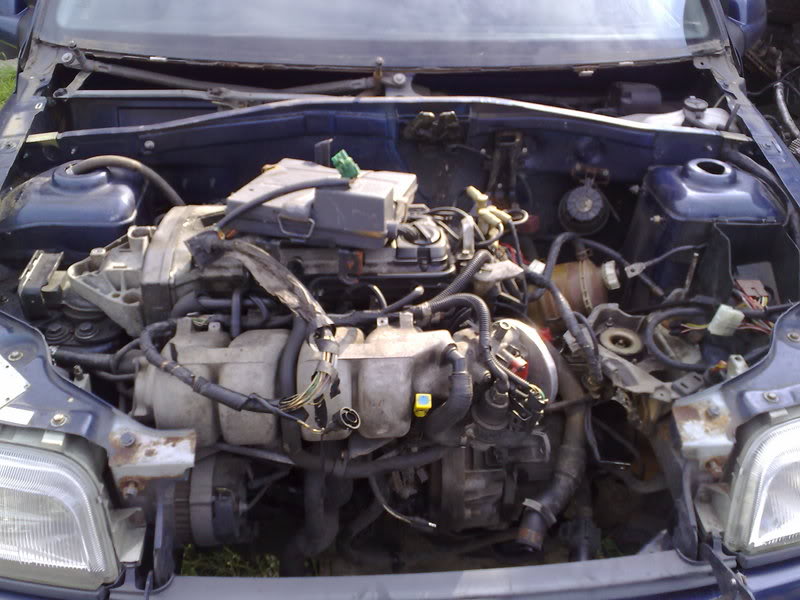

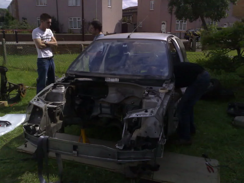

We were lucky enough to source a phase 1 48k donor car, cheers steve. Stripping the 172 pretty much turned into a garden party

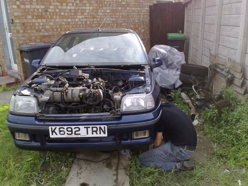

So we began stripping the old 1.8

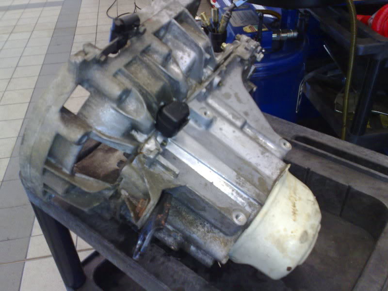

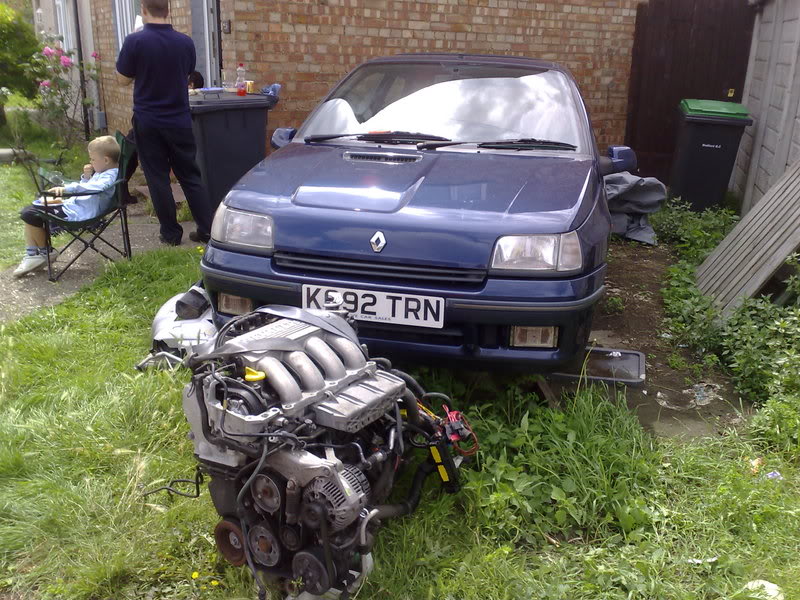

We did some comparisons

From what we've found out it all goes pretty much straight across, obviously there's a bit of adapting to do but none of it sounds too scary.

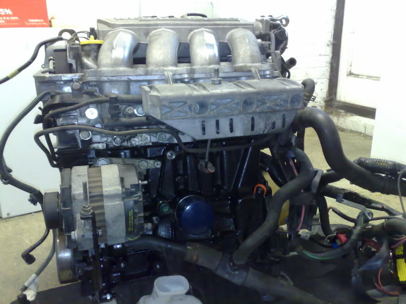

The Flywheel is at a local engine engineering shop being lightened and balanced to give it a livelier throttle response and i'm planning to get it chipped and rolling roaded but other than that it's pure driving fun i'm after. Other plans though are full lightening (sound deadening etc) full weld in cage, buckets etc and a respray inside and out (I work in a bodyshop).

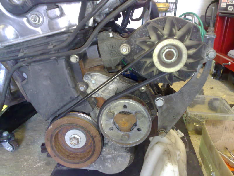

We used the valver alternator becuase it works better on the aduster bracket as they're from a similar era (my brother dropped the 172 alternator, braking pulley, and making the decision easier) Lol.:quiet:

The valve was strong as an ox and bullet quick before we stripped it so if anyones interested in the lump just pm me. (It comes with everything except an alternator:D )

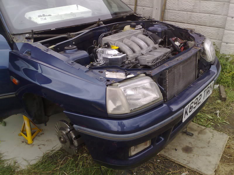

Wednesday night we finally got the flywheel back from lightening and balancing (half a kilo lighter). Put a new clutch in, fitted the gearbox and swung the 172 lump into the valver.
Since then we've got the subframe, most the brakes and suspension fitted, gear linkage attached along with the clutch and throttle cable. Temporarily mouted the the 172 rad to make sure it all fits, now its just a case of making a bracket to fit it perminately.

Got the v-belt with no power steering (personal choice) or a/c sorted. Thanks wayne
what bracket and belt are you are using with the valver alternator?
picked up my engine yesterday but didnt come with an alternator attached (and the lad had cut the aux belt off when removing the engine!!) so gonna use the one off the valver like yourself

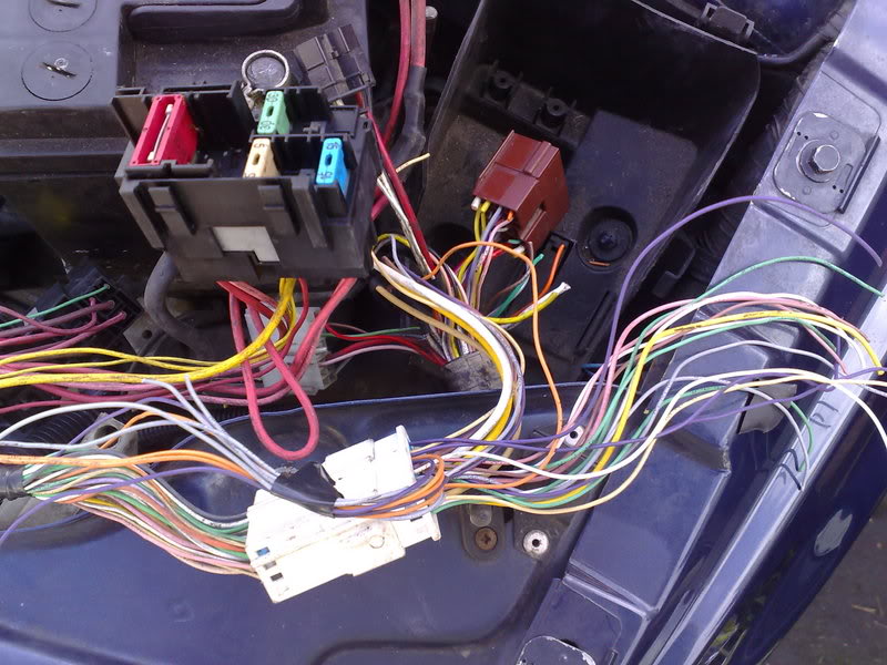

Further progress report. Spent a couple of evenings on the wiring and it doesn't seem to be too much of an involved job. I've got the majority done, it turns over and if we had the ecu back from decoding I think it should run.
