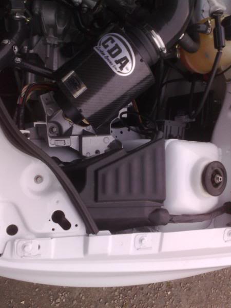

PMSL! this is for a different thread! But i'm just going by another thread in the project section where a guy said that his air feed was to be as high up the front as possible so the air would be colder.
i read that too. it does make sense tbh.
your car though so if you want it looking factory-ish with the caf in the fog then go for it. will still be awesome.:)
Ive been told by a very reputable tuner that in the summer the temperature at headlight level can be as much as 10 degrees lower than at road level due to the tarmac absorbing heat and radiating it. ie, heat haze

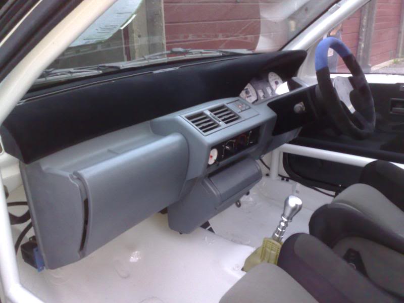

We started off by tidying up and fitting a few interior components we got from a scrappy last weekend.

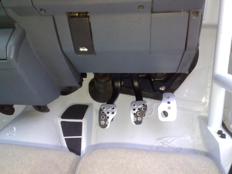

We fitted a gloveobx lid:
Also removed the headlight leveling from the under dash trim on the o/s and fitted that.

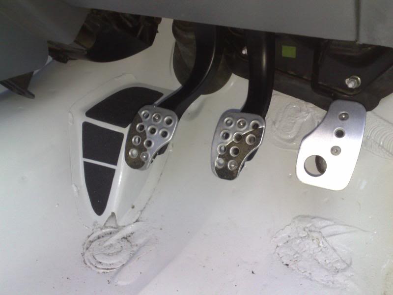

Se also got a bit 'arts and crafts' on the foot rest with some grip tape.

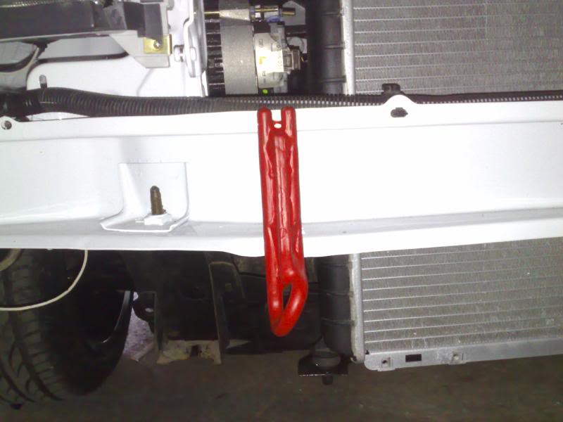

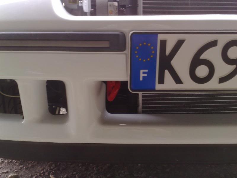

We noticed, to beanie's despaire that we'd forgotten to fit the tow eye so the front bumper had to come off again.:mad:
We wanted the tow eye to be noticable but not just painted as that'll chip easily, so we looked through a car restorer catalogue and found a rubber coating dip kit, and here are the results:

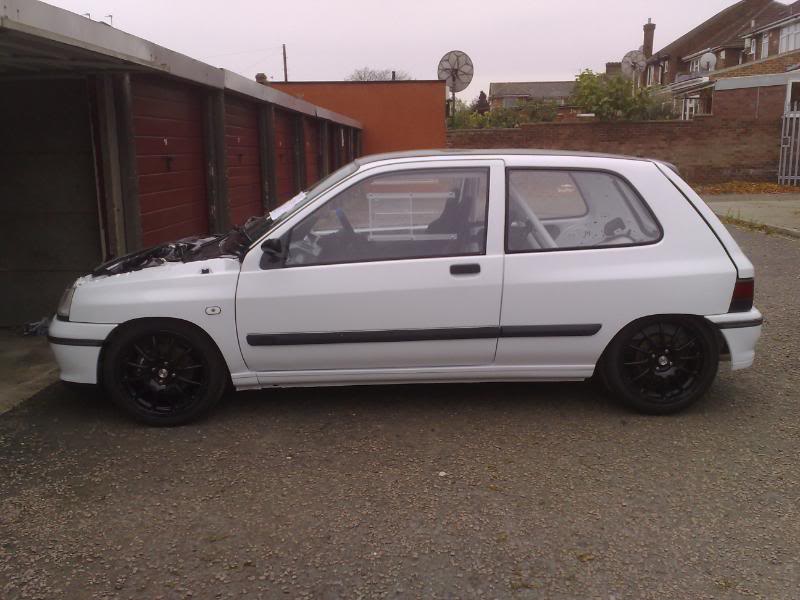

Something we noticed and a couple of other people have is the car was sitting high at the front. So we got hold of some 55mm front lowering springs and set about fitting them today. Got them on in just under half an hour without using spring clamps :cool:
Not sure how much of a difference its made but I'm sure after some 'settling' and with a person in it it'll be close enough to level.

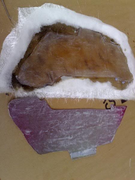

I've managed to get my bonnet to work and have begun the reconstruction of the inside of the bonnet. Here is the plate that is to be fibreglassed and glued into the bonnet to get some structure and strength back in it.

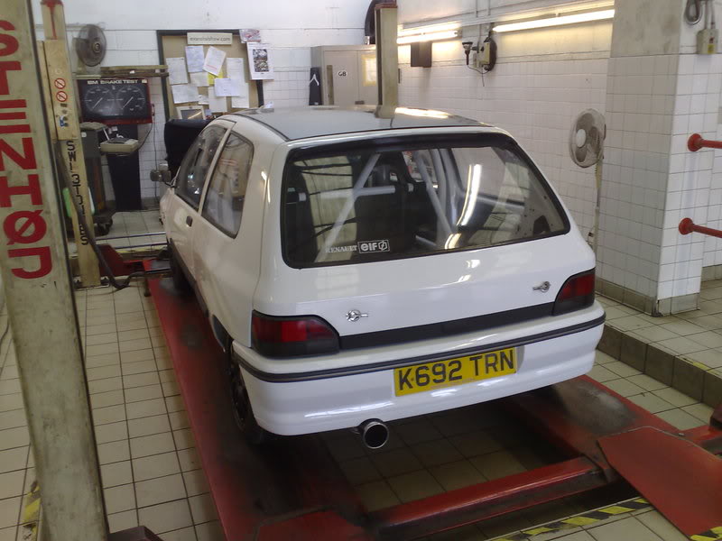

Well today the clio aquired this seasons must have accessory...
Then a quick phone call to the insurance company and i'm 394quid worse of but fully insured and able to drive it home legally!
Quickly checked all the levels and headed out onto the roads.
We only did a couple of miles owing to the fact that we can't tax it till the certifiacte of insurance arrives but its left a perminant mark in both of our existances and of anyone who saw or heard it.
It sounds beautiful and goes like you wouldn't believe, unfortunatly owing to saturday traffic and damp roads we feel we only got a taste of the performance that it can deliver!
We'll keep you posted:D:D:D:D:D:D:D:D:D:D
