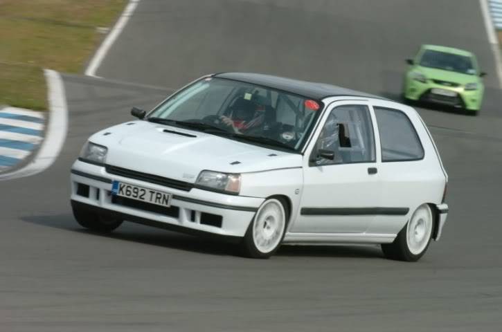

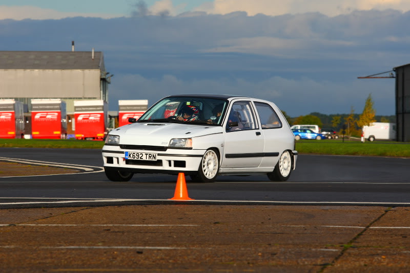

After the first outing of the car at USC, we got the car to Trax that year at Silverstone which was the first time we managed to get it on a track, with a 15 minute session!
The car instantly showed that we had built the car right as it seemed to be a complete demon on the track! Even though my talents at the time needed to be raised upto the standards of the car lol.
With old school glass headlights we had to tape them up (uber cool lol)
Then a couple of pictures of the car out on track stretching its legs, not the best but we were new to all this

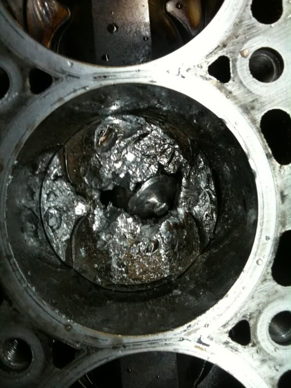

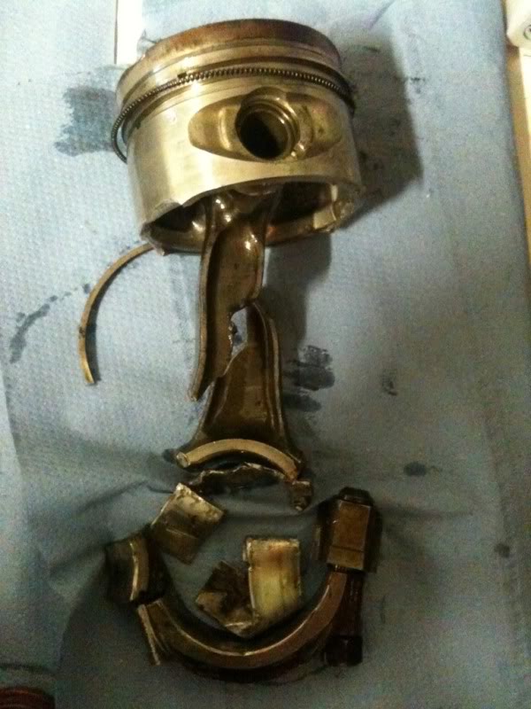

We'd arranged another trackday and being pretty sure the car seemed to be holding together we decided that we were going to go all out as fast as we could, taking as much curb as we can etc! So to get used to the car I decided to take it to work the week before!
2 days before the trackday coming down Chicheley Hill I was gunning it past a Kia of some sort (of all things), suddenly had a huge lack of power and missfire, and then I looked in the mirror there was a LOT of smoke.

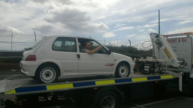

Managed to get it into a layby, called my brother and waited for him to arrive in the 306 diesel to tow me home. Fearing the worst but we were both oddly calm!?

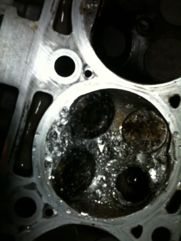

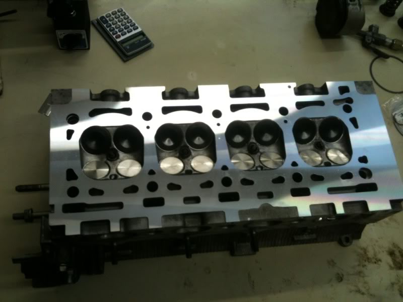

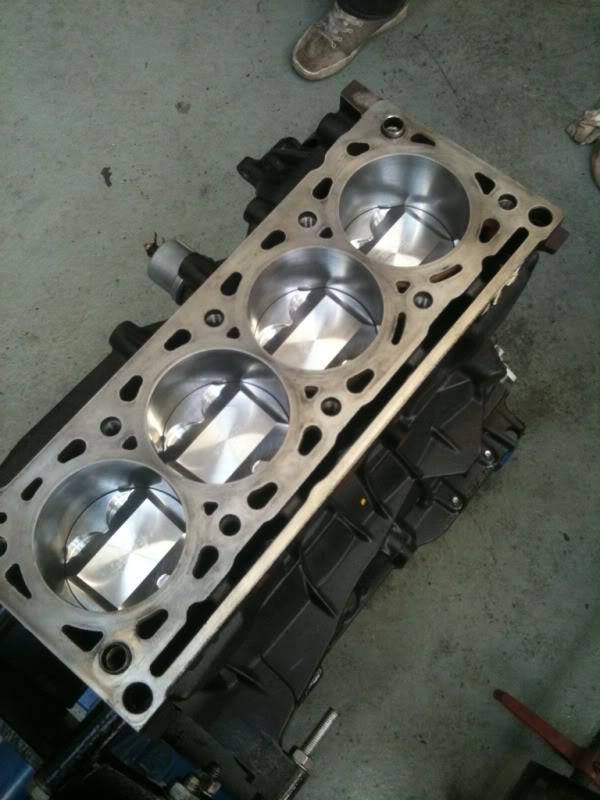

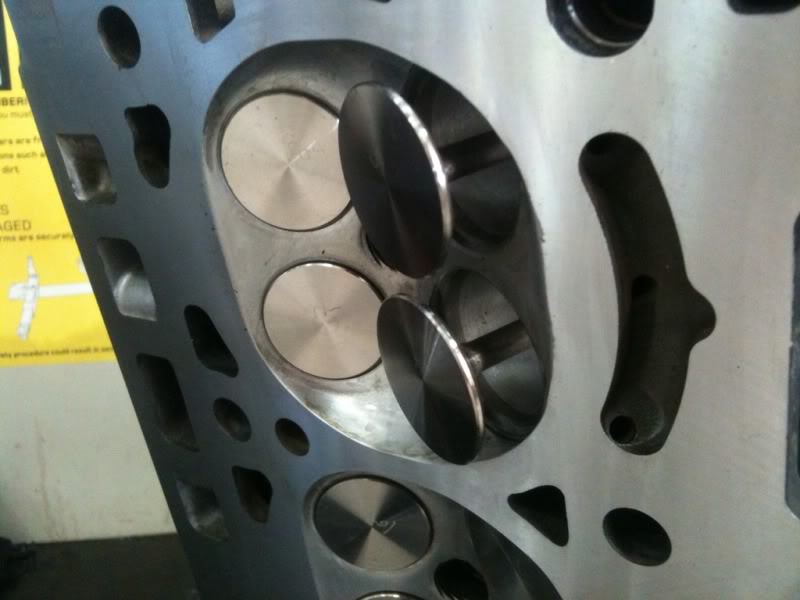

Looking in the bodies cylinder 3 had a lot of oil in it and a fair bit of metal, so we both knew it was terminal

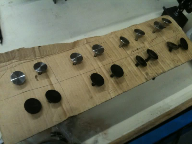

ot the car home and managed to pull the head off in well under half hour lol and our worst fears were confirmed

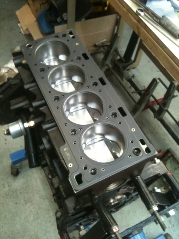

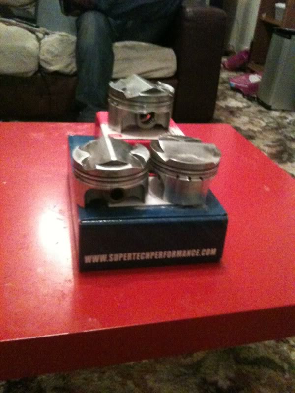

It had dropped a valve destroying pretty much everything

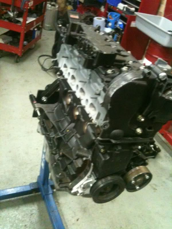

Not being phased by this, luckily I had some savings at the time, which were all entirely swolled up, but we managed to source a 172 engine off eBay, got some pistons, contacted our close friend Dan (sideways dan) at 519 automotive and set about another engine build to similar spec to its predecessor, just with stronger valves.
This was all on a very tight time scale to get the car ready for a mates birthday celebration once again at Bedford Autodrome.

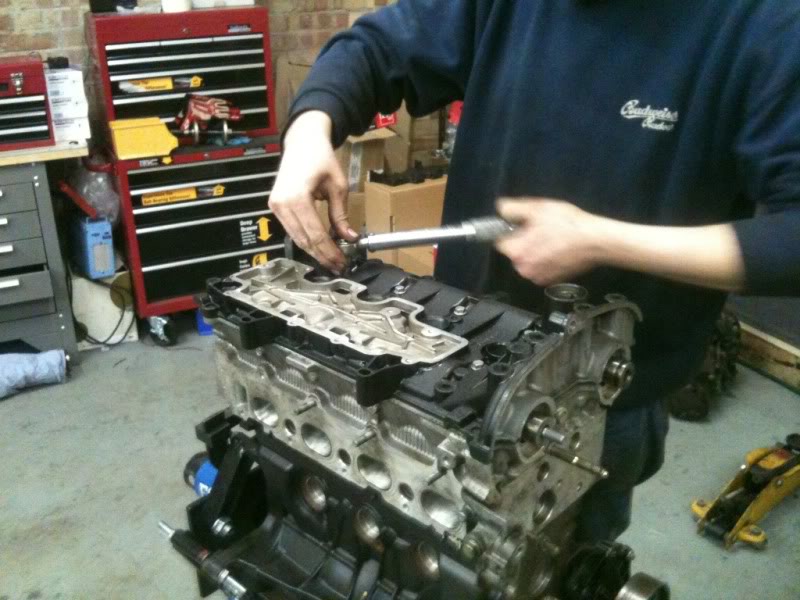

So the pistons arrived Monday morning, a couple of late nights to get the engine built.
Followed by another late night the get the engine fitted (something we HAVE done before lol)
Another late night to plum it in, followed by an early morning jolly down to a rolling road to get the engine mapped!
All very tight time wise, but somehow achieved!?!

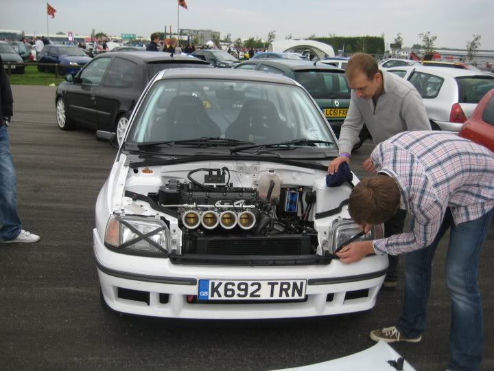

Right next up was a show we'd desperatly wanted to get the Clio to for quite some time now!
We made it to French Car Show!!!

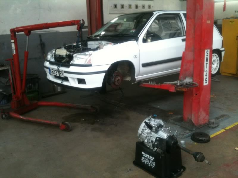

2 days before the trackday, in my infinate wisdom I decided to pull the gearbox out and fix a small oil leak we had from the rear main on the new engine
Luckily all went to plan and we made it to the trackday

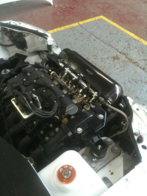

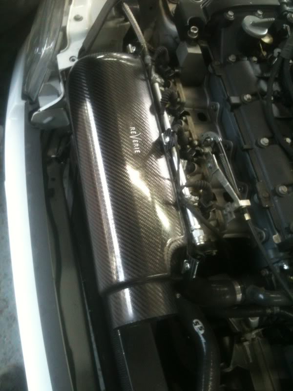

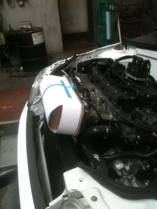

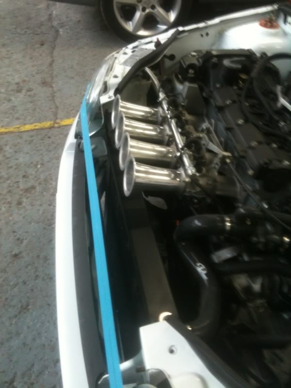

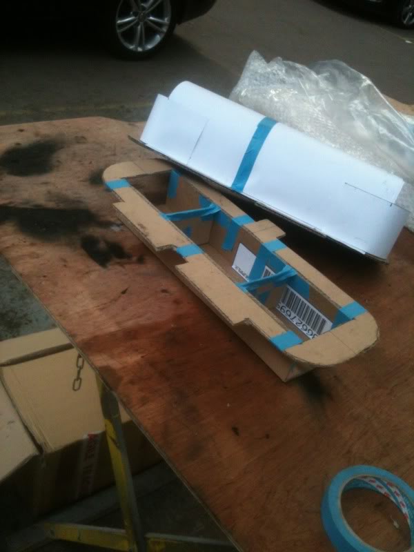

First thing that needed addressing is the noise, so after talking to some airbox manufacturers, I got some dimensions and made a mock up 'cardboardfibre' airbox to see what room we had.
Then decided to bite the bullet, get some shorter trumpets (as the 120's would never fit with an airbox) and order an airbox!
Very sexy, just need to do a bit of modifying of things to get it fitted

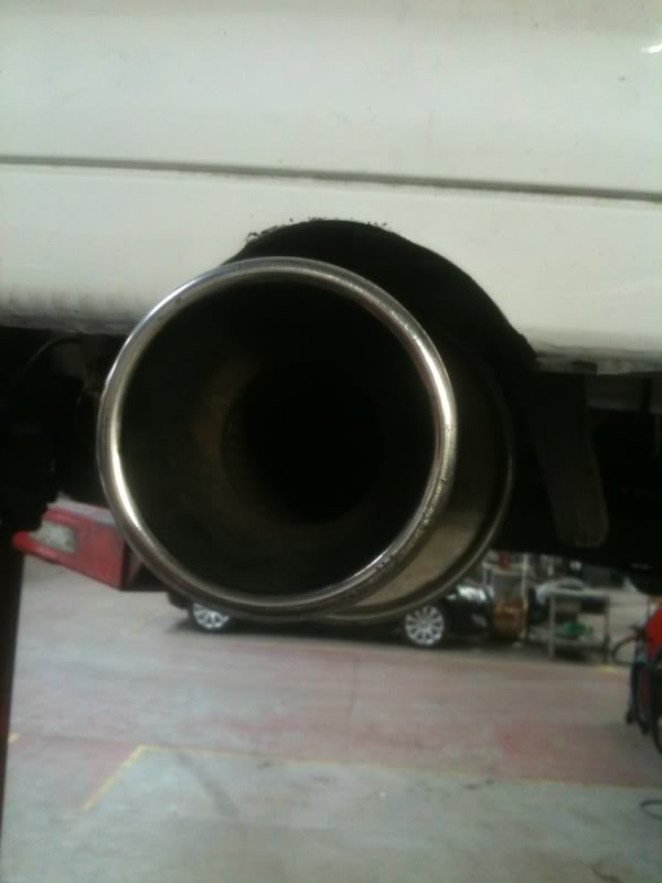

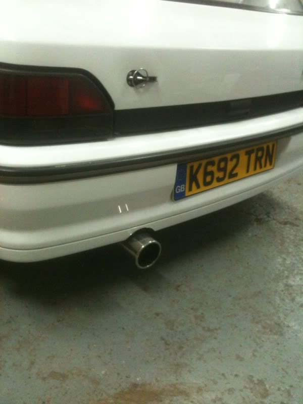

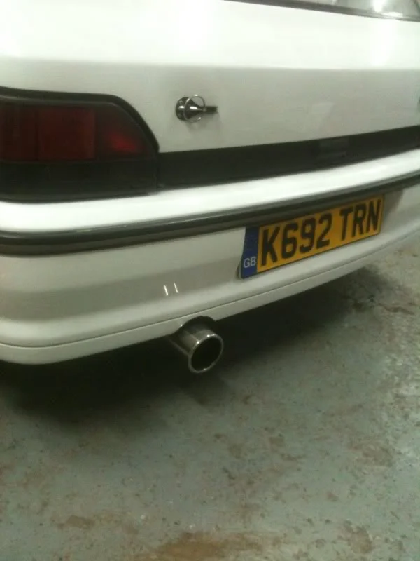

We have also managed to get hold of a Mongoose exhaust, for free for fitting an exhaust to a Focus St, to replace the awful Powerflow item it had on it, which should also help keep the noise down
THE BUMPER WAS CUT BY POWERFLOW WHEN THEY MADE THE ORIGINAL EXHAUST!!!!

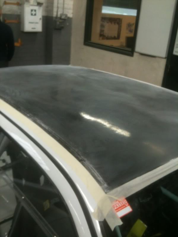

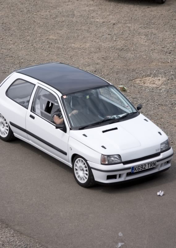

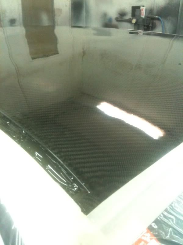

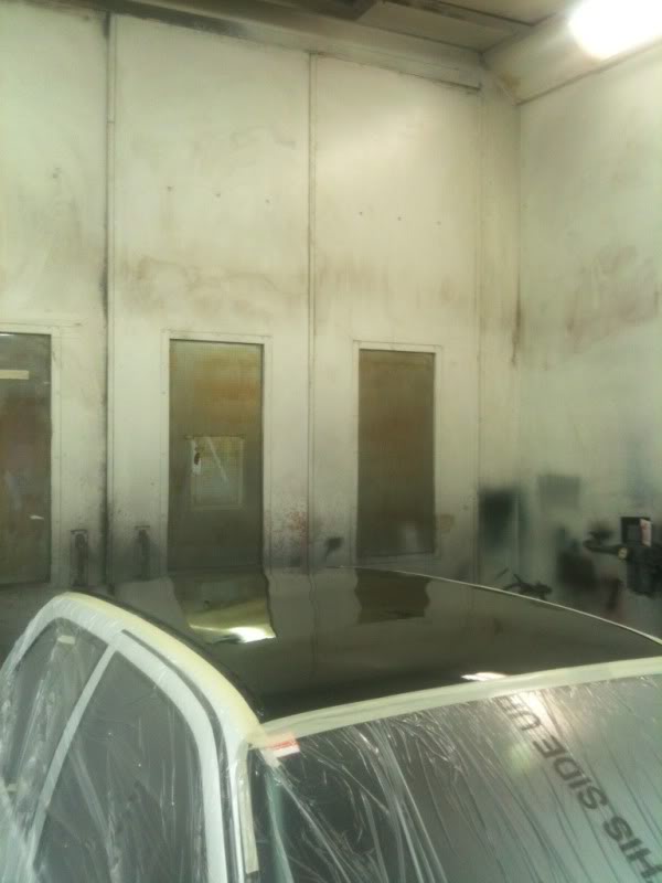

Finally we have got round to laquering the roof, which has needed doing since the car was orignially built, and looks amazing for it!

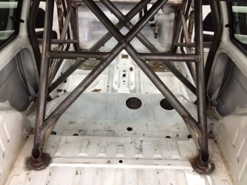

Good update mate. Seems ages since we were curb hopping at Donington.

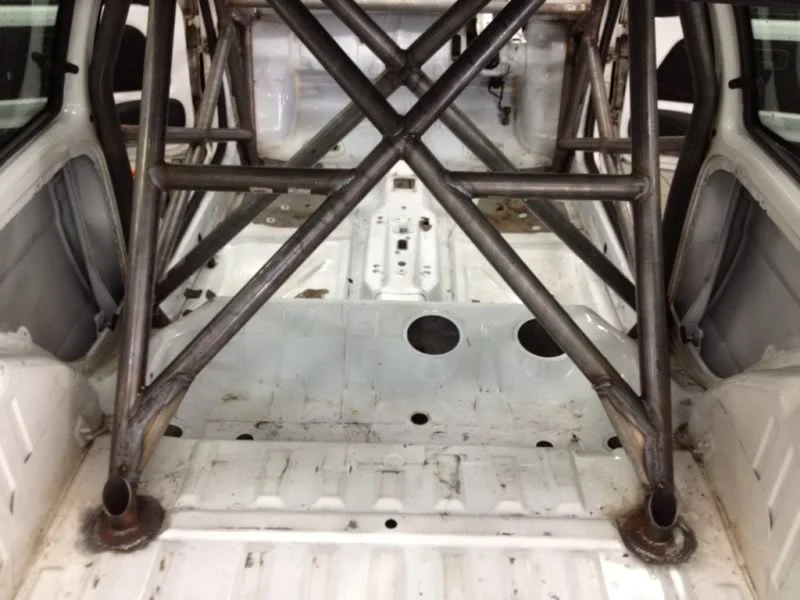

What's the cage in the 106 out of interest? I'm helping a friend with his GTI build at the moment.

The cage that we fitted in the 106 was a t45 custom cages item!
