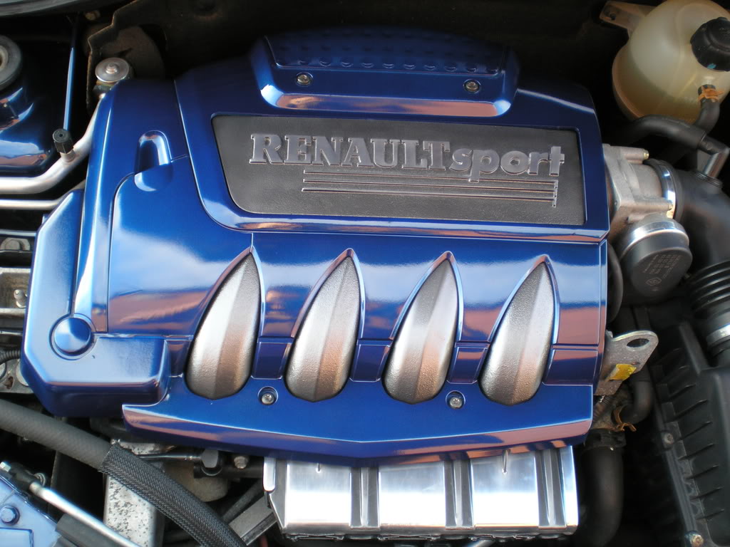

Done my Engine bay over the weekned, just needs the sticker now to finish off, arrived in the post this morning:cool:

how do you polish them?

is it just fine sand paper I'm guessing?

Yeah start off with coarse sand paper (something like 120 grit) to get off the rough casting finish. then work with finer and finer stuff to take out the scratches left by the coarse paper (Finish with something like 2500 grit) then get the autosol out and give it a gold old polish.

Yeah was quite pleased for a Halfrauds spray can lol
I've alwasy been against Halfrauds but il give em there dues on this occasion... I got some over the weekend too (to do my cover and bullets) and it seems spot on.... once the layers go on.... Looked shite after 1 or 2 coats

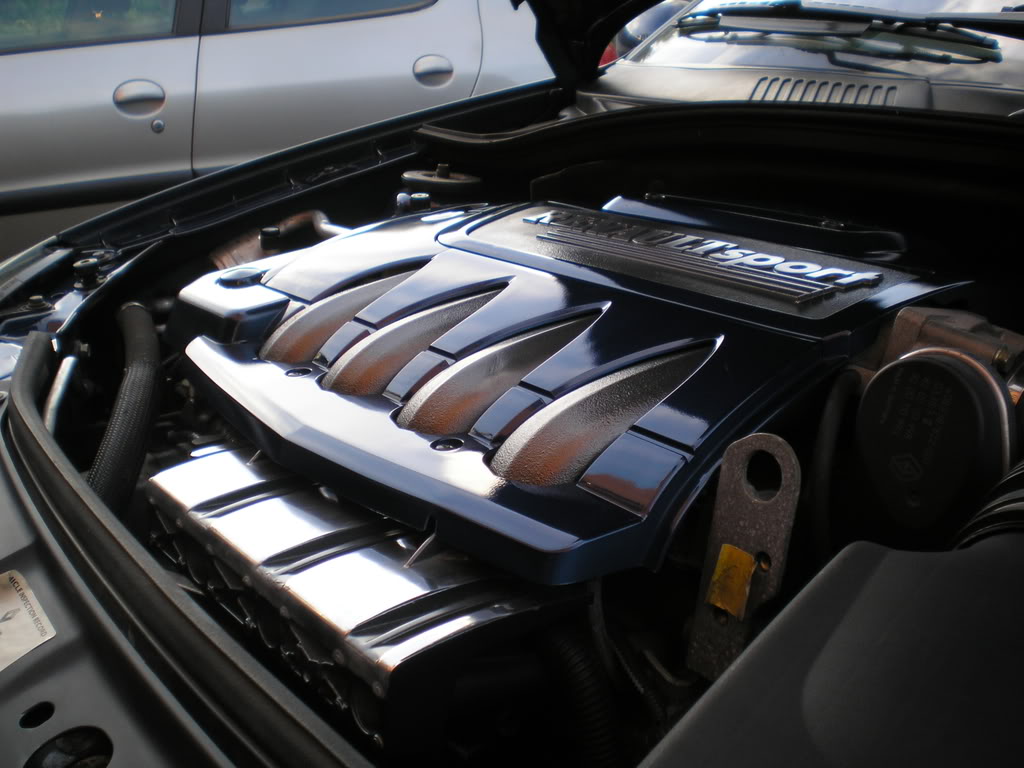

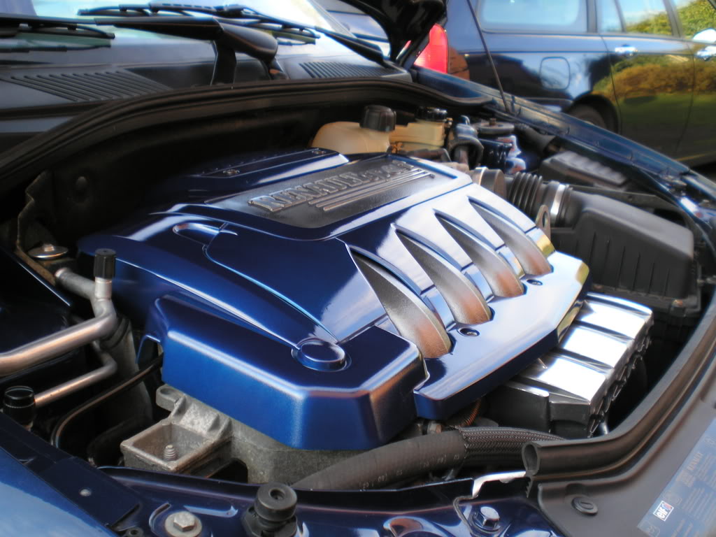

Looks very well done though pal. Pics of the engine bay from a far?

I've alwasy been against Halfrauds but il give em there dues on this occasion... I got some over the weekend too (to do my cover and bullets) and it seems spot on.... once the layers go on.... Looked s**te after 1 or 2 coats
Yeah sfter the first couple of coats it looked more like cup blue, but darkened with the layers, and the clearcoat finished it nicely
Yep exactly what I found!!... good to know it ends up looking okay... I made a bit of an error in not removing all the grease etc from mine... so its come through with the paint. DOH!

Looks very good. One thing i will ask though is did you use heat resistant paint? I cant see normal spray paint lasting very long before beginning to flake.

remove or paint that engine hoist mount tho, ruins it imo.
have you painted the battery terminal cover? if not, paint it monaco ;)
