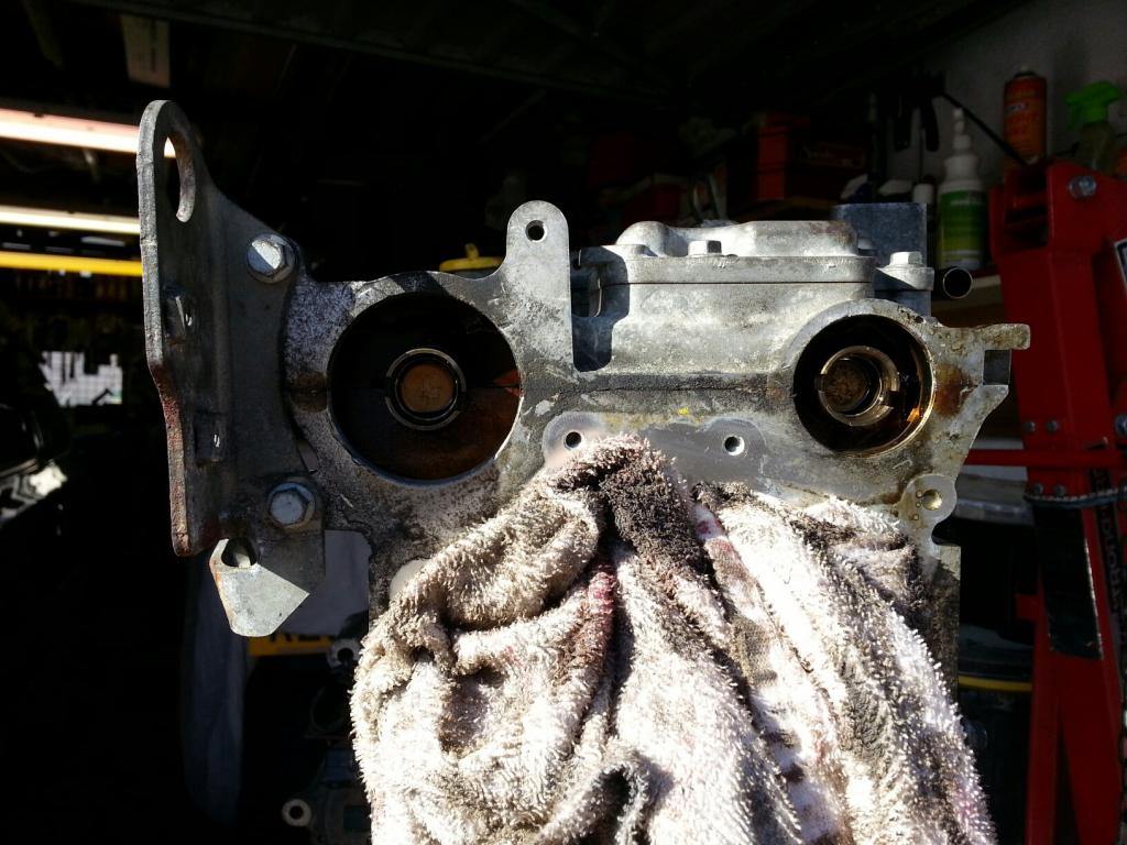

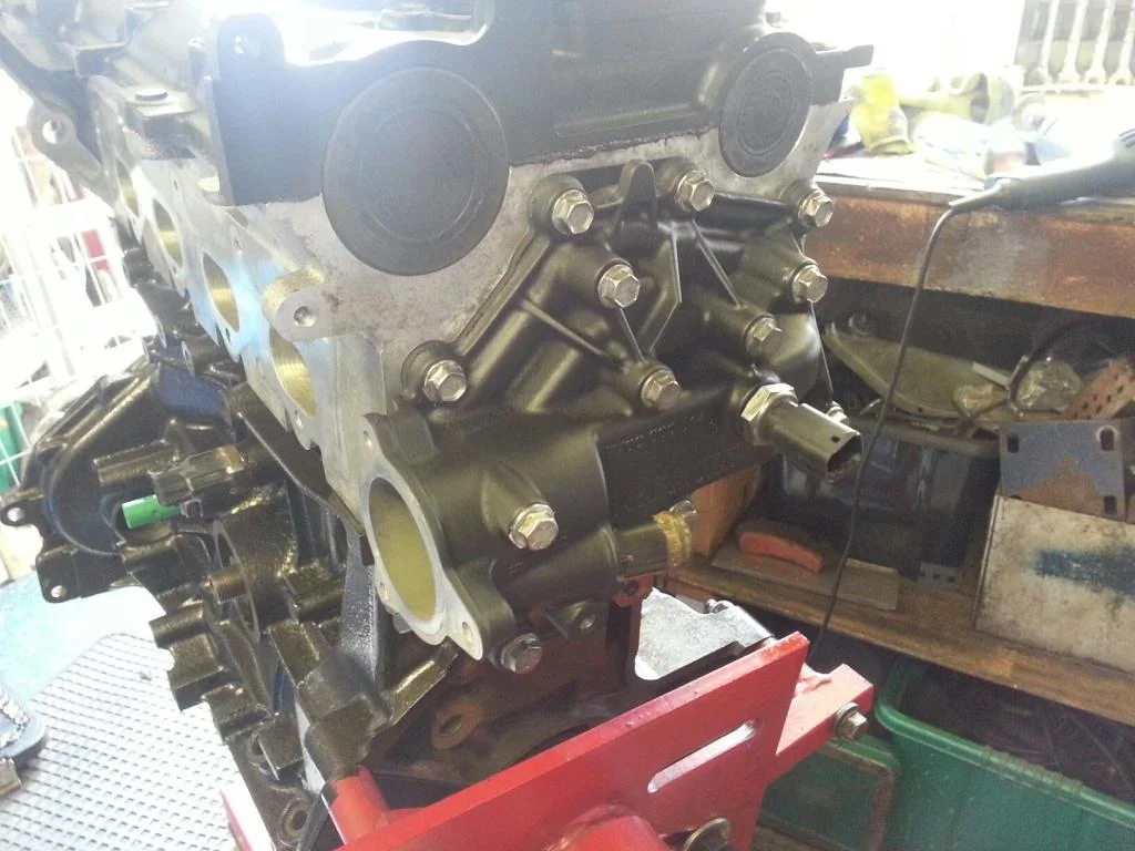

As for the 2 rubber cam bungs, not sure what you mean by this, are this the ones near to the airbox and throttle body? what shall I look for in there? (I am guessing that I should crank the engine by hand and check if the timing is correct by aligning horizontally the groves at the throttle body end, am I right?)
Look behind these bungs
this is how mine looked before I ripped it apart
