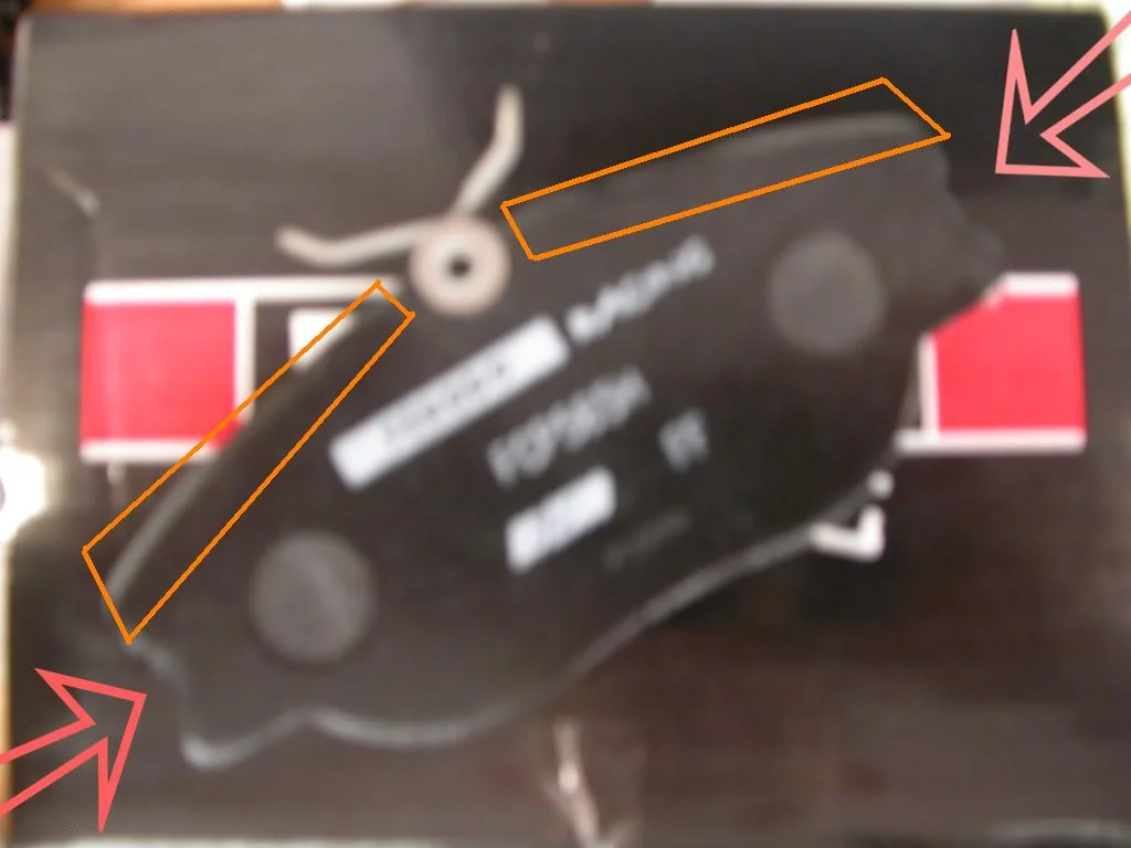

Nooo, it's hard to explain where I mean, if you look at the pads with the backing plate facing you, towards the top of the pad there is a slight chamfer, it was that I had to file down abit more. One second I'll try and find a picture
Where I've marked in the red rectangles is I had to file down slightly to allow the caliper to slide over the pads and yeah I pushed the piston as far back as it would go.

hmmm, not sure it that would do much as the clip holds it in tight anyway? strange you had to do there though. so long as they're ok now that's the main thing. make sure you bed them in properly and you'll love them.
Once I filed there though the caliper slid over easier though, oh well lol. Yeah I followed the instructions to another link you'd posted somewhere else about bedding brakes in (http://www.zeckhausen.com/bedding_in_brakes.htm) and now I'm just wearing them in. Even now I can tell a massive difference.
