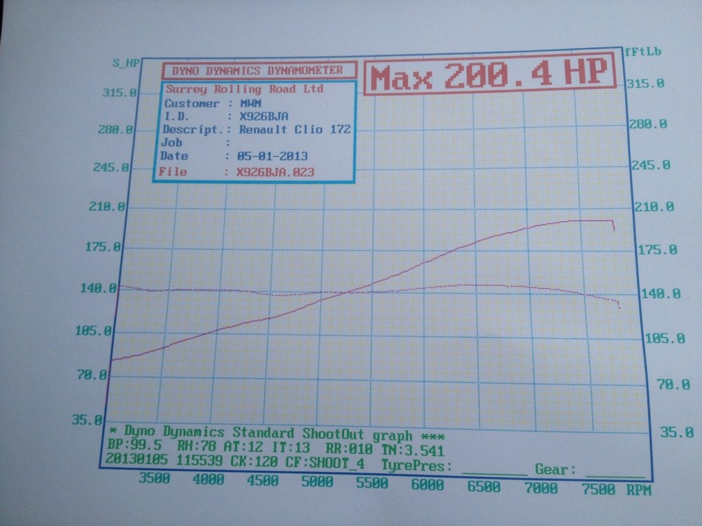

Ph1 172 & Clio DCi
Here we go again lol, another million page thread.
Our results seem to be consistent.
Spec:-
RS2
197 cams on Michael Woodford Motorsport timing
182 exhaust manifold
Decat
Cat back
140ft lb's nice that must be the 1.4L engine?
/troll
-j- the midrange on mikes was neer quite finished in the map, was running 12 flat afr, only reason it saw the dyno today was cause he is just about to remove the rs2 to sell, would have made about 145 I would expect.
Ah got you, so a few more tweaks of the mapping and it would have been up around where mine is![]()
Jay,
That was on a map I literally spent 10mins on just to dyno it. Ill post the AFR graph so you can see where it will make more power.
Tims brought the RS2 off me so I just did a rush attempt to get a dyno figure.

Mike, the torque looks to be sitting at 140lbft is this down to the cams or does the PH1 not perform the same as 172 cup for arguments sake?
As in the standard cams mine seems to sit at 150lbft?
Unless I'm reading the graphs wrong?

What's the cost of this setup? Just to clear it now, rather than a s**t load of people spamming it with s**t.
RS2- £1000
197 cams- £150ish
Belt kits £180
Decat- £70
Exhaust £200
Mapping £300
Based if you do the labour yourself.

Glad that when you text me earlier it cracked the 200bhp! My old engine this is, must have above 120k now and proving how strong these engines are when maintained properly! And obviously not forgetting Mikes handywork helped make the figures!
I've put 30k on that engine. What was it on when it was removed from your cup?
Tbh I don't think you could go faster for the cash with a Clio.
