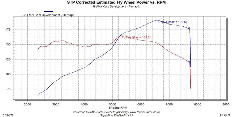

New to the market for the F4R 172/182 engine! Billet performance camshafts from only £999 FITTED* including FULL cambelt kit and FULL aux belt kit!
After recent testing we've seen peak power up over 190bhp and torque over 160lbsft on a STANDARD 182 remapped to suit!
check out the torque figure at 3000rpm!
you can add on a dephaser pulley to this package for £175
Note - the car will have to be remapped by TDF or RS Tuning, but is perfectly safe to drive without a map (short term)
So if your car is in need of a cambelt change or has a rattling dephaser why not add a set of cams!
Price includes VAT and 12months warranty
0121-783-6692
*(note this is an intoductry offer, normal retail price will be £1099)
Why does the rs2 lose torque over just cams as per above?

I assume people are using 197 cams because they are cheap? What sort of results would you expect to see with a car with 438's and a RS2? I'm currently sitting at 190bhp/162lb ft peak (150lb ft throughout range), and the £900 for cams already made me a little weak at the knees, i think after another £1000 i would be a little dissapointed with 200bhp and less torque :rasp:

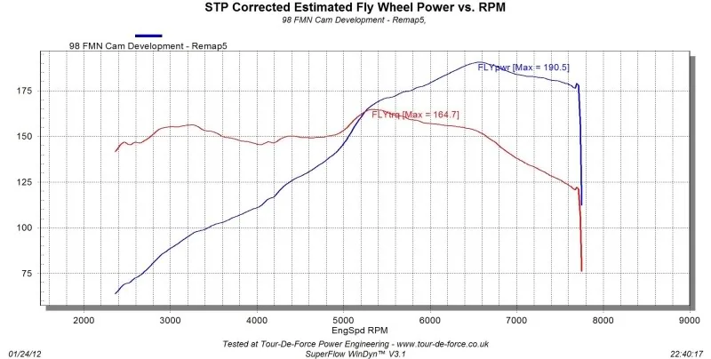

0121-783-6692
Tbh mate. You would have to spend a lot of money as I'm sure the standard injectors couldn't supply the fuel you would need.
So you would have to fit bigger injectors and rather than tweaking the fuel map, it would need to be totally re written.

The torque figure peaks earlier on RS2's and holds it throughout the range, but you guys are acting like those cams are laggy as s**t when they are actually not, you got over 150lbft at just under 3000 rpm but starts dropping after 5500 but still makes over 140lbft until 6500 rpm.

To answer your question and give you the benefit of the doubt that you are asking a serious question not just being a troll again:
The rs2 hasn't lost anything as that wasn't there on the standard car, it merely hasn't gained it in the same place, the reason for this is the cams aren't as long duration using 172 or 197 cams.
Likewise the reason the 438 have lost out massively compared to mikes at 7500rpm isn't a case of the cams have actually lost compared to standard they merely haven't gained as much as the standard inlet restricts them too much.
0121-783-6692
