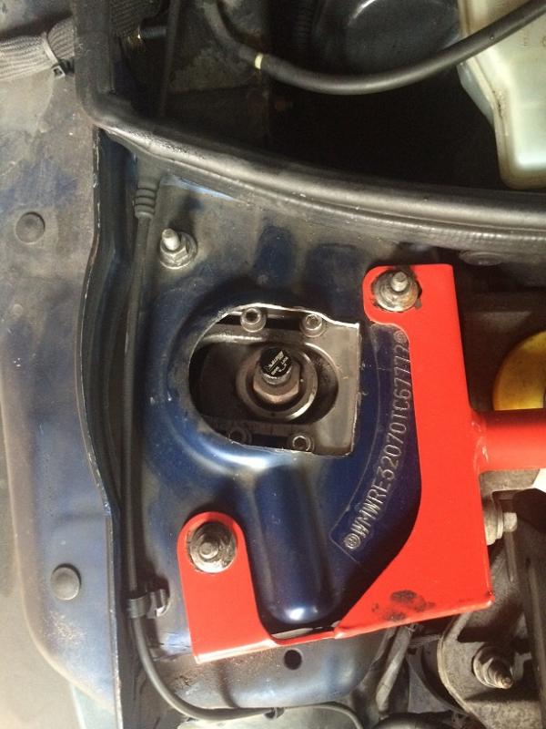

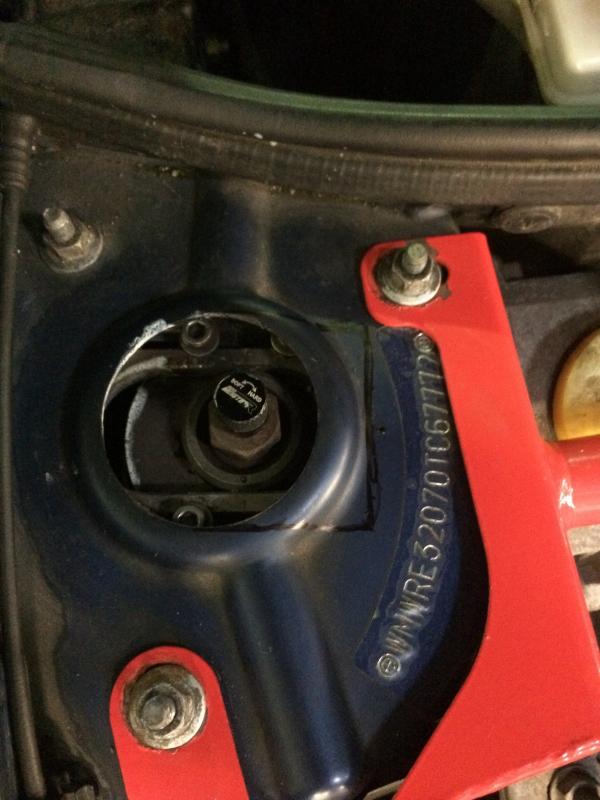

Strut tops were enlarged to allow easier camber adjustment. Angle grinder FTW!!
From:
To:

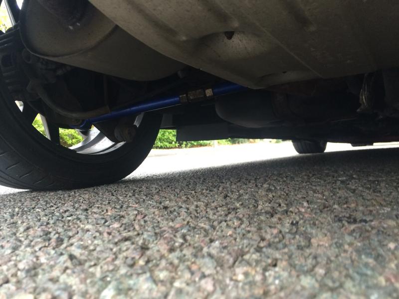

Then Whiteline rear ARB fitted:

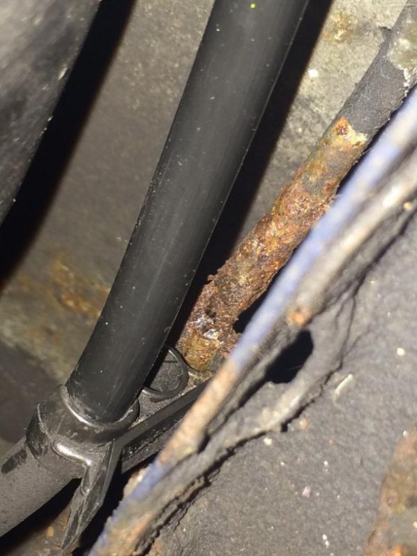

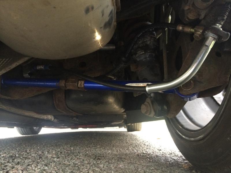

Unfortunately, on the way home, the brakes failed - not 1320's fault i might add!!
The culprit underneath the fuel tank:

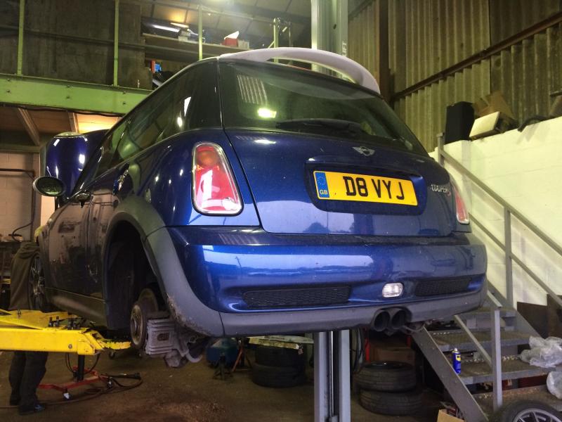

Which meant a trip to Minispeed in West Byfleet for a new brake pipe & hose.

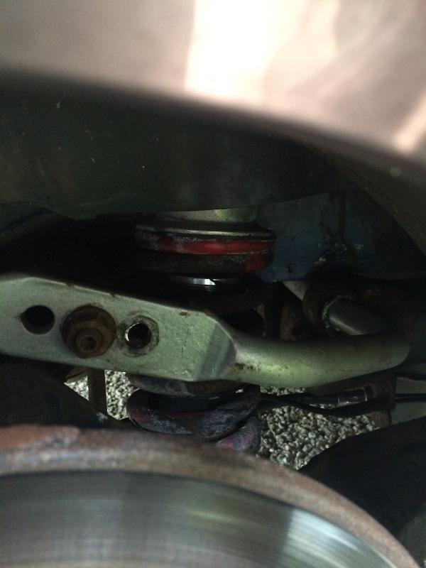

They also fitted a new handbrake cable & the rear Hardace camber arms that i bought a couple of month back:

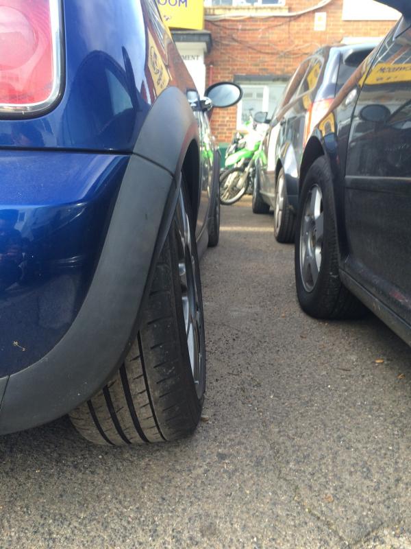

Before "alignment" - dunno how people drive with it like this lol:
Note the toe on the passenger rear wheel. They didnt sort this in the "alignment" as they couldnt get their equipment on apparently (not sure how they did the camber then ffs), so im going to sort it out myself over the weekend, the rear camber looks more positive than -1.5 as well, so need to check that with my camber gauge ...

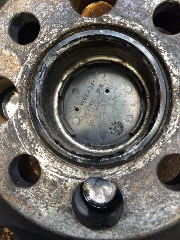

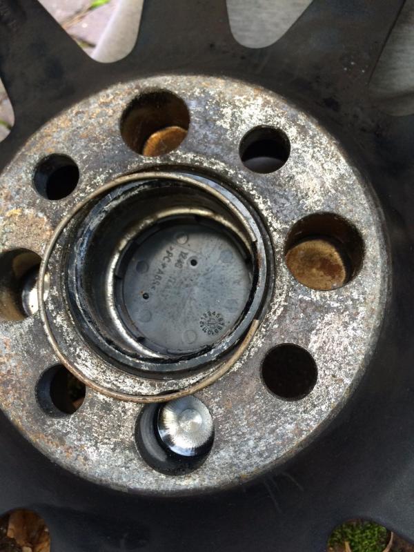

So, on Saturday Ollie82 and I discovered why the rear toe was off so much ... essentially Minispeed hadnt fitted the wheel properly, so the spigot wasnt seated correctly, but they'd gunned it on anyways, albeit only finger tight. So when the wheel turned, it wobbled from side to side, changing the camber/toe with each revolution. Really not happy, could have fallen off & killed me FFS!!
The metal ring that holds the spigot on, & how it was seated:
Damage to my wheel:
The wobble:
With this in mind, we then got the camber gauges out to check the front/rear camber that id asked them to set everything to: -2.5 front/-1.5 rear. Result (it looked off by eye in all seriousness):

So we re-did it to -2.0 front/-1.5 rear. Need to change the top mount screw holes in order to get more on the front, but as with other things on this car from now on, Ill be doing it myself where possible, not relying on others to do it in my lazyness. If you want a job doing properly etc.

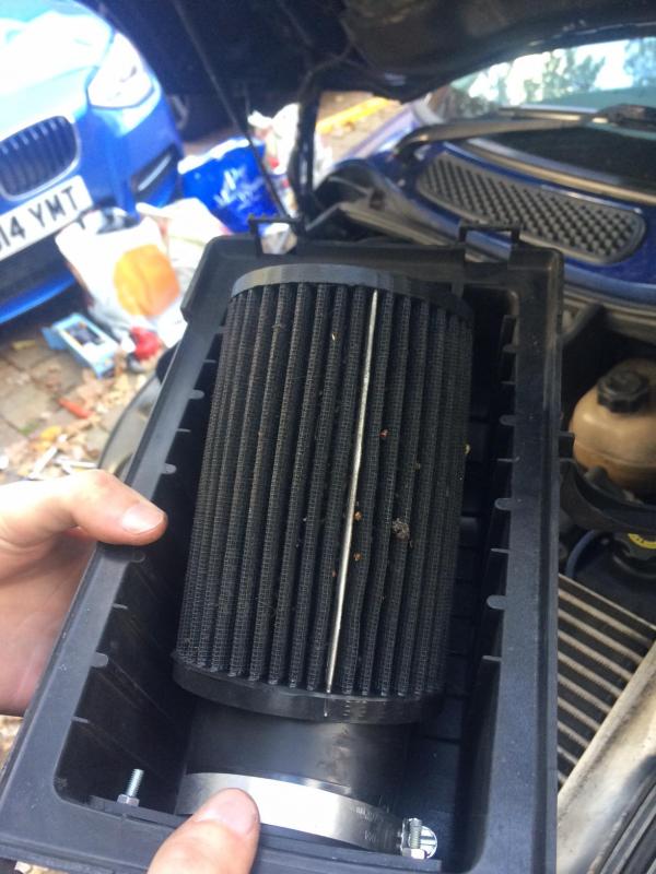

Also changed the K&N air filter. Bit grubby lol:

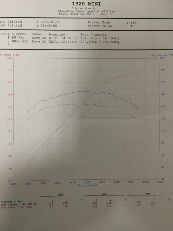

Quite a big one actually as i was at 1320 all day yesterday!!
Since "sparkpluggate" i've compression tested it (160ish across all 4, so perfectly fine), then fitted new OEM ignition leads and some colder NGK BCR8ES spark plugs. Got a coil pack as well, but it wouldnt fit, so will be sending that back instead. So onto yesterday:

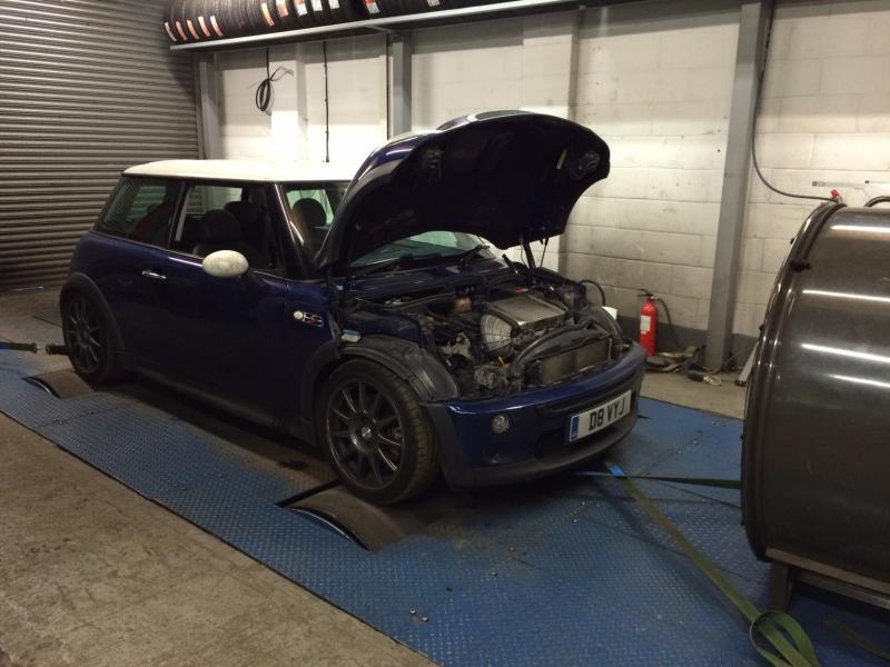

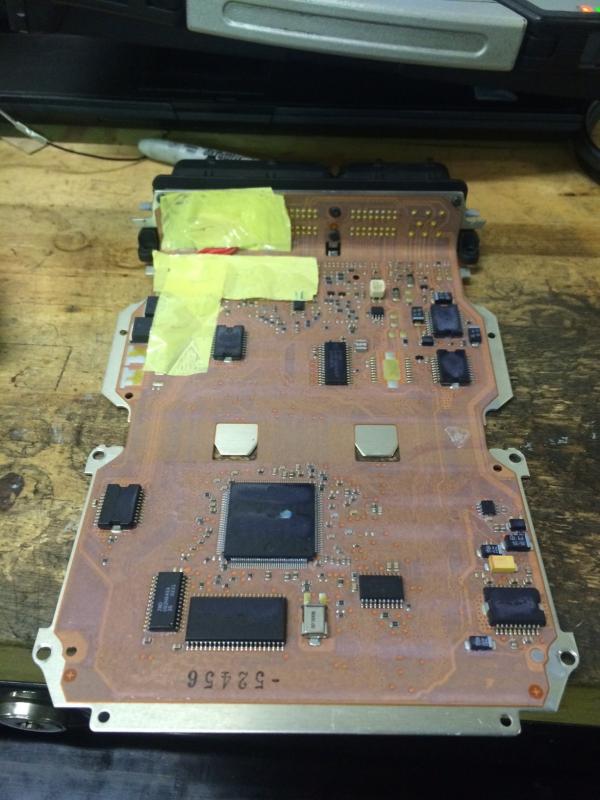

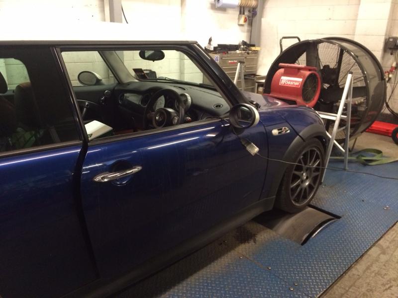

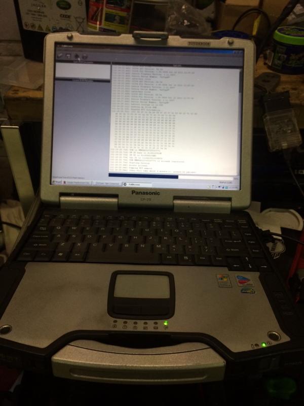

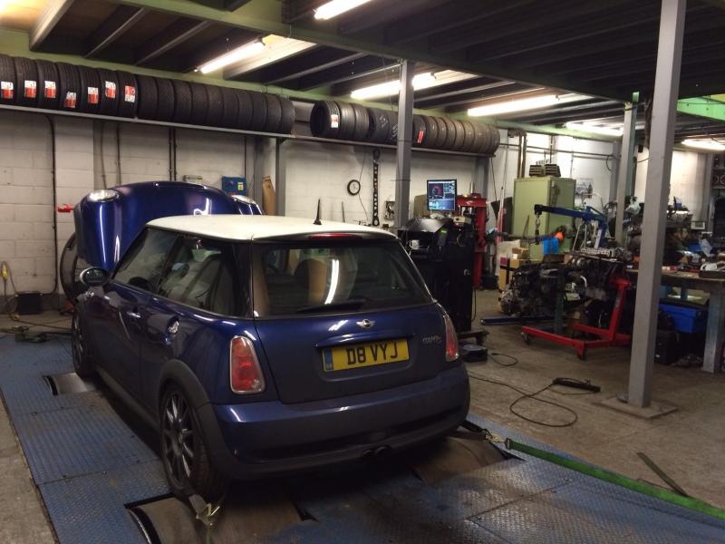

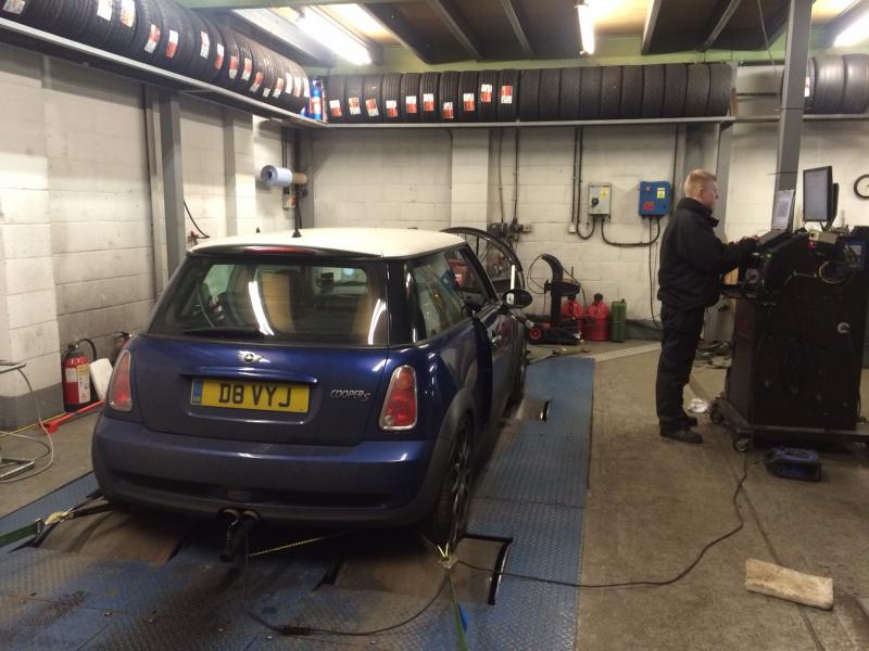

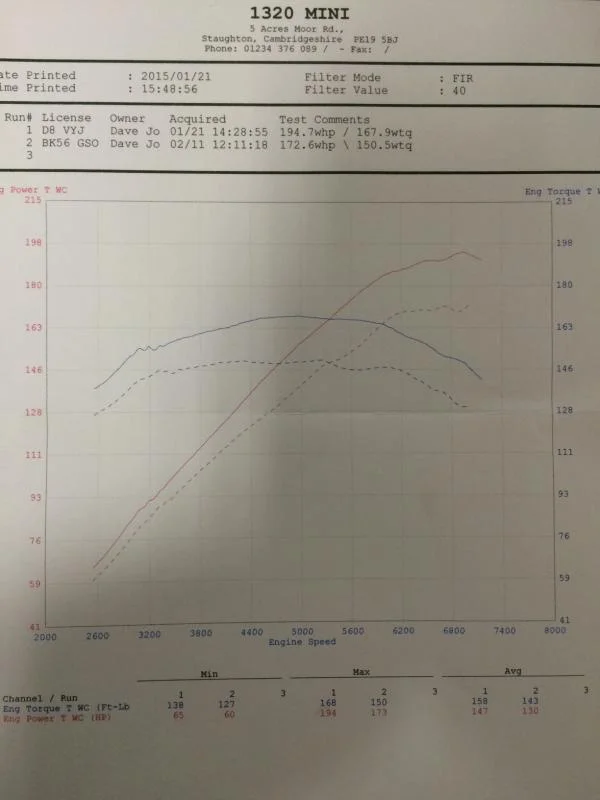

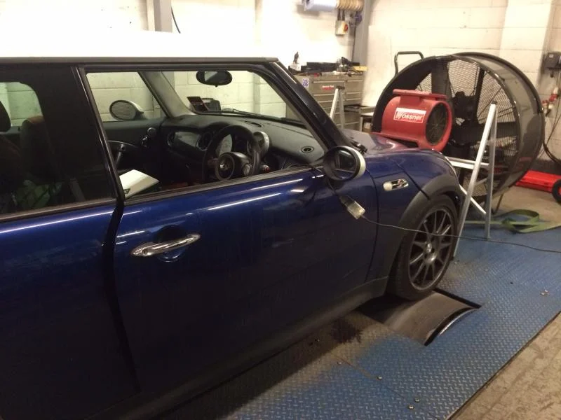

Got there at 9.30am, strapped the car to the dyno & Thomas removed the ecu to be read:

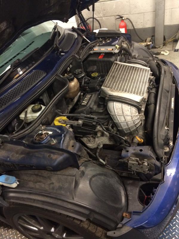

Engine bay needs a clean. Meh.

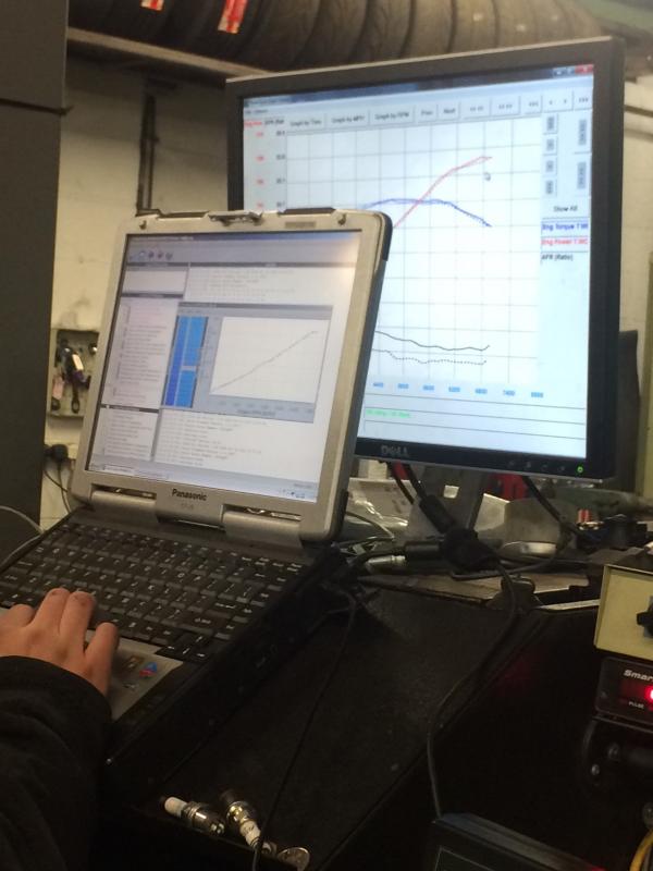

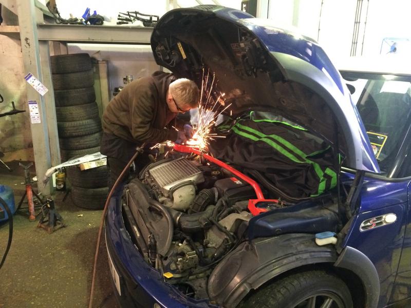

At this point, the ecu didnt want to be updated/read, so Thomas pulled it apart & soldered some things so that he could essentially re-boot it/wipe it/load the last tune back on & start afresh. Note the previous fixing that Richard's dad did to the board (hidden by the tape), things are never easy with this car lol:

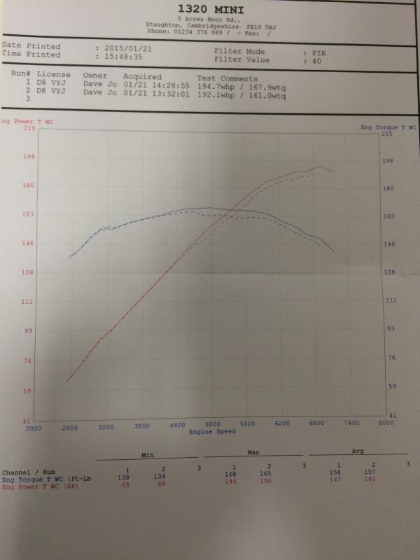

By 11.30 ish, after much swearing, the eco was sorted & the car did a base run:
At which point the map tinkering started (took some advance out/more updates/other tinkering):
Once that was done, AFR's were sorted etc, ended up with slightly more power & torque than previously. Happy days:
And compared to my previous GP:
Once the map was sorted, the rattly cam chain tensioner was changed and it got a quick oil change.
Now all ready for Bedford on Feb 28th, just need to bolt the R888's on and go for a play!!
