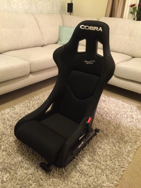

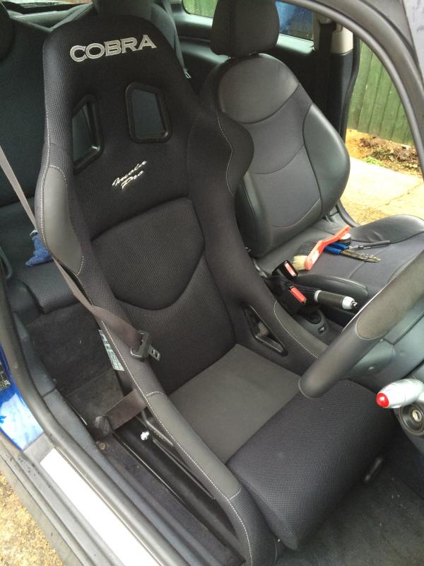

Picked up a Cobra Imola Pro last night, just in time for Bedford.
Only 1 though, as im a tight ar5e :laughing:

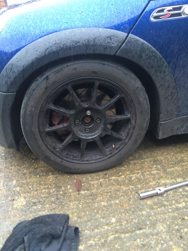

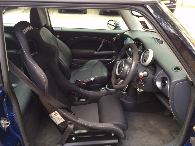

Apologies for the cr4ppy photos, it was raining.

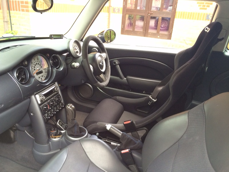

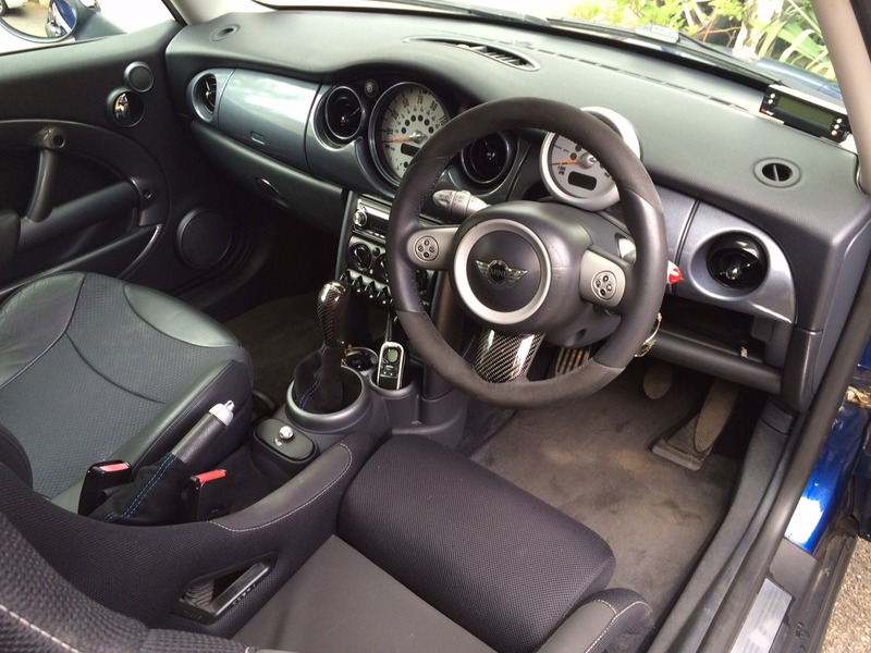

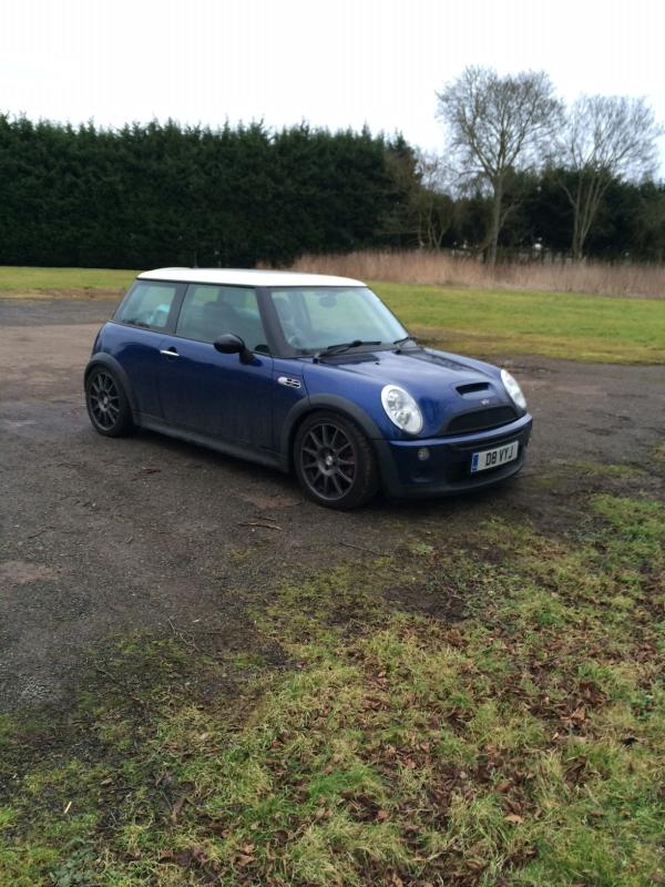

Seat fitted. Epic driving position now!!

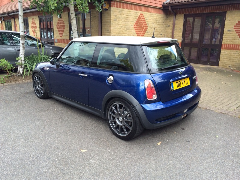

Wheel trial fitted, didnt realise they didnt come with spigots :tongueclosed: just bought some off ebay.
Also cleaned the mould off the roof with a dirty rag i found in my friends garage.
Nearly ready for Bedford on Saturday! Yay.

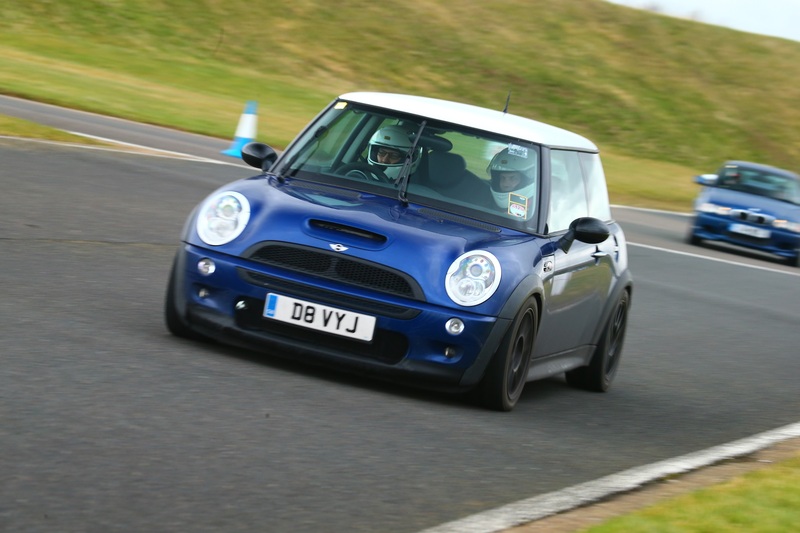

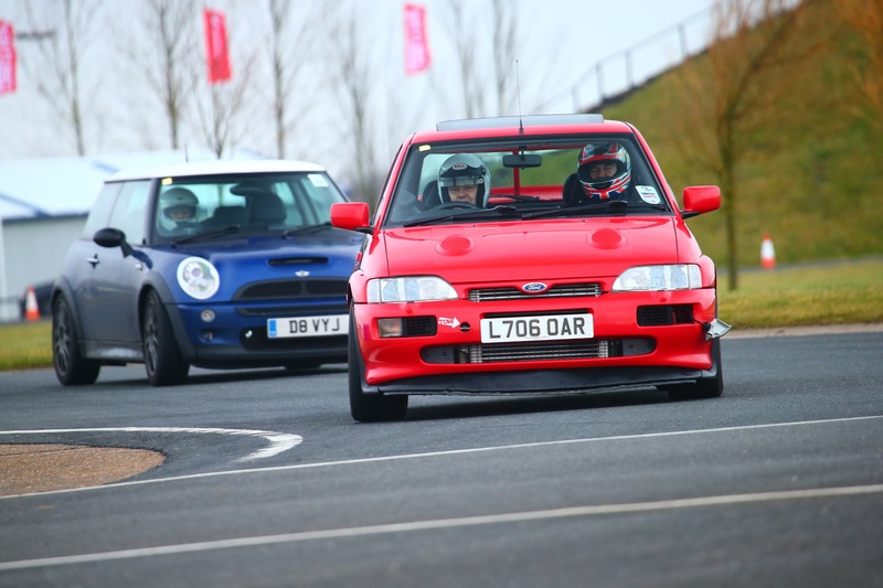

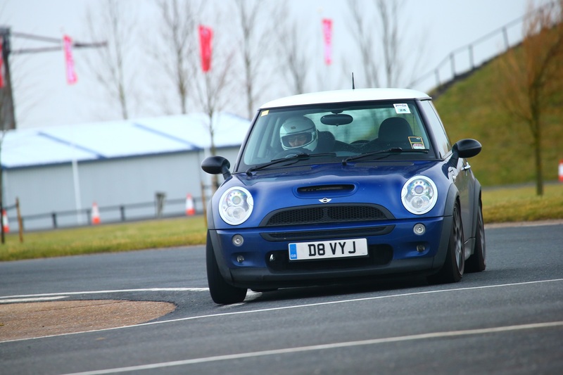

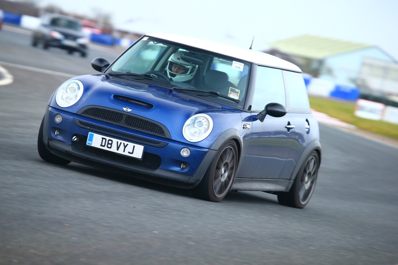

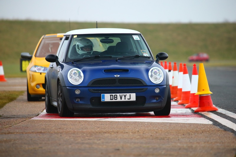

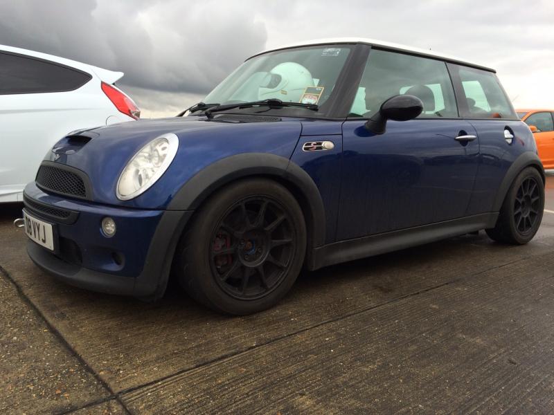

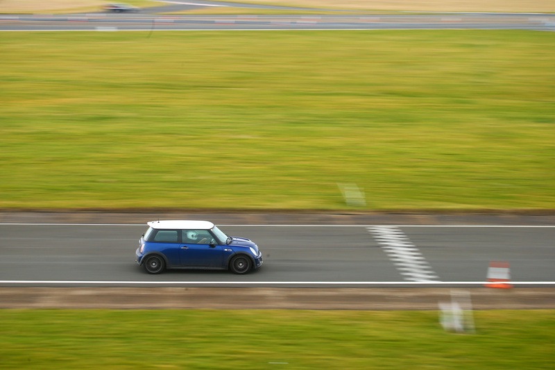

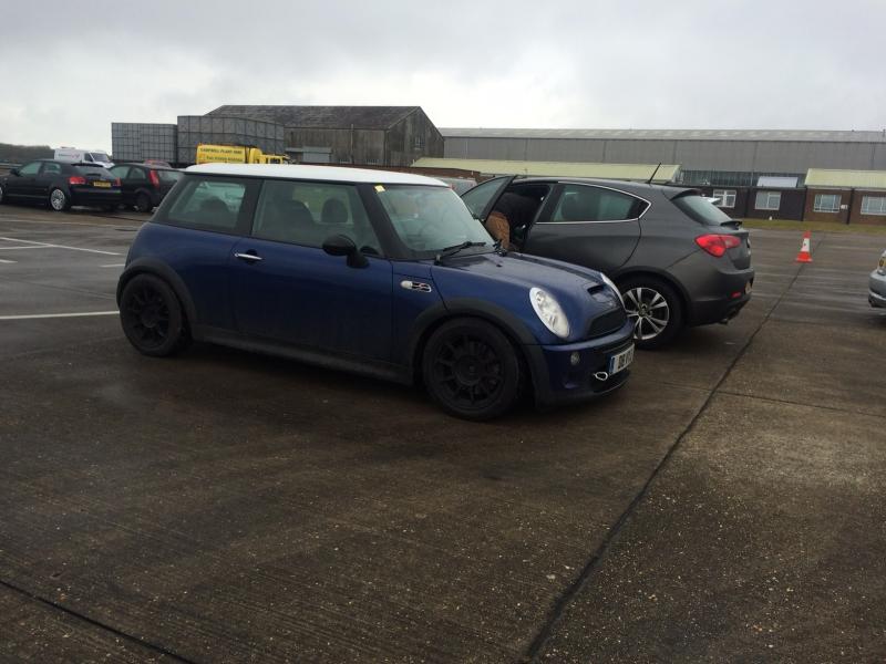

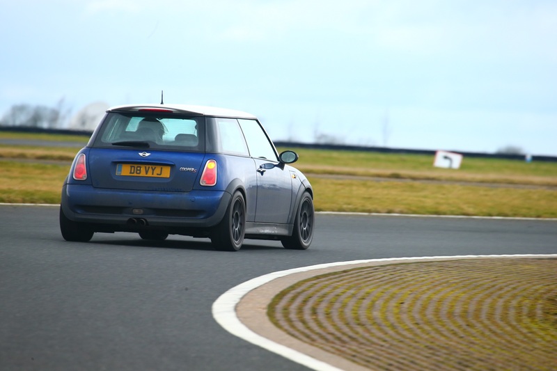

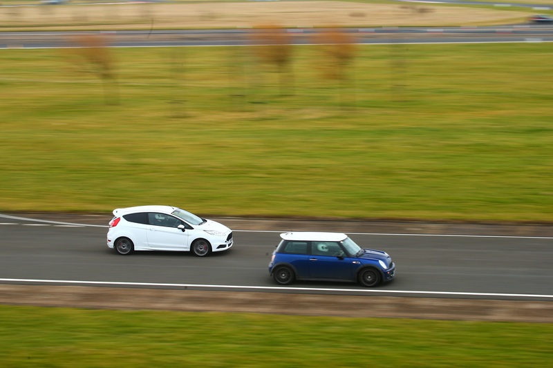

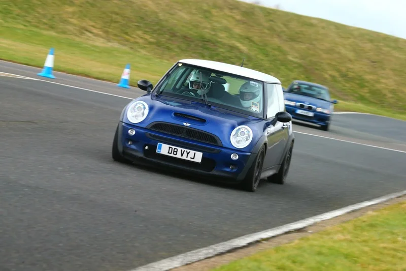

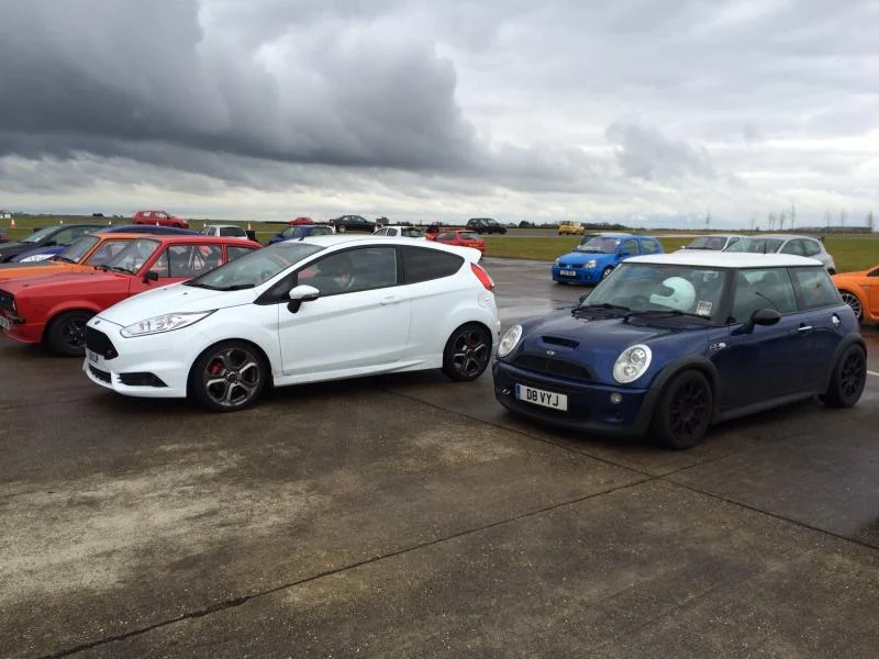

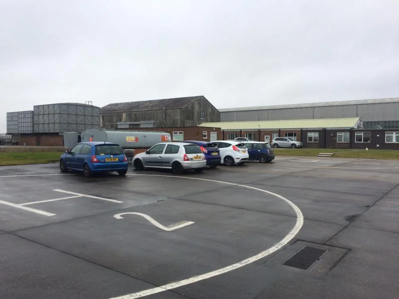

So Saturday 28th Feb was the Ford/Renault Bedford trackday on the SEN circuit, & happily, the car was 95% faultless all day long.
Engine pulled like a train, no spark plug/misfire issues (even at over 50IAT) so the new map from 1320 has cured all problems.
Handling wise, in the morning (damp) on the Continentals (Meisters set to 17fr/9r), the car was incredibly playful, good front end turn-in, but the ability to steer on the throttle whenever i wanted, oversteer on demand basically. Perhaps not the quickest way round the circuit, but certainly epic fun!! Myself & Tom were quite simply driving around giggling. Turn-in, lift, oppo, power. Brilliant!! In the afternoon (dry) the R888's went on & the rear dampers were turned up 2 clicks (now at 17f/11r). Compared to the morning, soo much more grip, incredibly turn in, at any speed, similar properties to previously re: LOOS but obviously at much higher grip thresholds. It was genuinely rapid.
Only issue all day was the brake pedal went a bit long (Minispeed didnt use the high temp fluid i gave them), so they need re-bleeding before the next trackday. Actual braking power was superb, there is simply no need for anything more than R56S fronts with XP8's imho, no fade at all, even after some seriously late braking lol.
In conclusion, i think ive now created something better than my beloved Trophy, the handling is the same (if not slightly more direct steering wise) and it has the power to overtake things that would previously have held me up on the straights. The extra bhp is also very useful for straightening the car up when staring out of the side windows 😂

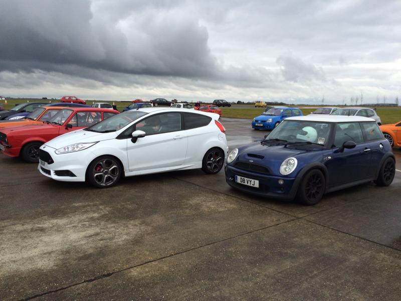

Some pictures, im awaiting the proper MSV ones, so just saome iPhone ones for now ..

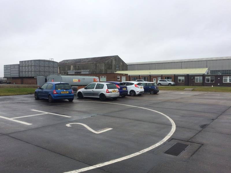

Hotel the night before:

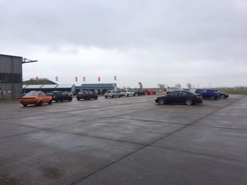

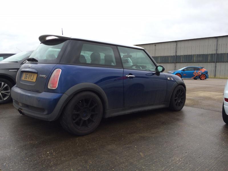

At Bedford:
What next? More track days. The Mini needs absolutely nothing else doing to it.

Awesome stuff mate. I see you finally got the wheels you were after!
Yup!! They dont make the R Specs anymore apparently, so got very lucky when the "Power Ranger" was being broken on MT. £400 for wheels & R888's with a couple mm tread left, was mega pleased!!! Did need spigots, but they were only £7 delivered off ebay.

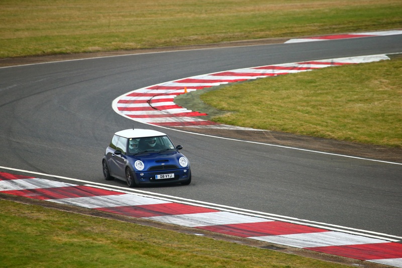

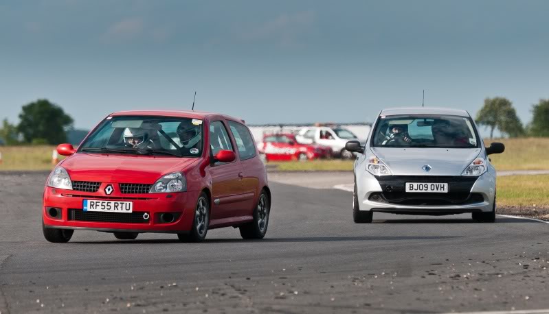

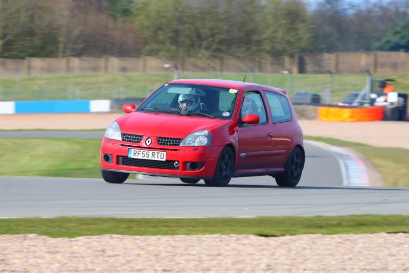

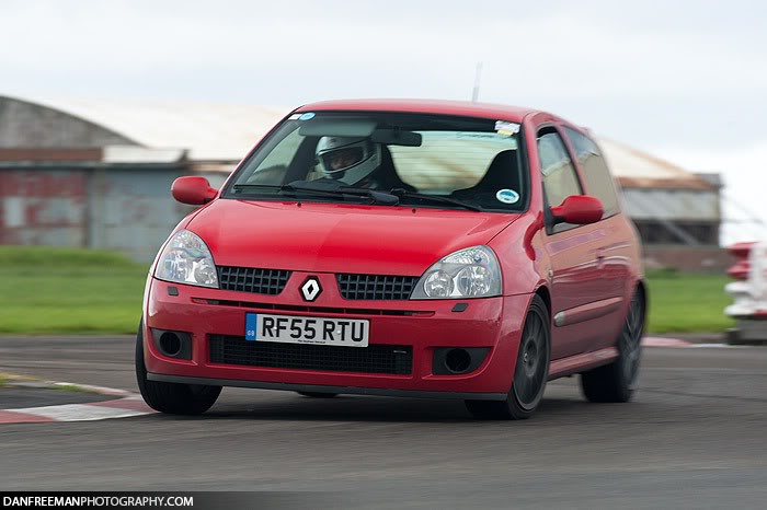

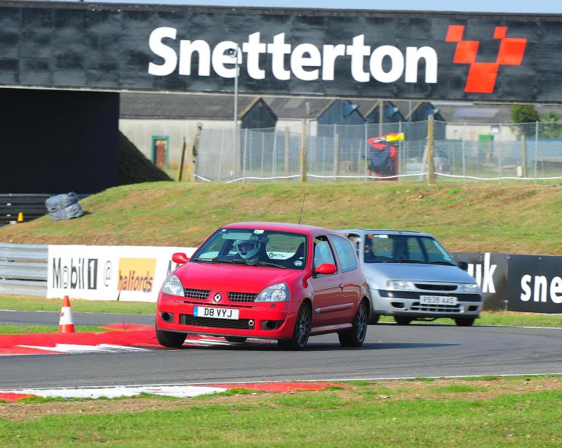

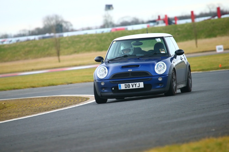

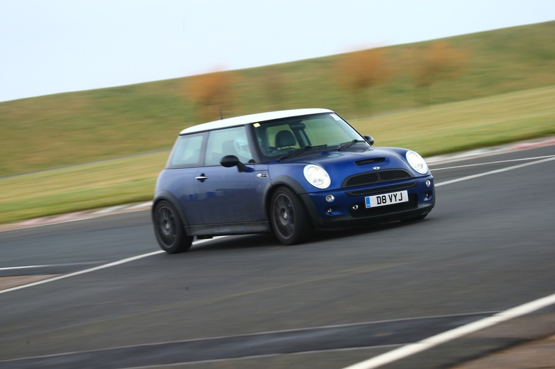

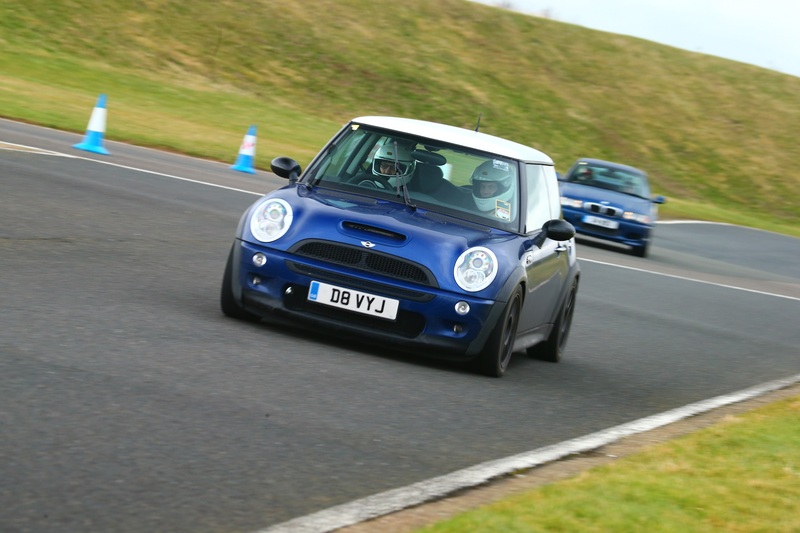

Just for some comparisons, hardly scientific as the corners were all different, but roll wise:
MCS on Meister R/conti tyres:

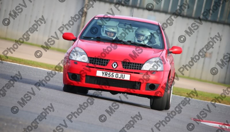

Totally standard Trophy on PE2's:
Totally standard Trophy on R888's:
Trophy with Sportlines, Whiteline Rarb, camber bolts & T1R tyres:
Trophy with Sportlines, Whiteine Rarb, camber bolts & R888 tyres:
Trophy with H&R coilovers, Whiteine Rarb, camber bolts & Hankook V12 Evos:
One thing i forgot to mention previously, is that the Trophy was ALOT better than the Mini on the road, the Sachs dampers were just sublime - perfectly damped for A/B roads, making it an incredibly good off the peg track/road car :up:

Awesome shots! Really nice pics of a really nice car. [emoji106]
I want another MCS badly [emoji17]
Interesting comparison shots too. The minis are a real hard and flat ride.

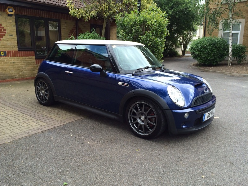

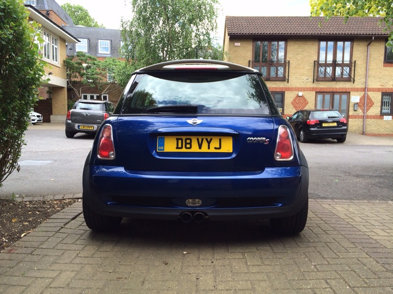

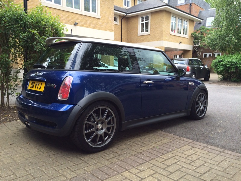

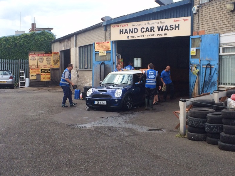

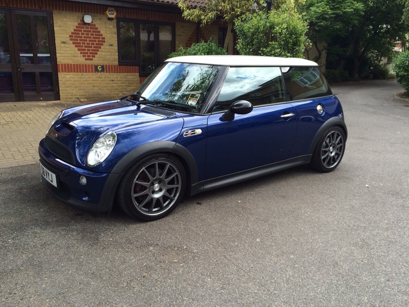

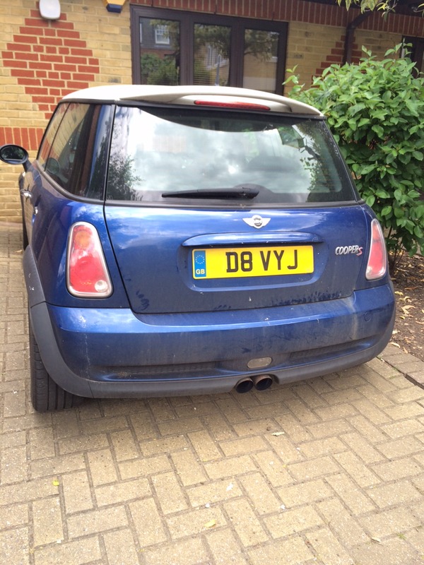

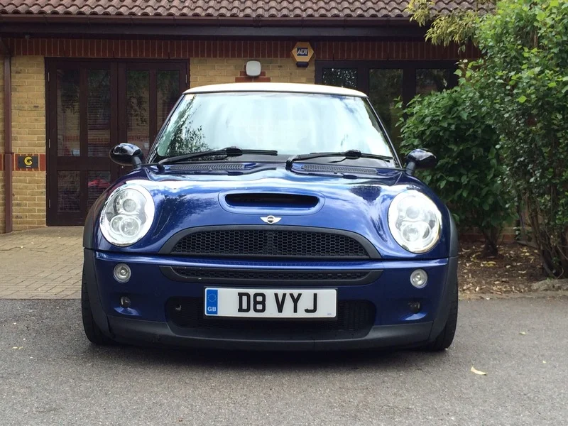

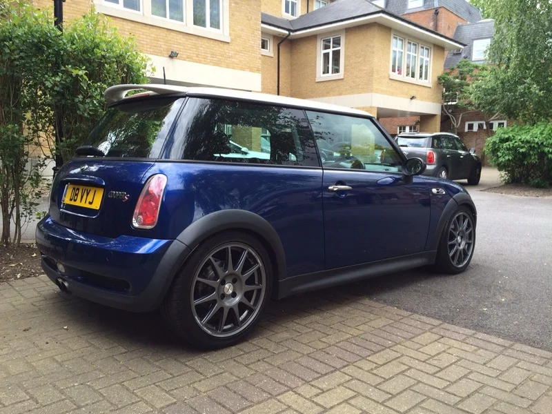

So, as i cleaned the M135i yesterday, i thought i had better give the mini some love.
After all, ive owned it since last August, done two trackdays and a few thousand miles without it seeing a sponge:
So i went to see these chaps:
And they made it look like this:
Cosmetically, bar a carbon JCW gearknob, the car is finished. I'd like the roof black, but i dont want to pay any money to do it. Mechanically its running very well, i fitted new rear discs/pads after Bedford, but the brakes do need a bleed before the next trackday i think - if only for a bit more pedal feel. Long term plans are simply to enjoy it on road & track, i might fit a Quaife at some point (& possibly a facelift gearbox), if/when it needs a clutch, but that very much depends on how much money gets spent on the car to replace the M135i over the winter.
