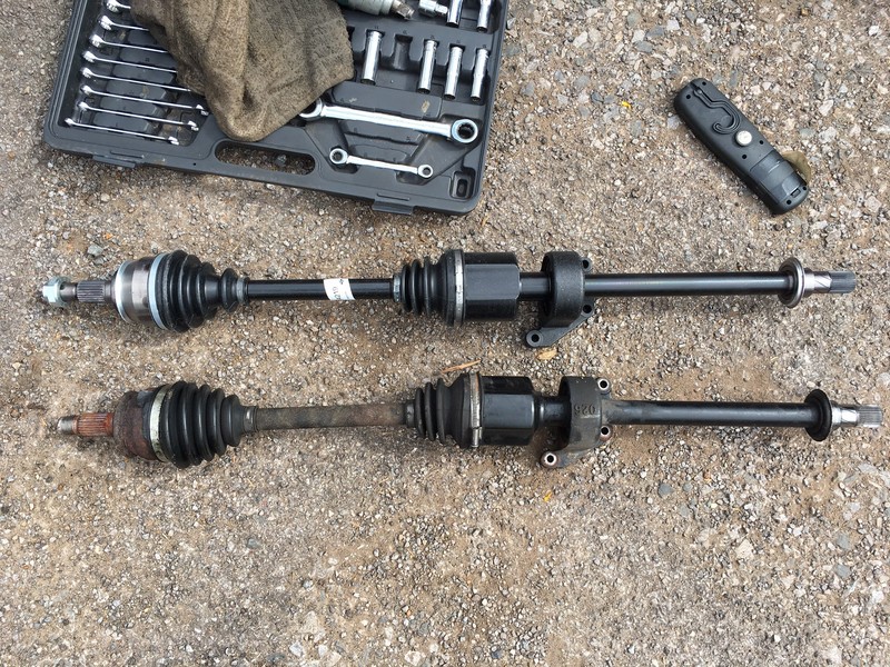

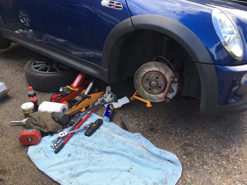

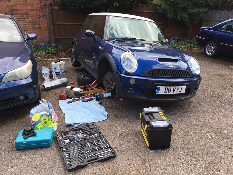

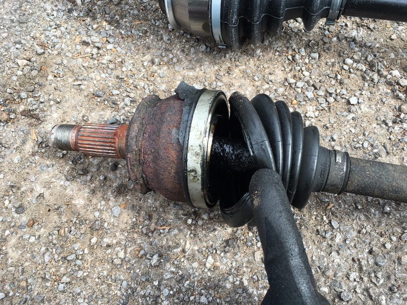

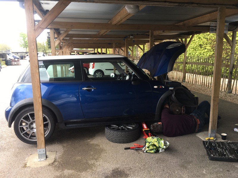

So the mini hasn't really moved since the Bedford track day at the end of Feb due to this:

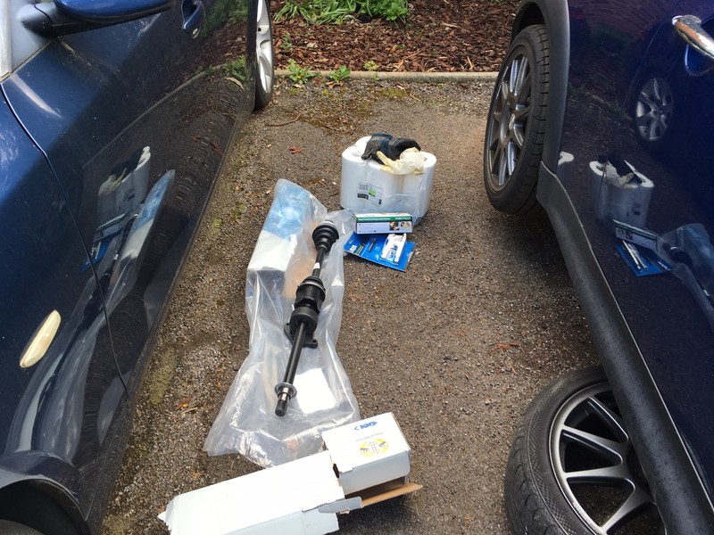

The outer CV boot had torn completely on the drivers side, dumping grease quite literally everywhere, over the wheel, brakes, etc. Such a flipping mess!! I had been in two minds what to do for a while, hence the delays, seems that in order to replace the outer boot, you need to remove the driveshaft and split it down, meaning that id have to buy a new outer boot/grease, new inner boot/grease and get mess everywhere. With both sides having done 100k miles and quite a few track days now, imho it made more sense to get new ones ... Mini wanted £770 after discount, so i went with GKN from ECP instead (£300 for both). After all, they are more than likely the OEM supplier anyways!
Only fitted the drivers side so far, along with a new ARB drop link as the passenger side is still mostly in one piece, but will get that done as well after the car is MOT'd on Saturday.
My Safety Devices rollcage has also been delivered to Millsy's Autos now, so i need to get up there at some point & get it all installed. Have also decided that i need to get some more cold air to my front brakes, so will be removing the fog lights and hacking away at the wheel arch liners at some point.

Is your axle stand made of cheese?
LOL.
SRS belt and braces, Captain Safety.
lol, as Mike knows, i am Mr Health & Safety 😂
In effect though, as its so low, i need the red low entry jack to get the car up in the air, but it doesn't rise very high, so then use the yellow one to get the car up a little higher to get the axle stand under the car. Even then, as neither jack goes up that high, & the car is so low, when i crawl under, my face is effectively on the subframe, so if it moved even slightly, id get stuck/squashed, so use pretty much everything i have to keep the car in one place!!
Ideally id have gone to Basingstoke and used my larger jack/Sarah's dads 3 tonners, but its got no MOT and couldnt really be driven due to the cv boot - although thats what i tend to do for anything that involves getting under the car :up:

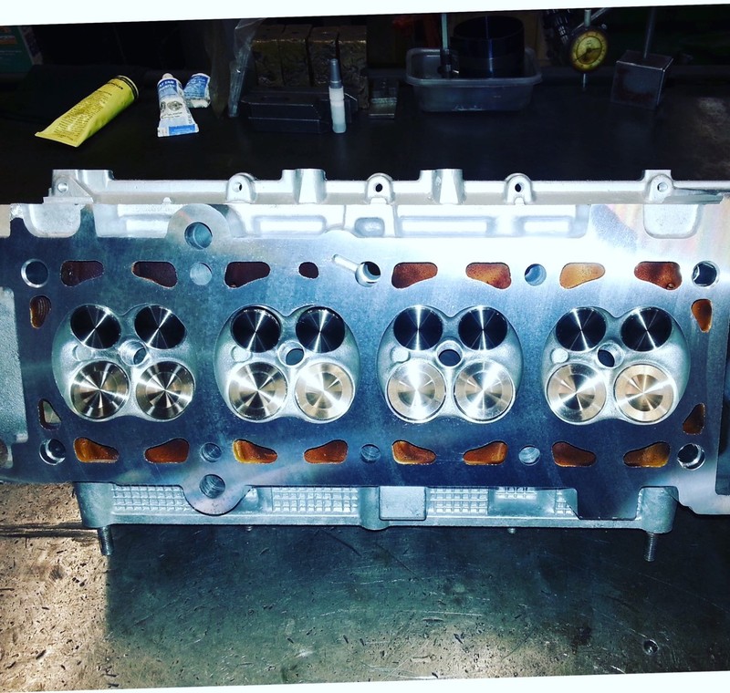

So after my pondering re: blue smoke on startup here: http://www.cliosport.net/threads/decisions-re-track-car-the-mini.793728/

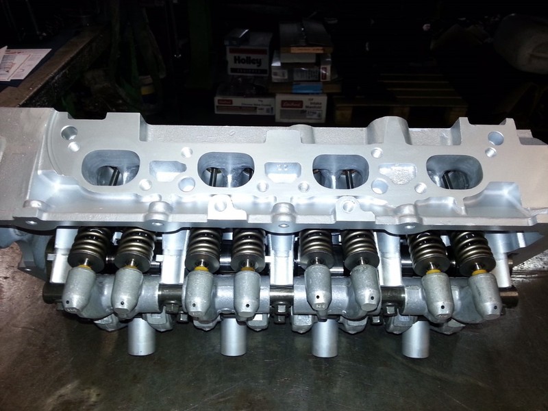

I bought a solution the other day off bidsy26 on Minitorque:
The head needed to come off to change the valve stem seals, so it made perfect sense to upgrade everything at the same time. Man Maths.
Its a Lohen Ported Head with enlarged Schrick inlet & exhaust valves. Got some ARP head head studs as well.
When mapped up, it should give me another 20-25WHP at a guess?

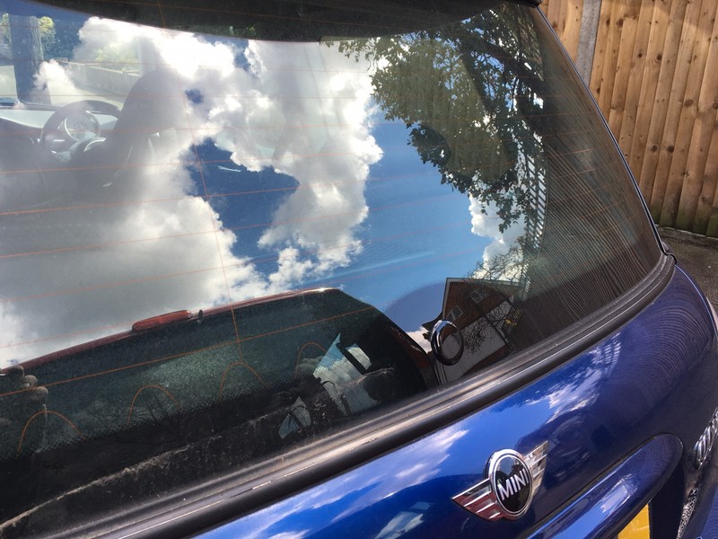

I can't remember/be bothered scrolling back through pics. Have you dewipered the rear? If not do you want the sticker for it? I'm clearly not going to need it!

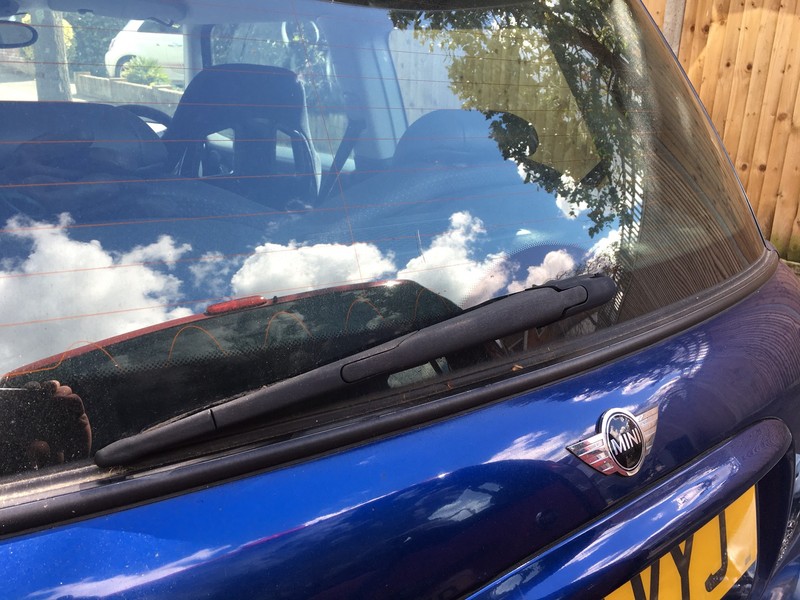

I have done it, just not documented on here, thanks for the offer off the sticker though :up:
to
Looks alot better imho, & as the rear wiper didnt work anyways, no worse visibility wise lol.

So as with most things, this is potentially spiraling again 😂
A BVH obviously has much bigger exhaust ports, so if i don't fit a better manifold (Janspeed 4-1), i will have a bottleneck. I need to keep the cat to keep noise down, but the Janspeed Sportscat is only rated for standard power (lol), so i need my cat modified to fit the new manifold. Then if ive got bigger inlet ports on my head, i might as well put the higher lift Catcam in there to make the most of it. Following that, as ive previously had issues with fueling etc, i want bigger injectors, purely as everyone else with a tuned mini runs the 550's these days, not the 450's (what i have), as the spray pattern is better and they are apparently easier to map.
To be brutally honest, i'm not sure i really need circa 230 bhp at the wheels (an extra 35 over what i have at the moment), but it would be silly not to spend the extra £600 on manifold/cam before getting it all mapped up again surely? My "cheap" track car has turned into some kind of quest for moar power. The trouble with boost i guess?
In the USA people used the standard mani and cat up to 270bhp.
I'd deffo go for 550's though. 450's will be running fairly high duty cycles.

Sell BVH, source replacement standard head, stop letting the scope creep.
I tend to agree tbh.
With that in mind, the R53 is going to come off the road long-term, for me to rebuild the existing head (new valve stem seals etc) - i've always wanted to pull an engine apart, so now is the ideal opportunity. Furthermore, i simply don't want to spend £2.5k building the top end to an epic spec, for the 100k mile bottom end to then give up the ghost. Luckily a lot of parts that are currently fitted to the R53, will also fit an R56, so happy days

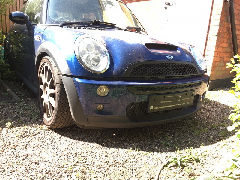

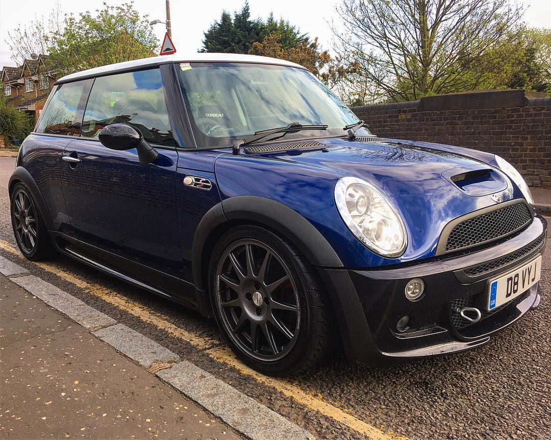

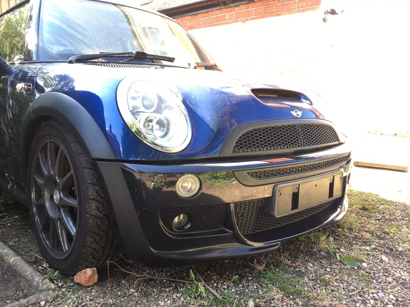

So with a deposit now placed on the R56, i swopped the Turinis/AD08R's back onto the R53 yesterday afternoon.
With it being nice & sunny, i also decided to fit the Aero front bumper that's also been clogging up the shed for aaaaaages ....
Before:
After:
Now, here is the slightly off-kilter part, with me being an utter gypsy when it comes to paying others to do things, i think i'm going to leave it as it is and not bother painting it. As it happens, i also have a set of aero side skirts (as below) in the same colour, so im thinking about going for an Indi Blue up top/Astro Black down below theme - just need to get hold of some 3M gloss black wrap to get rid of the hideous white roof then.
Have a track day at Goodwood on the 1st May, so think i have my hands full getting it running ok before then!!

That looks proper with the aero bits
Cheers, i was unsure when i bought them, but i think it goes well with the overall ethos of the car, i.e. its a surprisingly quick shed 😂
Why is the kit a different colour?
Mainly because im a gypsy that wont pay £300 to get some parts sprayed (they were, like 99% of things on this car, 2nd hand)... but also because i think it looks kinda cool. Will be 100% better once ive wrapped the roof gloss black!!

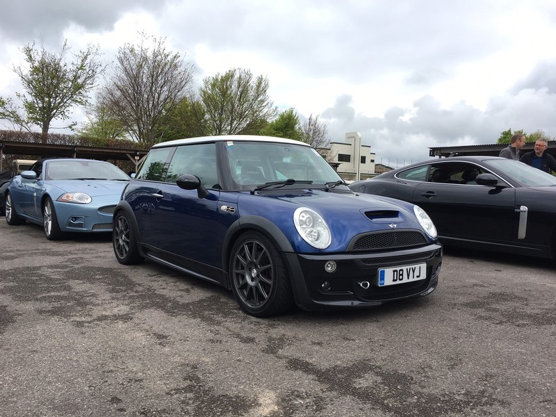

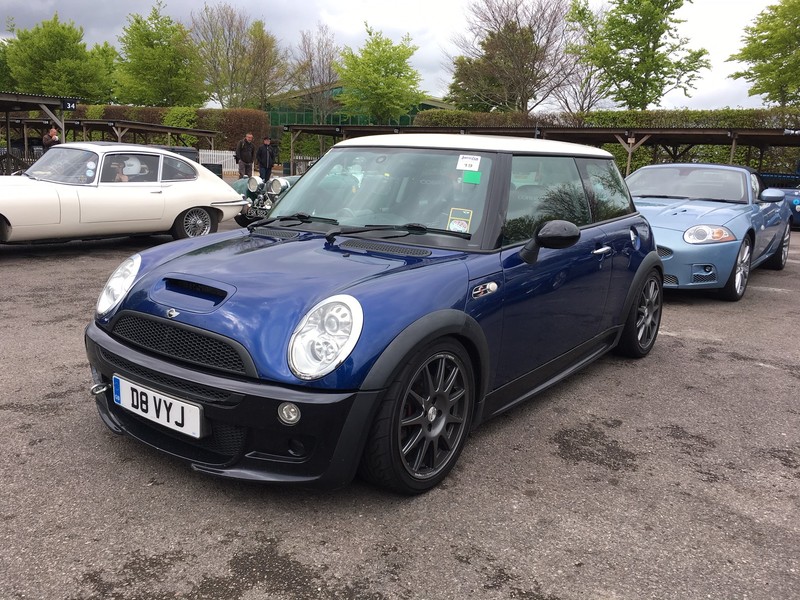

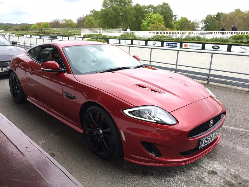

So Monday saw the R53's first trackday since Feb 16, bit random, but as Sarah's dad has an XKR, it was at Goodwood, with the Jag E-Type owners club. Which naturally, as you can imagine, saw an excellent selection of machinery!
The XKR, a last of the line Dynamique with a fresh set of PS4S':
Other finery:
First few laps went ok, having never driven Goodwood, i was taking it a little easy, but well, still seemed rather a lot quicker than most other things there lol.

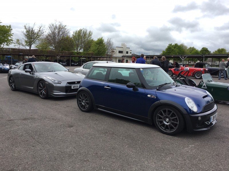

First few laps out where wet and a GTR had appeared for some trackday fun. It had 600bhp, but i did have a slight inkling that having experienced such cars on track before, it might be a case of blooming fast in a straight line, not quite so much talent in the corners, they do appear to be a great car for wealthier chaps that want a "beginners" trackday car ....
After that, he simply asked WTF i had done to it and whether i was related to Nick Swift, ie the epic Mini racing hero chap 😂
